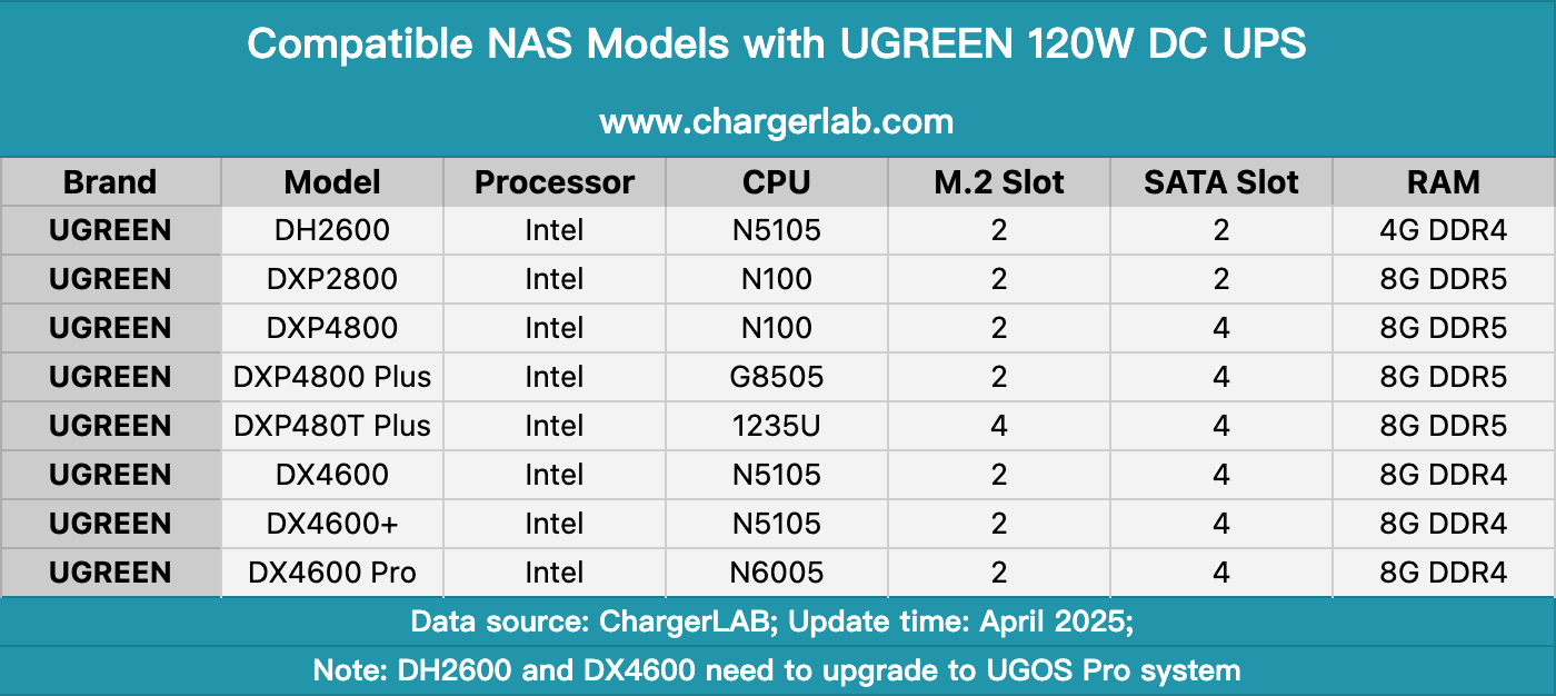

The above are the NAS models that are compatible with the UGREEN 120W DC UPS, for reference.

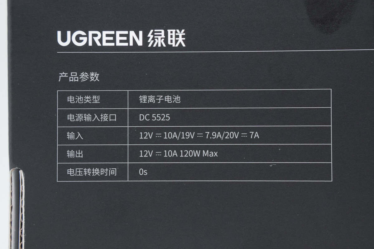

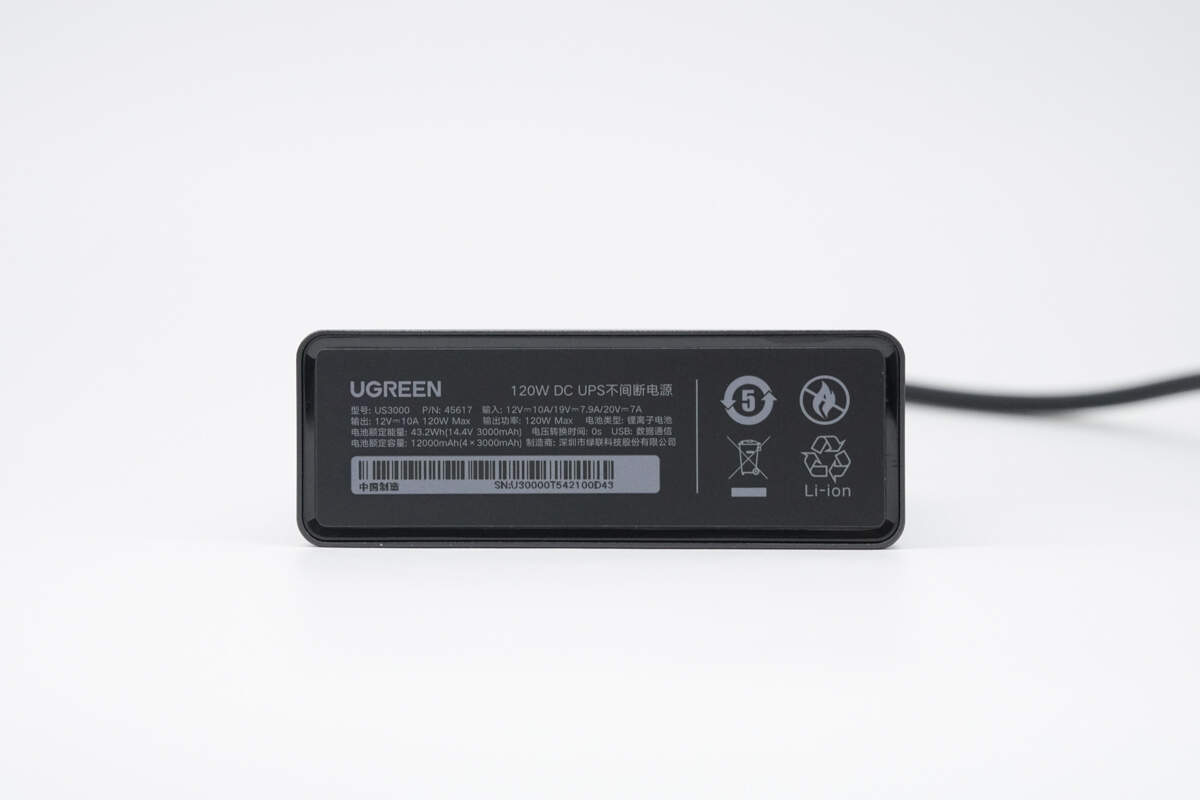

The spec info is printed on the back.
Review of UGREEN 120W DC UPS (Uninterruptible Power Supply)-Chargerlab
Battery type: Lithium-ion battery;
Power input interface: DC 5525;
Input: 12V 10A, 19V 7.9A, 20V 7A;
Output: 12V 10A, 120W Max;
Voltage conversion time: 0s.

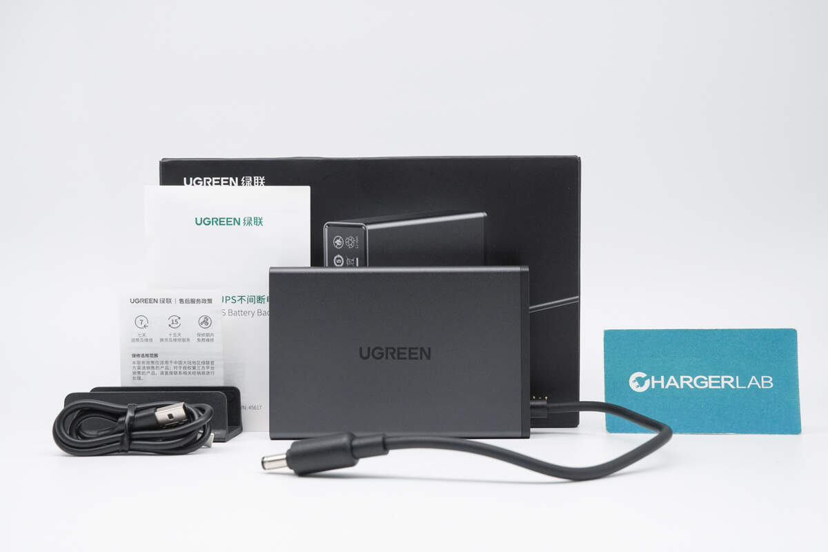

The box contains the power supply, a USB-A to USB-C cable, a bracket, and some documents.

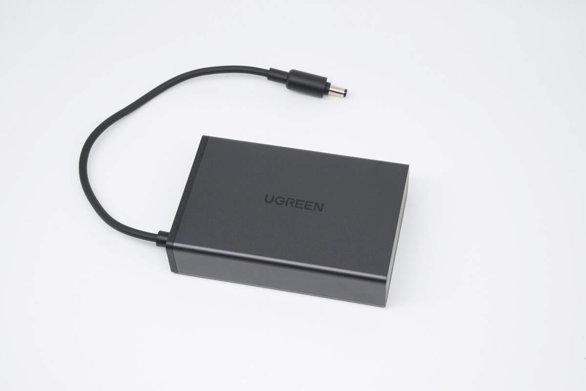

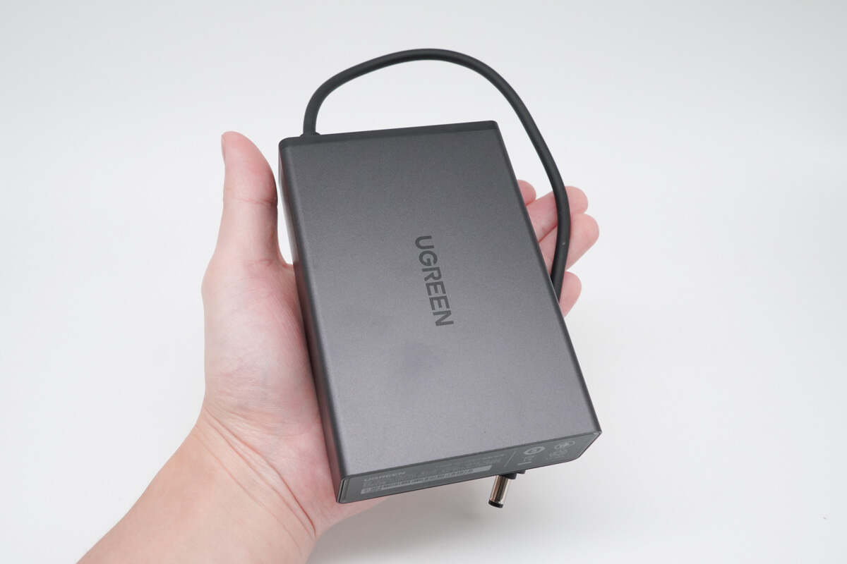

The UGREEN 120W DC UPS is made of aluminum alloy and comes with a DC5525 power cable.

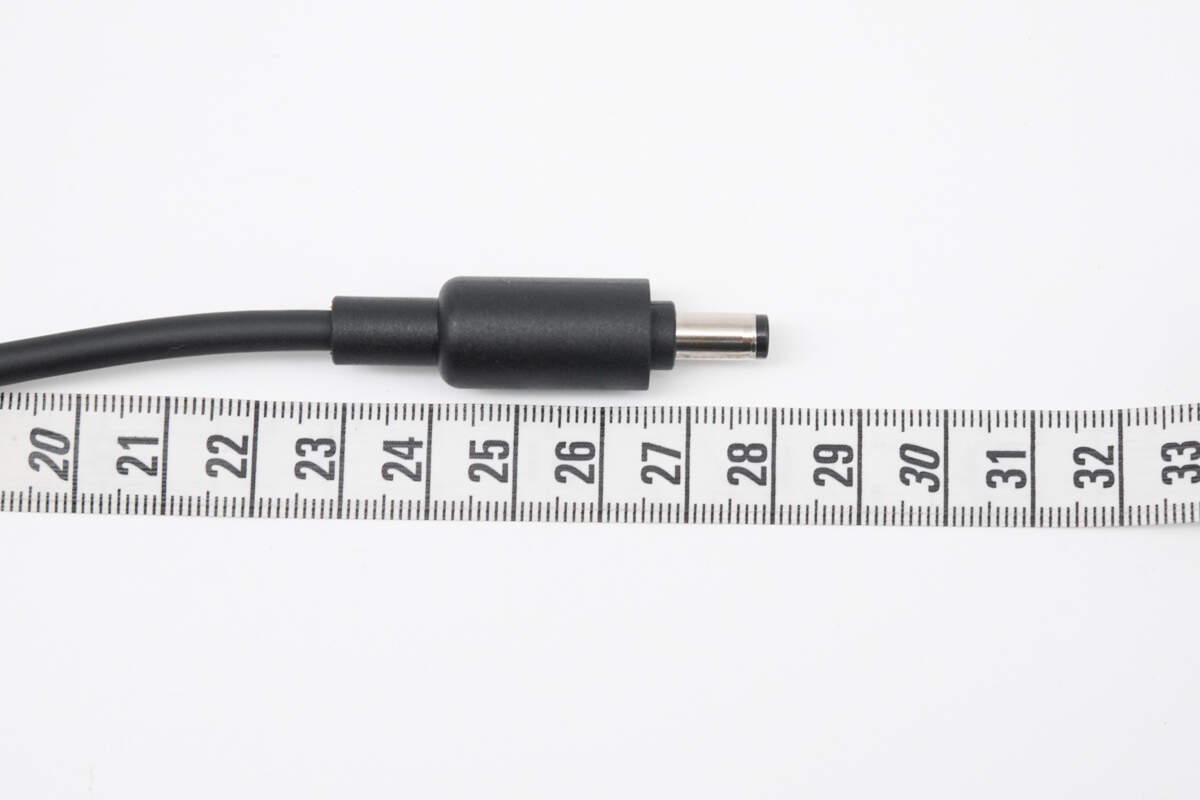

The length of the cable is about 28 cm (11.024 inches).

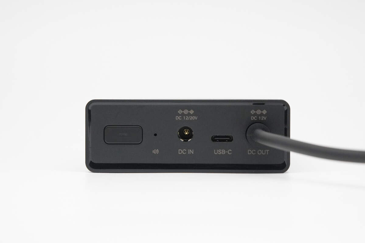

The panel features a power button, DC input port, USB-C port, and DC output port.

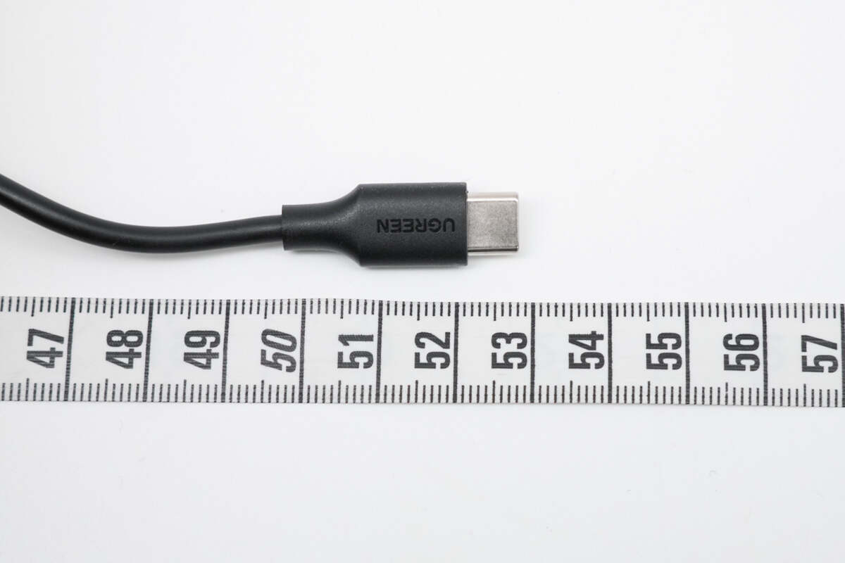

The length of the USB-A to USB-C cable is about 53 cm (20.87 inches).

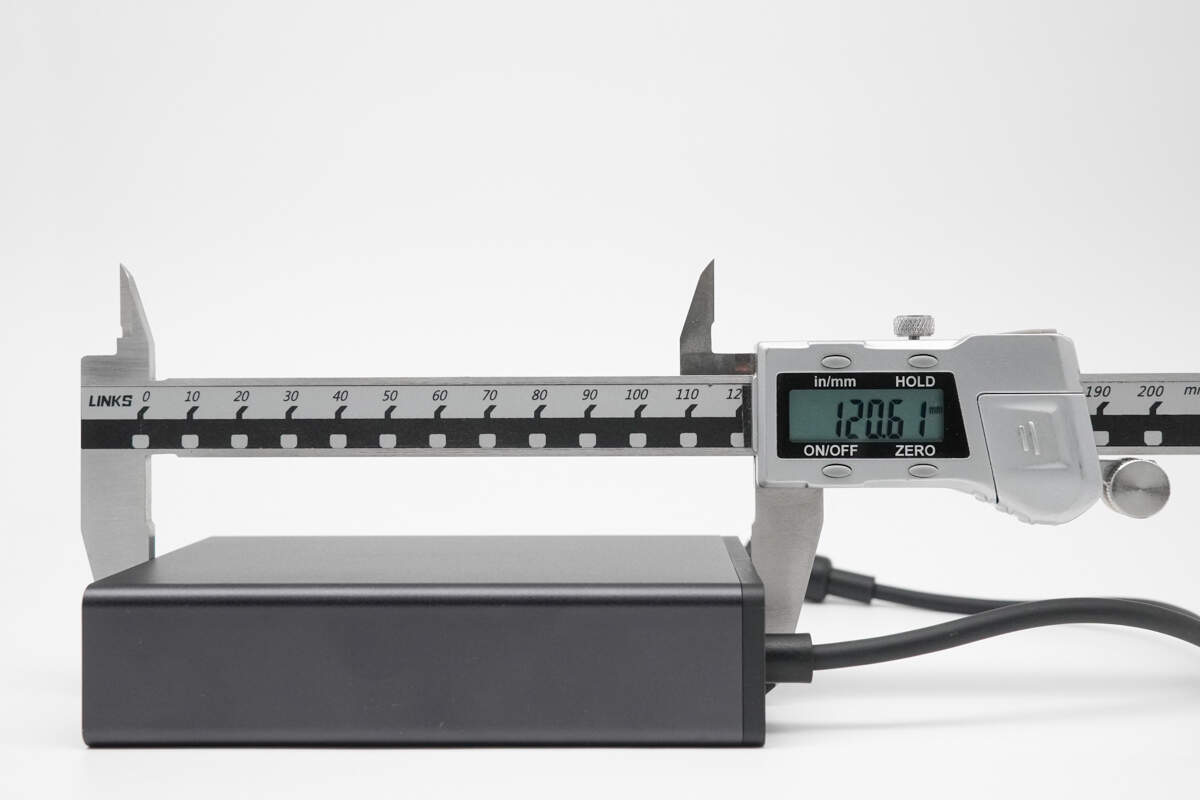

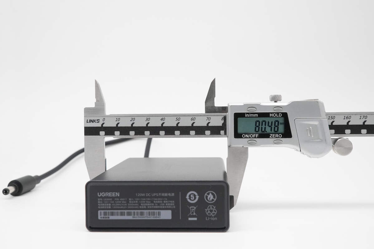

The length of the UPS is about 120.61 mm (4.75 inches).
The width is about 80.48 mm (3.17 inches).

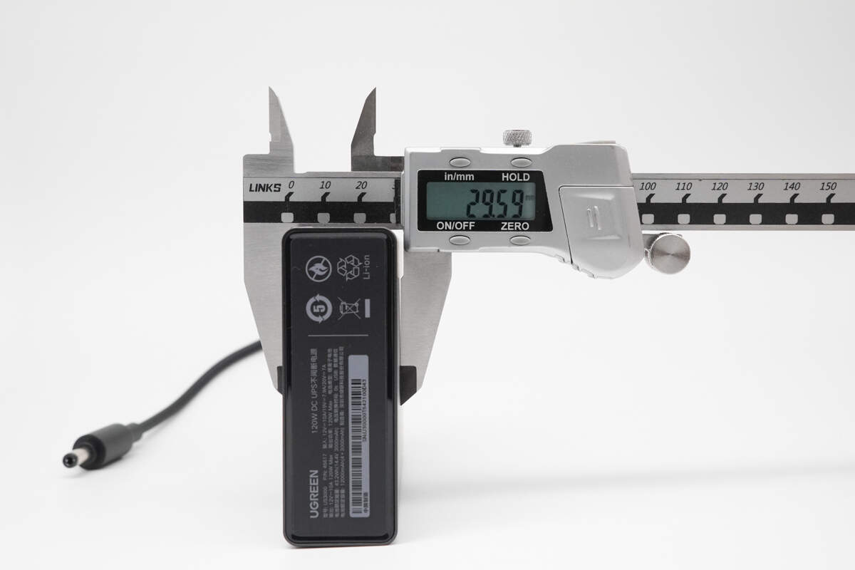

The thickness is about 29.59 mm (1.16 inches).

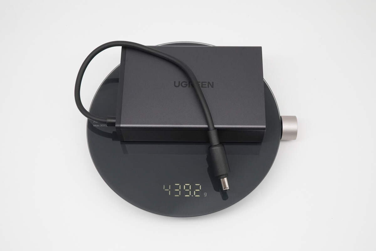

The weight is about 439.2 g (15.49 oz).

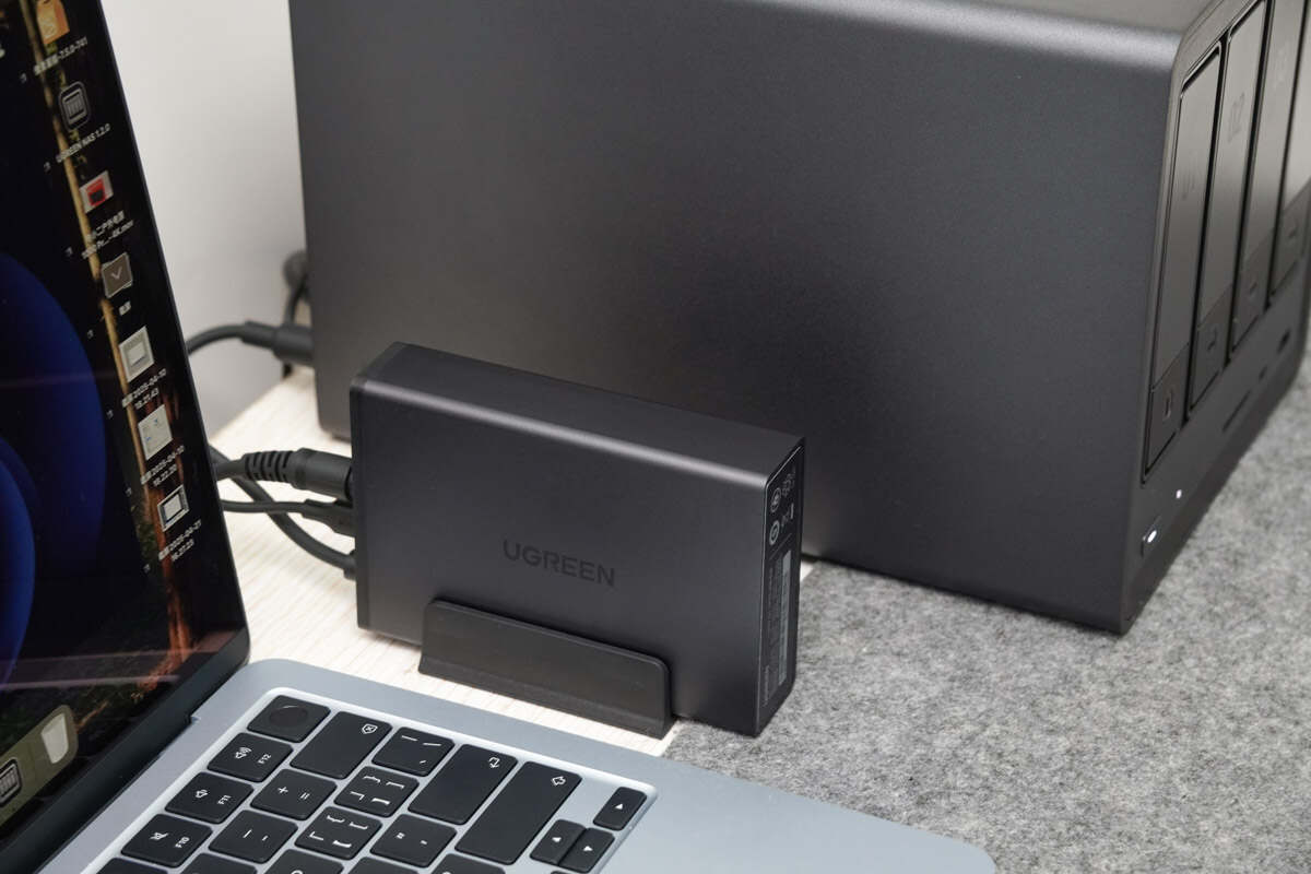

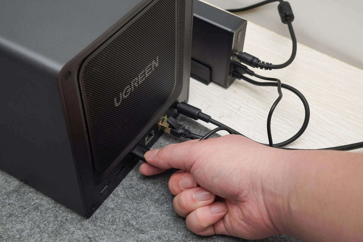

Connect the UGREEN 120W DC UPS to the UGREEN DXP4800 NAS's power adapter, and then output to the NAS via the DC5525 power cable; thus, the power supply, UPS, and NAS are connected in series. Finally, use the provided communication cable to connect the NAS and the UPS.

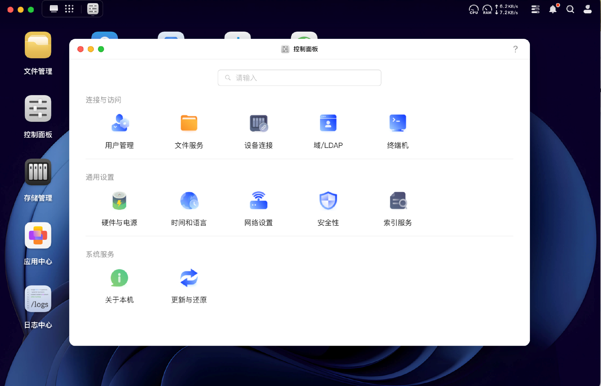

After connecting, find the hardware and power settings in the system's control panel.

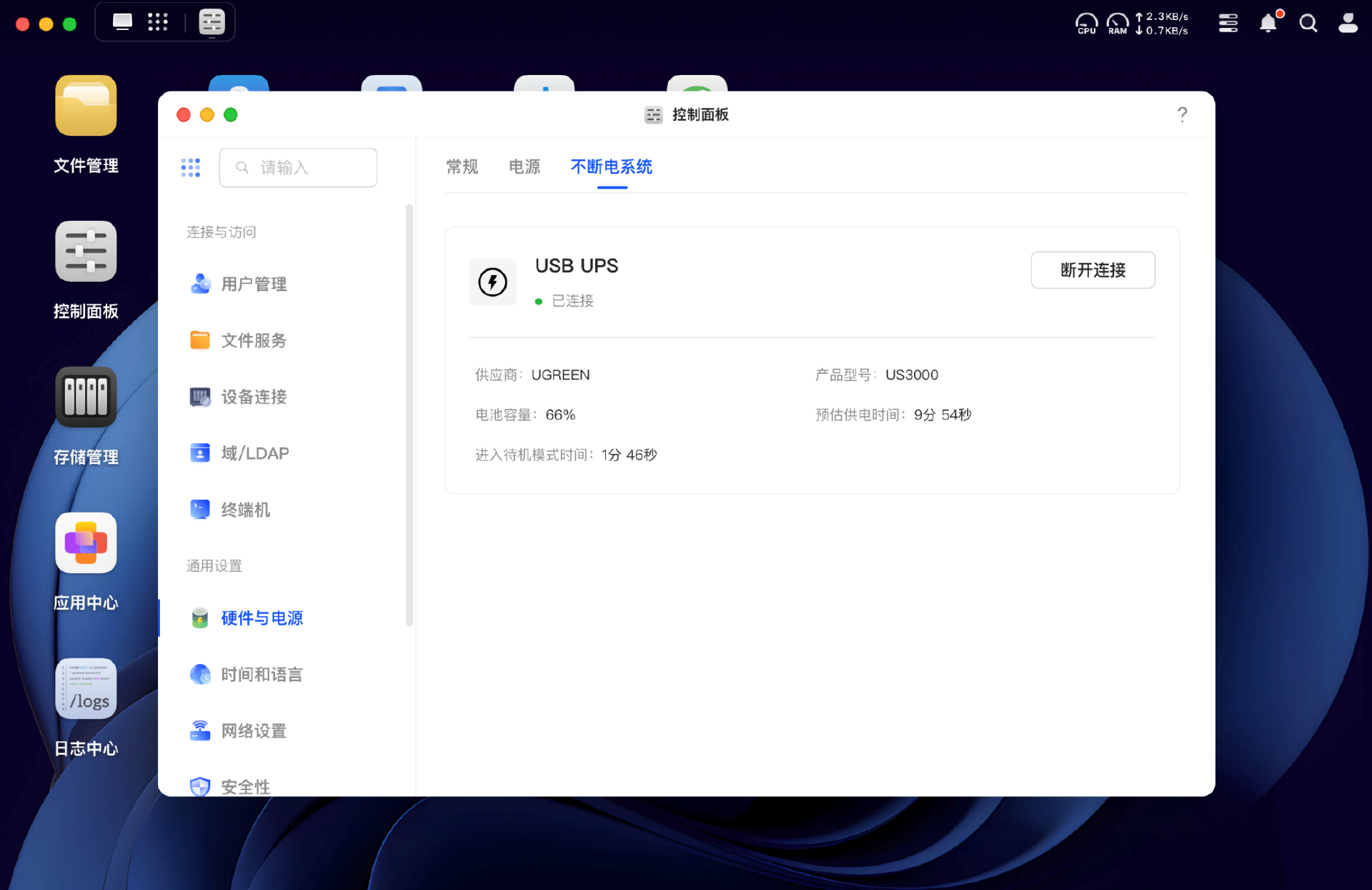

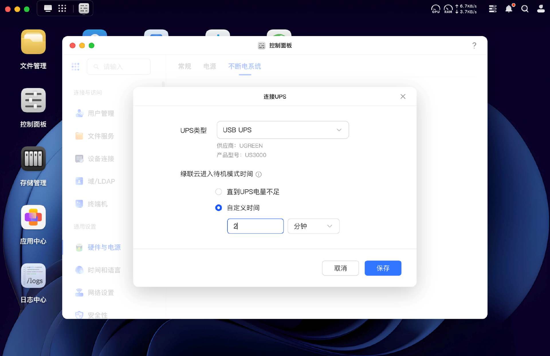

Find the UPS option, the NAS will automatically identify the UGREEN US3000, and you can set the duration for UPS intervention after a power outage as needed.
After the settings are completed, you can view the UPS connection status and setting options.
Simulated Power Outage Test
Before starting the simulated power outage test, set the NAS system to enter "standby mode" 2 minutes after a power outage.

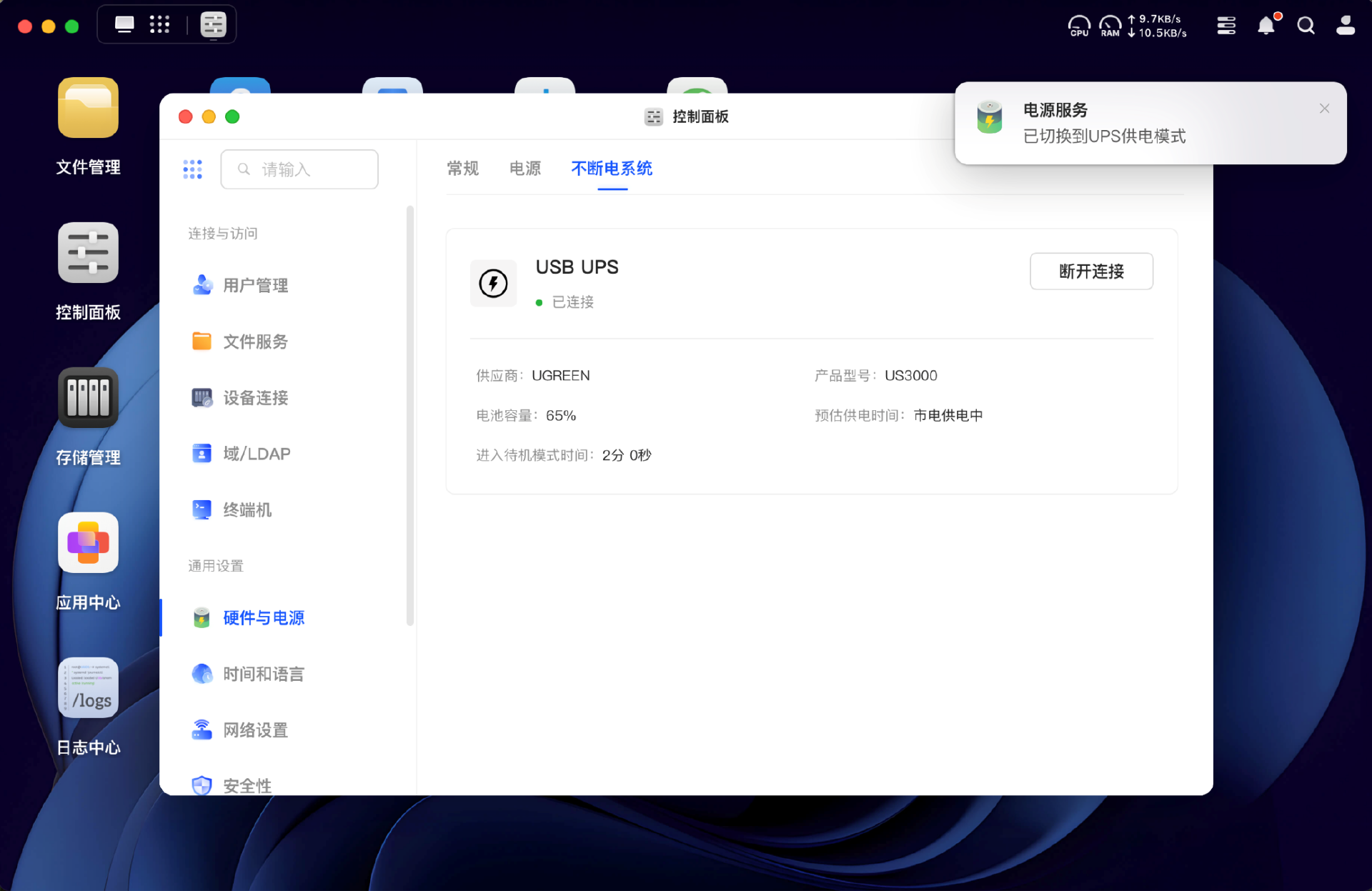

Unplug the power plug to simulate a sudden power outage.
At this time, the system will prompt "Switched to UPS mode".
