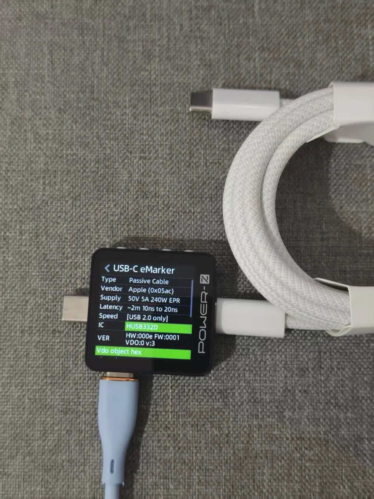

Reading results:
New Firmware Preview: ChargerLAB POWER-Z KM003C to Support Apple Cable SN Identification-Chargerlab
Figure 1: Counterfeit cable, no SN code displayed

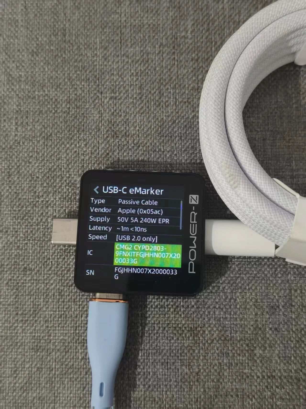

Figure 2: SN code FGJHHN007X2000033G

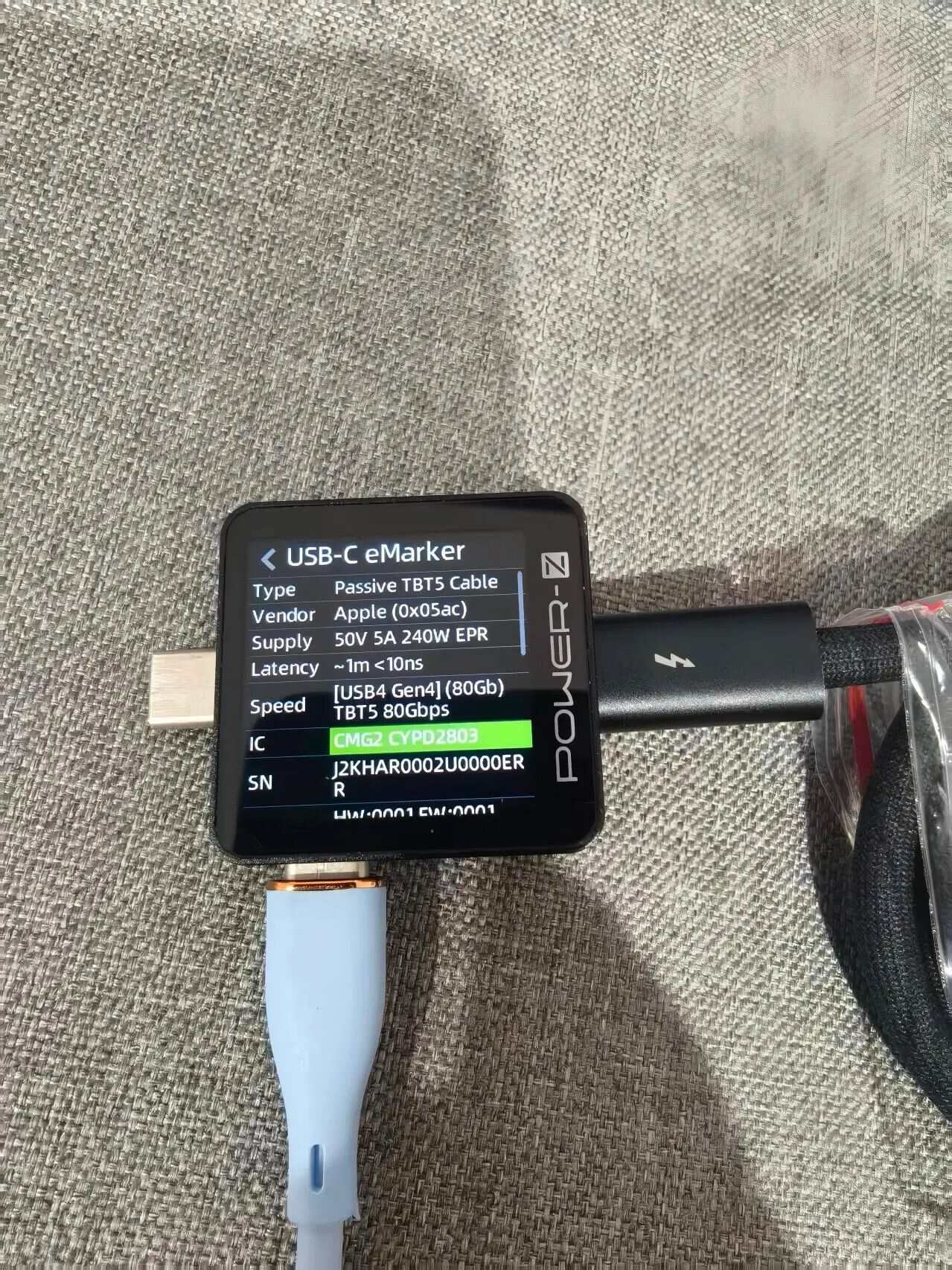

Figure 3: SN code J2KHAR0002U0000ERR
