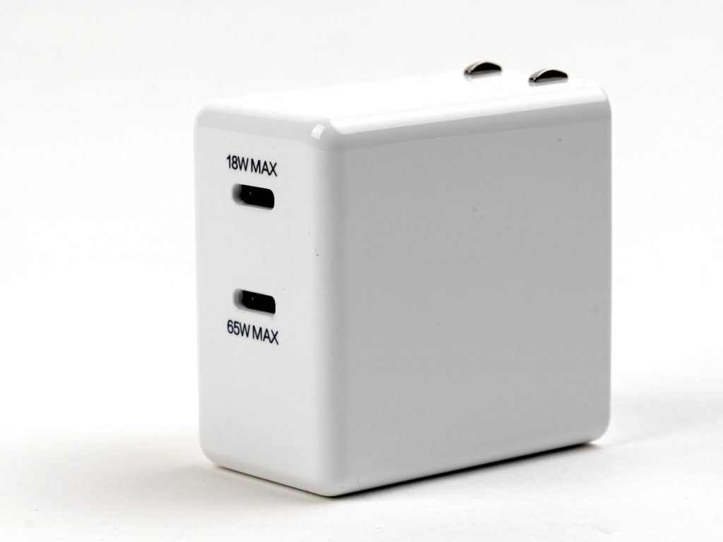

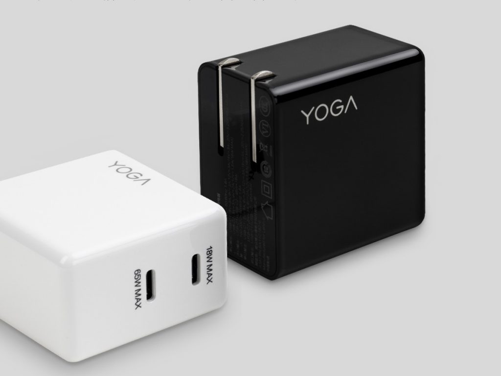

The YOGA 65W dual-port GaN charger is available in black and white. Unlike the dull chargers on the market, the YOGA 65W dual-port GaN charger shell is made by various processes. After injection molding, fireproof plastic will have UV high-gloss coating, then mark silver "YOGA" LOGO, making it exquisite and beautiful.

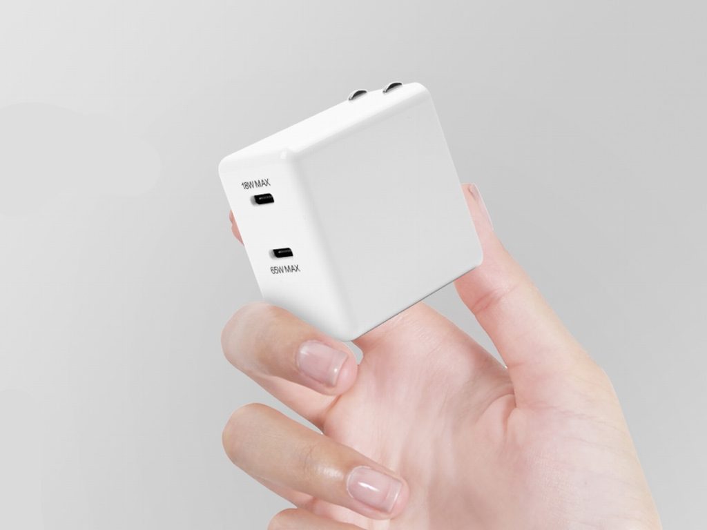

Whether it's a mobile phone or a laptop, the original charger only has a single-port output. It is very troublesome to bring multiple chargers for your mobile phones and laptops when traveling. YOGA 65W dual-port GaN charger has two USB-C output ports, USB-C1 has 5V3A / 9V3A / 12V3A / 15V3A / 20V3.25A, five fixed voltage outputs, the maximum output power is 65W, which can satisfy the need of most laptops on the market. USB-C2 has three fixed voltage outputs of 5V3A / 9V2A / 12V1.5A, and the maximum output power is 18W, which is mainly used for mobile phones and tablets.
Lenovo Launches YOGA 65W Dual-port GaN Charger that Supports Simultaneous Fast Charging of Two Devices-Chargerlab
YOGA 65W dual-port GaN charger is developed based on the USB PD fast charging standard, with a PPS voltage subset, and compatible with the common QC3.0 fast charging protocol, suitable for mainstream electronic products on the market. In addition, it can fast charge two devices at the same time, supporting the use of different devices such as mobile phones and mobile phones, notebooks, and mobile phones. There is a built-in intelligent power distribution strategy. When two devices are detected to charge simultaneously, the output power is intelligently adjusted to 45W and 18W, achieving simultaneous dual-port fast charging.

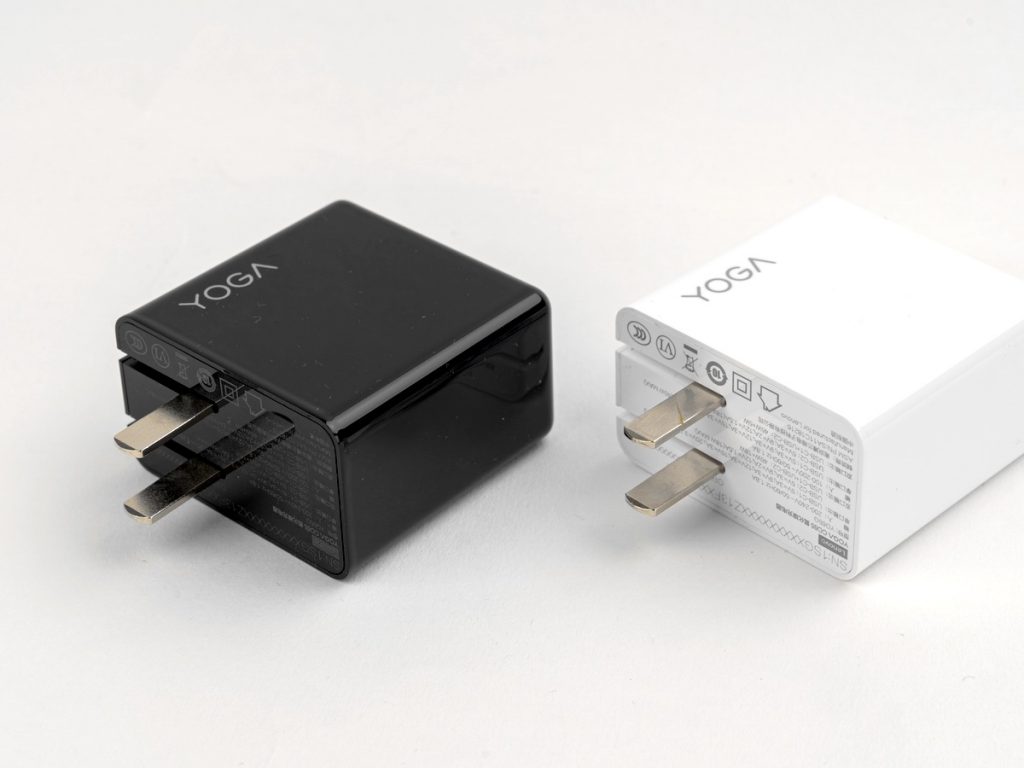

In order to make it more convenient for users to travel, the YOGA 65W dual-port GaN charger adopts a foldable pin design. When going out, the pins can be stored in the shell to avoid scraping with luggage. For international travelers, the YOGA 65W dual-port GaN charger also supports 100-240V global power grid. It can provide 65W (65W / 45W and 18W / 18W) maximum output power under 200-240V 50/60Hz power grid and can provide 50W (45W and 5W / 45W / 18W)maximum output power under 100-200V 50/60Hz power grid.
