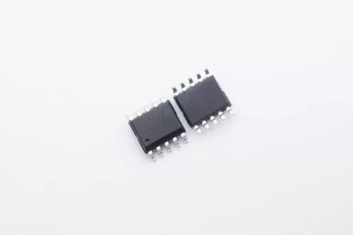

JD6610A is a highly integrated fast-charging protocol controller supporting an output current of 3A. It is compatible with PD3.1, PPS, Huawei FCP/SCP, AFC, and QC2.0/3.0/3+ fast-charging protocols, making it ideal for wall adapters, car chargers, and USB power output ports.
JD6610A: A High-Performance USB-PD PPS Protocol Controller-Chargerlab
This chip can detect USB-C plug-in and removal states and supports VBUS voltage regulation within a range of 5V to 12V. The Prog voltage detection further enhances compatibility. Additionally, the JD6610A integrates USB D+/D- data line monitoring, dynamically adjusting output voltage based on connected devices, with an adjustable range from 3.6V to 12V.
The JD6610A also features a CV (Constant Voltage) mode, which allows fine voltage adjustments using a reference voltage of 1.24V, ensuring stable output for precision applications. It comes in a space-saving SOP-10L package, making it suitable for compact designs.
Moreover, JD6610A offers compatibility with Apple 2.4A charging, BC1.2 identification, multi-protocol port configuration, and dynamic voltage adjustment. These features provide a flexible and efficient power solution for diverse charging scenarios.
