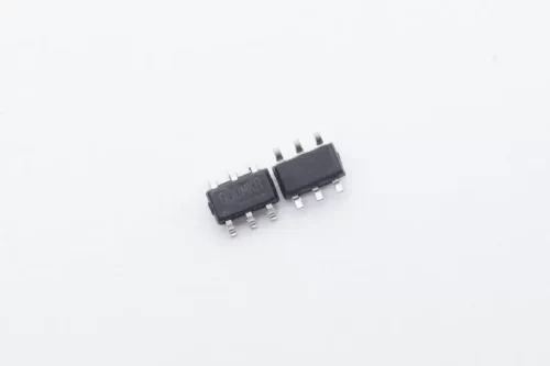

JD6610C is a simplified USB Power Delivery 3.1 SPR and Programmable Power Supply (PPS) controller chip. It supports an output current of up to 3A and is designed to meet various charging requirements efficiently.
JADARD's USB PD 3.1 PPS Protocol Controller: JD6610C-Chargerlab
This chip integrates a CC pin for real-time detection of USB-C plug-in and removal status. It supports a VBUS voltage output range from 5V to 12V and provides a programmable 9V Prog voltage, making it ideal for USB-C charging applications such as travel adapters.
JD6610C also features Constant Voltage (CV) mode, which allows high-precision voltage regulation using a voltage loop. With a reference voltage of 1.24V, it ensures stable and precise power output for demanding applications. The chip is available in a compact SOT-23-6L package, making it suitable for wall adapters, car chargers, and USB power output ports, providing an efficient power solution for various devices.
