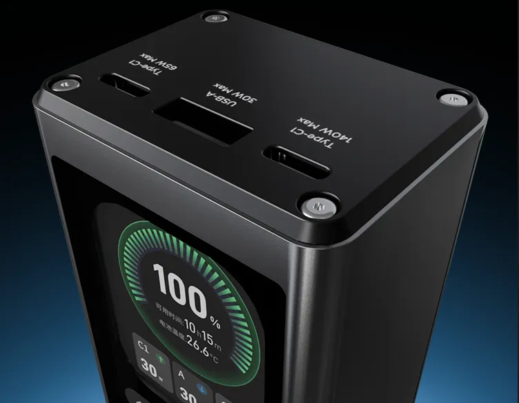

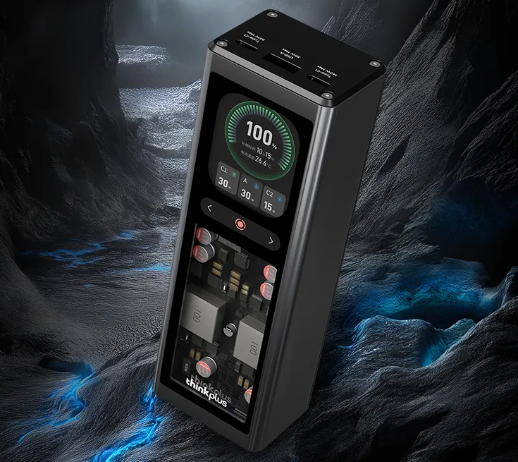

Recently, Lenovo released the thinkplus FLUXO 140W 20000mAh Power Bank. This power bank features industry-leading digital hybrid charging technology and sports a cyberpunk-style design that combines semi-transparent elements with a metallic finish, perfectly replicating classic design elements from Lenovo laptops. It also includes a 2.01-inch display that provides real-time monitoring of usage status and battery level.
iSmartWare SW3517P Adopted in Lenovo High-Power Laptop Power Bank-Chargerlab
Equipped with a high-capacity 20,000mAh battery, this power bank ensures powerful and worry-free endurance for devices during travel.
It offers three output ports—2 USB-C and 1 USB-A—with the C1 and C2 ports supporting 100W fast charging input.

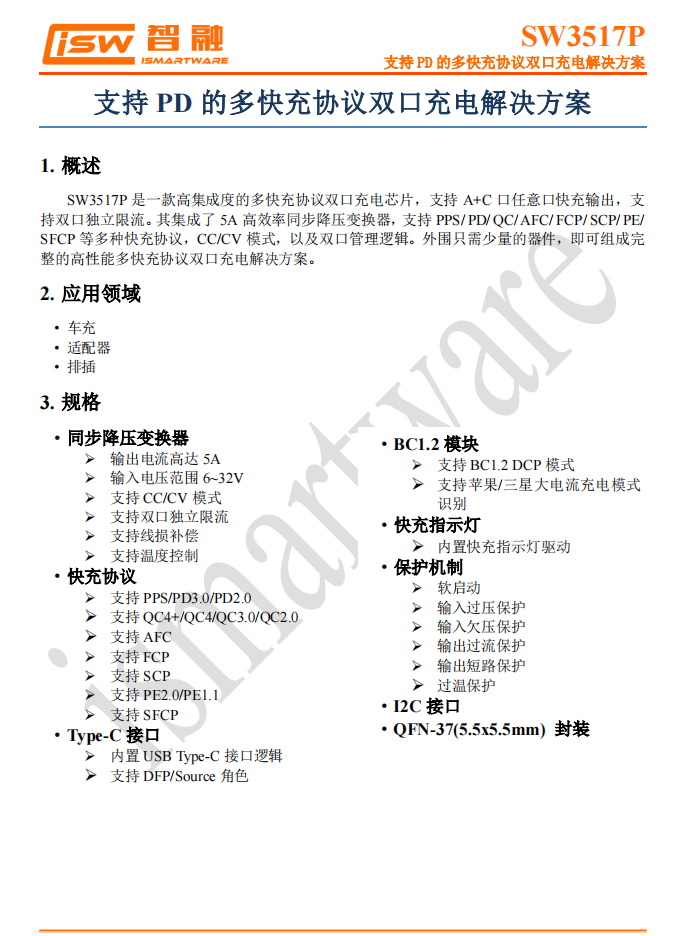

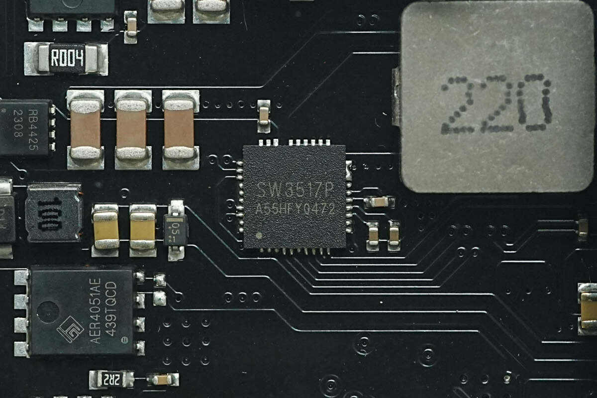

Through our teardown, we found that the device uses the iSmartWare SW3517P protocol chip. Below, we will provide a detailed introduction to its features and capabilities.
iSmartWare SW3517P
The buck protocol chip used is the iSmartWare SW3517P, a highly integrated dual-port fast charging protocol chip. It supports fast charging output from either the USB-A or USB-C port and allows for independent current limiting on both ports.
The chip integrates a 5A high-efficiency synchronous buck converter and supports multiple fast-charging protocols, including PPS, PD, QC, AFC, FCP, SCP, PE, and SFCP, as well as CC/CV modes and dual-port management logic. With only a small number of external components required, it enables the construction of a complete high-performance, dual-port fast charging solution.
Here is the information about iSmartWare SW3517P.
