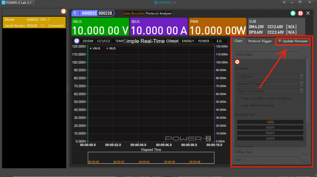

To update the firmware of ChargerLAB POWER-Z KM003C/KM002C PD3.1 tester, you need to operate with the PC software.

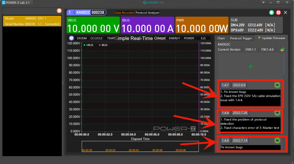

And if you don't see anthing in the detailed operation interface of "Update Firmware," you can always click the big + icon above it to update. You can find all the firmware files from Google Drive.

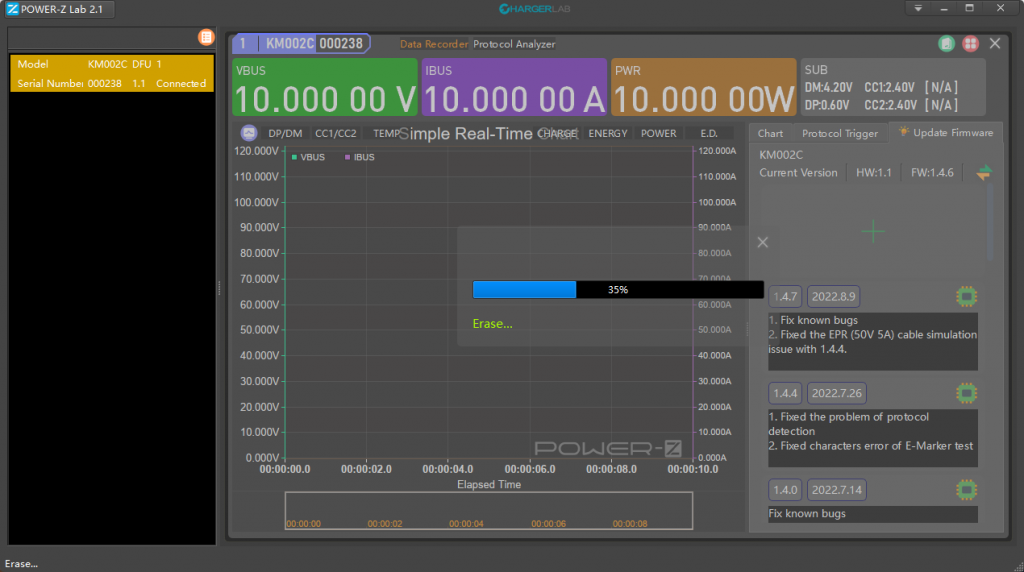

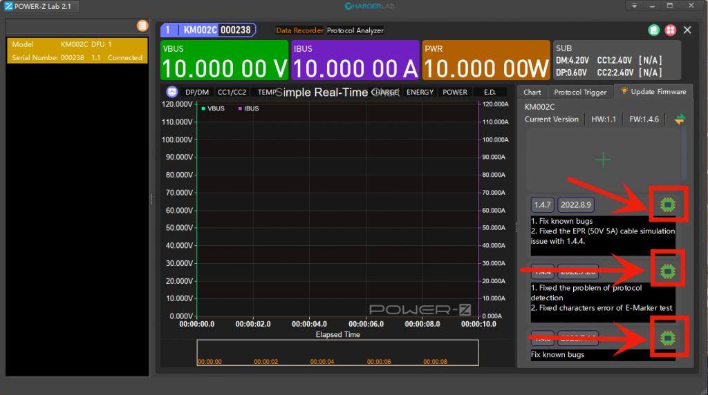

After that, click on the "Chip Icon" in the red frame to complete the update. That is easy, isn't it? Why not turn on your ChargerLAB POWER-Z KM003C/KM002C and have a try?
