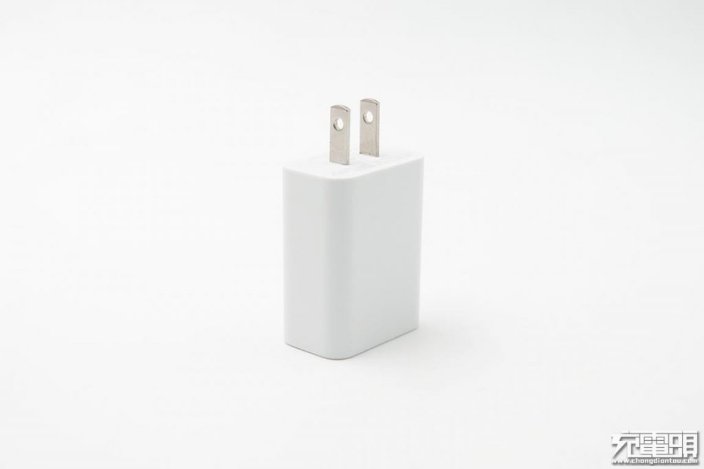

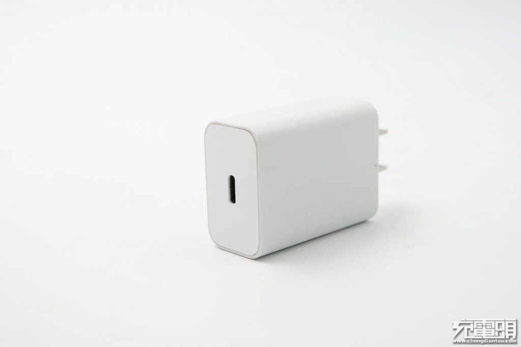

Minimalist design with a matte finish. Length: 1.6 in (40.0 mm). Width: 1.0 in (24.8 mm). Height: 2.0 in (52.0 mm). Weight: 2.1 oz (59.5 g).
Google Pixel 18W PD Charger (TC G1000) Teardown Review-Chargerlab

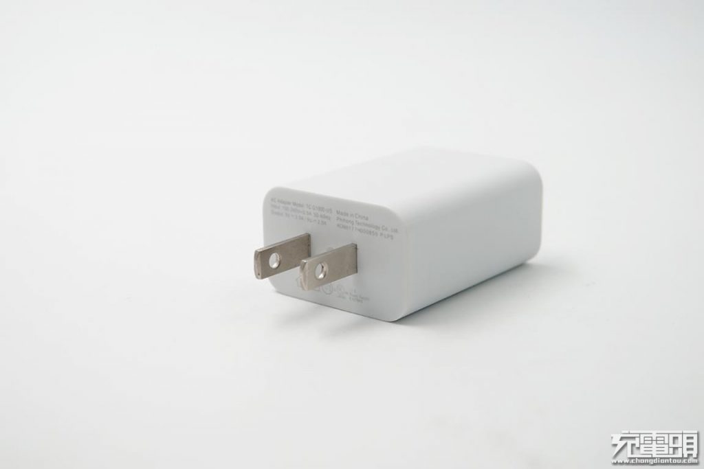

US AC prongs, unfoldable.
Single USB-C port.

Model: TC G1000-US. Input: 100-240V, 0.5A, 50-60Hz. Output: 5V/3A, 9V/2A. The charger has a DOE Energy Efficiency Level VI, and is UL certified. It is made by Phihong (one of the world's largest adapter manufacturers).

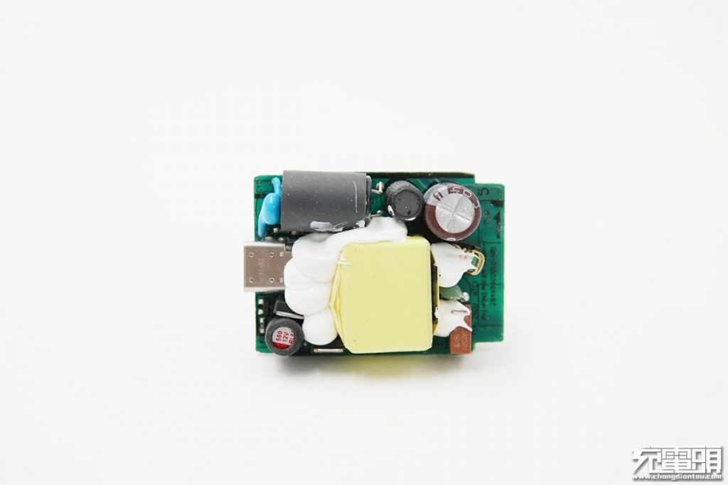

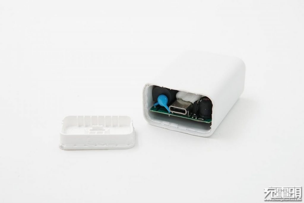

Pry open the cover of the USB-C port.
And pull out the internal PCB board directly.
The pins inside the housing and the PCB board use contact connection.
Some components are covered with glue, looking so neat overall.

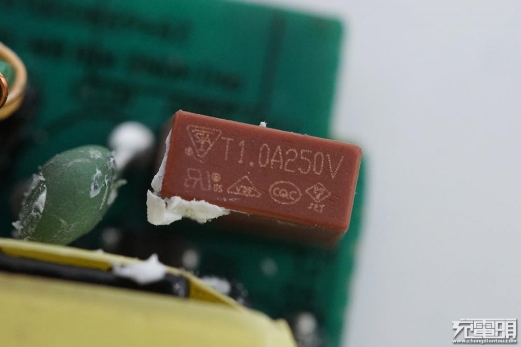

Slow-blow fuse at the AC input side.

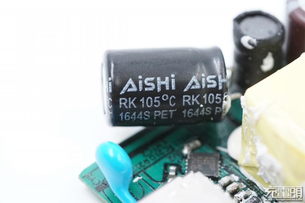

An electrolytic capacitor from AiSHi for input filter, 400V, 18μF.

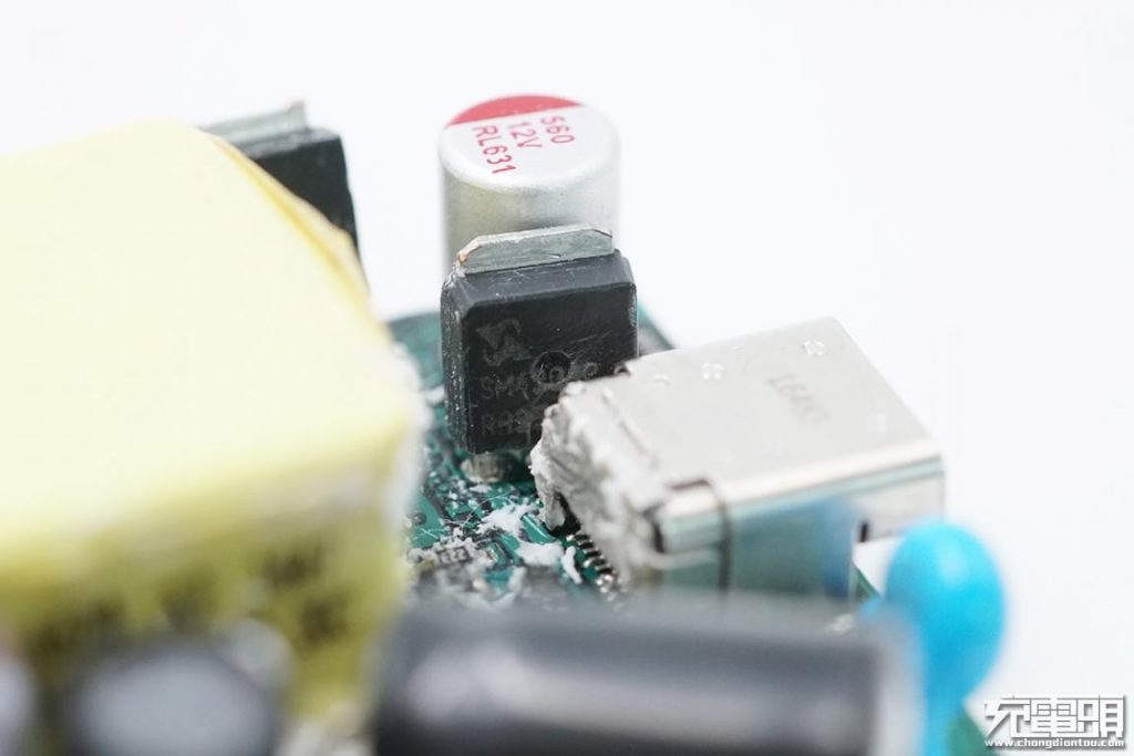

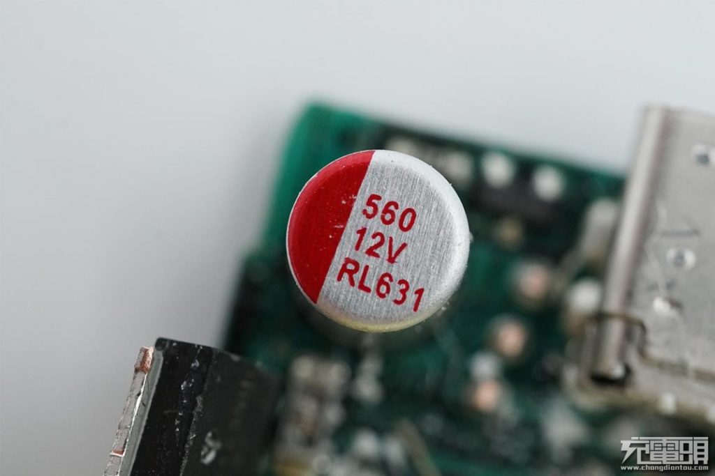

A solid state filter capacitor for utput filter, 12V, 560μF.

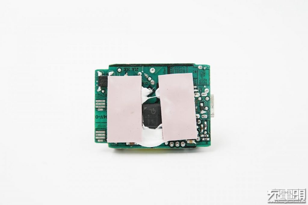

There is a chip on the back of the PCB board, which is covered with glue and two silicone thermal pads. The main controller chip from PI can be identified.
The SC1224K from PI is used as the main controller chip.

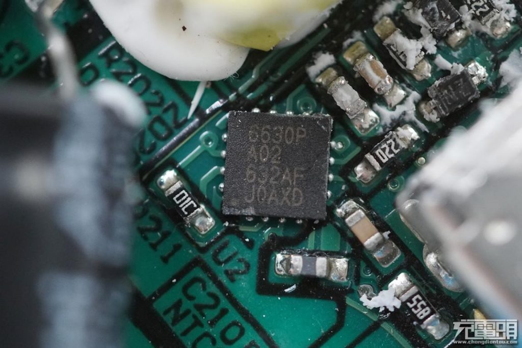

A Weltrend WT6630P is used as the USB-C port output controller.
The WT6630P is a highly integrated USB Power Delivery (PD) controller that supports USB PD 2.0 specification designed for USB Type-C Downstream Facing Port (Source) charging applications such as travel adapters, charger, and power banks. It minimizes external components by integrating USB PD baseband PHY, Type-C detection, shunt regulator, voltage and current monitors, control circuits of blocking MOSFET, and an 8-bit MCU to allow small form factor and low BOM cost. It supports wide operating voltage range from 4V to 30V without the need of an external LDO. An One-Time-Programmable (OTP) ROM is provided for program code and user configuration data. The WT6630P is certified by USB Implementers Forum (USB-IF) for USB Type-C.

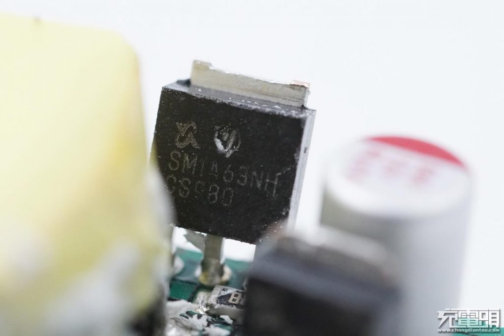

Synchronous rectifier from Sinopower, model SM1A63NHUB.
Detailed specification of the Sinopower SM1A63NHUB.
The USB-C port output VBUS switch is also from Sinopower.
