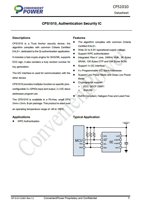

As Qi2 and Qi2.2 standards reshape wireless charging, device authentication has become a non-negotiable requirement. ConvenientPower is addressing this head-on with the CPS1010, a dedicated Trust Anchor chip that puts security at the heart of your hardware. By moving authentication logic into a secure, isolated silicon environment, the CPS1010 safeguards keys and encrypts data for everything from magnetic power banks to charging pads. Its reliability is proven, currently powering the latest Anker Nano magnetic charging solutions.
ConvenientPower CPS1010: Setting the New Bar for Wireless Charging Security-Chargerlab

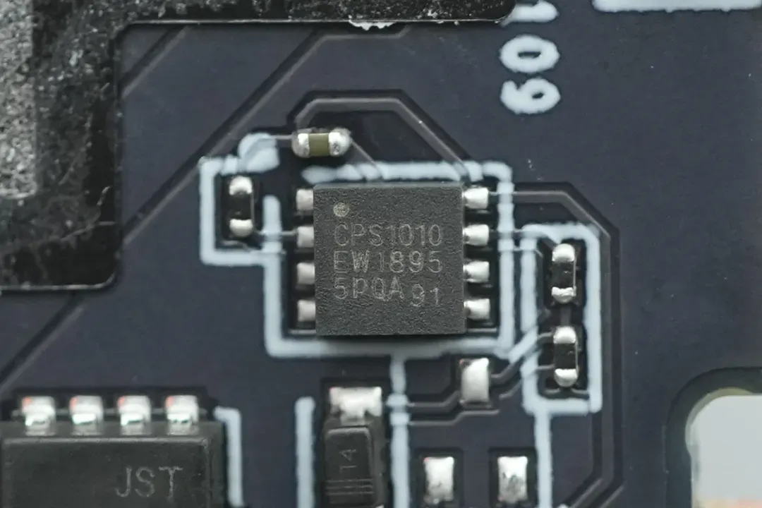

Don't let the compact 2mm x 2mm DFN8 footprint fool you—the CPS1010 is a performance beast. At its core, a 32-bit RISC-V processor handles security, backed by EAL5+ certified algorithms including SHA-256, ECC signatures, and a hardware TRNG. It offers extensive design flexibility with a multi-purpose I²C interface and customizable GPIO pins, making it an easy drop-in for existing controller designs. Furthermore, with its advanced low-power modes and wide operating temperature range, it’s built to keep devices efficient and secure, whether they are in your pocket or on your desk.
The CPS1010 is more than just a chip; it’s a shortcut to compliance. By replacing easily-compromised software authentication with robust, hardware-level security, ConvenientPower helps power manufacturers speed up their development timelines and hit global certification milestones faster. It ensures seamless, secure interoperability across the Qi ecosystem, guaranteeing that both the hardware and the data remain secure. For brands looking to build professional-grade wireless accessories, the CPS1010 is the smart, high-compliance move.
