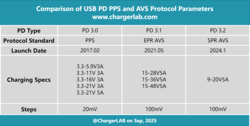

This extra 60W is actually enabled by SPR AVS, which was introduced in the USB PD 3.2 specification update of October 2024. SPR AVS defines a standard power range of 27W–100W, allowing devices to precisely negotiate charging needs between 9V and 20V in 100mV steps. This ensures better power conversion efficiency while reducing heat loss.
Complete PD 3.2 SPR AVS Specification (Including Full USB PD Protocol) – Download-Chargerlab
ChargerLAB has compiled a comparison table of USB PD PPS, ERP AVS, and SPR AVS protocols.
