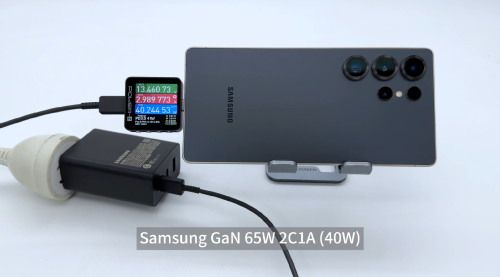

First, using Samsung’s 65W three-port charger with the original 3A cable, the ChargerLAB POWER-Z KM003C measured an input power of 13.46V 2.99A 40.24W.

We tested all of Samsung’s own chargers one by one, using the original 3A Dual USB-C cable. The highest voltage measured was 13V. Except for the 25W charger, which has a power limit, all other original chargers delivered over 40W.

The bar chart clearly shows the charging power of each charger. Overall, the original chargers performed well. Chargers rated at 45W or higher consistently reached around 40W, while the 25W charger still managed to deliver close to 20W.
