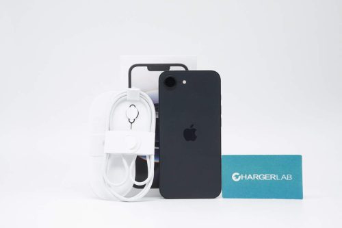

Model: iPhone 16e (A3410). The version we got has a storage capacity of 128GB.
4005mAh+27W | Charging Review of iPhone 16e-Chargerlab
The box contains the phone, cable, and some documents.
