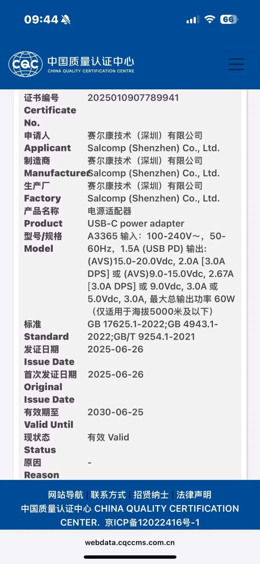

Key specifications of this charger:
  • Model: A3365
  • Input: 100-240V~, 50-60Hz, 1.5A (USB PD)
Output:
  • (AVS) 15.0–20.0Vdc, 2.0A [3.0A DPS]
  • (AVS) 9.0–15.0Vdc, 2.67A [3.0A DPS]
  • 9.0Vdc, 3.0A
  • 5.0Vdc, 3.0A
  • Max total output power: 60W
  • Manufacturer: Salcomp Technology (Shenzhen) Co., Ltd.
  • (For use at altitudes of 5000m or below)

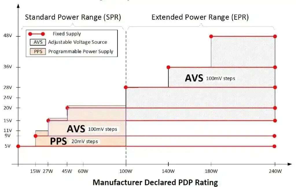

What is the PD 3.2 AVS protocol?
In October 2024, the USB-IF officially released USB PD 3.2. Compared with PD 3.1, the major update lies in the introduction of an Adjustable Voltage Supply (SPR AVS) mechanism within the Standard Power Range (27W–100W). This allows devices to fine-tune the charging voltage between 9V and 20V in precise 100mV steps, enabling more efficient power conversion and reducing heat loss.

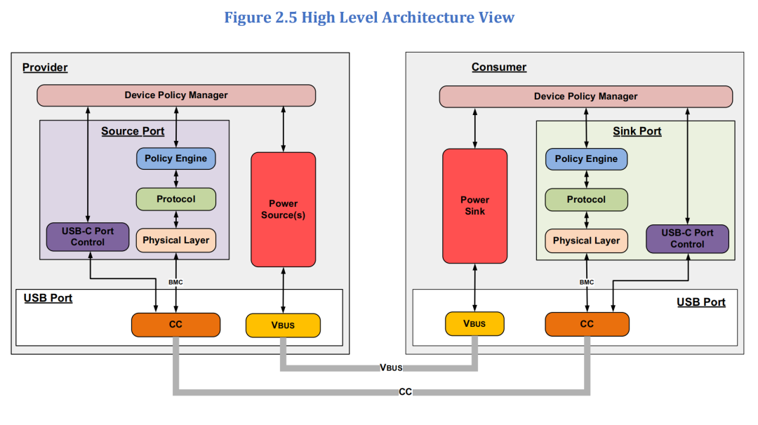

PD 3.2 also refines the version negotiation process between ports and E-marker cables. Even before an explicit power contract is established, it can automatically detect and determine a compatible protocol version. This prevents negotiation failures between new and legacy devices and cables, greatly improving cross-generation interoperability.

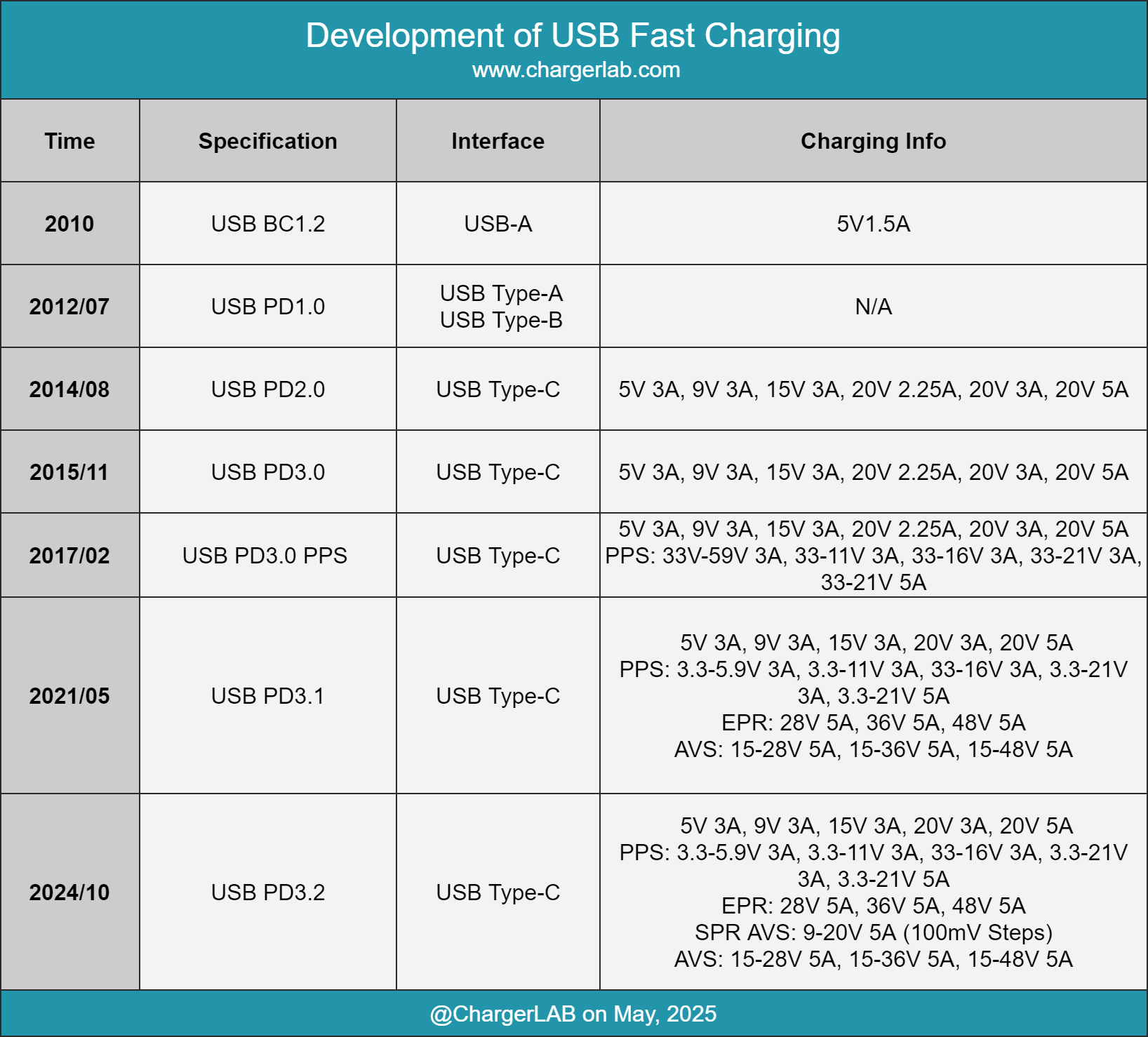

ChargerLAB previously compiled a timeline of USB charging standards, providing an easy reference for tracking the evolution of each stage.

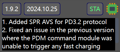

The ChargerLAB POWER-Z KM003C tester had already integrated PD 3.2 AVS detection back in October last year. This not only serves as a compliance verification tool for the industry but also allows ordinary users to quickly confirm whether a charger supports PD 3.2 AVS power delivery.
