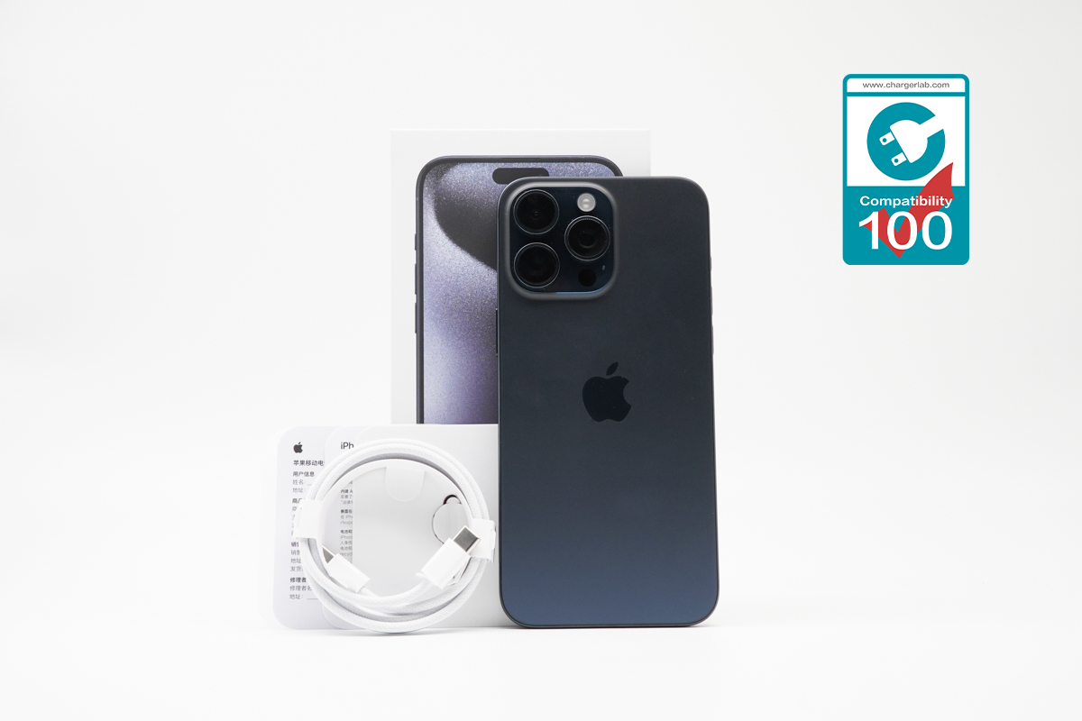

The recently launched iPhone 15 series by Apple may mark one of the biggest turning points in iPhone history. It features a switch to a USB-C physical port for charging, significantly improving connectivity compatibility. Additionally, it boasts a battery capacity of 4852mAh and comes with a braided USB-C to USB-C charging cable.
We received the all-new iPhone 15 Pro Max just yesterday, so without further ado, let's dive into ChargerLAB Compatibility 100 test.
