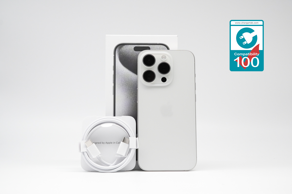

Not long ago, we did the ChargerLAB compatibility 100 test for both 15 Pro Max and 15. The results demonstrated consistent and excellent compatibility. Since then, many people have left comments on our YouTube and official website, expressing their interest in seeing the charging compatibility of the pro model. Therefore, today, we will examine whether its compatibility matches that of the Pro Max.
Charging Compatibility Test
ChargerLAB will conduct a comprehensive test on the compatibility of the iPhone 15 Pro, evaluating its performance with a selection of more than 100 charging devices. These devices include Apple chargers, third-party chargers, power banks, and portable power stations, aiming to cover the majority of users' charging scenarios.
