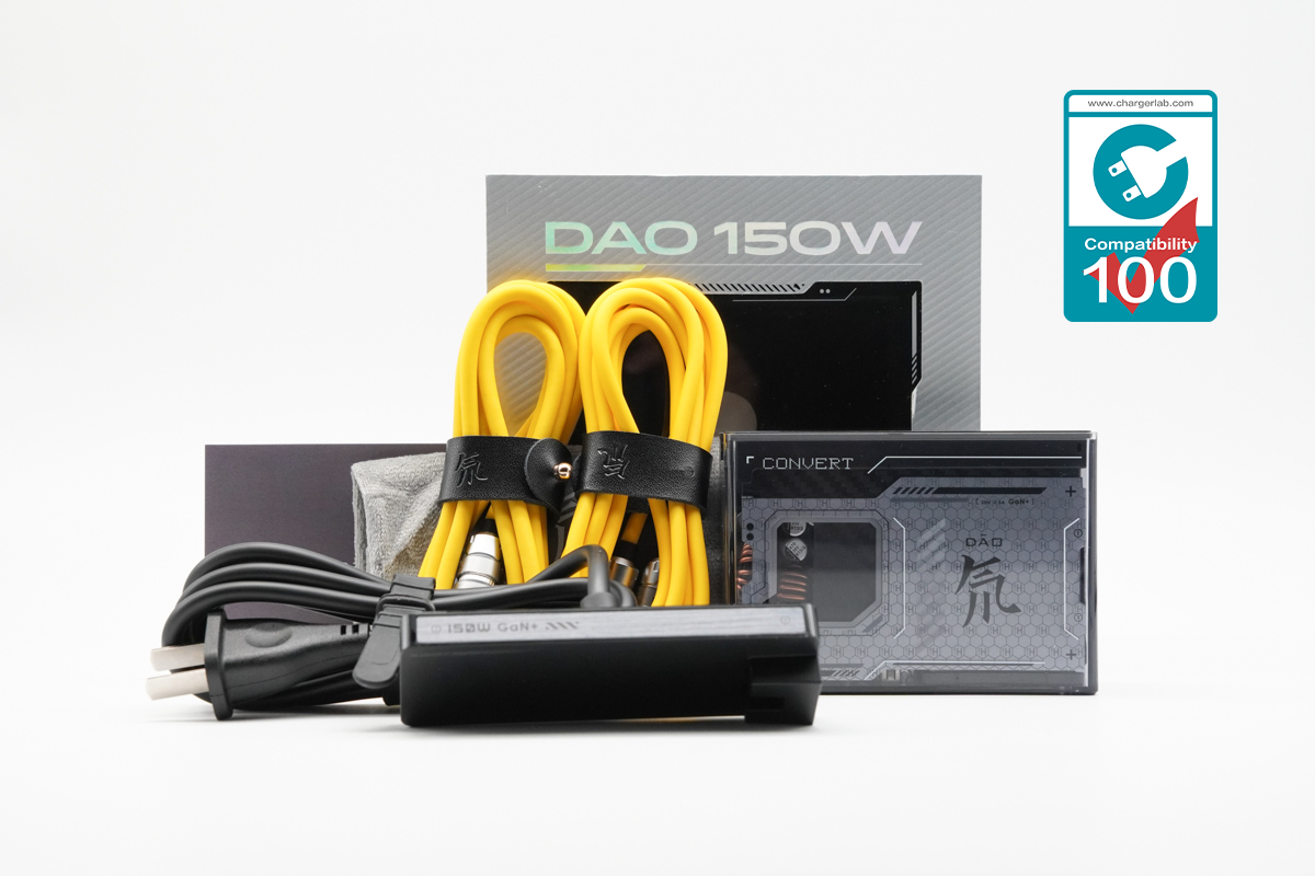

Previously, we presented a ChargerLAB Compatibility 100 video of the REDMAGIC DAO 150W GaN Desktop Charger. Through the video, we believe that everyone has gained some understanding of this charger. Now, we present it in a textual format to provide a more detailed insight into its charging compatibility.
REDMAGIC DAO 150W GaN Desktop Charger ChargerLAB Compatibility 100-Chargerlab
It features a full-color digital display and a custom modular design. It's worth noting that this charger was launched on KICKSTARTER on August 8th at 20:00. ChargerLAB was among the first to get their hands on this charger. It adopts a transparent space silver design and can support DC 150W+PD 3.1 140W output, making it compatible with mainstream laptop brands.
