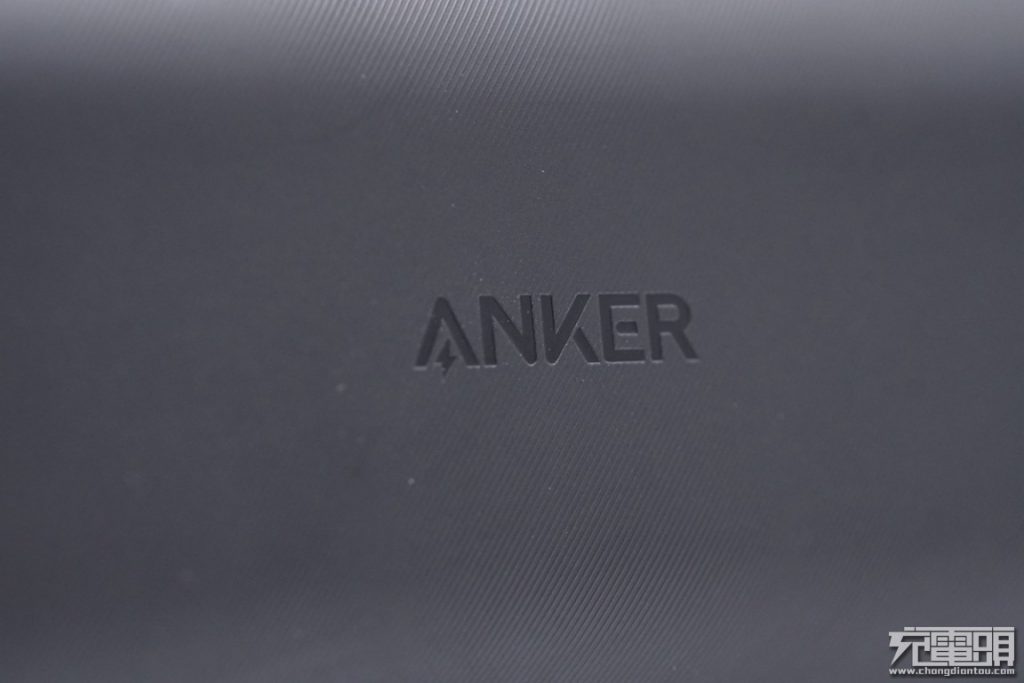

The front has a diagonal 45-degree striped texture, with engraved ANKER logo in the center.

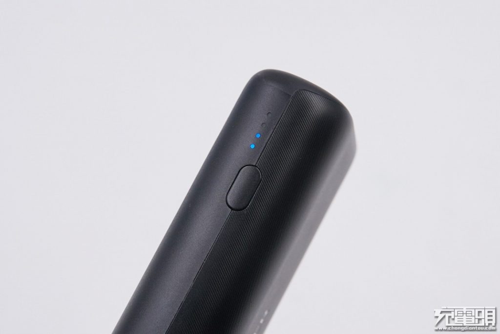

Four LED indicators and a power button at the side.

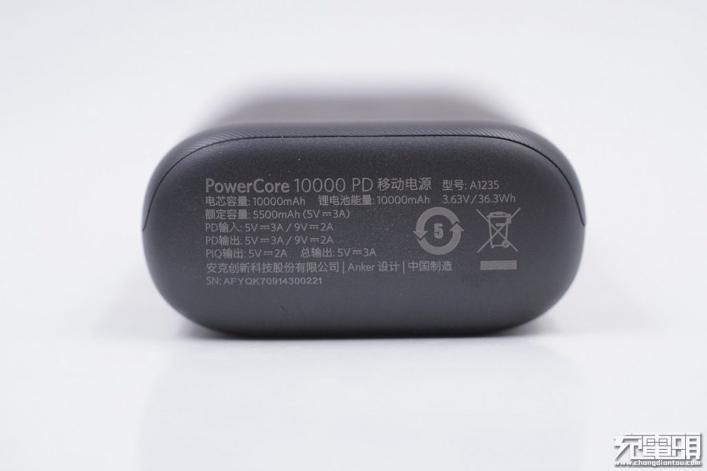

Specifications on the bottom.

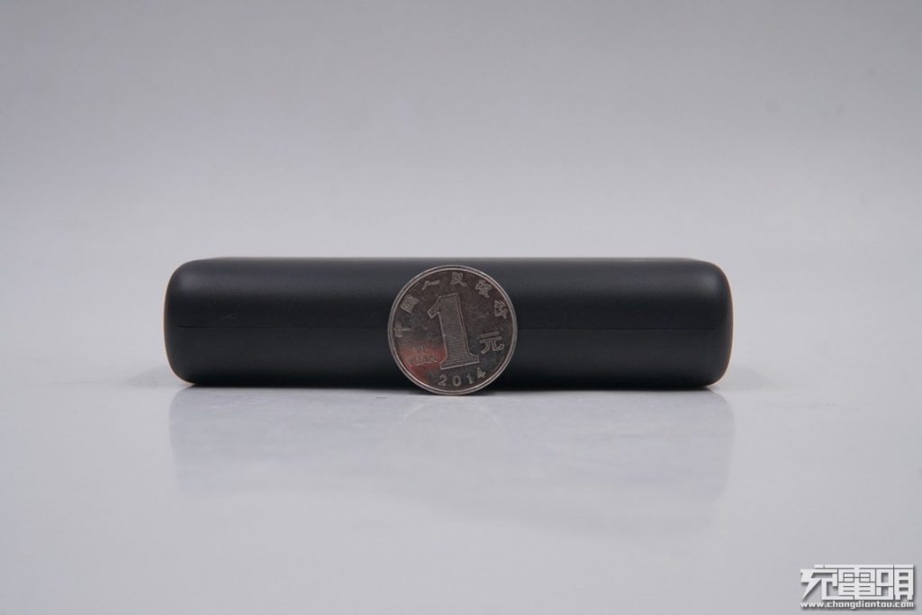

Anker PowerCore 10000 PD Power Bank (A1235) In-Depth Review: Compact Wonder-Chargerlab
Thickness comparison to a 1 Yuan RMB coin.

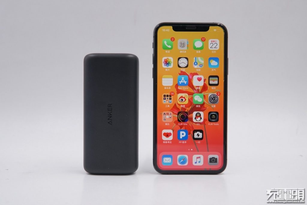

Compared to an iPhone Xs.

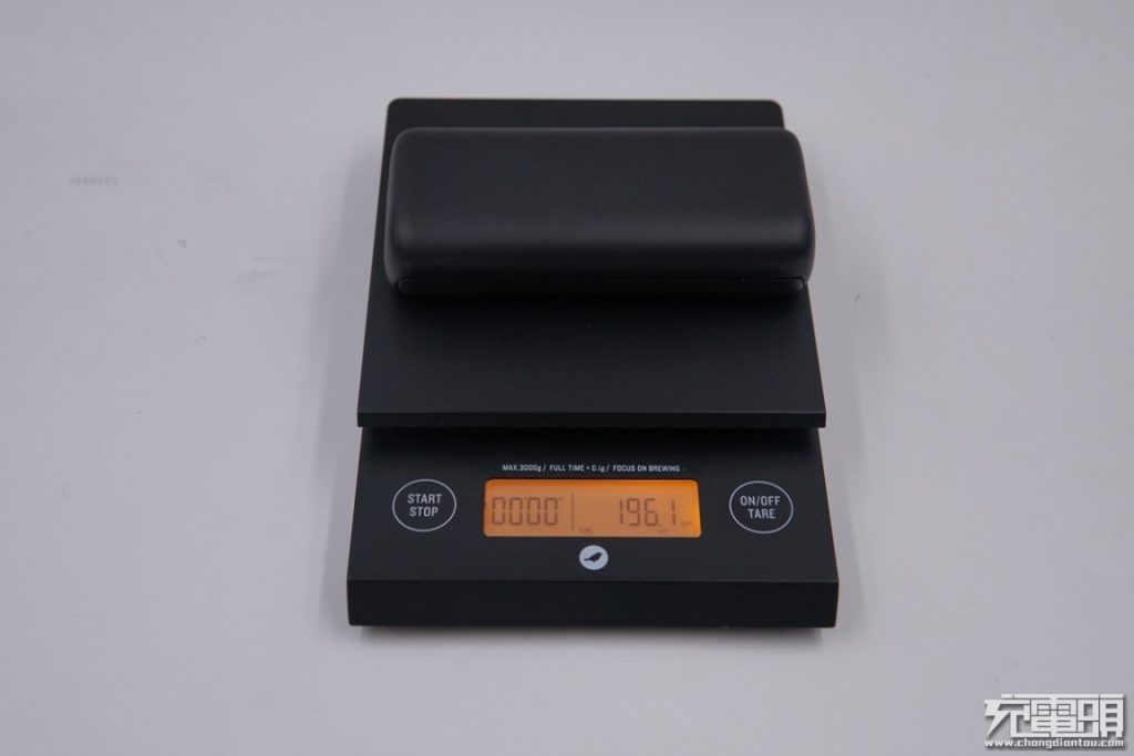

It weighs 196.1g (6.9oz) which is one of the lighter ones for a 1000mAh power bank.

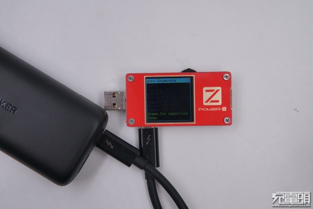

And its USB-C port supports USB PD protocol only.

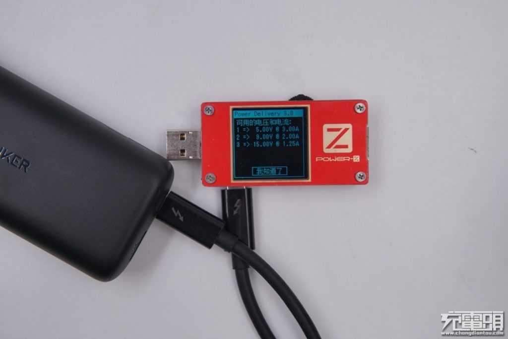

PDO information reveals its USB-C port is capable of PD3.0 quick charging output in 5V/3A, 9V/2A, and 15V/1.25A.

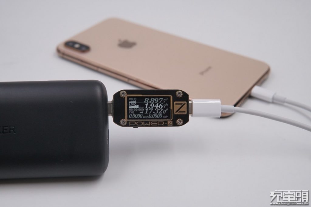

Use the USB-C port to charge the iPhone XS Max, we are getting 8.90V 1.95A 17.32W, under PD protocol.

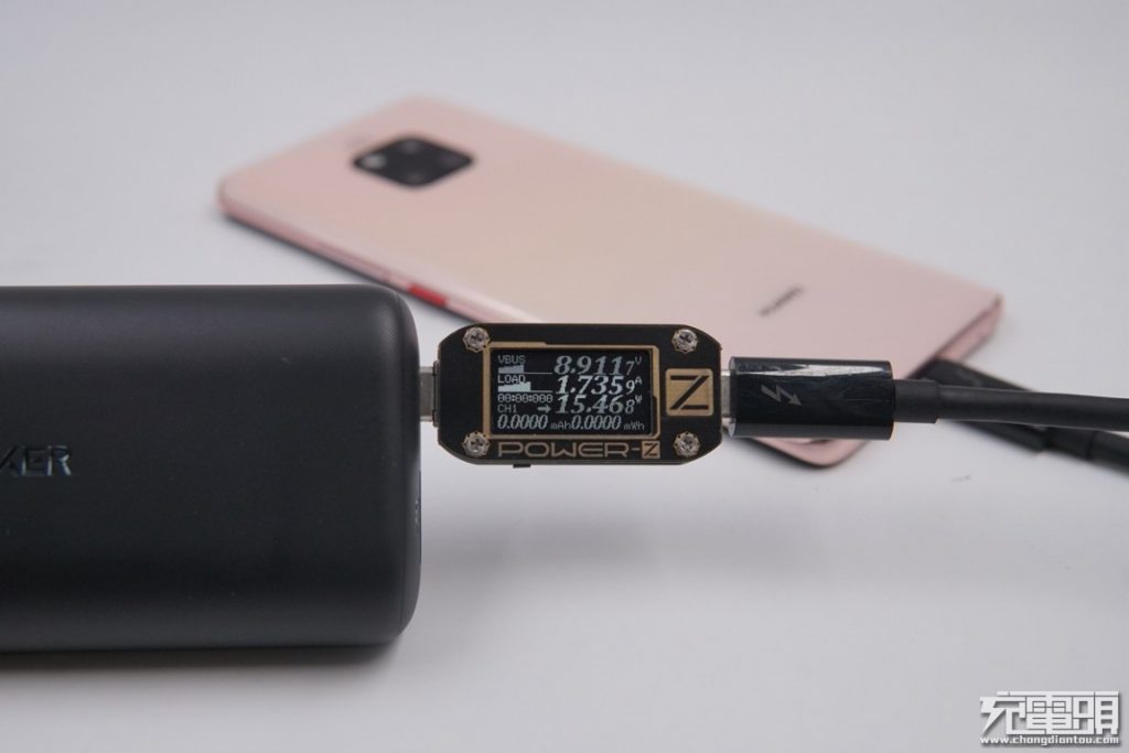

Our Huawei Mate 20 Pro is getting 8.91V 1.74A 15.47W, under PD protocol.

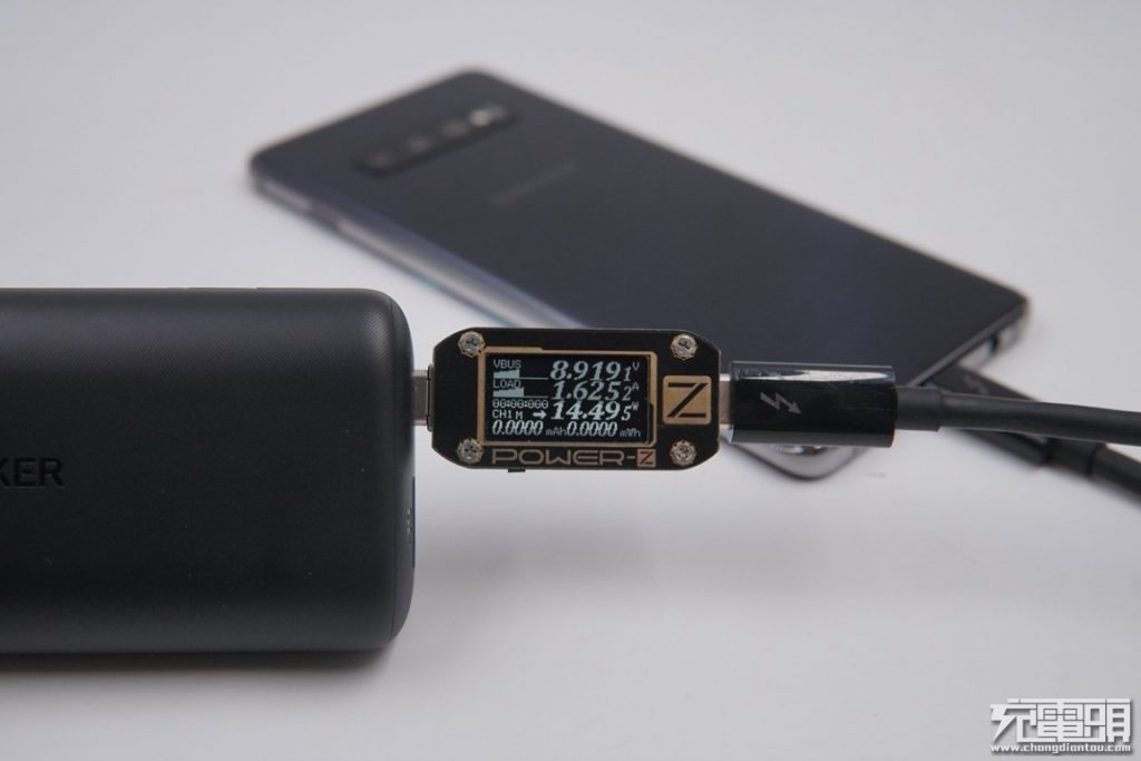

Our Samsung Galaxy S10+ is getting 8.92V 1.63A 14.50W, under PD protocol.
As we can see, the USB-C port of the Anker Powercore 10000 PD enables PD fast charging for all supported phones.

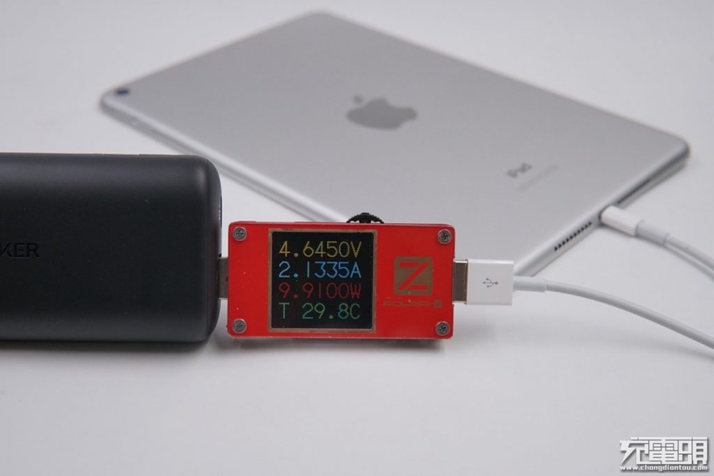

Use the USB-A port to charge the iPad mini5, we are getting 4.56V 2.13A 9.91W, under Apple 2.4A protocol.

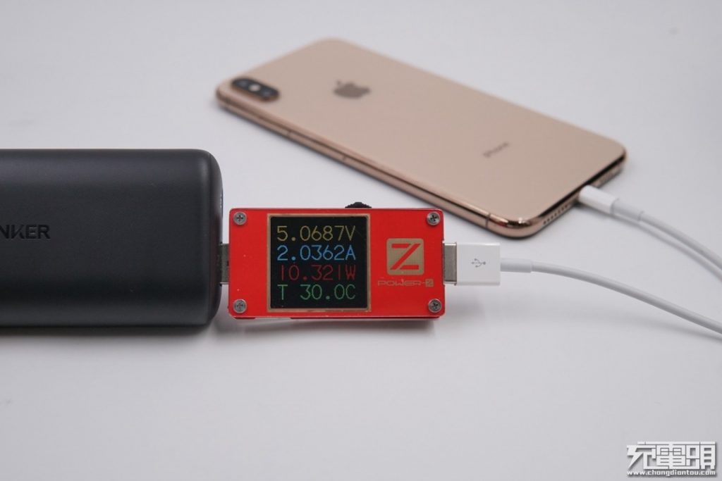

Our iPhone XS Max is getting 5.07V 2.04A 10.32W under Apple 2.4A protocol.
As we can see, the USB-A port of the Anker Powercore 10000 PD enables Apple 2.4A charging for supported Apple devices.

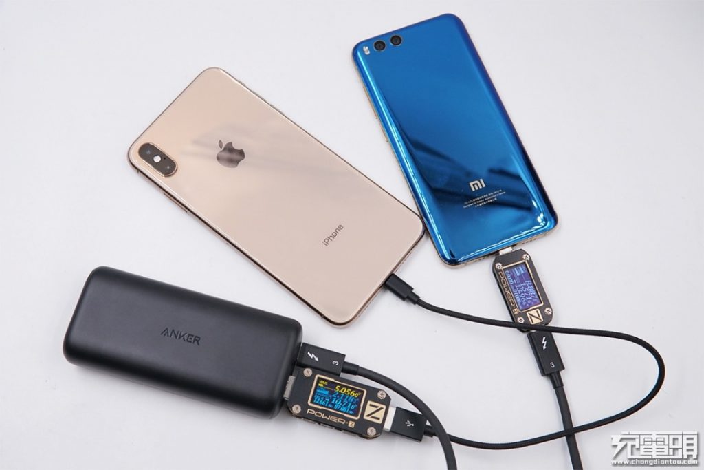

er bank supports dual-port simultaneous output, and the output has a two-way independent design. Using its USB-C port to charge the Mi 6 and while using the USB-A port to charge the iPhone Xs Max, the USB-C port output is 8.89V 1.57A 13.97W, while the USB-A port output is 5.06V 2.12A 10.71W, a total power of 24.68W. Imagine such powerful dual port output in such a small package, that's darn impressive.
