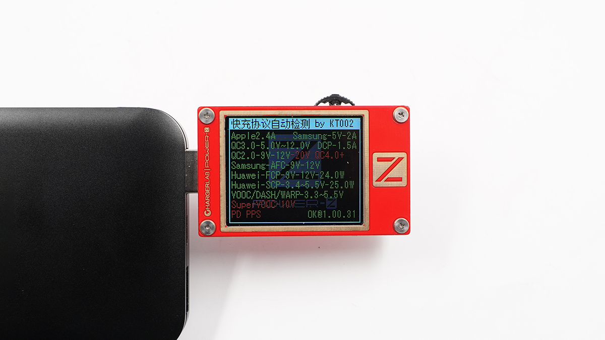

Once the KT002 and charger are connected, press the MultiKey to the left, select "Fastcharge Auto Enum," and press it again.
A Simple Guide to ChargerLAB POWER-Z KT002's Protocol Detection Feature-Chargerlab
Then, you will get this note. It means you need to disconnect any device connected to other ports, because the high voltage may ruin your device.
After a short wait, it will end with a beep, and the results will be presented in the form of a checklist. Specifically, the supported protocols will be displayed in green, while the unsupported ones will be in red, making it very intuitive.

Finally, let's test it on a power bank. Take this all-protocol power bank for example. Its USB-A port supports VOOC series protocols.
The ChargerLAB POWER-Z KT002 is a versatile USB tester that allows you to measure voltage, current, power, and capacity. It also has a protocol detection feature that can identify the fast charging protocols supported by a charger or power bank, just like our KM003C!
