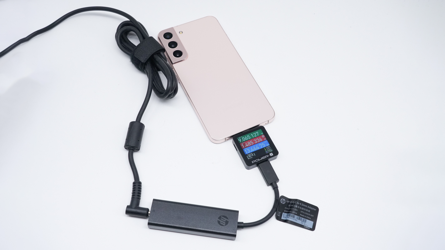

Lastly, for the Samsung Galaxy S22+, the charging power is 9.07V 1.49A 13.46W. As we can see, for mainstream smartphones in the market, the charging power is around 18W, which is sufficient.
