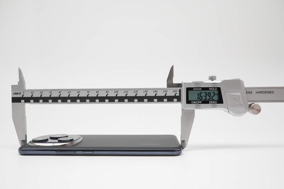

The length is about 163.92 mm (6.45 inches).

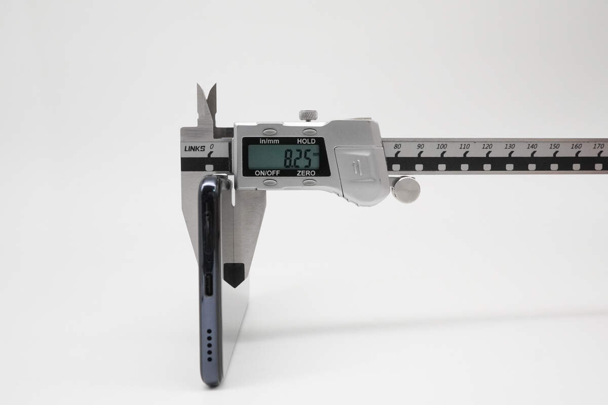

8000mAh + 66W | Charging Review of Honor Power-Chargerlab
The thickness is about 8.25 mm (0.32 inches).

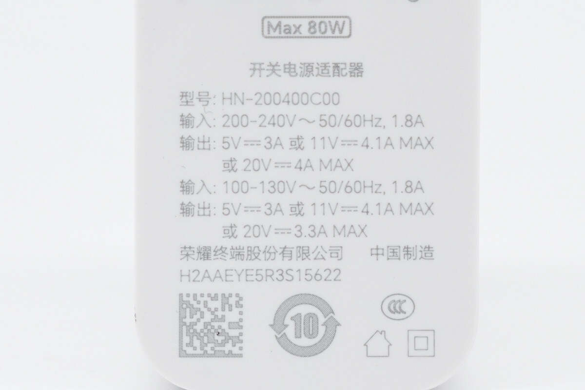

It comes with an 80W charging set.
The weight is about 134.5 g (4.74 oz).
Model: HN-200400C00
Input: 200-240V~ 50/60Hz, 1.8A
Output: 5V⎓3A or 11V⎓4.1A MAX or 20V⎓4A MAX
Input: 100-130V~ 50/60Hz, 1.8A
Output: 5V⎓3A or 11V⎓4.1A MAX or 20V⎓3.3A MAX

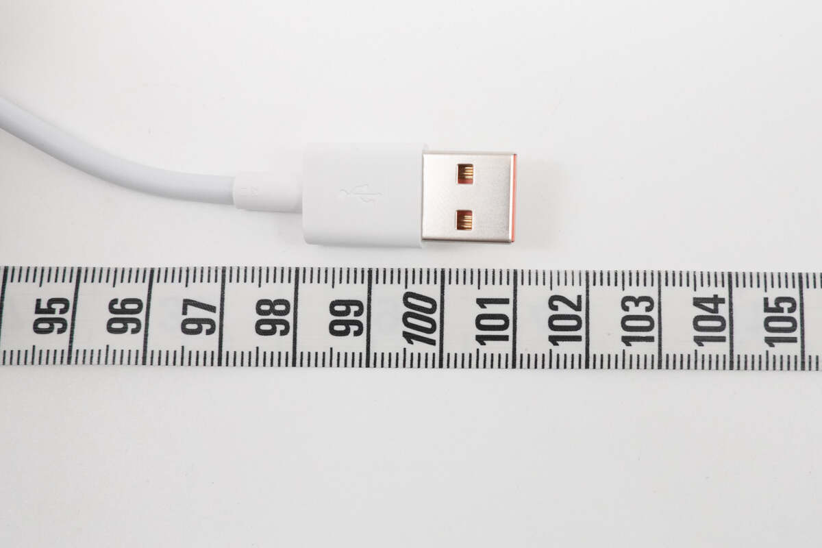

6A is printed on the connector.
The length is about 1 meter.

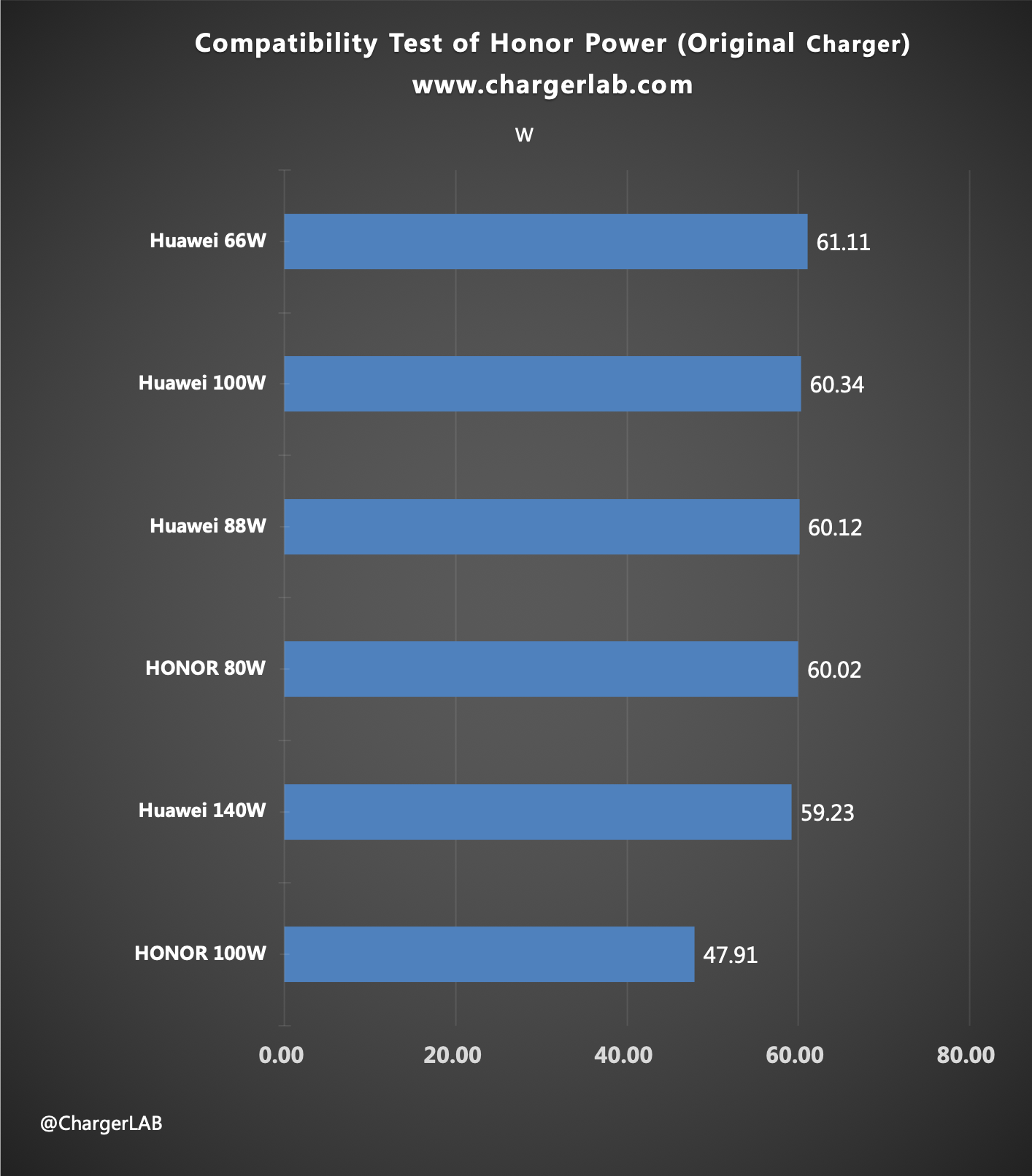

When using the original charger set to charge it, the power is about 18.46V 3.21A 59.27W.
The charging power is above 47W, and the original 80W charger set can reach 60.02W.

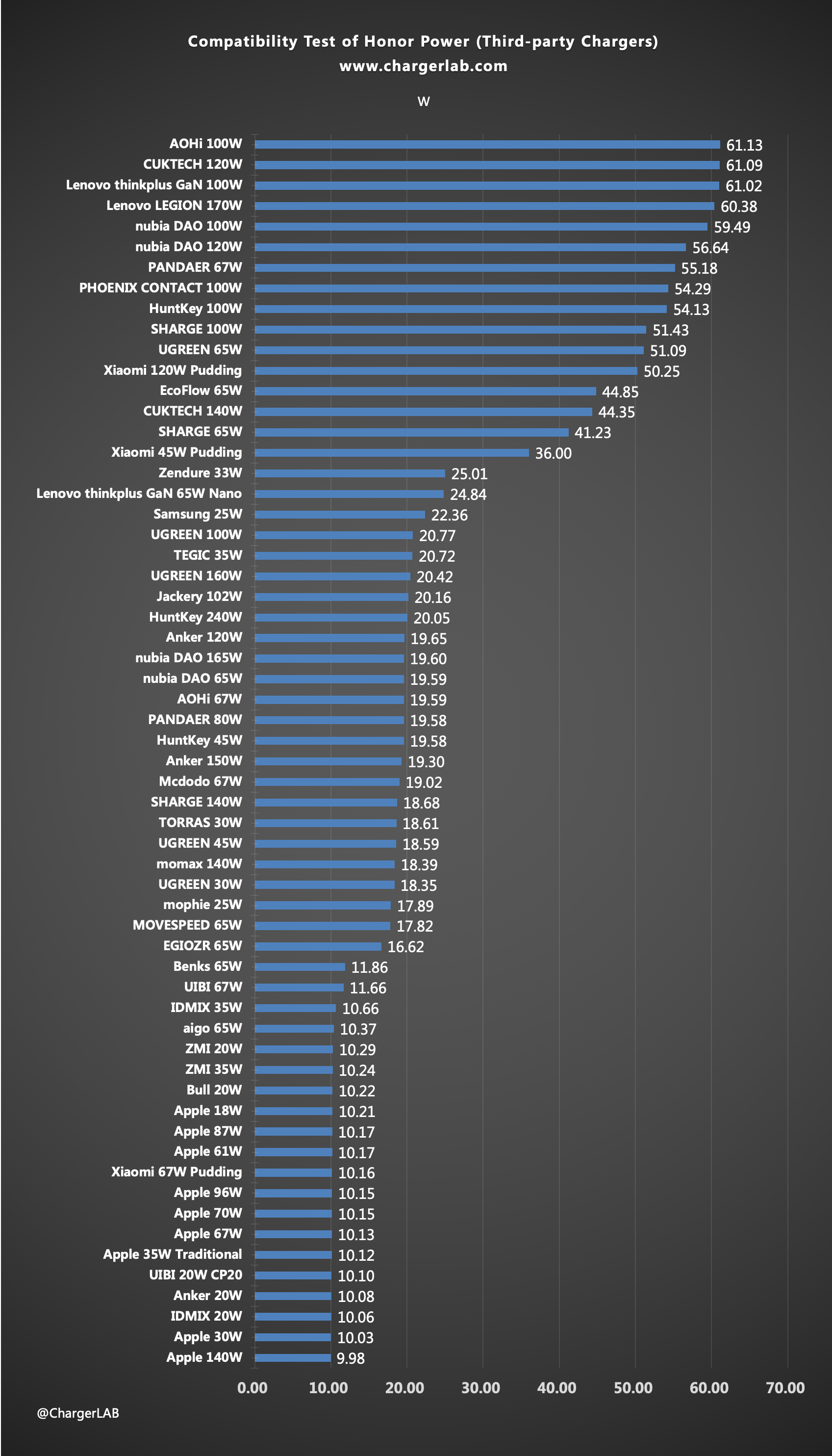

Third-party Chargers
The charging power is mainly concentrated at several levels: 11W, 18 to 20W, and 40 to 60W. Many Huawei chargers support the SCP protocol, so their charging power is close to that of the original charger. Some chargers that support PPS can also provide relatively high charging power of around 40 to 60W.

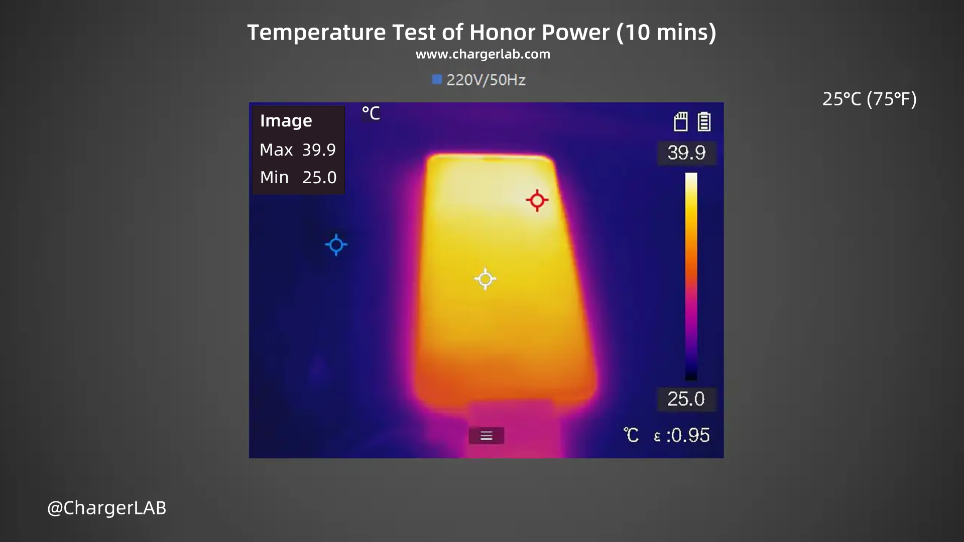

Temperature Test
10 minutes Charging
After 10 minutes, the maximum temperature on the front is 39.9℃ (103.82 ℉).
The back is 38.5℃ (101.3 ℉).

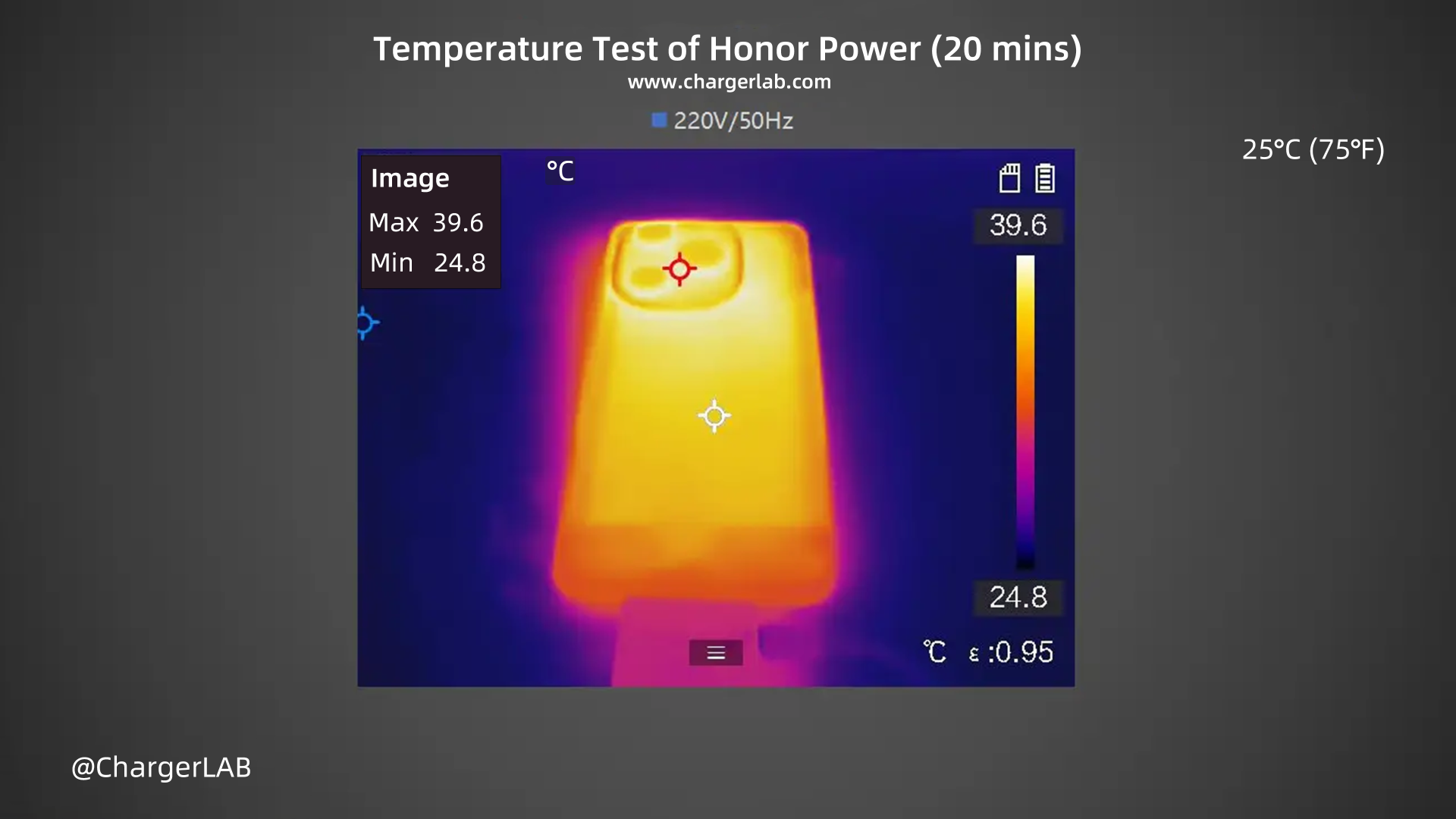

20 minutes Charging
After 20 minutes, the maximum temperature on the front is 38.7℃ (101.66 ℉).
The back is 39.6℃ (103.28 ℉).

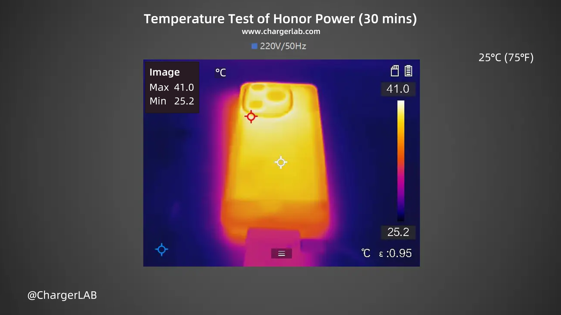

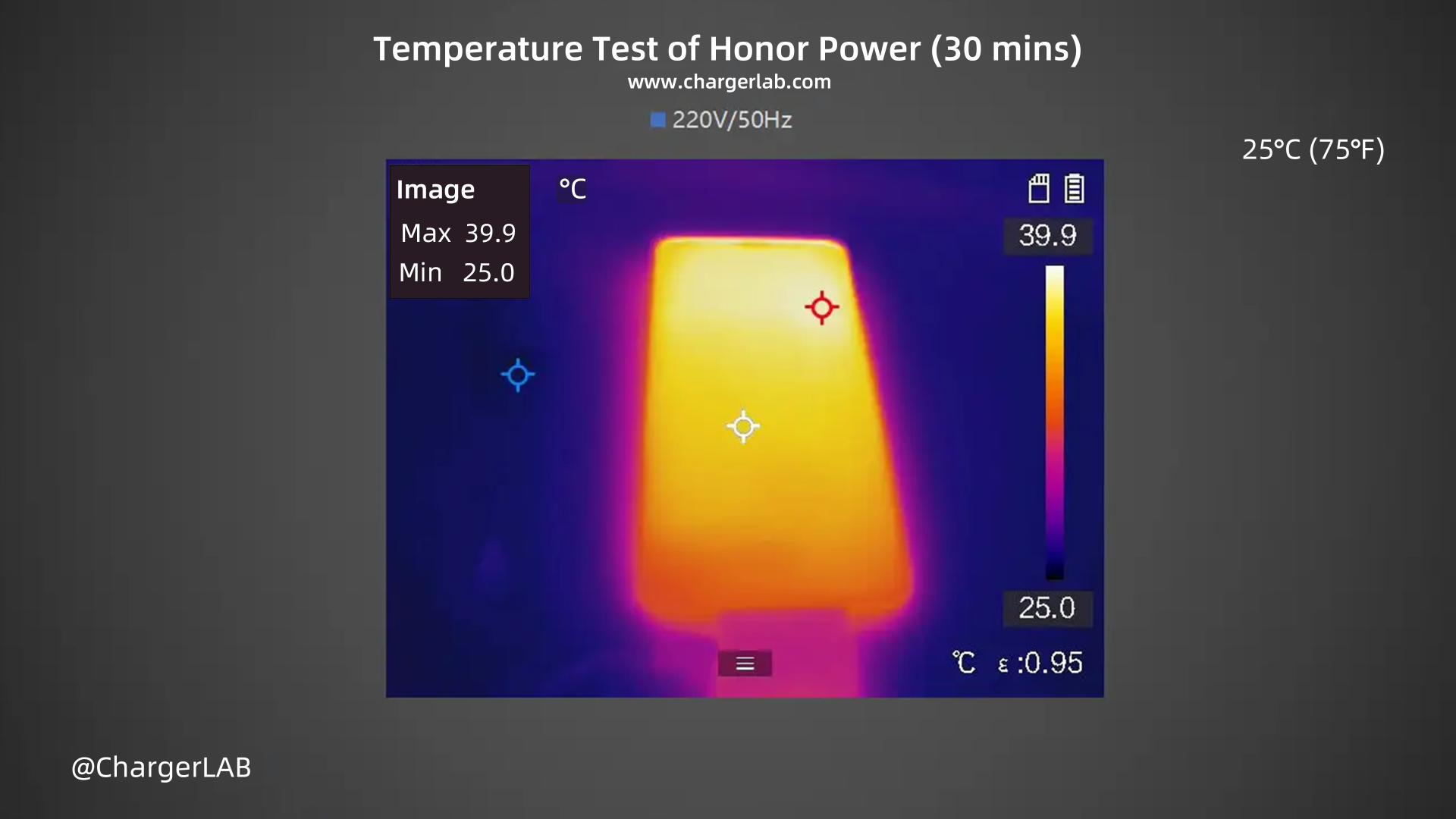

30 minutes Charging
After 30 minutes, the maximum temperature on the front is 39.9℃ (103.82 ℉).
The back is 41℃ (105.8 ℉).

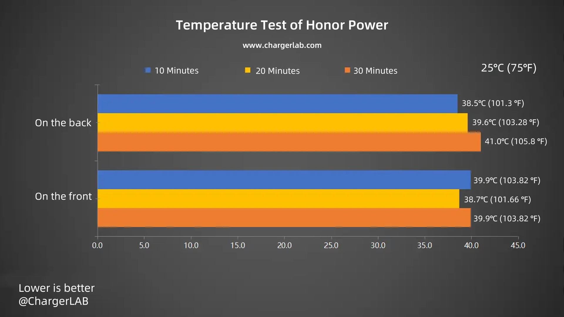

We also turn it into a bar chart. During charging for 30 minutes, the temperature is between 38.5 and 41°C. The temperature isn’t very high, and the thermal control performance is decent.
