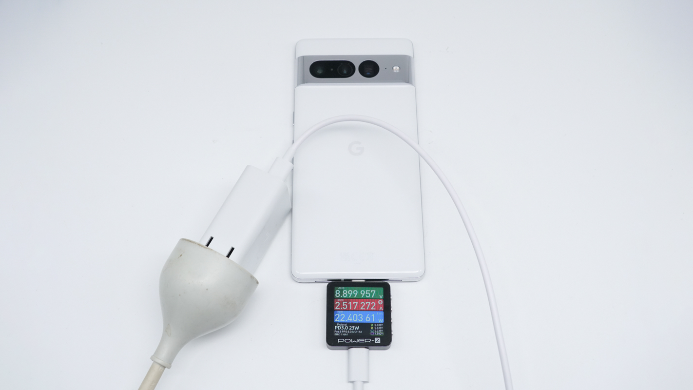

First, when use the 65W charger purchased on their official store (model: G8JK8LPS) and the included dual USB-C cable to charge it, the KM003C shows the power is 8.9V 2.52A 22.4W.
5000mAh Battery & 23W Charging | Charging Review of Google Pixel 7 Pro-Chargerlab
Then, replace the cable with a third-party one, the power reduced to 9.14V 2.10A 19.17W.

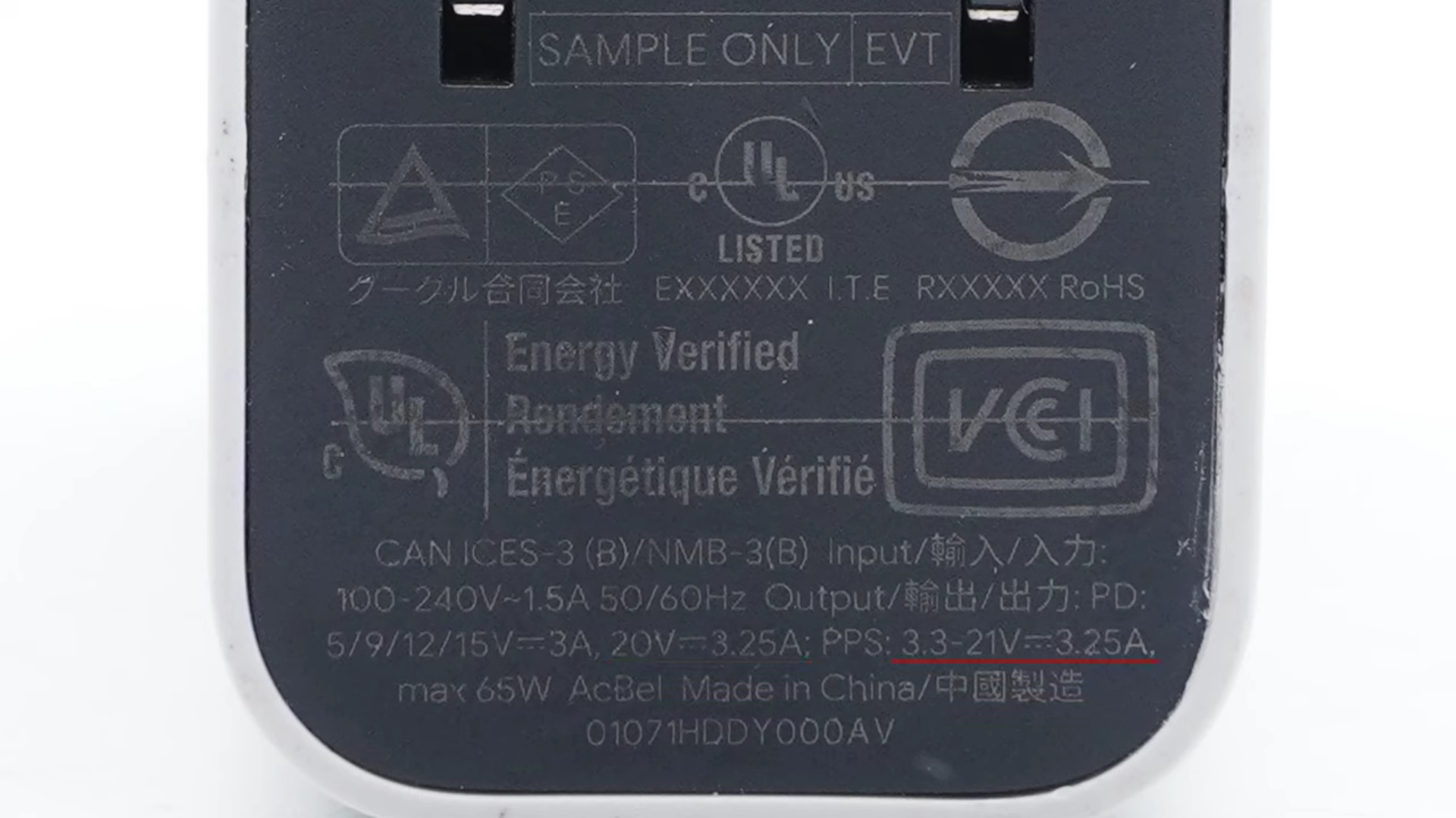

Since we do not have a Google 30W charger, we choose a Google 65W charger to test it.
It supports PD protocol of 20V 3.25A and PPS protocol of 3.3-21V 3.25A.
The peak power is about 23W.
