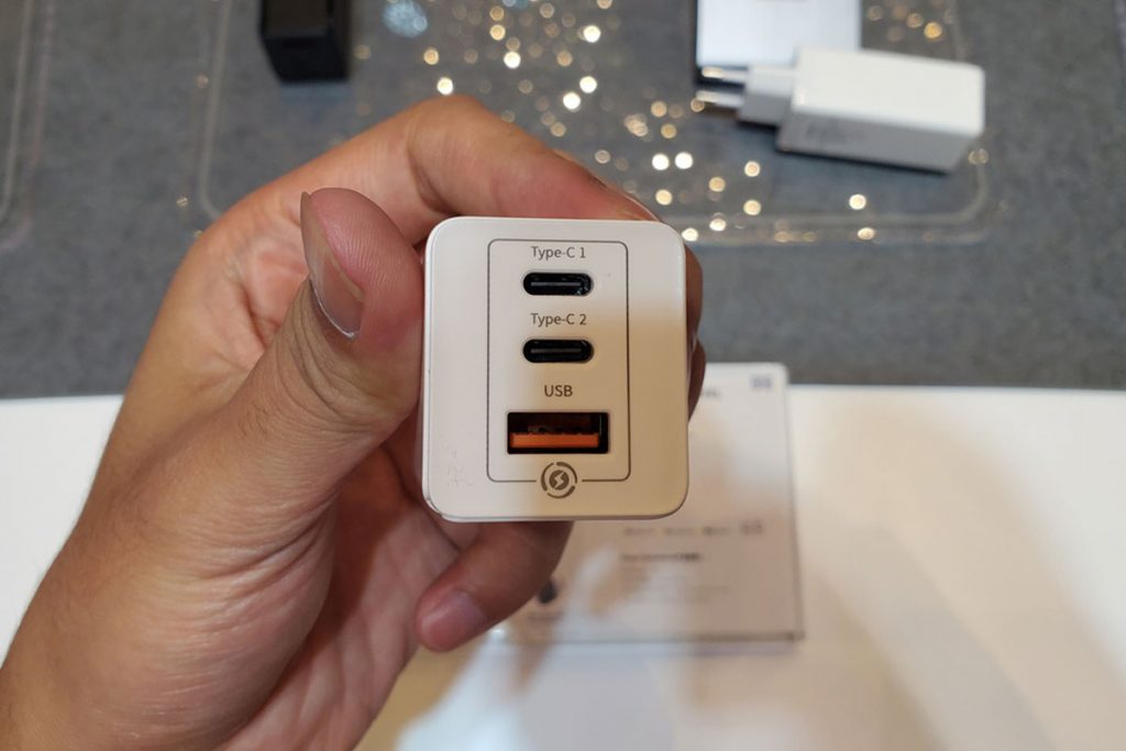

Accessory maker Baseus unveiled a 2C1A (two USB-C ports and one USB-A port) multiport GaN charger – a world’s first, at a special event in Shenzhen, China, on August 18.
The 65W PD charger is base on GaNFast solution from Navitas which enables high wattage inside an ultra compact form factor. It also makes the first debut of GaNFast on a multiport charger (the RAVPower 45W Ultrathin and AUKEY 27W PA-Y19 are single port chargers based on GaNFast). GaN, or Gallium Nitride, which is a new type of semiconductor material that offers higher efficiency, higher thermal conductivity, higher temperature resistance, and other advantages than traditional silicon. When it comes to charging, GaN can greatly reduce the size and boost the efficiency of a charger.

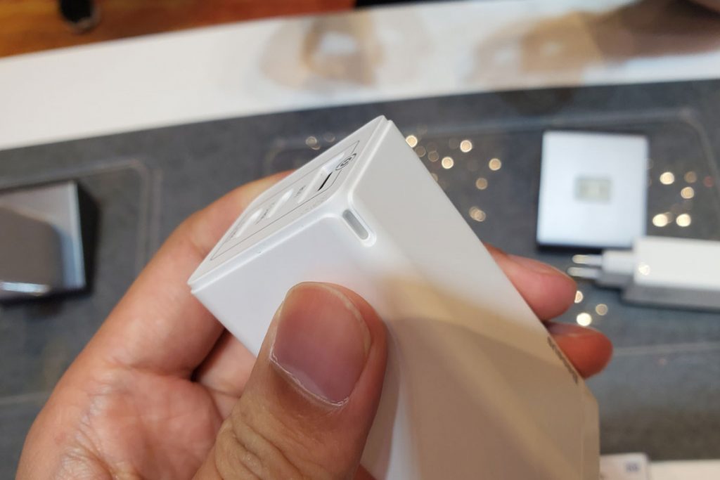

An LED indicator on the side.

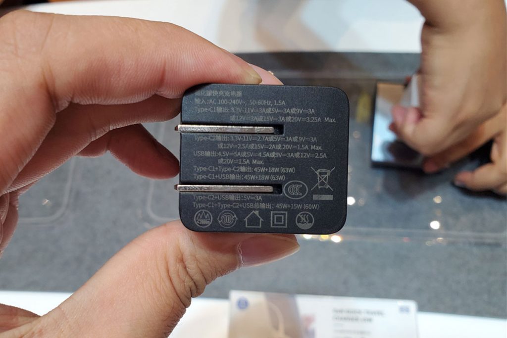

Specifications of the Baseus 2C1A multiport 65W PD GaN charger:
Input: AC 100-240V~, 50~60Hz, 1.5A
USB-C1 Output: 3.3V-11V/3A, 5V/3A, 9V/3A, 12V/3A, 15V/3A, 20V/3.25A Max
USB-C2 Output: 3.3V-11V/2.7A, 5V/3A, 9V/3A, 12V/2.5A, 15V/2A, 20V/1.5A Max
USB-A Output: 4.5V/5A, 5V/4.5A, 9V/3A, 12V/2.5A, 20V/1.5A
USB-C1+USB-C2 Output: 45W+18W (63W)
USB-C1+USB-A Output: 45W+18W (63W)
USB-C2+USB-A Output: 5V/3A
USB-C1+USB-C2+USB-A Output: 45W+15W (60W)
