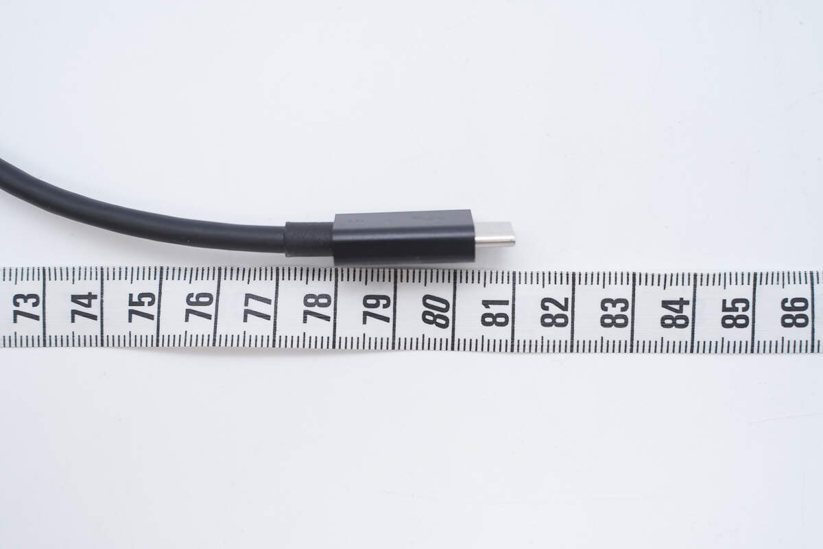

Close-up of the included Thunderbolt 5 cable's connectors.
Teardown of UGREEN Revodok Max Thunderbolt 5 Docking Station (U715)-Chargerlab
The length of the cable is about 81 cm (31.89 inches).

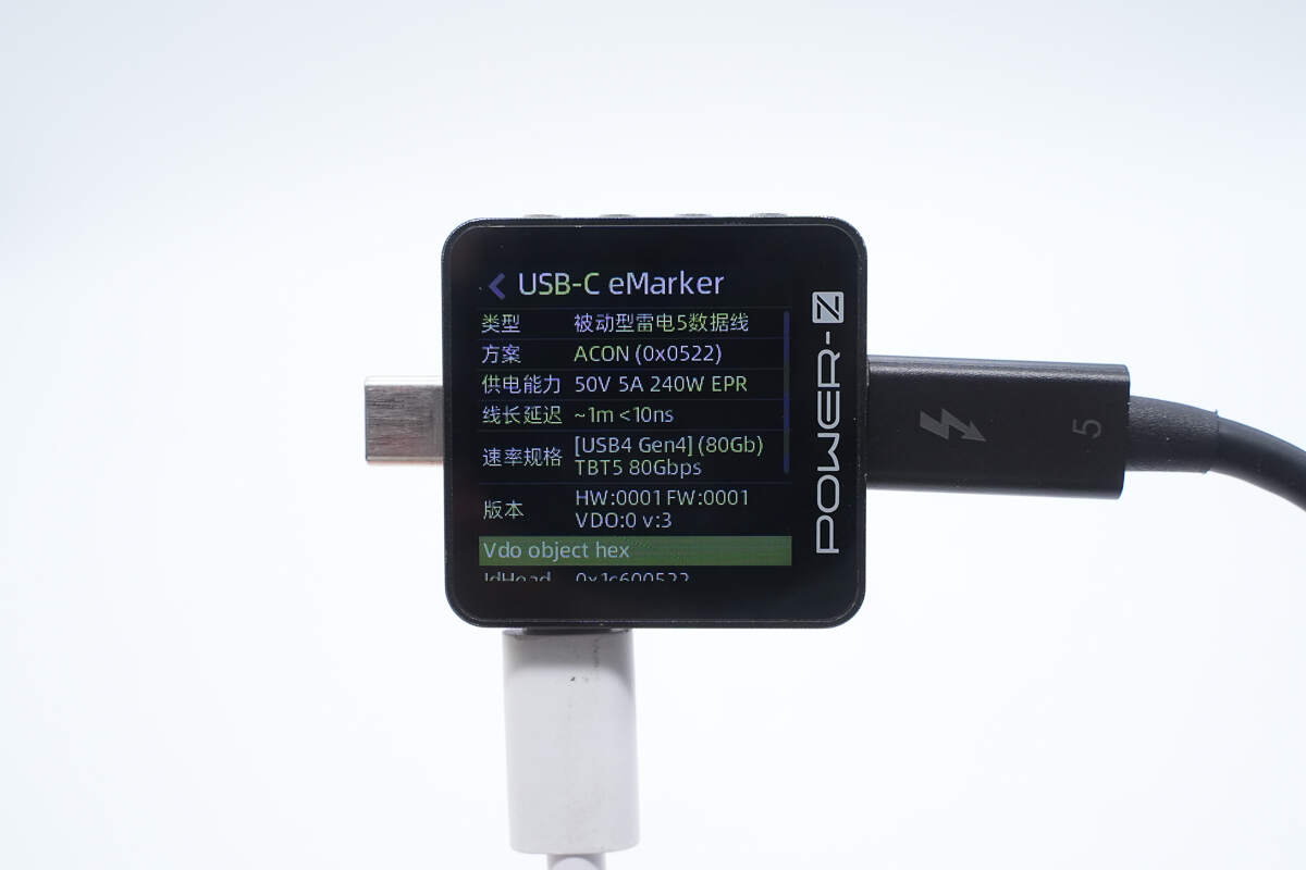

ChargerLAB POWER-Z KM003C shows it has an E-Marker chip, with a power delivery capability of 50V 5A and data transfer capability of USB4 Gen4 (80Gbps) / Thunderbolt 5 80Gbps.

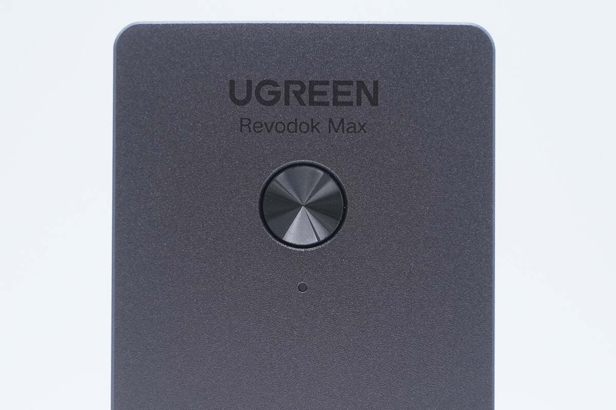

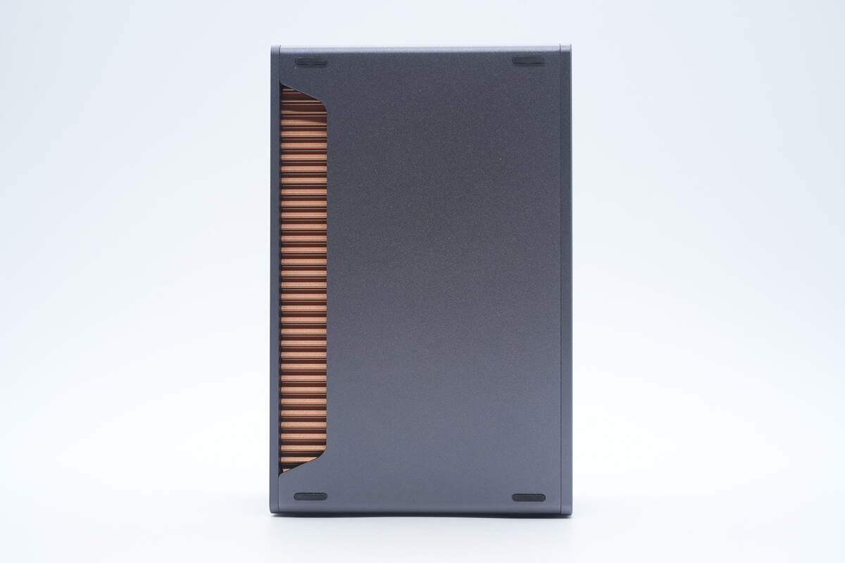

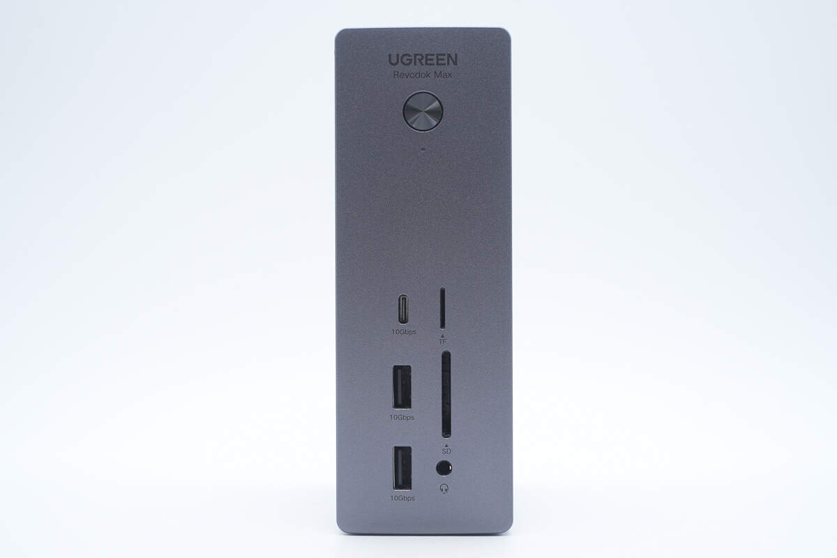

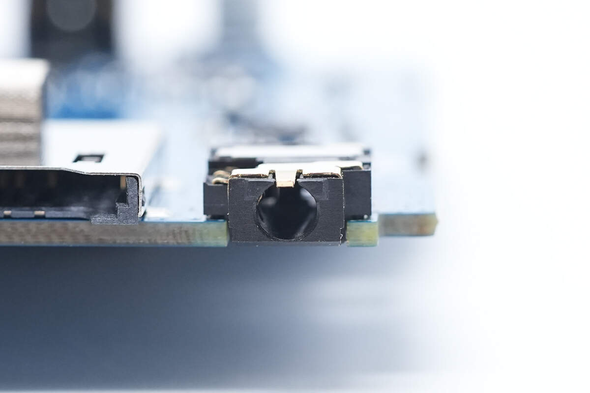

The front of the docking station features a power button, indicator light, USB ports, a TF card slot, an SD card slot, and a 3.5mm audio jack.
The indicator light is located below the power button.
The ports are labeled with their respective data transfer rates.

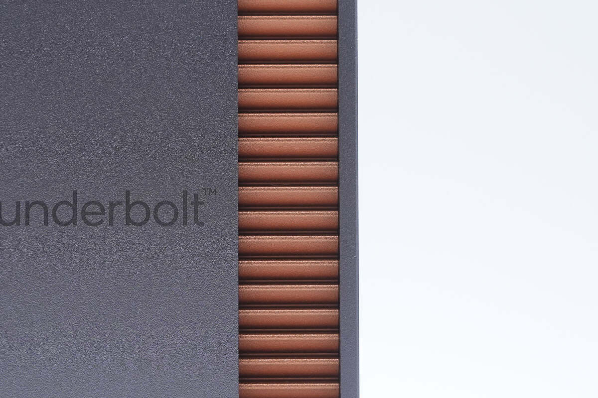

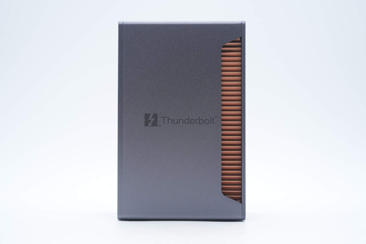

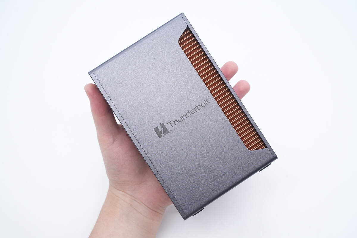

The side features the Thunderbolt logo.
Inside, there are heatsinks installed.
The other side also has heatsinks and is equipped with anti-slip pads.

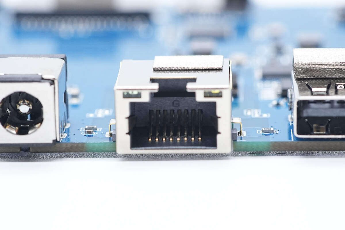

The back has Thunderbolt 5 ports, USB-A ports, an Ethernet port, and a power input slot.
The back cover is secured with Allen screws.

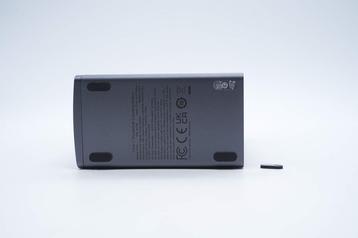

The bottom has anti-slip pads and printed product information.
Model: U715
P/N: 45790
Input: 21V8.57A Max
It has passed FCC, CE, and UKCA certifications.

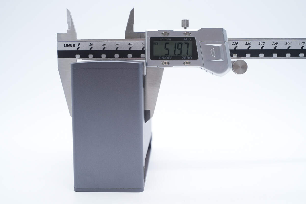

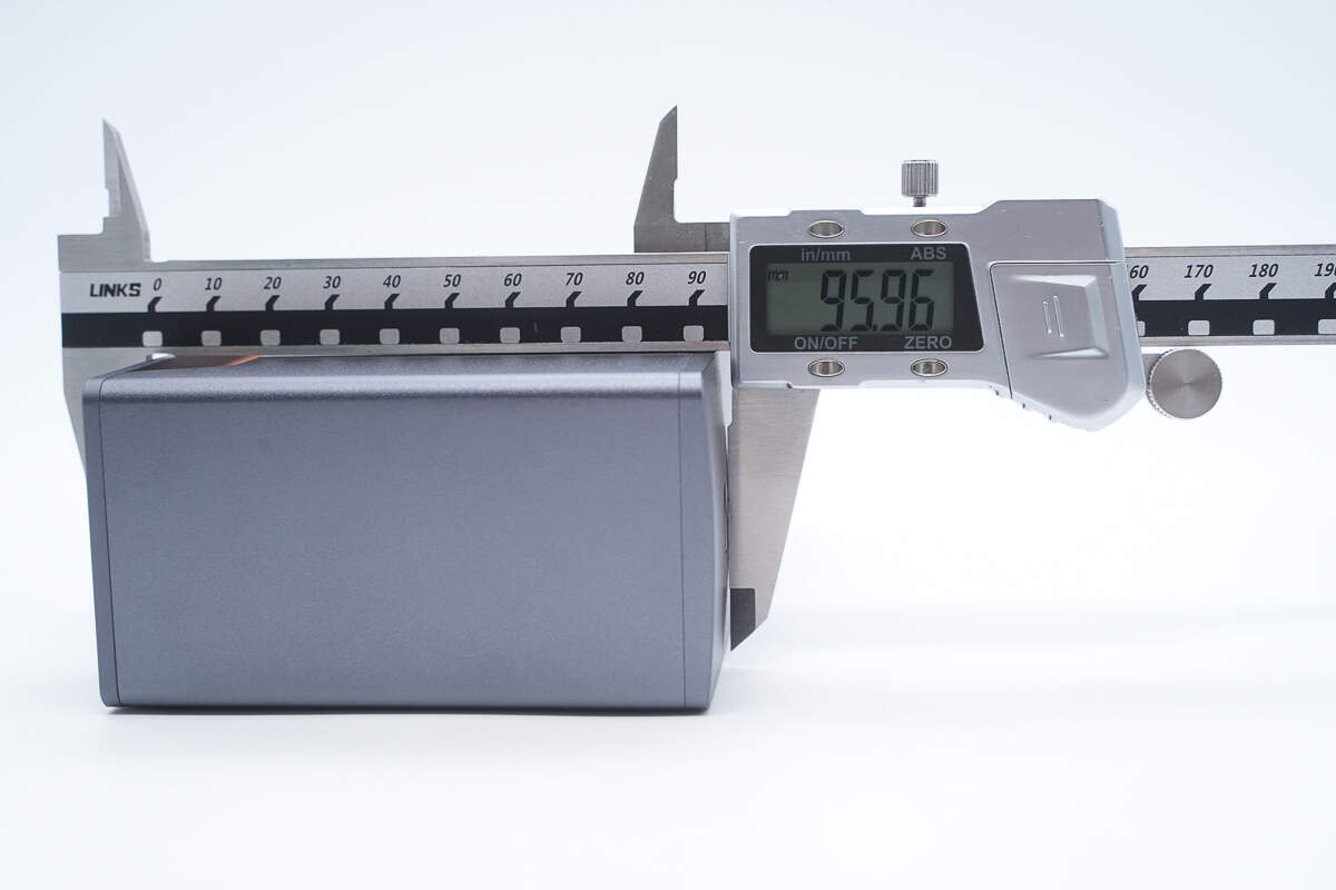

The width of the dock is about 52 mm (2.047 inches).
The thickness is about 96 mm (3.78 inches).
The height is about 148.2 mm (5.83 inches).

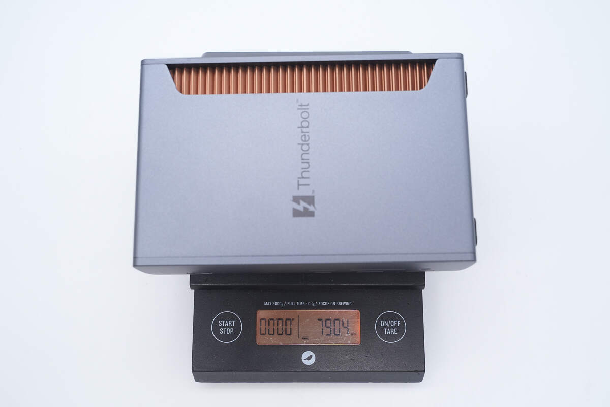

The weight is about 790 g (27.87 oz).

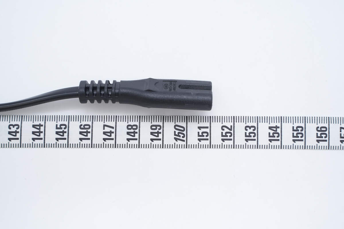

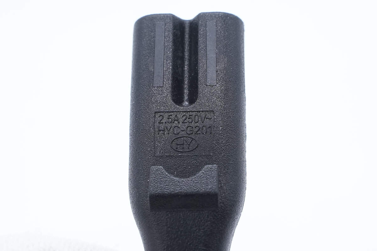

The included power cable has a C8 connector.
The length of the cable is about 151 cm (59.45 inches).

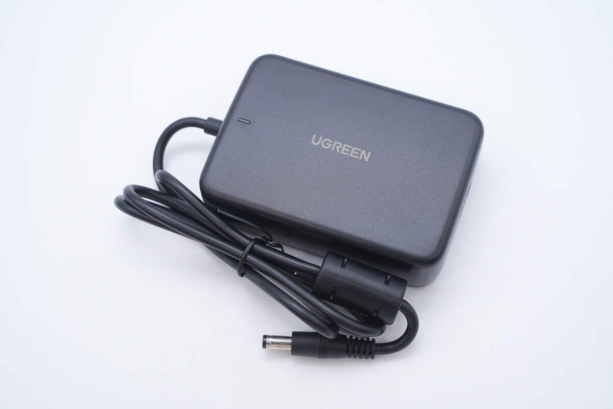

The included power adapter features an integrated cable design.
The front is printed with UGREEN and has an indicator light.

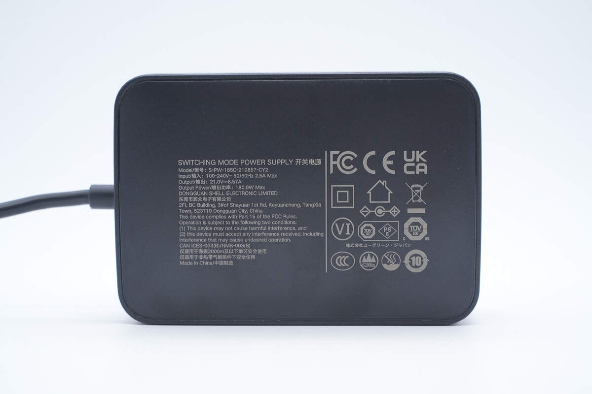

The spec info is printed on the back.
Model: S-PW-185C-210857-CY2
Input: 100-240V~ 50/60Hz 2.5A Max
Output: 21V 8.57A
Output Power: 180W Max

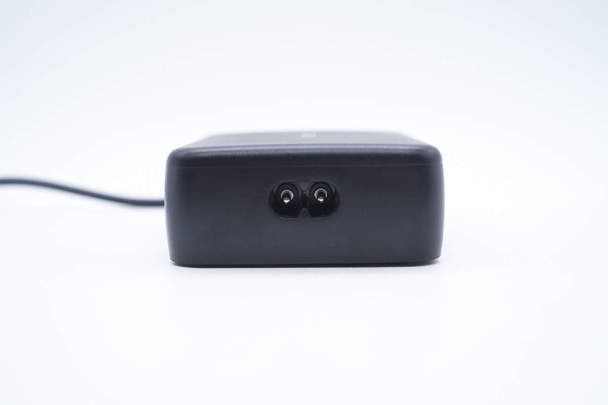

The power input features a C8 socket.

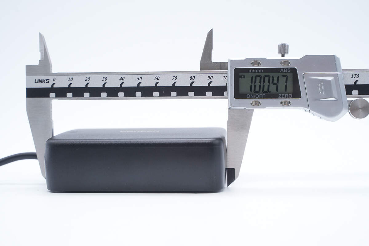

The length is about 100.5 mm (3.96 inches).

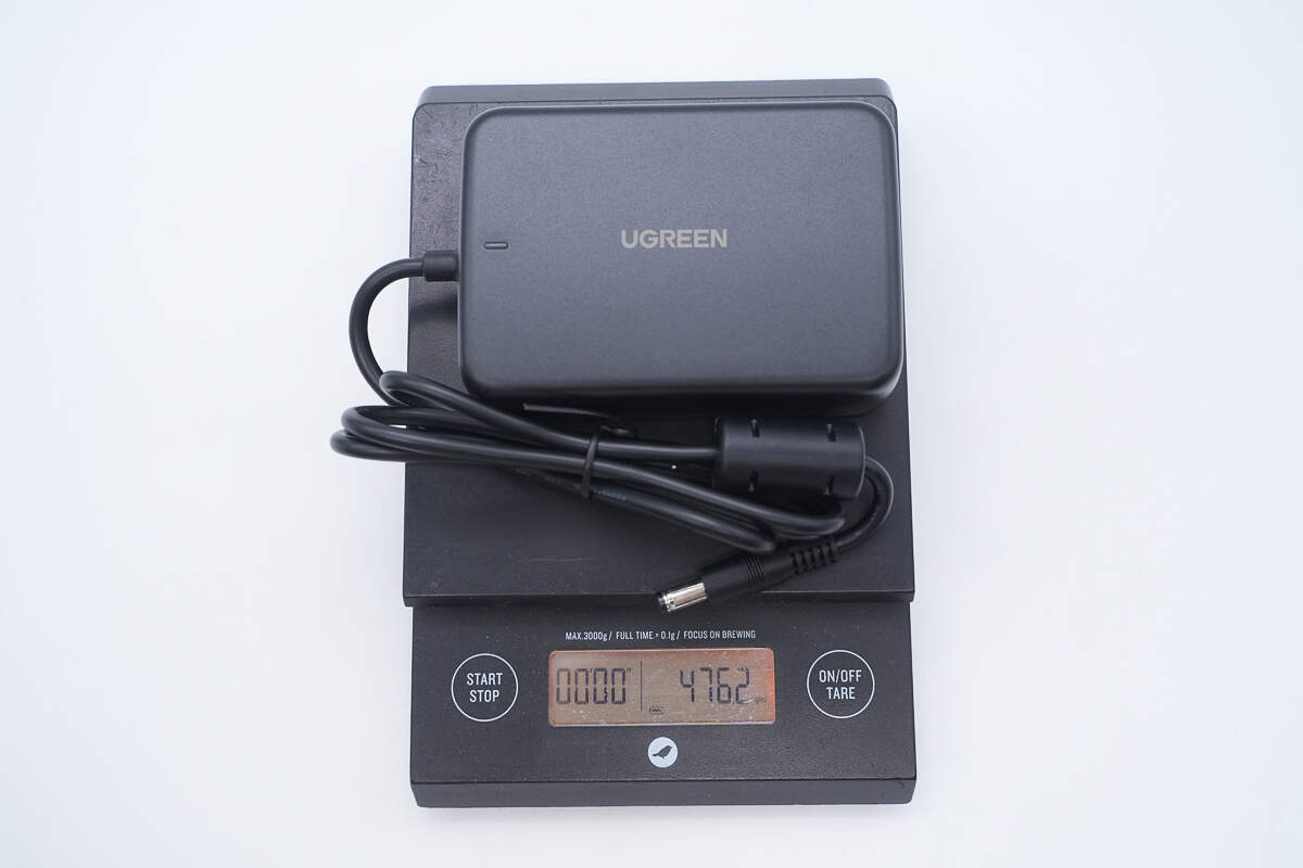

The weight is about 476 g (16.79 oz).

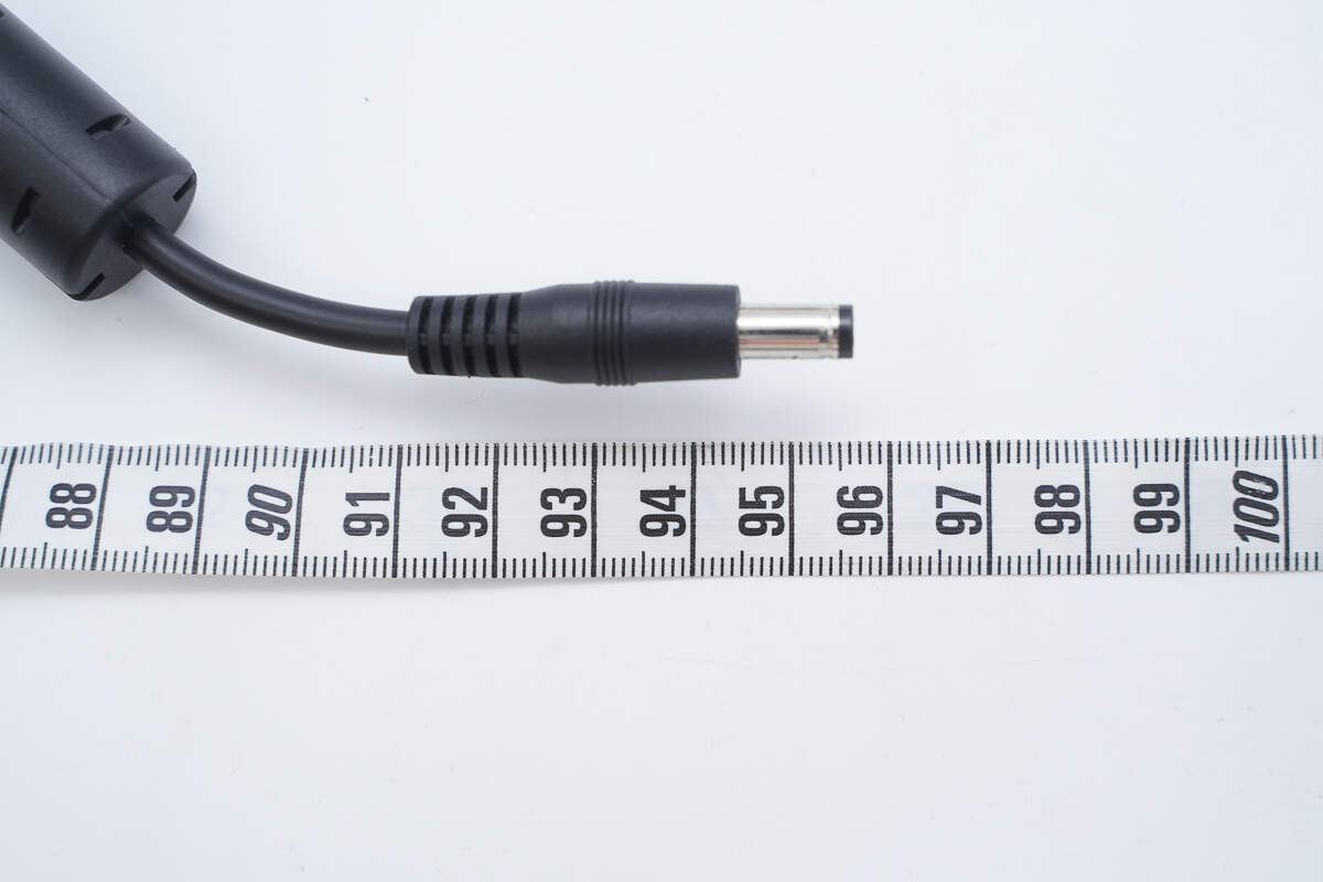

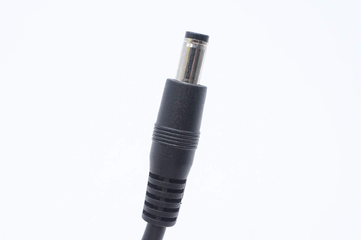

The output is a DC connector.
The output cable is equipped with an anti-interference ferrite core.
The length of the output cable is about 96 cm (37.8 inches).

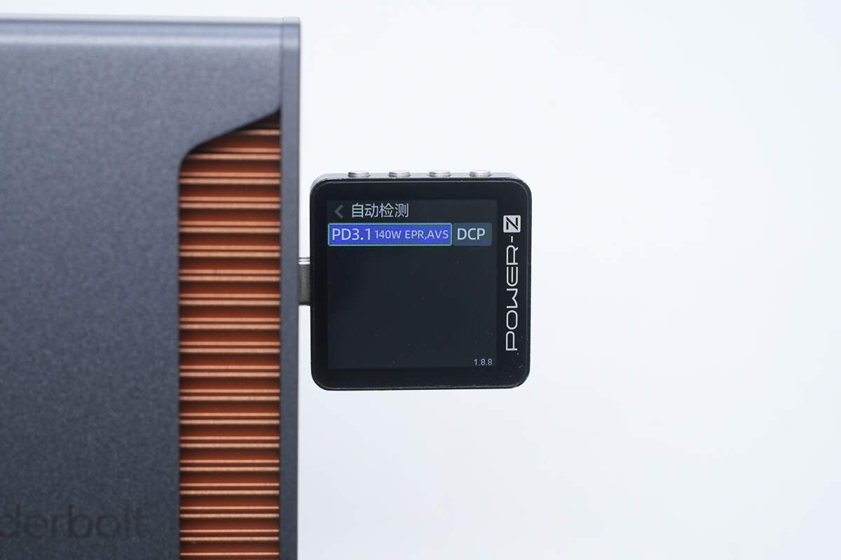

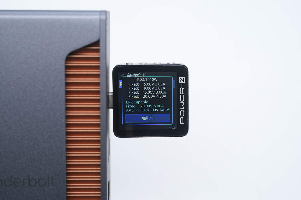

ChargerLAB POWER-Z KM003C measured that the Thunderbolt 5 upstream port supports PD3.1 140W charging protocol and DCP charging protocol.
And it has five fixed PDOs of 5V3A, 9V3A, 15V3A, 20V4.8A, and 28V5A. It has one set of AVS, which is 15-28V 140W.

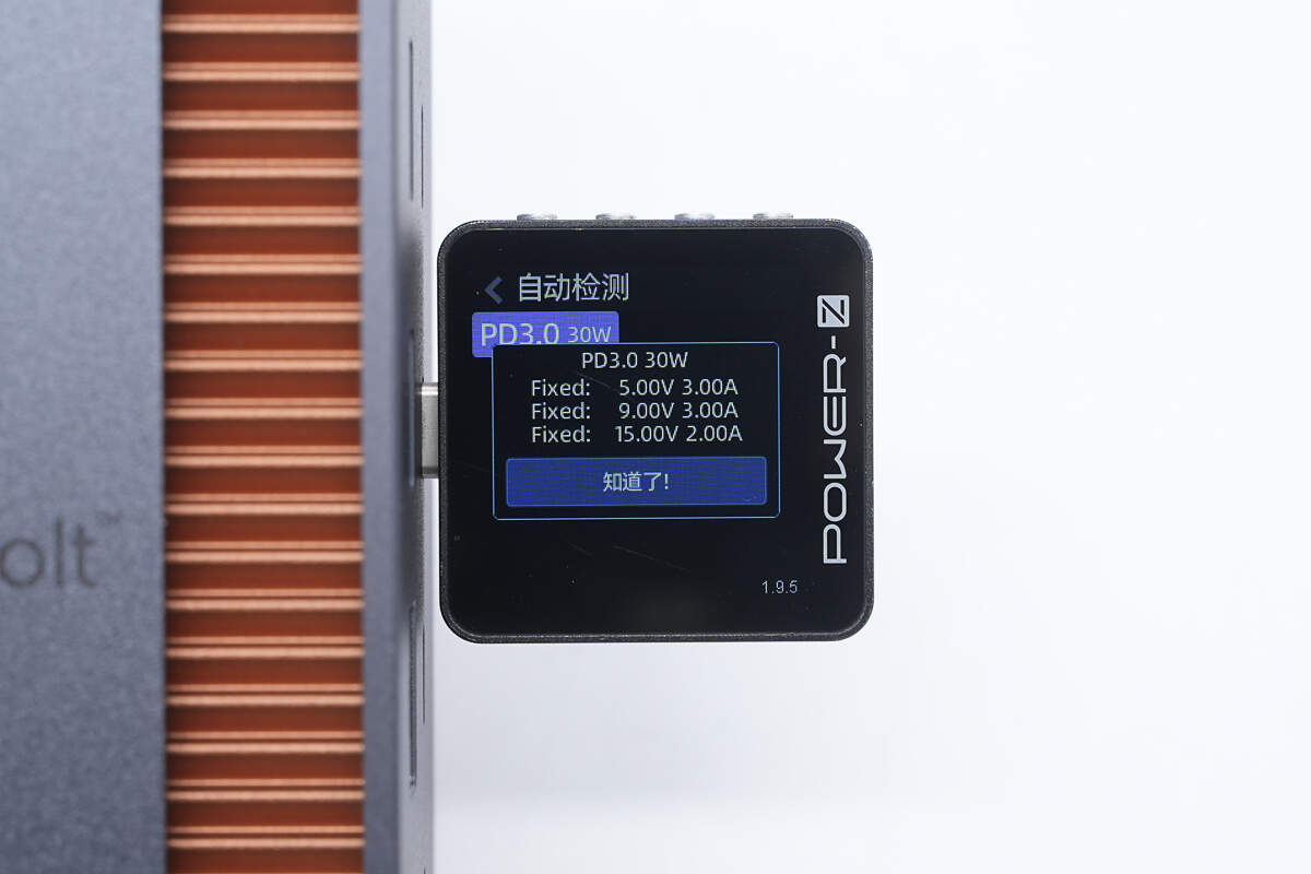

It was measured that Thunderbolt 5 downstream port A supports PD3.0 30W output.
And it has three fixed PDOs of 5V3A, 9V3A, and 15V2A.

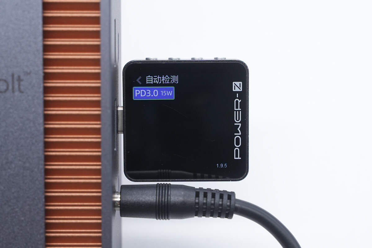

Thunderbolt 5 downstream ports B and C support PD3.0 15W output.
And it has one fixed PDO of 5V3A.

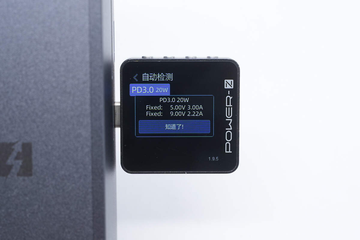

The front USB-C port supports 20W PD.
And it has two fixed PDOs of 5V3A and 9V2.22A.

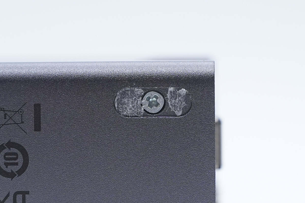

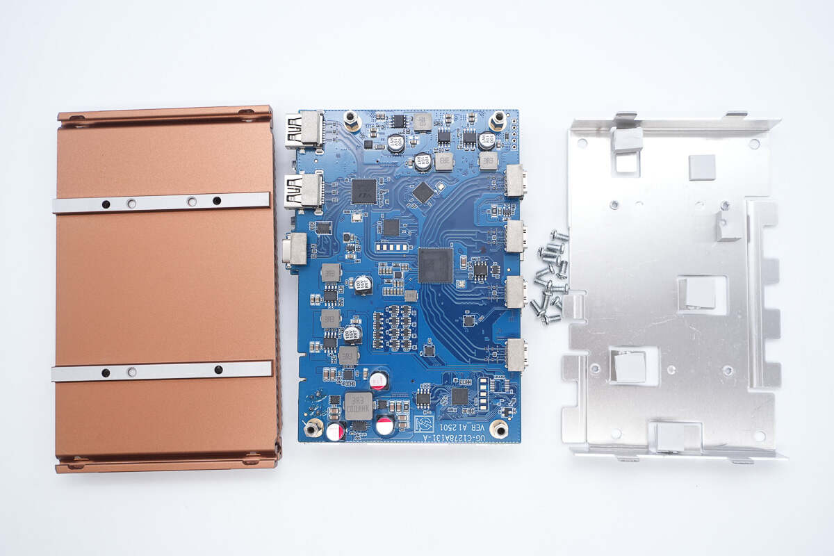

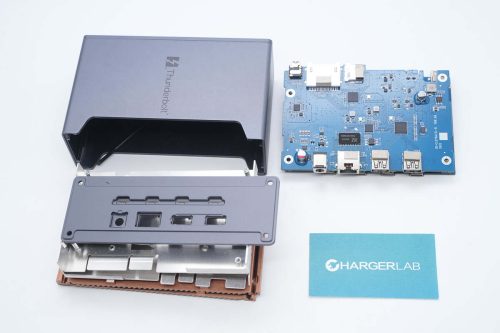

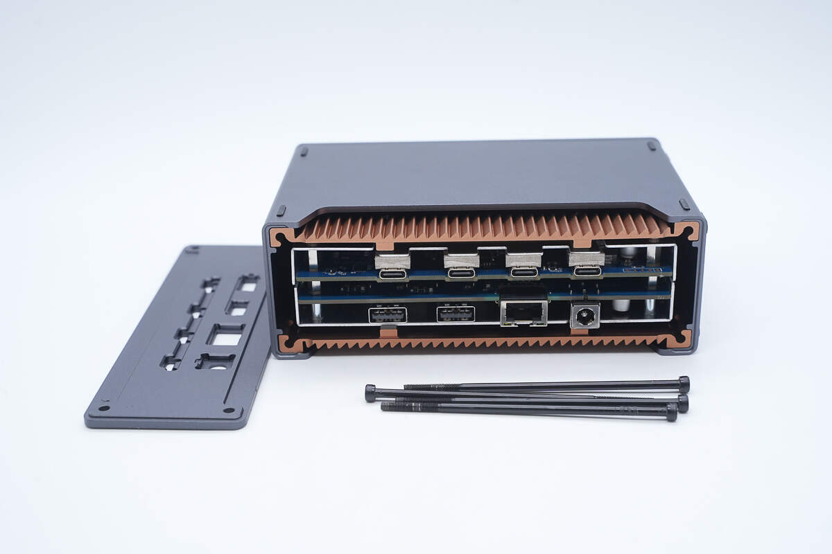

First, unscrew the four long screws to remove the back cover.

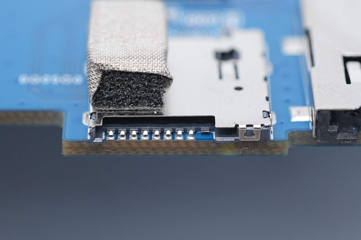

The PCBA module is equipped with aluminum alloy shielding covers, and conductive fabric is applied between the ports and the casing for grounding.
Peel off the anti-slip pads from the bottom.
There are screws underneath the pads.

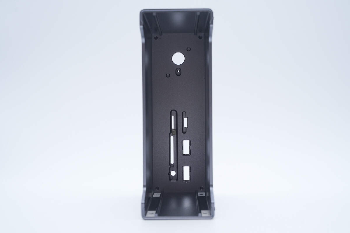

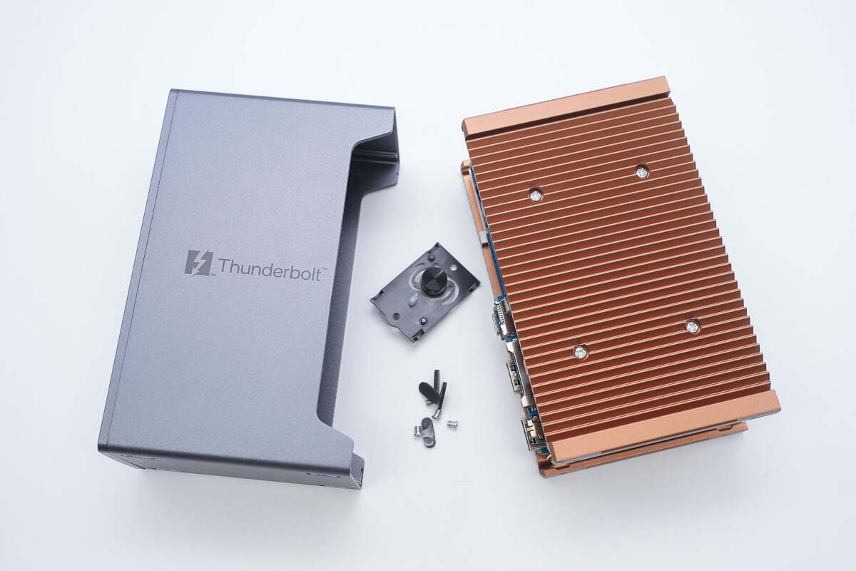

Unscrew the screws and remove the PCBA module.

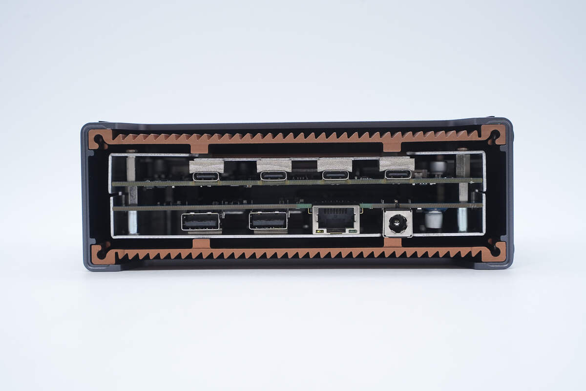

The casing is made of aluminum alloy.

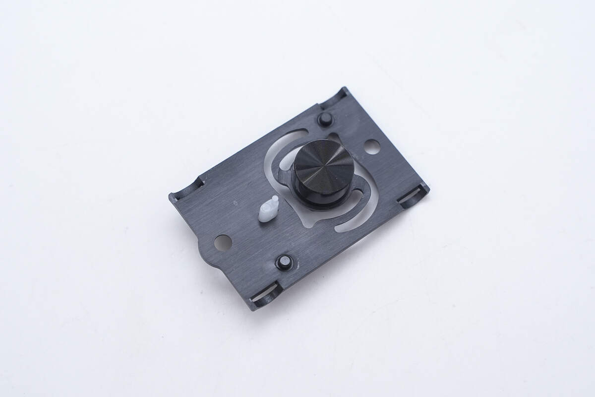

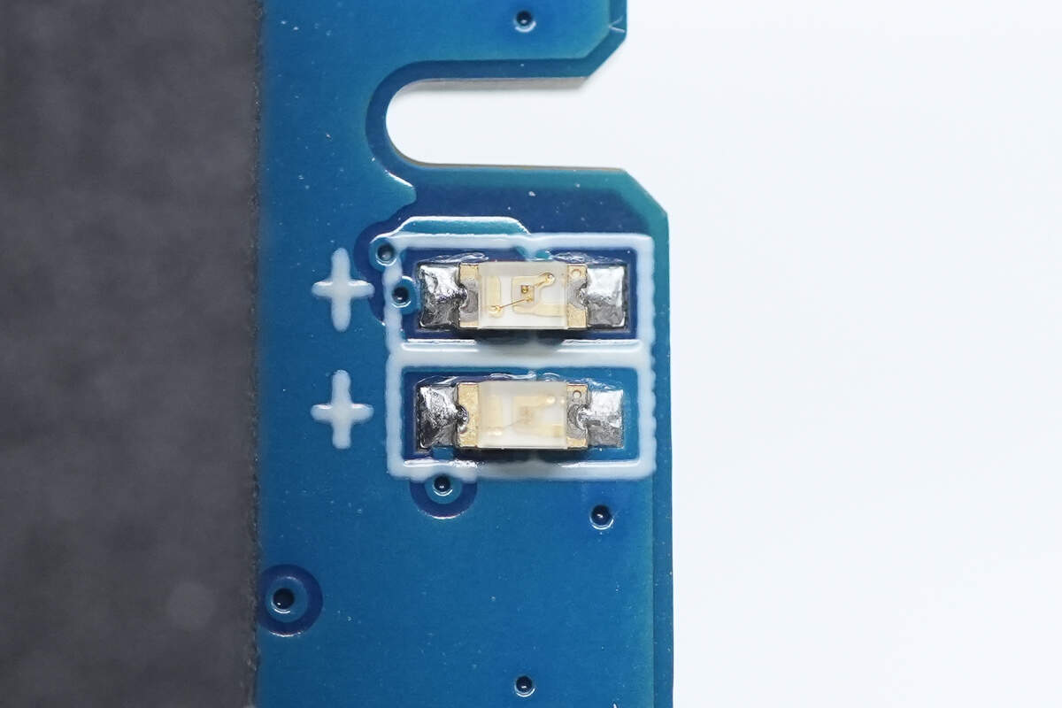

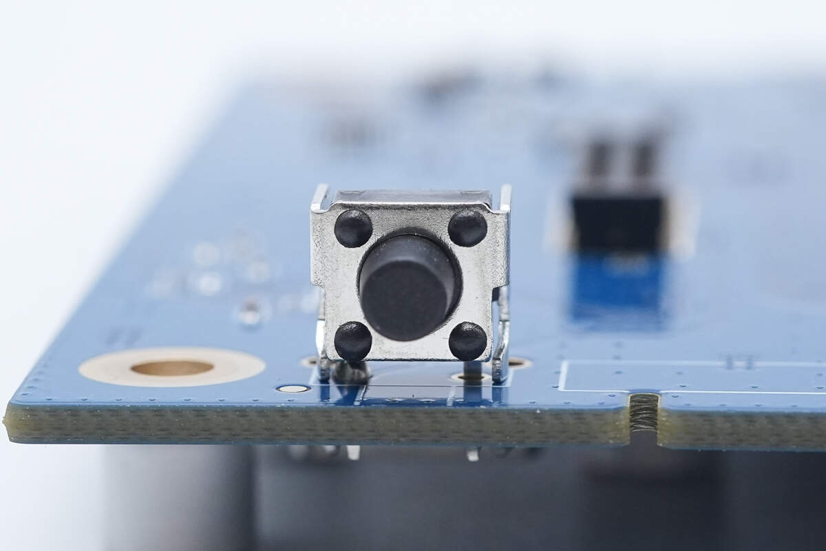

Close-up of the power button and the light guide for the indicator LED.

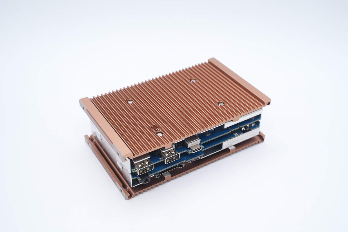

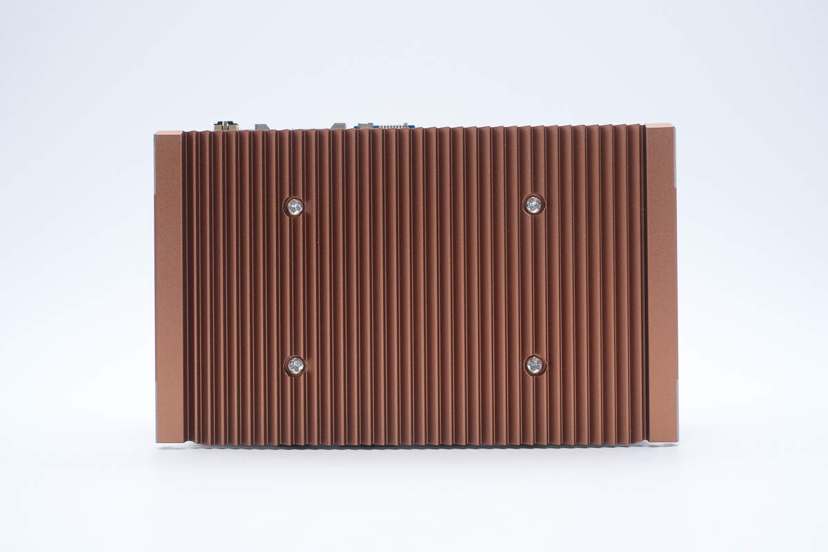

The PCBA module has aluminum alloy heatsinks on both sides.
The heatsinks are secured with screws.
The heatsinks are attached to the shielding cover.

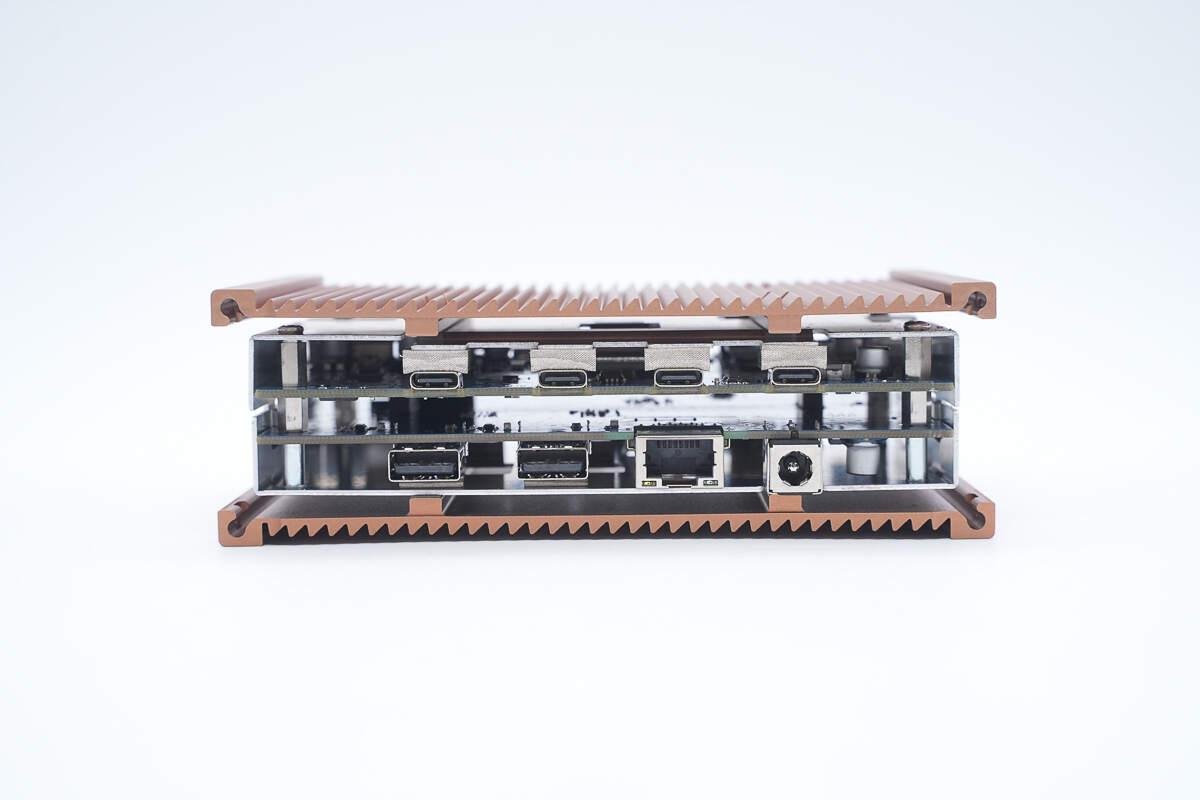

After removing the heatsinks and shielding cover, thermal pads are placed on the shielding cover corresponding to the heat-generating components.
The PCBA module is secured with standoffs.
Close-up of the standoffs securing the PCBA module.

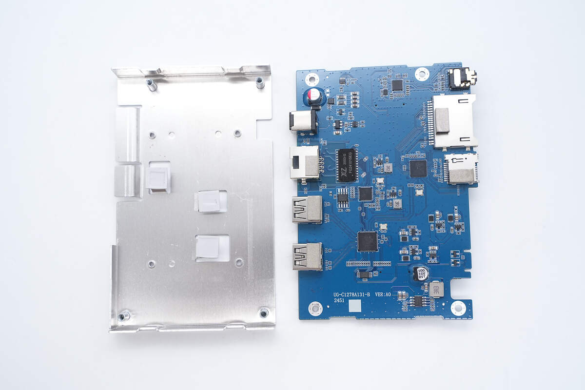

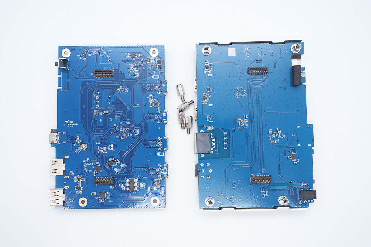

Separate the two PCBs.
There are also thermal pads between the other side of the PCB and the shielding cover.

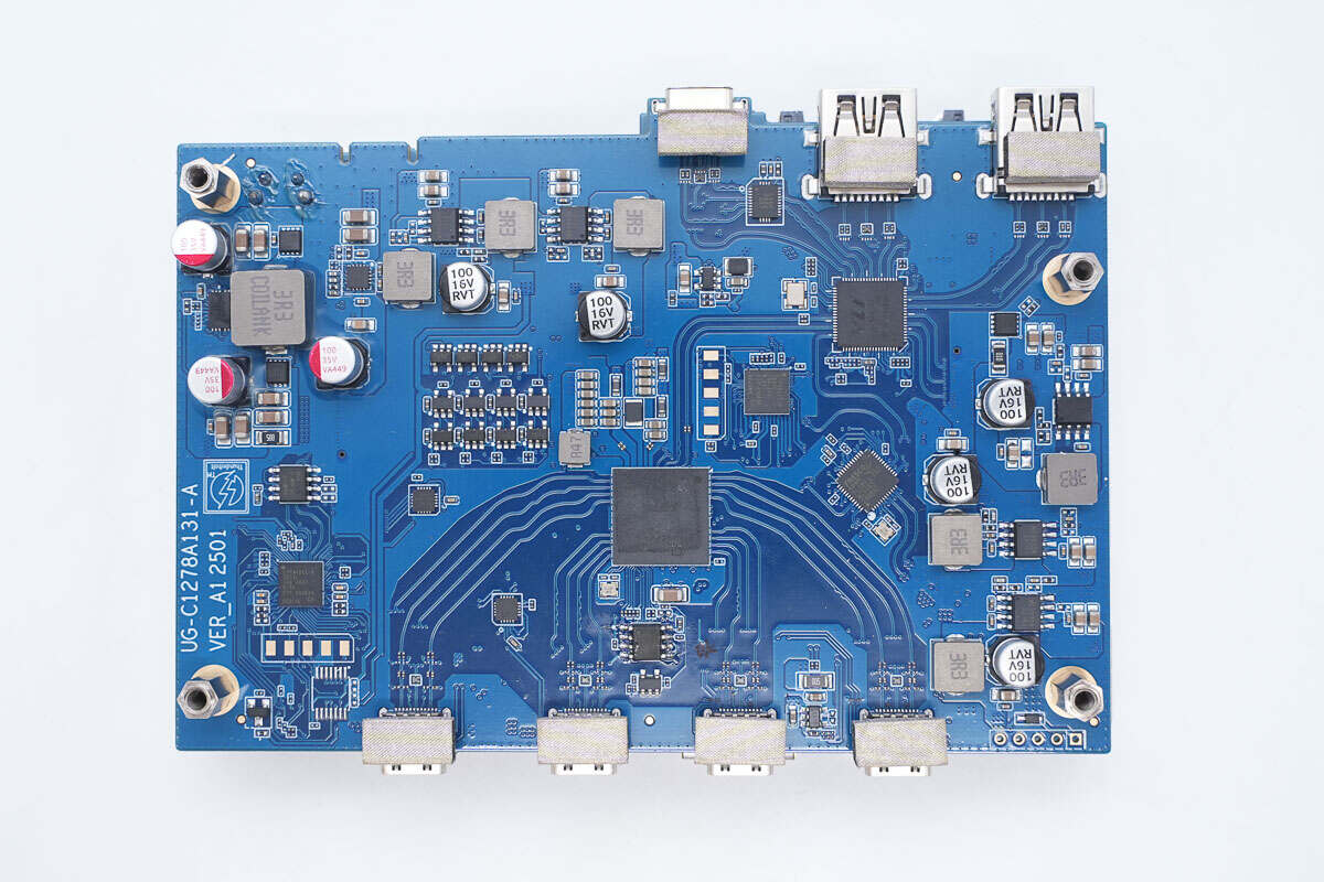

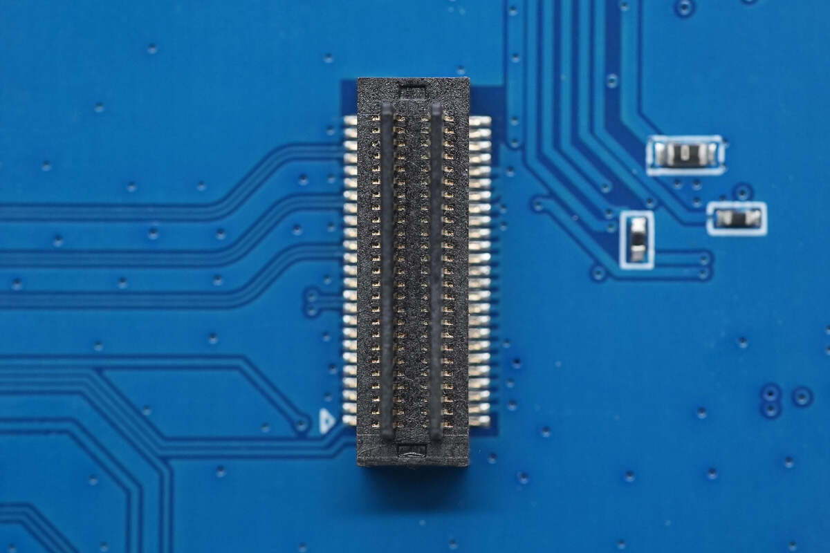

The two PCBs are connected through connectors.

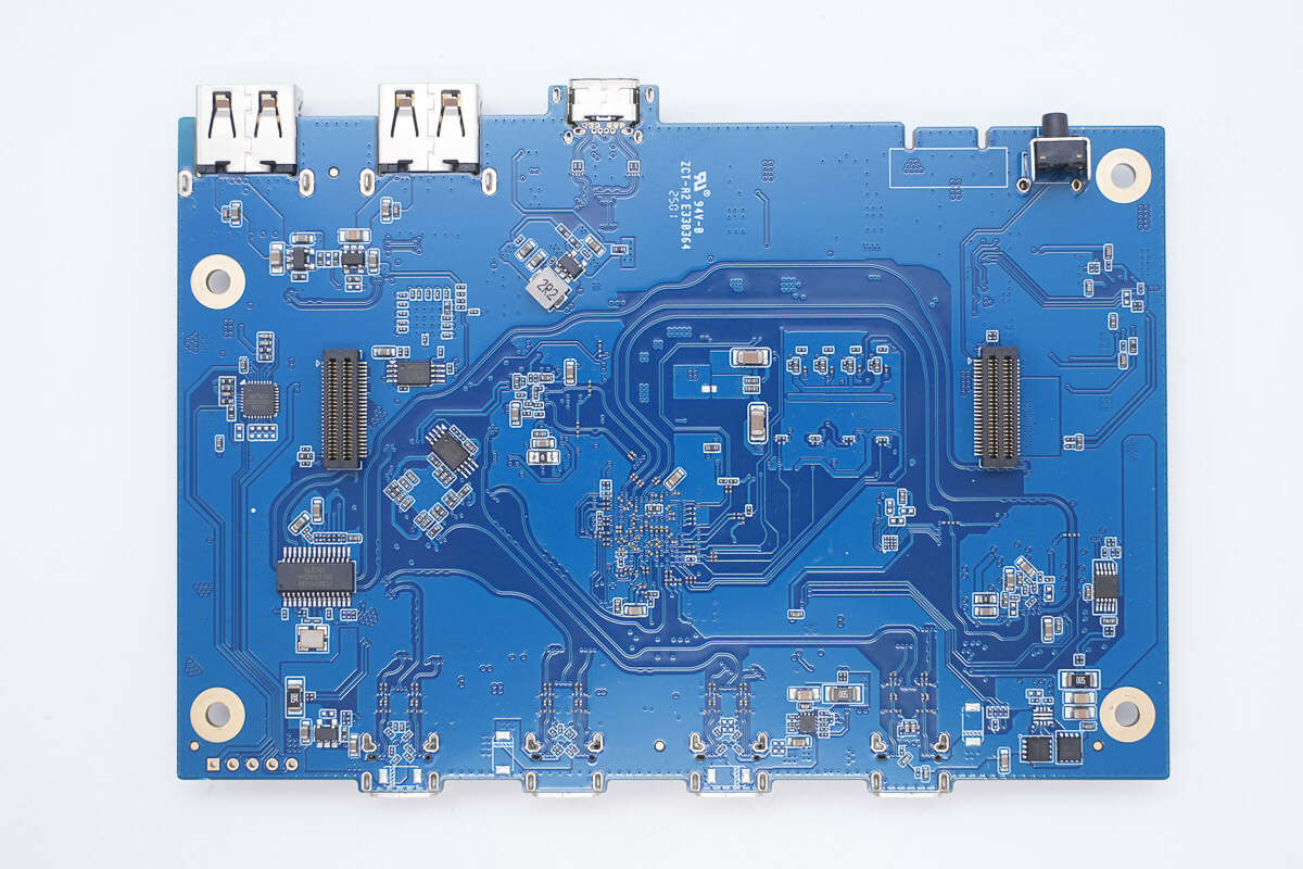

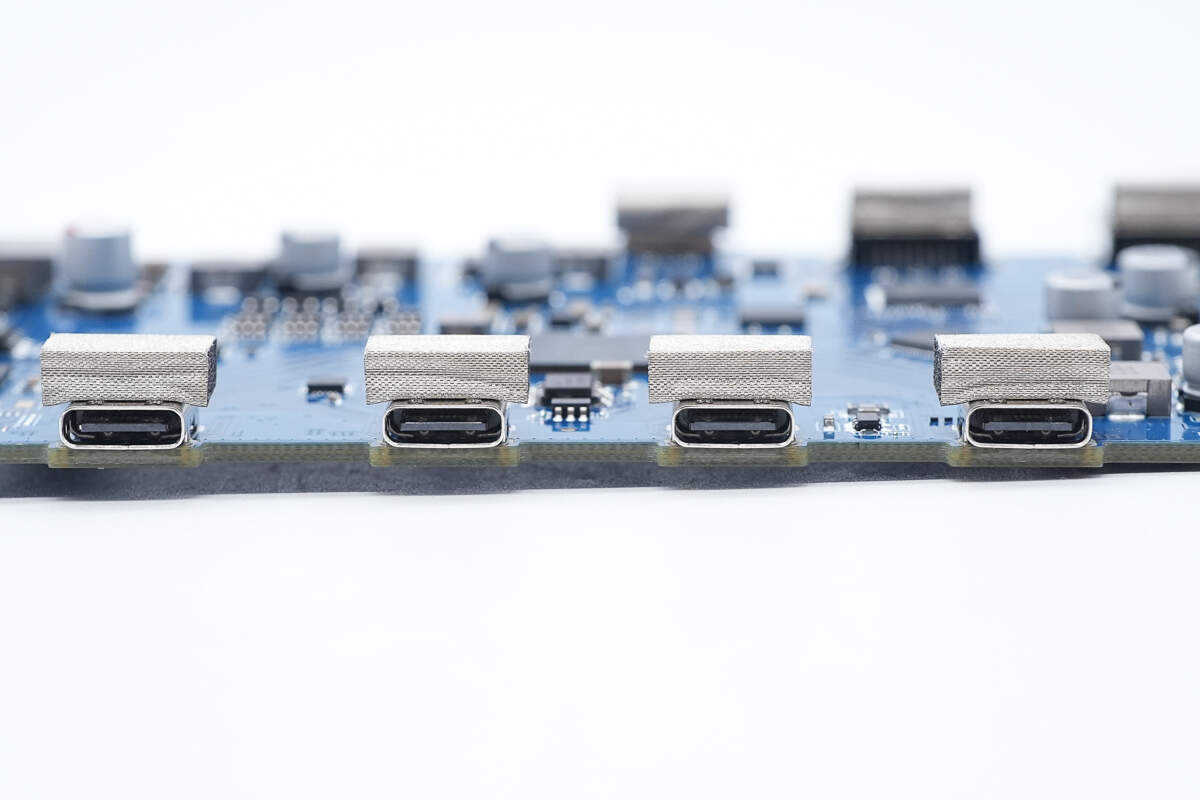

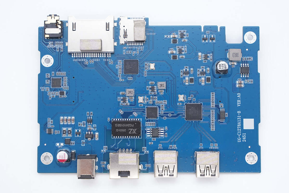

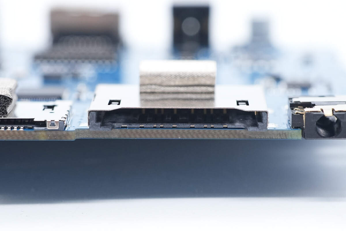

On the bottom side of the Thunderbolt 5 interface PCB, there are four Thunderbolt 5 ports and the Thunderbolt controller. The upper left area contains synchronous buck-boost and synchronous buck circuits. The lower left area houses protocol chips. The upper right corner has USB ports and a hub chip. The right side includes synchronous buck circuits, a hub chip, and protocol chips.

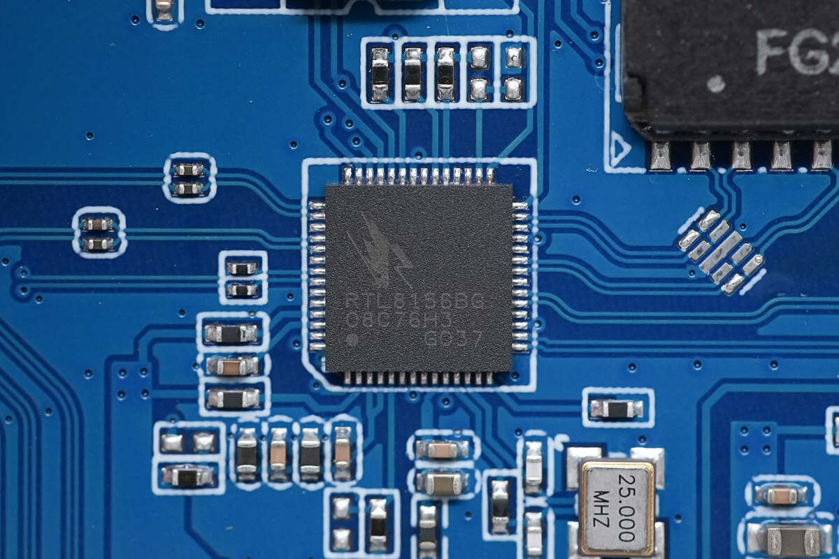

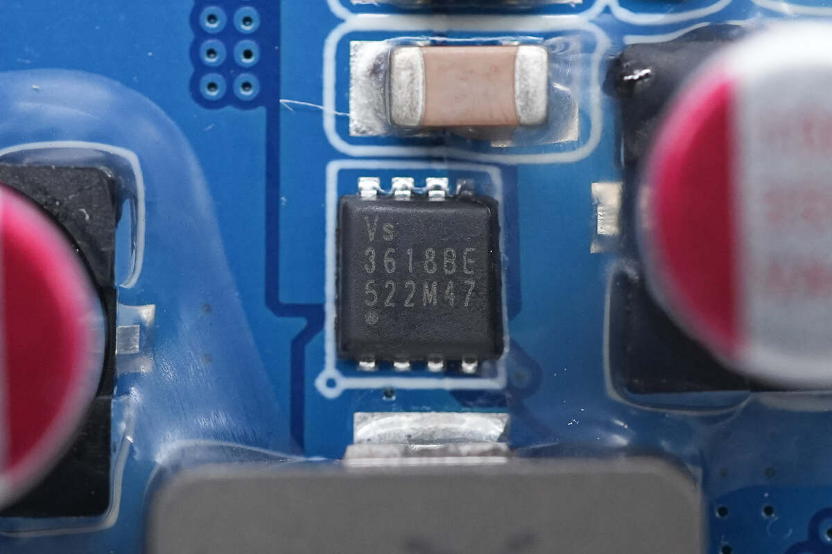

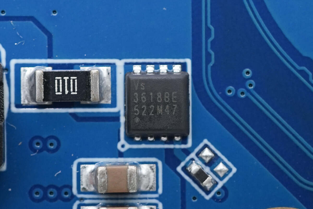

The back side has connectors, protocol chips, hub chips, memory, and VBUS MOSFETs. It also features synchronous buck chips and overcurrent protection chips.
The Thunderbolt controller is from Intel, model JHL9480, codenamed Barlow Ridge. It supports four PCIe lanes configured as x4 Gen 4 and includes features such as ACS, FBP, PTM, and P2P. It supports 128/256B payloads. For display ports, it provides 2 DP sinks and 3 DP sources, supports DP 2.1 tunneling and retiming functions, and operates in x1/x2/x4 modes with speeds ranging from 1.62Gbps to 20Gbps. It features SST, MST, DSC 1.2, FEC, LTTPR, Panel Replay, and uses an FC-CSP package.

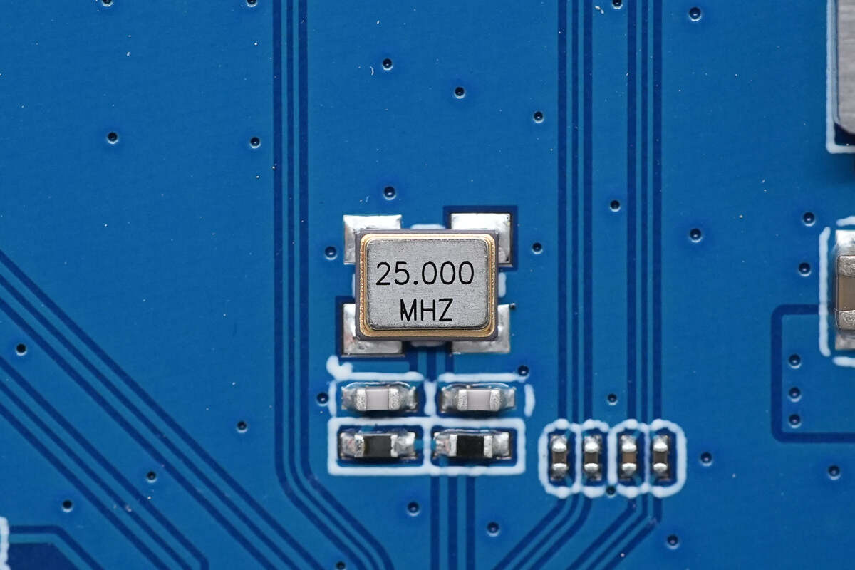

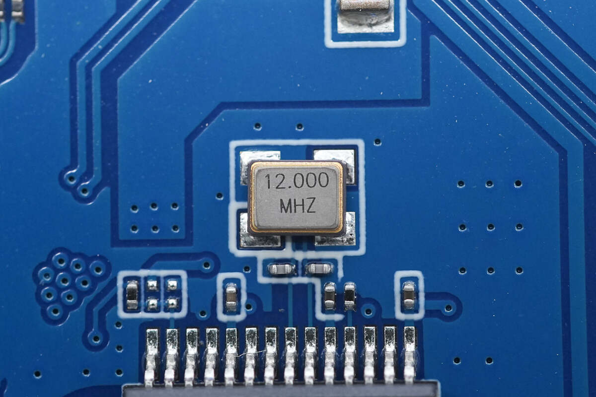

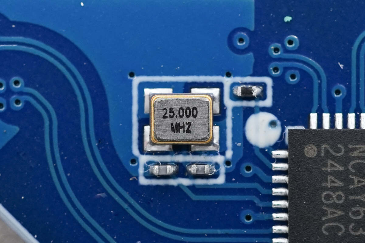

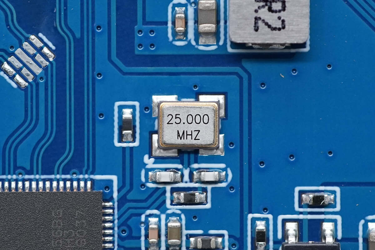

Close-up of the external 25.000 MHz clock crystal oscillator.

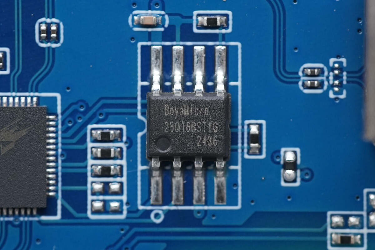

The memory is from BoyaMicro, model BY25Q16AWTIG, with a capacity of 2MB and packaged in SOP8.

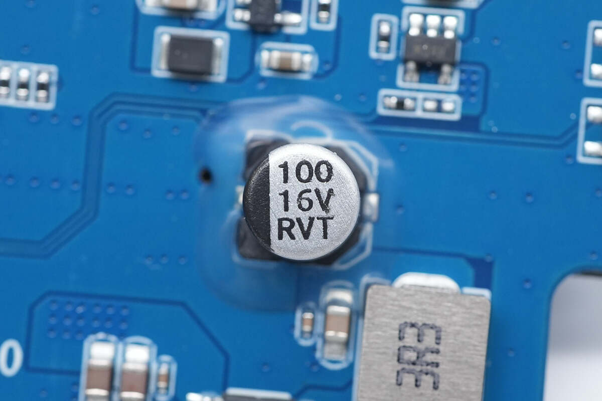

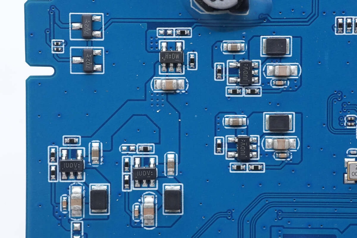

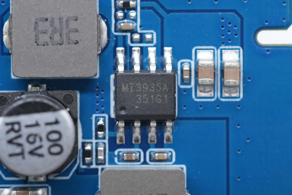

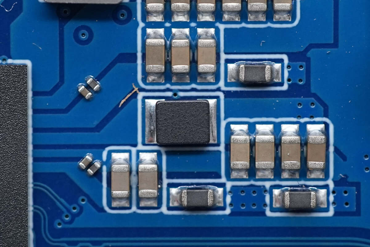

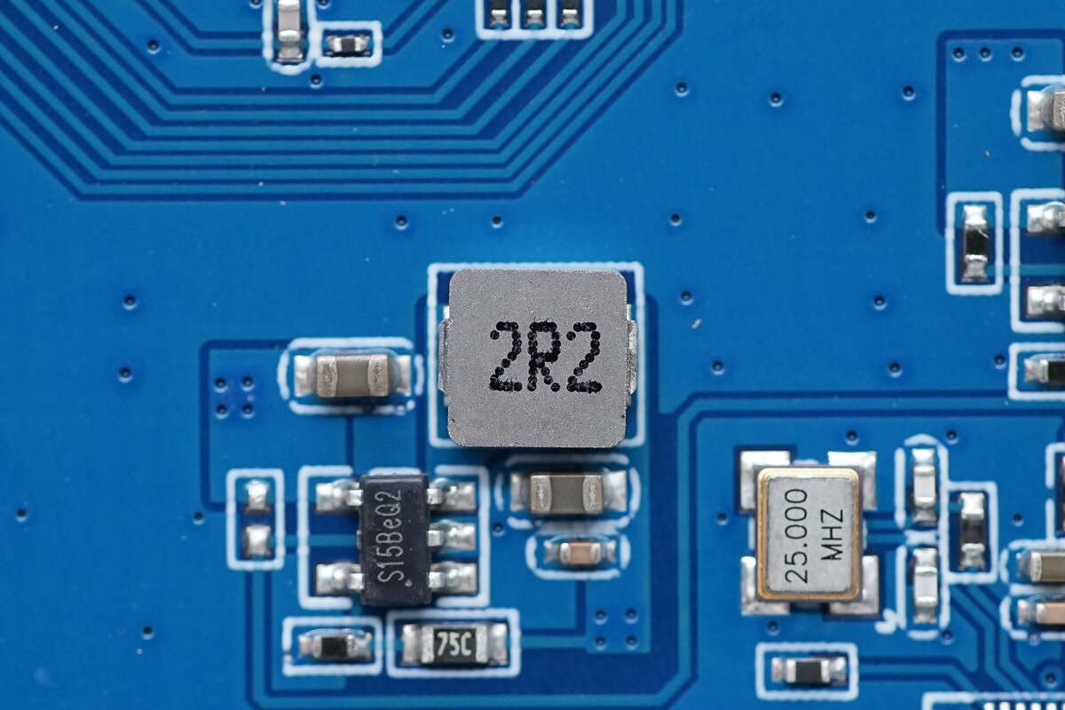

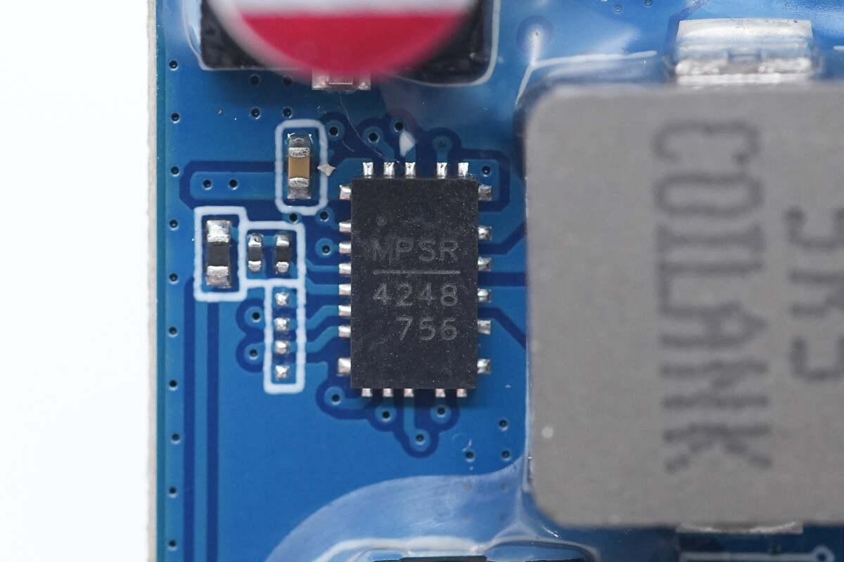

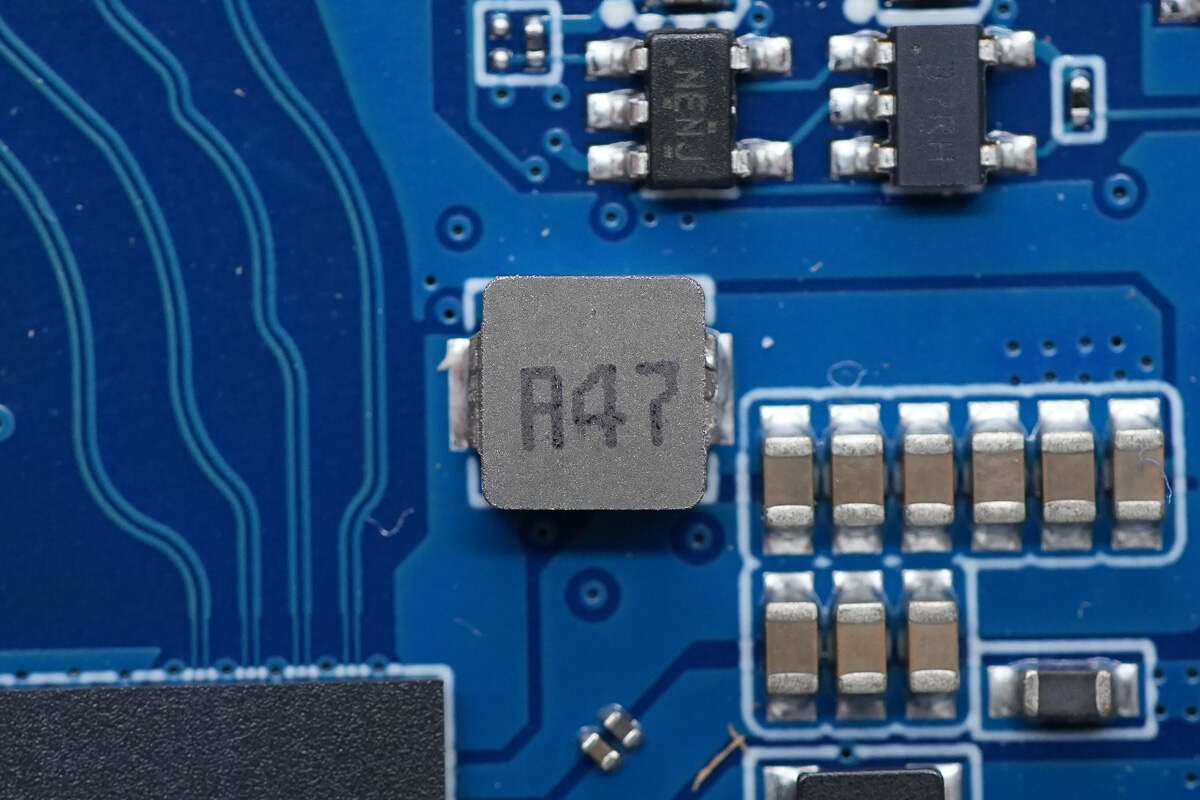

Close-up of the external 0.47μH buck inductor for the Thunderbolt controller.

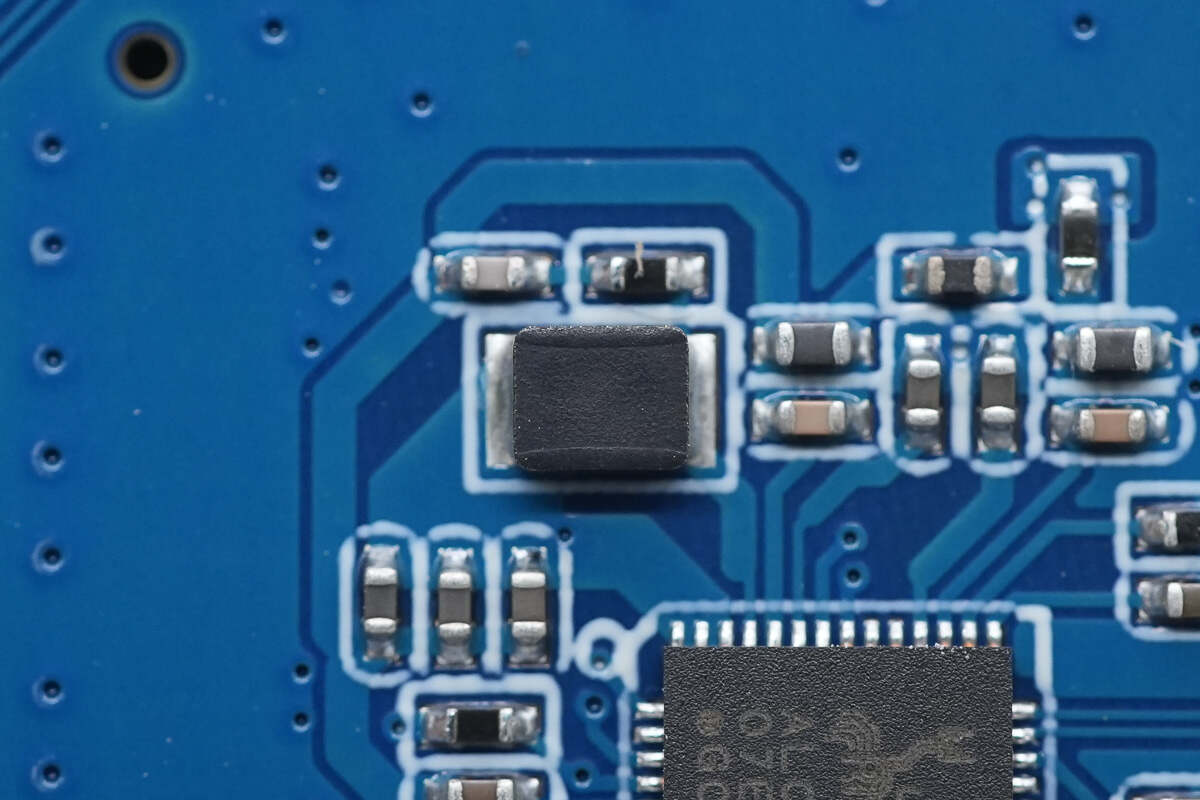

Close-up of the external buck inductors.

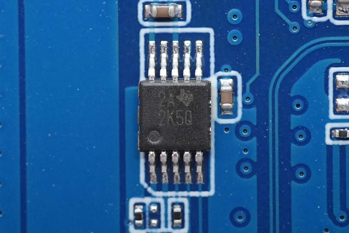

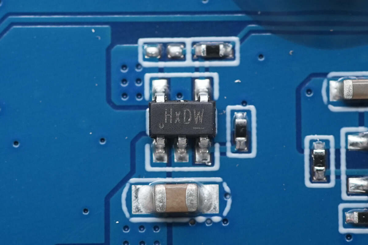

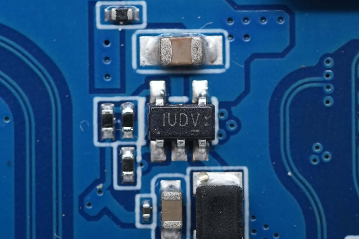

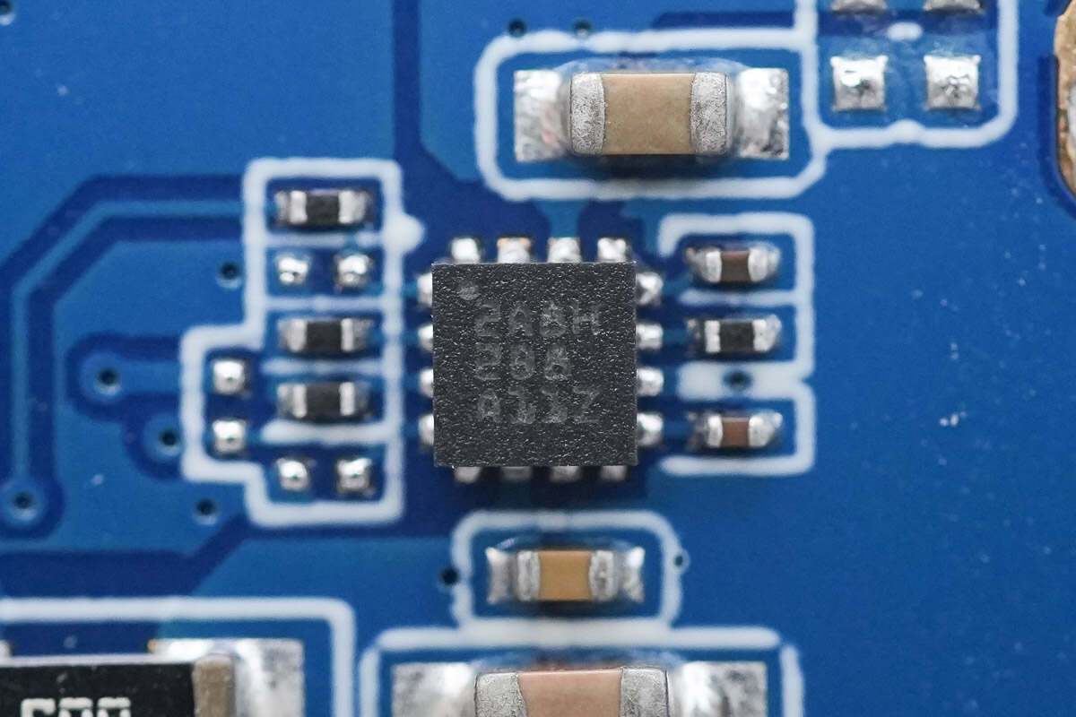

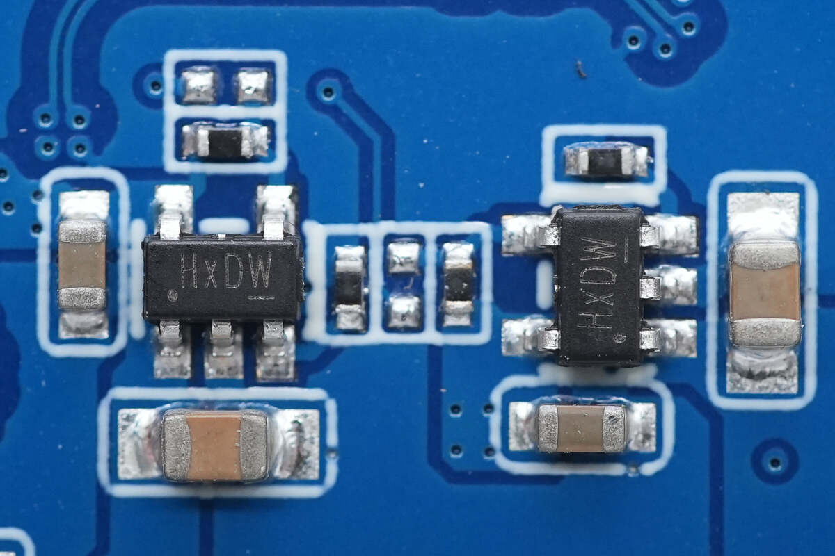

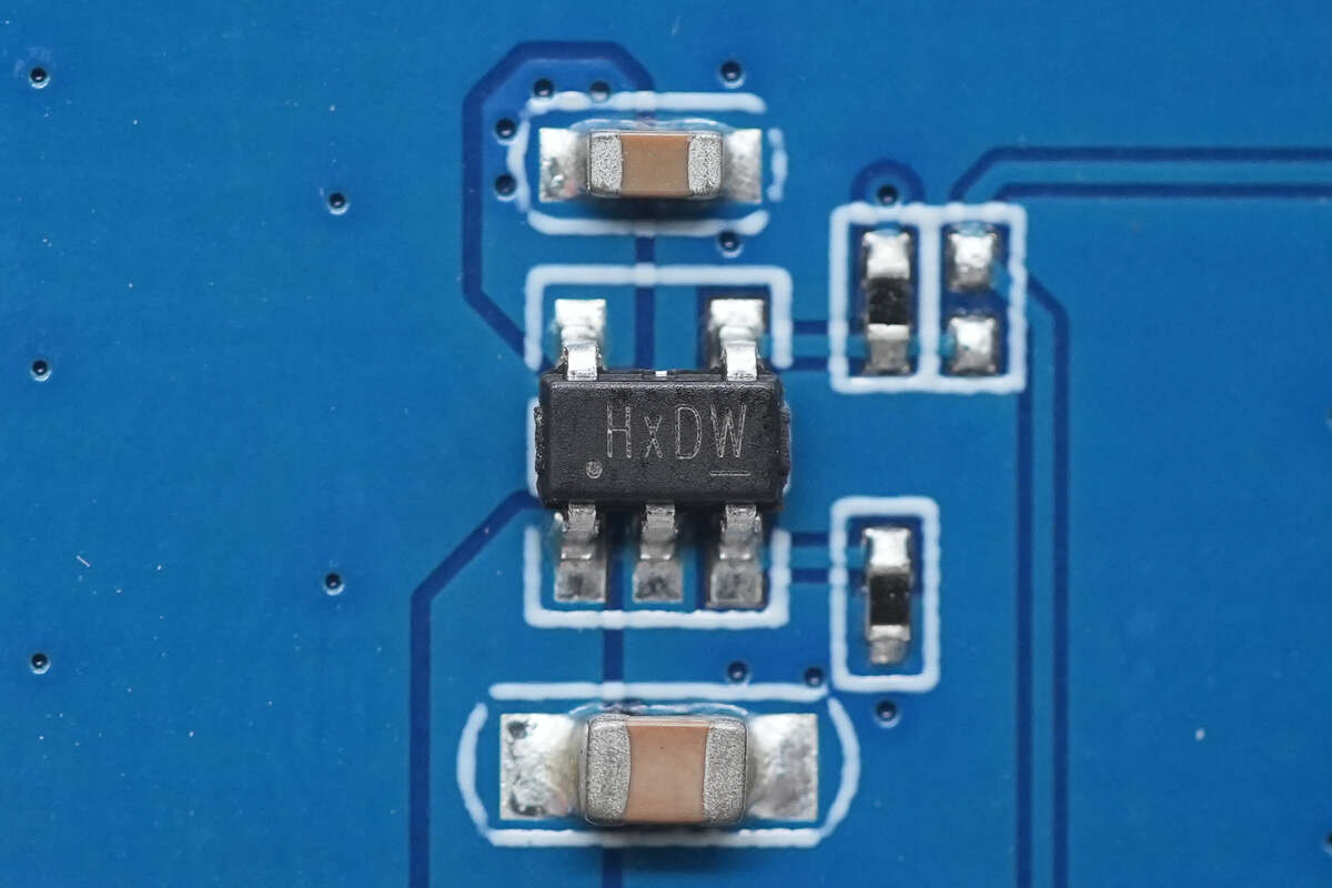

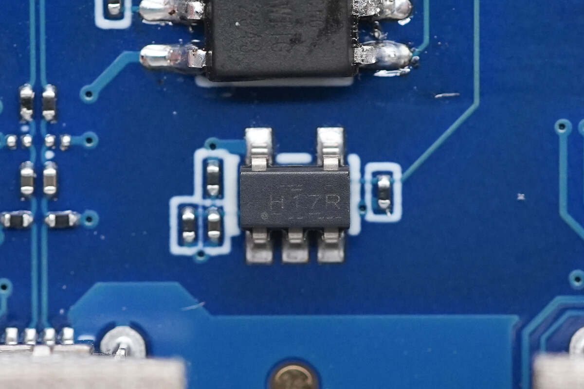

The buffer is from TI, marked with H17R, model SN74AUP1G17. It features a Schmitt-trigger input and comes in an SOT-23 package.

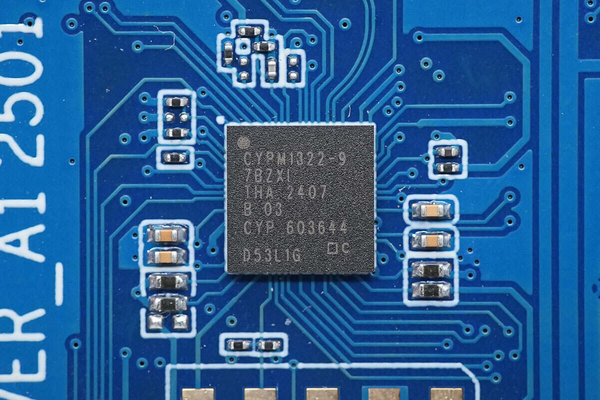

The USB-C controller is from Infineon, model CYPM1322-97BZXI, part of the EZ-PD PMG1-S3 series high-voltage microcontroller chips. It features a built-in ARM Cortex-M0+ MCU, 256KB Flash, and 32KB SRAM. The chip integrates voltage regulators and protection circuits and comes in a 97-BGA package.

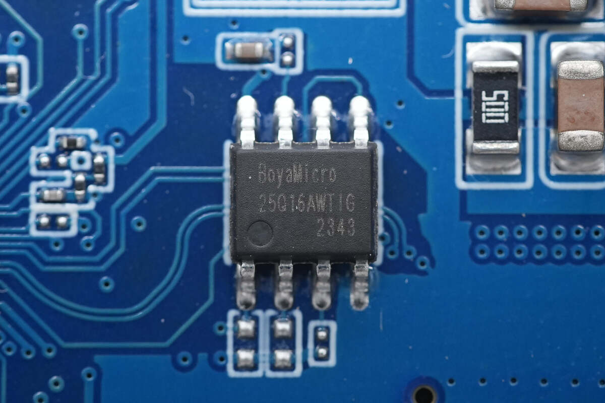

The memory is from BoyaMicro, model BY25Q16AWTIG, with a capacity of 2MB, packaged in SOP8.

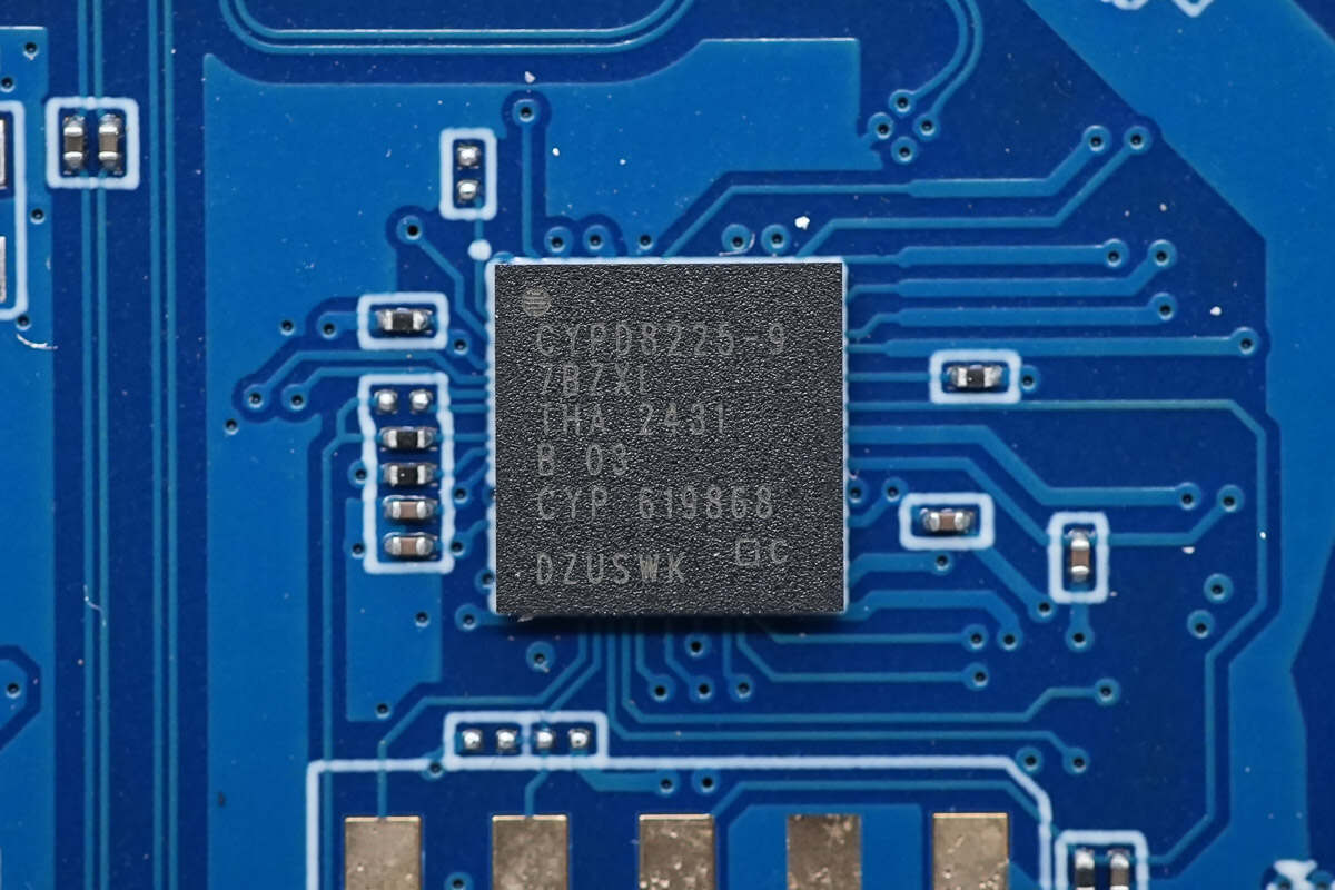

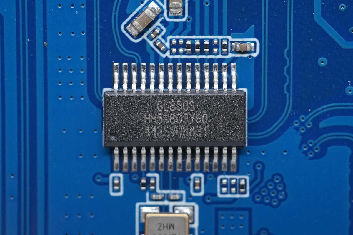

The other USB-C controller is from Infineon’s EZ-PD CCG8 series, model CYPD8225-97BZXI. This chip supports PD3.1 28V EPR applications, features a built-in ARM Cortex-M0+ MCU, 256KB Flash, and 32KB SRAM. It supports dual-port control and comes in a 97-BGA package.

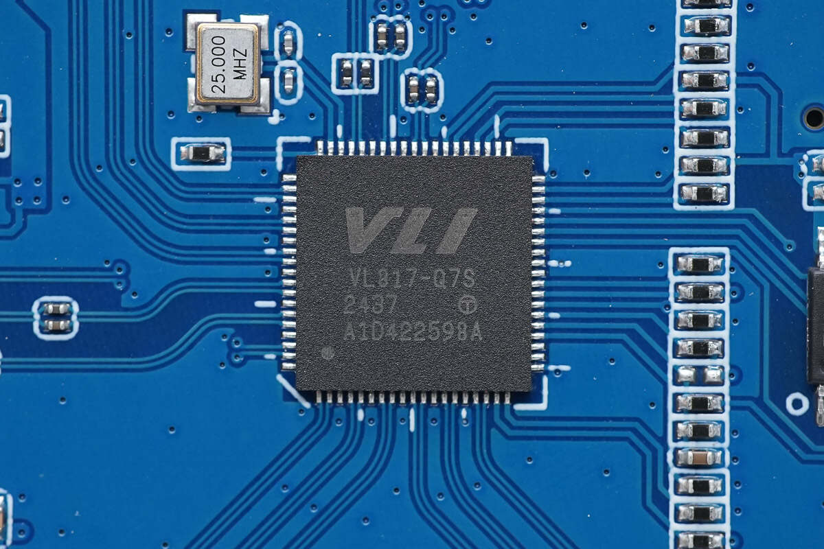

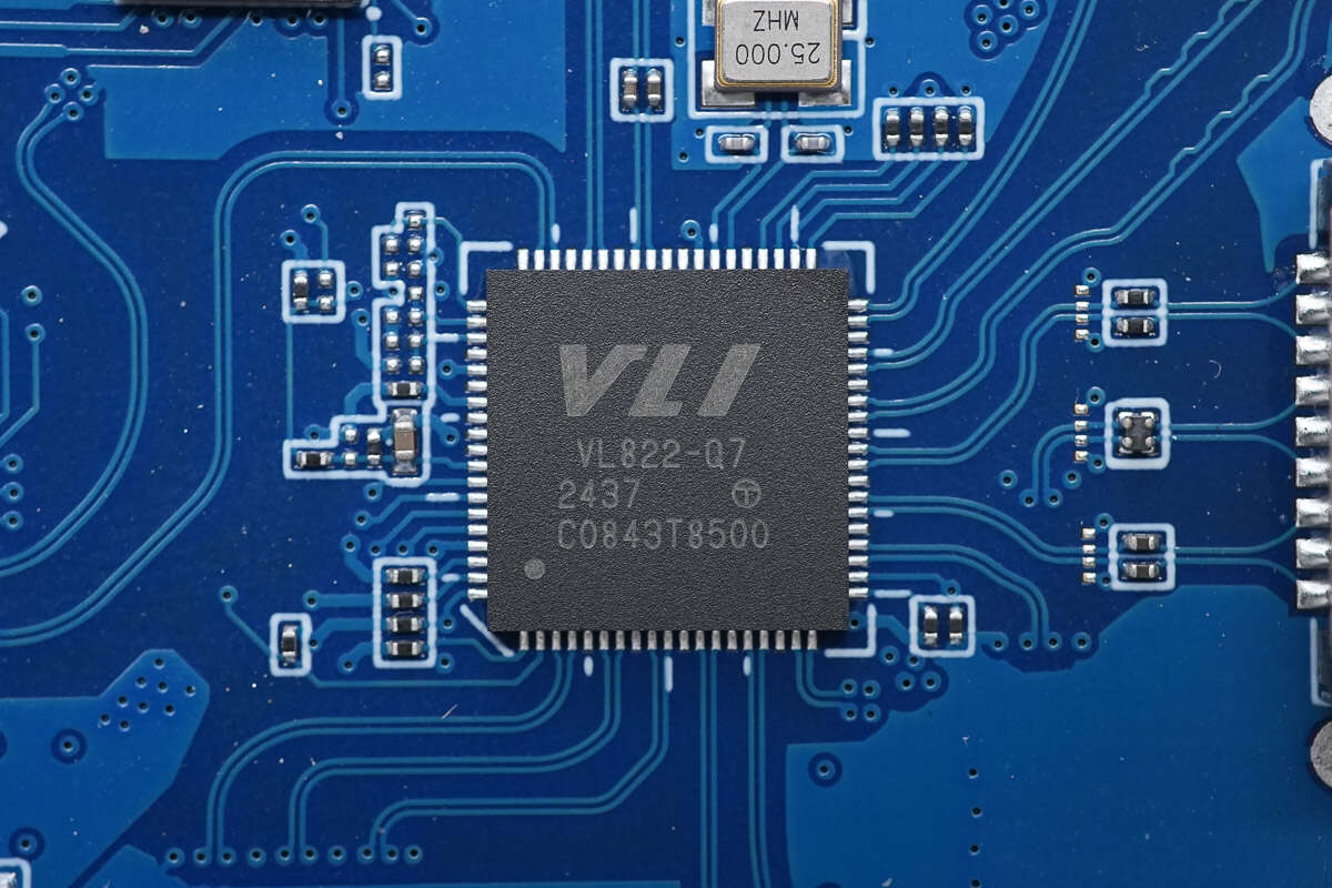

The USB hub chip is from VIA Labs, model VL822-Q7. It integrates an upstream port and two downstream port multiplexers, suitable for expanding four USB-A ports. It supports 10Gbps speeds and comes in a QFN-76 package.

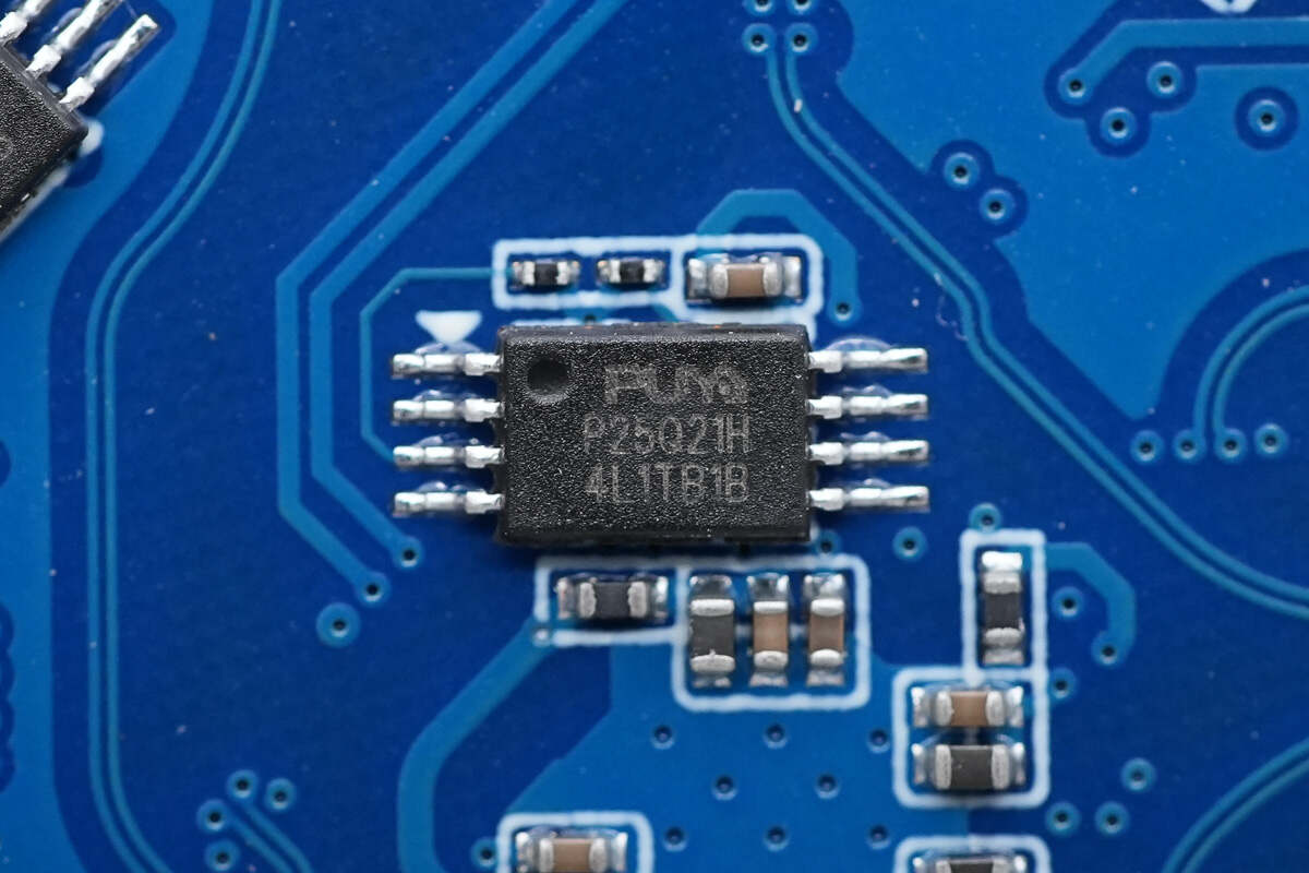

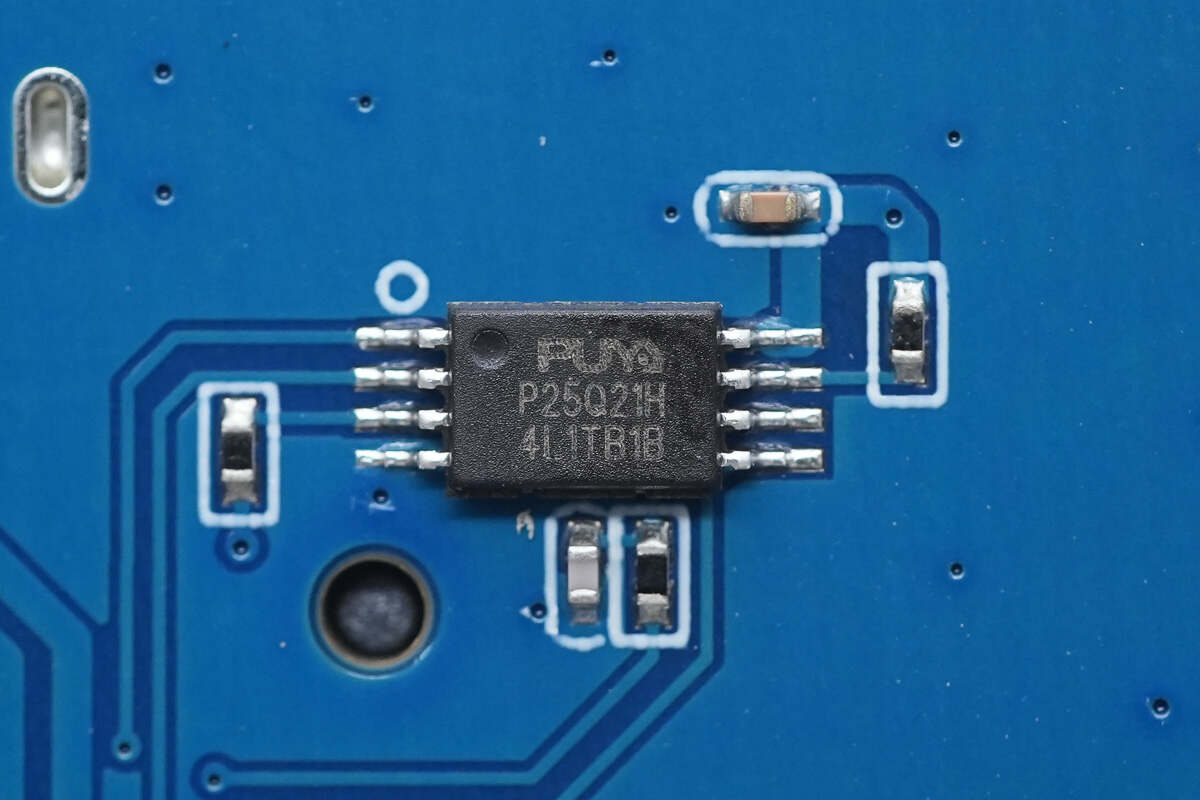

The memory is from Puya, model P25Q21H, with a capacity of 256KB, packaged in TSSOP8.

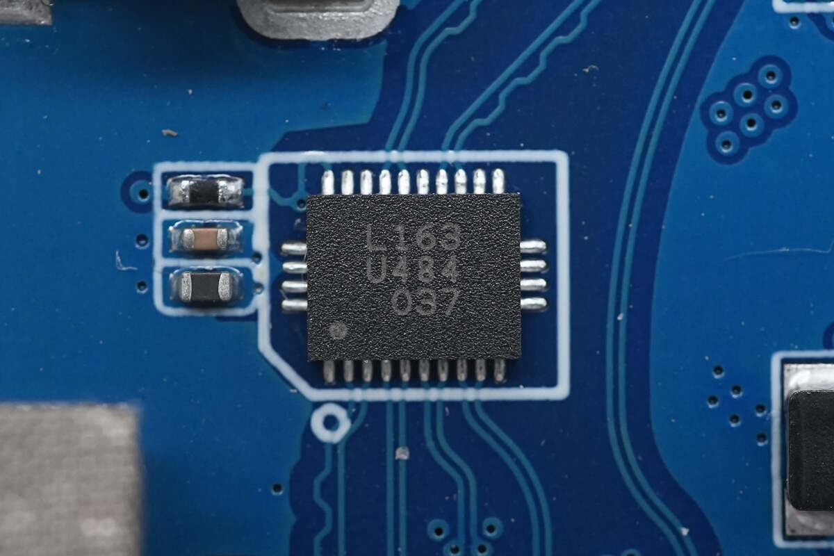

The VIA Labs VL163 port multiplexer is used for switching the front and back of the USB-C interface and comes in a QFN-28 package.

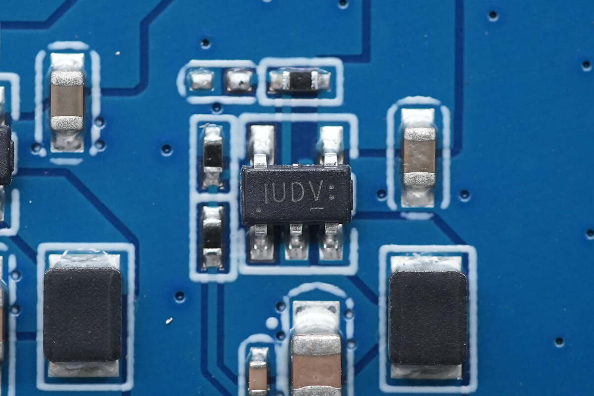

The synchronous buck converter is from ETA, marked with IU, model ETA3485S2F. It supports a 7V input voltage, adjustable output voltage, and an output current of 1.5A, with a switching frequency of 2MHz. Fixed output voltage versions of 1.2V, 2.5V, and 3.3V are also available. It comes in a SOT23-5 package.
Close-up of the connector used to connect two PCBs.

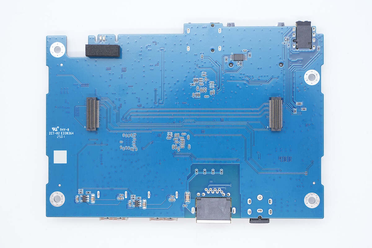

The lower PCB features a power socket, an Ethernet port, and two USB-A ports. The upper side includes a headphone jack, an SD card slot, and a TF card slot. In the middle are a hub chip, an Ethernet controller, and a card reader controller, while the left side houses the audio interface chip.
On the back are connectors, memories, and overcurrent protection chips.

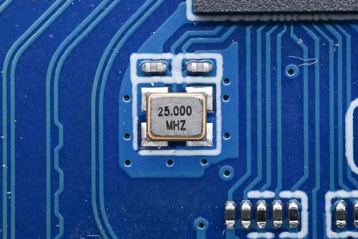

Close-up of the external 25.000 MHz crystal oscillator.

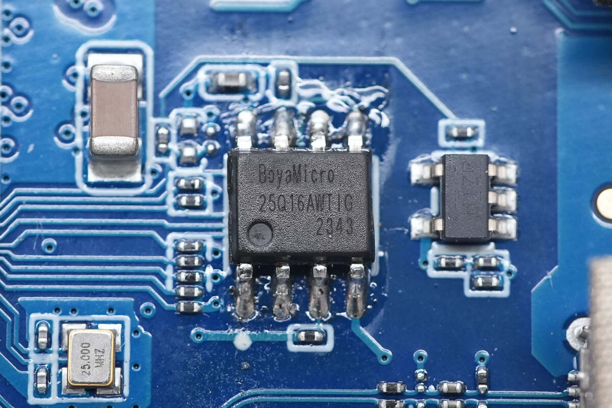

The memory is from BoyaMicro, model BY25Q16BSTIG, with a capacity of 2MB. It comes in an SOP8 package.

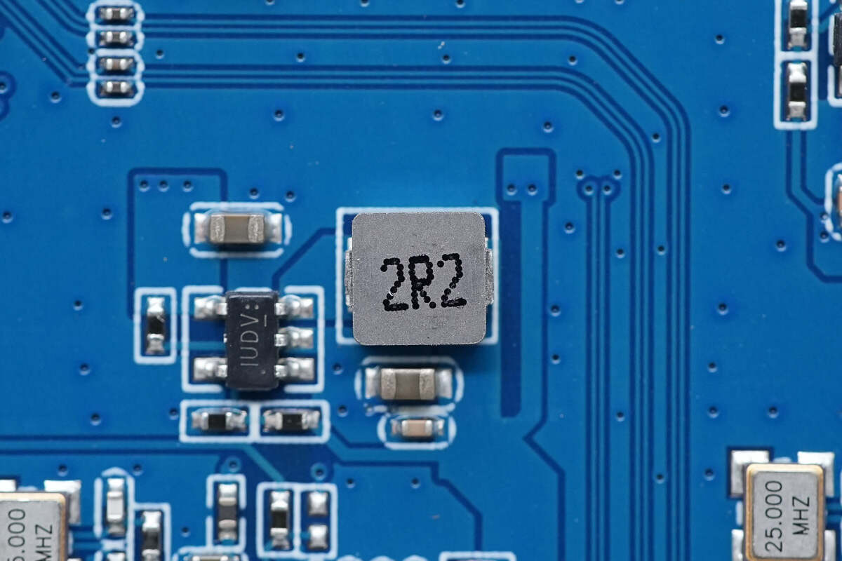

Close-up of 2.2μH alloy inductor.
The SMD LED is used to indicate the dock’s operating status.
