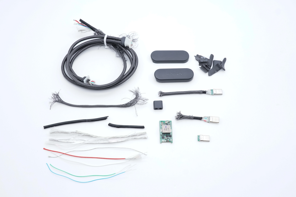

The two wireless charging coils are placed overlapping.
Teardown of Tesla Wireless Phone Charger (WC1)-Chargerlab
There is a thermistor in the center of the coil to detect the temperature.
Well, those are all components of the Tesla Wireless Phone Charger.
Here is the component list of the Tesla Wireless Phone Charger for your convenience.
Tesla's in-car wireless charger is officially produced for the early Model S and Model X that did not support wireless charging. It supports 7.5W output power and is powered by a USB-A port. It can charge one phone and fix the phone through the structural design.
After taking it apart, we found it uses the NXP MWCT1013AVLH master control chip with four DIODES DGD05473 drivers, which are used for synchronous buck-boost MOSFET and wireless charging full-bridge MOSFET driving, respectively. The inside of the shell is shielded by metallization, the shrapnel is welded on the PCB for contact and grounding, and automotive-grade components are used. The solution and materials are solid and reliable.
