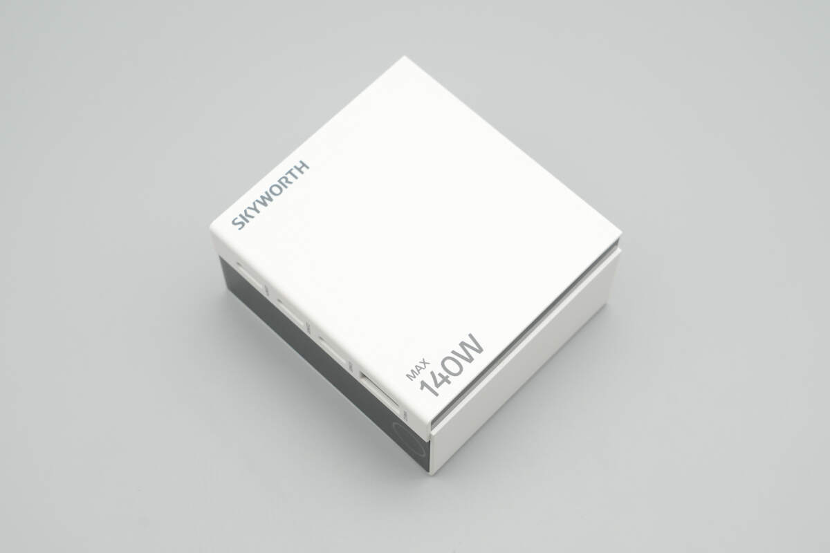

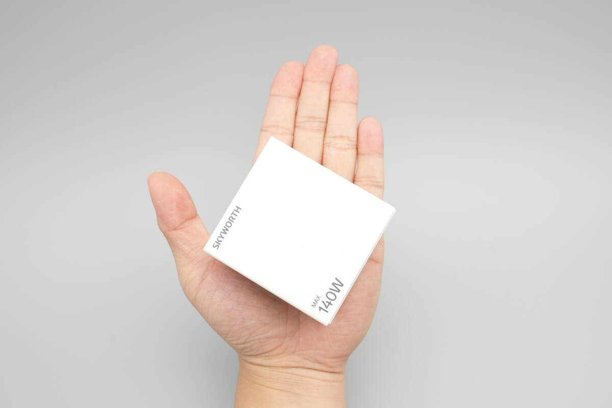

The shell is made of flame-retardant PC material and features a simple yet stylish black-and-white color scheme.
Teardown of Skyworth 140W SiC Charger with Smart Display (C-140W)-Chargerlab
The front is printed with SKYWORTH and 140W MAX.

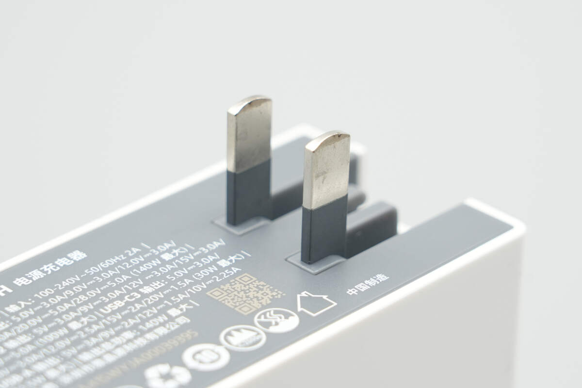

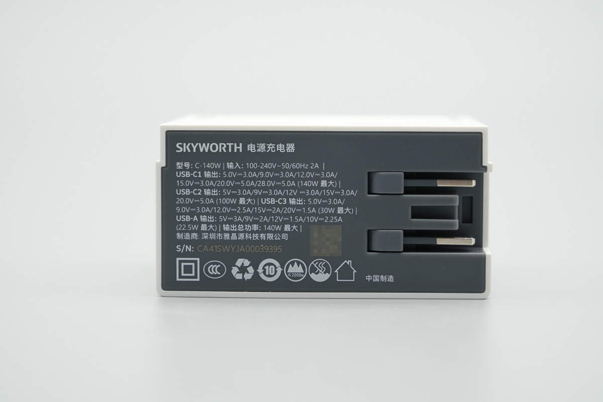

The input end is printed with parameter information.
Model: C-140W
Input: 100-240V~50/60Hz 2A
Output:
USB-C1: 5V3A, 9V3A, 12V3A, 15V3A, 20V5A, 28V5A (Max 140W)
USB-C2: 5V3A, 9V3A, 12V3A, 15V3A, 20V5A (Max 100W)
USB-C3: 5V3A, 9V3A, 12V2.5A, 15V2A, 20V1.5A (Max 30W)
USB-A: 5V3A, 9V2A, 12V1.5A, 10V2.25A (Max 22.5W)
Total Output Power: Max 140W

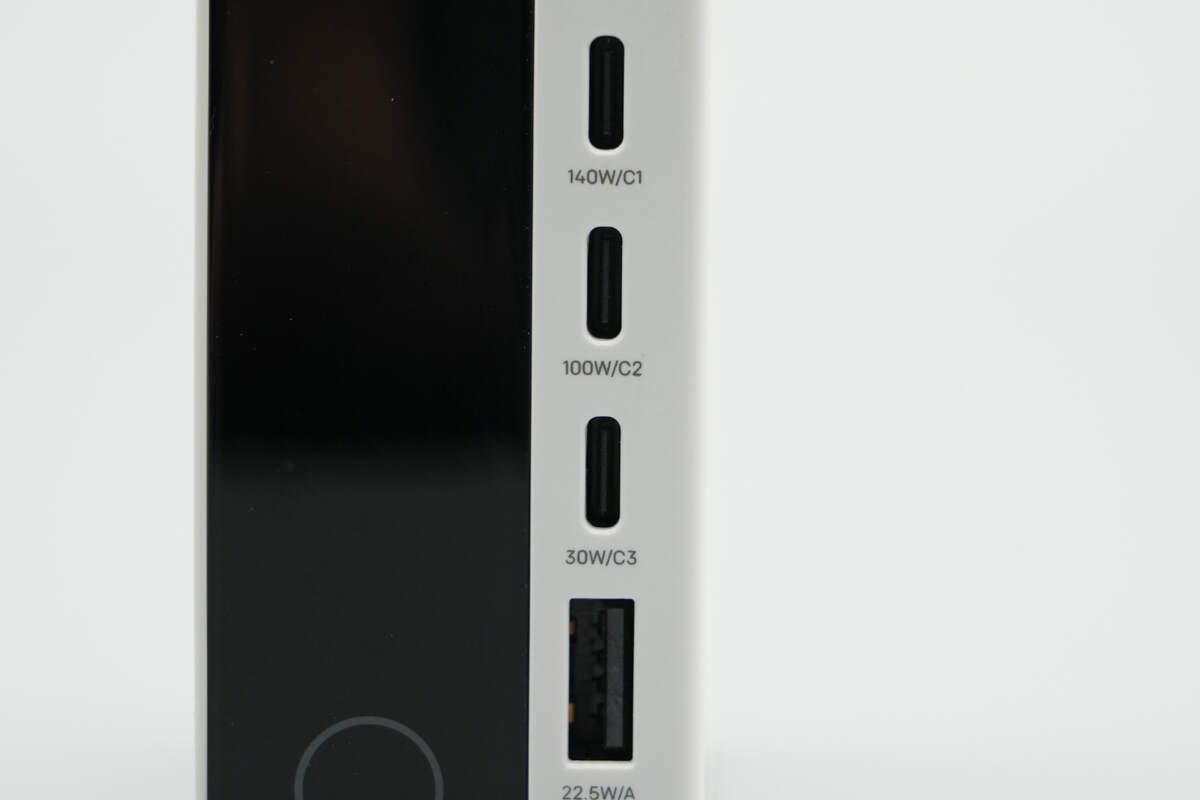

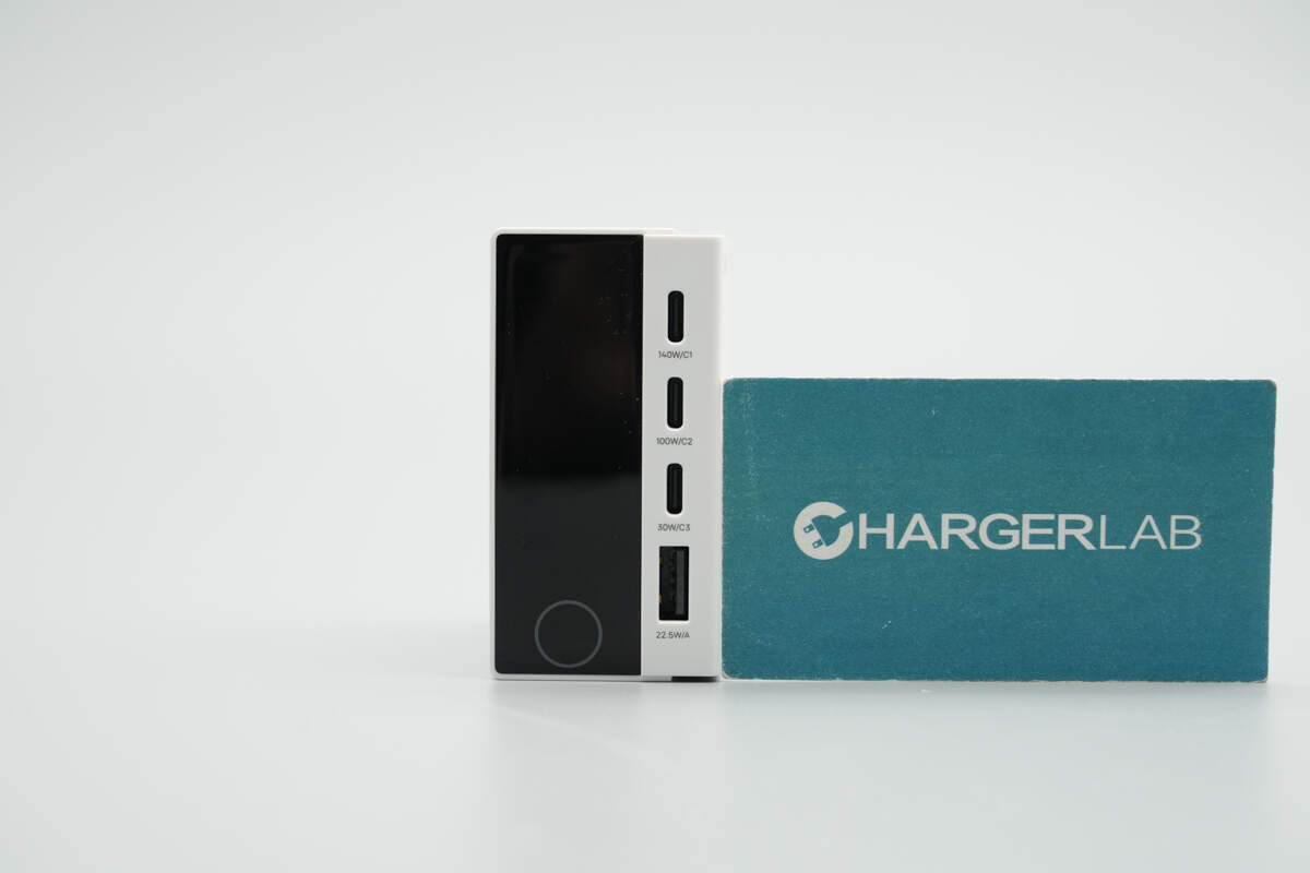

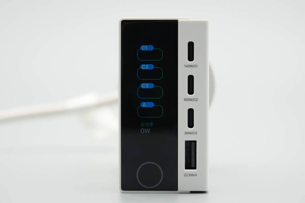

The left side features a TFT color display, while the right side is equipped with 3 USB-C ports and 1 USB-A port.
Each of the four ports is marked with its label and maximum output power.

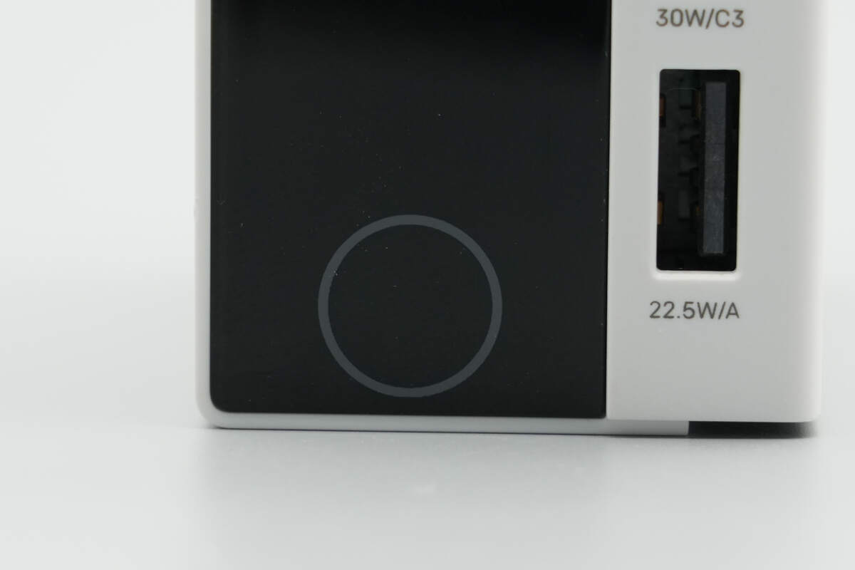

A touch control button is located below the screen, making operation simpler.

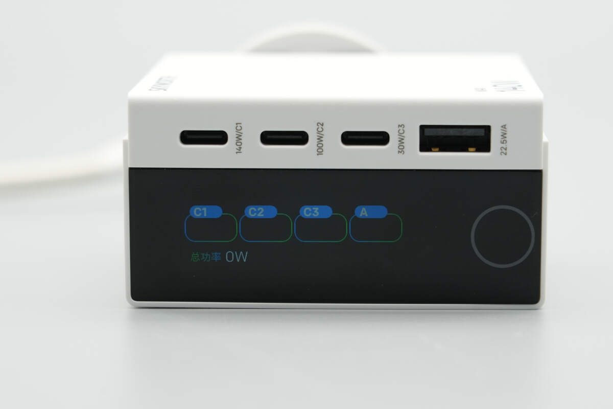

Close-up of the startup screen.
In the no-load state, the screen displays an output of 0W.

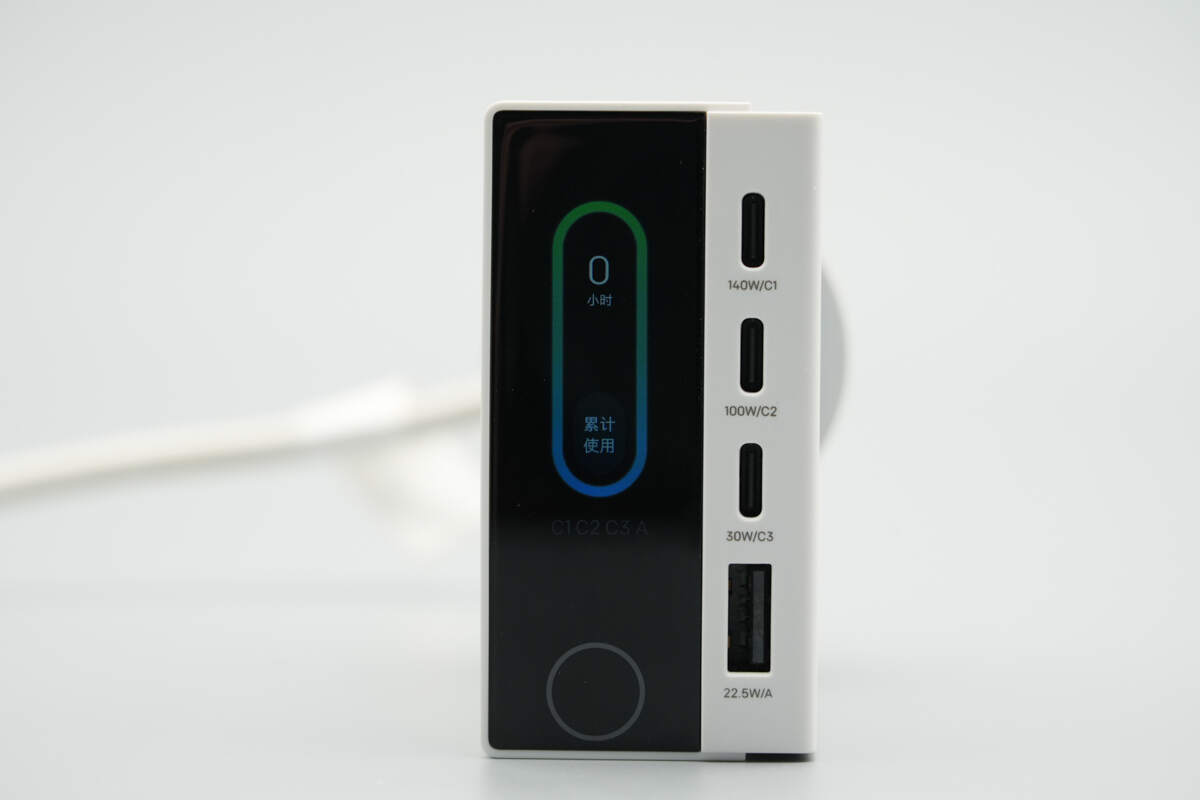

A single tap on the touch control button switches the interface. The power interface displays the usage status and output power of each port, and the total power.
A long press of the touch control button for 5 seconds allows the screen to switch between landscape and portrait modes.
Close-up of the temperature interface.
Close-up of the accumulated time interface.

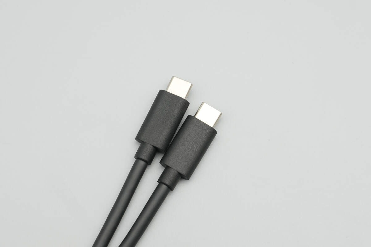

The included cable is of the USB-C to USB-C type.
The length of the cable is about 152 cm (59.84 inches).
ChargerLAB POWER-Z KM003C shows it has an E-Marker chip. Its power transmission capability is 50V 5A, and its data transmission capability is USB 2.0.

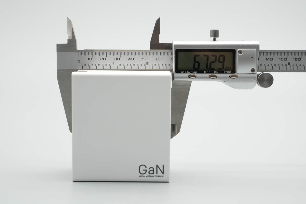

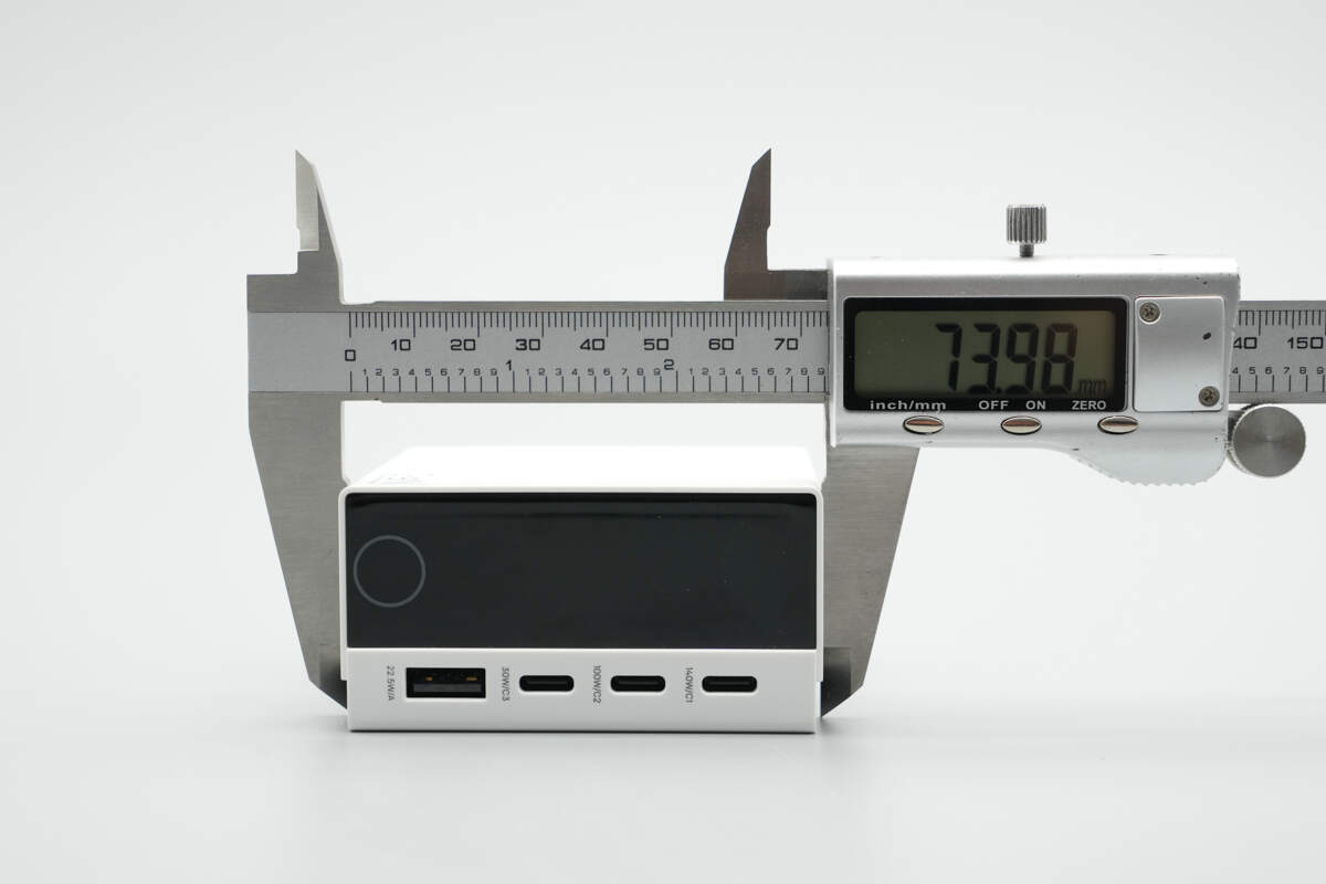

The length of the charger is about 67.29 mm (2.65 inches).
The width is about 73.98 mm (2.91 inches).

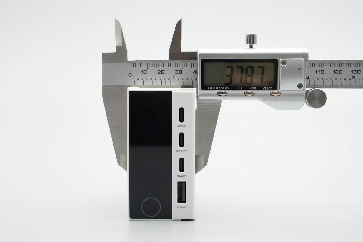

The thickness is about 37.87 mm (1.49 inches).

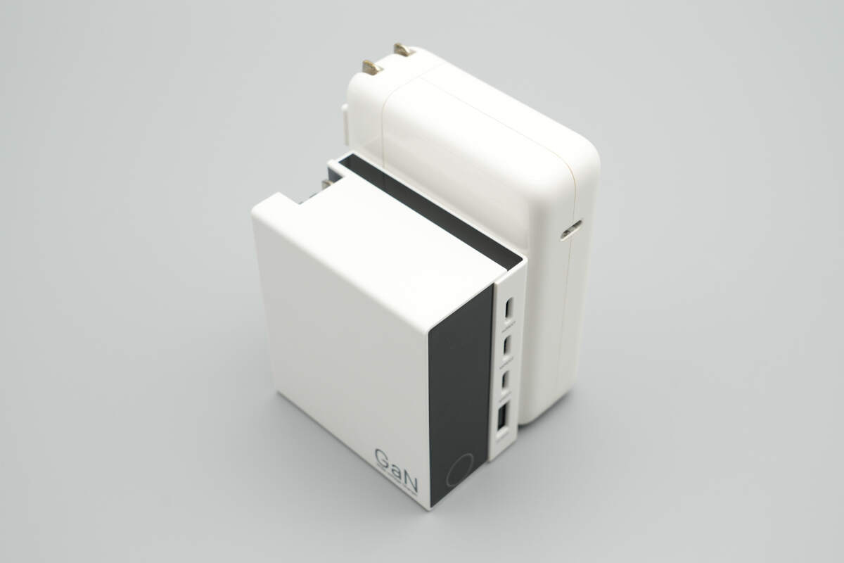

An overview comparing it with the Apple 140W GaN charger.

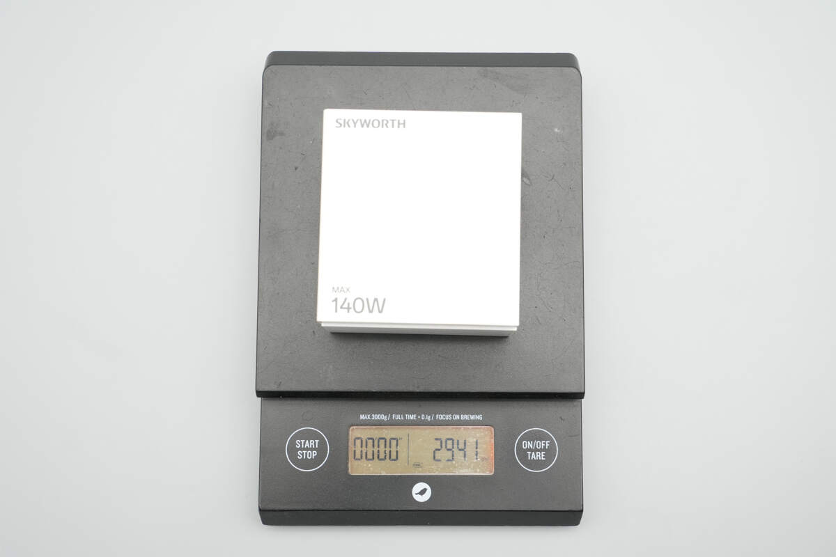

The weight is about 294 g (10.37 oz).

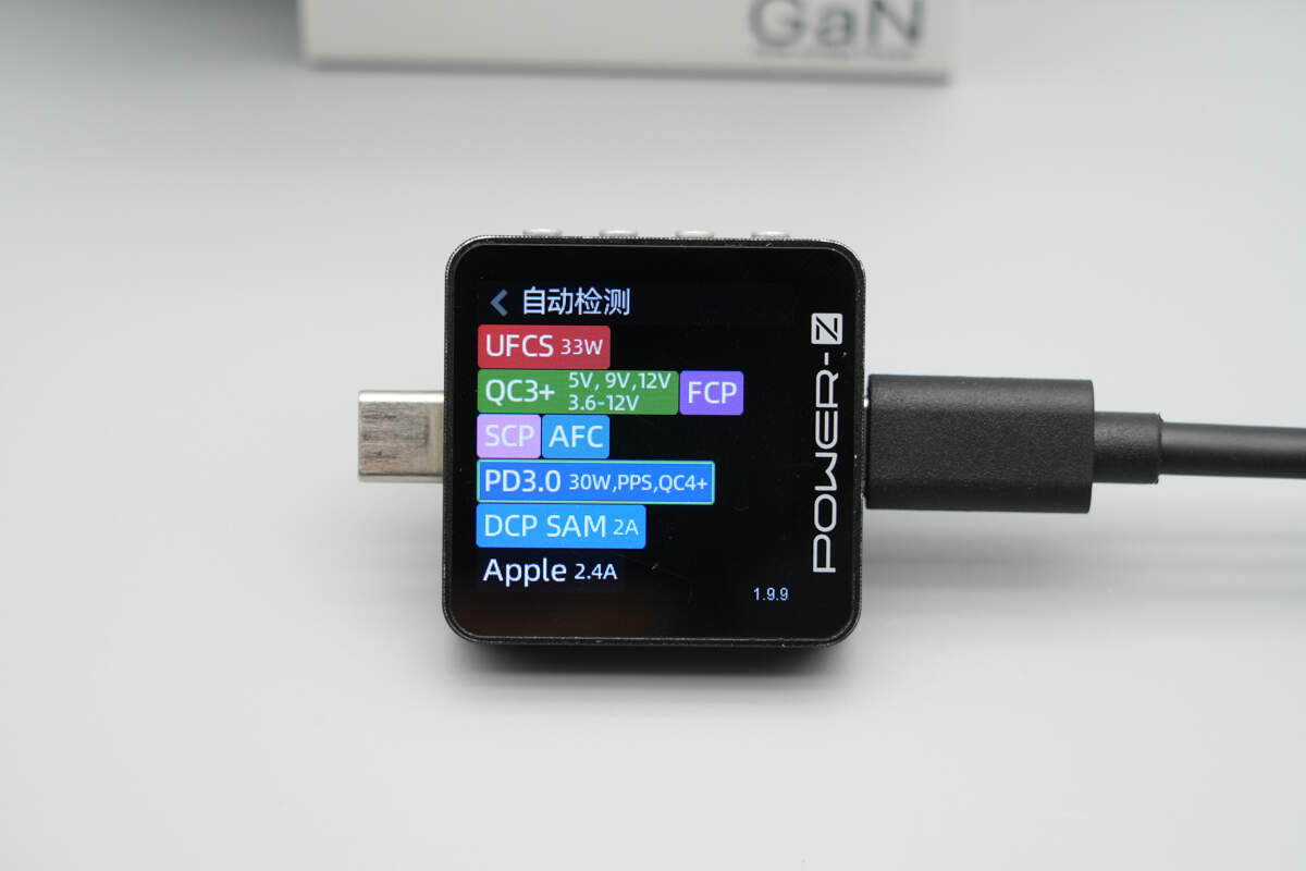

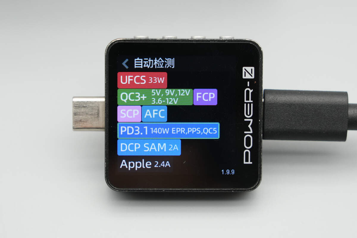

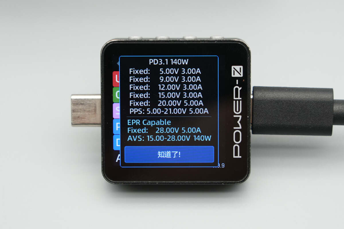

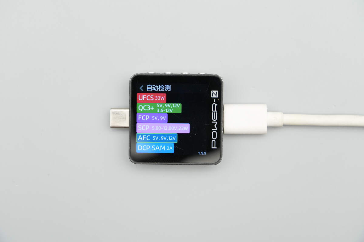

ChargerLAB POWER-Z KM003C shows that the USB-C1 supports UFCS, QC3+/5, FCP, SCP, AFC, PD3.1, PPS, DCP, SAM 2A, and Apple 2.4A charging protocols.
It has six fixed PDOs of 5V3A, 9V3A, 12V3A, 15V3A, 20V5A, and 28V5A, as well as one PPS voltage level of 5-21V5A and a 15-28V 140W AVS voltage level.

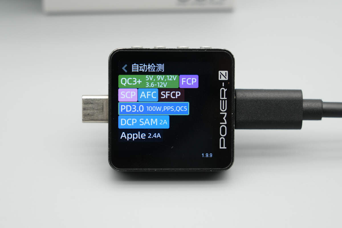

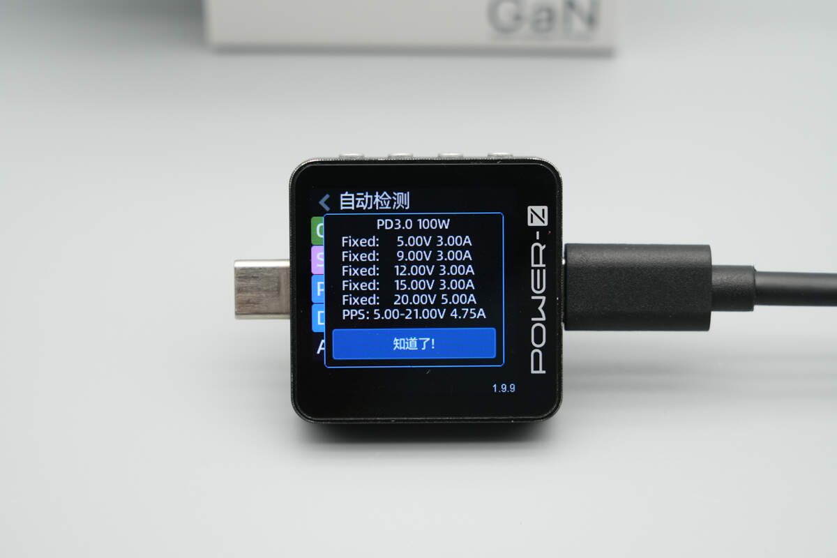

The USB-C2 supports QC3+/5, FCP, SCP, AFC, SFCP, PD3.0, PPS, DCP, SAM 2A, and Apple 2.4A protocols.
It has five fixed PDOs of 5V3A, 9V3A, 12V3A, 15V3A, and 20V5A. It also has one set of PPS, which is 5-21V4.75A.

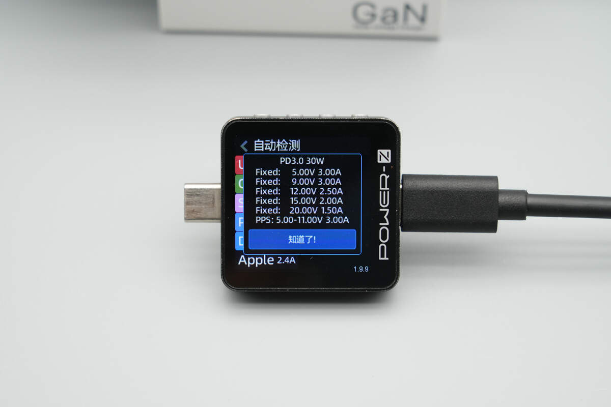

The USB-C3 supports UFCS, QC3+/4+, FCP, SCP, AFC, PD3.0, PPS, DCP, SAM 2A, and Apple 2.4A protocols.
It has five fixed PDOs of 5V3A, 9V3A, 12V2.5A, 15V2A, and 20V1.5A. It also has one set of PPS, which is 5-11V3A.

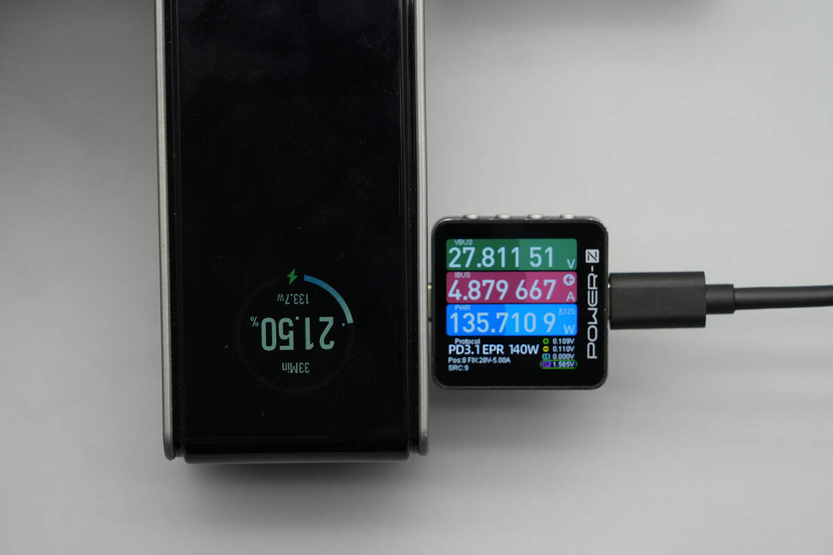

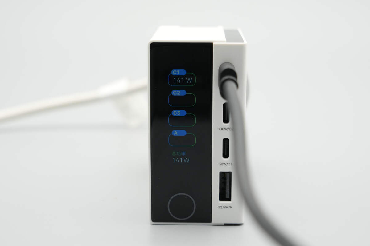

Using this charger to charge the EcoFlow 170W 25000mAh power bank, it successfully initiates 140W PD3.1 fast charging, with a charging power of about 135.71W.
At this point, the power interface shows that the USB-C1 port is in use, with an output power of 141W.

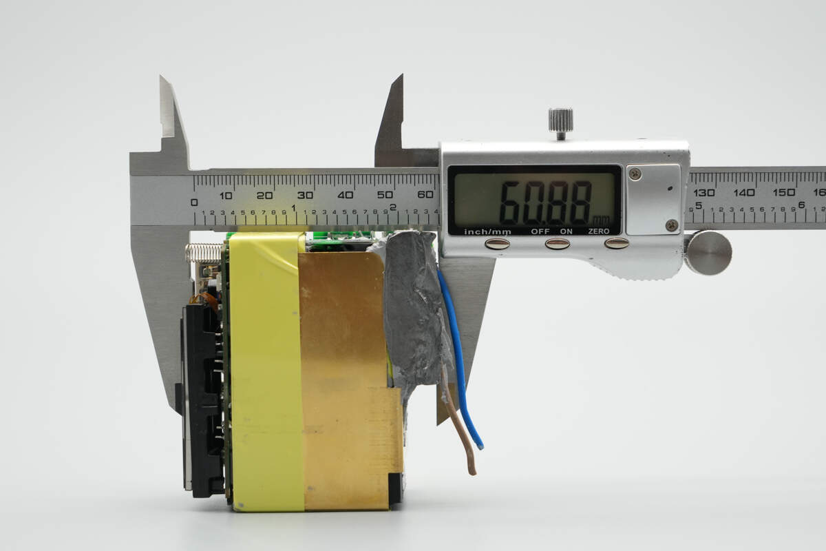

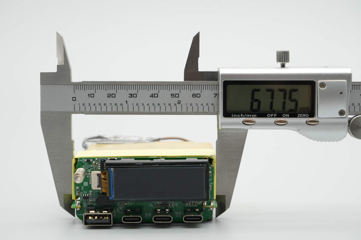

The length of the PCBA module is about 60.88 mm (2.4 inches).
The width is about 67.75 mm (2.67 inches).
The thickness is about 31.67 mm (1.25 inches).

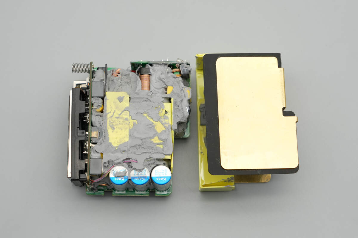

Remove the heatsink. The gaps between the components are filled with thermal adhesive to assist with heat dissipation.

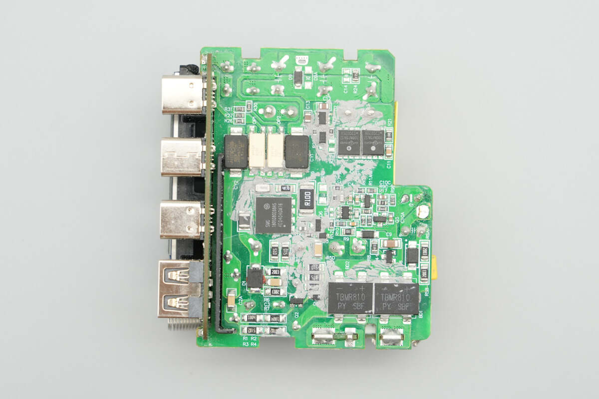

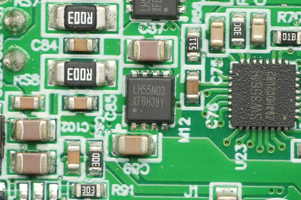

Remove the thermal adhesive. The front of the module has a compact component layout, with small PCBs on one side and the output end. A plastic plate is also used for isolation and insulation between the primary and secondary sides.
The back of the module features bridge rectifiers, the master control chip, primary MOSFETs, optocouplers, SMD Y capacitors, a synchronous rectifier controller, and synchronous rectifiers.

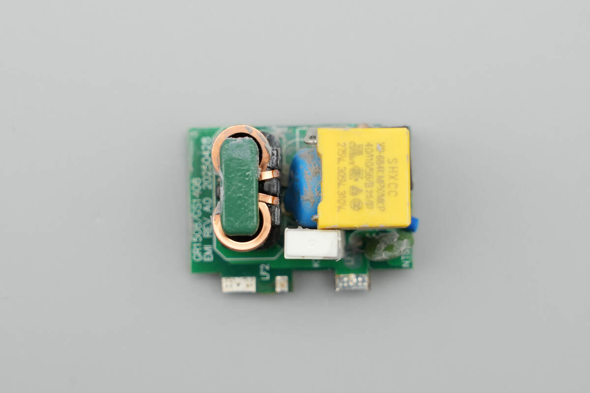

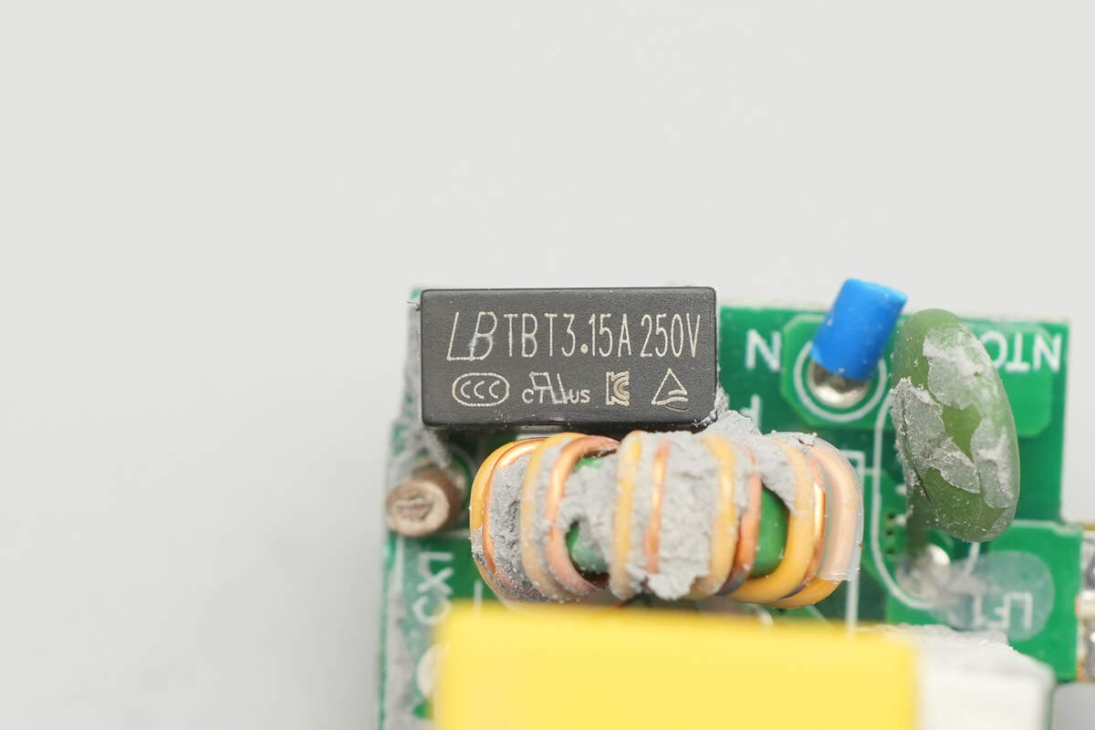

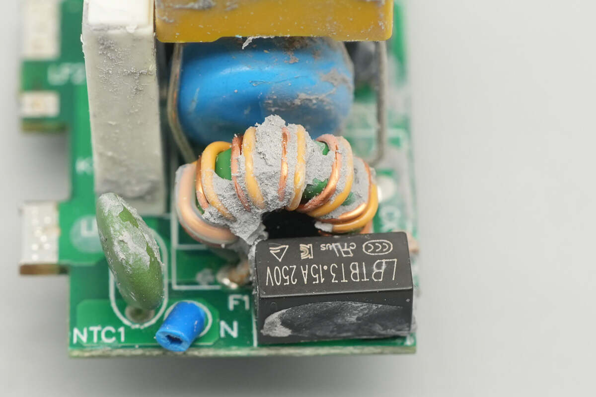

Remove the small PCB at the input end. The front of the PCB is equipped with a time-delay fuse, NTC thermistor, thermal protector, common mode chokes, safety X2 capacitor, and a varistor.
The time-delay fuse is from Lanbao, with a specification of 3.15A 250V.

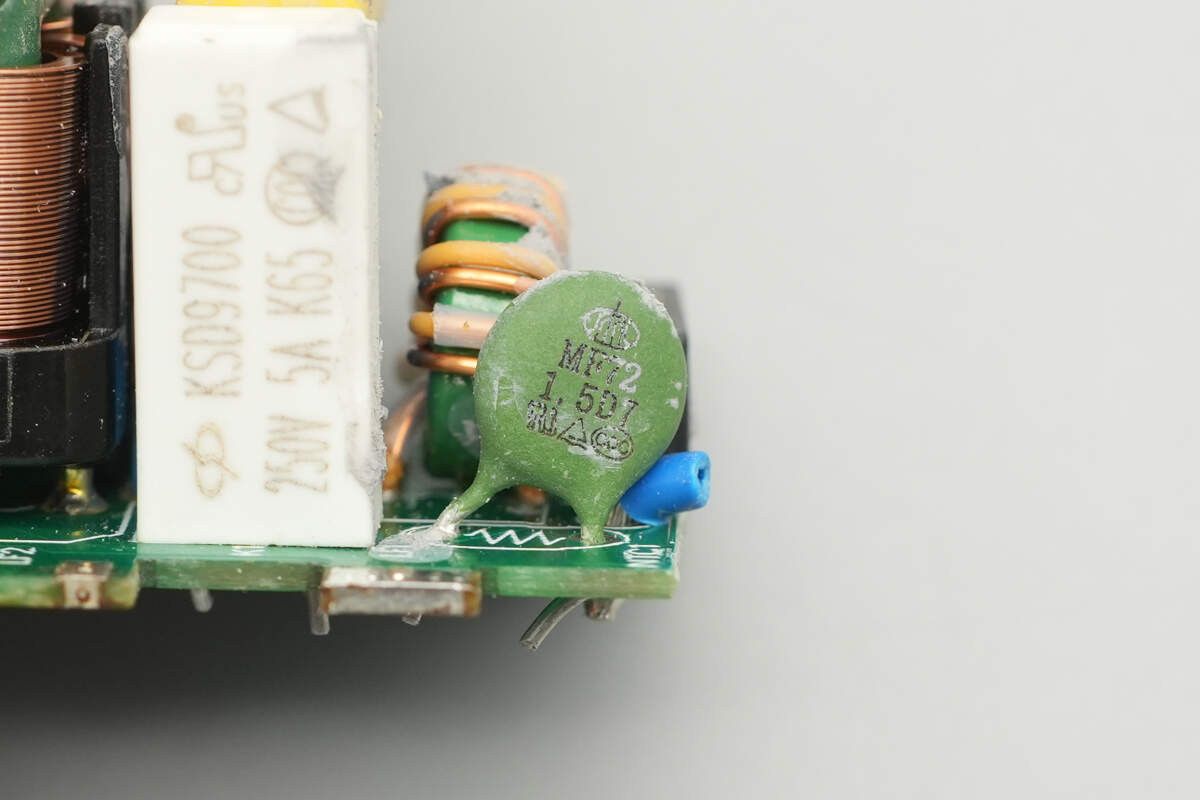

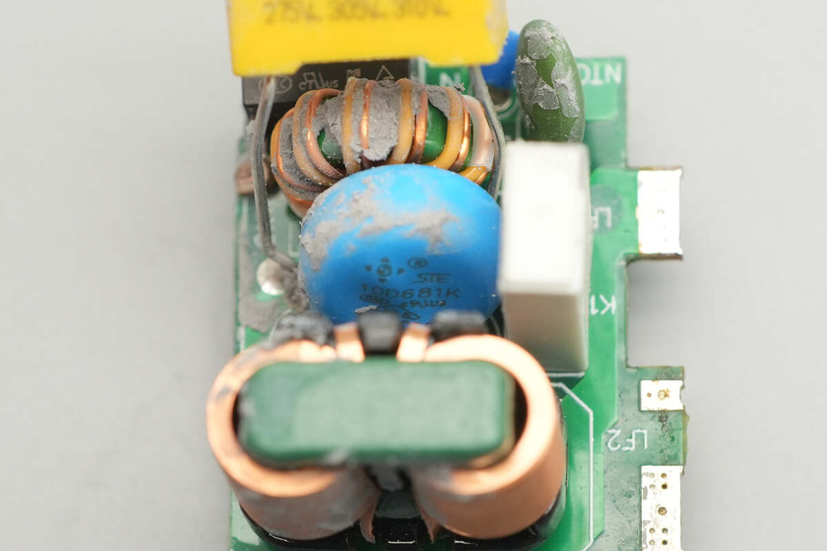

The NTC thermistor is from shiheng, part of the MF72 series, and is used to suppress inrush current during power-on.
The KSD9700 thermal protector has a triggering temperature of 85°C and is used for internal overheat protection.
The common mode choke is a dual-wire wound type, used to filter out EMI interference.
The safety X2 capacitor is from SHXCC, with a specification of 0.68μF.

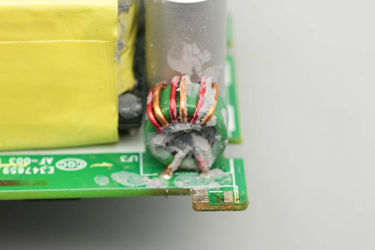

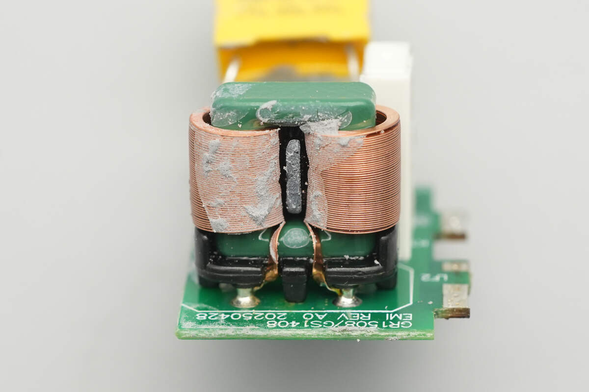

The secondary common mode choke is wound with flat copper tape.
The 10D681K varistor is also from STE and is used for input over-voltage protection.

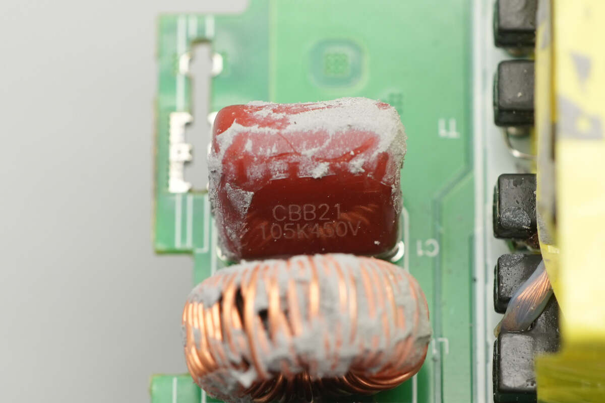

The CBB21 film capacitor has a specification of 1μF 450V.
The other film capacitor has the same part number.

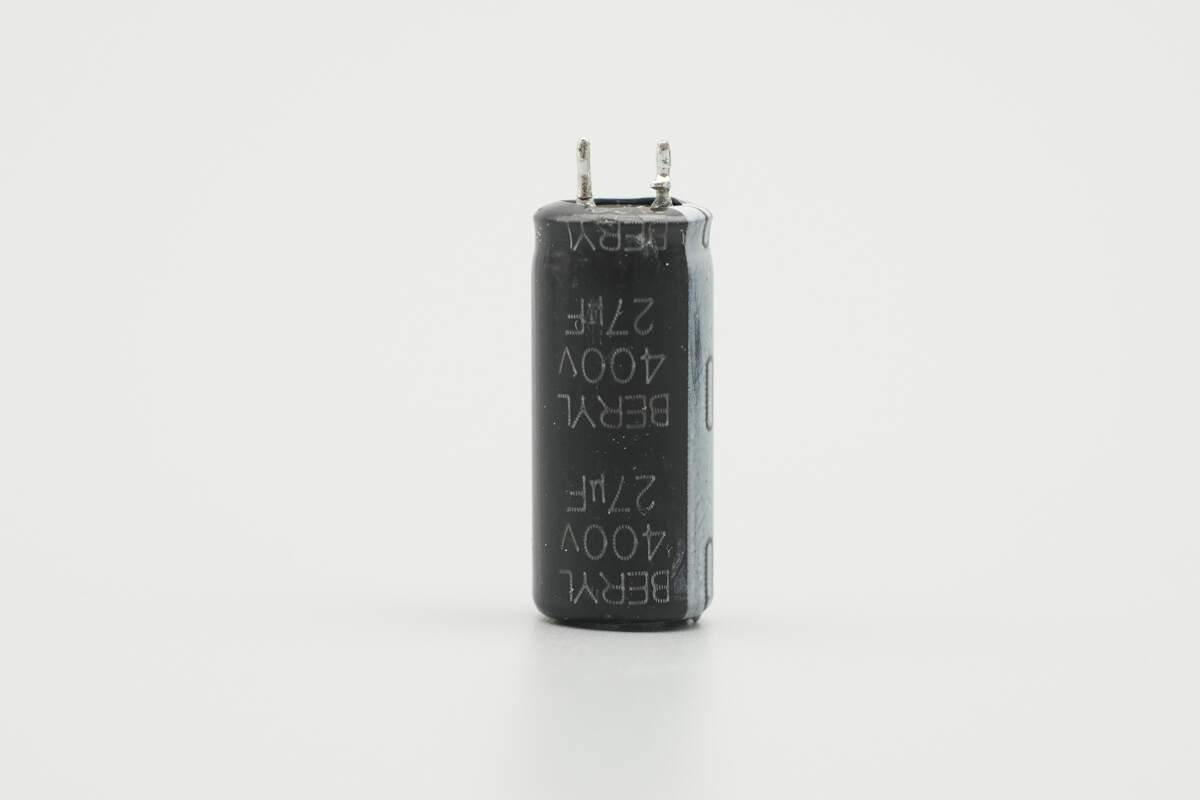

The high-voltage filtering electrolytic capacitor is from BERYL, with a specification of 400V 27μF.

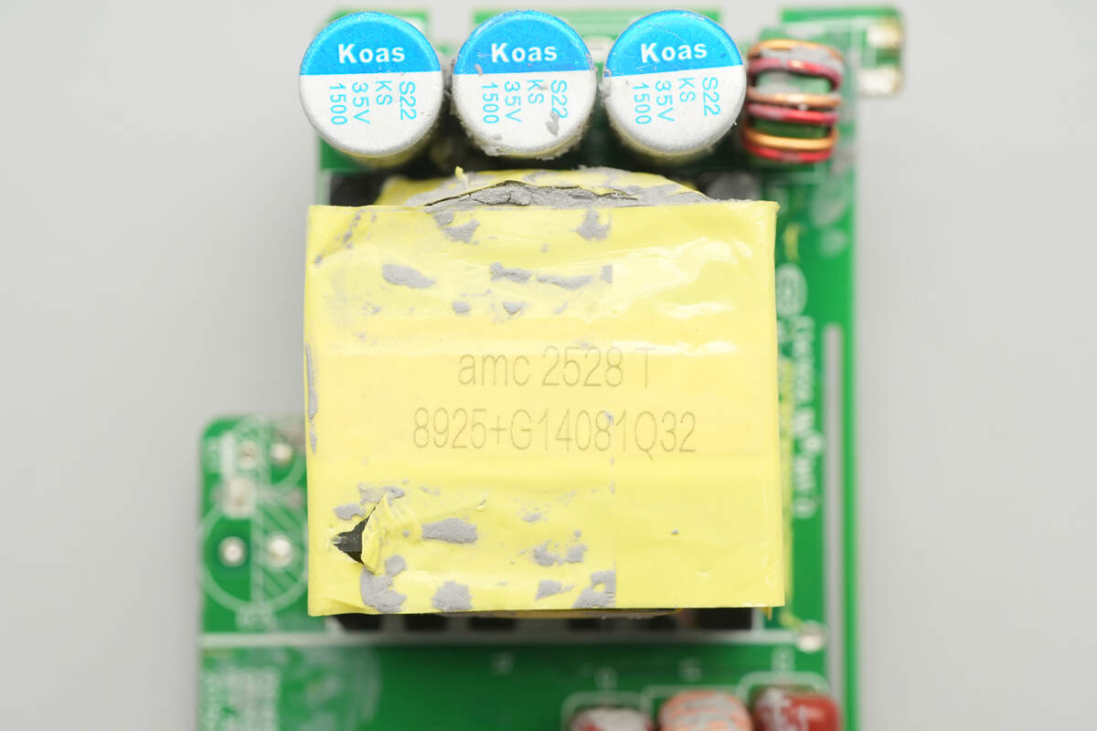

Close-up of the transformer.

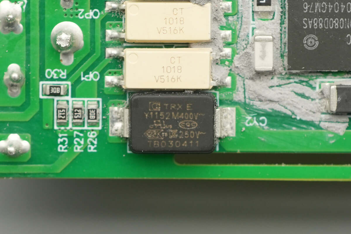

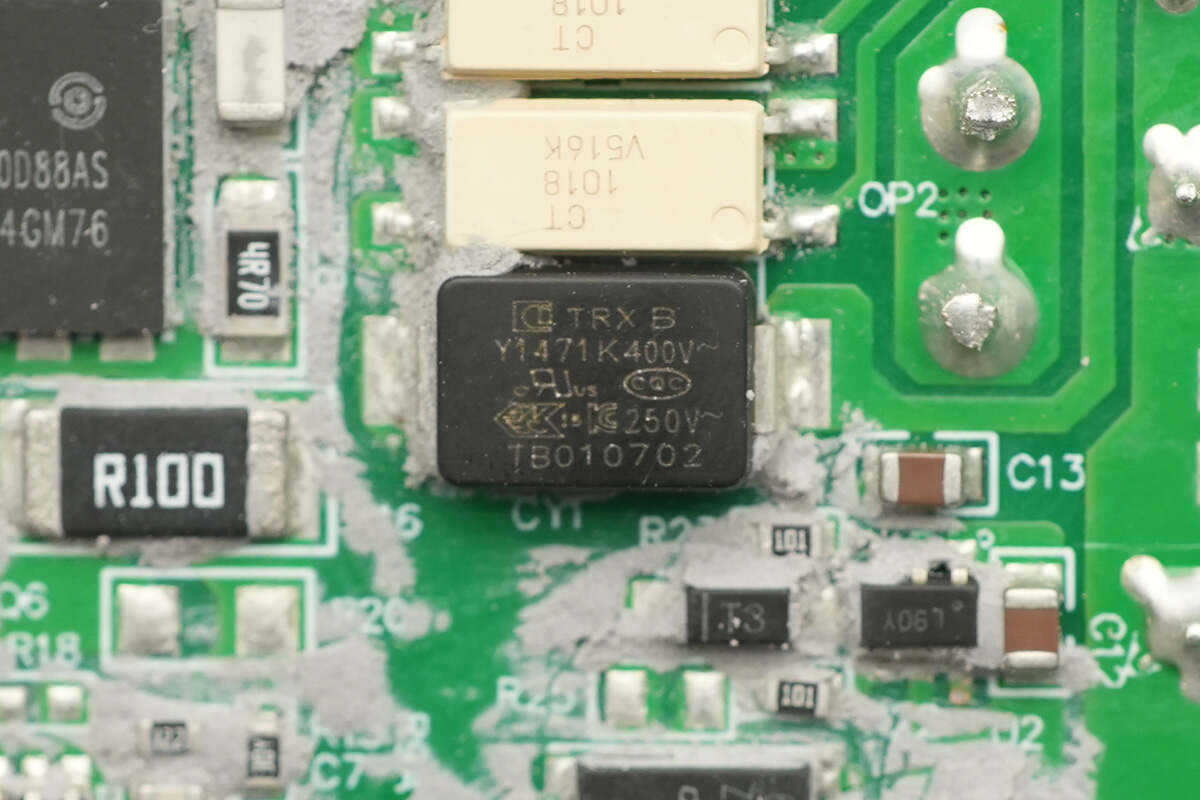

Close-up of two CT 1018 optocouplers.

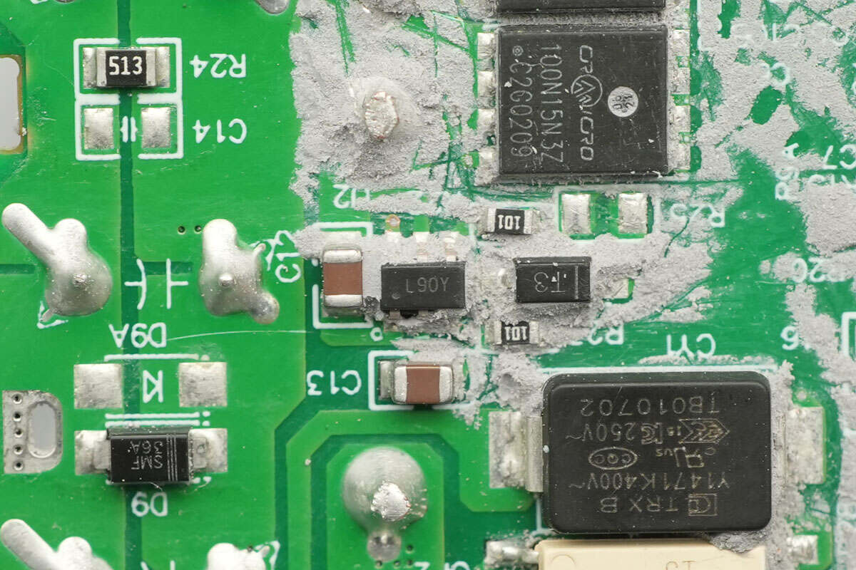

The SMD Y capacitor is from TRX, with the part number TMY1471K. Its compact size and lightweight design make it ideal for high-density power products, such as GaN fast chargers.
The other TRX SMD Y capacitor has the part number TMY1152M.

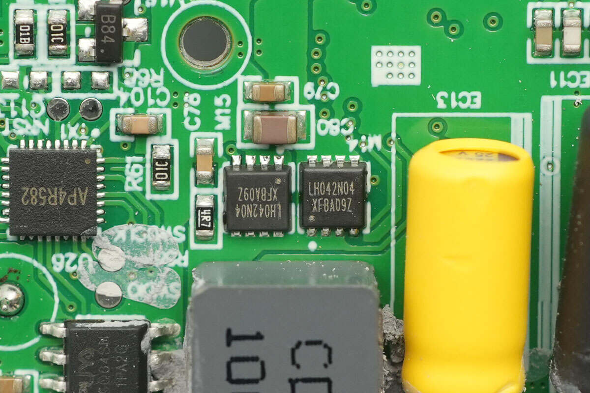

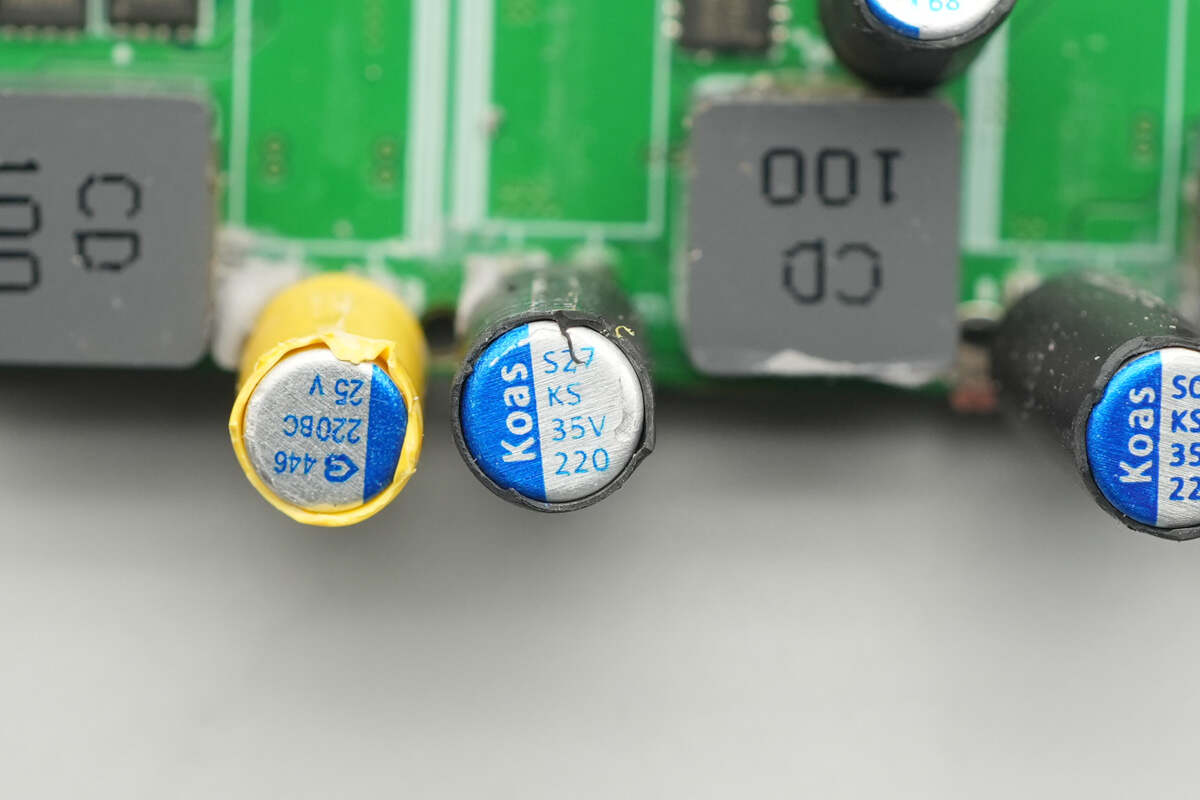

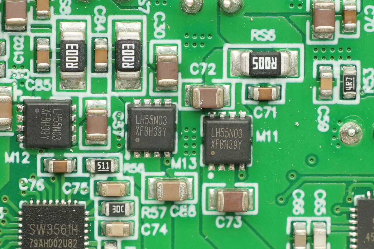

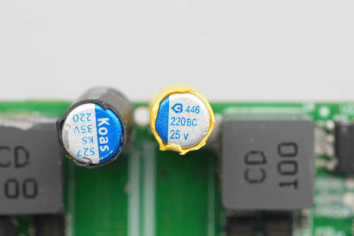

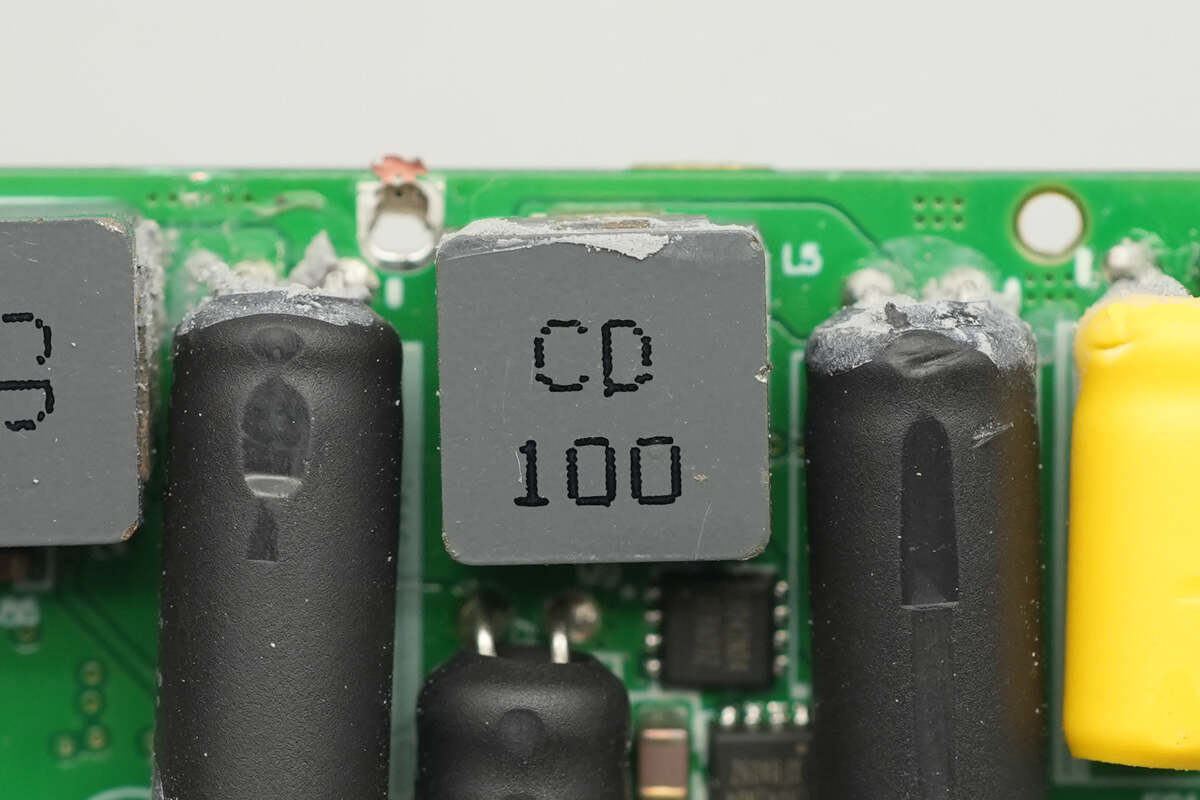

On this side, there are solid capacitors and a filter inductor.

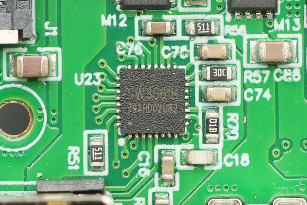

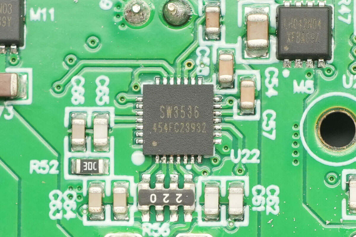

The synchronous rectifier controller is from RENESAS, marked with "L9," and the model is iW610-01C. It supports QR, ZVS, ACF, and LLC switching power supply applications. The chip supports both DCM and CCM operation, as well as low-side and high-side applications. It has an output voltage range of 3-28V and comes in an SOT23 package.
The synchronous rectifiers are from CR MICRO, model CRSM100N15N3Z. They are NMOS transistors with a voltage rating of 150V, a conduction resistance of 9.5mΩ, and come in a DFN 5x6 Rib package.
The three solid capacitors for output filtering are from Koshin, with a specification of 35V 1500μF.

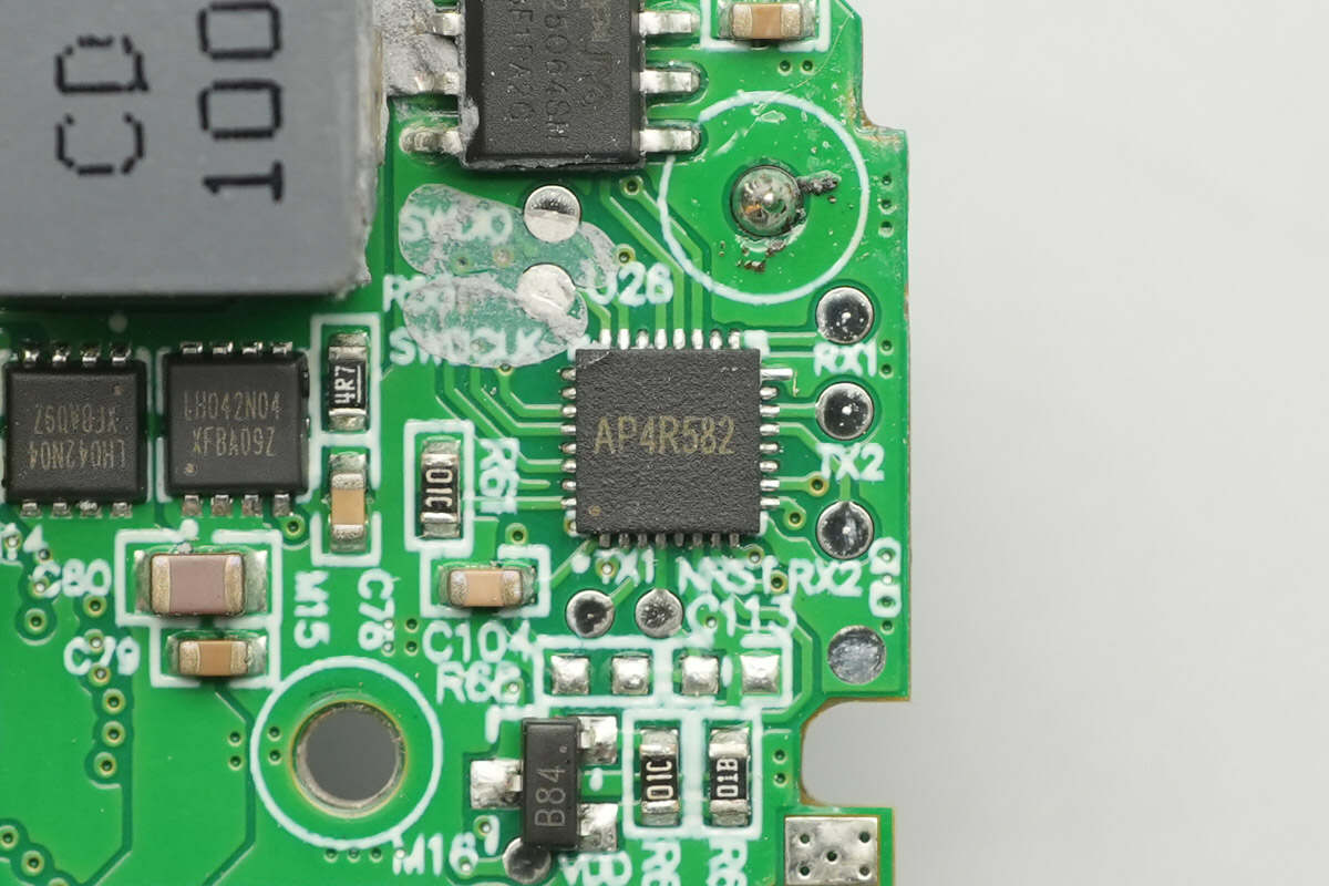

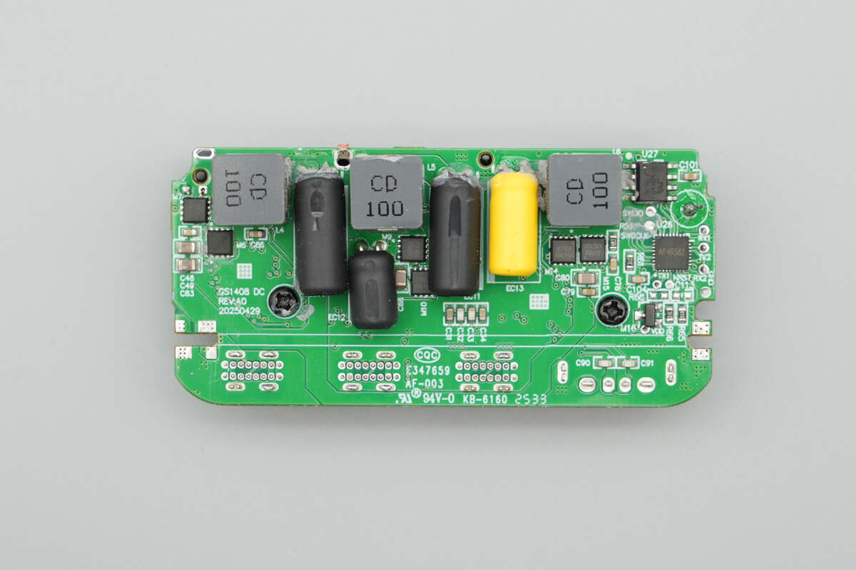

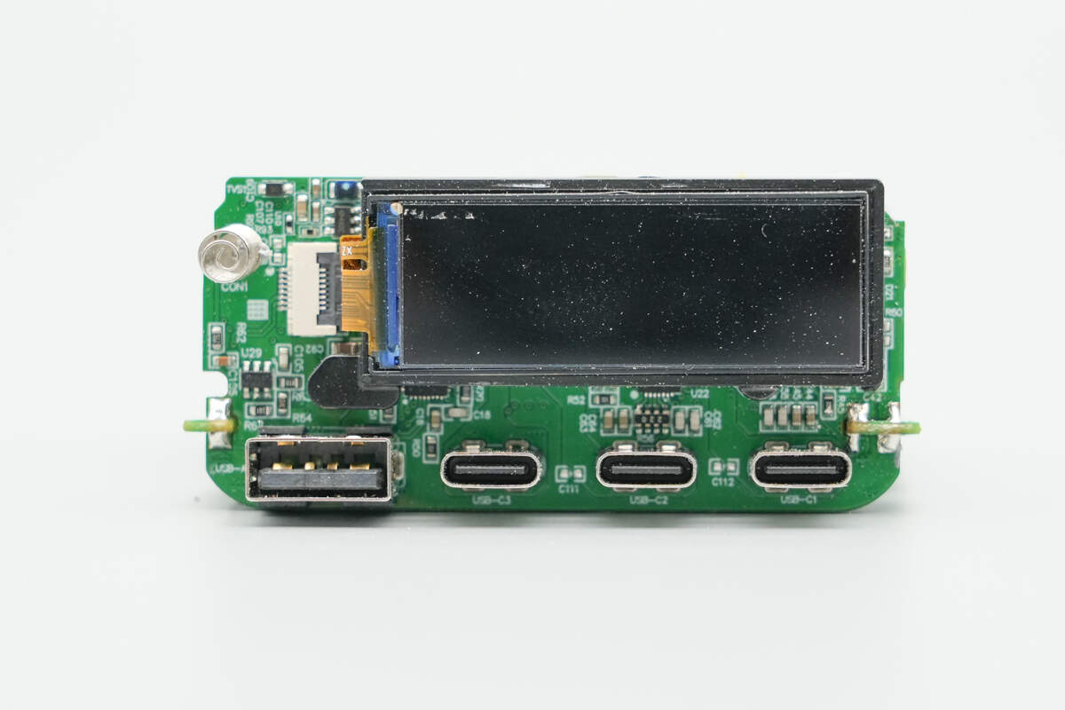

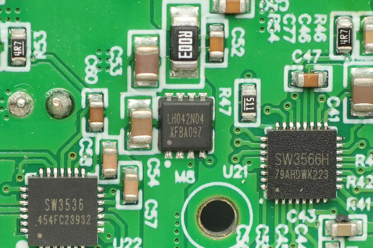

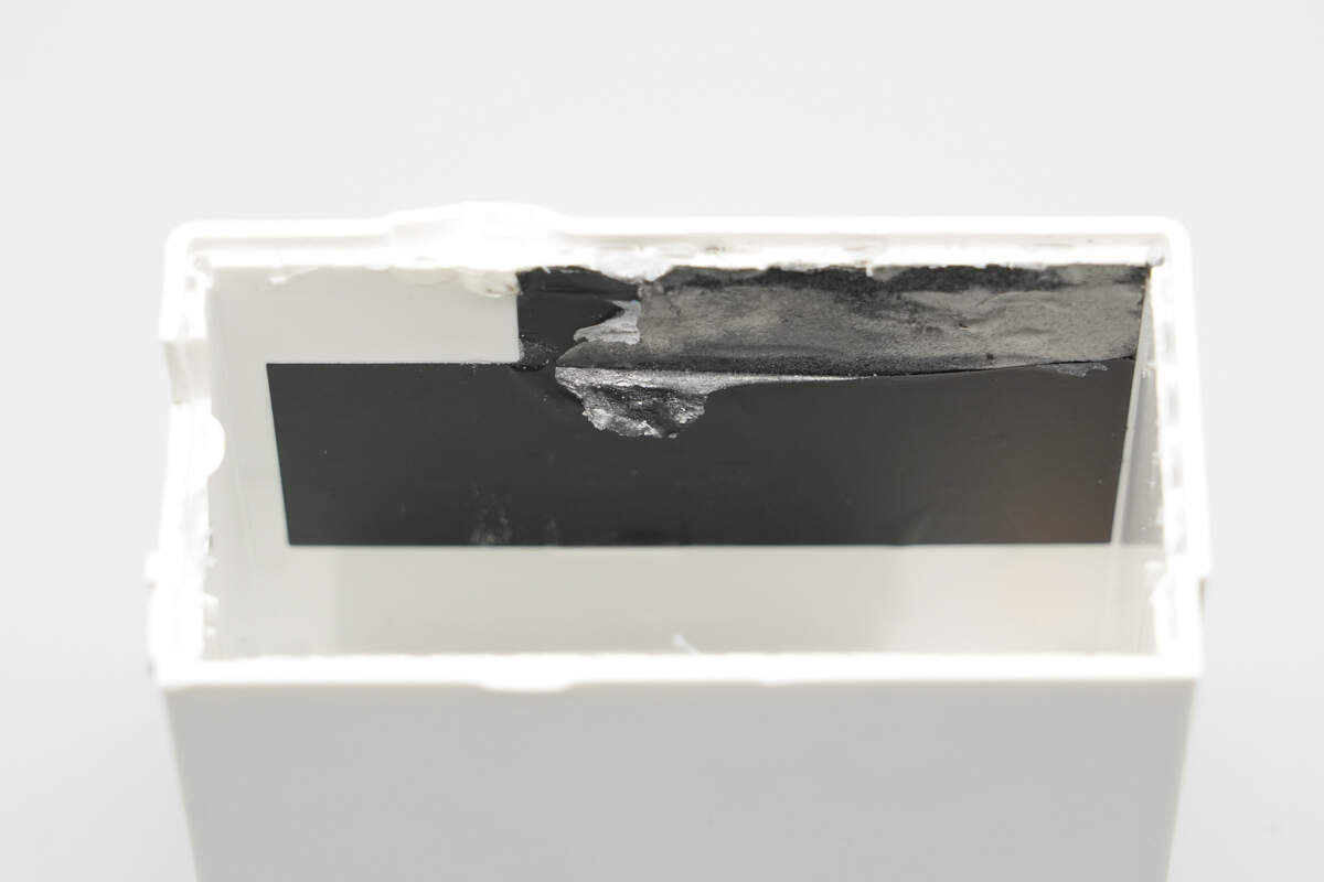

The small PCB at the output end is soldered onto a substrate. The screen is placed in a groove on the plastic plate for secure mounting and connected via a flex cable.
The back side features synchronous buck MOSFETs, buck inductors, and solid capacitors for three buck conversion circuits. It also includes the MCU and memory.

Remove the screen. The front of the small PCB features the buck protocol chips, output VBUS MOSFETs, switch-mode buck converters, touch controller chip, and other components.
The buck protocol chip for USB-C1 is from iSmartWare, model SW3566H. This chip is a highly integrated dual-port charging SOC that supports multiple fast charging protocols for both USB-C and USB-A interfaces, with independent current limiting for each port. It integrates a highly efficient synchronous buck converter, supporting 20V7A and 28V5A output, and supports fast charging protocols such as PD3.1, QC, SCP, UFCS, and custom protocols, with a maximum output power of 140W.
The SW3566H includes CC/CV modes, dual-port management logic, and bus voltage detection. Paired with the corresponding buck MOSFETs and VBUS MOSFETs, it can achieve dual-port buck output. The built-in buck converter operates at a frequency of 180kHz and supports both PWM and PFM operating modes. Protection thresholds such as output current and line loss compensation can be set through the I2C interface, and the internal ADC enables data sampling for 9 channels, including input/output voltage, output current, and chip temperature. It also supports external MCU integration for parameter display.
The SW3566H supports an input voltage of up to 36V and a maximum output current of 7A. It features soft-start, input over-voltage/under-voltage protection, output over-voltage/under-voltage protection, output over-current/short-circuit protection, DP/DM/CC over-voltage protection, over-temperature protection, external NTC thermistor protection, and power-limiting protection. The chip is packaged in a QFN 4x4-32 format.
The synchronous buck-boost MOSFETs are from LIHOMICRO, model LH042N04. These are NMOS transistors with a voltage rating of 40V, a conduction resistance of 4.2mΩ, and are packaged in a DFN 3x3 format.

The buck protocol chip for USB-C2 is from iSmartWare, model SW3536. This is a highly integrated dual-port fast charging chip that supports USB-A + USB-C dual-port fast charging output, with independent current limiting for each port. It integrates a 7A high-efficiency synchronous buck converter and supports multiple fast charging protocols, including PPS, PD, QC, AFC, FCP, SCP, PE, SFCP, and TFCP, with a maximum output power of 140W.
The SW3536 integrates CC/CV modes, dual-port management logic, and dynamic power distribution between two chips, making it a complete and high-performance multi-fast-charging protocol dual-port charging solution. The SW3536 supports an input voltage of up to 36V, which makes it suitable for 12-24V input car charger applications. It is ideal for use in fast charging adapters, power strips, and car charging applications.
The two synchronous buck MOSFETs used in conjunction are also the LIHOMICRO LH042N04.

The buck protocol chip for USB-C3 and the USB-A port is from iSmartWare, model SW3561H. This is a buck SoC that supports dual USB-C port output. It integrates a high-efficiency synchronous buck controller, supporting 20V 5A power output, and is compatible with USB PD3.1 SPR. The chip integrates an ARM Cortex-M0 core and Type-C logic, supporting fast charging protocols such as PD3.1, QC, SCP, UFCS, and custom fast charge protocols.
The SW3561H supports dual USB-C port path control, line loss compensation, and, when paired with two synchronous buck MOSFETs and the corresponding VBUS MOSFETs for each port, can achieve dual-port buck output. The built-in buck converter operates at a default frequency of 180kHz, with support for customized operating frequencies and up to 100W power output, making it suitable for compact designs. The chip also integrates comprehensive protection features, including overheat protection, input/output over-voltage/under-voltage protection, output over-current protection, and data pin over-voltage protection. It is packaged in a QFN-32 format.
The MCU, marked with AP4R582, is packaged in a QFN32 format.
