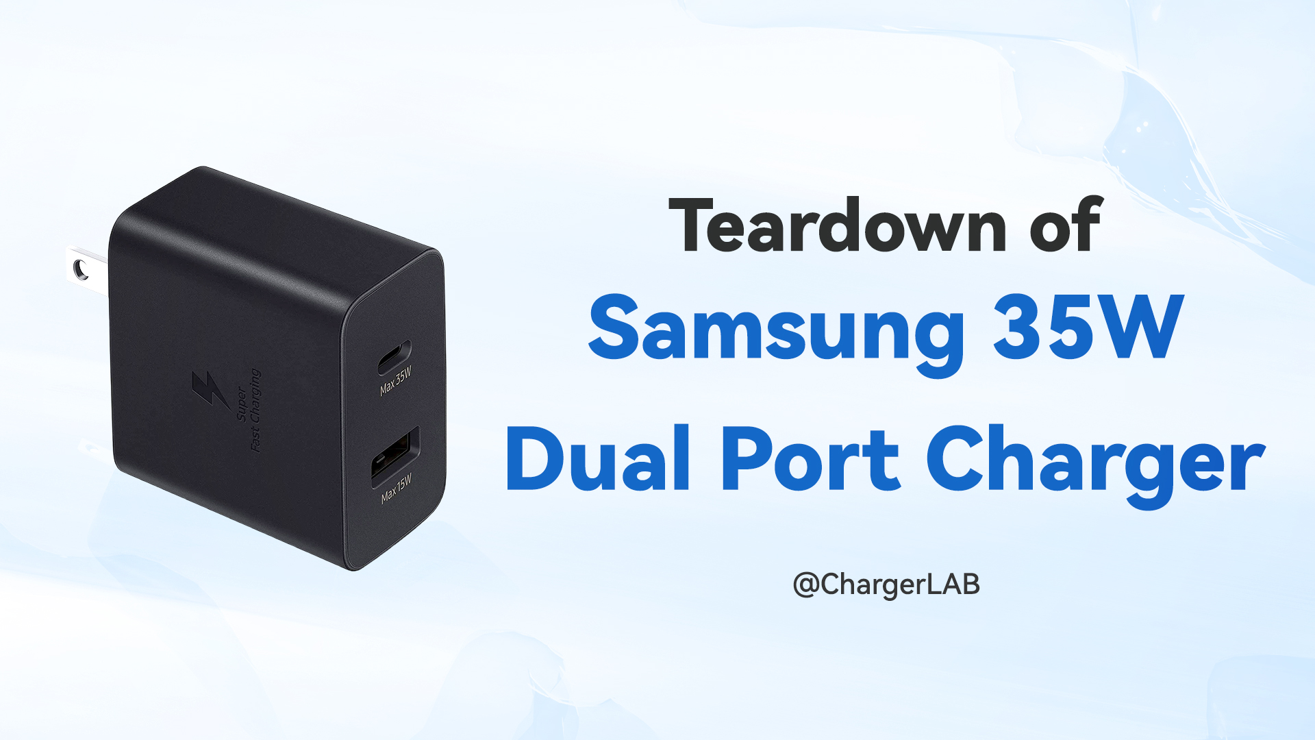

We've taken apart the Samsung 25W, 45W, and 65W chargers. But today, we got a 35W dual USB ports charger from Samsung, which is sold separately.
It's like the Samsung 65W trio charger we took apart before. But it has one less USB-C port, and the output power is also halved. Let's see what it looks like inside.
