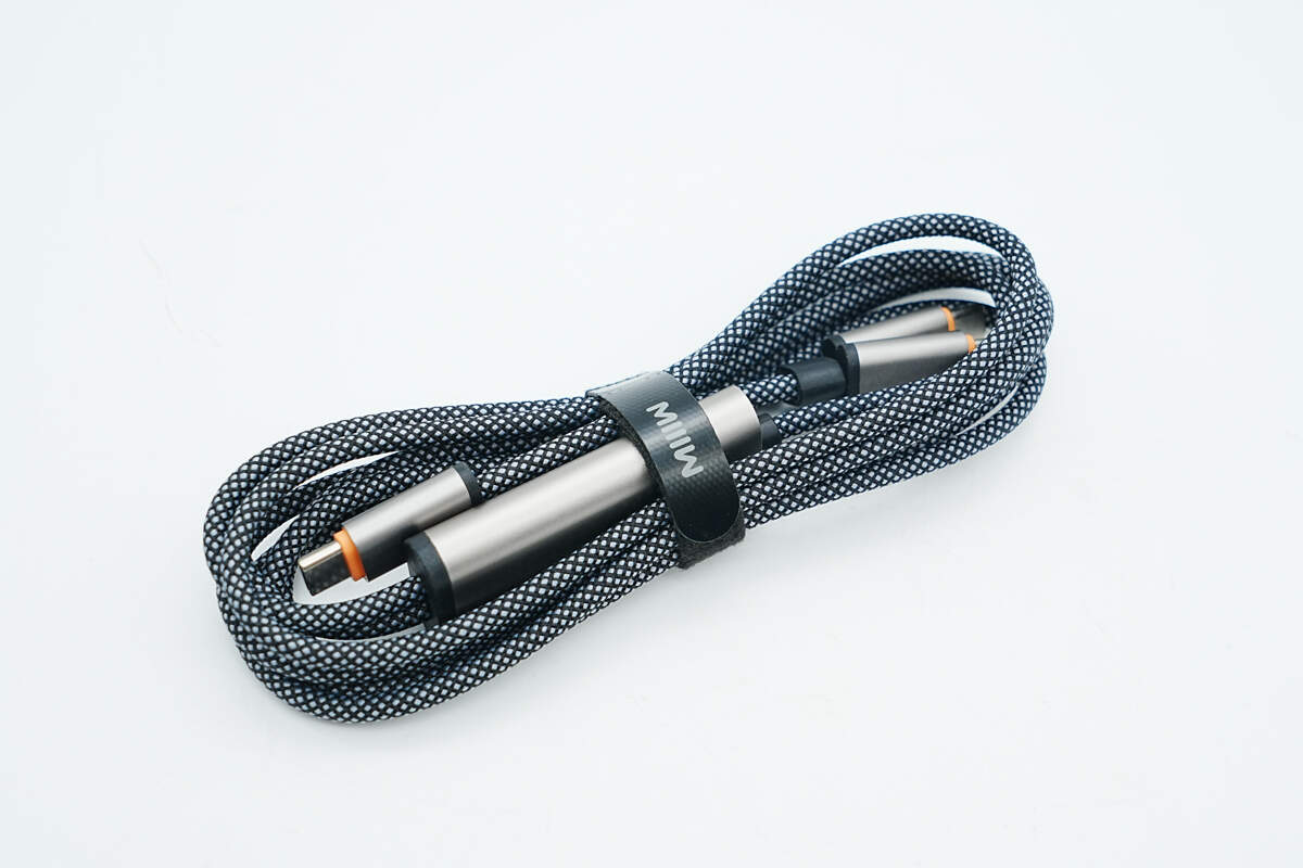

It features a braided design with a black-and-white alternating pattern along the sheath. Both the USB-C connectors and the splitter are housed in a silver-gray metal casing, giving the overall design a refined and aesthetically pleasing appearance.

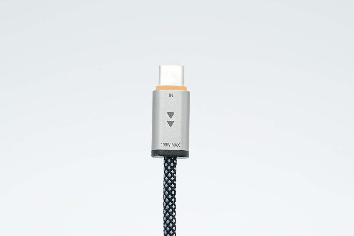

The input connector features a sandblasted finish with smoothly curved edges on both sides. Additionally, the front of the USB-C input connector housing is printed with "IN," a triangle symbol indicating the input current direction, and the "100W MAX" power rating.
Teardown of MIIIW CB510 Pro 100W Two-in-One Supercharging Cable (iCB1013Y)-Chargerlab

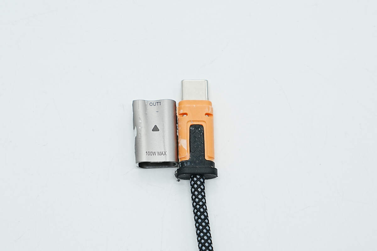

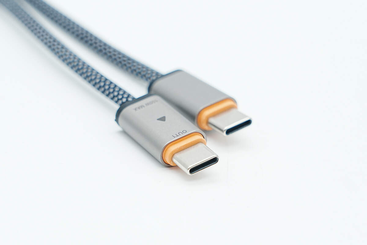

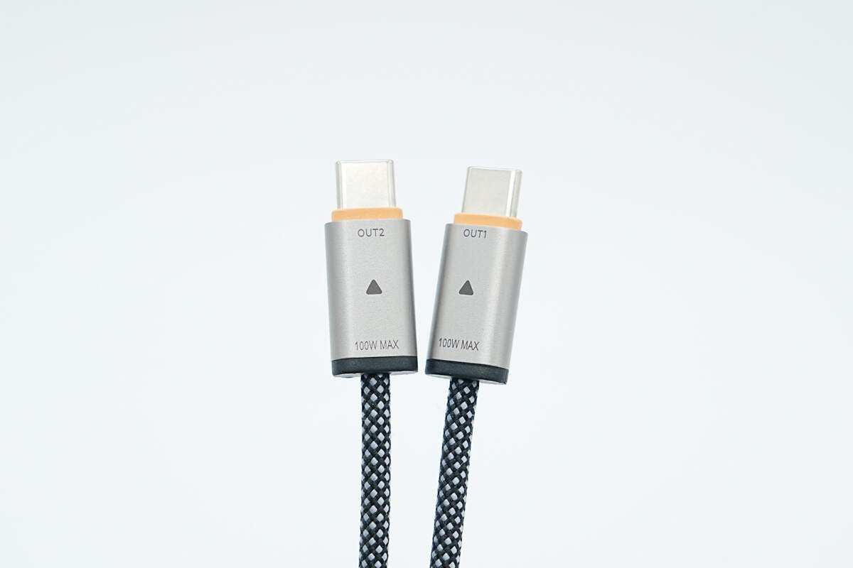

The two output cable connectors are marked with OUT1, OUT2, 100W MAX, and a triangle symbol to help users easily distinguish between them.
The USB-C male output connectors feature orange plastic casings for enhanced protection.

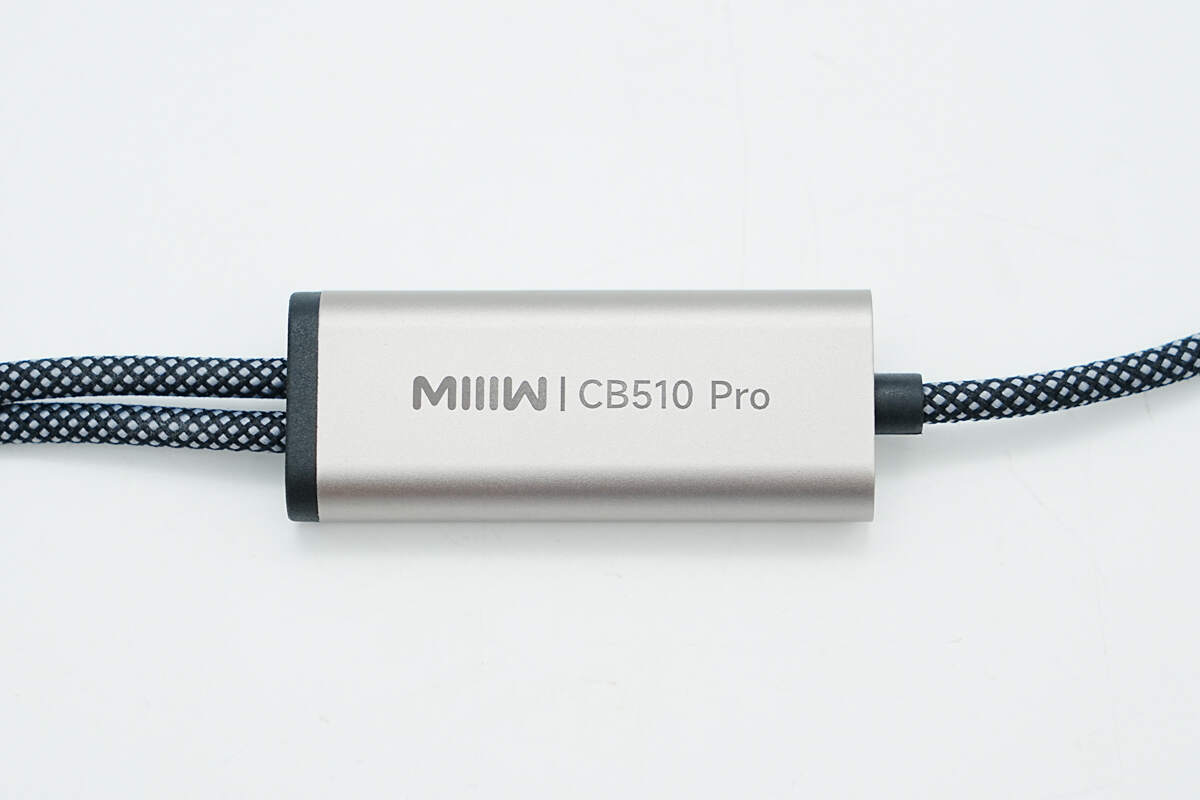

The splitter housing features the same design, with MIIIW and CB510 Pro printed on the front.

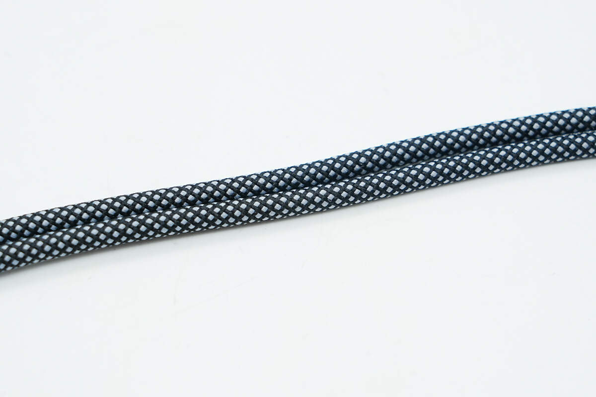

The cable body is tightly braided, smooth overall, and free of any burrs, reflecting high-quality craftsmanship.

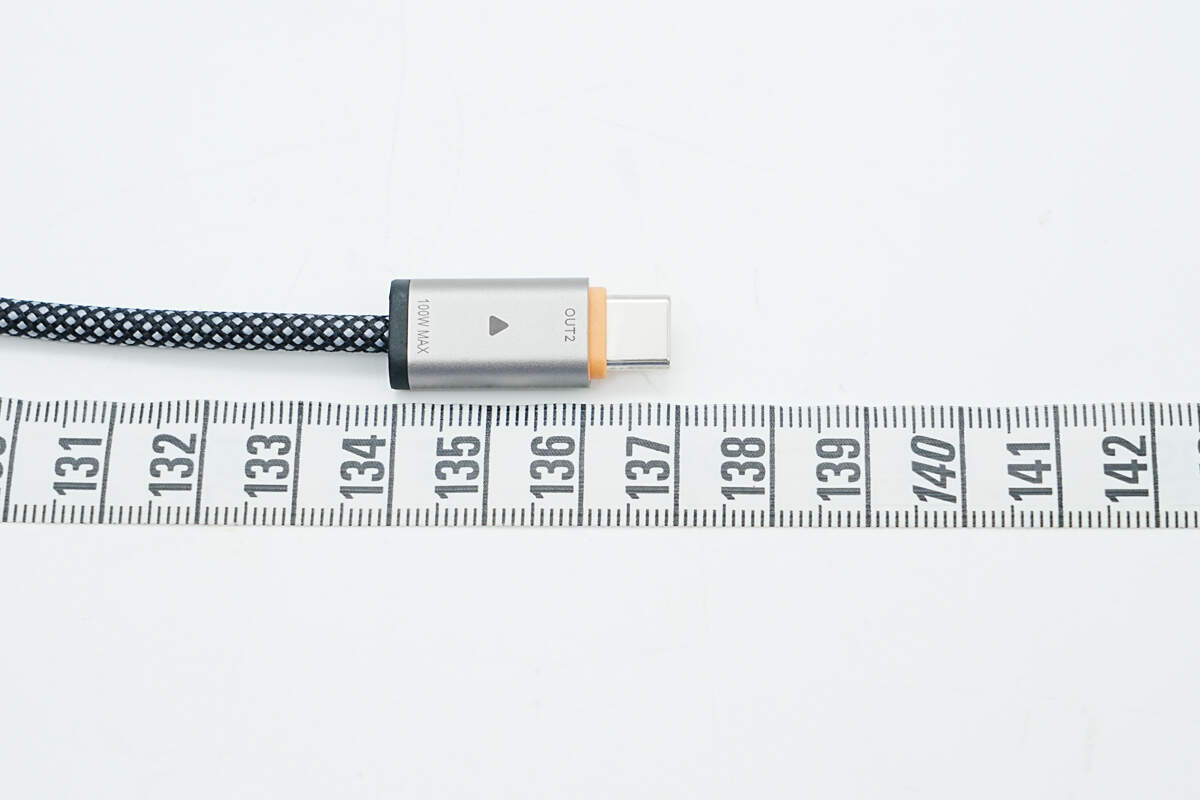

The length of the cable is 137 cm (53.94 inches).

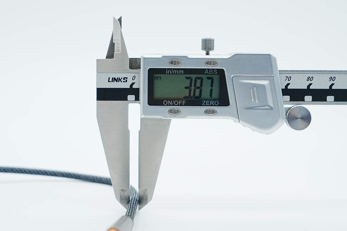

The diameter is about 3.87 mm (0.15 inches).

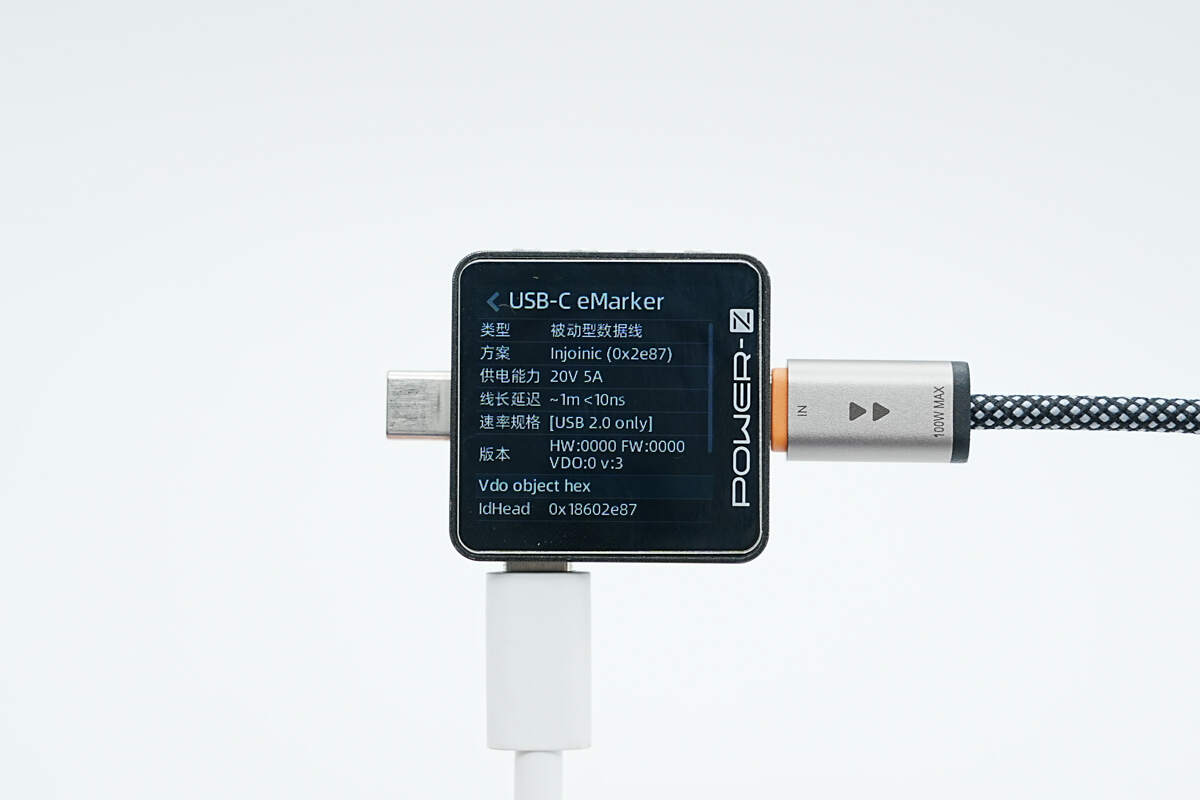

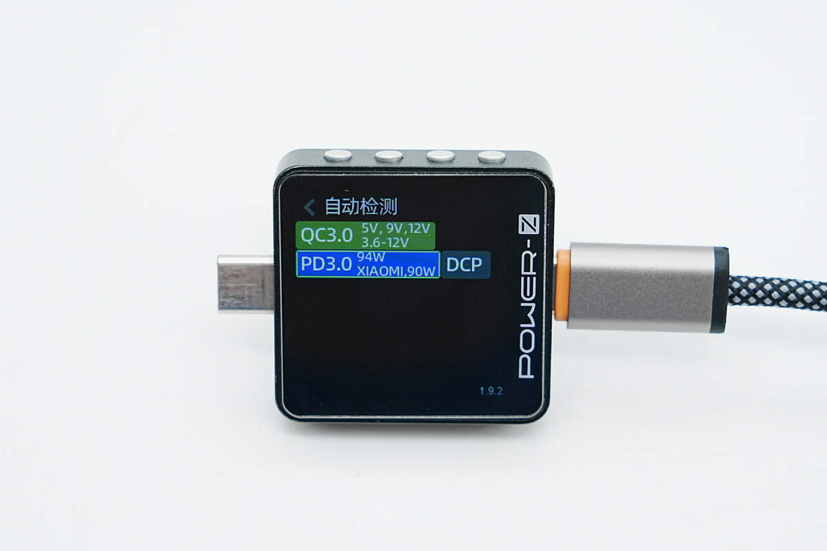

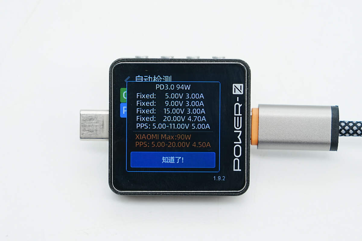

ChargerLAB POWER-Z KM003C shows it has an E-marker chip, supports 20V5A, and USB 2.0.

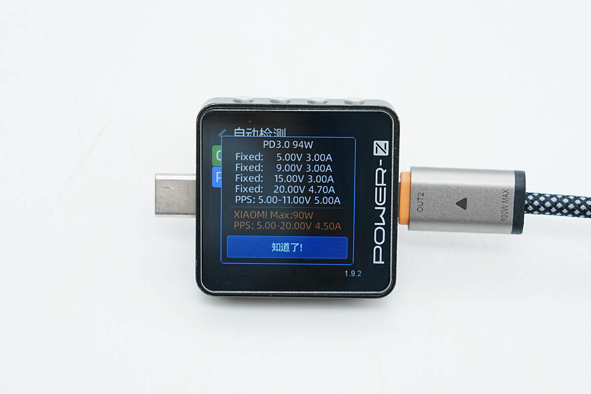

The cable enables standard chargers to be converted to support Xiaomi’s proprietary 90W MAX fast charging protocol. For instance, testing with an Apple 140W charger confirmed that the output supports Xiaomi’s 90W proprietary fast charging.
It supports one Xiaomi proprietary fast charging fixed PDO of 5-20V4.5A.
The test results for the other output cable are the same.
The PDO reports are also the same.

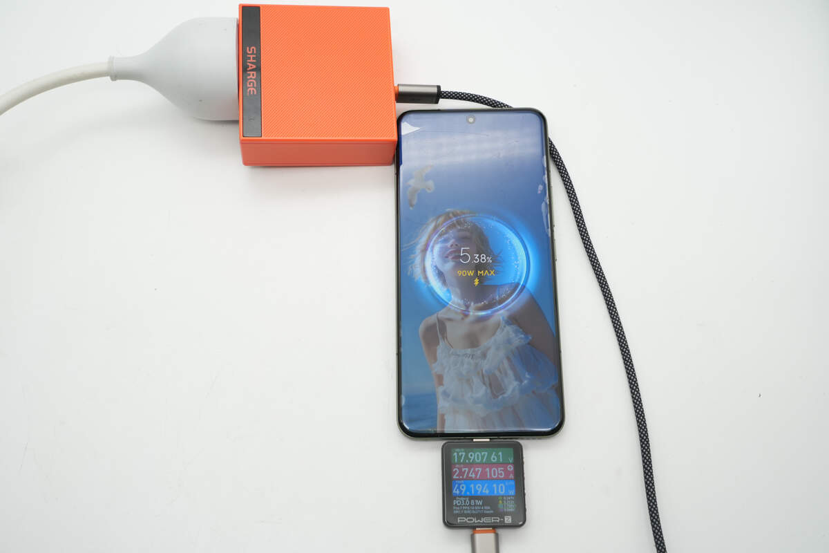

Paired with the SHARGE 140W charger, charging the Xiaomi 15 Pro successfully triggers Xiaomi’s 90W proprietary fast charging.

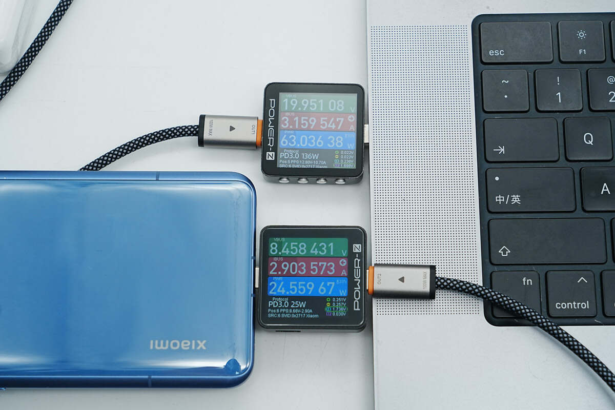

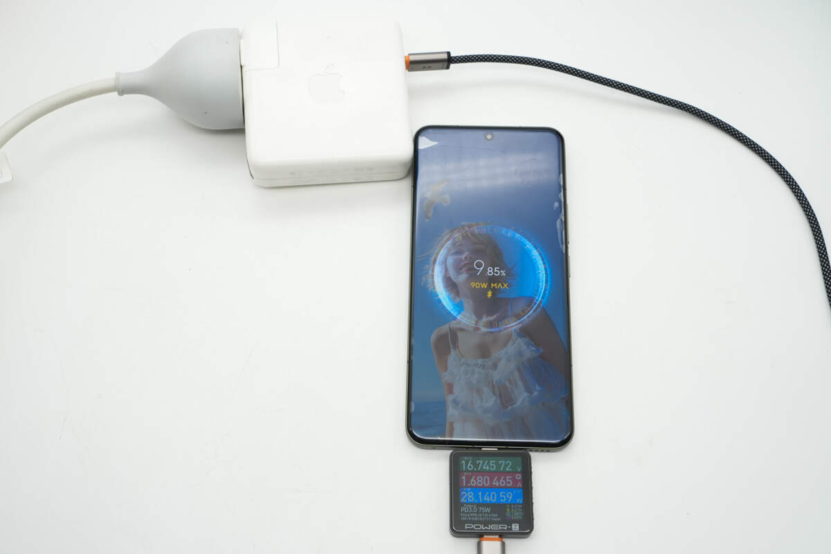

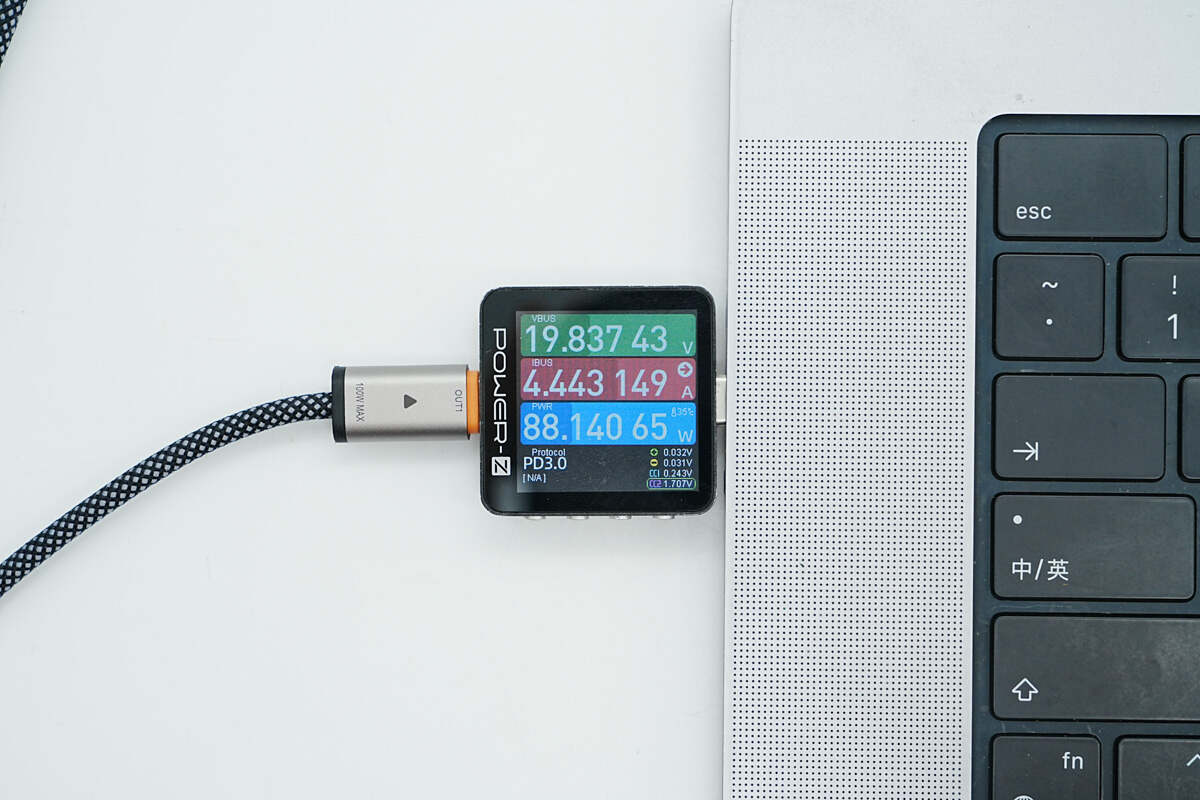

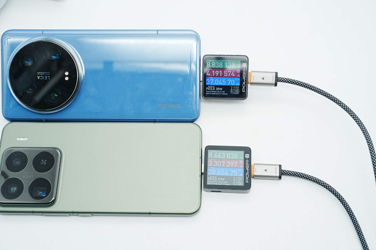

Using an Apple 96W charger with the cable to charge both the MacBook Pro and Xiaomi 14 Ultra delivers charging powers of 63W and 24.56W respectively, enabling simultaneous fast charging for two devices.
Charging the Xiaomi 15 Pro and Xiaomi 14 Ultra simultaneously, the power is 28.65W and 37W, respectively.

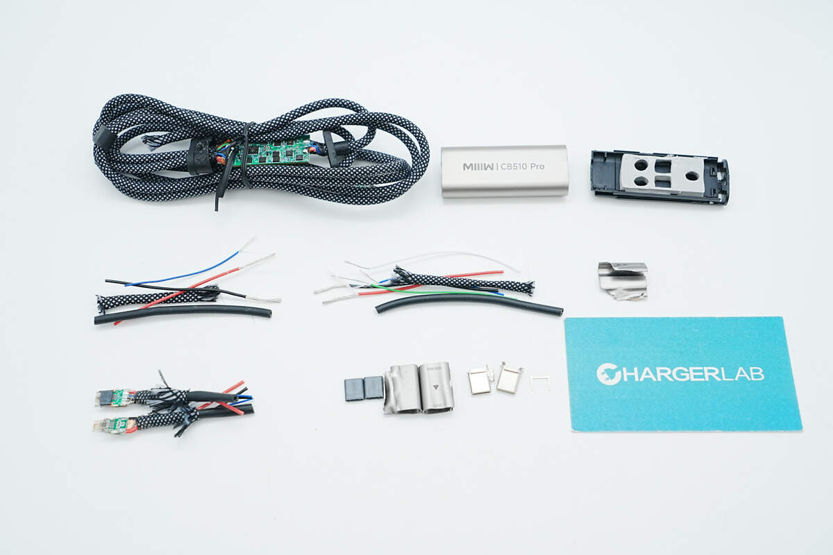

Next, let's take it apart to see its design and build quality.

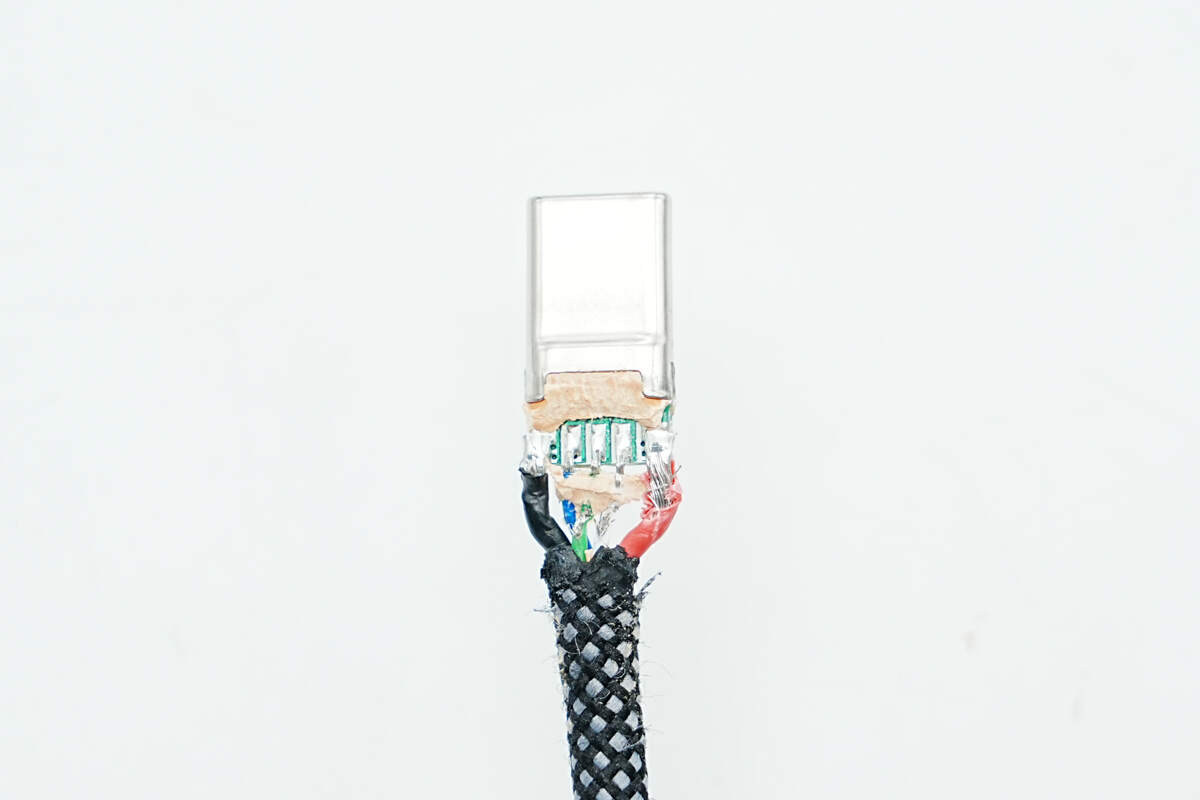

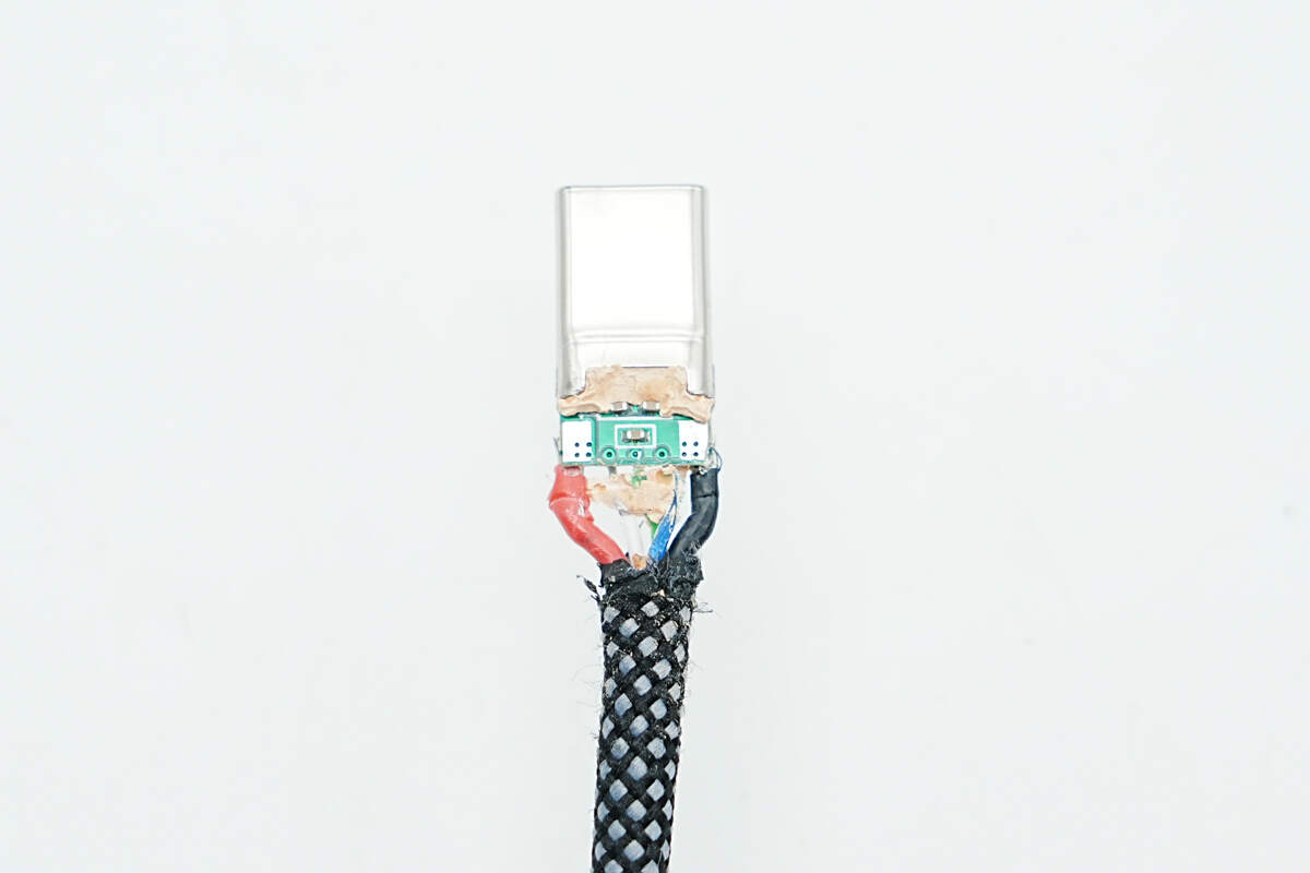

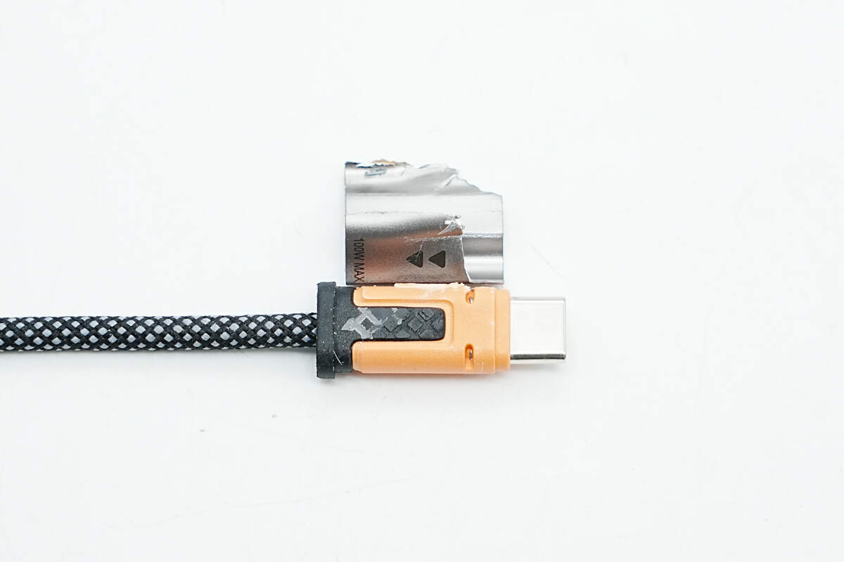

Cut open the input connector. The interior is filled with orange and black plastic.

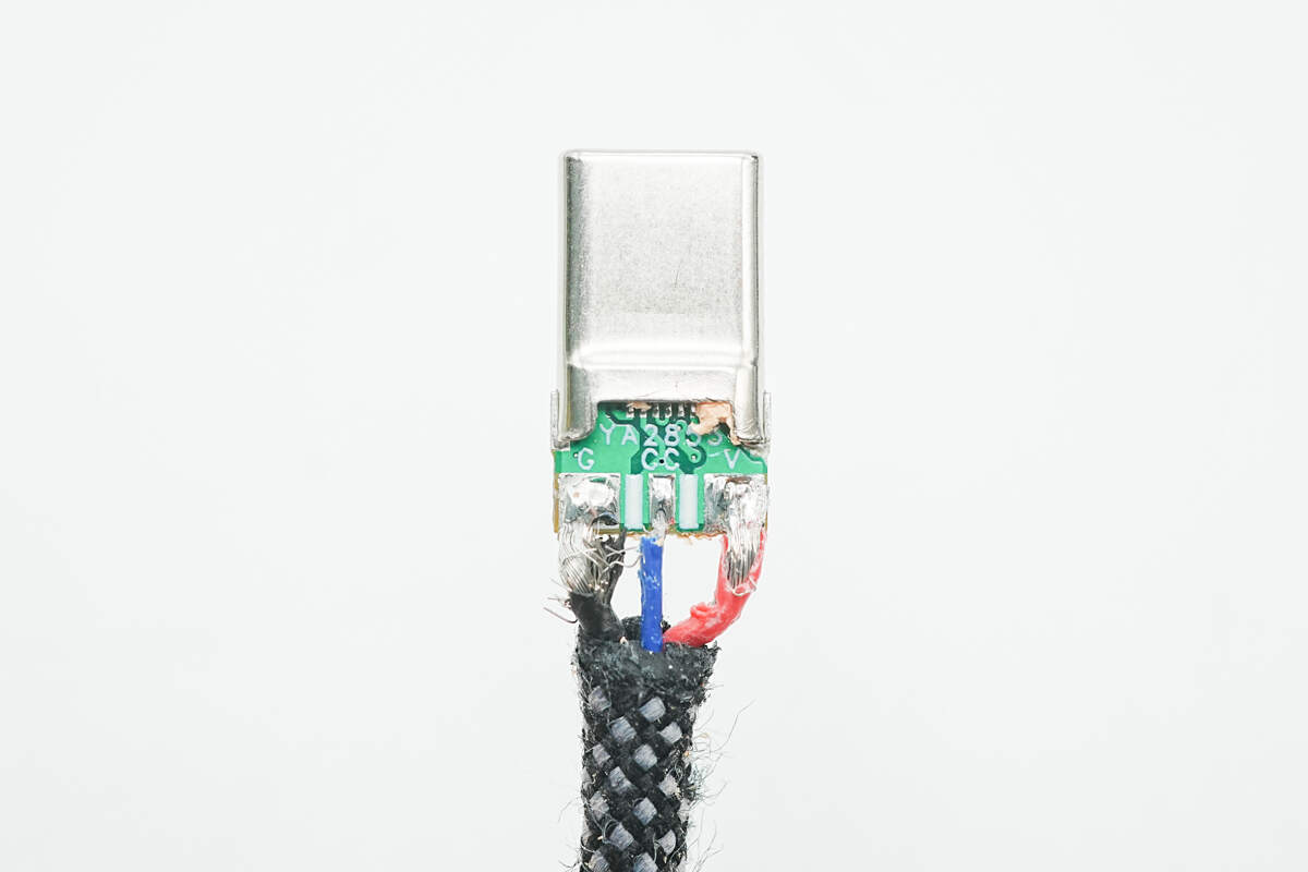

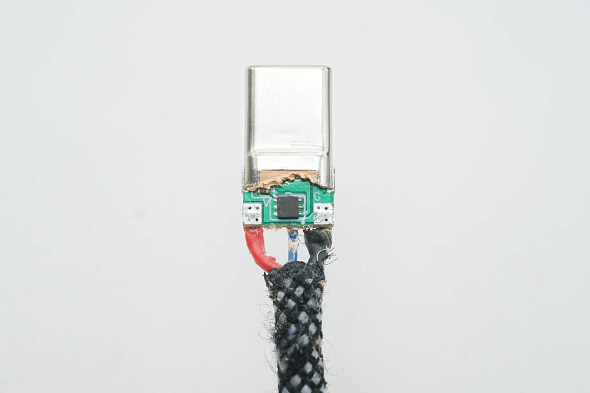

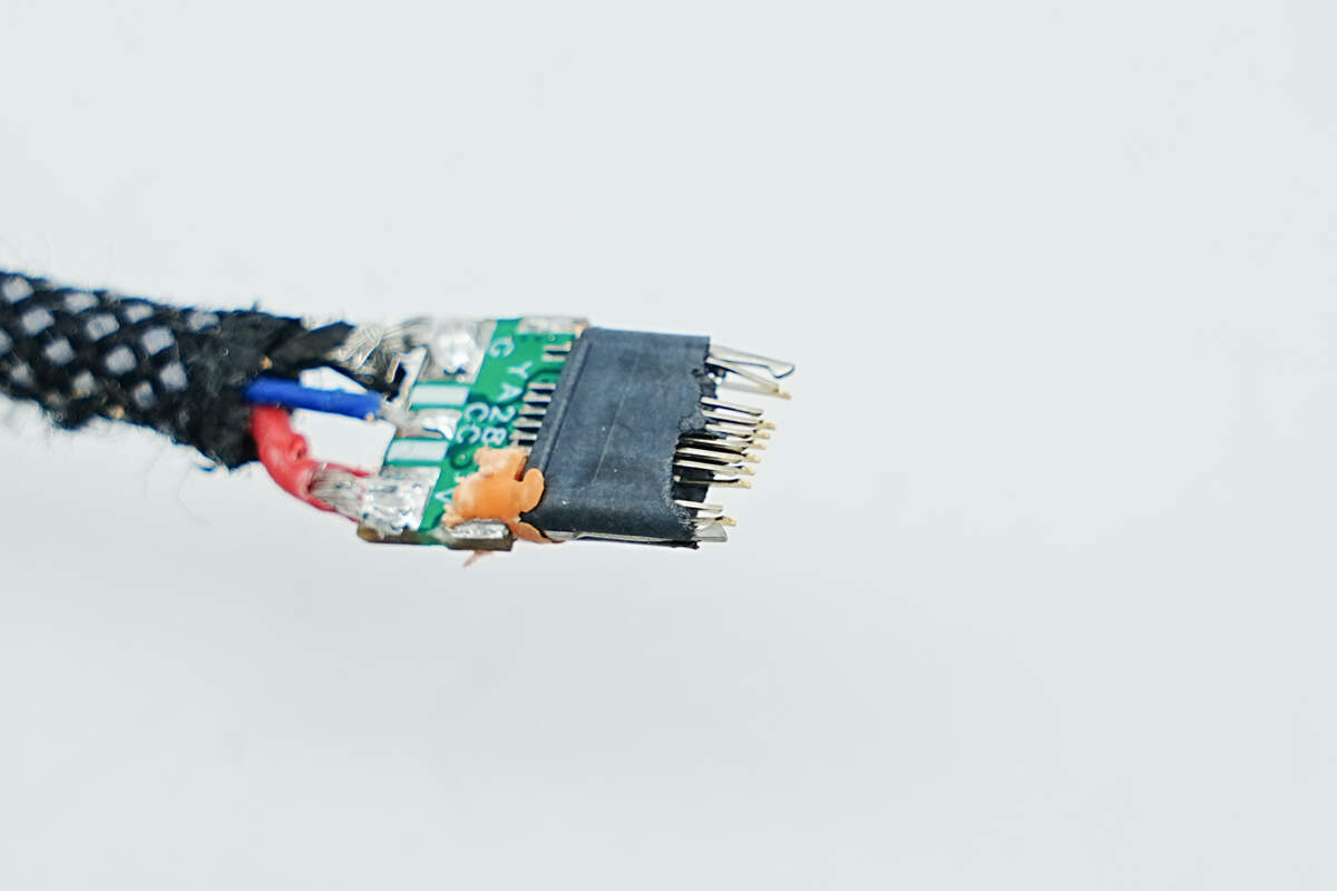

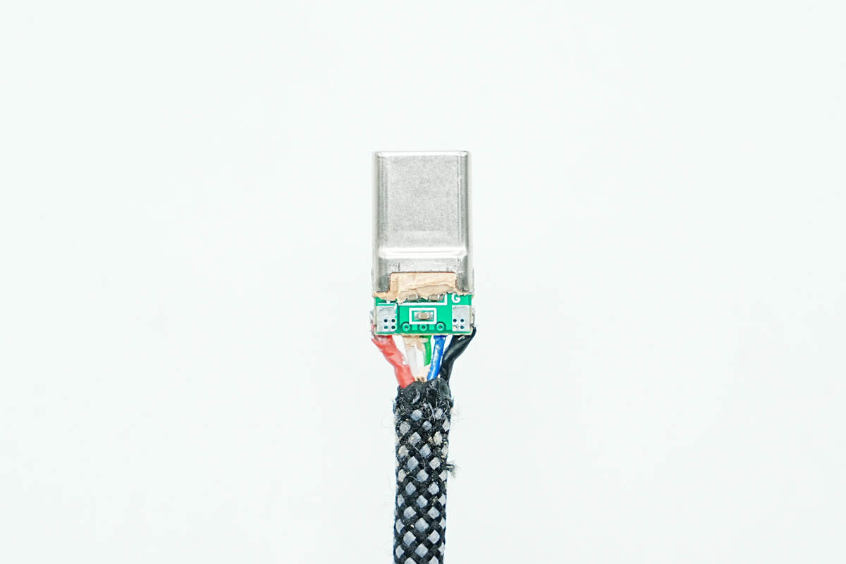

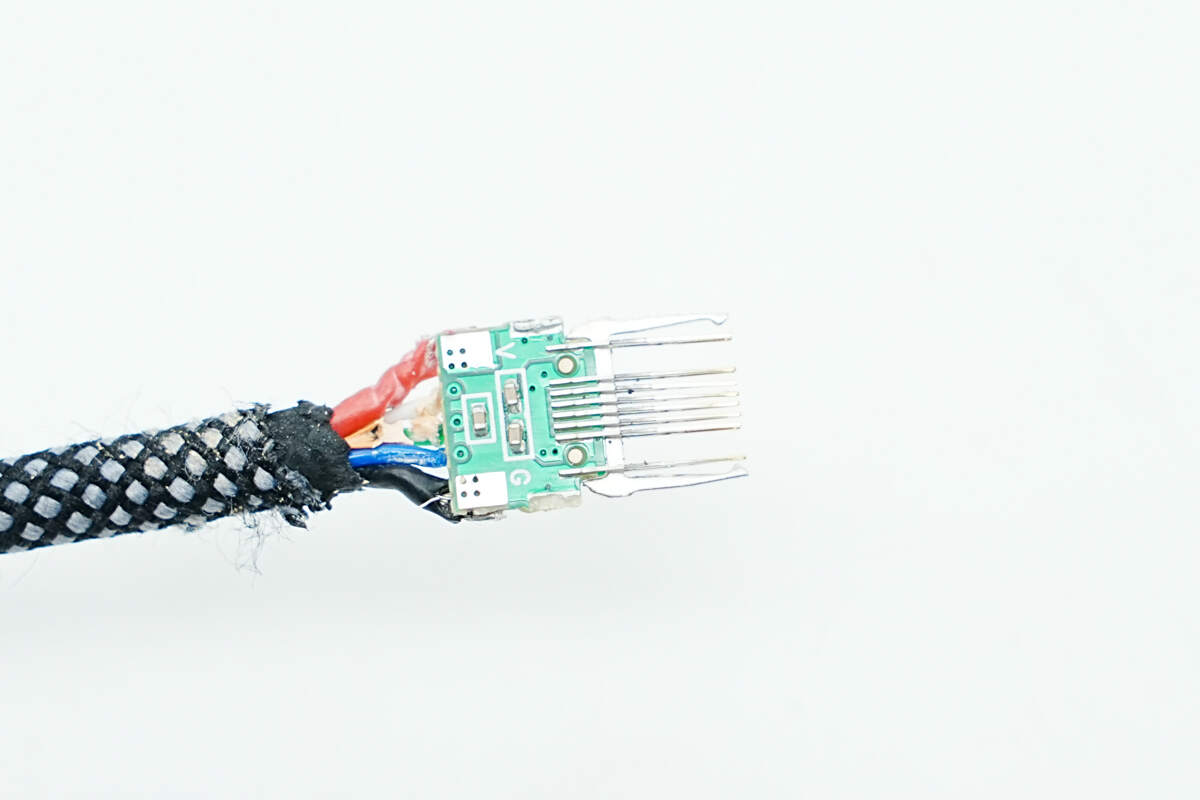

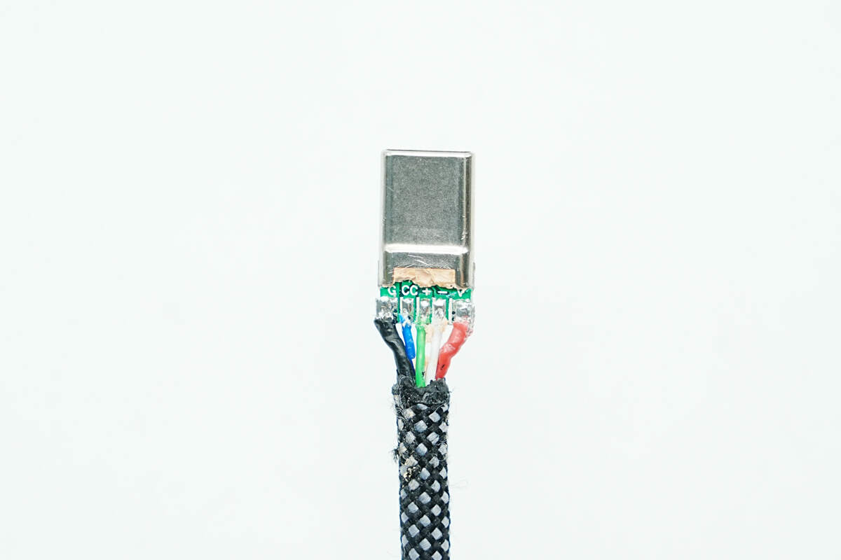

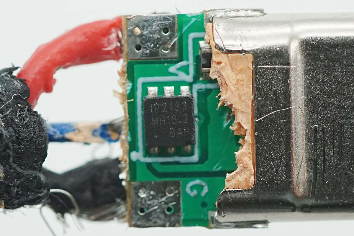

After removing the internal plastic, one side of the internal PCB reveals an E-Marker chip.
The other side is soldered with three wire cores.

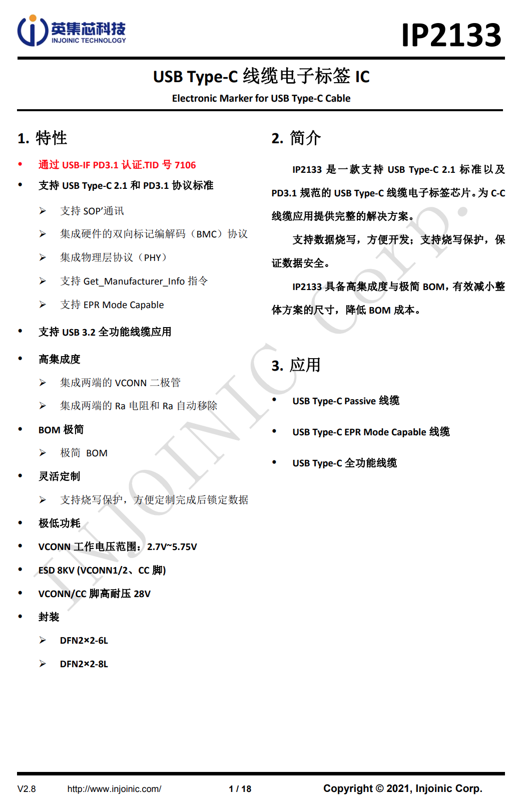

The E-Marker chip is from Injoinic. It is a USB Type-C cable electronic marker chip that supports the USB Type-C 2.1 standard and PD 3.1 specification, providing a complete E-Marker chip solution for USB-C cables. It has passed the USB-IF PD 3.1 certification with TID: 7106 and supports full-function USB 3.2 cable applications. Model is IP2133.
It integrates a VCONN diode and an Ra resistor, supports data programming and write protection, as well as data locking. It operates within a voltage range of 2.7 to 5.75V, with VCONN and CC pins rated for 28V withstand voltage. The chip comes in DFN 2x2-6L and DFN 2x2-8L packages, making it suitable for USB-C passive cables, EPR, and full-function cable applications.
Here is the information about Injoinic IP2133.

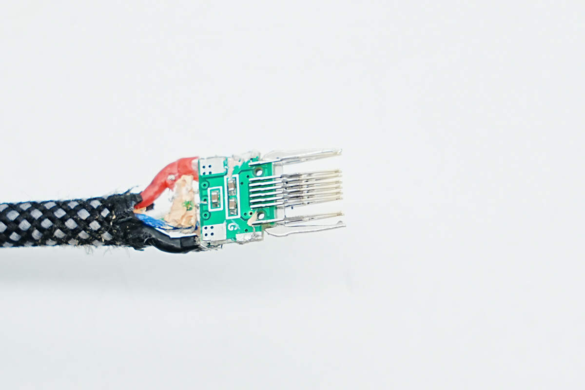

Remove the metal shell. The internal pins are molded with plastic and feature gold plating on the front ends.

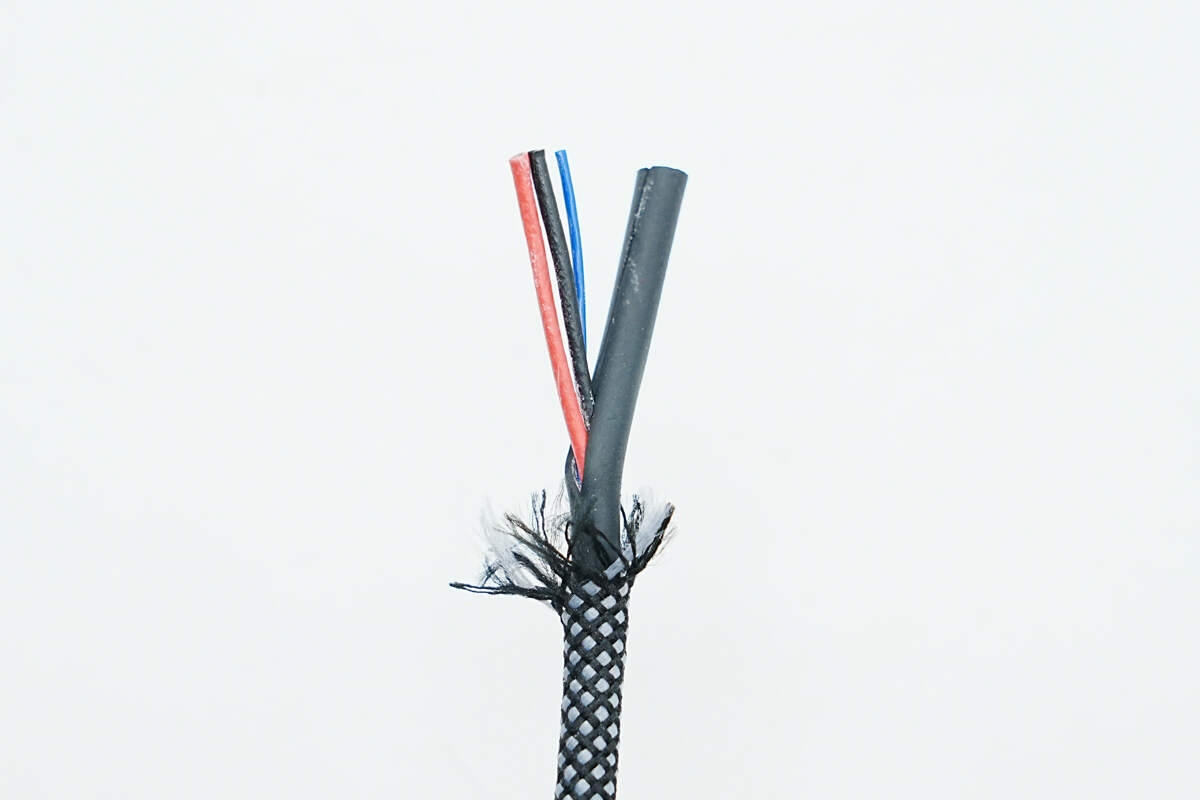

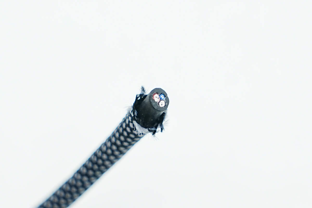

Cut the input wire, and you can see there are three wire cores.

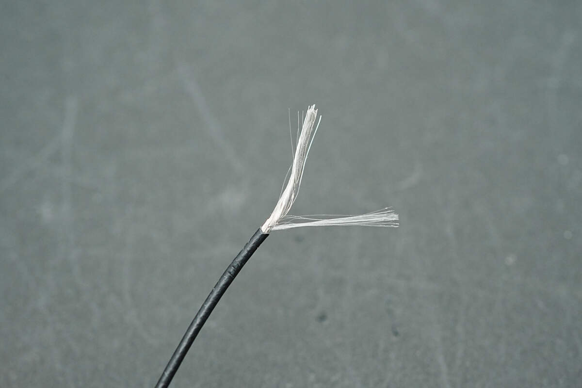

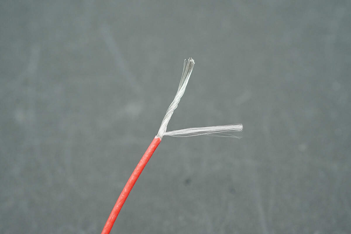

Cut open the black TPE outer jacket. The three internal cores consist of positive and negative power wires and a CC wire.

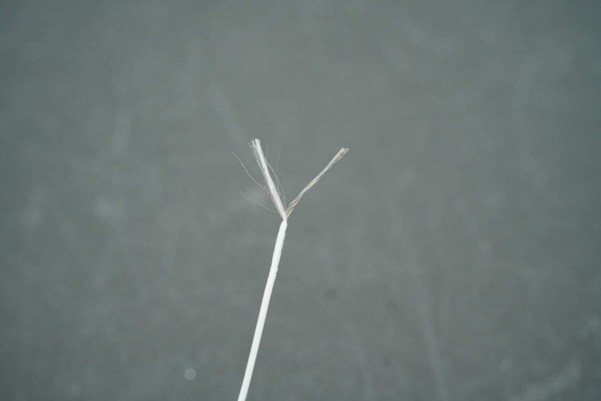

The red positive power wire includes reinforcement fibers for better tensile strength.

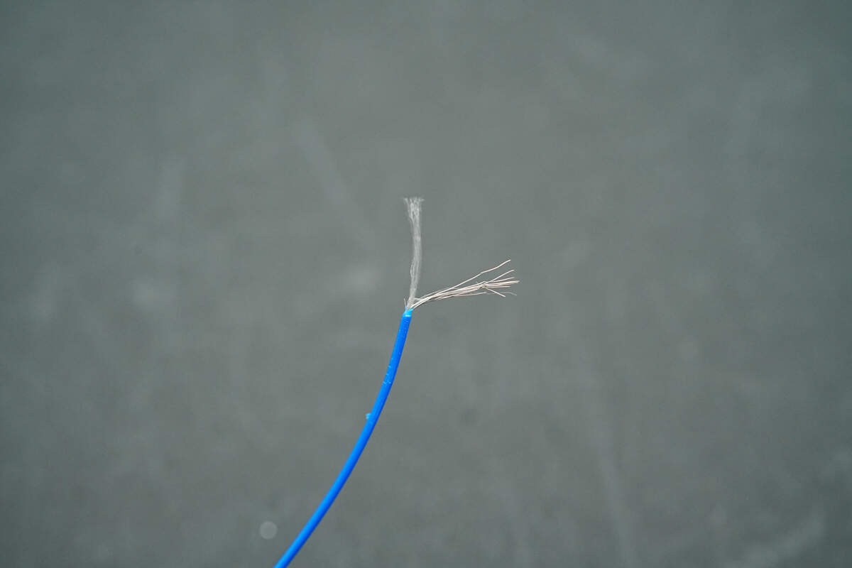

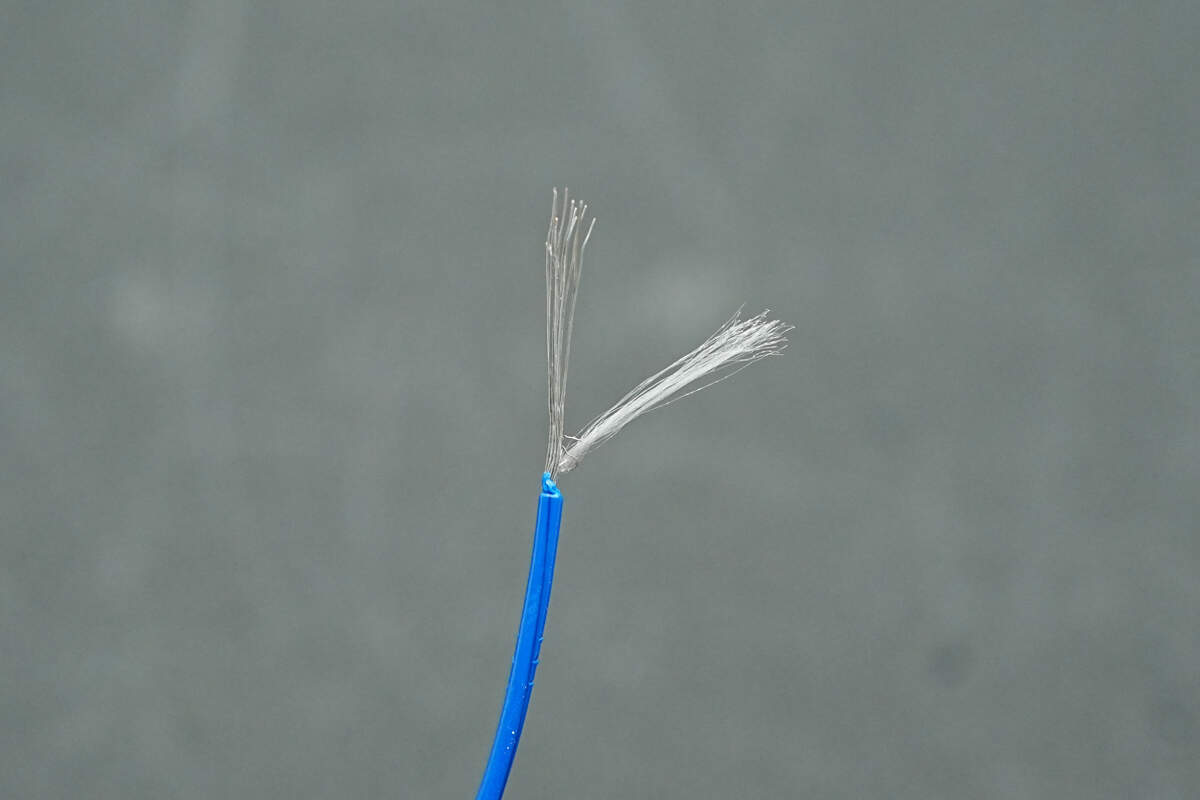

This is the blue CC wire.

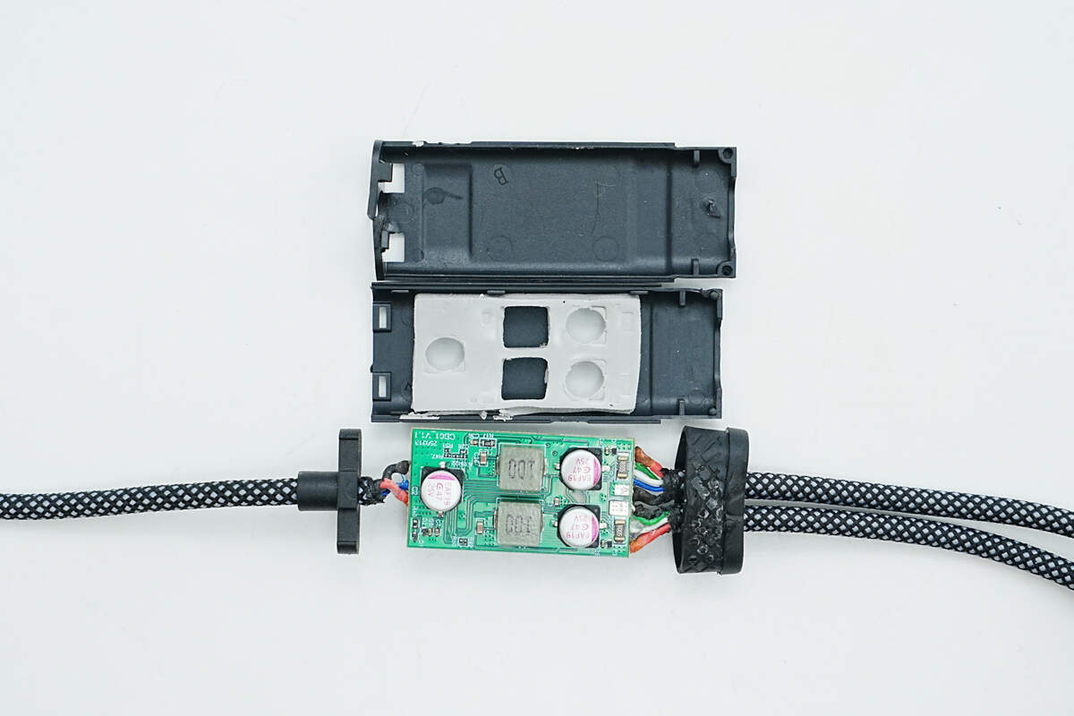

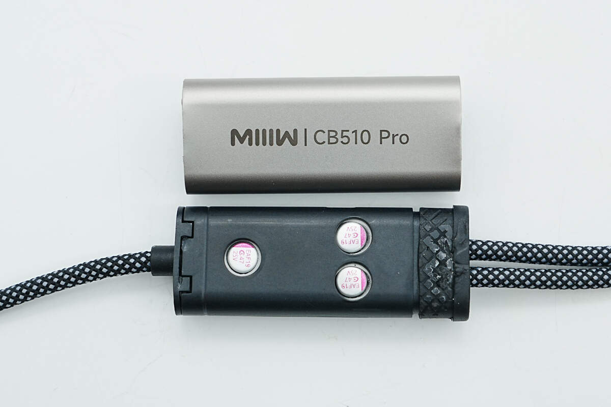

Remove the metal casing of the splitter. Inside, there is a plastic casing for protection, with three cutout areas corresponding to the capacitors.
Remove the plastic casing. Inside, there is a single thermal pad to aid heat dissipation.

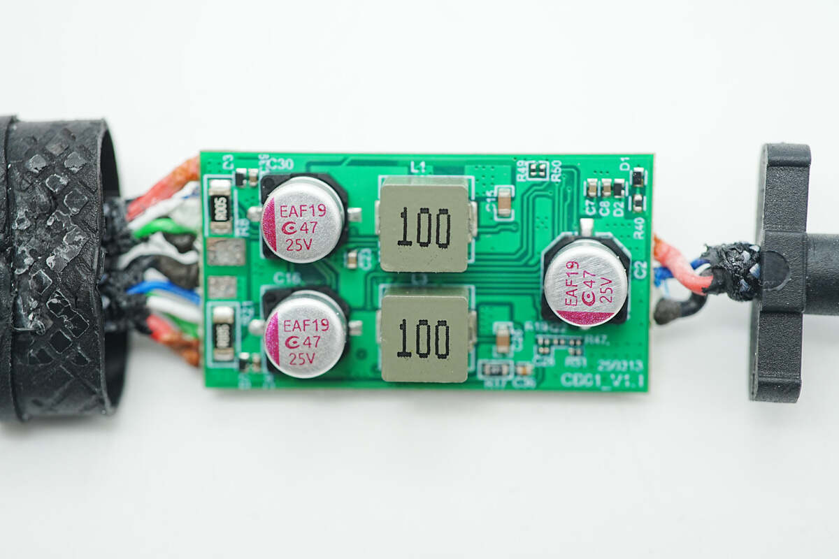

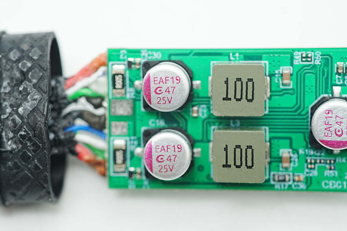

The front side of the PCB features components such as inductors and capacitors.

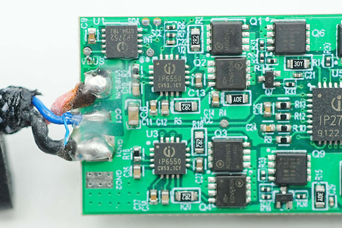

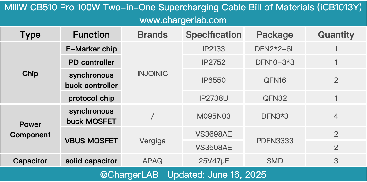

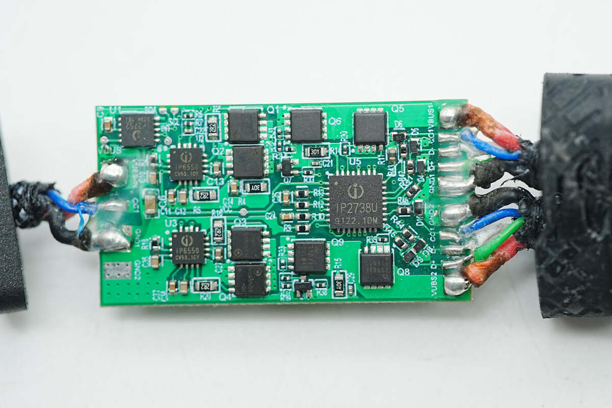

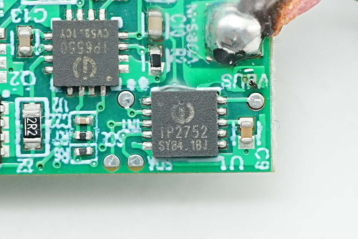

On the back are the PD controller, synchronous buck controller, synchronous buck MOSFET, protocol chip, and VBUS MOSFET. The wire cores at both ends are reinforced and protected with molded plastic.

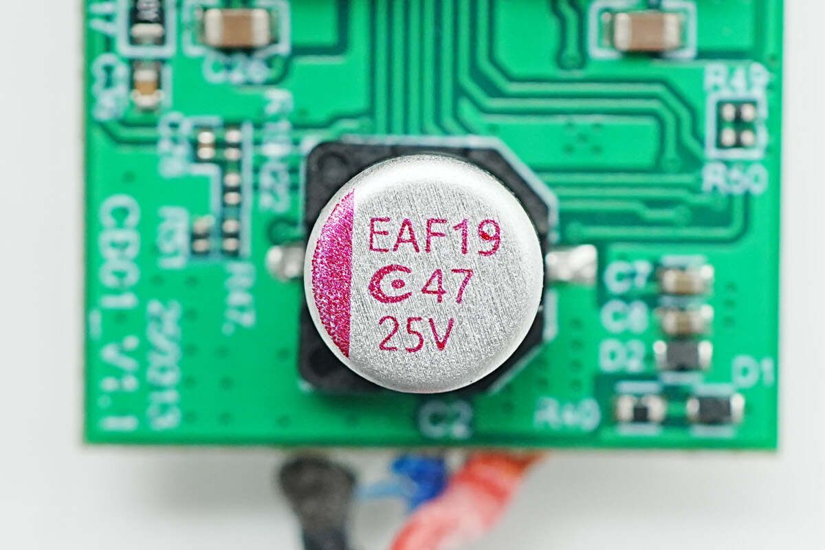

The solid capacitor for input filtering is from APAQ. 25V 47μF.

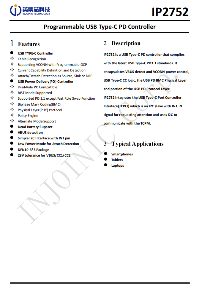

The PD controller is from Injoinic and adopts the DFN10-3*3 package. It supports bidirectional operation, VCONN power supply, and programmable overcurrent protection. It features current capability definition and detection, and can function as a source, sink, or DRP. It supports connect/disconnect detection and is compatible with PD 3.1 applications. The chip integrates the physical layer protocol, uses I²C interface communication, and the VBUS, CC1, and CC2 pins have a 28V withstand voltage rating. Model is IP2752.
Here is the information about Injoinic IP2752.

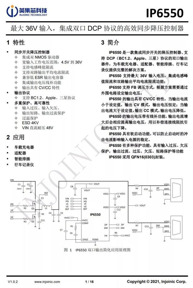

The synchronous buck controllers used for both output cables are Injoinic IP6550. It supports a 36V input and features a built-in NMOS driver with two external MOSFETs for efficient synchronous buck conversion. The output voltage is regulated via a feedback pin. It operates at a switching frequency of 135 kHz and has an input voltage tolerance of up to 48V. The device includes comprehensive protection features and comes in a 3x3 mm QFN16 package, enabling simplified synchronous buck converter circuit designs.
The IP6550 is suitable for applications such as car chargers, multi-port adapters, smart power strips, USB-C-enabled power strips, and dash cams. Its synchronous rectification buck converter offers high conversion efficiency and high output current, making it ideal for multi-port 5V outputs. When paired with a PD protocol chip, it supports wide-range voltage regulation to meet USB PD 3.1 specifications.
Here is the information about the Injoinic IP6550.

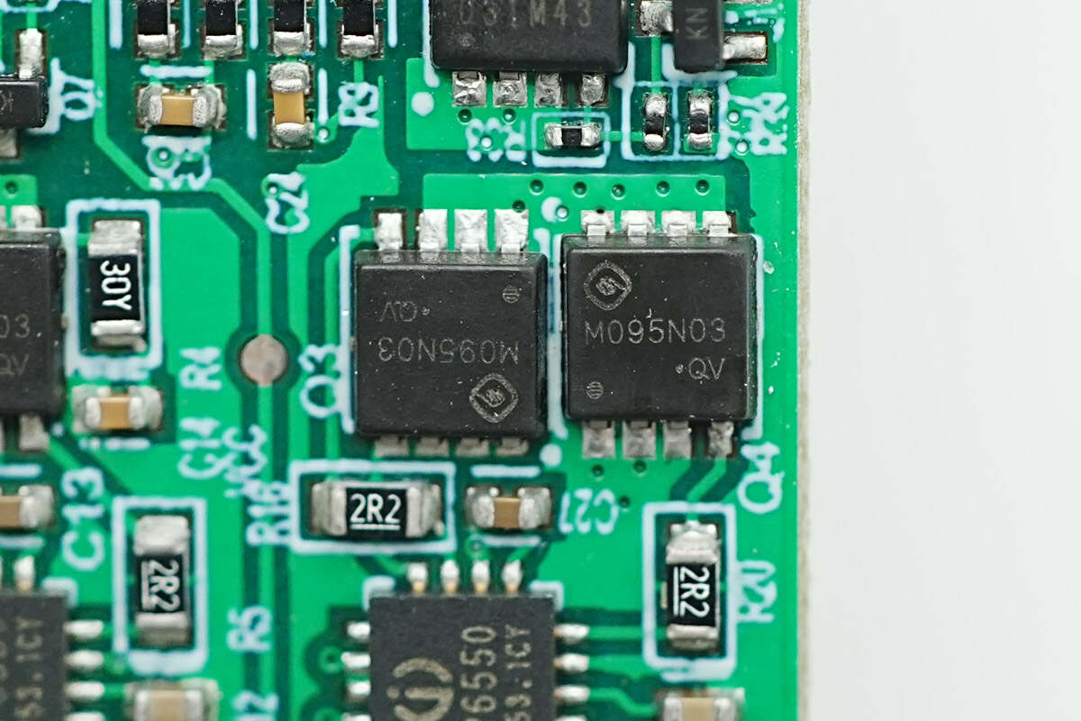

The synchronous buck MOSFET is marked with M095N03.

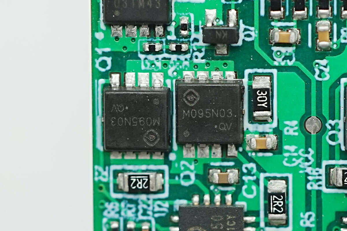

The two synchronous buck MOSFETs on the other output cable are the same model as the previous ones.

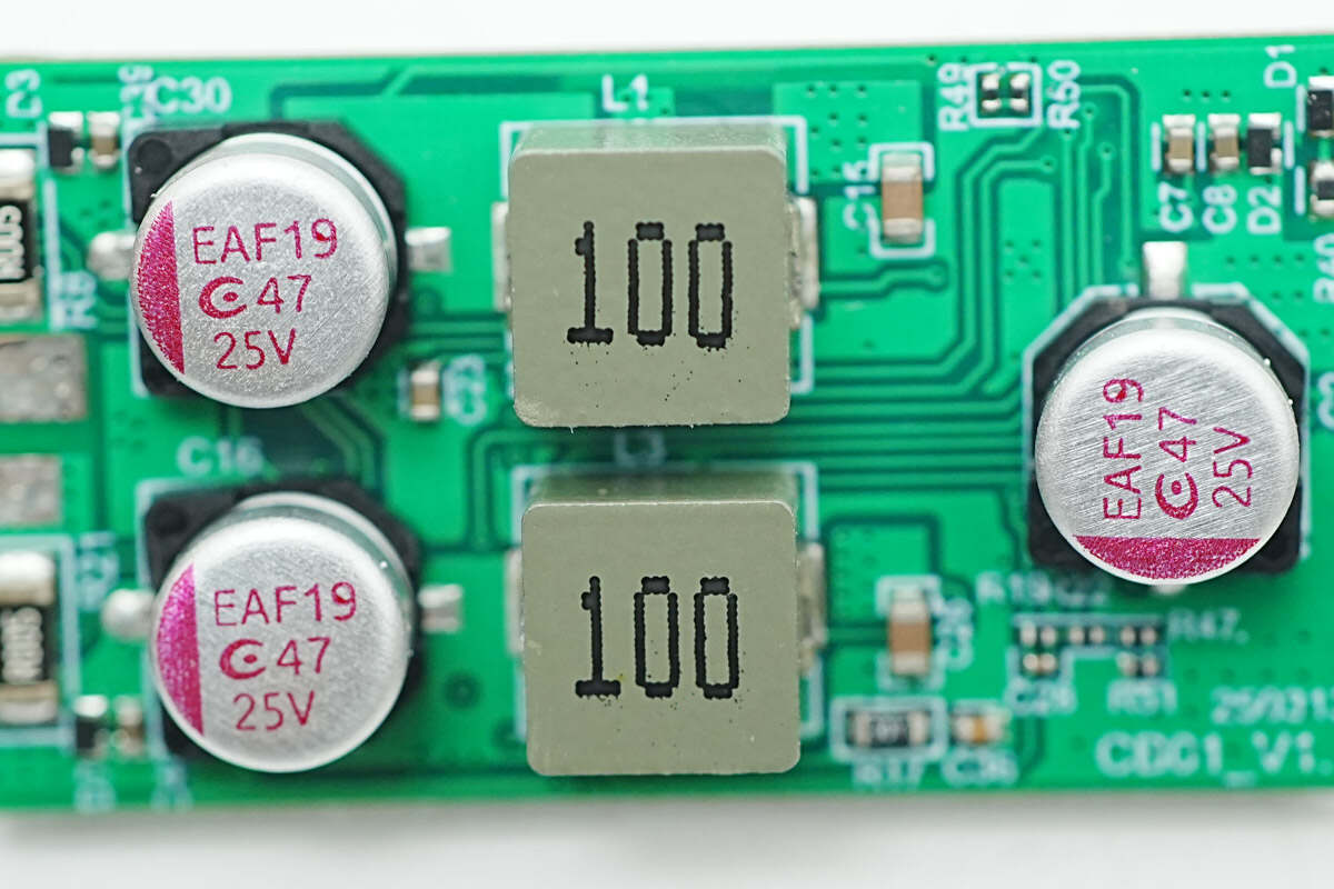

There are two alloy inductors. 10μH.
The two buck output filtering solid capacitors are also from APAQ. 25V 47μF.

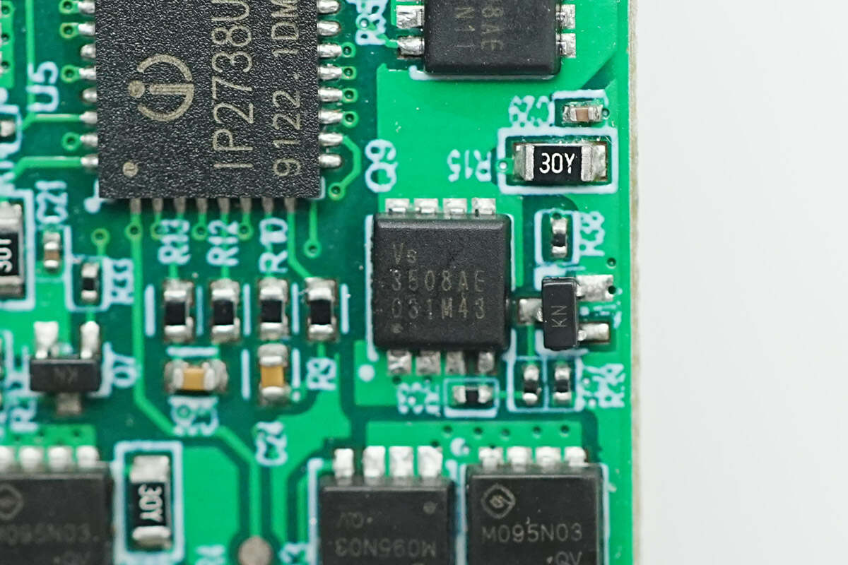

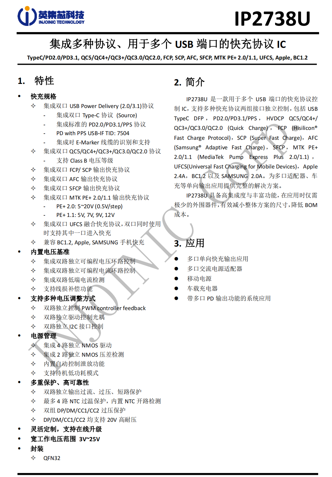

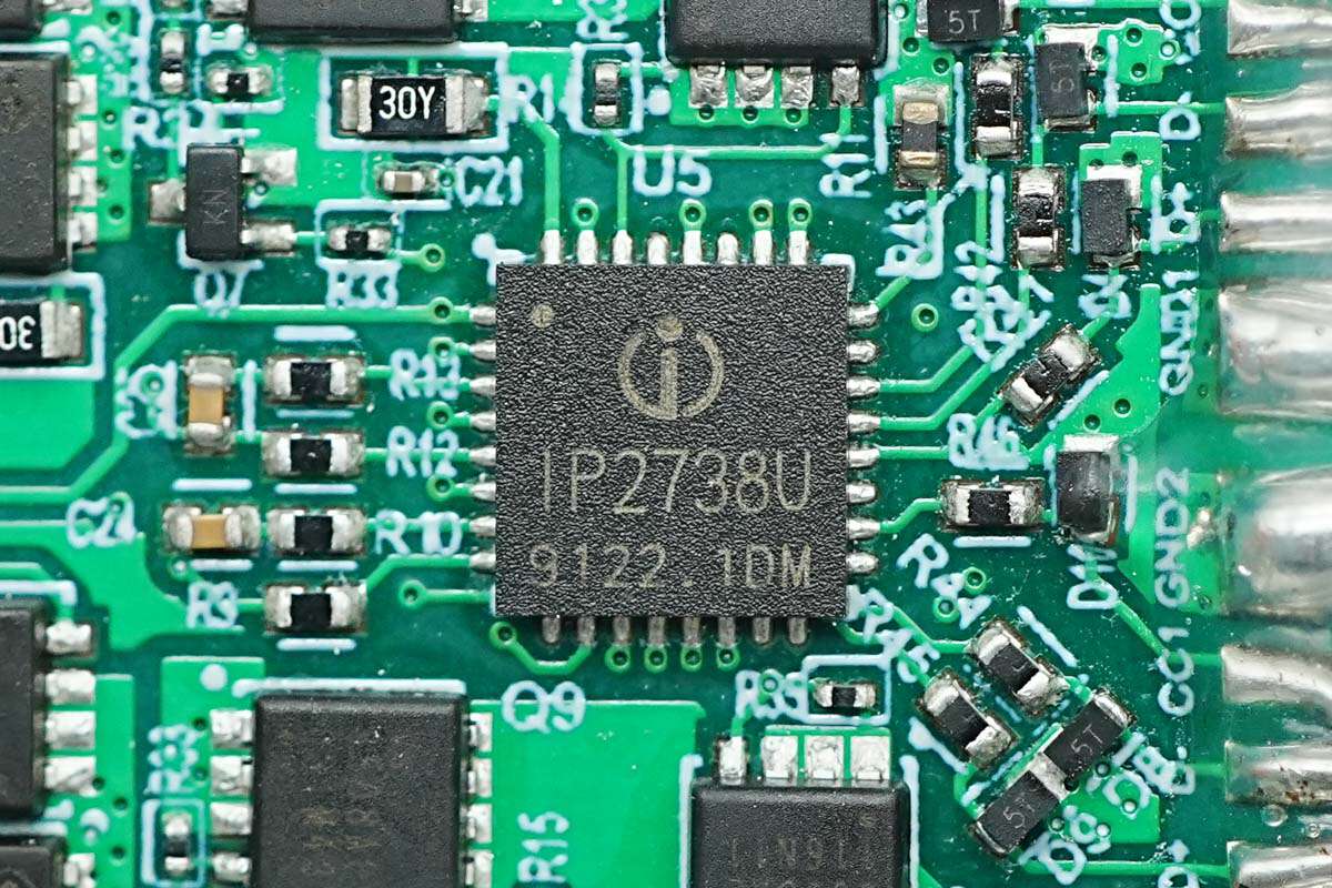

The protocol chip is from Injoinic. It supports multiple USB ports and dual-port fast charging applications ranging from 18W to 140W. The chip features independent feedback control and independent USB PD control, effectively integrating two IP2736 chips into one. Its fast charging specifications are identical to the IP2736. It supports USB PD 3.1 with 28V EPR profiles, UFCS fast charging fusion, as well as comprehensive fast charging protocols like PD 3.0 and PPS, ensuring excellent compatibility. Model is IP2738U.
The Injoinic IP2738U integrates four independent NMOS drivers for controlling multiple output interfaces, managing several VBUS MOSFETs for output port switching, and dual power source parallel control. It also supports independent overcurrent, overvoltage, and short-circuit protection on two channels, ensuring safe operation.
Here is the information about Injoinic IP2738U.

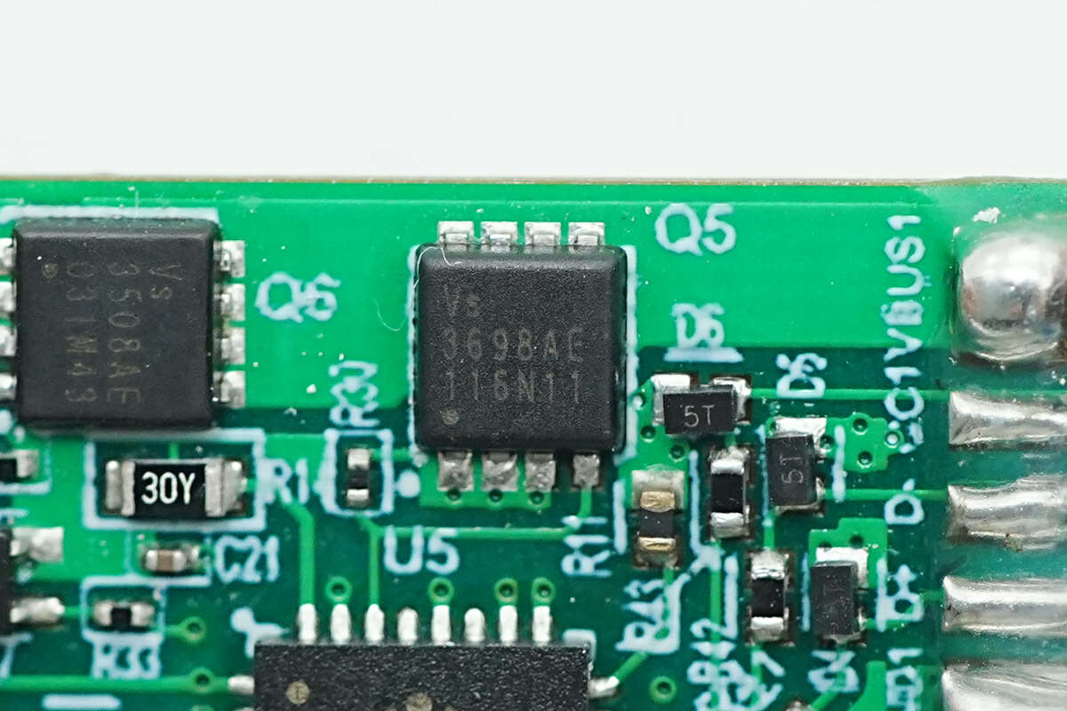

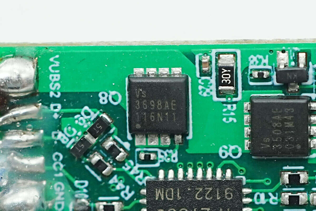

Each of the two outputs uses two Vergiga MOSFETs for output switching control, with the pairs being models VS3698AE and VS3508AE, respectively.
The Vergiga VS3698AE is an NMOS with a 30V voltage rating, 3mΩ on-resistance, and comes in a PDFN3333 package.
Here is the information about Vergiga VS3698AE.

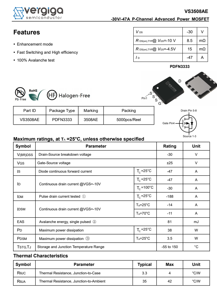

The Vergiga VS3508AE is a PMOS with a 30V voltage rating, 8.5mΩ on-resistance, and comes in a PDFN3333 package.
Here is the information about Vergiga VS3508AE.

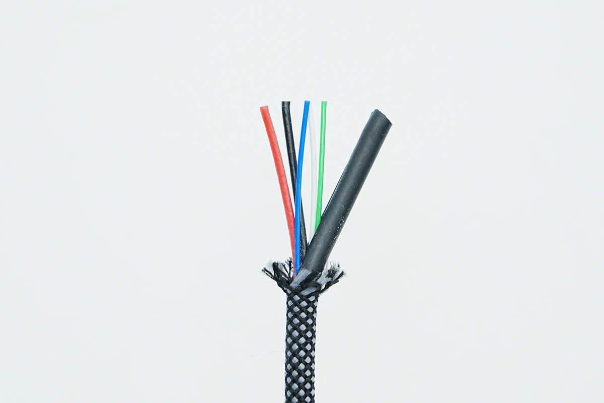

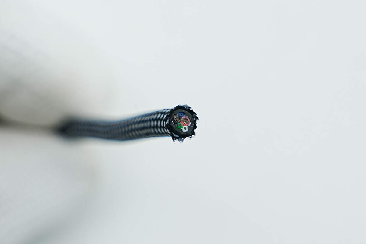

Cut the output cable. Inside, there are five wire cores, differing from the number in the input cable.

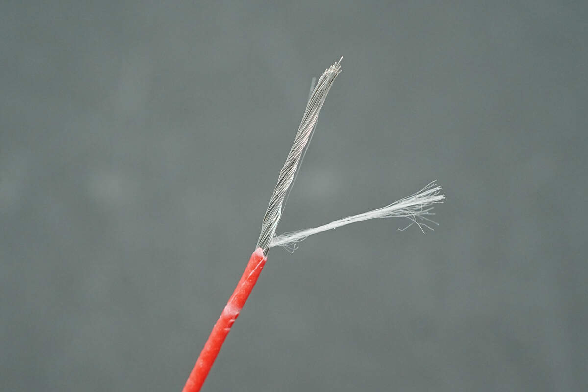

Cut open the jacket. Inside are the red positive power wire, black negative power wire, green D+ wire, white D- wire, and blue CC wire.

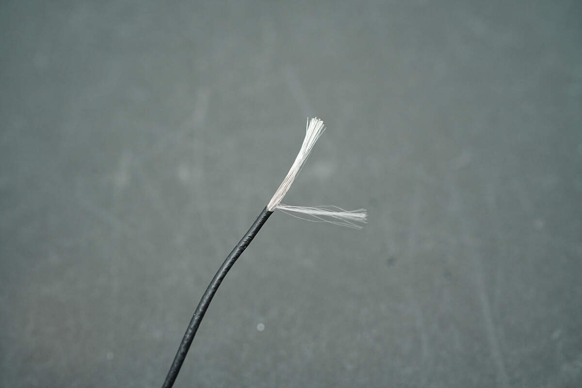

The red positive power wire core contains reinforcement fibers, and the other four wire cores share the same design.
This is the black negative power wire.
The green D+ wire is used for the QC charging protocol.
The white D- wire is also used for the QC charging protocol.
Cut open the USB-C1 connector. The internal design is the same as that of the input connector.
Remove the plastic protective shell. Five wire cores are soldered on one side of the PCB.
There are multiple small capacitors on the other side.
The pins have gold plating on the front ends.
Cut open the USB-C2 connector. The internal structure is the same.
Five wire cores are soldered on the front side of the PCB.
Overview of the other side of the PCB.
Close-up of the pins.

Well, those are all components of the MIIIW CB510 Pro 100W Two-in-One Supercharging Cable.

Here is the component list of the MIIIW CB510 Pro 100W Two-in-One Supercharging Cable for your convenience.
Not only does it feature a sleek and stylish design, but it also uses the same 48-strand braided construction as Apple cables, making it more durable and long-lasting — an ideal companion for various scenarios such as the living room, bedroom, office, or car.
It supports up to 100W fast charging, which is more than sufficient to meet the daily charging needs of most users. In addition, its dual-output design and IDC2.0 conversion module can instantly upgrade older chargers into multi-port fast chargers compatible with brands like Xiaomi, Vivo, and Apple. It also supports intelligent voltage and current distribution, significantly enhancing the user experience.
After taking it apart, we found that it adopts a complete solution featuring the Injoinic IP2133 E-Marker chip, the IP2738U protocol chip, the IP2752 PD controller, and the IP6550 synchronous buck controller. Thanks to this solution, the cable can intelligently recognize different devices and adjust the output voltage and current to distribute power accordingly. Inside the cable, a tensile-resistant wire core design has been added, significantly improving the overall tensile strength and durability of the cable.
