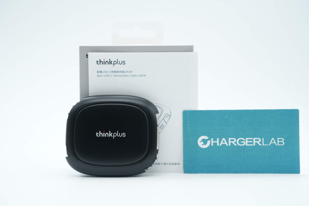

Teardown of Lenovo thinkplus 240W Qlex Dual USB-C Retractable Cable (CBQX240A)-Chargerlab
The package includes the cable and some documents.

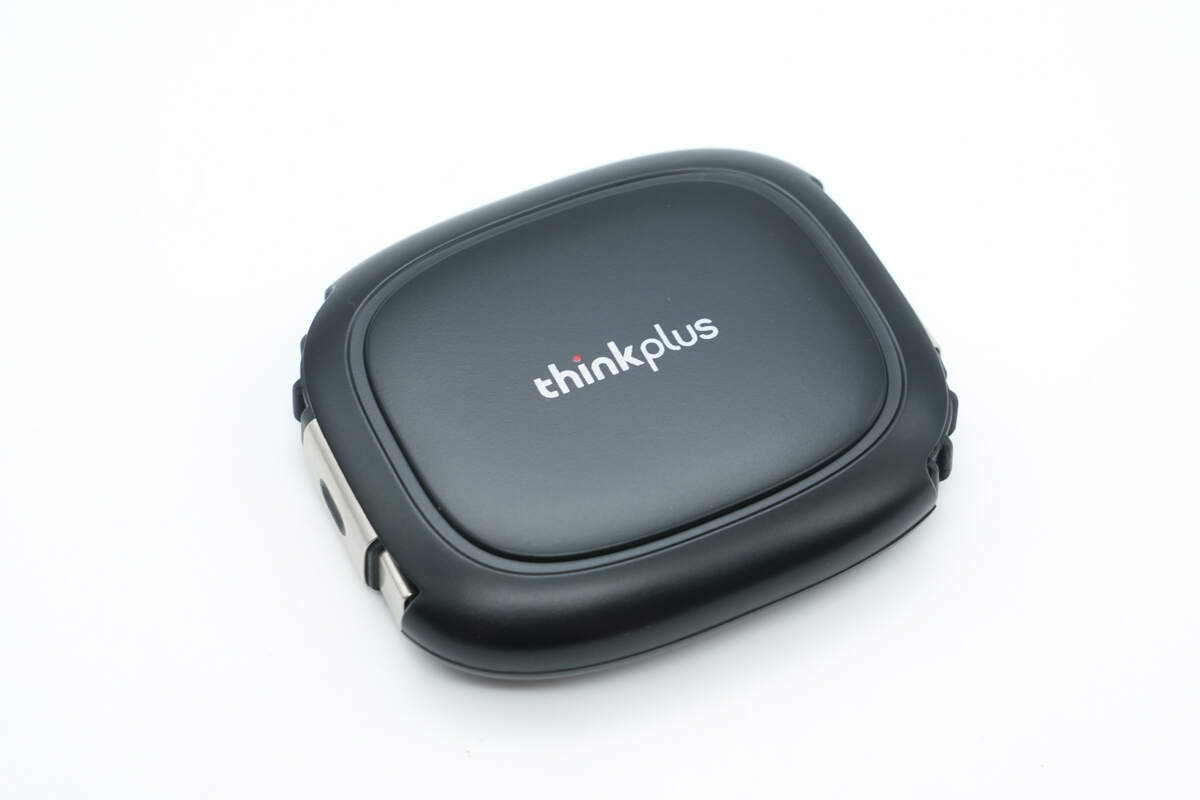

The casing is made of flame-retardant PC material, featuring smooth, rounded edges. It is compact and slim.
The center of the top surface is printed with the thinkplus logo.

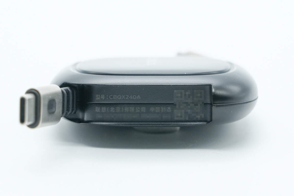

It is marked with the model number CBQX240A.

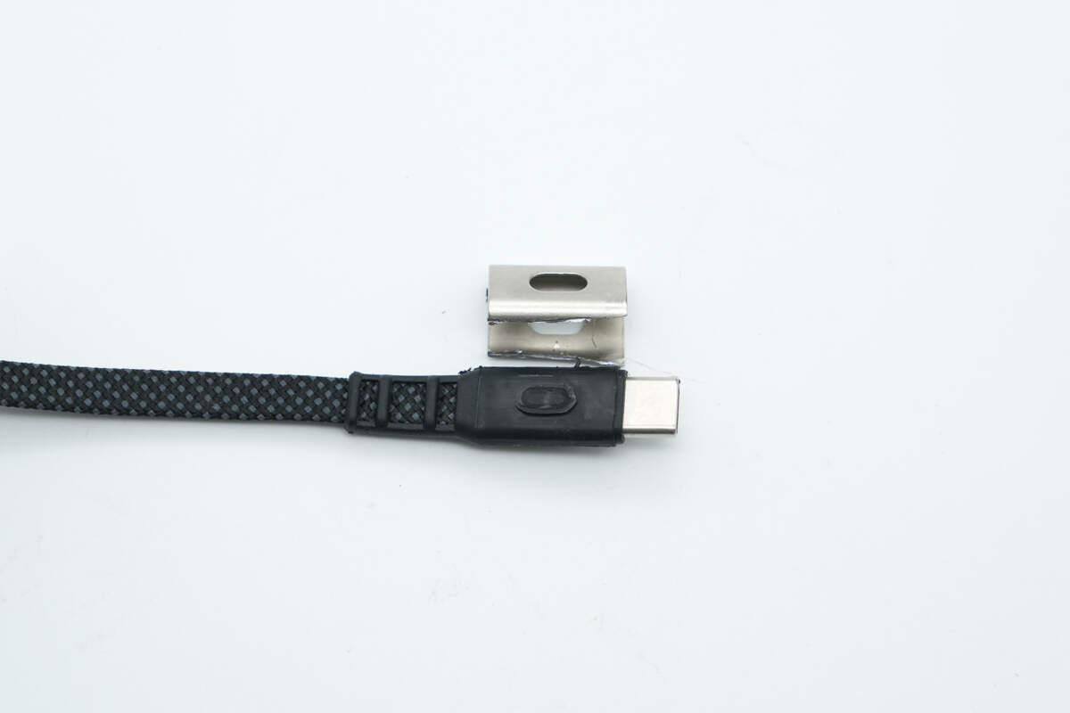

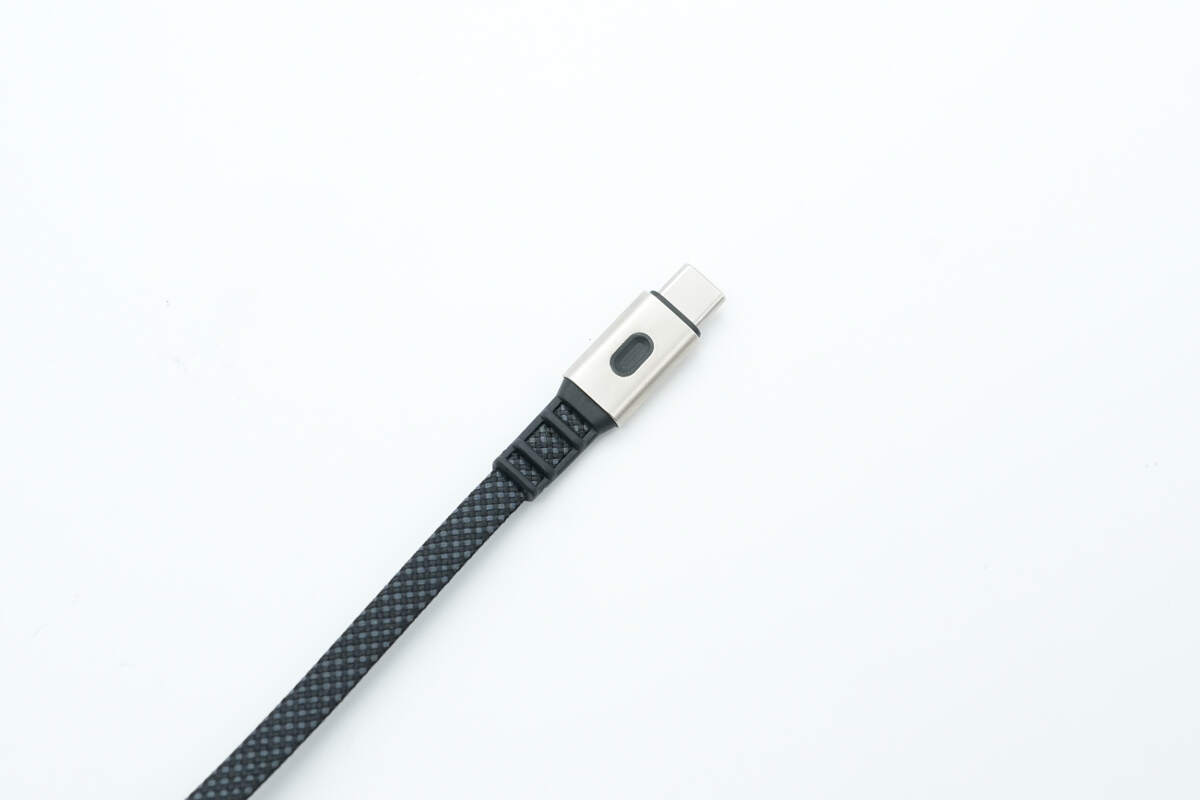

The USB-C connectors feature metal housings. The cable features a flat design with a dual-color braided exterior and meets VM-1 fire resistance standards.

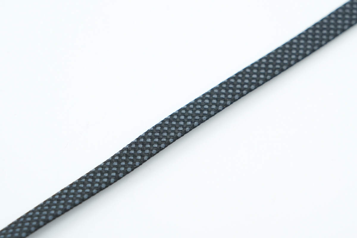

The braided exterior is crafted using a high-density 48-strand weaving technique, enhancing its resistance to pulling, abrasion, and bending.

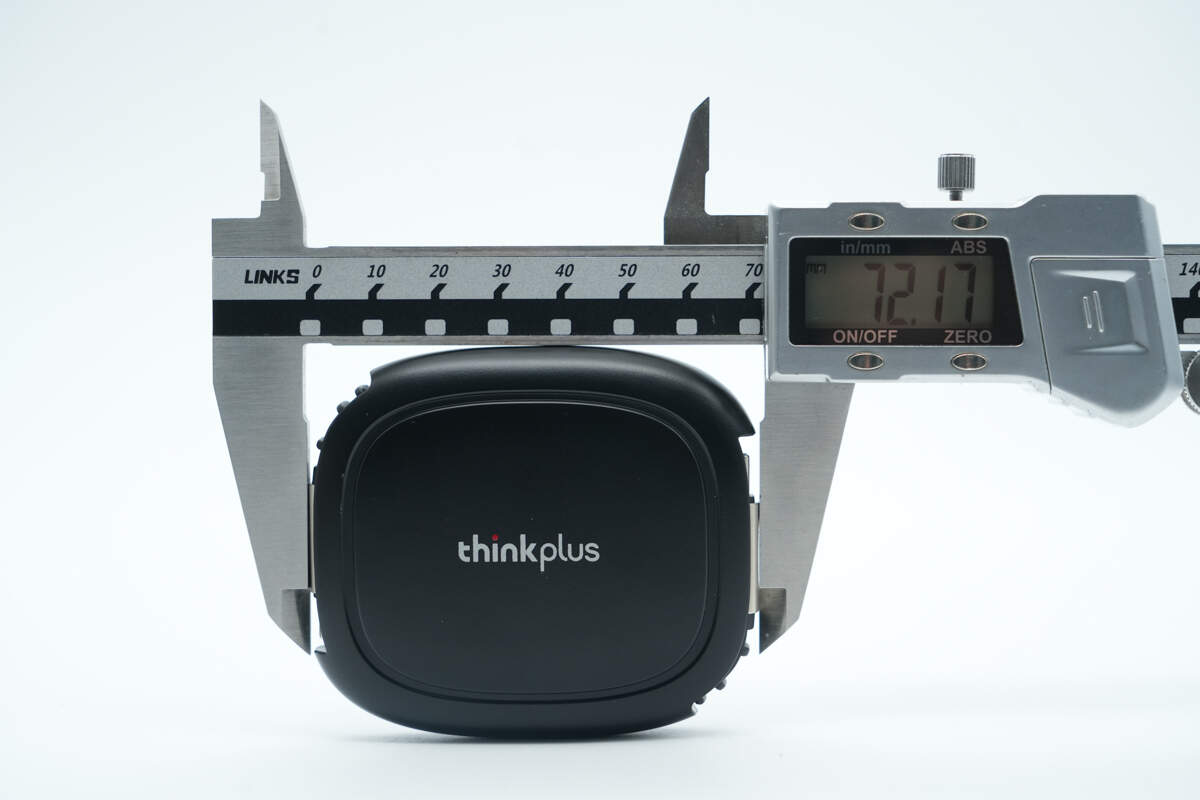

The length of the casing is about 72.17 mm (2.84 inches).

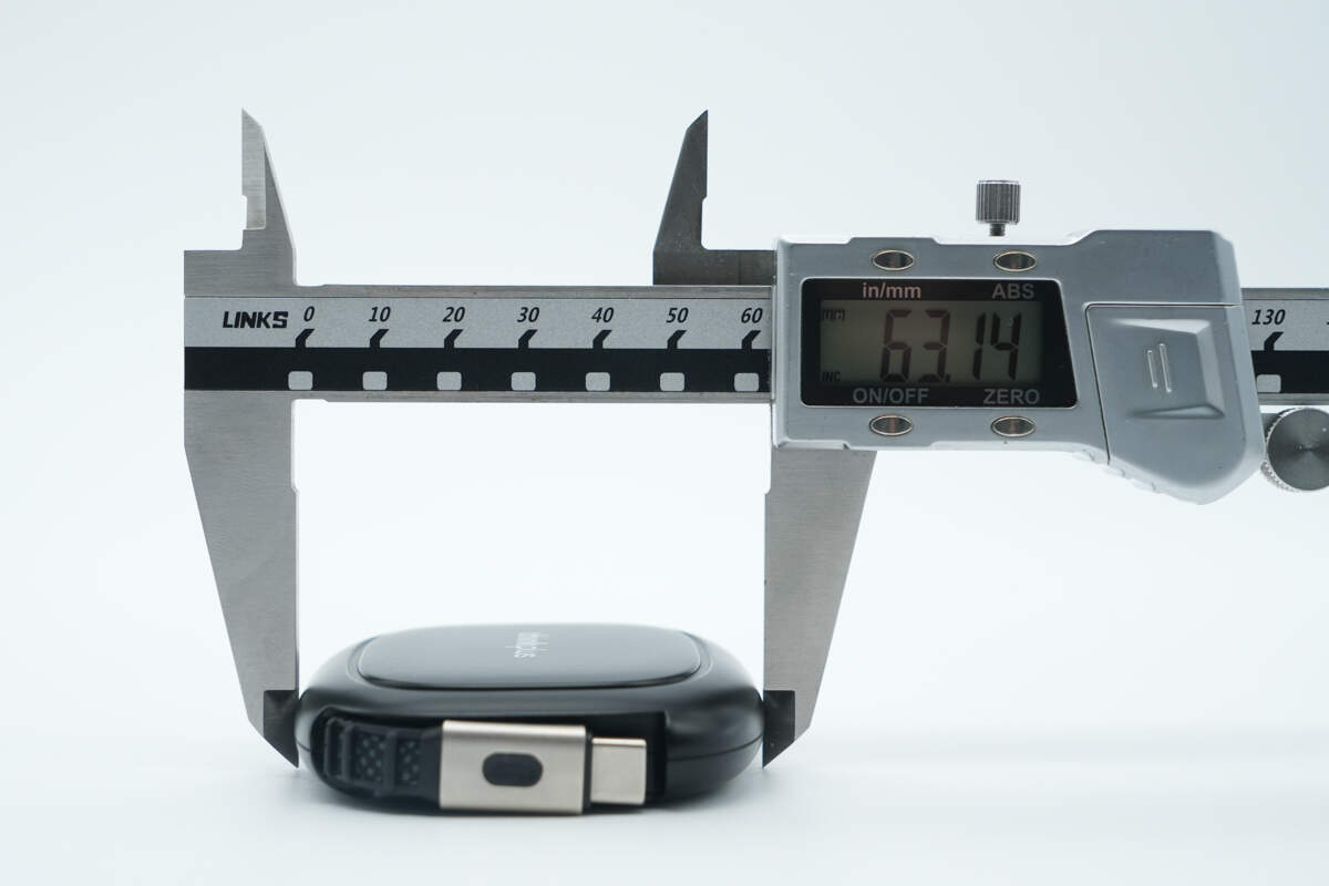

The width is about 63.14 mm (2.49 inches).

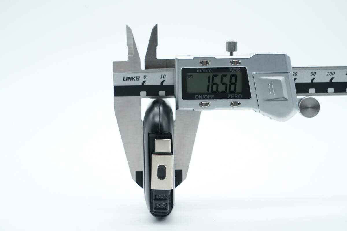

The thickness is about 16.58 mm (0.65 inches).

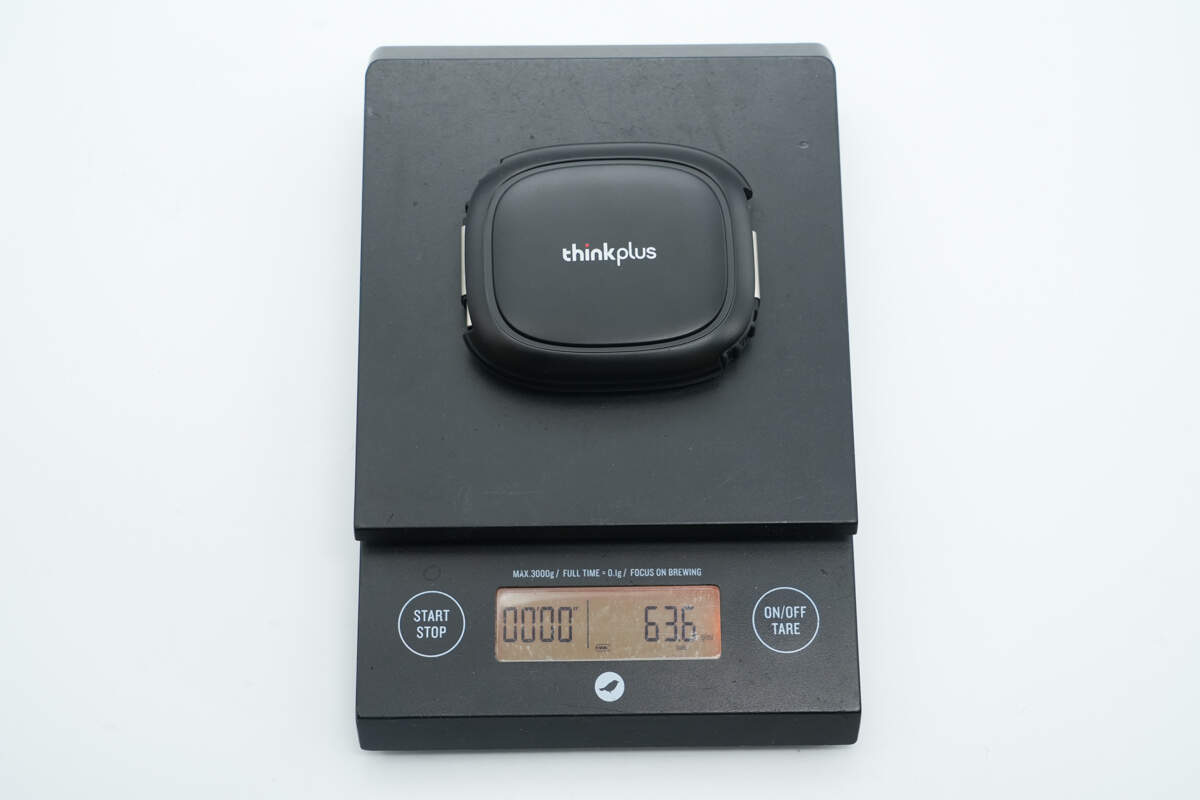

The weight is about 64 g (2.26 oz).

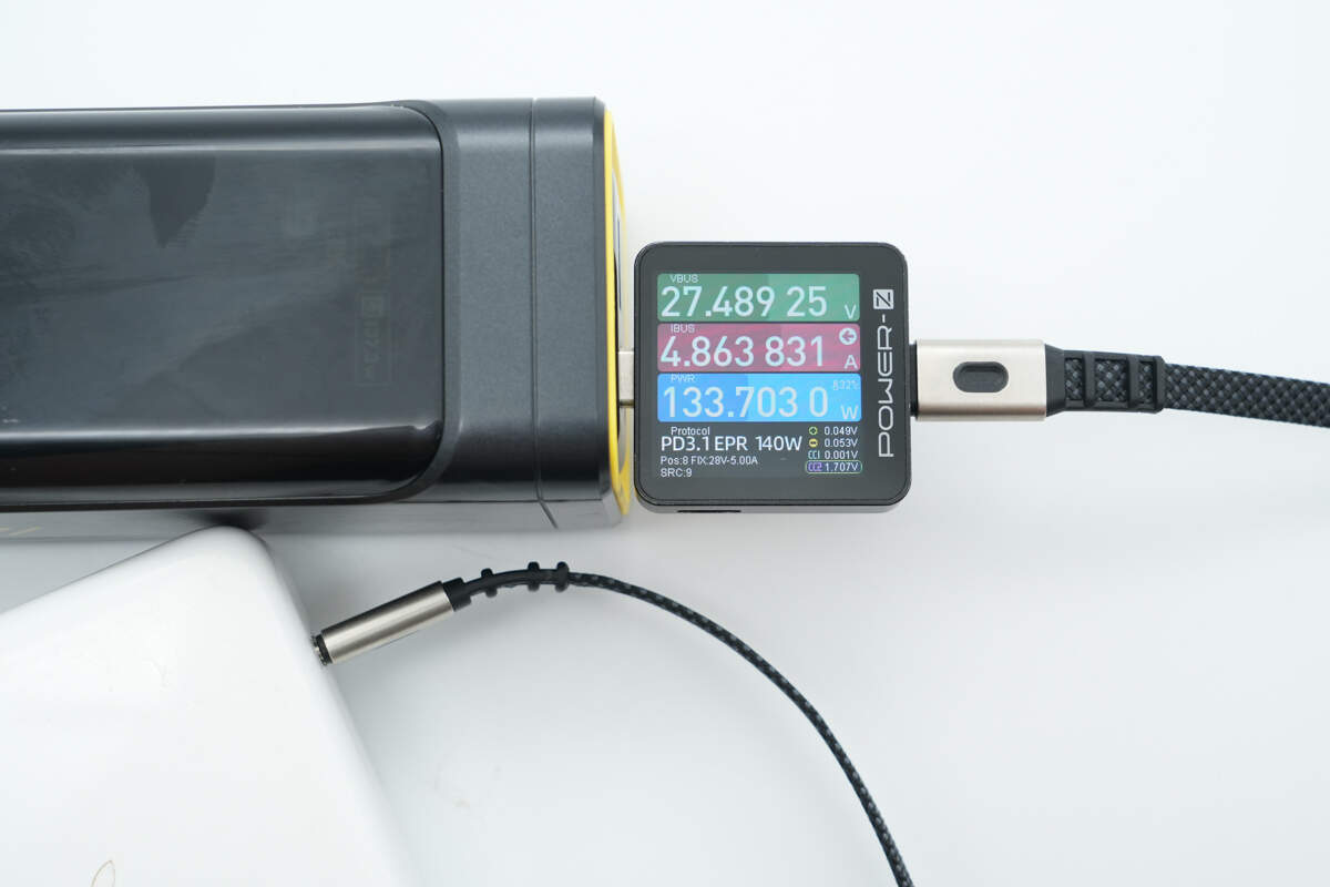

ChargerLAB POWER-Z KM003C shows that it has an E-Marker chip. It supports power delivery up to 50V/5A (240W) and data transfer at USB 2.0 speeds.
When paired with the Apple 140W charger to charge the Aohi 240W PD 3.1 power bank, the cable successfully triggered PD 3.1 fast charging at 28V/5A, delivering about 133.7W of power.

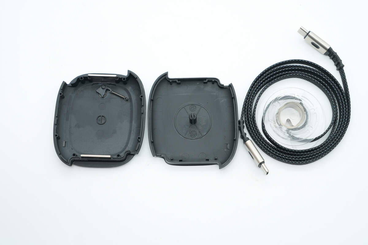

Open the casing and take out the retractable cable.
Both ends of the casing are secured with magnetic plates.
At the center of the cable is an alloy pivot with a bi-directional turbine mechanism, ensuring smooth retraction and quick storage.

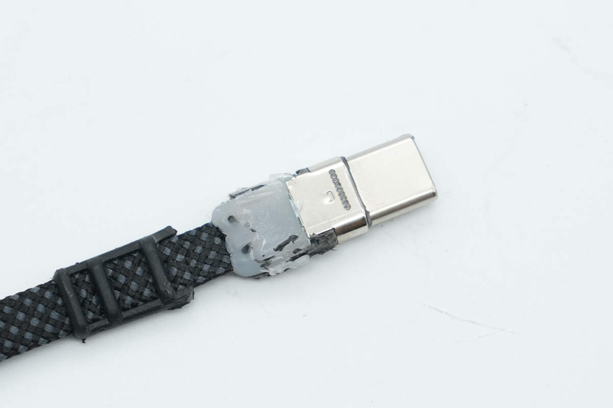

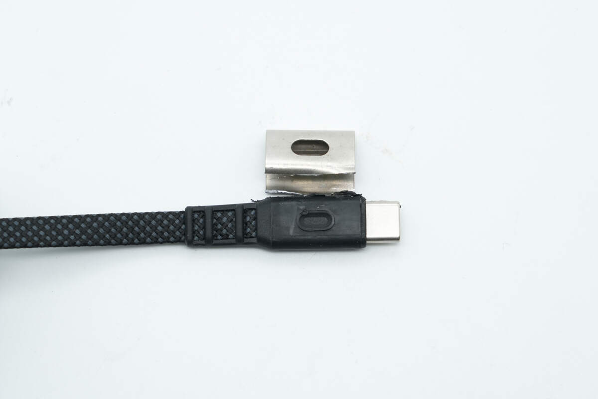

After disassembling the metal housing of the USB-C connector, the interior is revealed to be filled with injection-molded material for added durability and structural integrity.
After removing the black plastic, the PCB is sealed with a hard potting compound and encased in a steel sleeve for protection.

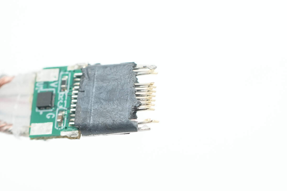

The PCB has an E-Marker chip mounted on one side.

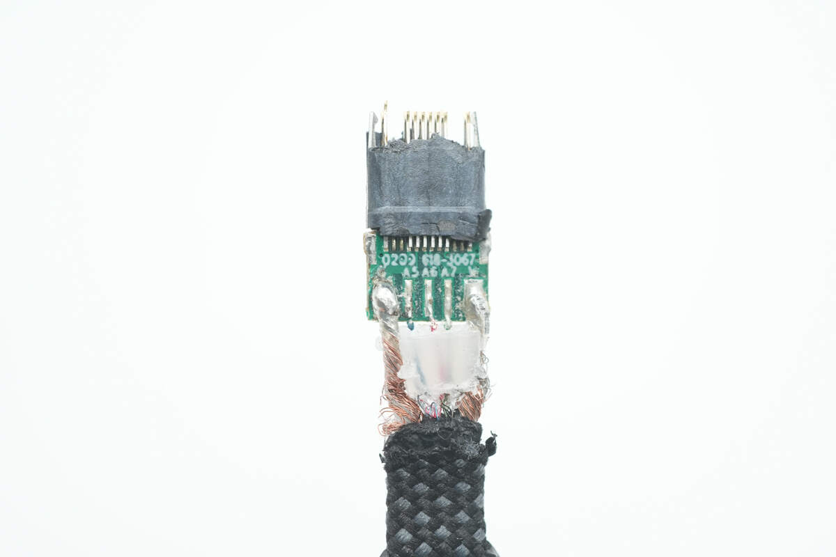

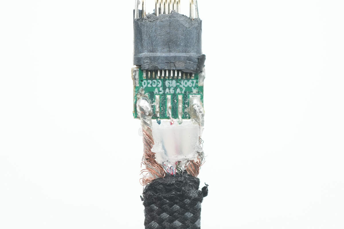

The other side of the PCB is soldered with the wires.

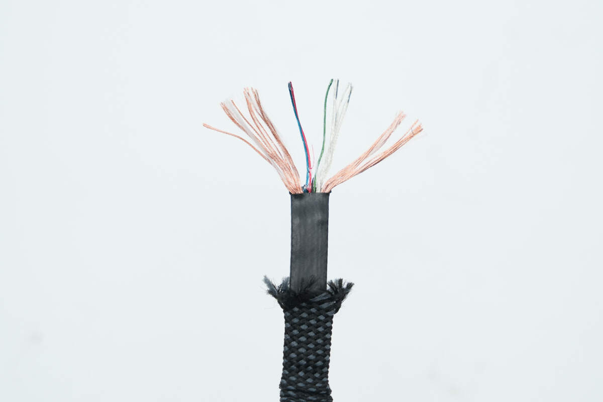

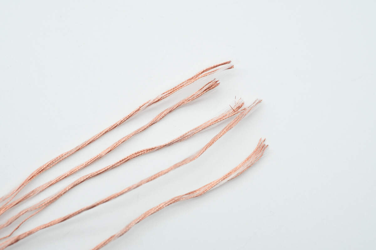

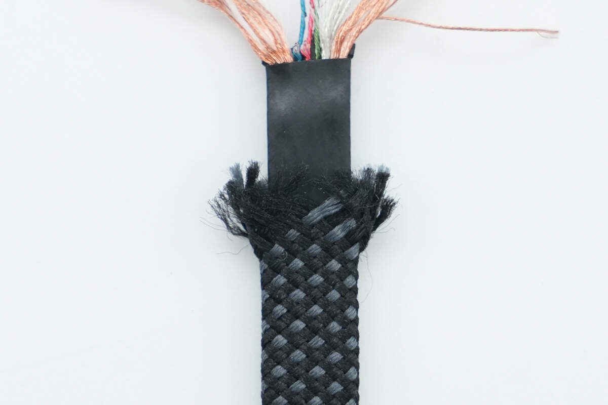

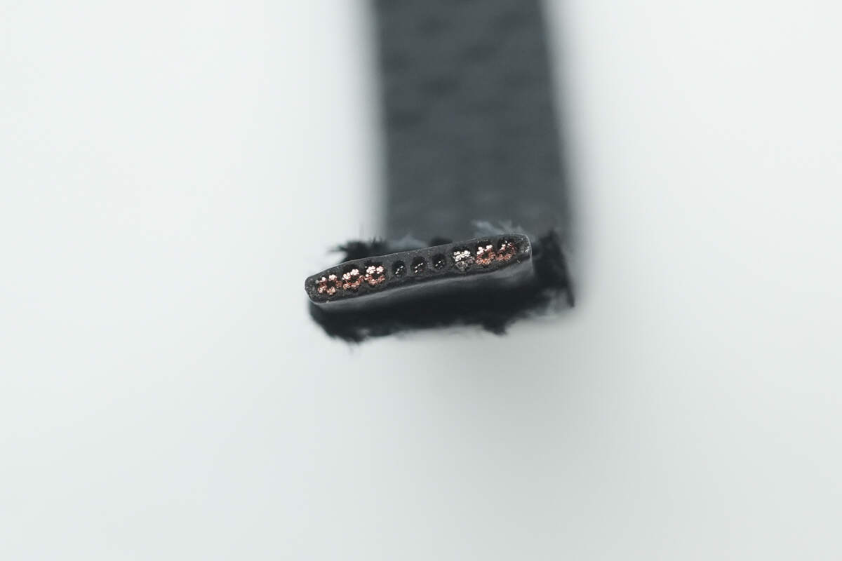

After cutting the cable, nine individual wire cores were found inside.
The cable cores include reinforcement fibers for tensile strength. The positive and negative wires are coated with insulating varnish, while the three middle wires are coated with colored varnish.

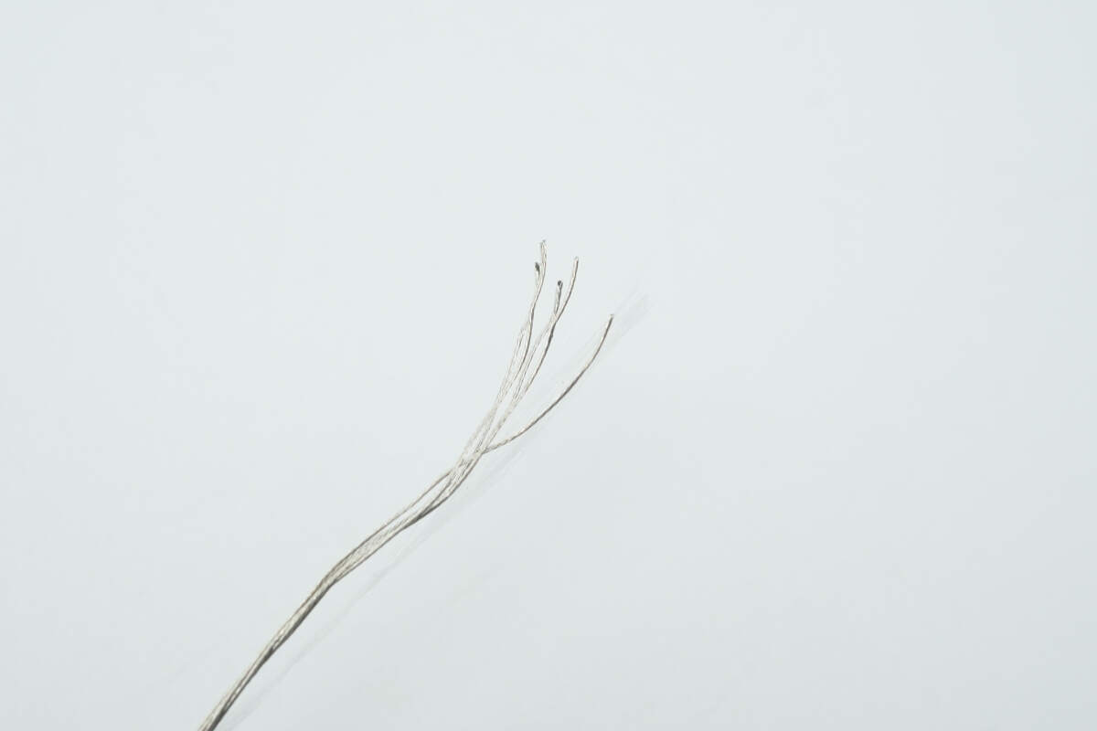

All nine wire cores are enamel-coated wires. Among them, five are positive power conductors, each reinforced with tensile-strengthening fibers.。
Close-up of the negative power core.
The wire core used for USB 2.0 transmission has a red-colored core representing the D+ line.
The green wire represents the D- line.

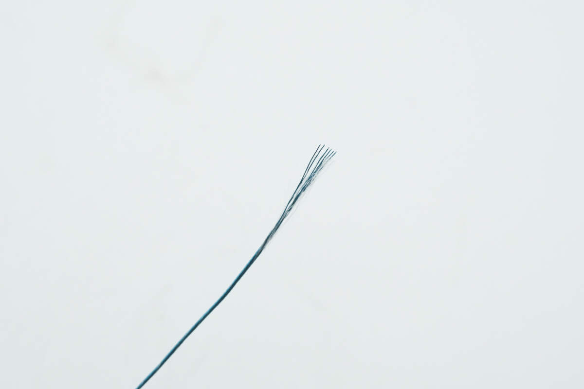

Close-up of the blue CC wire core.
The outer sheath uses an ultra-thin 3D dual-color braided design with 48 strands tightly interwoven, providing stronger tensile strength. This makes the cable more resistant to unraveling, breakage, and wear, enhancing its durability.

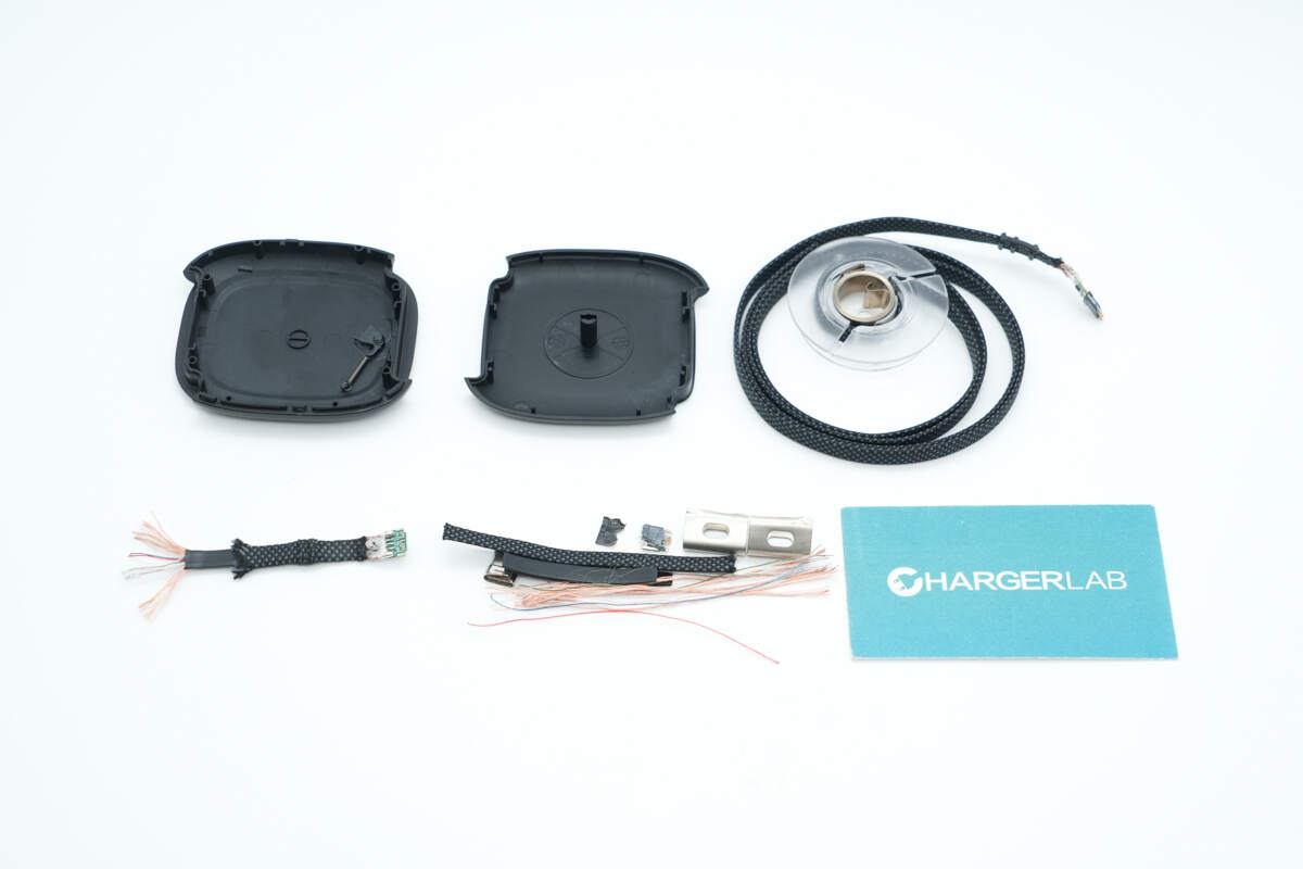

Well, those are all components of the Lenovo thinkplus 240W Qlex Dual USB-C Retractable Cable.
The Lenovo thinkplus 240W Qlex Dual USB-C Retractable Cable innovatively combines a retractable cable with a compact housing, keeping your setup neat and clutter-free. The casing is designed to be exceptionally small and lightweight, measuring just 16.4mm thick and weighing only 65g, making it highly portable. The cable itself is flat with a braided outer jacket, providing tangle resistance and excellent durability against pulling and everyday wear.
It has also passed over 10,000 bending tests and more than 20,000 plug-and-unplug cycles, ensuring durability for frequent use. With 240W power delivery and 480Mbps data transfer speeds, it meets everyday charging and office file transfer needs.
After taking it apart, we found that it uses the Hynetek HUSB332E E-Marker chip, which enables intelligent identification of fast-charging devices and controls voltage and current for safe, low-temperature fast charging that protects the device. The connector is reinforced with hard potting compound, injection molding, and steel sleeves for protection. The cable cores are enamel-coated wires reinforced with tensile-strength fibers to enhance durability.
