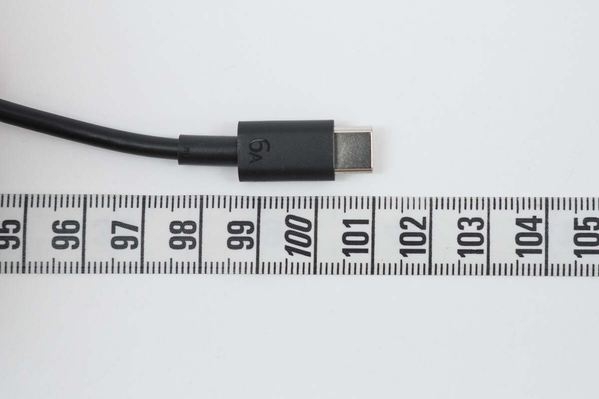

The connectors are engraved with "6A".
Teardown of HUAWEI 100W SuperCharge Car Charger (P0019)-Chargerlab
ChargerLAB POWER-Z KM003C shows that it has an E-Marker chip and supports power delivery of 20V 5A, enabling 100W PD fast charging.

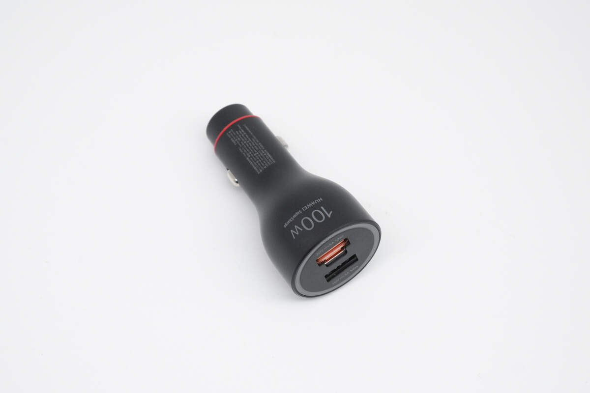

It features a flame-retardant PC casing with a matte finish.
This side is printed with the HUAWEI logo and the CQC certification mark, among others.
This side is printed with "100W HUAWEI SuperCharge" along with specification information.

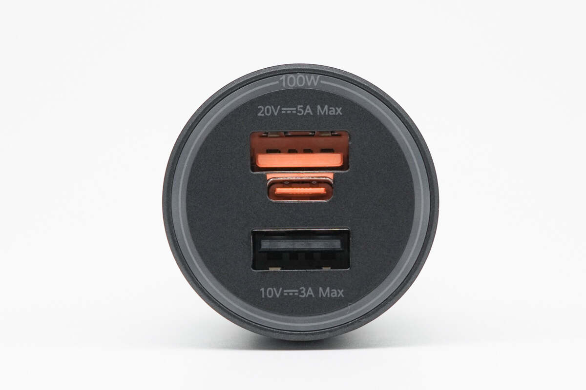

The top features a combined USB-A/USB-C port and a USB-A2 port, with a light ring around the edge.

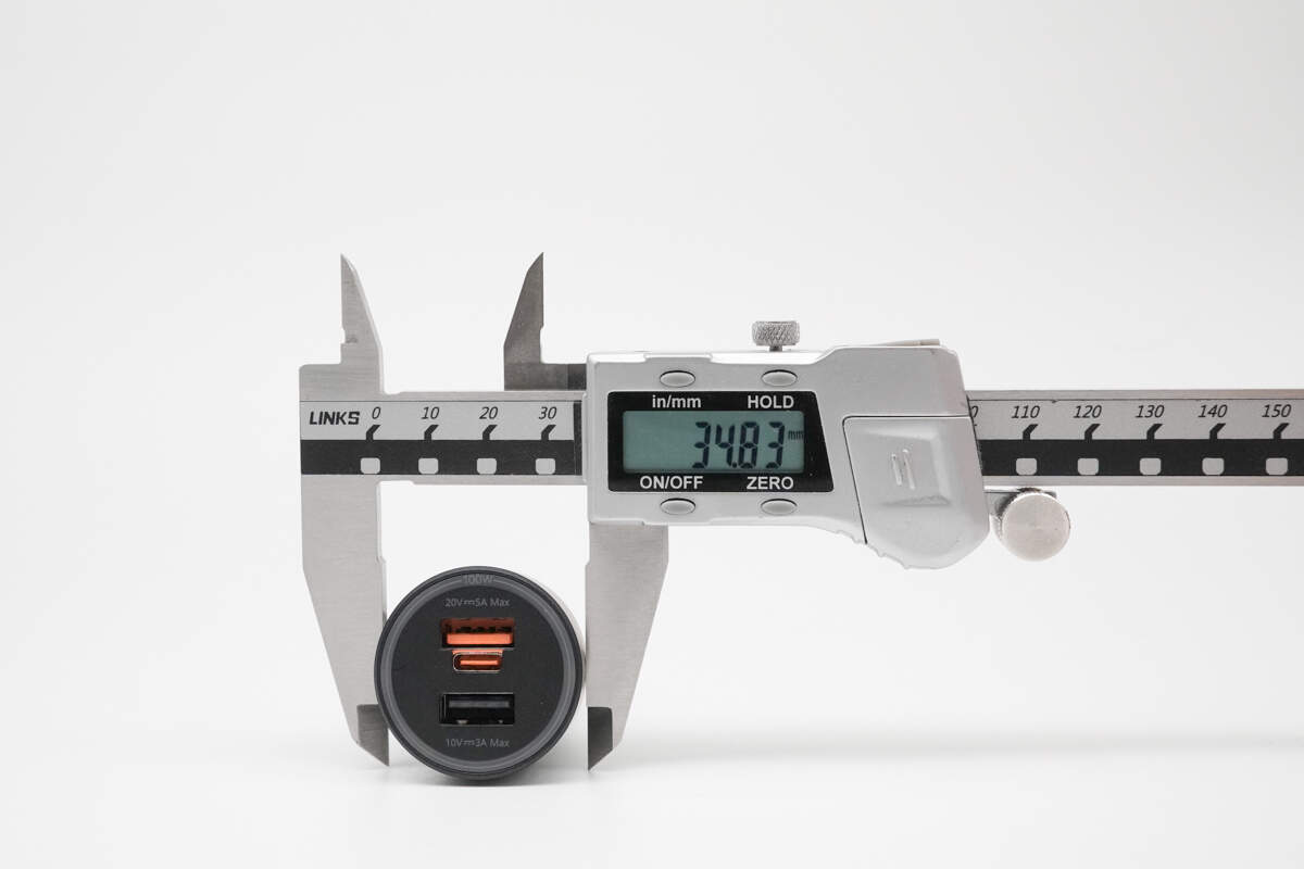

The length of the charger is about 74.74 mm (2.94 inches).
The diameter of the top is 34.83 mm (1.37 inches).

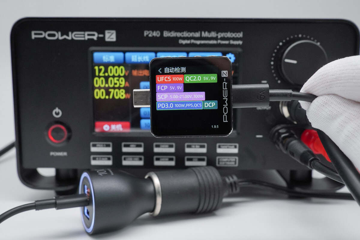

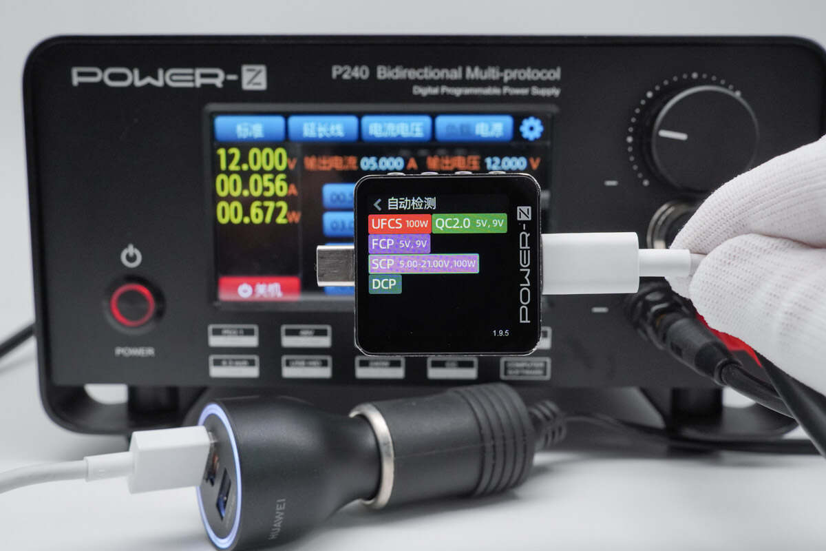

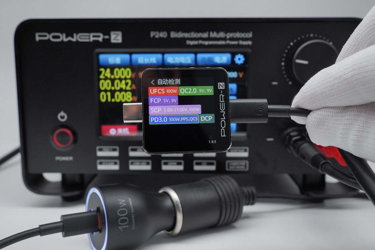

Simulating a 12V DC input, the USB-C1 port was found to support UFCS, QC2.0/5, FCP, SCP, PD3.0, PPS, and DCP charging protocols.
And it has five fixed PDOs of 5V3A, 9V3A, 12V3A, 15V3A, and 20V5A. It also has a set of PPS, which is 5.5-21V 5A.

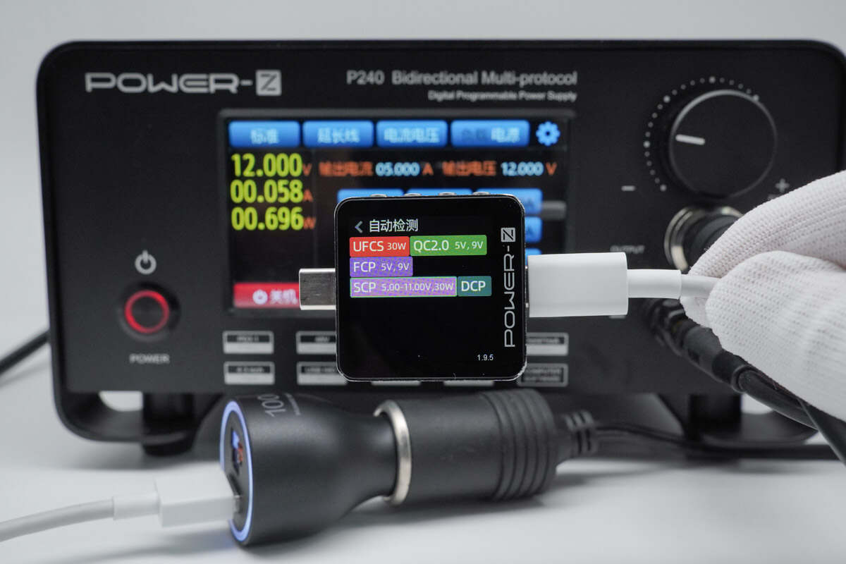

The USB-A1 port was found to support UFCS, QC2.0, FCP, SCP, and DCP charging protocols.

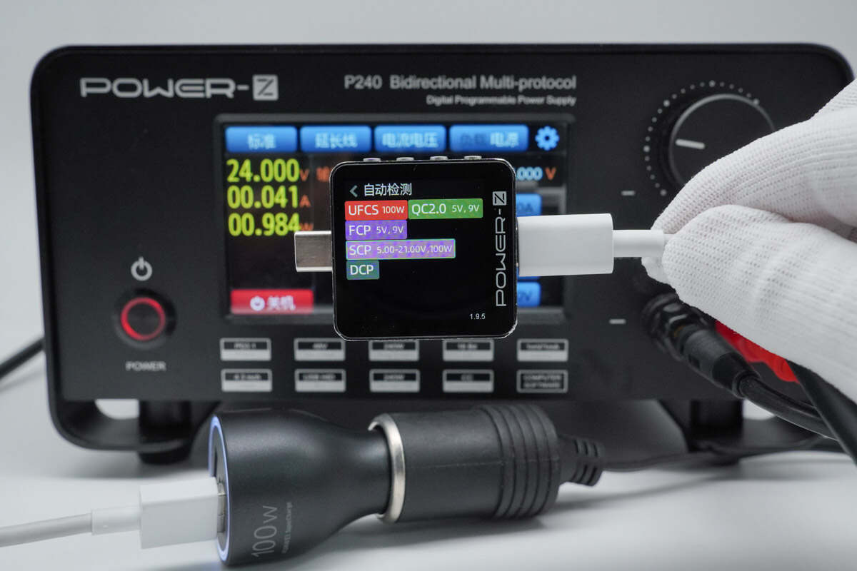

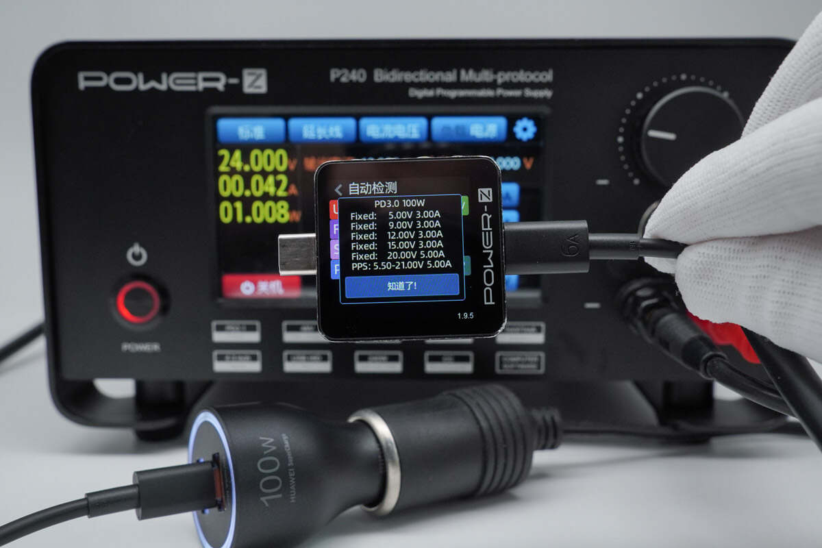

When simulating a 24V DC input, the USB-C1 port was found to support the same charging protocols as with a 12V DC input.
Additionally, the PDO messages are also the same.

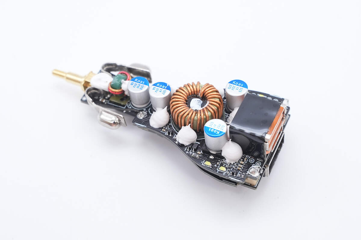

The PCBA module uses a double-layer design, with components such as capacitors and inductors reinforced with adhesive.

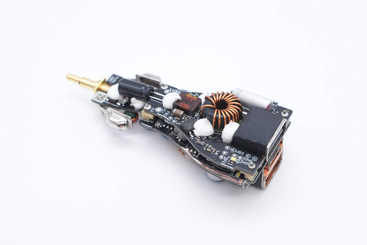

Components such as capacitors and inductors on the other PCB are also reinforced with adhesive, and both USB-A sockets are insulated.

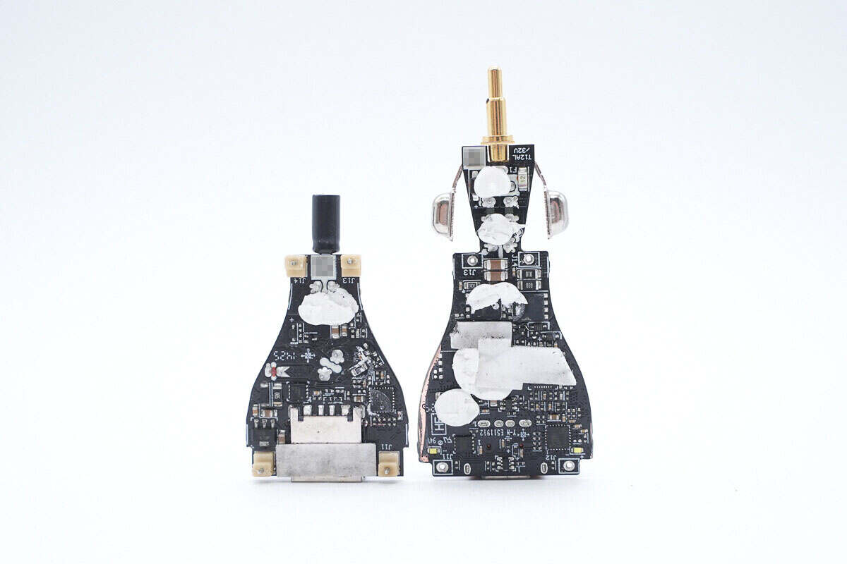

Separate the two PCBs, with a thermal pad between them to help dissipate heat.

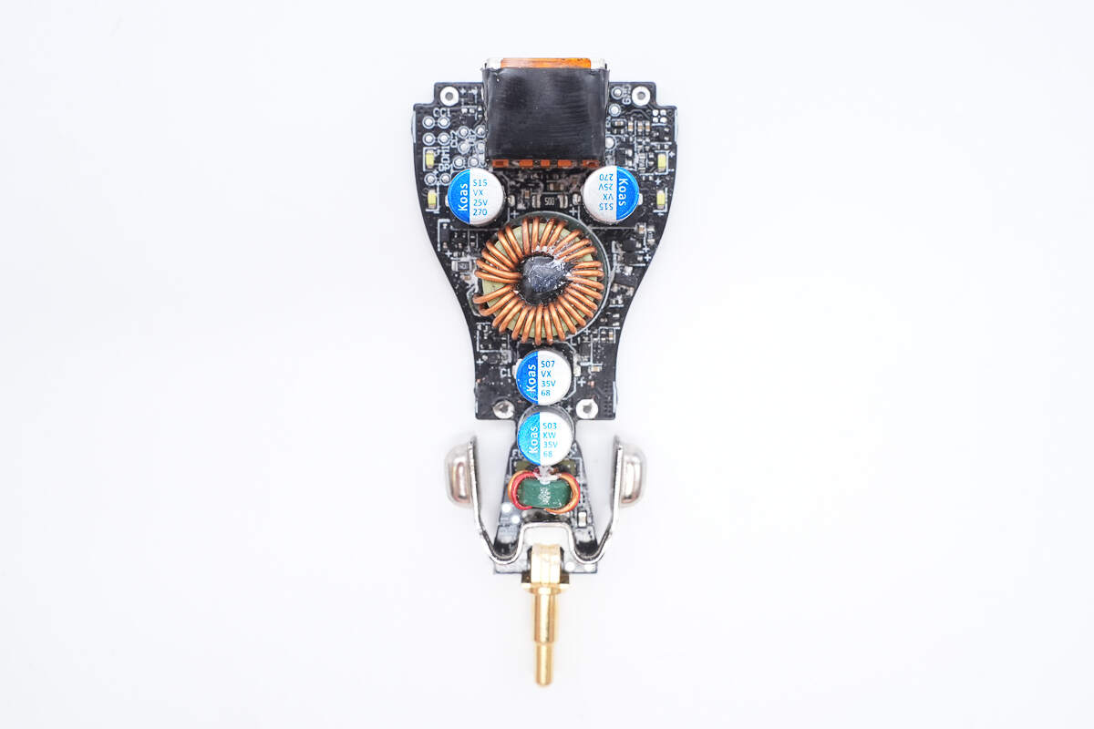

The front side of the PCB with the combined port is equipped with components such as a filter inductor, filter capacitor, and buck-boost inductor.
On the back are a synchronous buck-boost controller, a buck-boost MOSFET, a protocol chip, and a VBUS MOSFET.

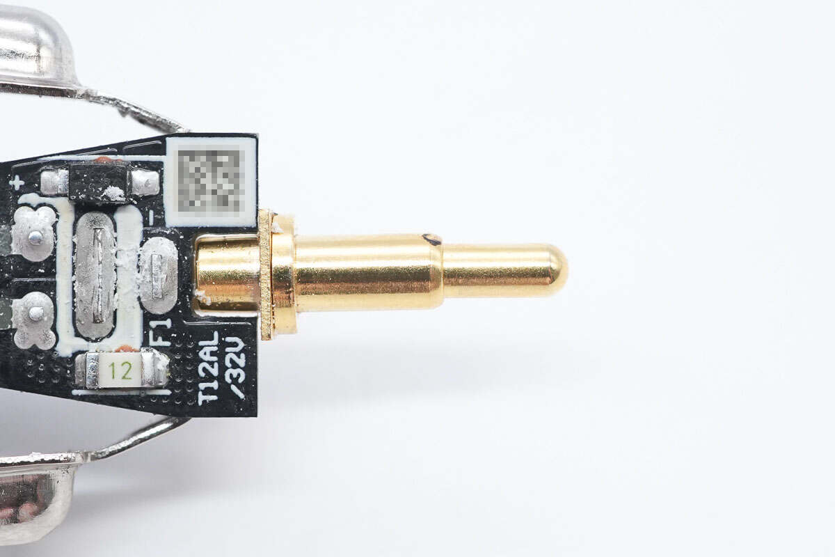

The positive conductive copper post is gold-plated.
Close-up of the SMD fuse.

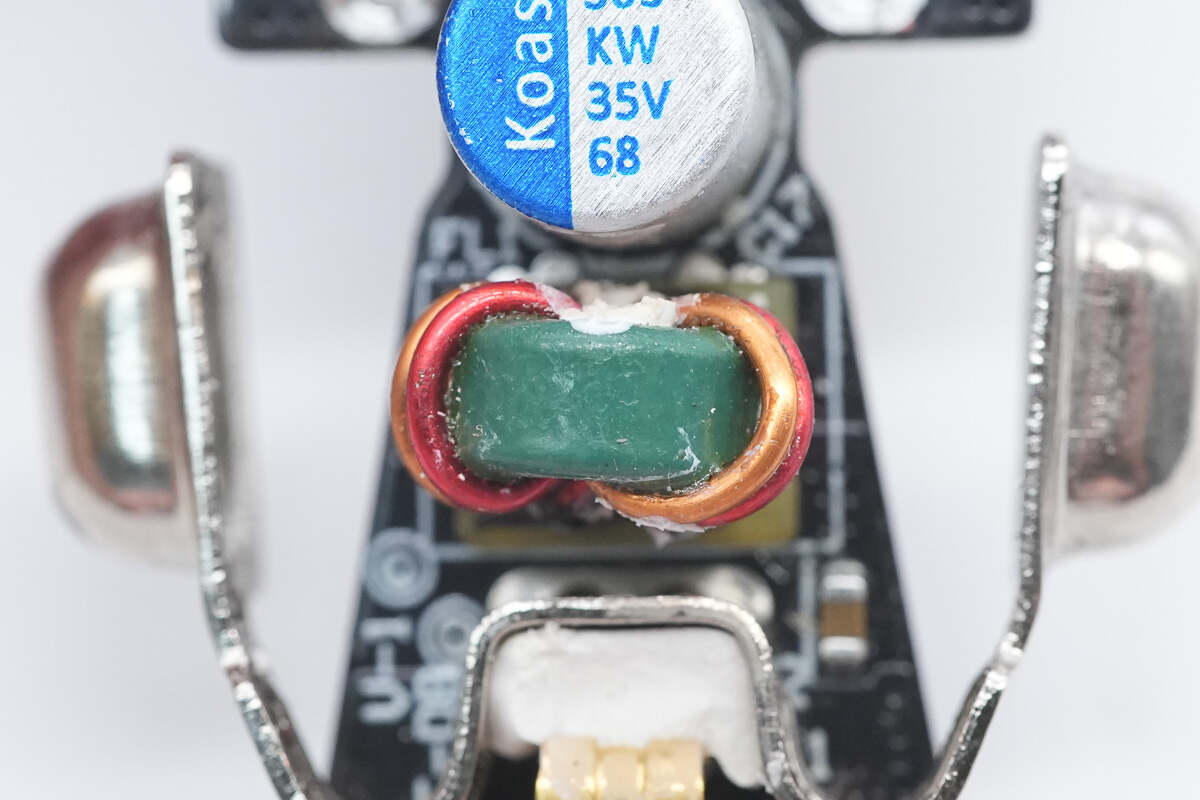

Close-up of the input filter inductor.
Both solid capacitors are rated at 35V 68μF.

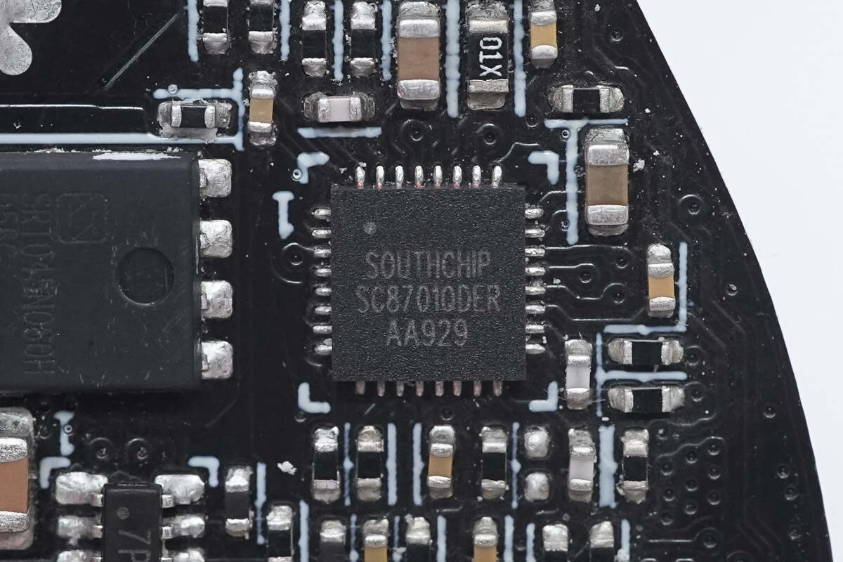

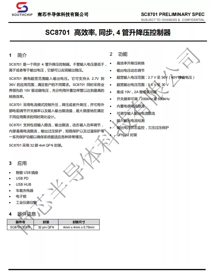

The synchronous buck-boost controller is from SouthChip, model SC8701. It is a 4-switch synchronous buck-boost controller capable of efficiently regulating the output voltage regardless of whether it is higher, lower, or equal to the input voltage. It supports a wide input and output voltage range, with input from 2.7V to 36V and output from 2V to 36V. The driver voltage is set to 10V to fully utilize external MOSFETs for maximum efficiency.
Here is the information about SouthChip SC8701.

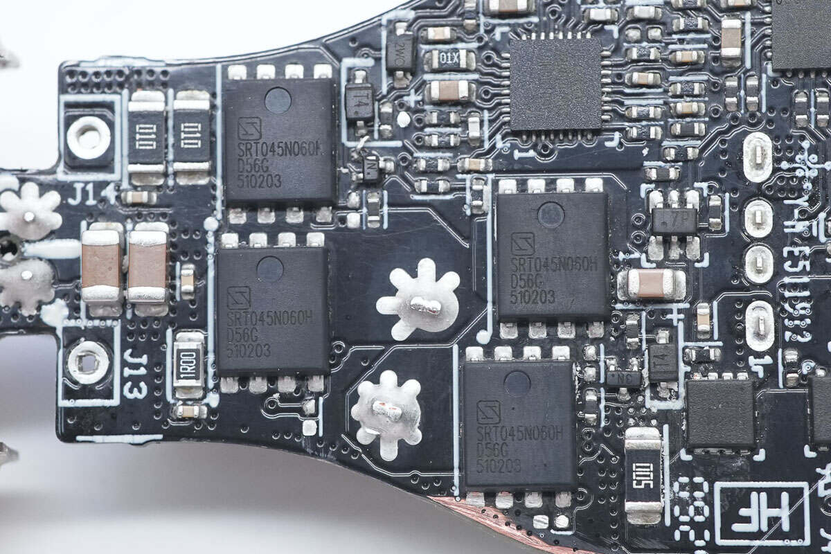

The four external synchronous buck-boost MOSFETs are model SRT045N060H. These are 45V-rated N-channel MOSFETs with an on-resistance of 5.1mΩ and come in a PDFN 5×6 package.

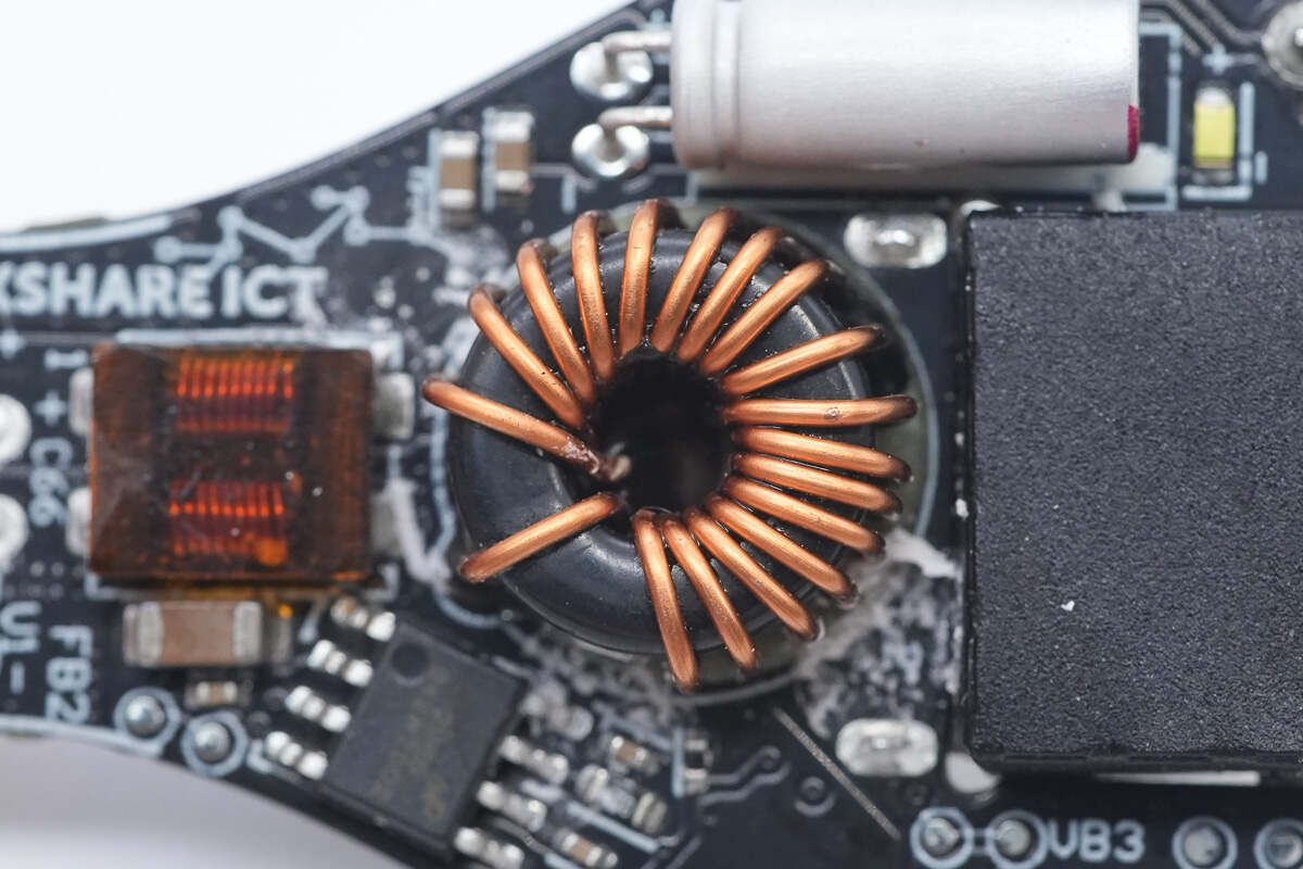

The buck-boost inductor is wounded with magnetic ring, and it's also insulated with bakelite.

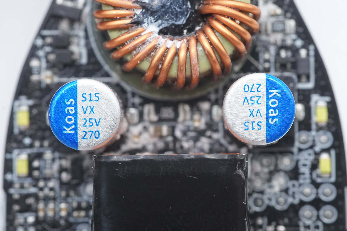

The two output filter capacitors are also from Koshin, each rated at 25V 270μF.

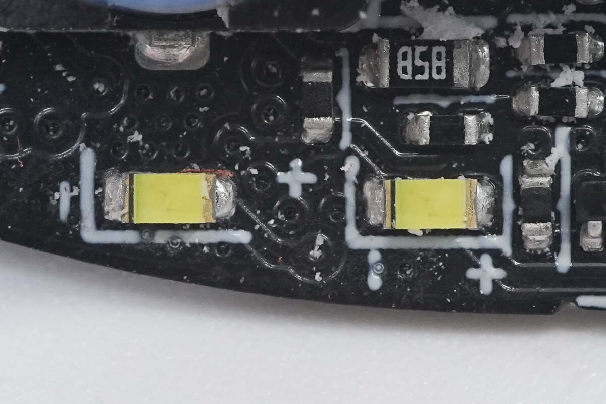

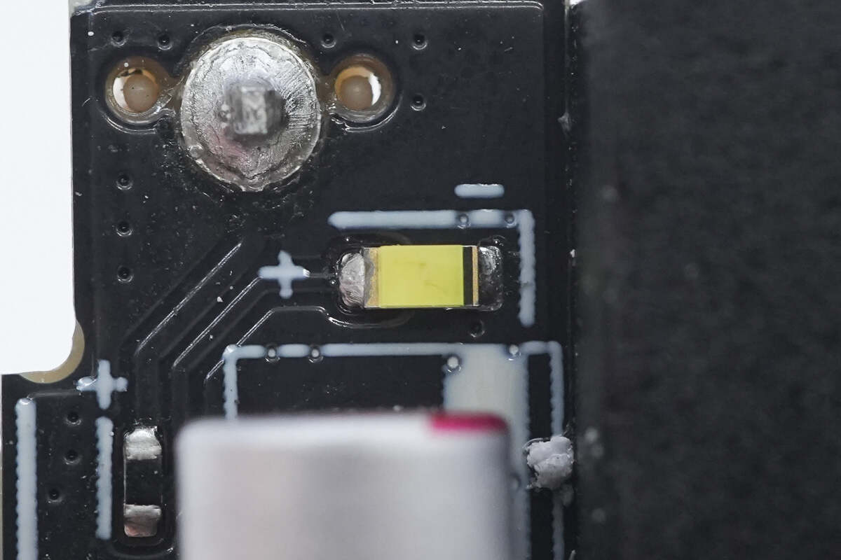

Close-up of the LED indicators located at the edge of the PCB.
Close-up of the LED indicators on the other edge of the PCB.

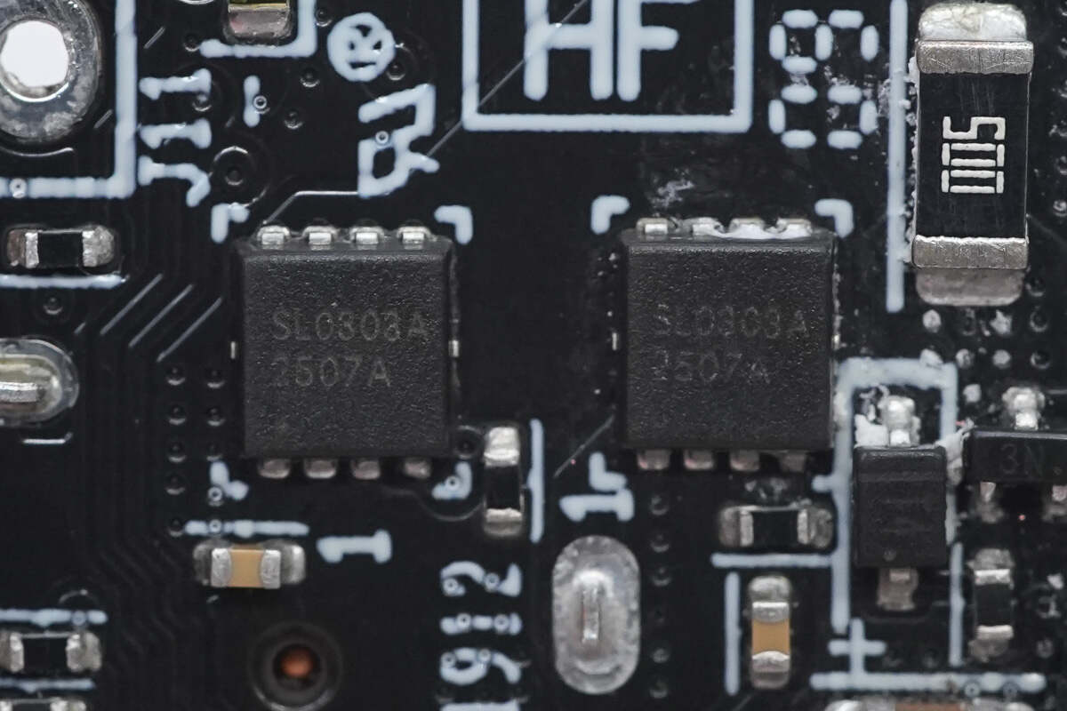

The two VBUS MOSFETs are from JieJie, model JMSL0303AU. These are 30V-rated N-channel MOSFETs with an on-resistance of 1.8mΩ, housed in a PDFN 3×3-8L package.

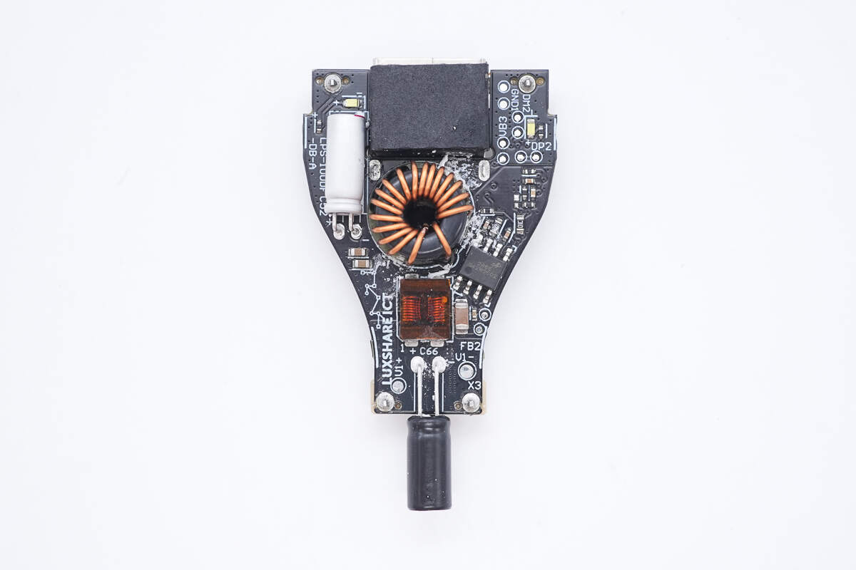

The front side of the other PCB features a filter inductor, capacitors, a synchronous buck converter, and a buck-boost inductor.
The other side has the protocol chip, output VBUS MOSFET, and the USB-A2 socket.
The solid capacitor for input filtering is also from Koshin, rated at 35V 68μF, and is insulated with heat-shrink tubing.
Close-up of the SMD filter inductor. The PCB is marked with "LUXSHARE ICT," indicating it is manufactured by Luxshare Precision.

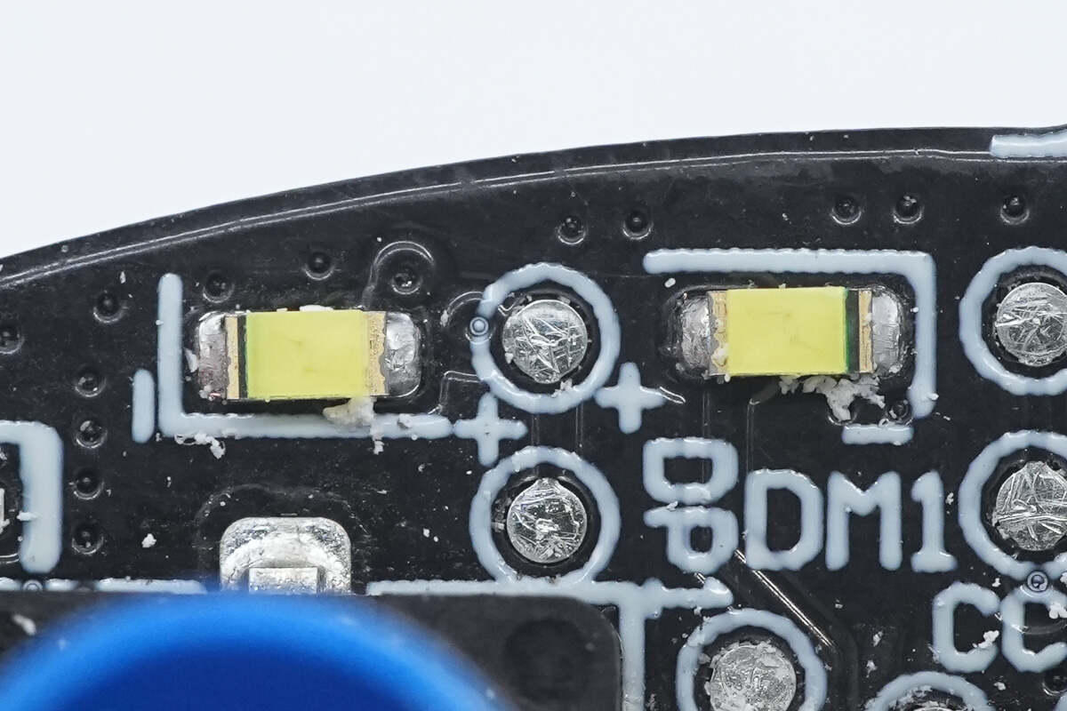

Close-up of the indicator LED on the PCB.
Close-up of the other indicator LED.

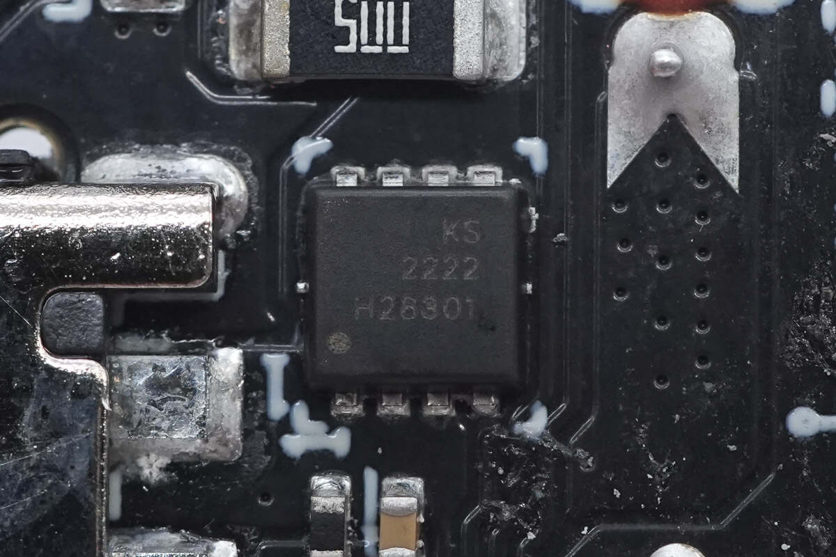

The output VBUS MOSFET is from Kwansemi, model KS2222. It is a 20V-rated N-channel MOSFET with an on-resistance of 5.9mΩ, packaged in a PDFN 3×3×3.

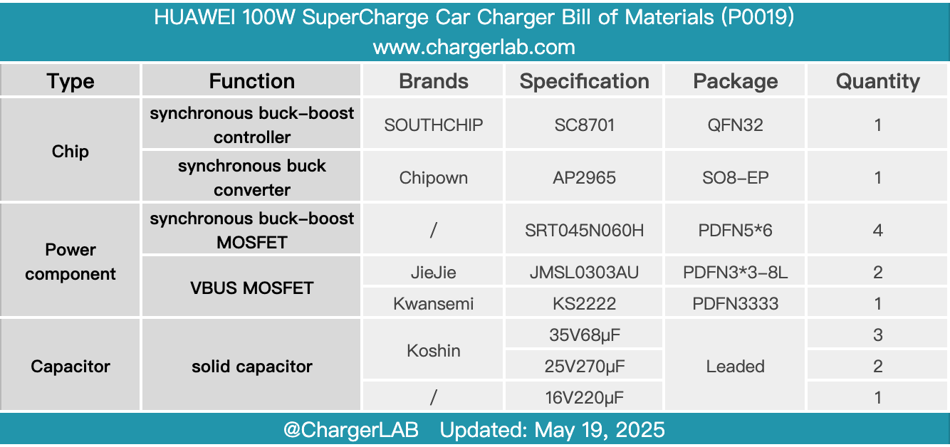

Here is the component list of the HUAWEI 100W SuperCharge Car Charger for your convenience.
It features a combined USB-A/USB-C port and a USB-A2 port, supporting a wide input voltage range of 12–24V. It maintains consistent output performance across different input voltages to ensure a reliable user experience. All ports support Huawei SuperCharge and UFCS protocols, with the USB-C port supporting 100W PD/PPS. Additionally, it supports output configurations of 100W+18W, 88W+22.5W, and 66W+30W.
After taking it apart, we found that it uses two separate circuits, regulated respectively by SouthChip SC8701 and Chipown AP2965 solutions. Capacitors, inductors, and other components on the PCB are reinforced with adhesive, and a thermal pad is placed between the two PCBs for heat dissipation. The USB sockets are insulated. In addition, it features comprehensive protection functions including input/output overvoltage/undervoltage, overcharge, output overcurrent, and short circuit protection, ensuring reliable quality.
