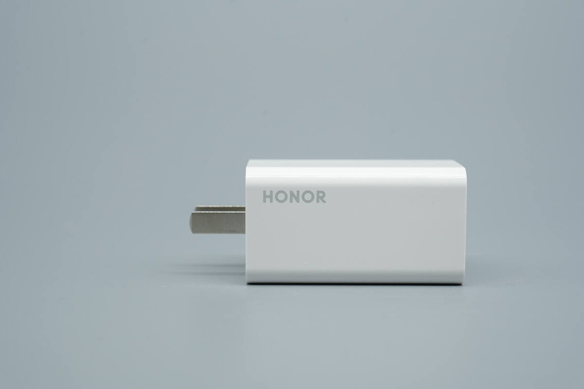

The charger features a white plastic enclosure with a glossy, painted finish, resulting in a smooth surface.
Teardown of HONOR SuperCharge 66W Power Adapter (HN-110600CP0)-Chargerlab
One side is printed with the HONOR logo.

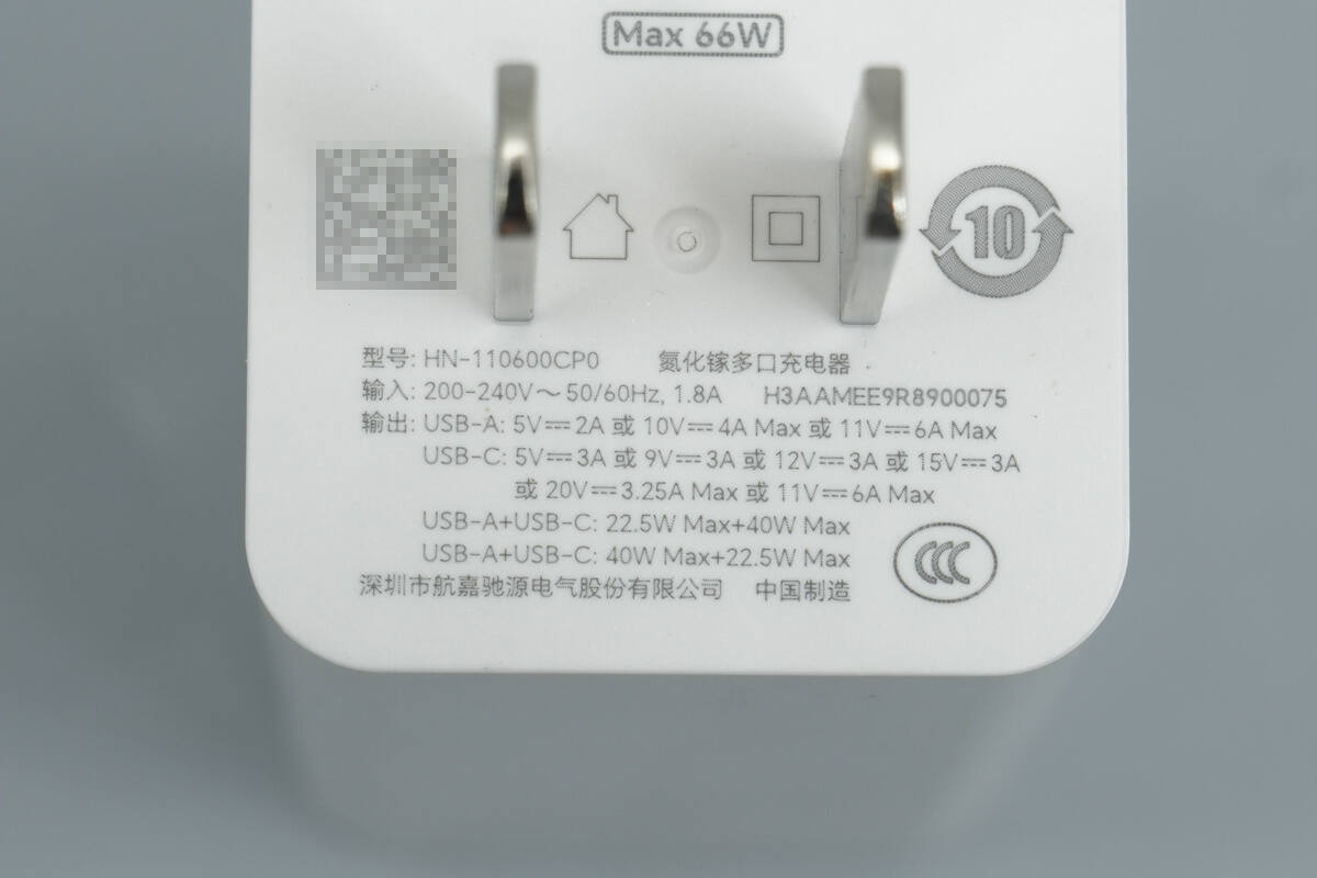

The input-side housing is printed with specs info.
Model: HN-110600CP0
Input: 200–240V~50/60Hz 1.8A
Output:
USB-A: 5V 2A, 10V 4A, 11V 6A Max
USB-C: 5V 3A, 9V 3A, 12V 3A, 15V 3A, 20V 3.25A, 11V 6A
USB-A + USB-C: 22.5W + 40W
USB-A + USB-C: 40W + 22.5W
The charger has obtained CCC certification.

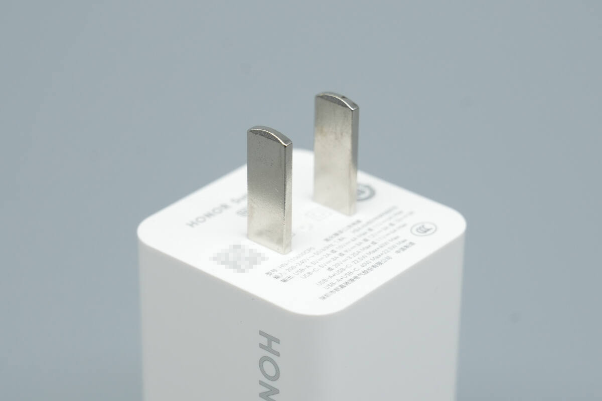

It is equipped with fixed prongs.

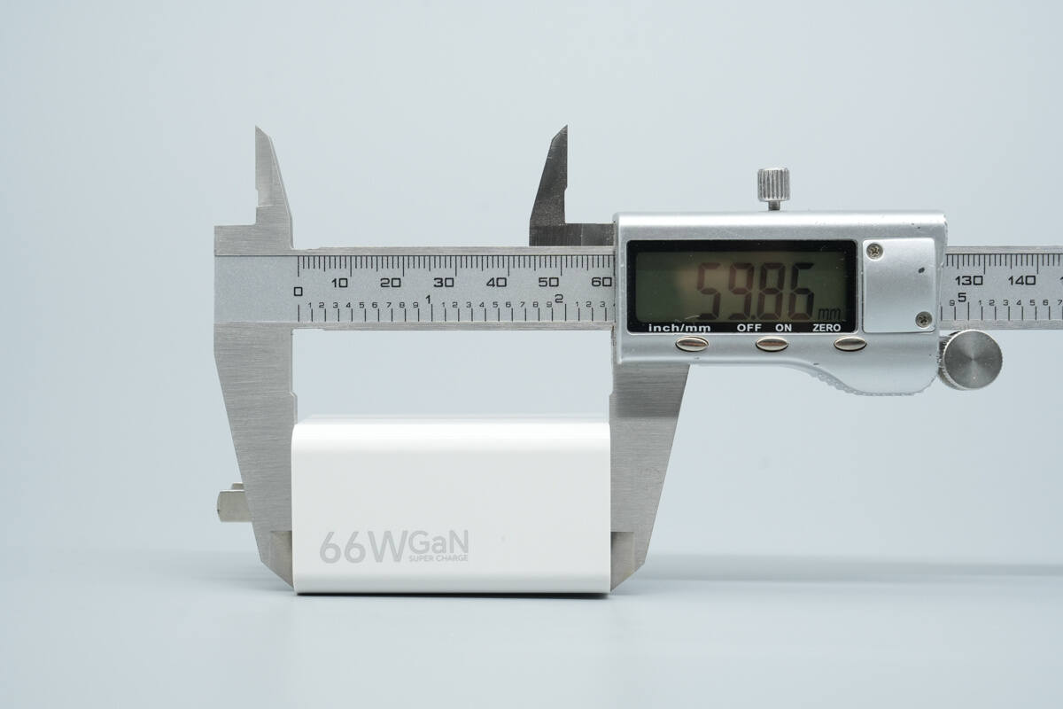

The length of the charger is about 59.86 mm (2.36 inches).

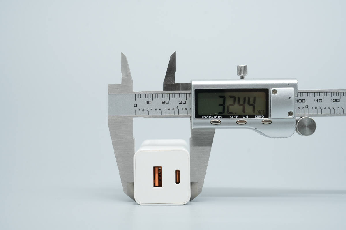

The thickness is about 32.44 mm (1.28 inches).

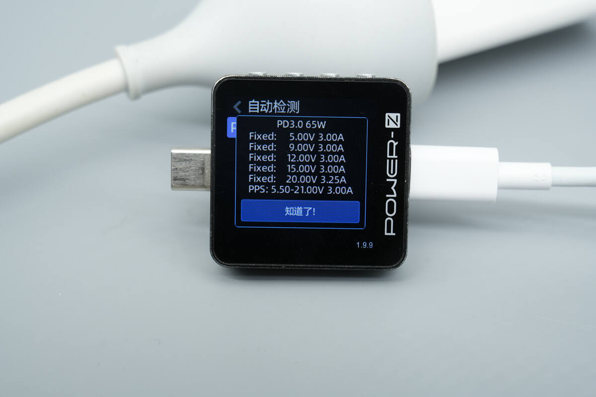

ChargerLAB POWER-Z KM003C shows that the USB-C port supports PD3.0, PPS, and QC5 charging protocols.
It features five fixed PDOs of 5V3A, 9V3A, 12V3A, 15V3A, and 20V3.25A. It also supports one set of PPS, which is 5-21V3A.

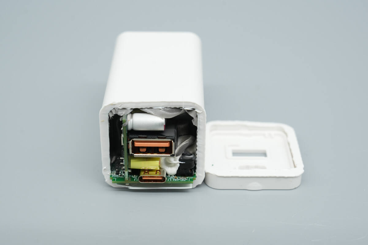

Cutting open the output-side housing reveals that the PCBA module is firmly secured in place.

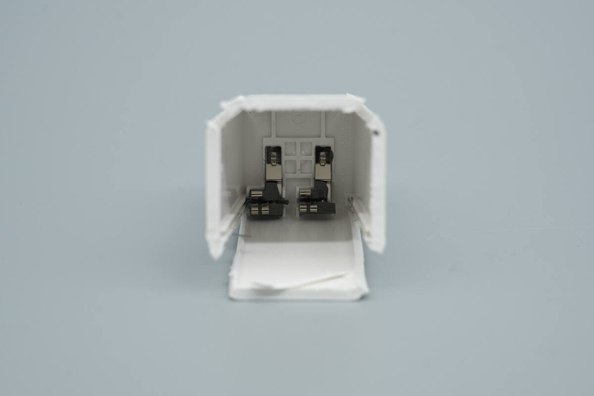

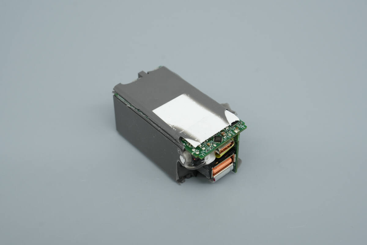

Cut open the housing and remove the PCBA module.
The input side uses a contact-based power connection design, with the prongs crimped to metal plates.

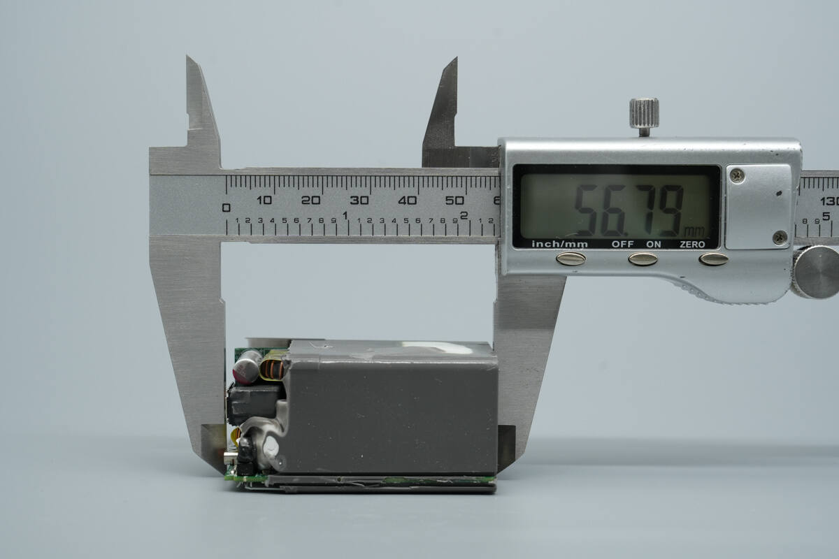

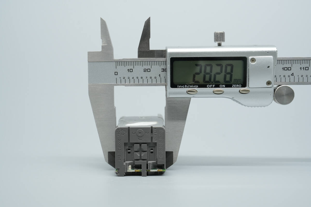

The length of the PCBA module is about 56.79 mm (2.24 inches).
The width is about 28.28 mm (1.11 inches).
The thickness is about 28.21 mm (1.11 inches).

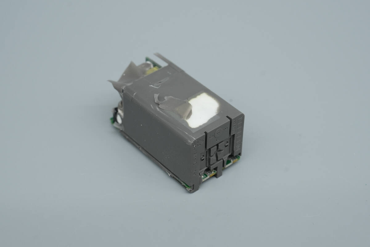

The PCBA module is encapsulated with adhesive to improve overall durability and heat dissipation.
The bottom is covered with a layer of aerogel.

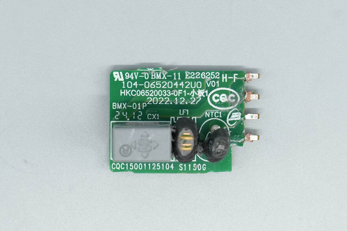

Remove the small PCB on the front left side of the module, revealing an NTC thermistor, a common mode choke, and a safety X2 capacitor on the front.

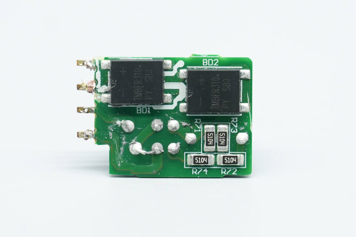

The other side houses two bridge rectifiers.

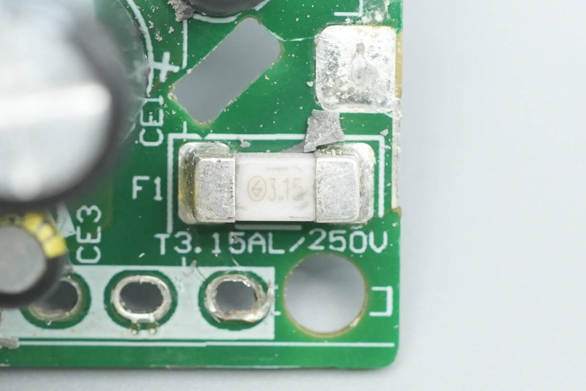

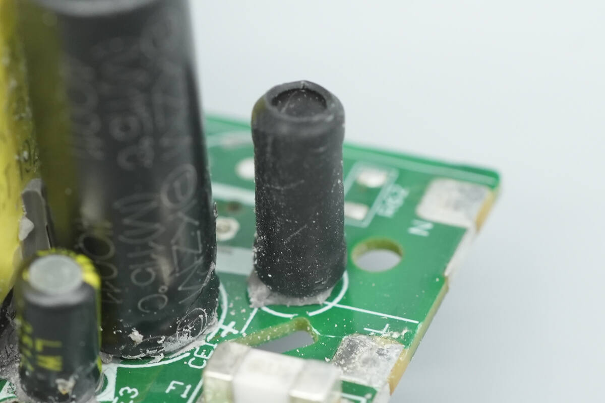

The fuse is from Betterfuse with a rated current of 3.15A.
The NTC thermistor is used to suppress inrush current at power-on and is insulated with a heat-shrink tube.

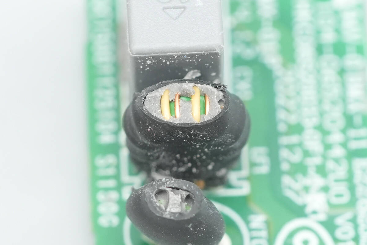

The common mode choke is used to filter EMI and is also covered with a heat-shrink tube.

The two bridge rectifiers are from PY, model TMBFR310, rated at 3A 1000V, and use a TMBF package.

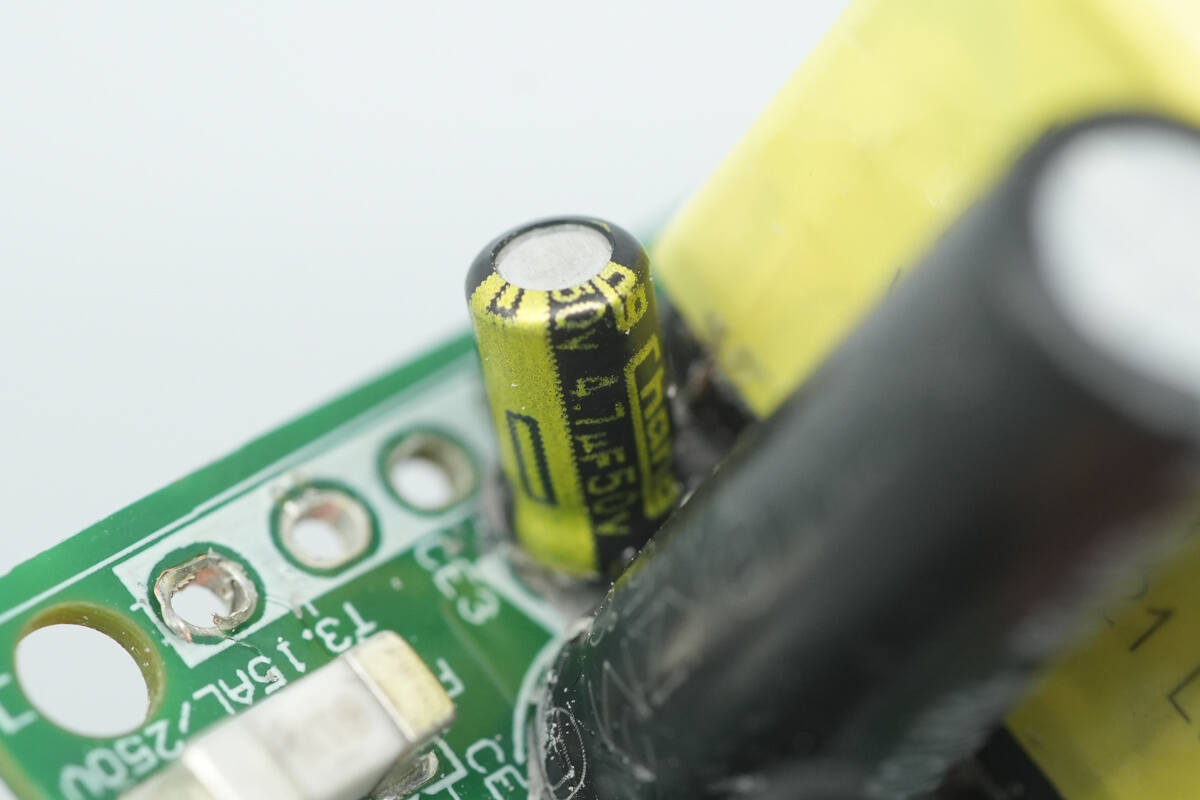

The capacitor supplying power to the master control chip is rated at 50V 4.7 μF.

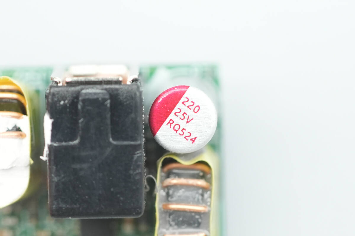

The two solid-state capacitors used for synchronous rectification output filtering are rated at 25 V 470 μF.

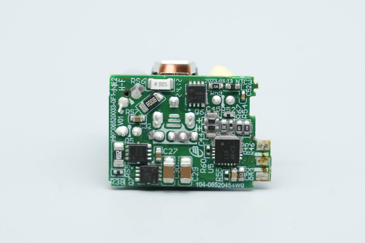

The front of the small PCB houses the synchronous buck controller, buck inductors, and a solid capacitor. The two buck inductors are used for two separate secondary buck circuits.
The other side features the synchronous buck MOSFETs, a protocol chip, and output VBUS MOSFETs.
The synchronous buck controller for the USB-C port is from SouthChip, model SC8002. It supports an input voltage range of 4.6–36 V, adjustable output voltage, and a 5 V fixed output for fast-charging applications. The chip features high-precision output current limiting, dual-channel independent current limiting, and comprehensive built-in protection functions. The SC8002 comes in a QFN 3×3-20 package and is suitable for car chargers, multi-port chargers, USB hubs, and similar applications.
Here is the information about SouthChip SC8002.
The accompanying synchronous buck MOSFETs and the USB-C output VBUS MOSFETs both use the AOS AON7544. They are NMOS devices rated at 30 V with an on-resistance of 4.1 mΩ, and come in a DFN 3×3 package.

The secondary buck output filtering solid-state capacitor is rated at 25 V 220 μF.

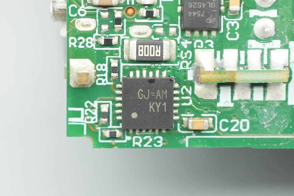

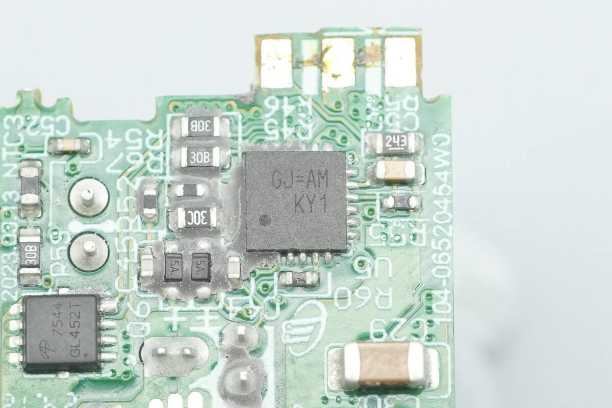

The protocol chip for the USB-C port is marked with “CJ=AM.”

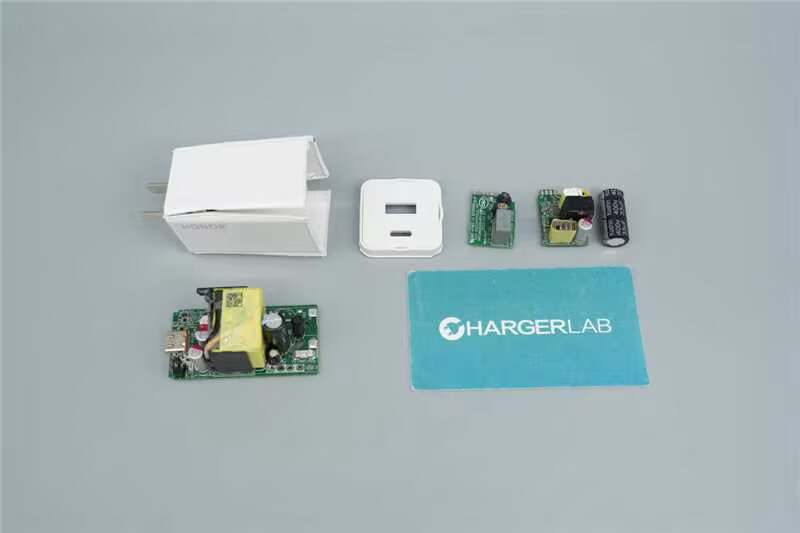

Well, those are all components of the HONOR SuperCharge 66W Power Adapter.

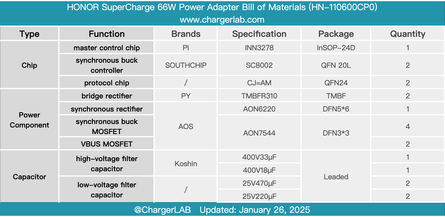

Here is the component list of the HONOR SuperCharge 66W Power Adapter for your convenience.
