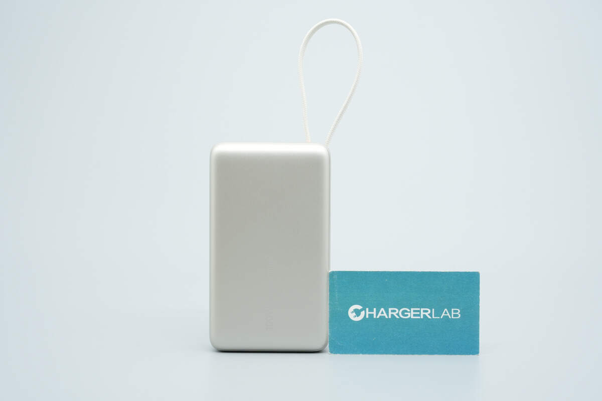

Recently, HONOR Choice released a 100W power bank with an integrated cable. The built-in USB-C cable uses a braided design. The power bank also includes one USB-A port and one USB-C port, supporting 100W PD and 100W SCP to meet fast-charging requirements for Huawei and HONOR smartphones. It is CCC-certified and can be carried on airplanes. Next, let’s take a closer look at its internal components and design.

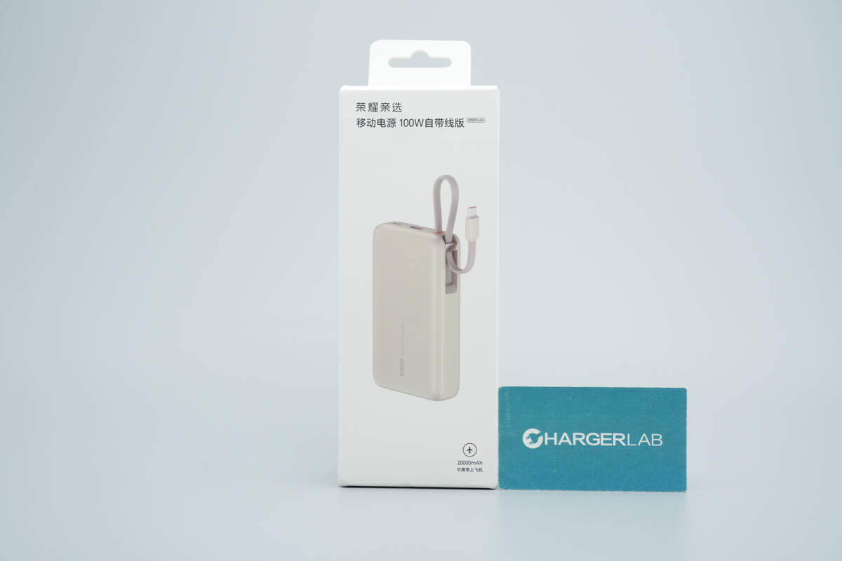

The front of the packaging displays the brand, product name, appearance image, and the 20,000 mAh capacity label.

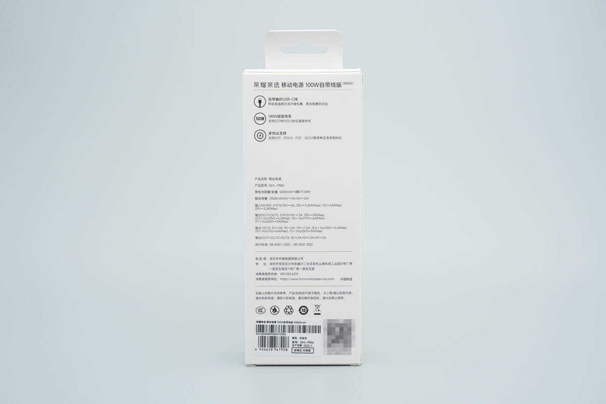

The back of the packaging lists the product specifications and related information.

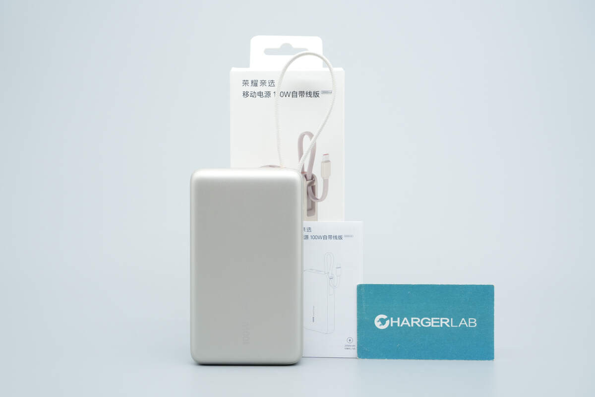

The package includes the power bank and a user manual.

The enclosure is made of flame-retardant PC material, with smoothly contoured edges.

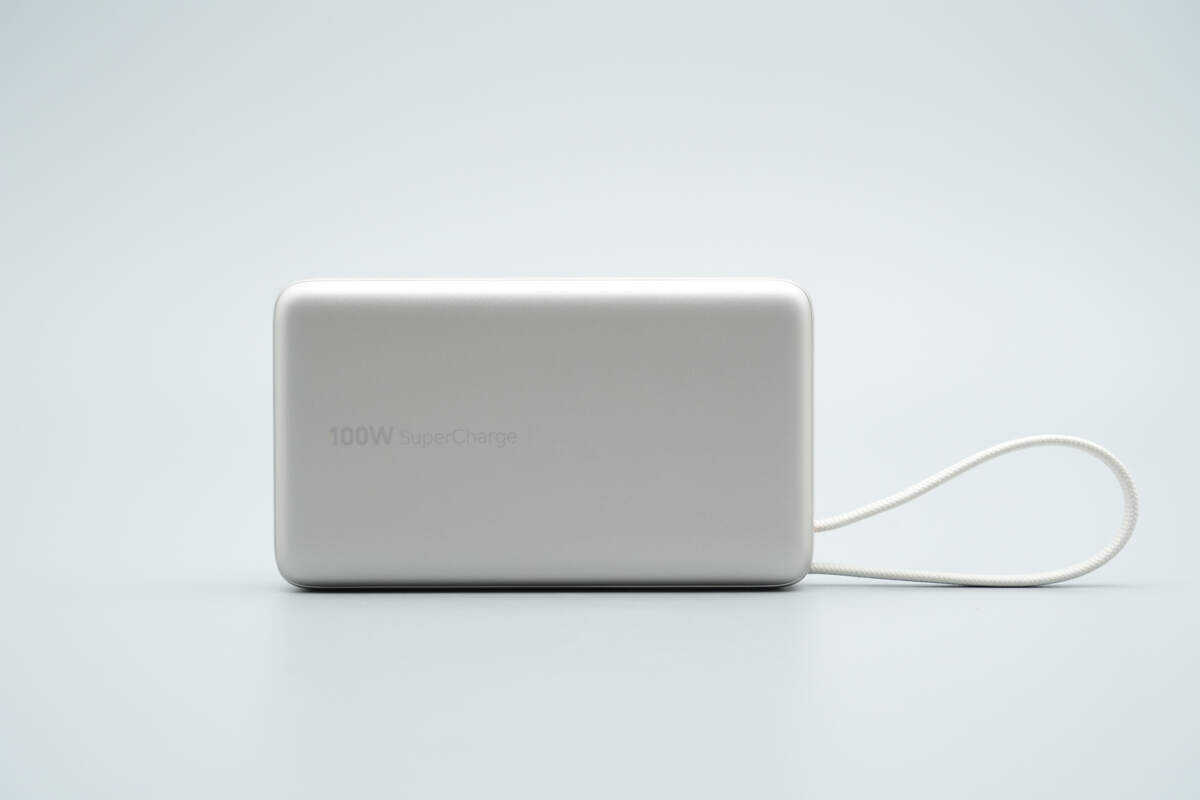

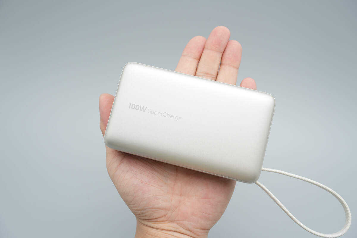

The front is printed with “100W SuperCharge.”

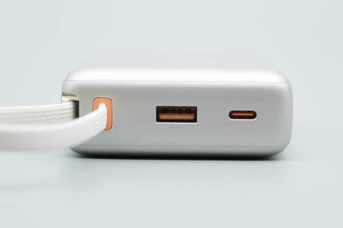

The top side features one USB-A port and one USB-C port, with the integrated USB-C cable positioned on the left.

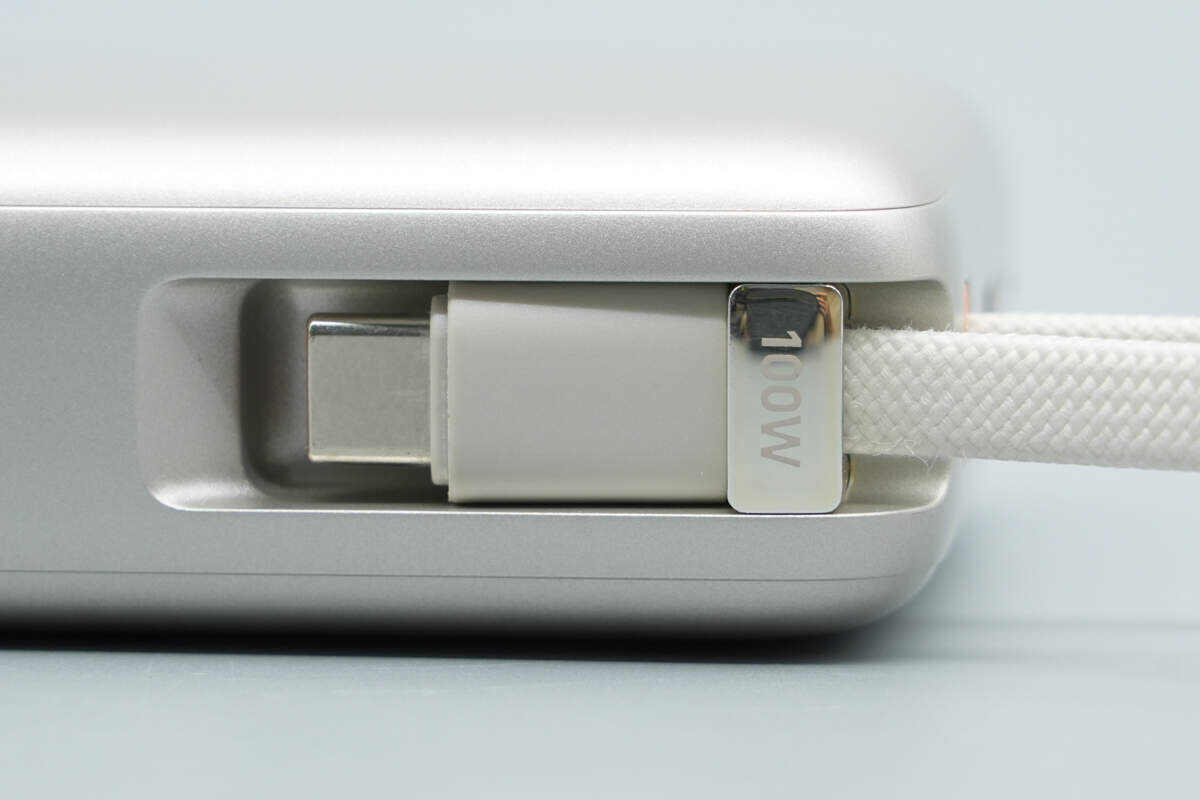

The side includes a metal latch and a dedicated groove for securing and storing the cable.
Teardown of HONOR CHOICE 100W 20000mAh Power Bank (QHL-PB06)-Chargerlab

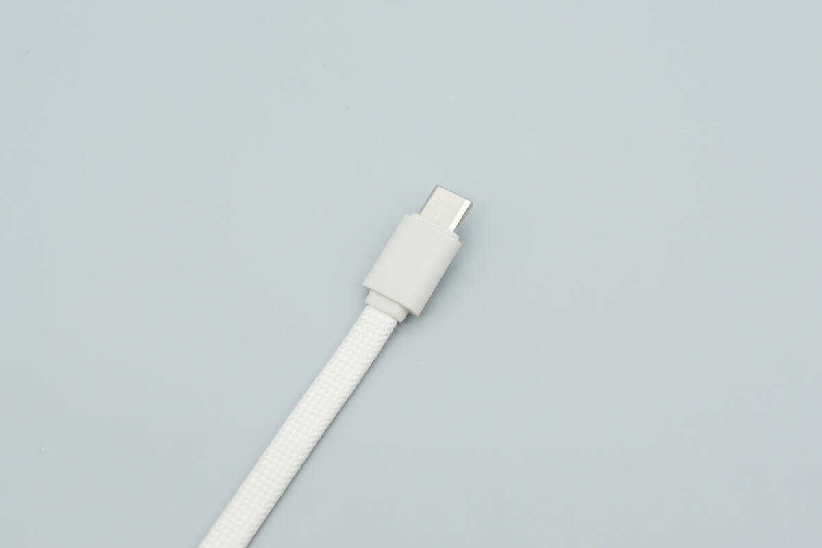

The integrated USB-C cable uses a braided design, making it more resistant to pulling and wear.

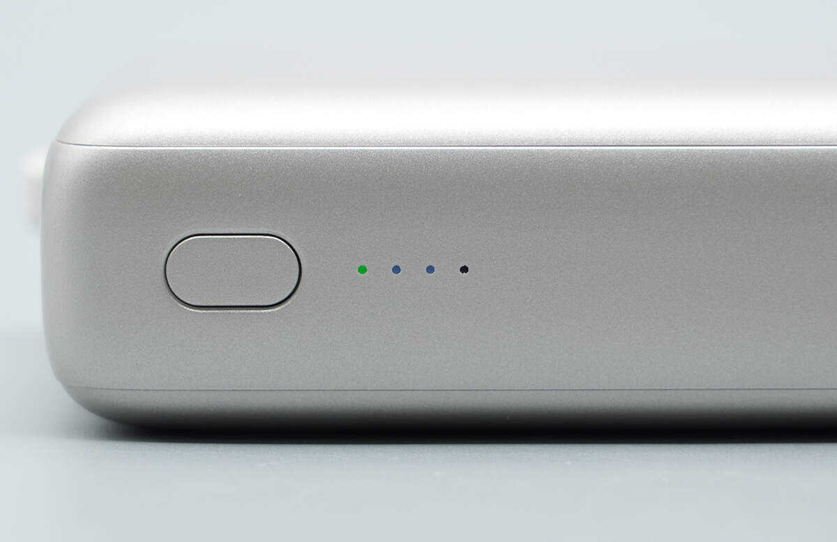

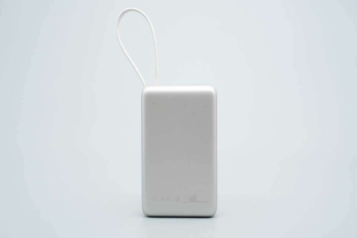

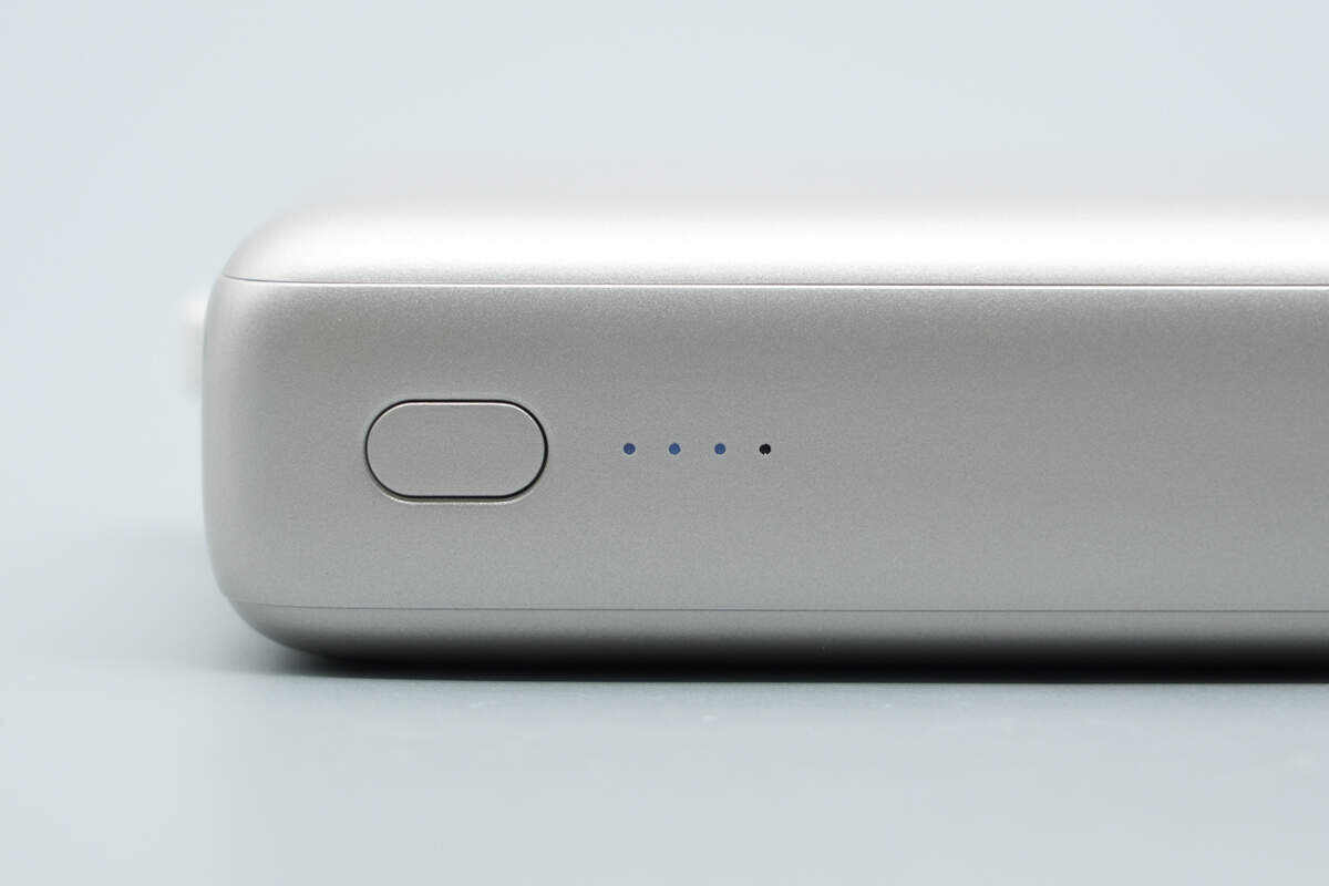

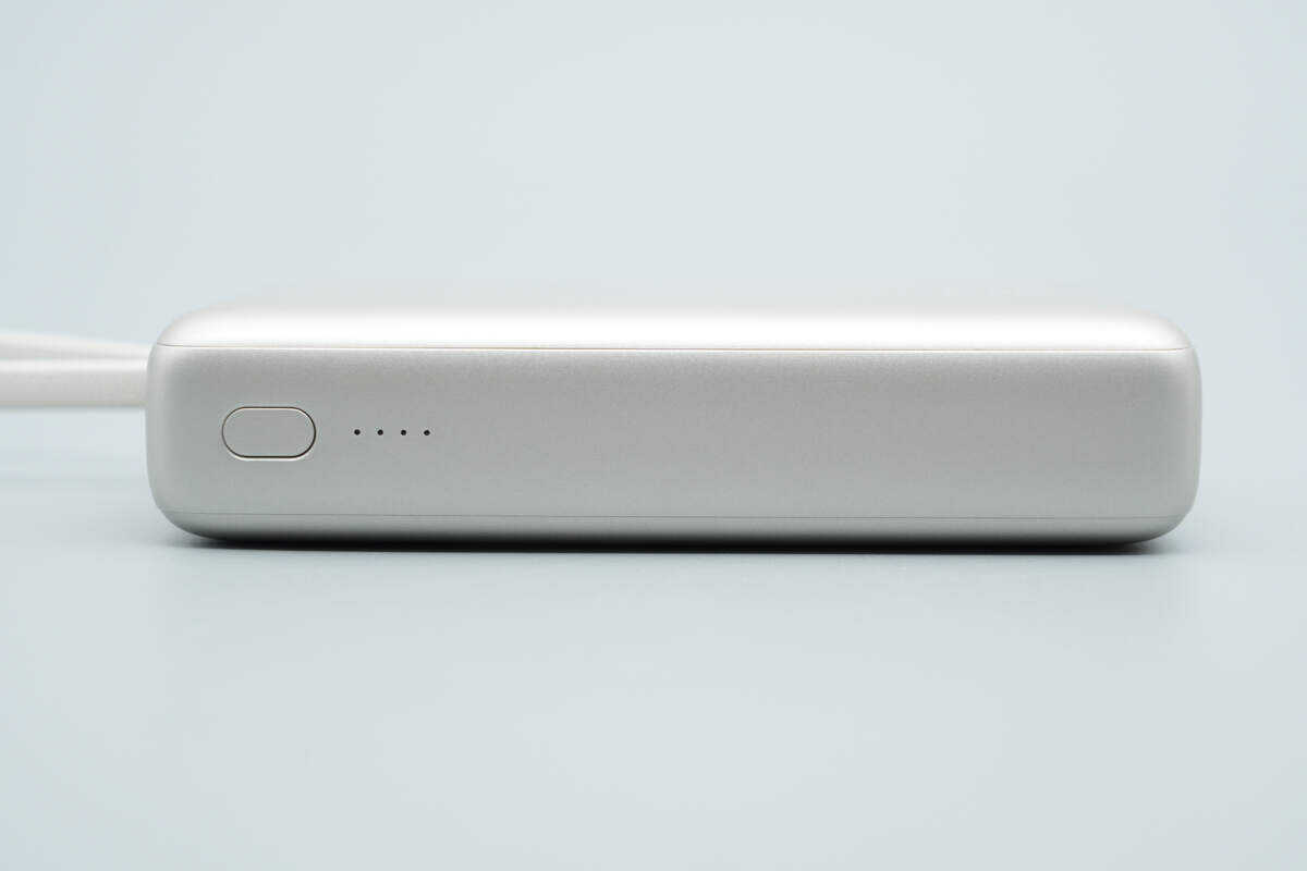

This side features the power button and LED indicators for battery level.
The battery indicator lights up in blue.
When the power bank is fast-charging a device, the leftmost indicator lights up green to indicate fast-charging status.

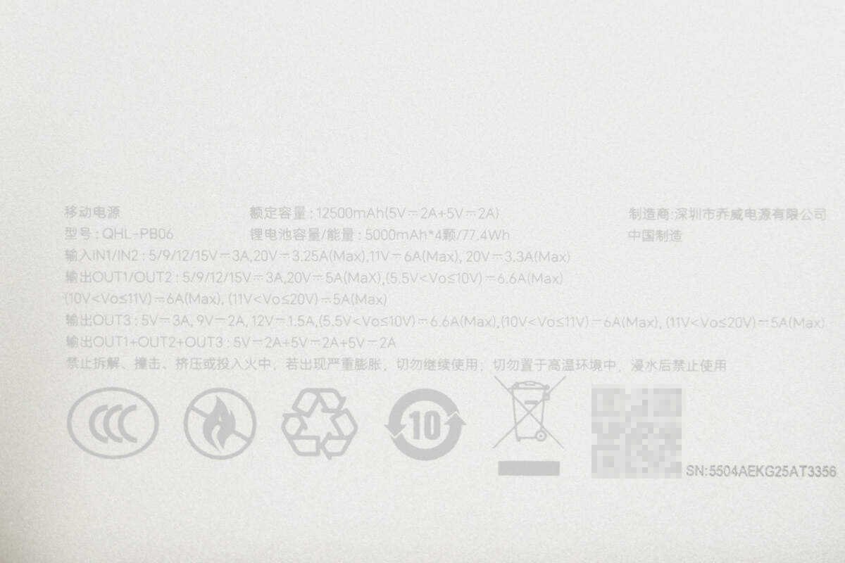

The back is printed with the product’s technical specifications.
Model: QHL-PB06
Rated Capacity: 12,500mAh (5V 2A + 5V 2A)
Battery Capacity / Energy: 4 × 5,000mAh / 77.4Wh
Input (IN1 / IN2): 5/9/12/15V 3A, 20V 3.25A, 11V 6A, 20V 3.3A
Output (OUT1 / OUT2): 5/9/12/15V 3A, 20V 5A (Max), 5.5–10V 6.6A, 10–11V 6A, 11–20V 5A
Output (OUT3): 5V 3A, 9V 2A, 12V 1.5A, 5.5–10V 6.6A, 10–11V 6A, 11–20V 5A
Combined Output (OUT1 + OUT2 + OUT3): 5V 2A + 5V 2A + 5V 2A

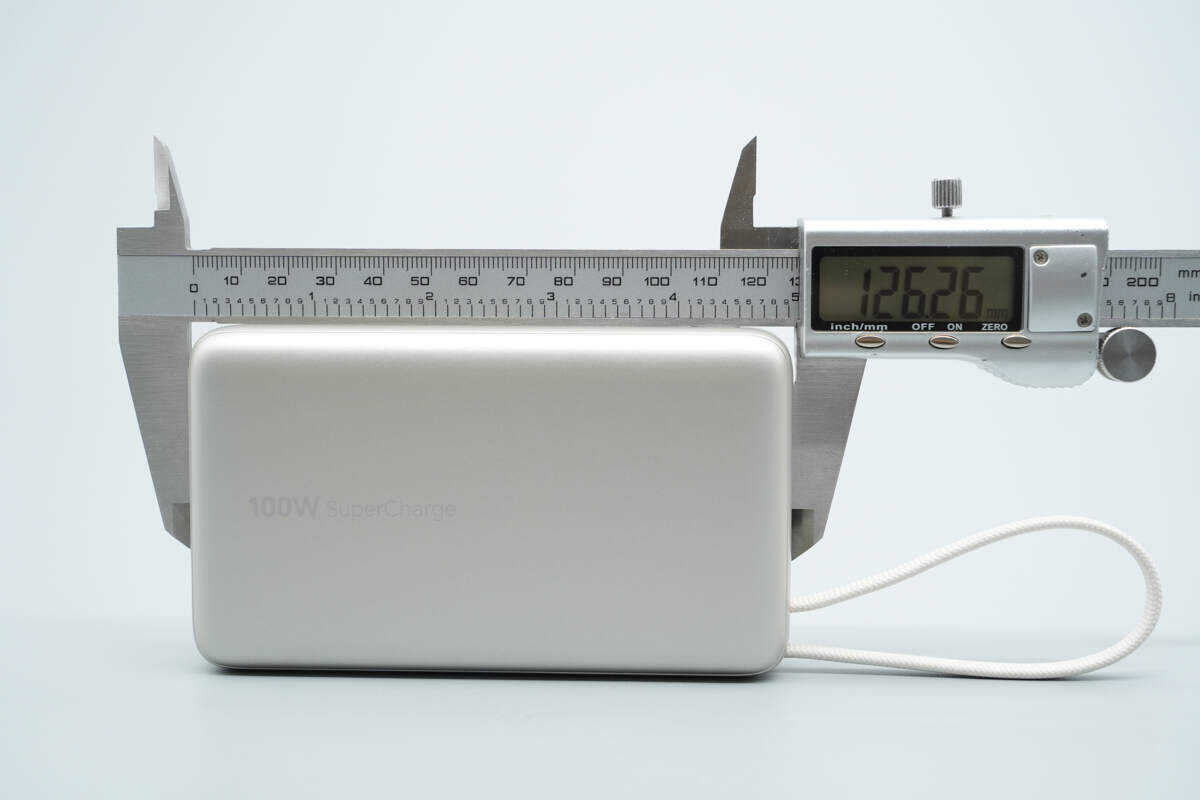

The length of the power bank is about 126.26 mm (4.97 inches).

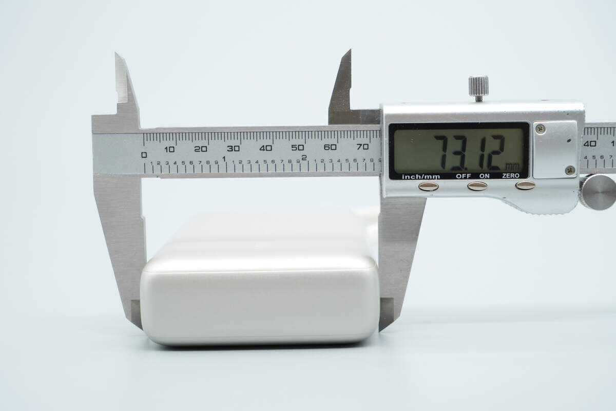

The width is about 73.12 mm (2.88 inches).

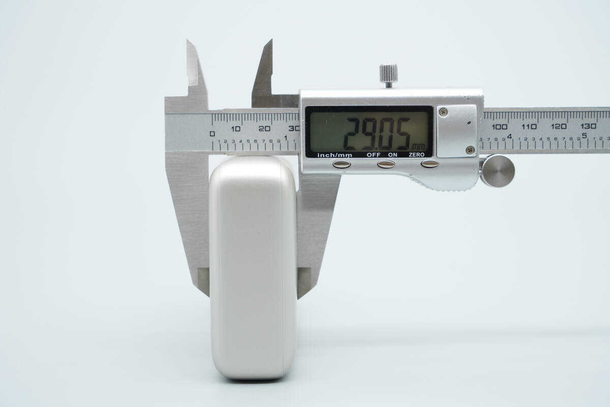

The thickness is about 29.05 mm (1.14 inches).

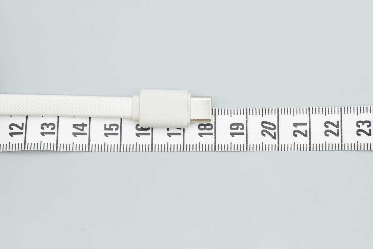

The length of the cable is about 18 cm (7.087 inches).

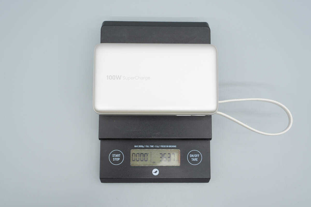

The weight is about 364 g (12.84 oz).

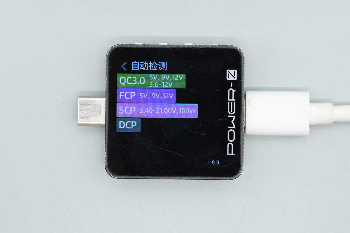

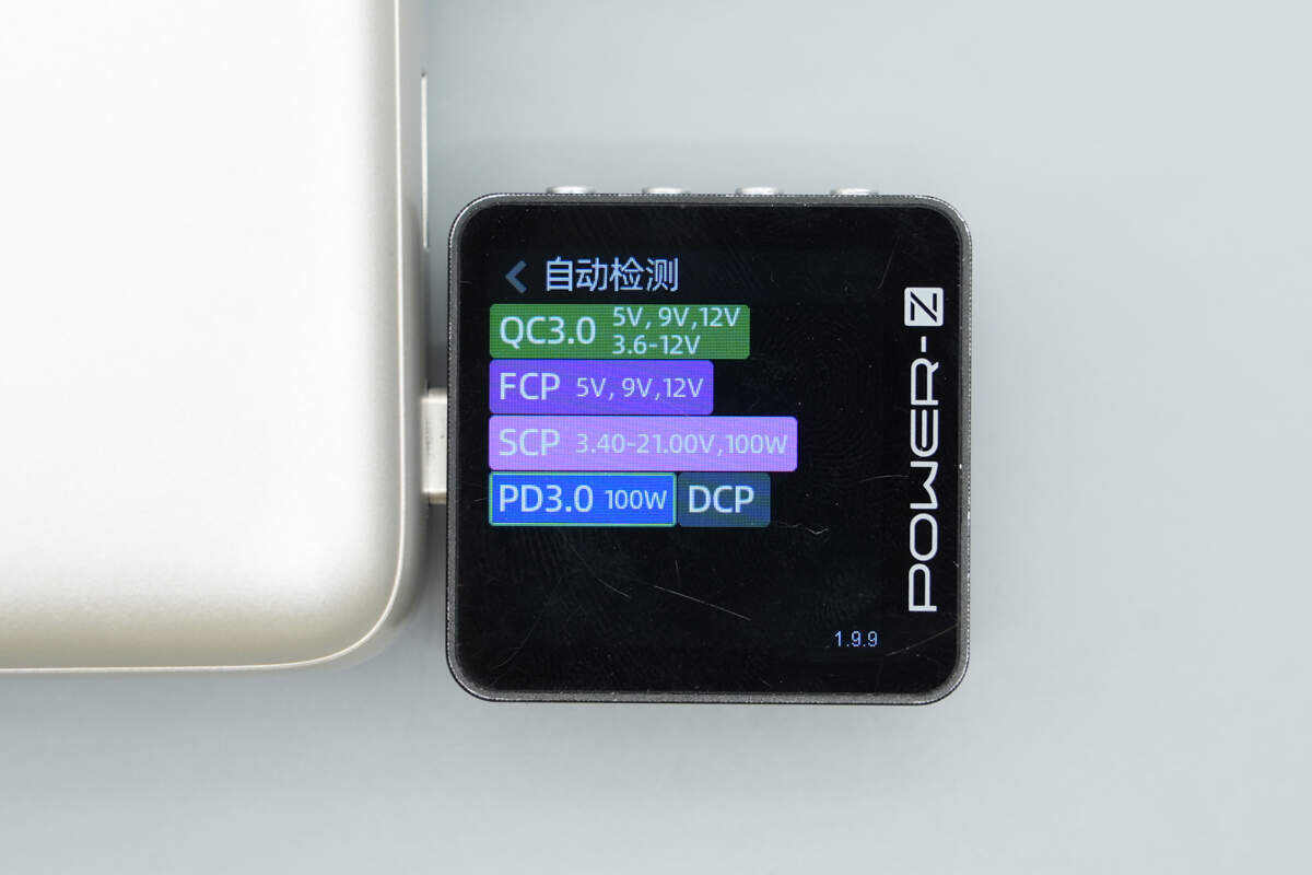

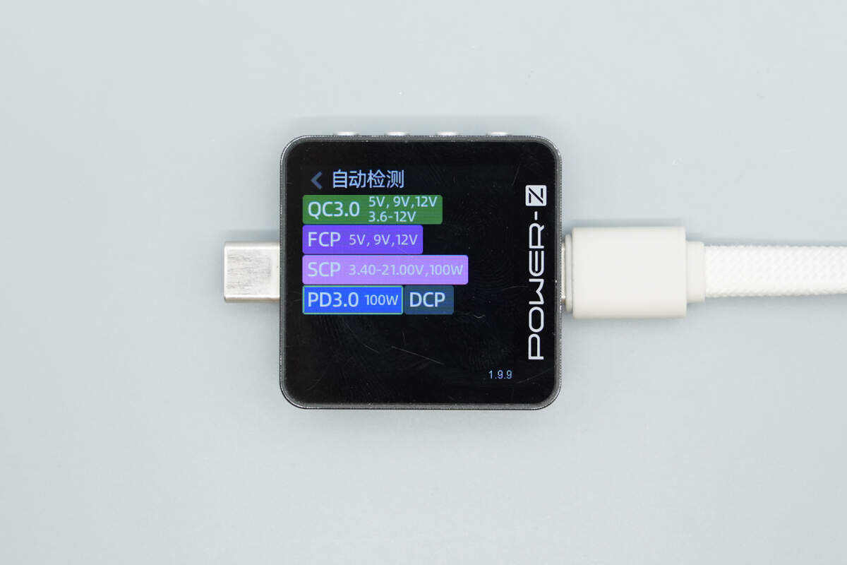

ChargerLAB POWER-Z KM003C shows that the USB-C cable supports QC3.0, FCP, SCP, PD3.0, and DCP charging protocols.

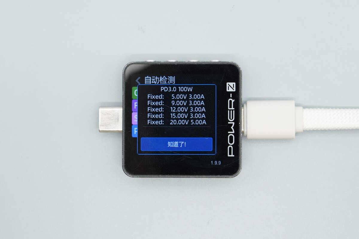

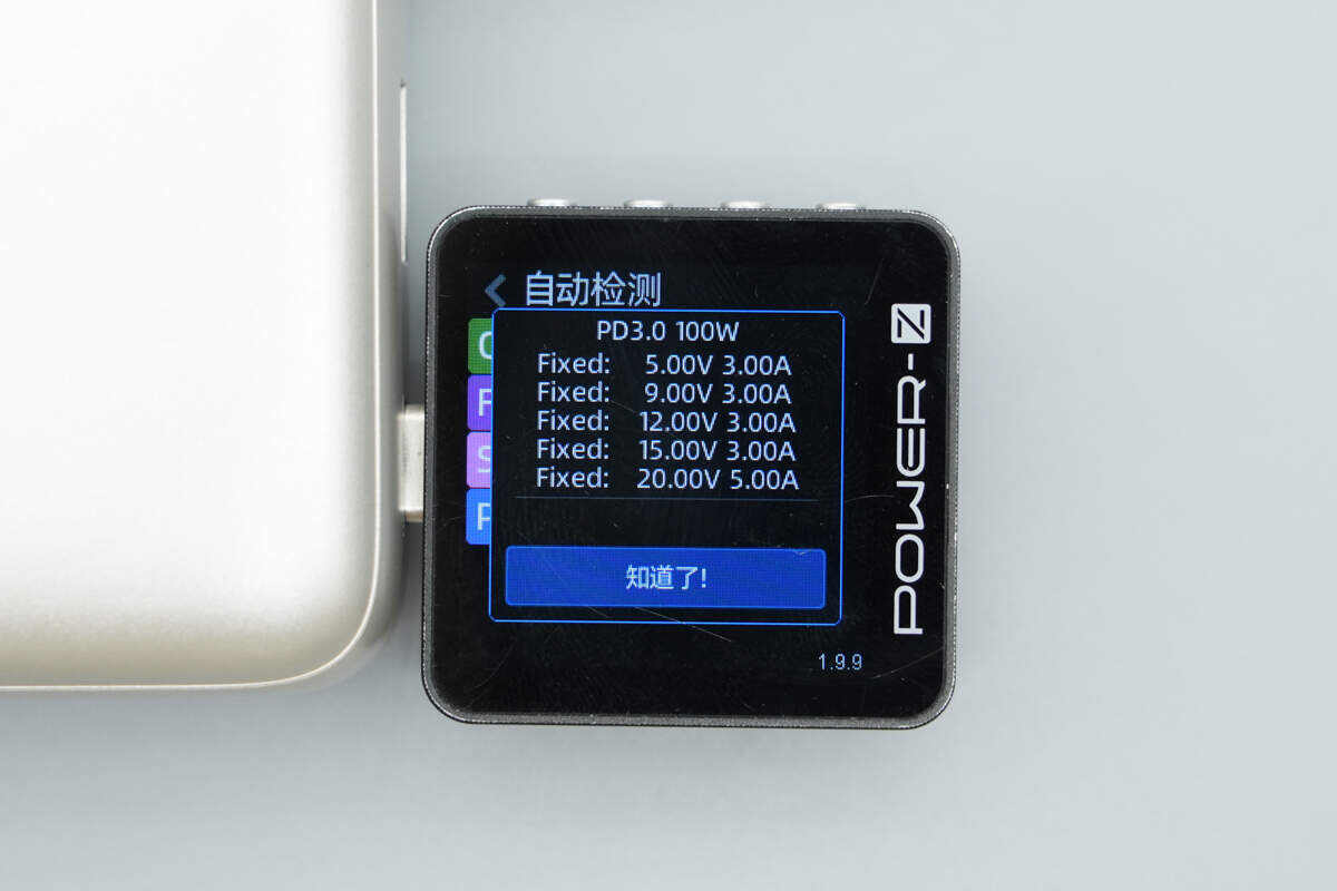

And it has five fixed PDOs of 5V3A, 9V3A, 12V3A, 15V3A, and 20V5A.
The USB-C port is compatible with the same protocols as the integrated USB-C cable.
The PDO communication is also the same.

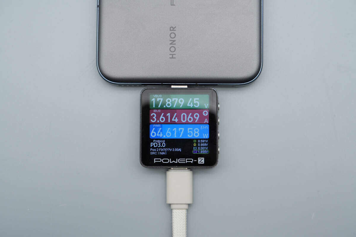

When charging the HONOR Magic7 RSR using the integrated USB-C cable, the charging power is about 64.62W.

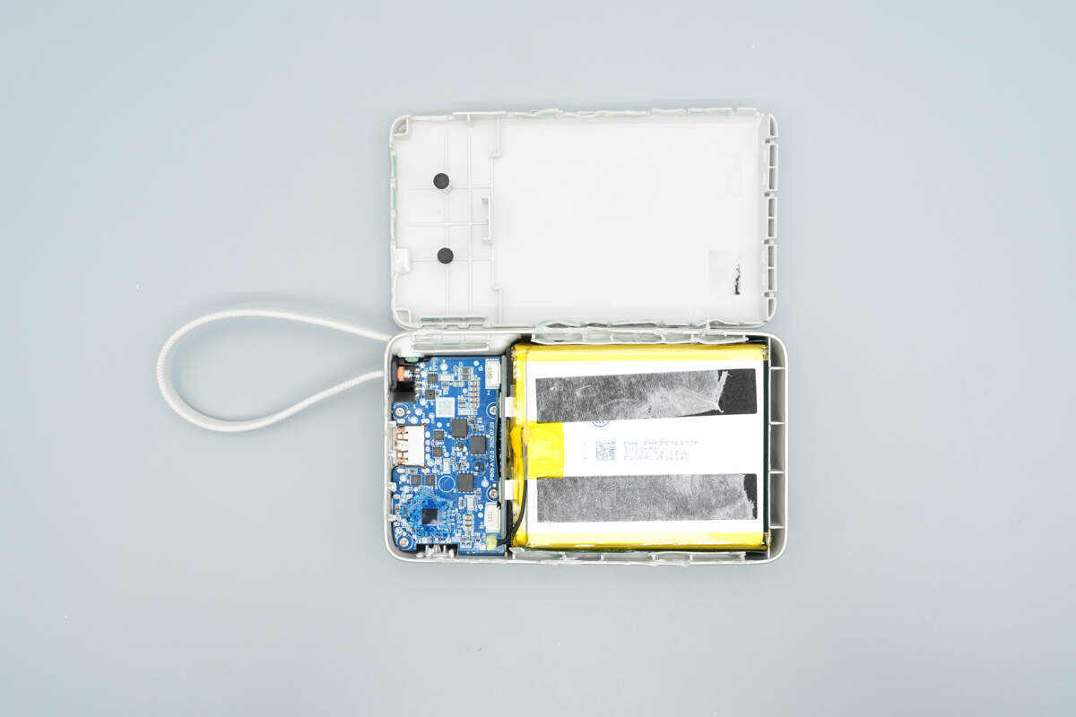

The snap-fit enclosure is opened by disengaging the clips.

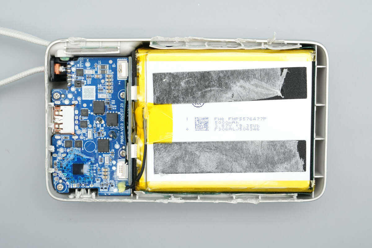

The battery cells are covered with protective foam padding.
A thermistor is installed at the front of the battery cells, and the PCB is secured with screws.

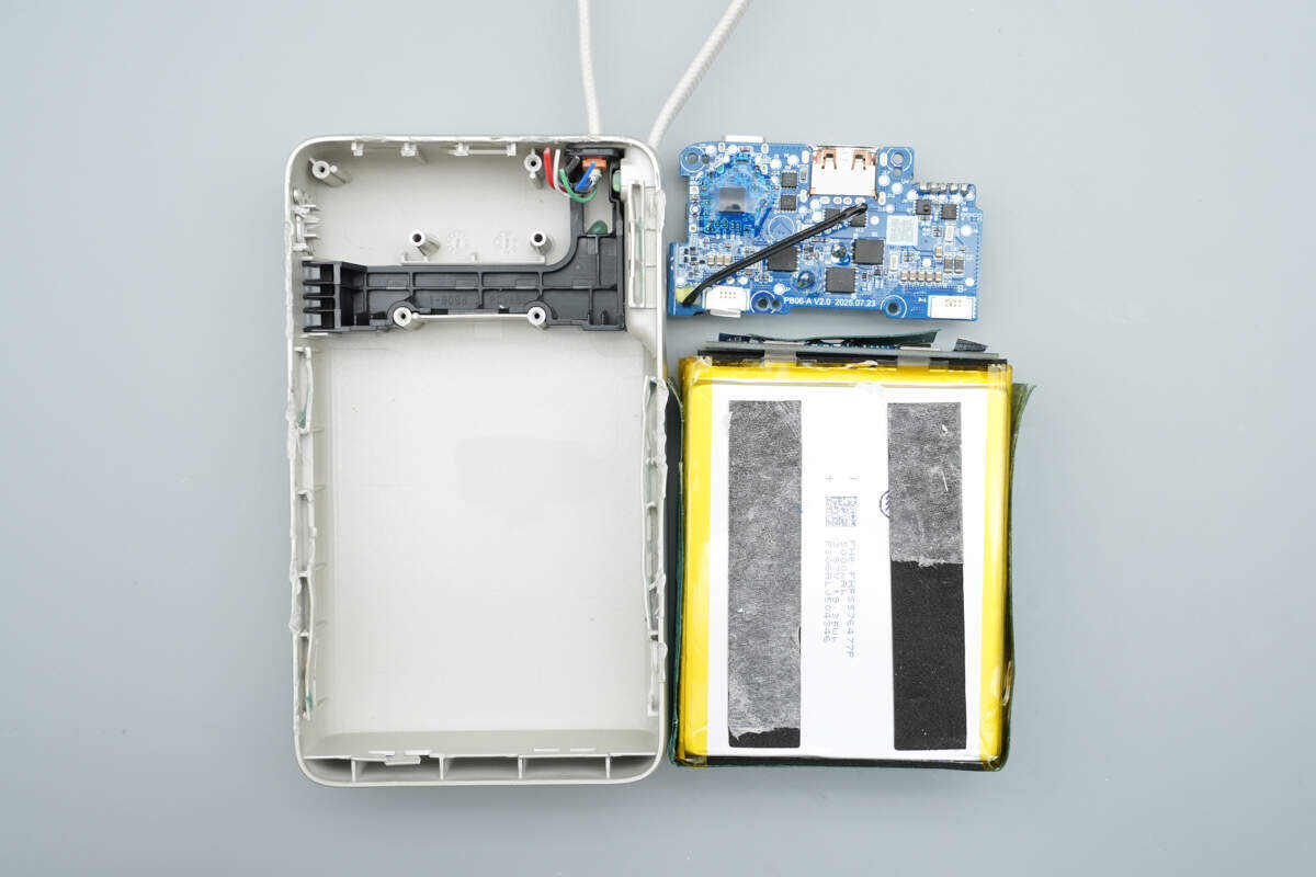

Remove the PCB and battery cells. The bottom of the PCB features a black plastic plate and supporting posts.

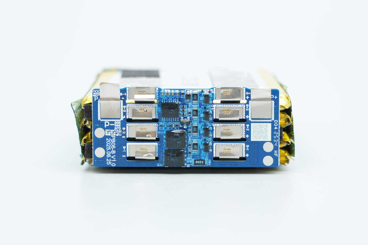

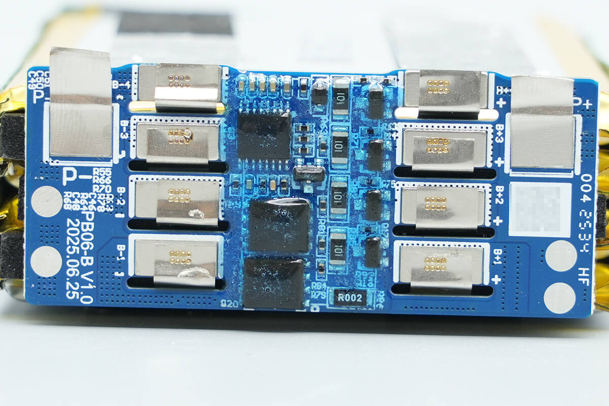

The battery pack is connected to the front lithium battery protection PCB via nickel strips.

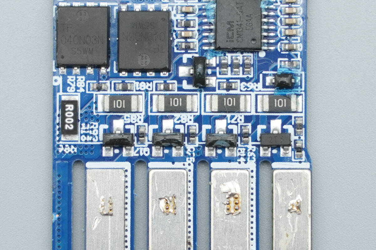

The front of the lithium battery protection PCB houses the battery protection chip, battery protection MOSFETs, and the balancing circuitry.

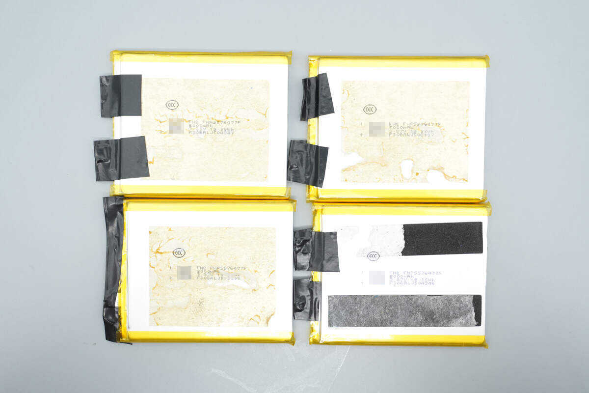

The battery pack consists of four identical polymer lithium cells.

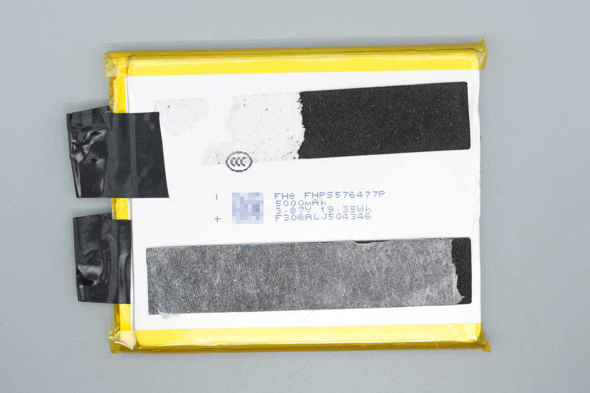

The cells are from FHE, model FHPS576477P, with a nominal voltage of 3.87V, a capacity of 5,000mAh, and an energy of 19.35Wh. They are CCC-certified.

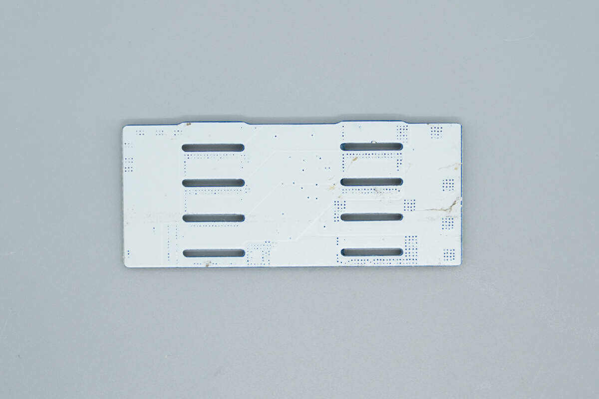

The back of the PCB has no components.

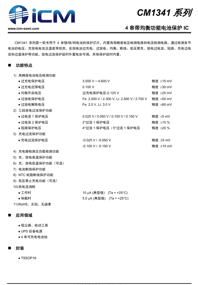

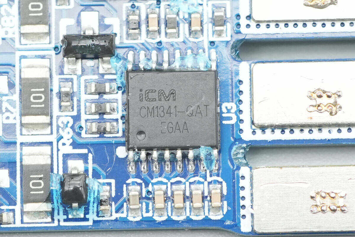

The battery protection chip is from iCM, model CM1341-QAT, specifically designed for 4-series lithium-ion or LiFePO₄ batteries. It features built-in high-precision voltage and current detection circuits.
By monitoring the voltage of each cell, charge and discharge currents, and temperature, the chip provides protections including overcharge, over-discharge, cell balancing, open-circuit detection, low-voltage charge inhibition, over-discharge current, short-circuit, overcharge current, and over-temperature. The discharge overcurrent protection delay is adjustable via an external capacitor, while other protection delays are built-in.

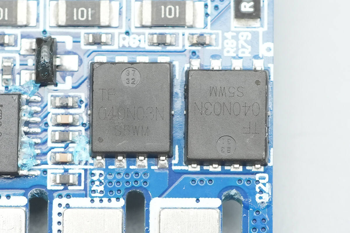

The battery protection MOSFETs are from TUOFENG, model TF040N03N, NMOS type, with a voltage rating of 30V and an on-resistance of 4.7 mΩ. They are packaged in PDFNWB5×6-8L.
Close-up of the balancing circuit.

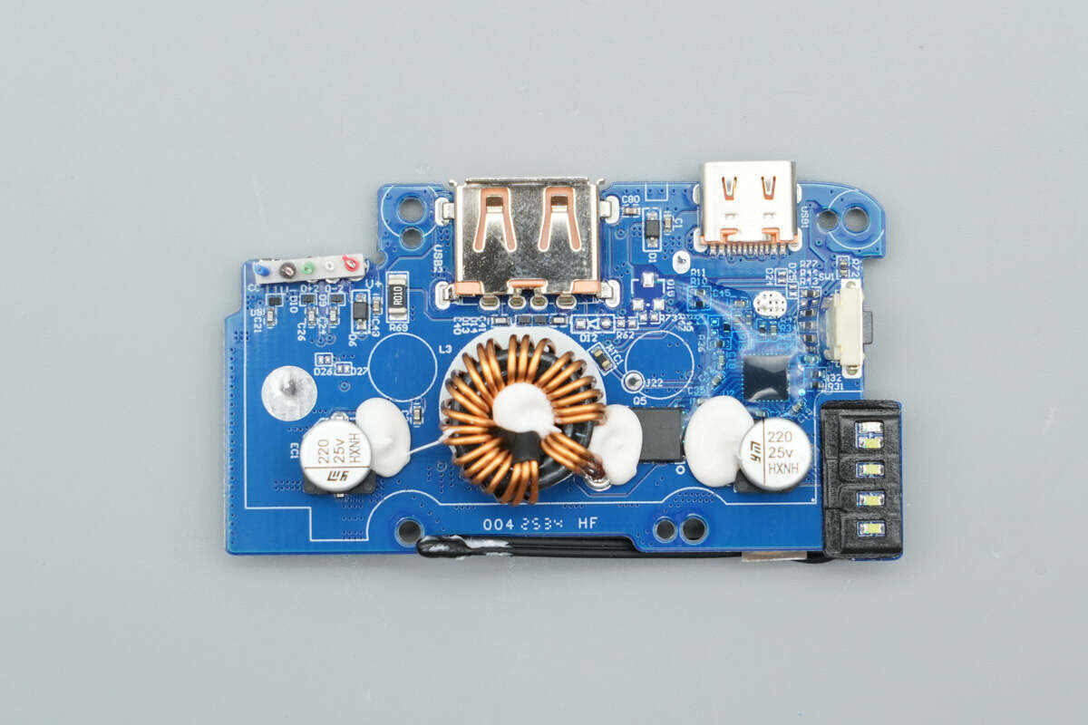

The front of the PCBA module features a synchronous buck-boost controller, a synchronous buck-boost MOSFET, a buck-boost inductor, solid capacitors, and other components.

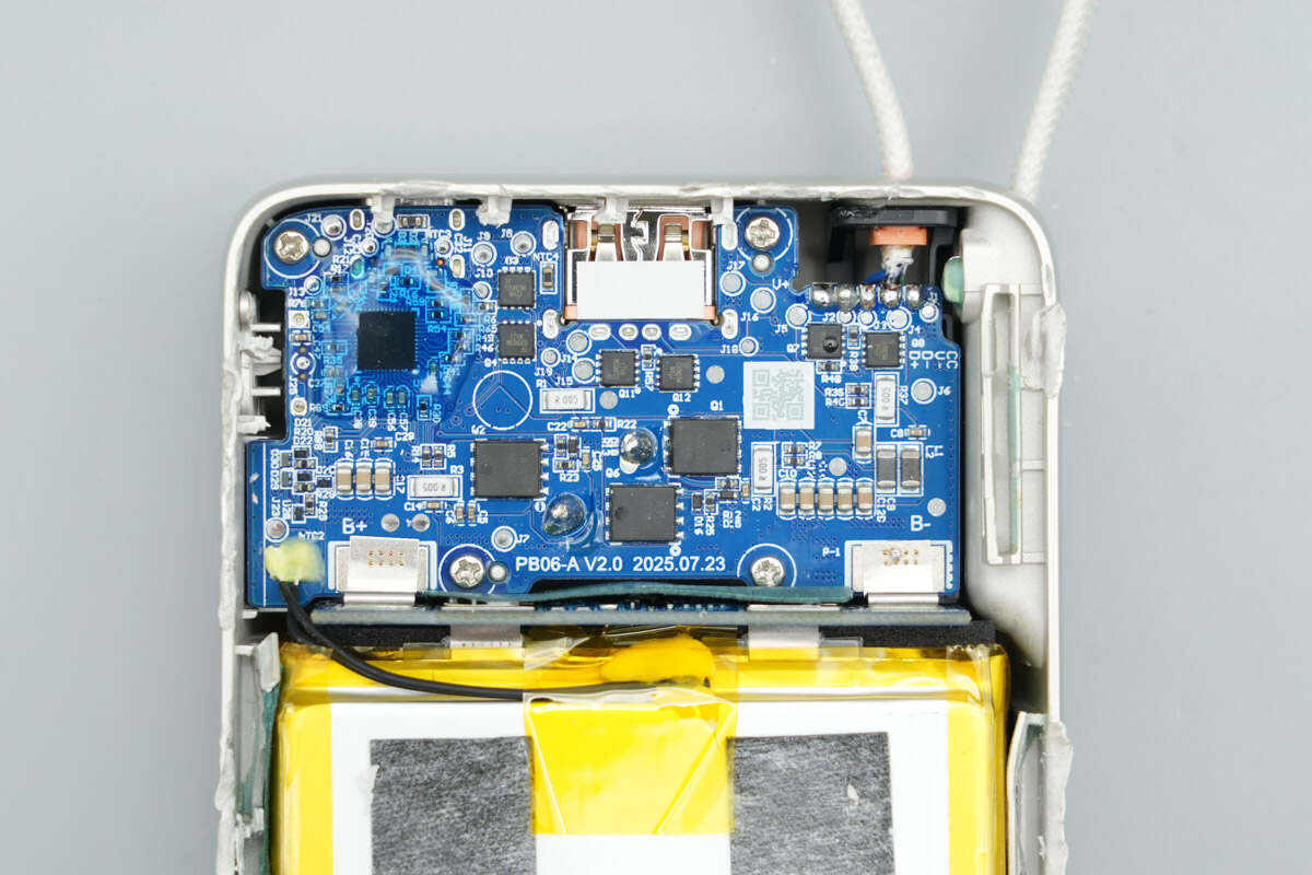

The back of the PCBA houses the protocol chip, synchronous buck-boost MOSFETs, and VBUS MOSFETs.

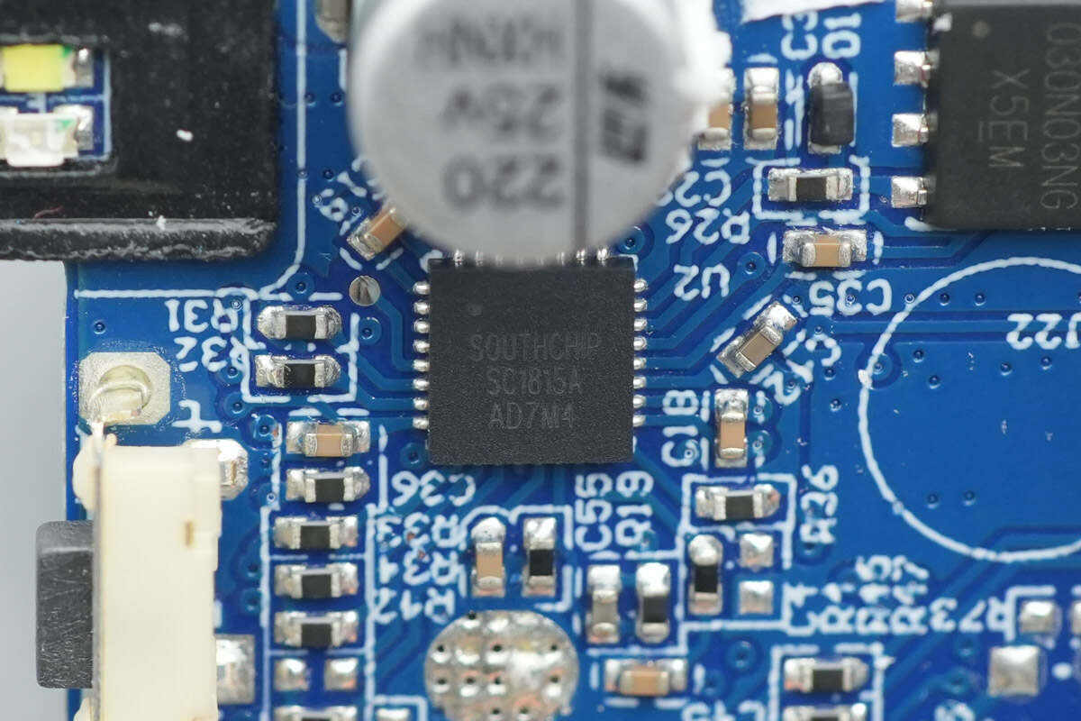

The synchronous buck-boost controller is from SouthChip, model SC1815A, and comes in a QFN32 package.

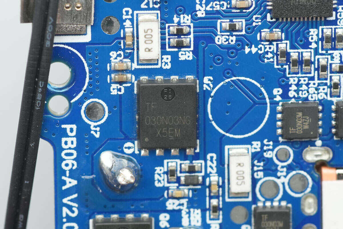

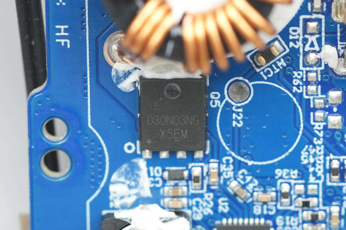

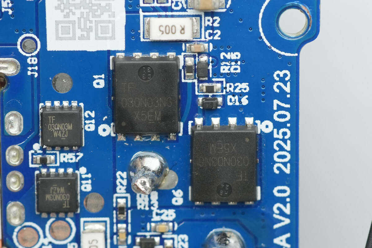

The synchronous buck-boost MOSFETs are from TUOFENG, model TF030N03NG, NMOS type, with a voltage rating of 30V and an on-resistance of 3.6 mΩ. They use a PDFNWB5×6-8L package.
A close-up of another TUOFENG TF030N03NG synchronous buck-boost MOSFET.
The fourth TUOFENG TF030N03NG synchronous buck-boost MOSFET is located on the front side of the module.

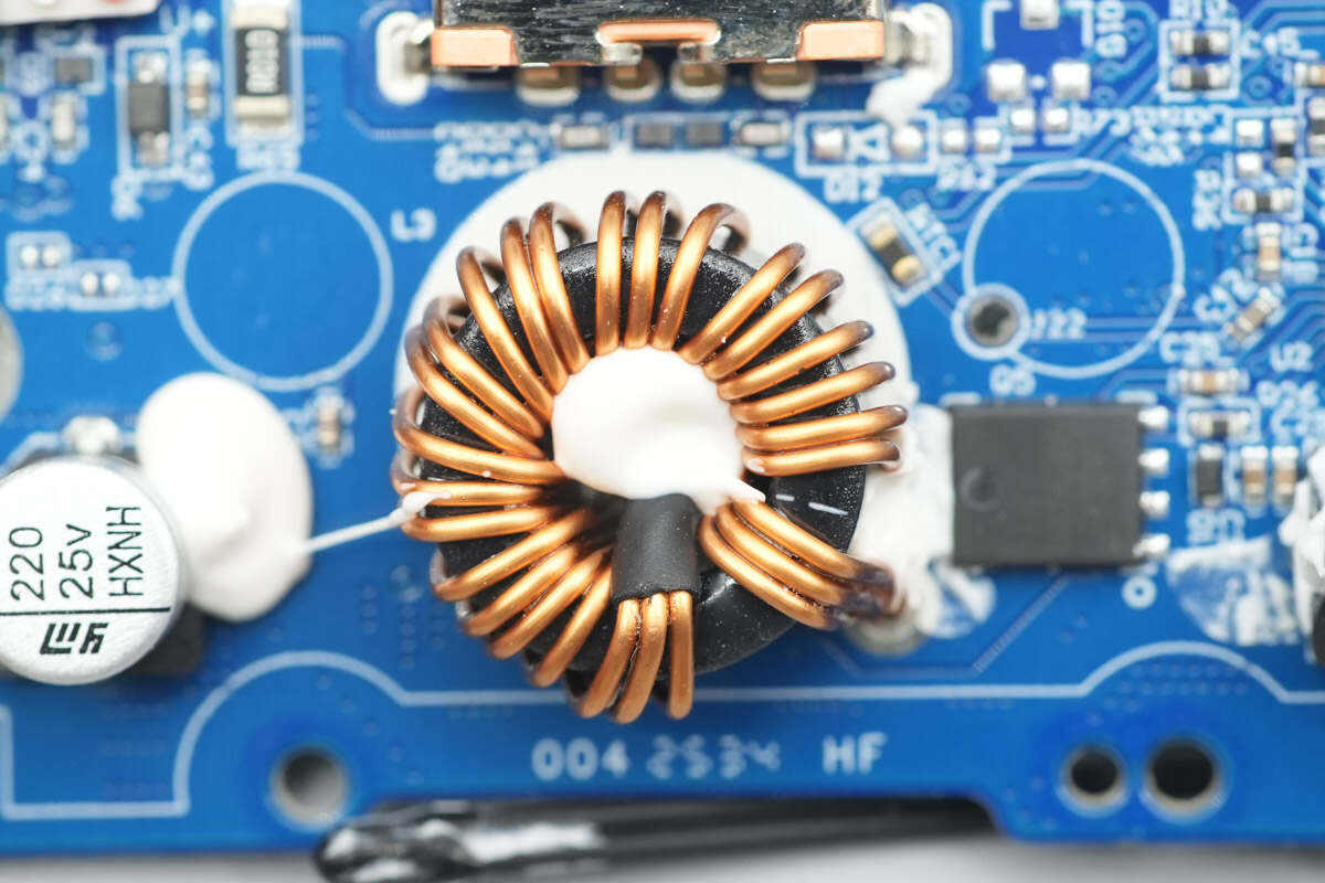

The buck-boost inductor is reinforced with adhesive.

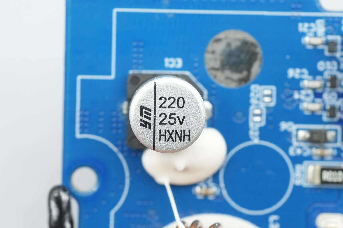

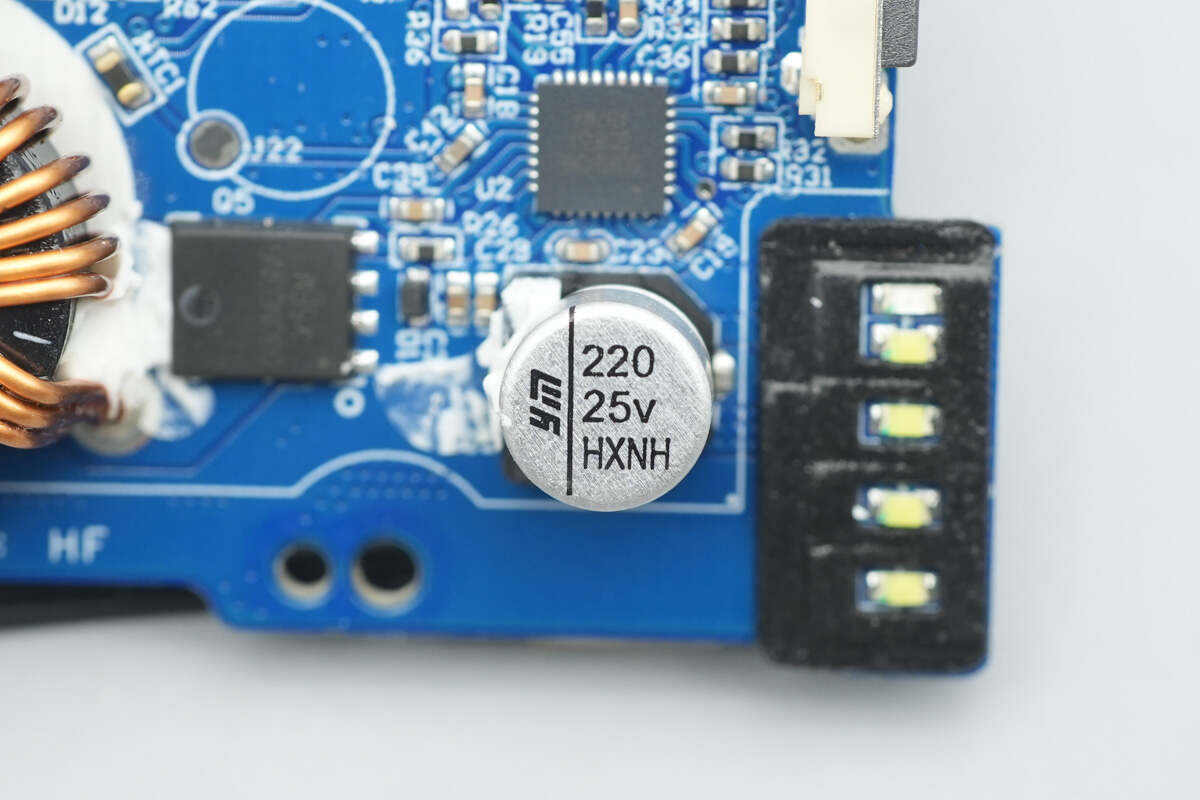

The solid capacitor is from YMIN, rated at 25V 220 μF.
There is another capacitor with the same specifications.

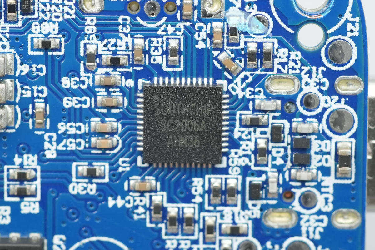

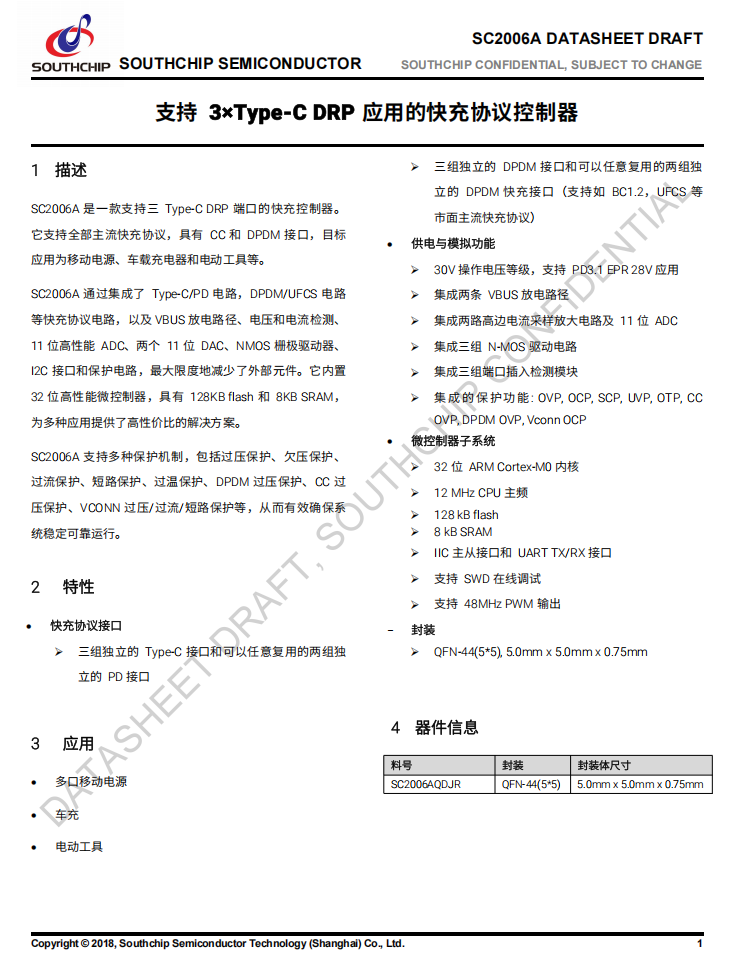

The protocol chip is a SouthChip SC2006A, a fast-charging controller supporting three Type-C DRP ports. It is compatible with all mainstream fast-charging protocols and features CC and DPDM interfaces. Its target applications include power banks, car chargers, and power tools.
The SC2006A integrates Type-C/PD circuits, DPDM/UFCS protocol circuits, a VBUS discharge path, voltage and current sensing, an 11-bit high-performance ADC, two 11-bit DACs, NMOS gate drivers, an I²C interface, and protection circuits, minimizing the need for external components.
The SC2006A features a built-in 32-bit high-performance microcontroller with 128 KB of flash memory and 8 KB of SRAM, providing a cost-effective solution for various applications. It also supports multiple protection mechanisms, including overvoltage, undervoltage, overcurrent, short-circuit, overtemperature, DPDM overvoltage, CC overvoltage, and VCONN overvoltage/overcurrent/short-circuit protection, ensuring stable and reliable system operation.

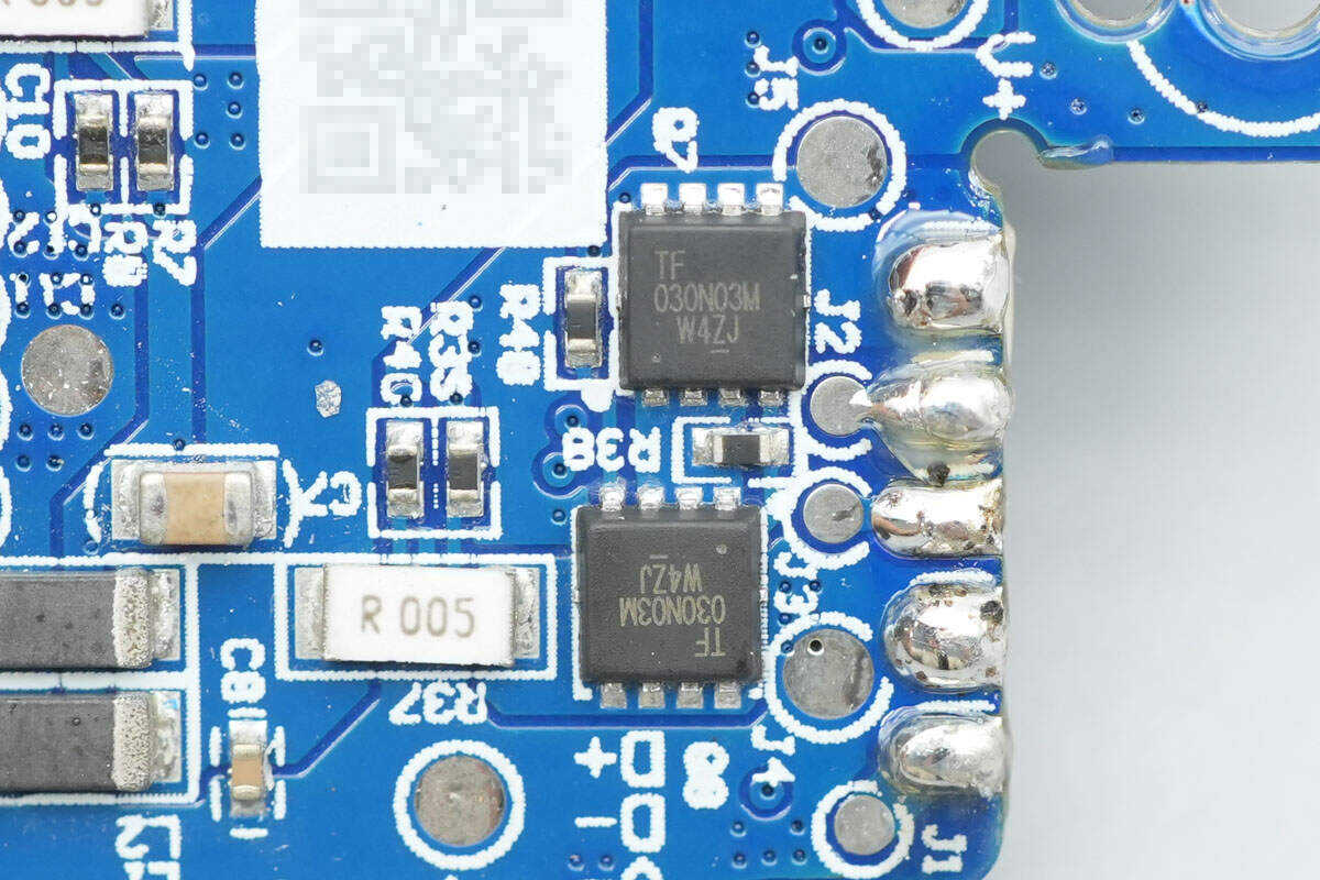

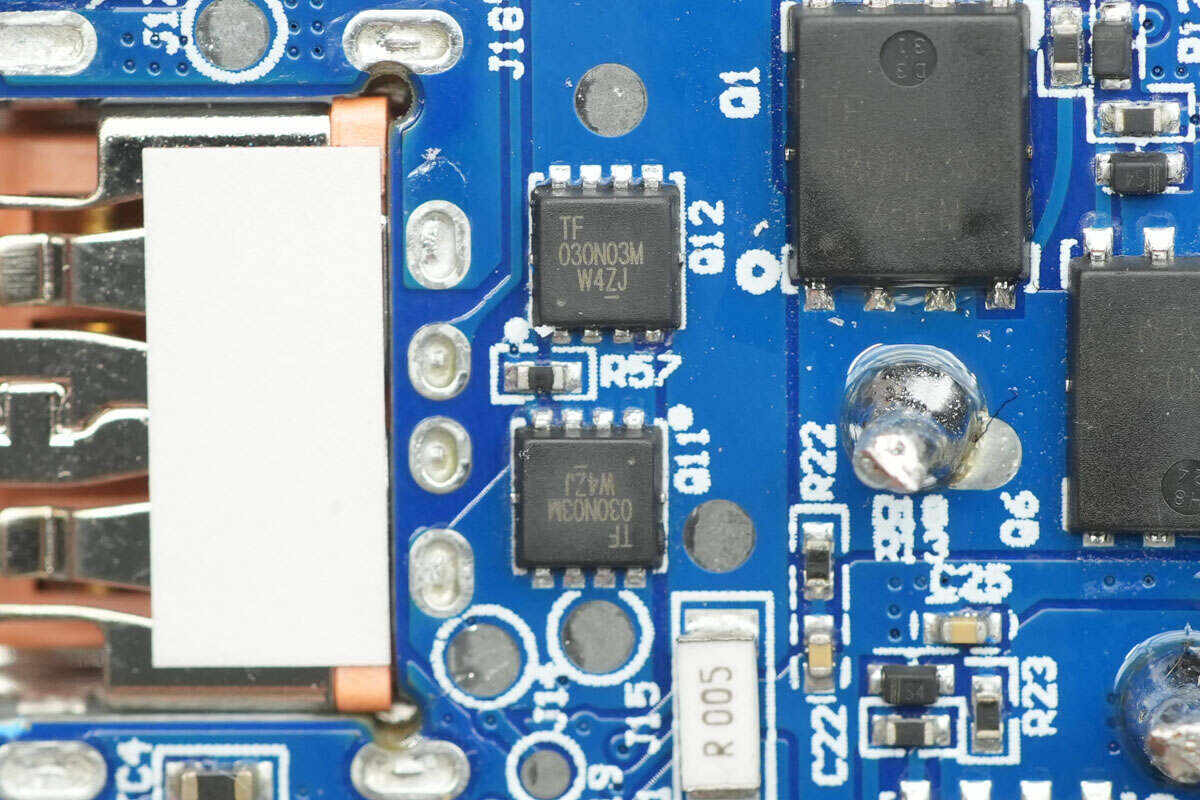

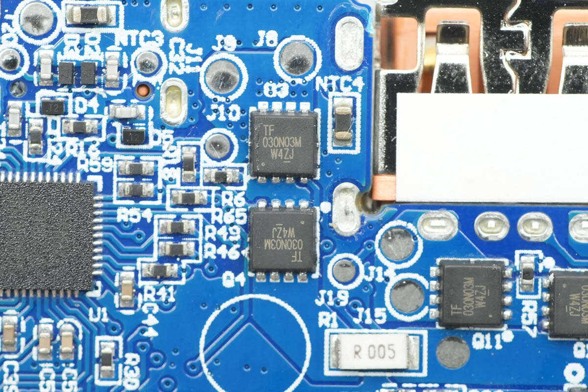

The VBUS MOSFETs for the integrated USB-C cable are from TUOFENG, model TF030N03M, NMOS type, with a voltage rating of 30 V and an on-resistance of 3 mΩ, packaged in PDFN3333‑8L.
The VBUS MOSFETs for the USB-C port also use the TUOFENG TF030N03M.
The VBUS MOSFETs for the USB-A port also use the TUOFENG TF030N03M.

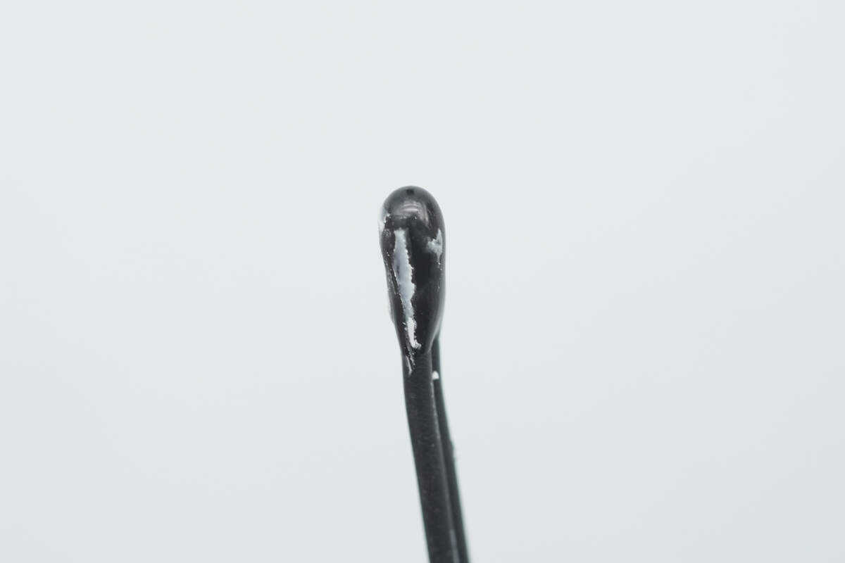

Close-up of the thermistor.

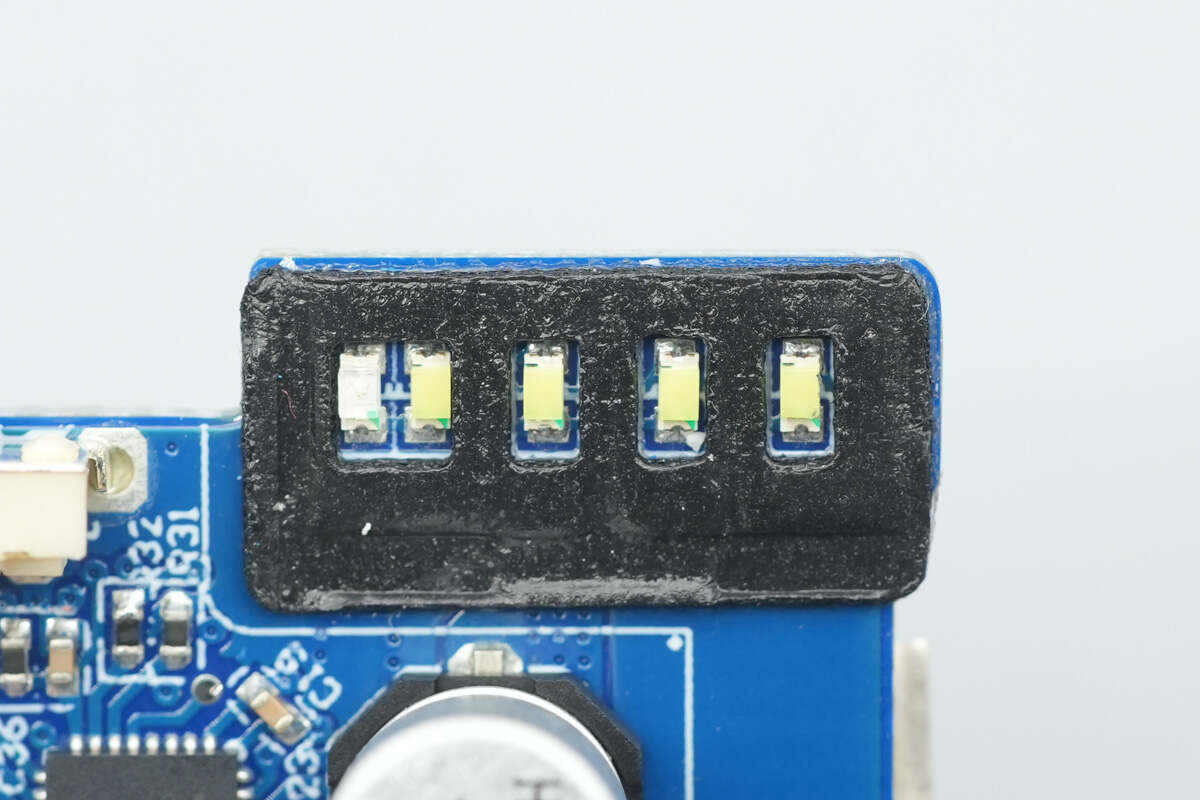

Close-up of the LED indicators.

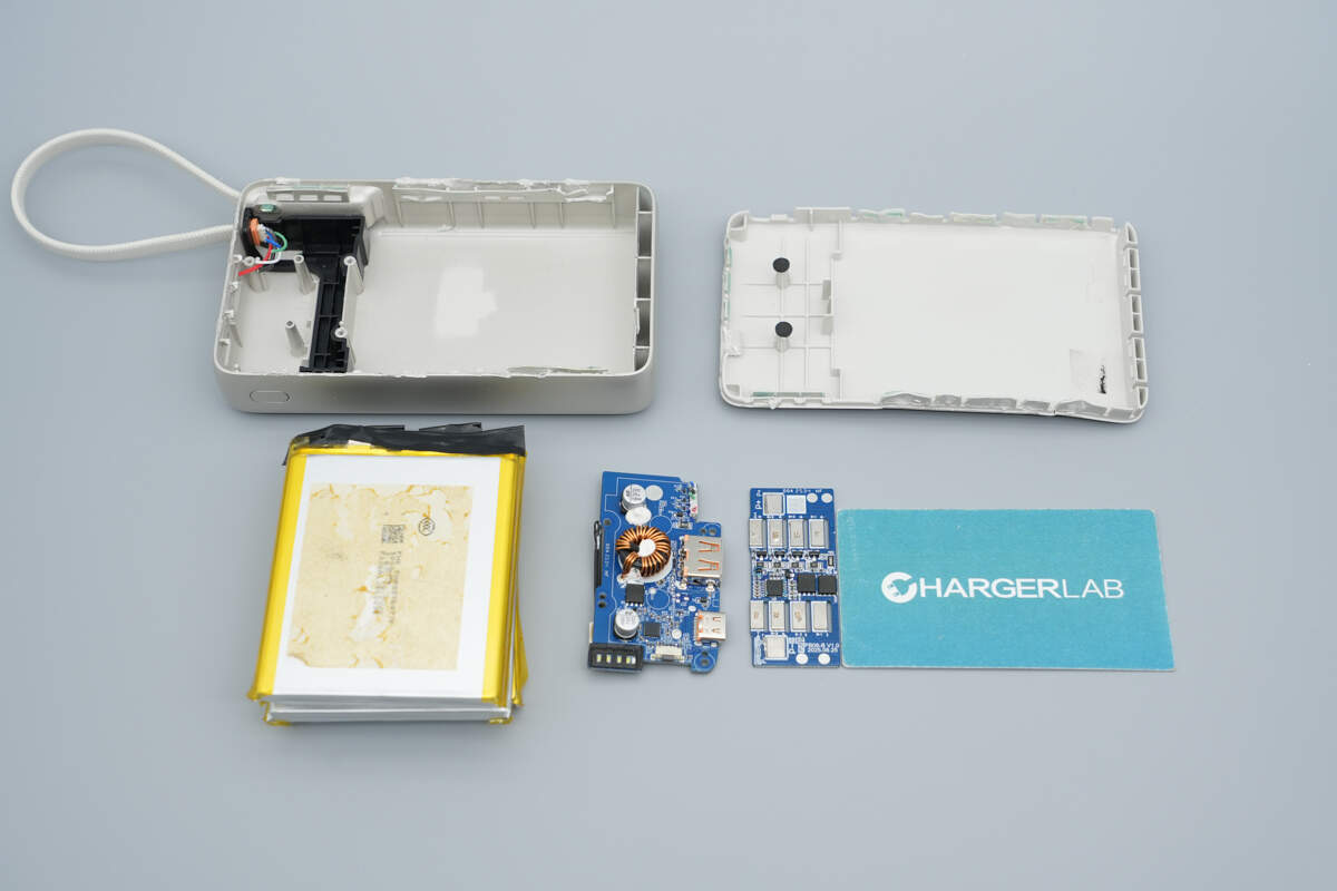

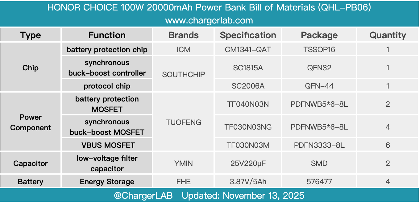

Well, those are all components of the HONOR CHOICE 100W 20000mAh Power Bank.
Here is the component list of the HONOR CHOICE 100W 20000mAh Power Bank for your convenience.
It features an integrated USB-C cable, along with one USB-C and one USB-A port, supporting up to 100W PD/SCP fast charging. A low-current mode is designed for small devices such as wearables, ensuring safe low-power output without damaging the device.
After taking it apart, we found that it uses FHE polymer cells and an iCM CM1341-QAT lithium battery protection solution. The module employs a SouthChip SC1815A power management chip paired with the SC2006A protocol chip to control the integrated USB-C cable, one USB-A port, and one USB-C port for input/output. The battery protection MOSFETs, synchronous buck-boost MOSFETs, and VBUS MOSFETs all come from TUOFENG. Key components, including chips and capacitors, are secured with adhesive for protection.
