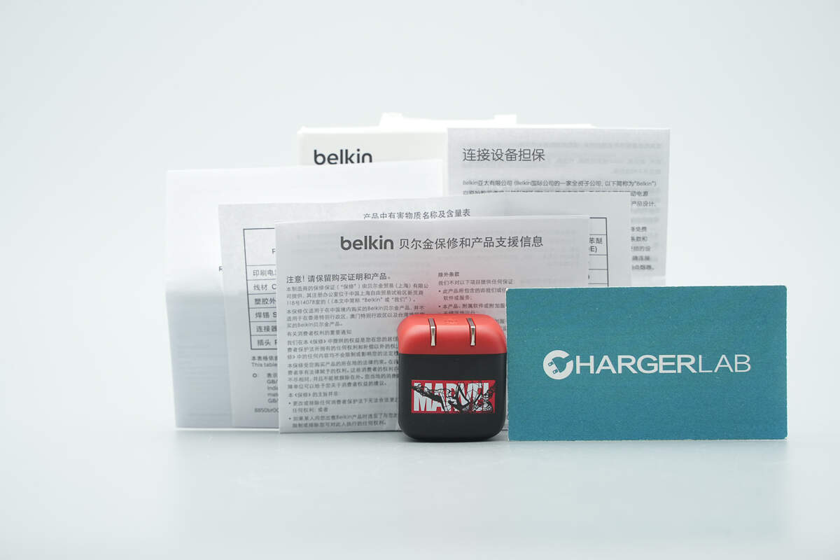

Teardown of Belkin BoostCharge 45W GaN Wall Charger – Spider-Man Limited Edition (WCA013yz)-Chargerlab
The package includes the charger itself, a user manual, a warranty card, and related documentation.

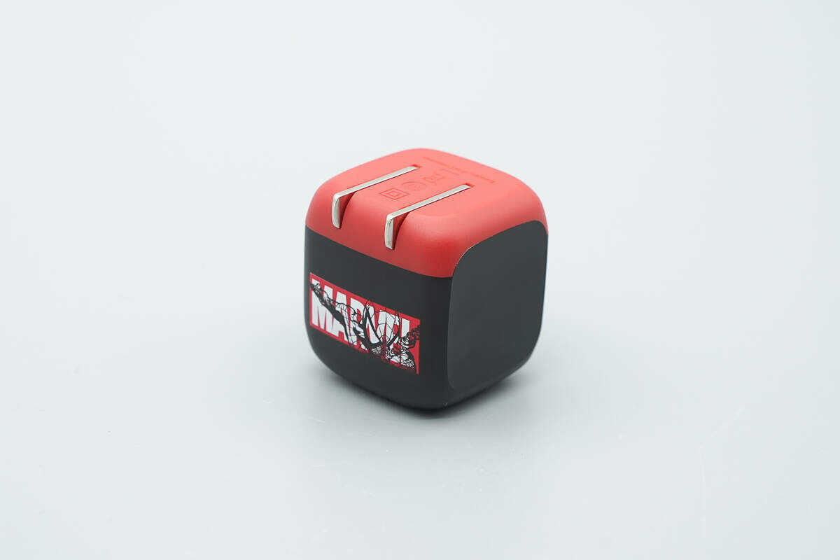

It incorporates the red and black elements of Spider-Man’s suit in its design. The charger has a compact, rounded form factor that gives it a high level of visual distinctiveness.

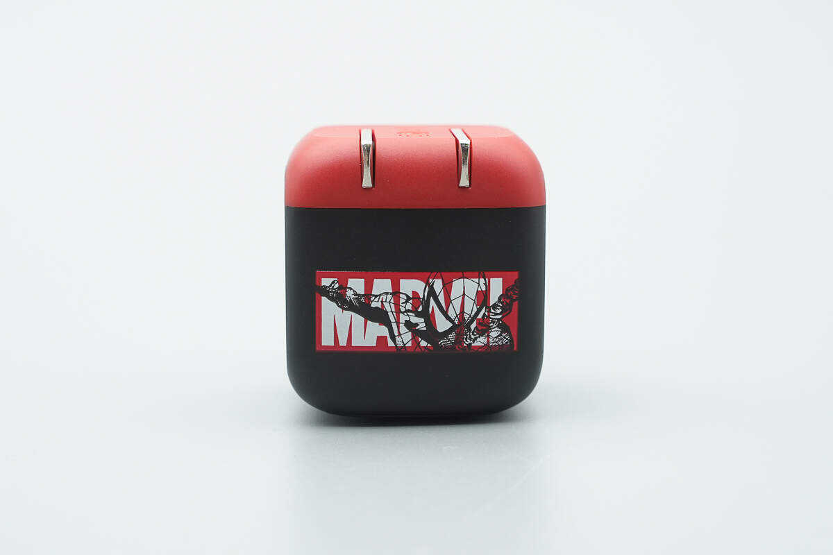

The front features the Marvel logo paired with a comic-style Spider-Man graphic.

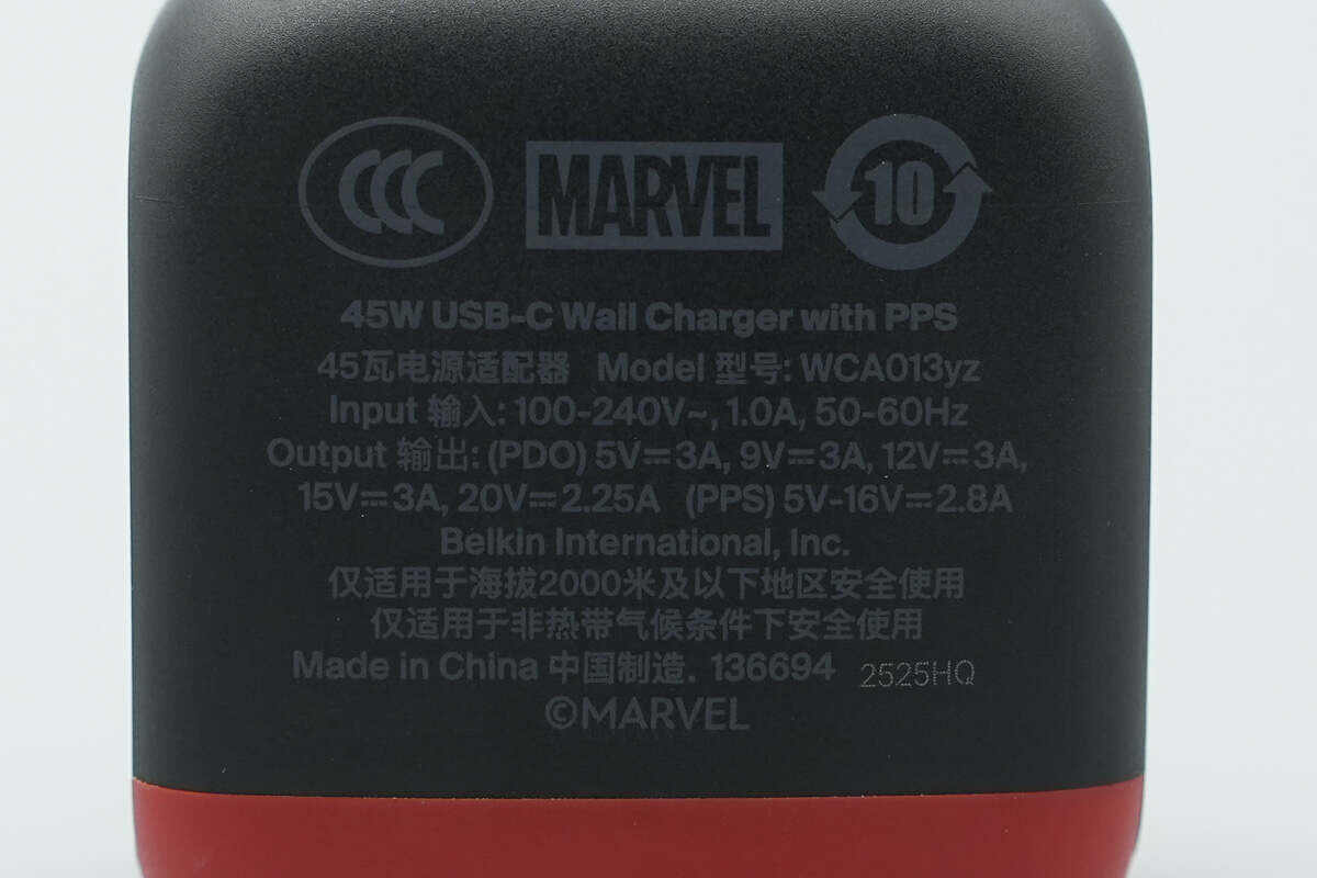

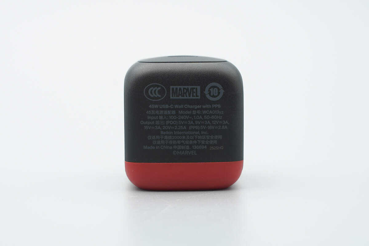

The back displays the specifications.
Model: WCA013yz
Input: 100–240V~50/60Hz 1A
Output: 5V 3A, 9V 3A, 12V 3A, 15V 3A, 20V 2.25A
PPS: 5–16V 2.8A
The product is certified with CCC.

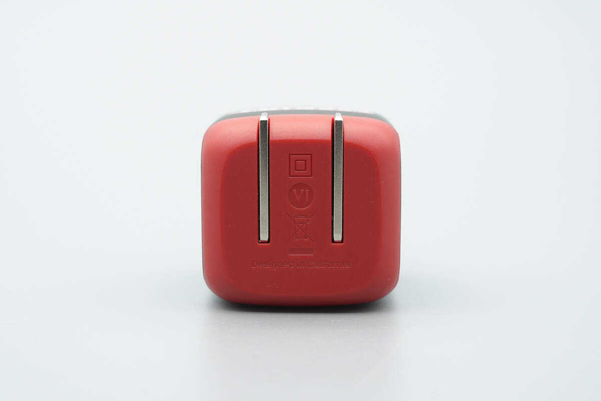

It is also certified with Level VI energy efficiency.

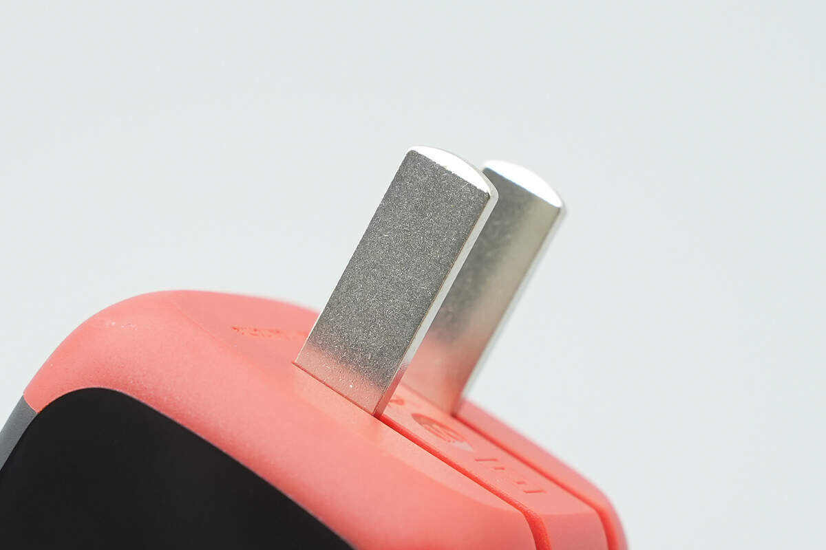

It comes with foldable prongs.

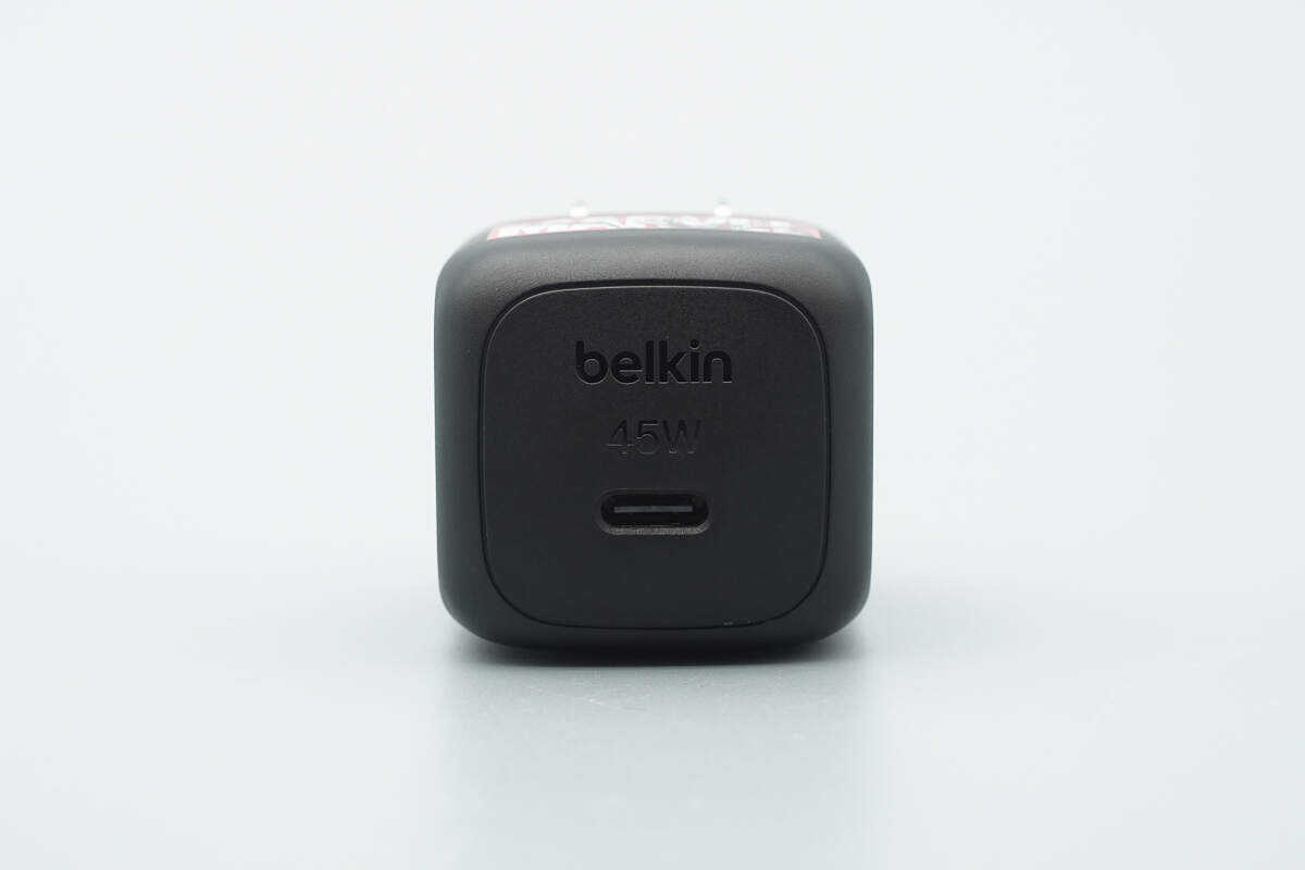

The top features a USB-C port, above which “Belkin” and “45W” are printed.

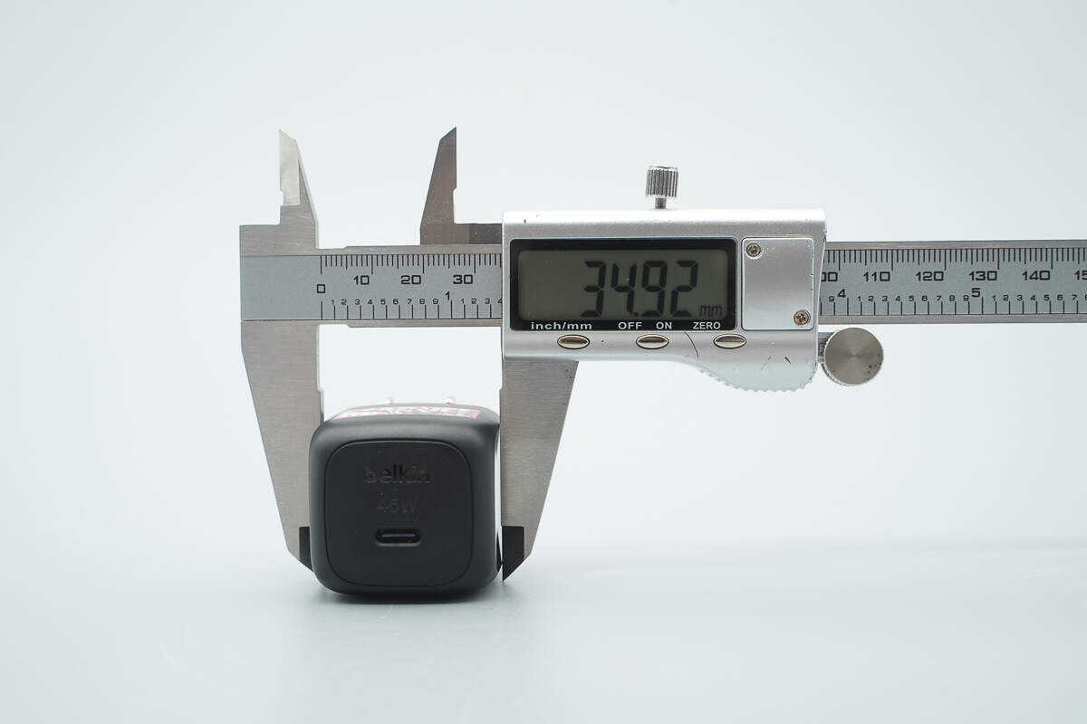

The length of the charger is about 39.52 mm (1.56 inches).
The width is about 34.92 mm (1.37 inches).

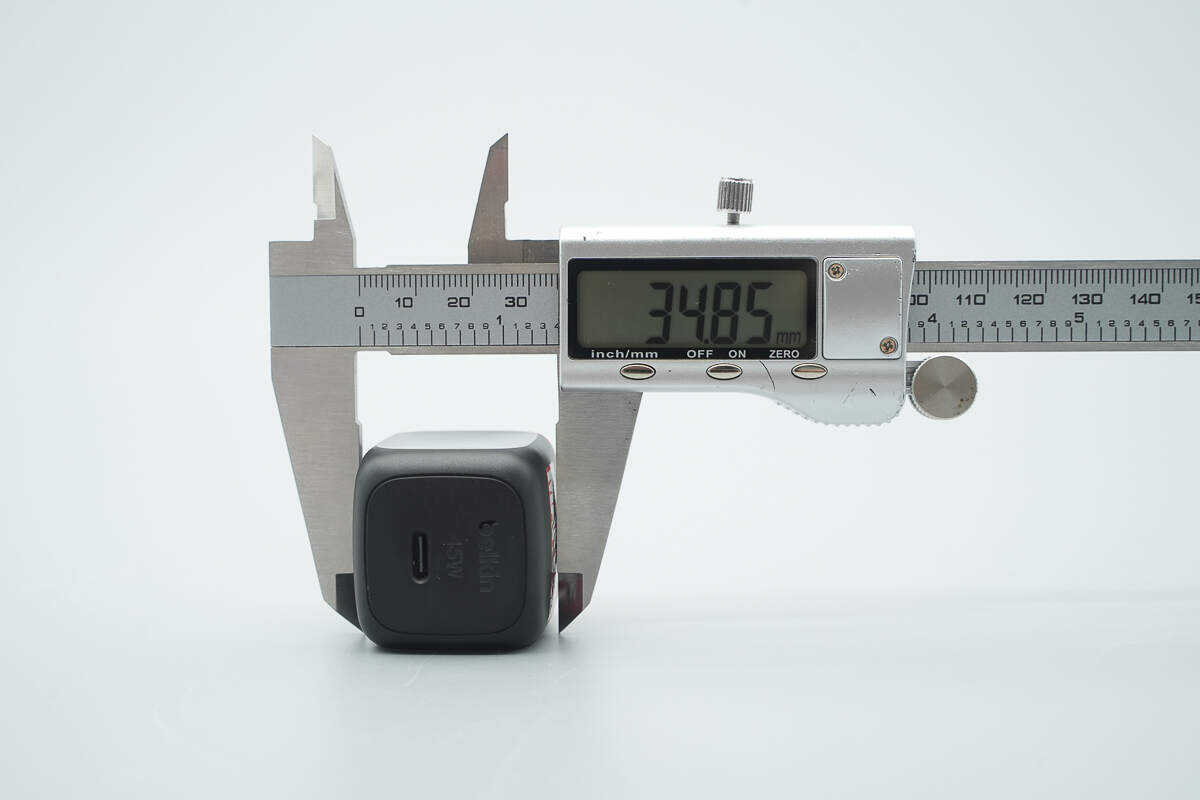

The thickness is about 34.85 mm (1.37 inches).

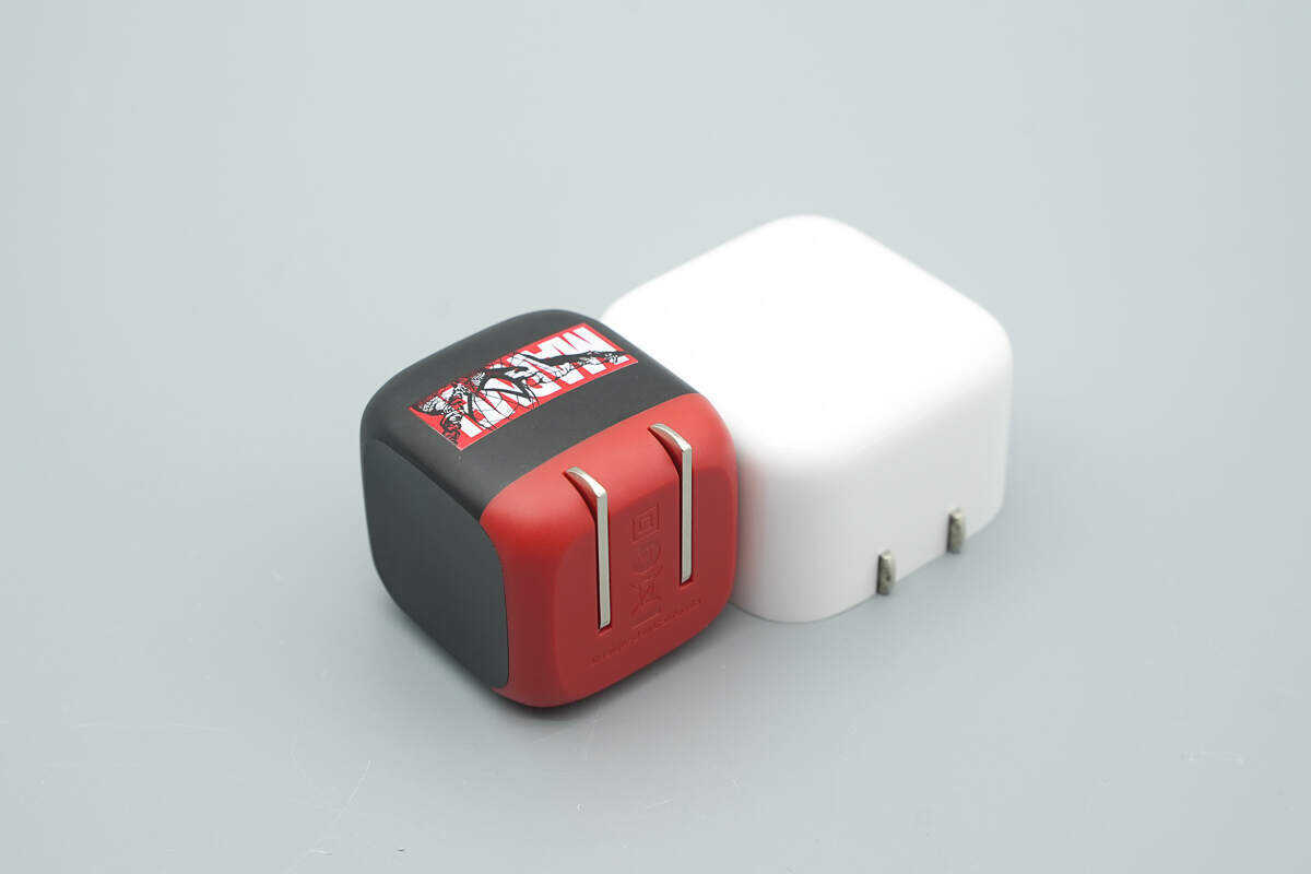

This shows a size comparison with the Apple 40W Dynamic Charger.

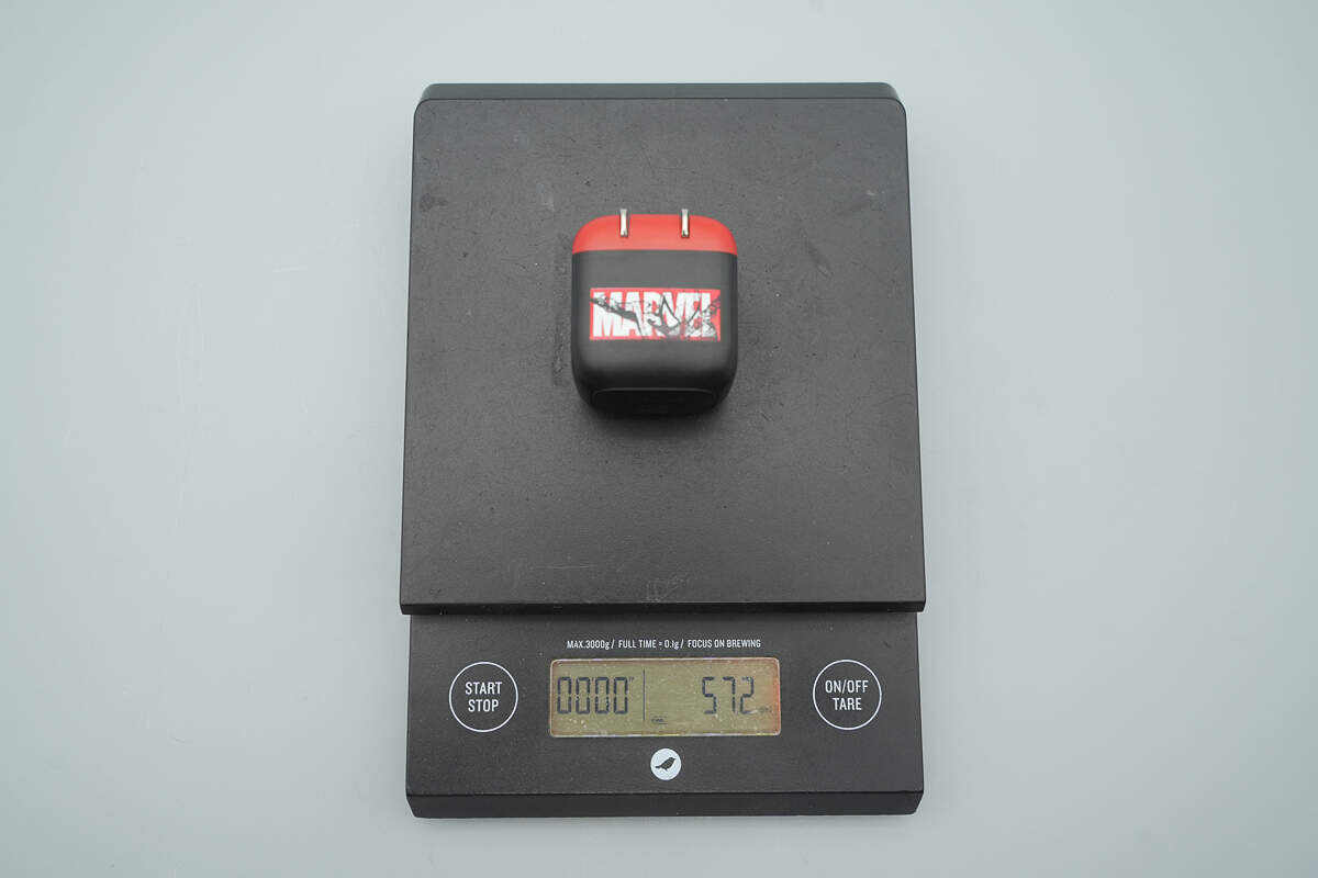

The weight is about 57 g (2.011 oz).

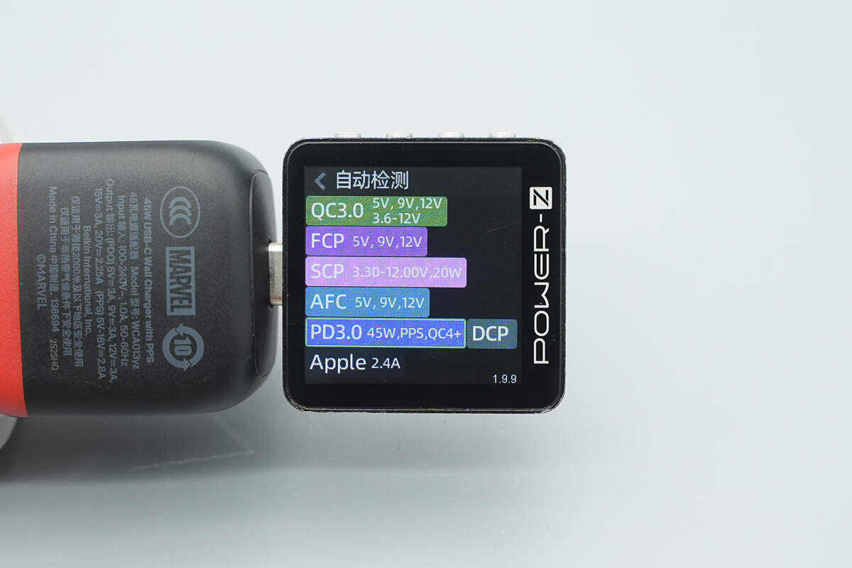

ChargerLAB POWER-Z KM003C shows that it supports QC3.0, FCP, SCP, AFC, PD3.0, PPS, QC4+, DCP, and Apple 2.4A charging protocols.
It features five fixed PDOs of 5V3A, 9V3A, 12V3A, 15V3A, and 20V2.25A. It also has one set PPS, which is 5-16V3A.

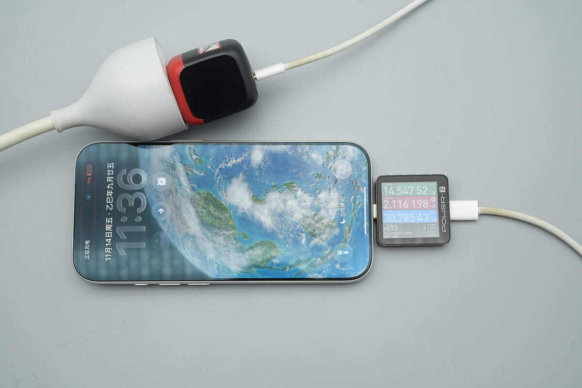

Use it to charge the iPhone 17 Pro, the charging power is about 30.79W.

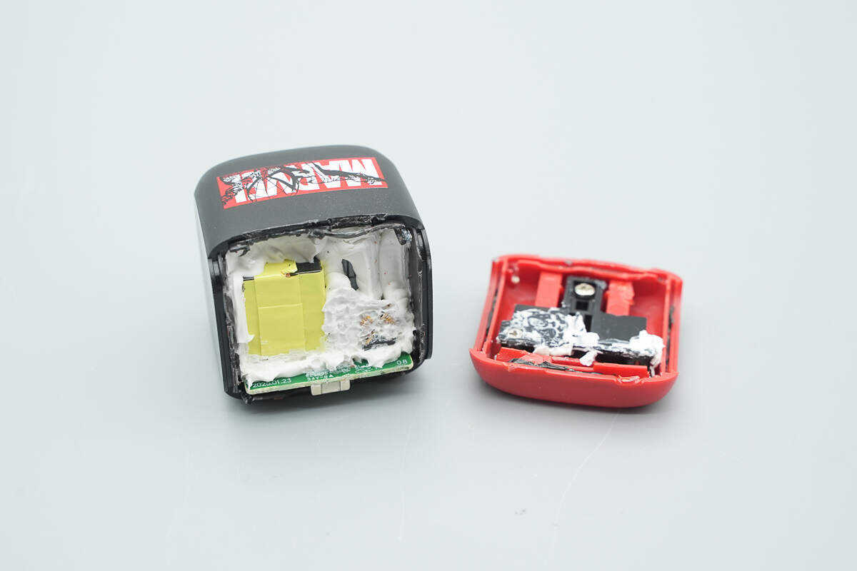

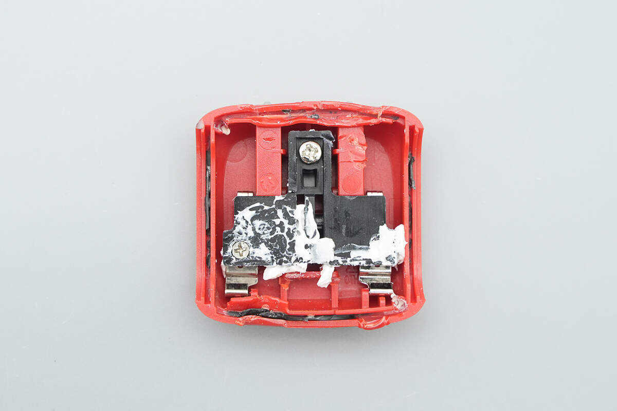

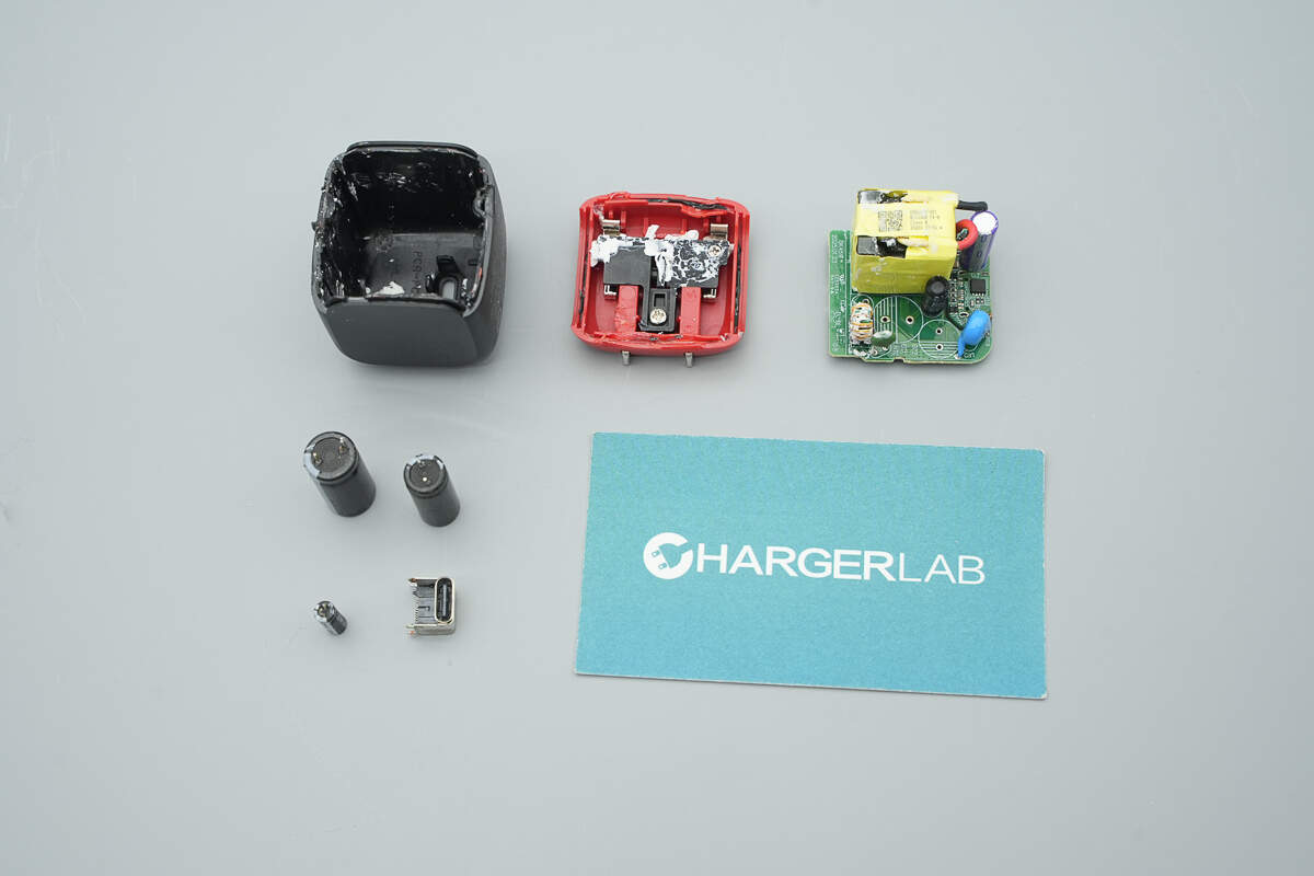

Open the input-end casing, which is joined using ultrasonic welding.
The input section uses a contact-based electrical design, with the prongs secured by a black plastic plate and screws.

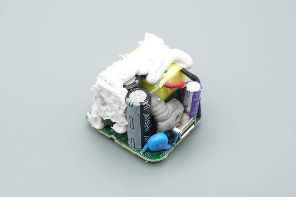

The interior of the charger is heavily filled with white adhesive, keeping the PCBA module securely in place.

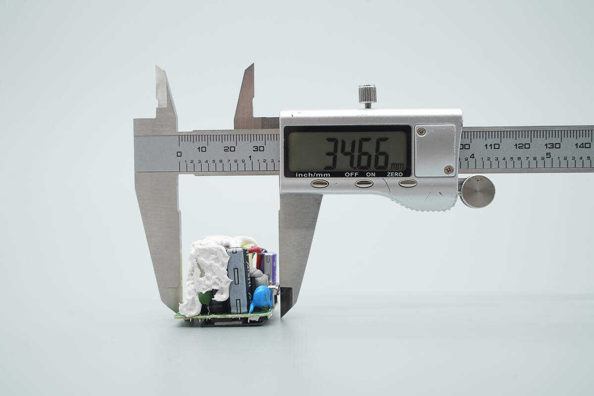

The length of the PCBA module is about 34.66 mm (1.36 inches).

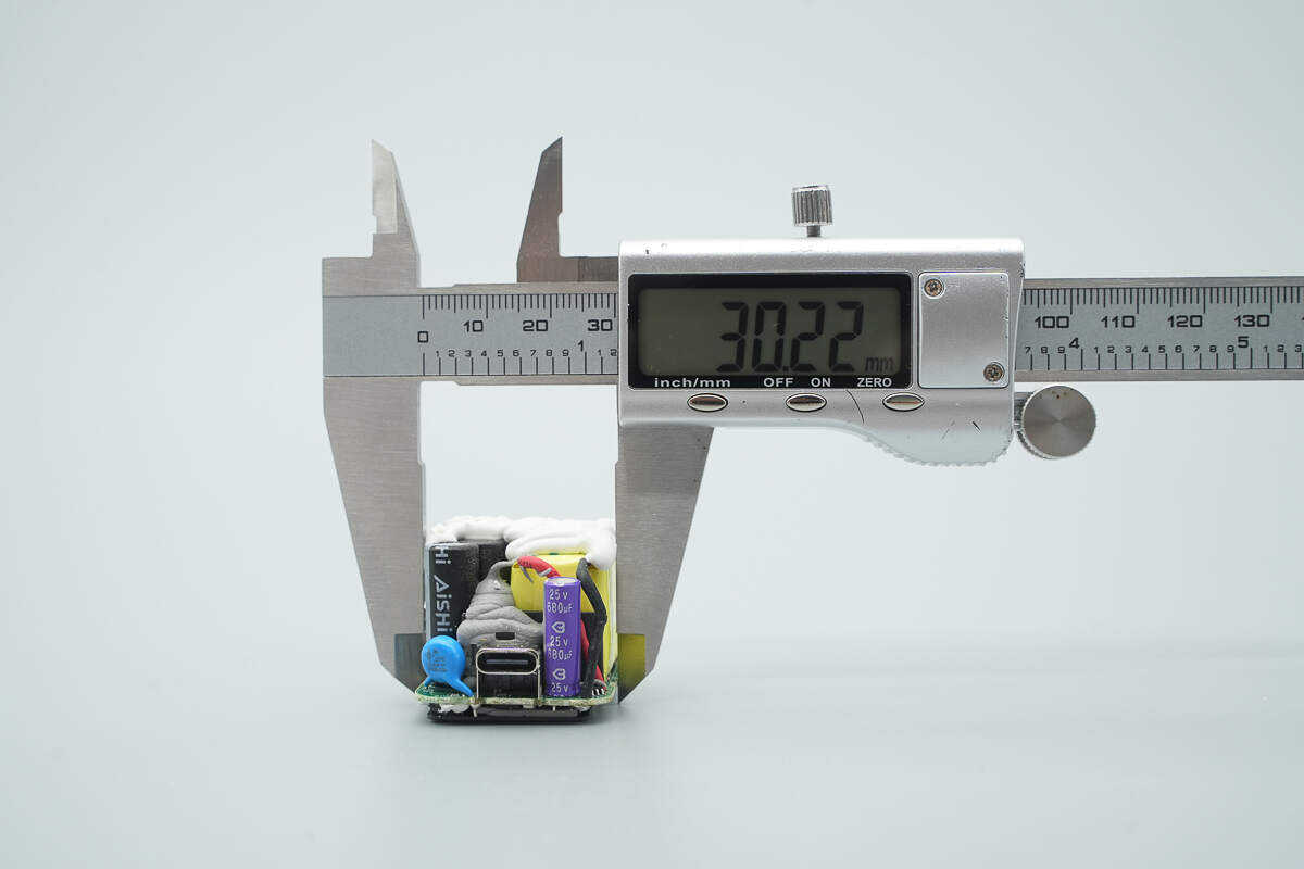

The width is about 30.22 mm (1.19 inches).

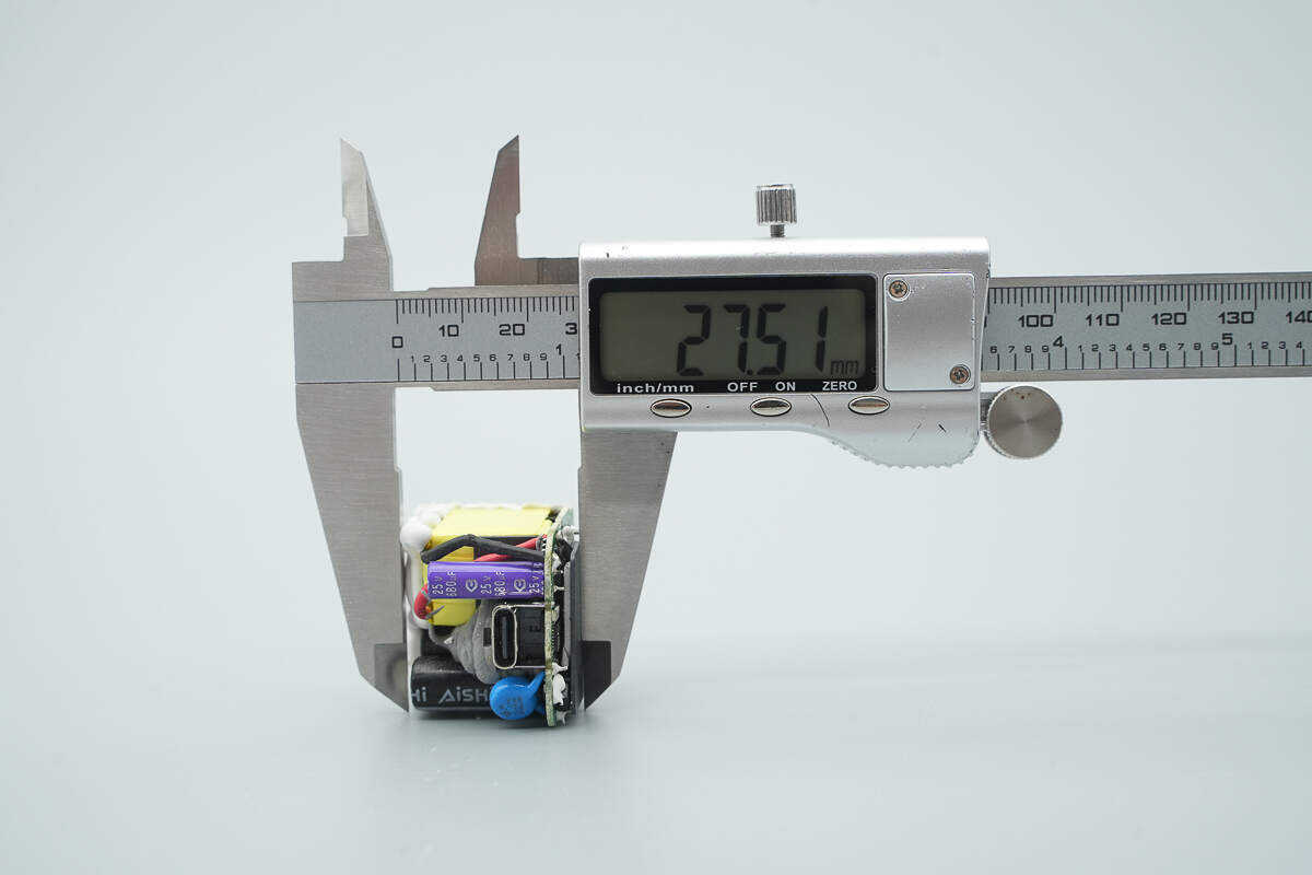

The thickness is about 27.51 mm (1.083 inches).

The gap between the capacitor and transformer is filled with gray thermal paste, and the USB-C socket is reinforced with a steel sleeve.

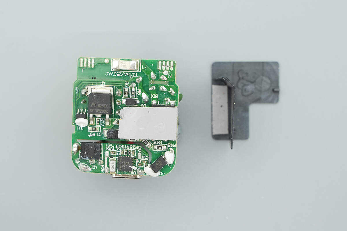

At the bottom, there is a plastic plate that isolates the primary and secondary circuits.

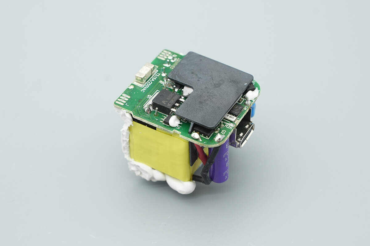

Remove the plastic plate. Thermal pads are seen at the bridge rectifier and synchronous rectifier.
Cleaning away the gray and white adhesive. This side of the PCB reveals an NTC thermistor, a common mode choke, high-voltage filter capacitors, and a Y capacitor.

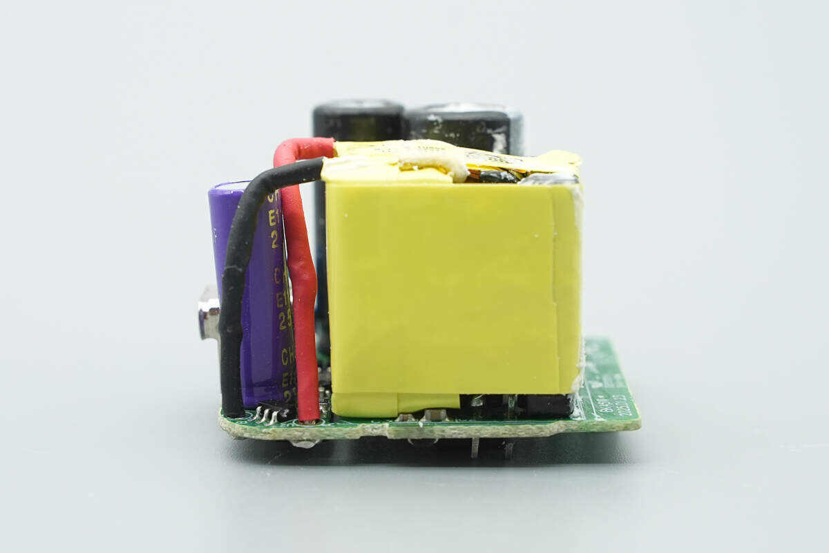

On the other side, there is a transformer, a synchronous rectifier controller, and a solid capacitor for output filtering.

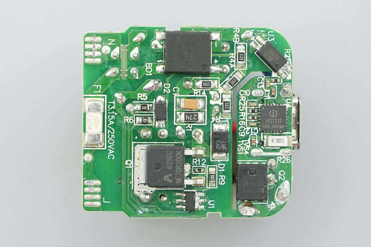

On the back side, there are an SMD fuse, a bridge rectifier, a primary controller, a primary MOSFET, an optocoupler, a synchronous rectifier, and a protocol chip.

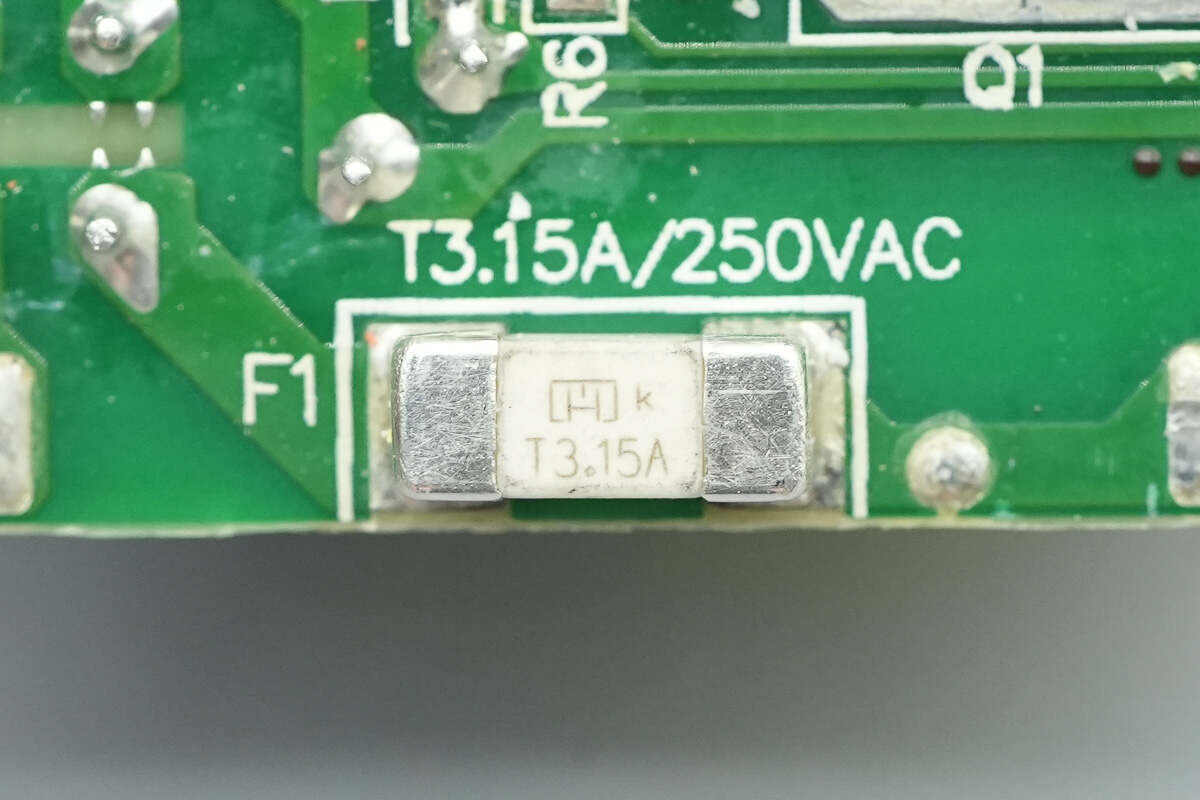

The SMD fuse is rated for 3.15A.

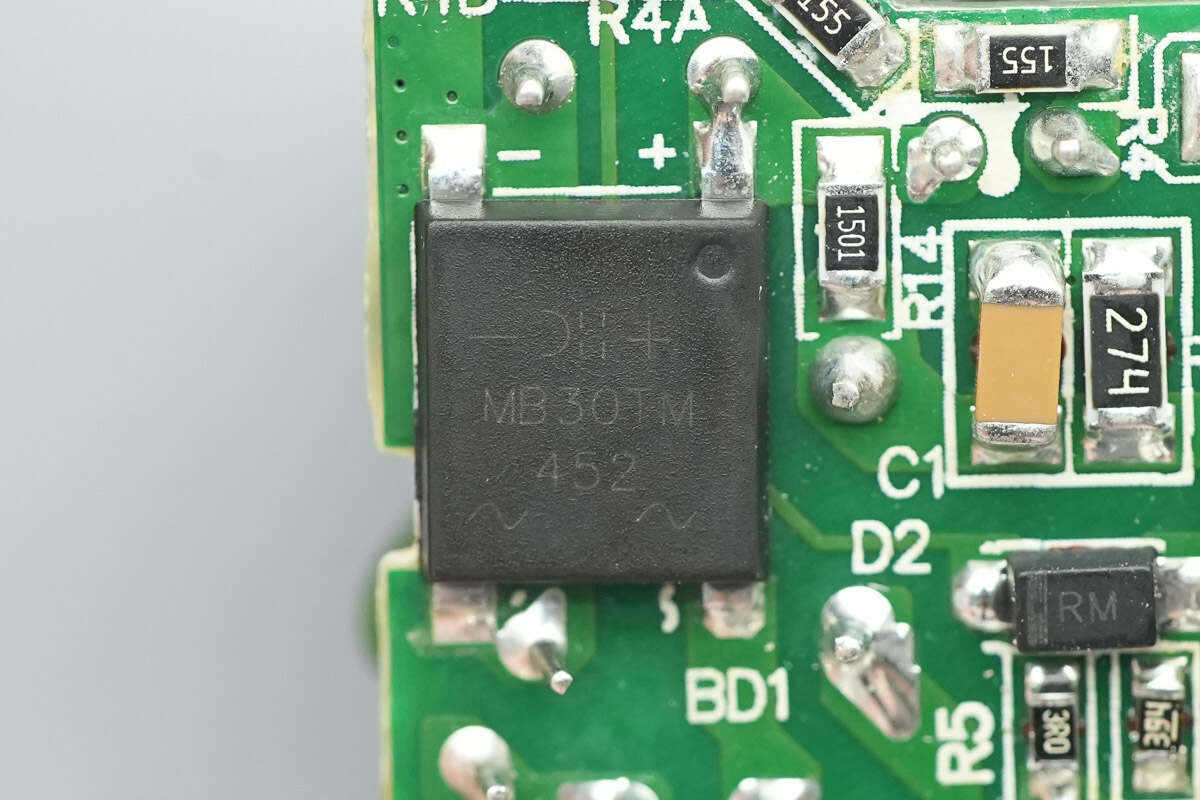

The bridge rectifier is from DIODES, model MB30TM.

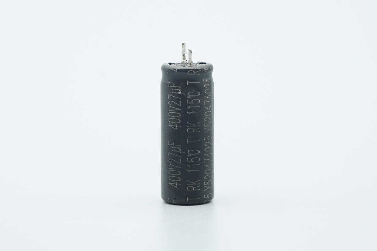

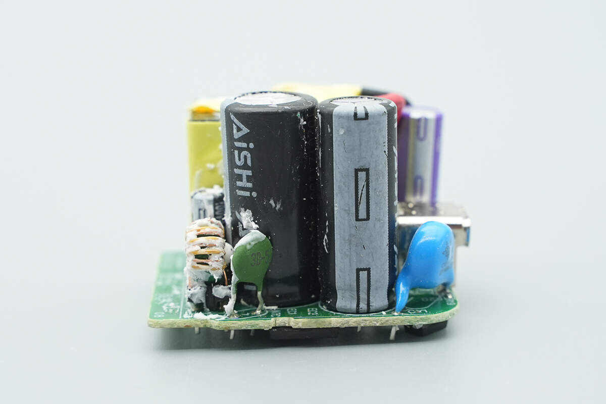

The high-voltage electrolytic capacitor is from AiSHi.
It is rated at 400V, 27μF.

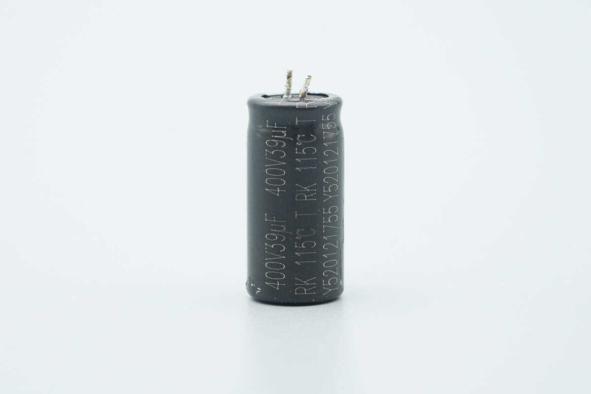

The other one is also from AiSHi.
It is rated at 400V, 39μF.

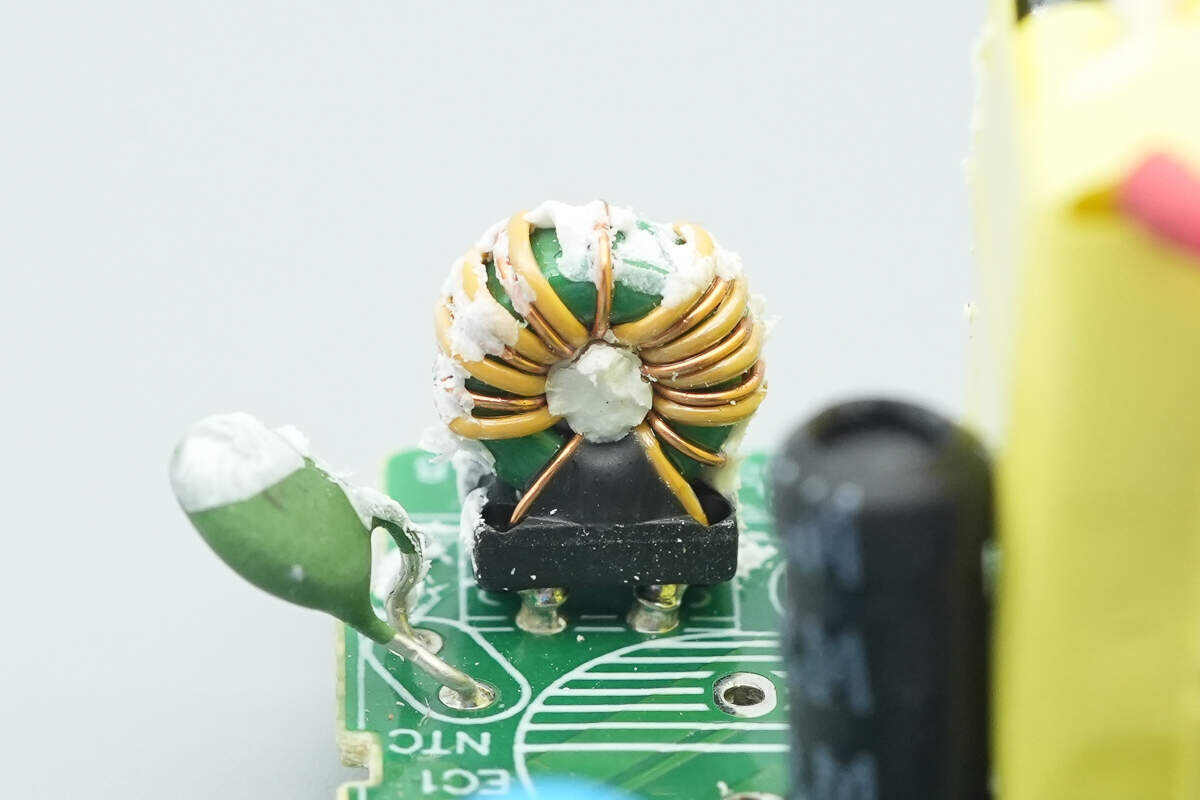

The I-shaped inductor is covered with heat-shrink tubing for insulation and protection.

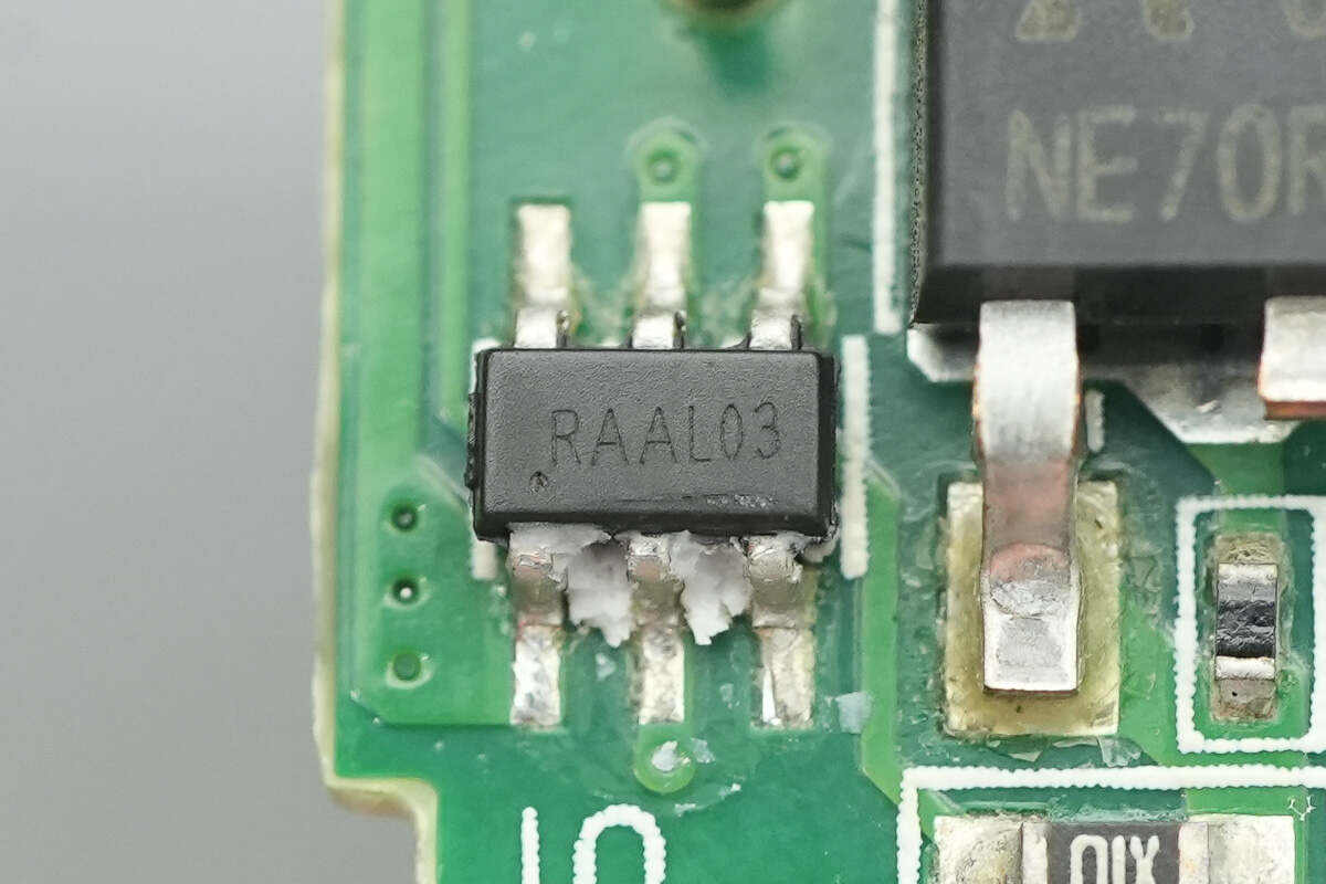

The primary controller chip is marked RAAL03 and packaged in a SOT-23-6.

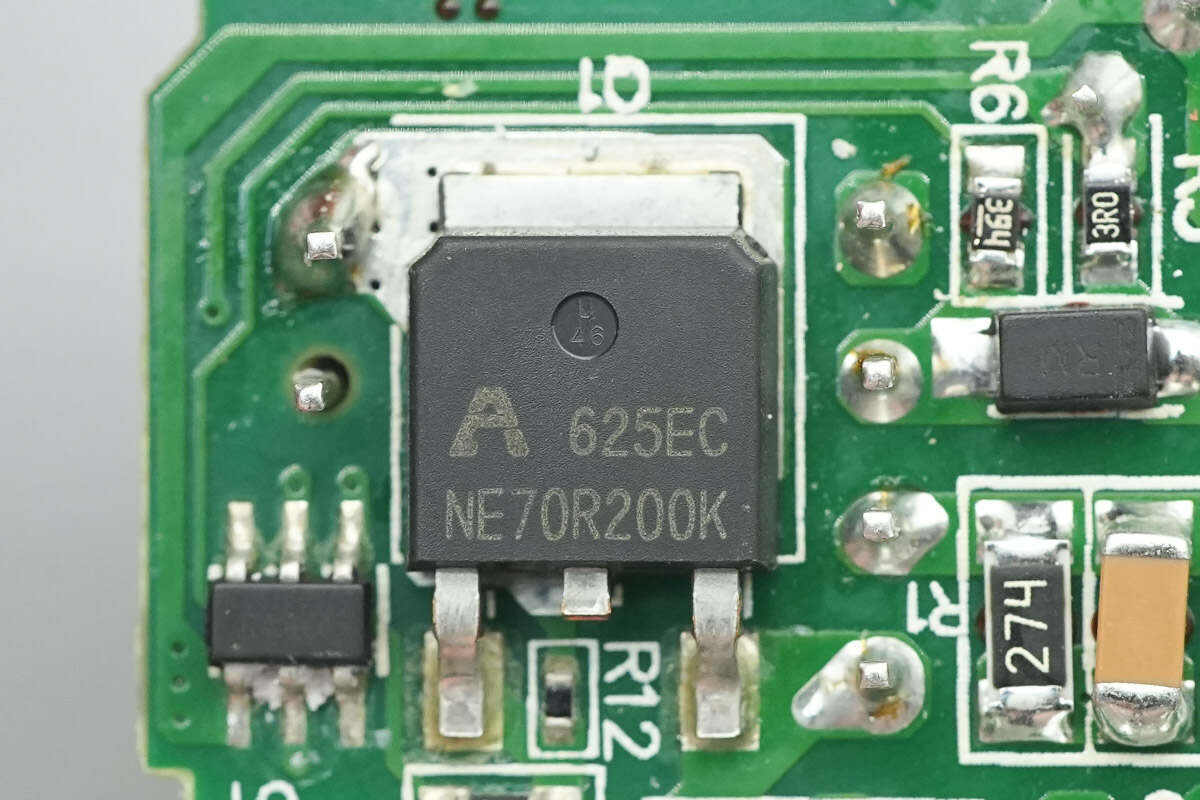

The primary MOSFET is from Allpower, model APNE70R200K. It is a 700V enhancement-mode GaN FET with a 10A current rating and normally-off characteristics. Its typical on-resistance is below 200mΩ (at VGS = 6V), which helps significantly reduce conduction losses. This MOSFET is suitable for applications such as AC-DC converters, DC-DC converters, Totem-pole PFC circuits, and high-density power modules.

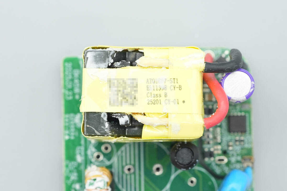

Close-up of the transformer.

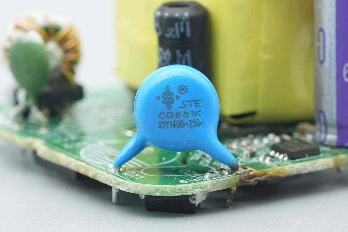

The blue Y capacitor is from STE.

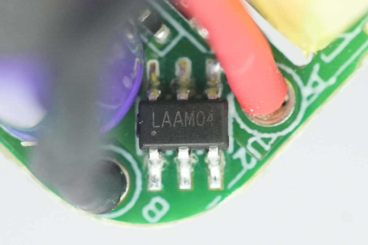

The synchronous rectifier controller is marked LAAM04 and comes in a SOT-23-6 package.

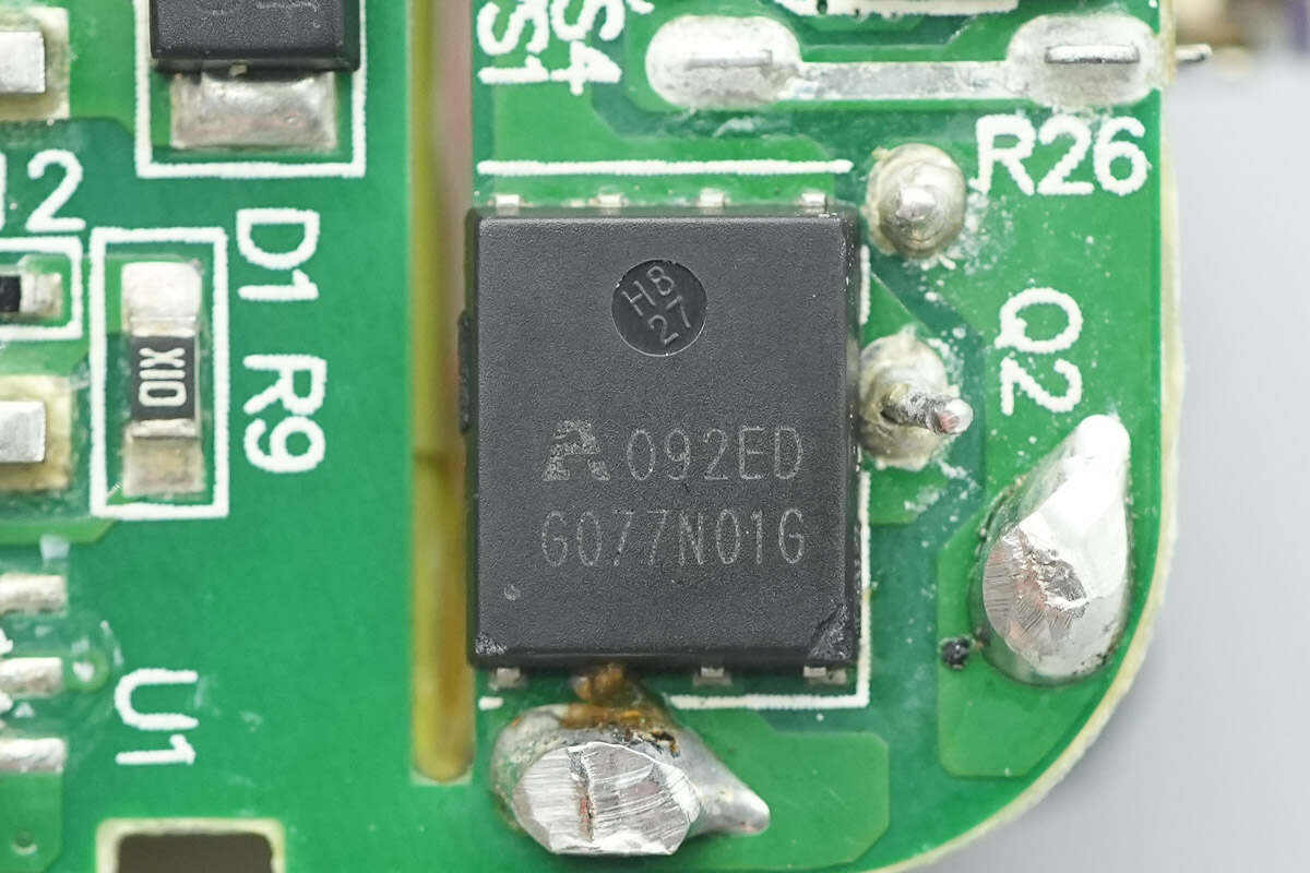

The synchronous rectifier is also from Allpower, model APG077N01G. It is an NMOS with a voltage rating of 100V and an on-resistance of 6.2mΩ, packaged in PDFN 5×6.

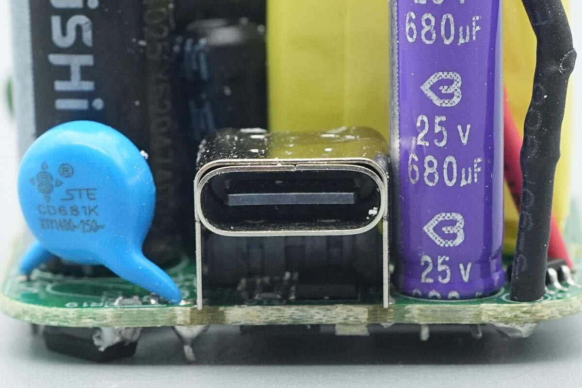

The solid capacitor for output filtering is from BERYL, rated at 25V, 680μF.

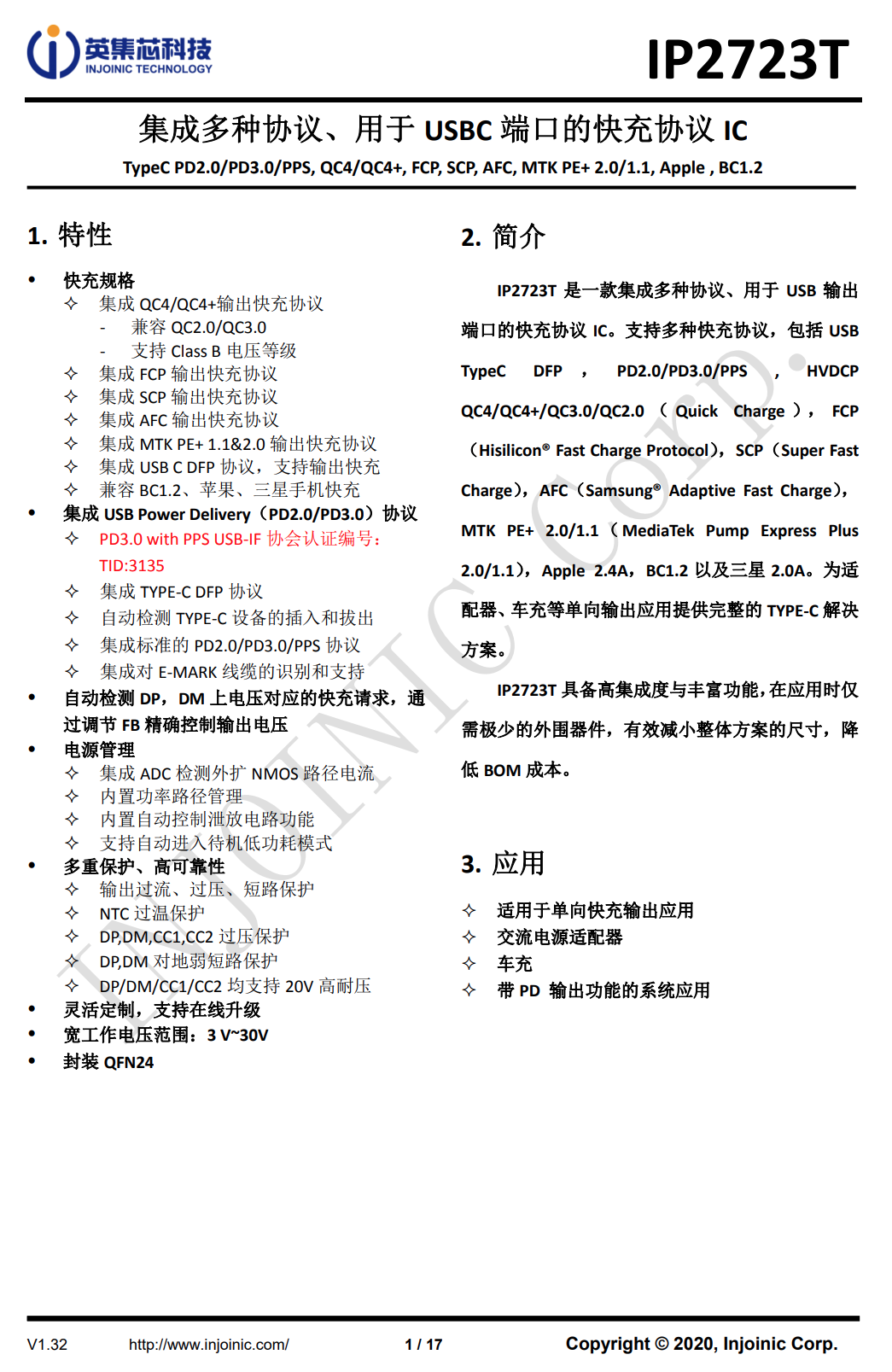

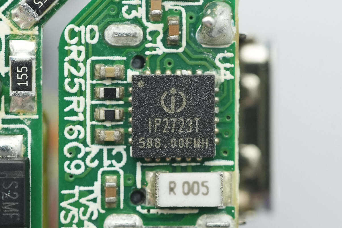

The protocol chip is from Injoinic, model IP2723T. This chip is certified by the USB-IF for PD 3.0 and PPS, TID: 3135, and integrates multiple protocols for USB output ports. It supports fast-charging protocols including USB Type-C DFP, PD 2.0/3.0, PPS, HVDCP QC4, QC4+, QC3.0/2.0, FCP, SCP, AFC, MTK PE+ 2.0/1.1, Apple 2.4A, BC1.2, and Samsung 2.0A. It provides a complete Type-C solution for one-way output applications such as adapters and car chargers. The IP2723T features high integration and rich functionality, requiring minimal external components, effectively reducing overall solution size and lowering BOM cost.

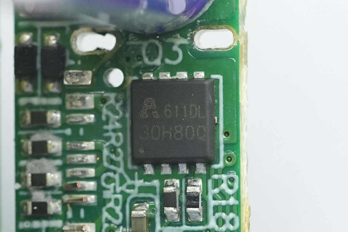

The output VBUS MOSFET is from Allpower, model AP30H80Q. It is an NMOS with a voltage rating of 30V and an on-resistance of 4.1mΩ, packaged in PDFN 3×3.

Close-up of the USB-C socket.

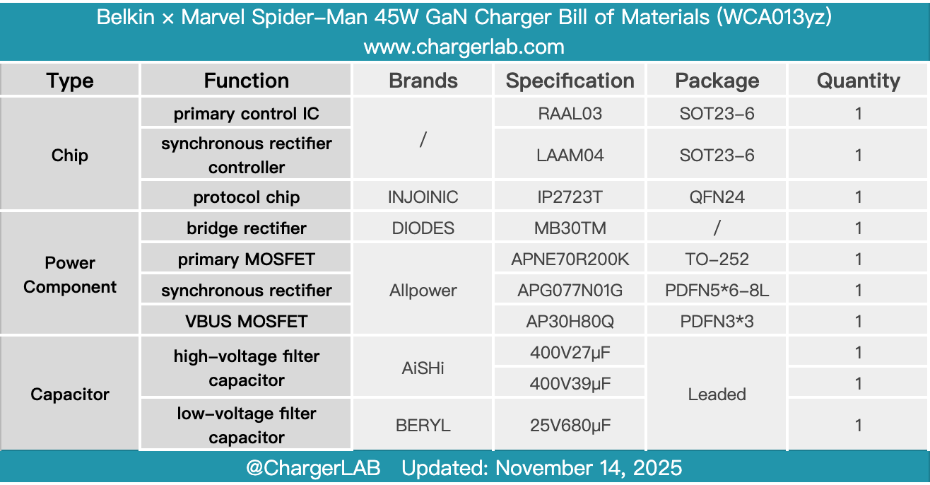

Here is the component list of the Belkin BoostCharge 45W GaN Wall Charger – Spider-Man Limited Edition for your convenience.
