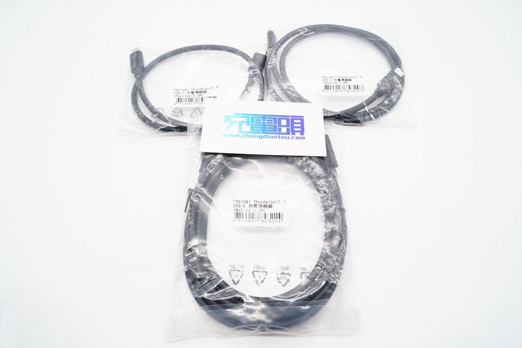

The cables we received this time are divided into three different lengths, namely 0.5 m, 0.8 m, and 2 m, to adapt to different purposes.
Review of Pasidal’s New Product: Ultra-high-speed Thunderbolt 4 Cable-Chargerlab

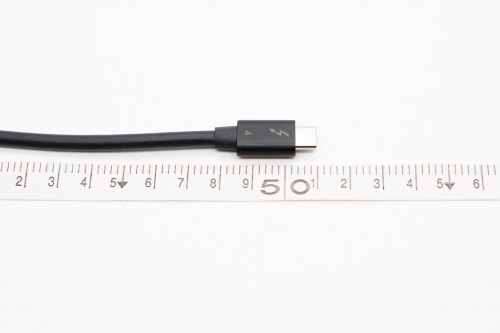

The first one is the 0.5 m cable. Because the cable length is relatively short, the impact of the cable length within 50 cm is close to 0 for the transmission quality, so it can work perfectly. The performances of active and passive cable are the same. Therefore, it is a passive cable, which is suitable for copying data from an SSD and using the power bank to charge.

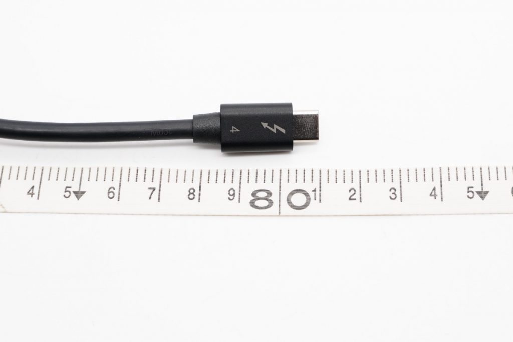

Then, it will be the 0.8 m passive cable, which is the limit length that the current passive cable can be achieved. The limit length of the Apple passive cable is also the same, which reflects the excellent quality of this cable. This cable is more suitable for desktop charging, external desktop graphics card, display output and other purposes.
The last one is an active cable of 2m. At this length, the bandwidth will be severely affected by the length of the cable. It is necessary to purchase an active cable with a chip. The passive cable can only achieve 20 Gbps bandwidth at that length. This length is mainly suitable for some special purposes, for example, the outlet is far away and needs to be extended.

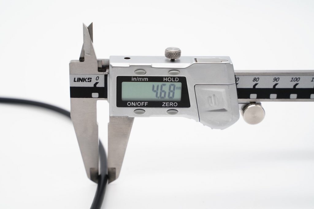

The cable is made of black rubber wire, which is tight, smooth and without burrs.
The diameter of the cable is 4.68 m. It can support higher bandwidth requirements.

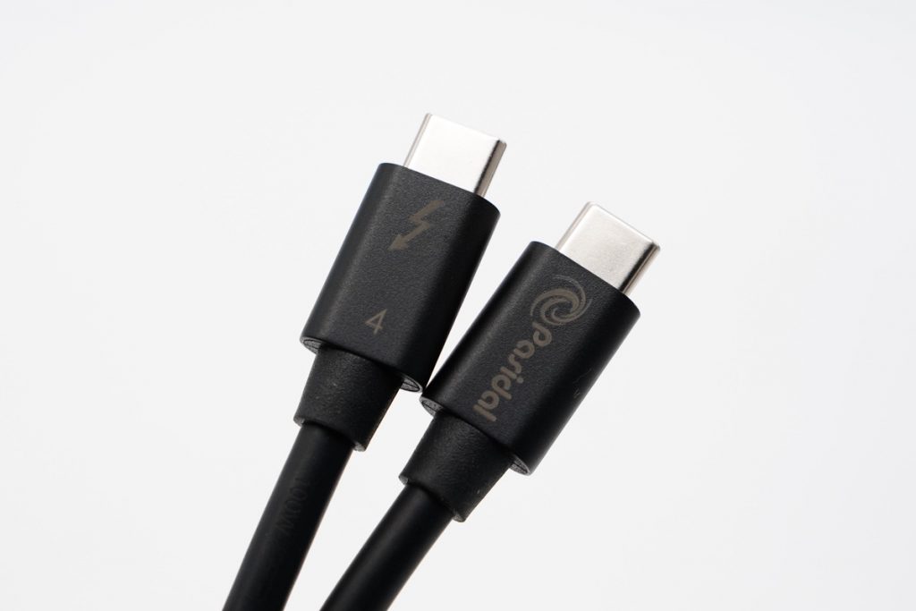

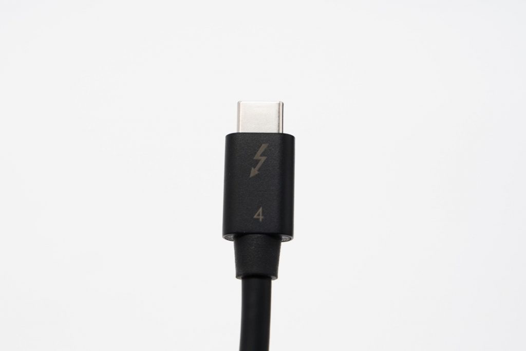

There is a thunderbolt mark on both sides of the cable, and the “4” means this cable is the fourth-generation thunderboltstandard. At present, only the Thunderbolt 4 cables that have passed the official certification of Intel can print the Thunderbolt mark and the number 4 logo at the end of the cable, which is convenient for users to judge the specifications of the cable clearly.
At the same time, there is Pasidal logo on the other side of the cable, and it extended the length of the end, making the product more durable.
Up and down sides of the Pasidal Thunderbolt 4 cable used 12-pin, a total of 24 full pins, which meets the requirements of the Thunderbolt 4 standard. At the same time, there are three clips on the top and bottom to ensure the stability of the connection.

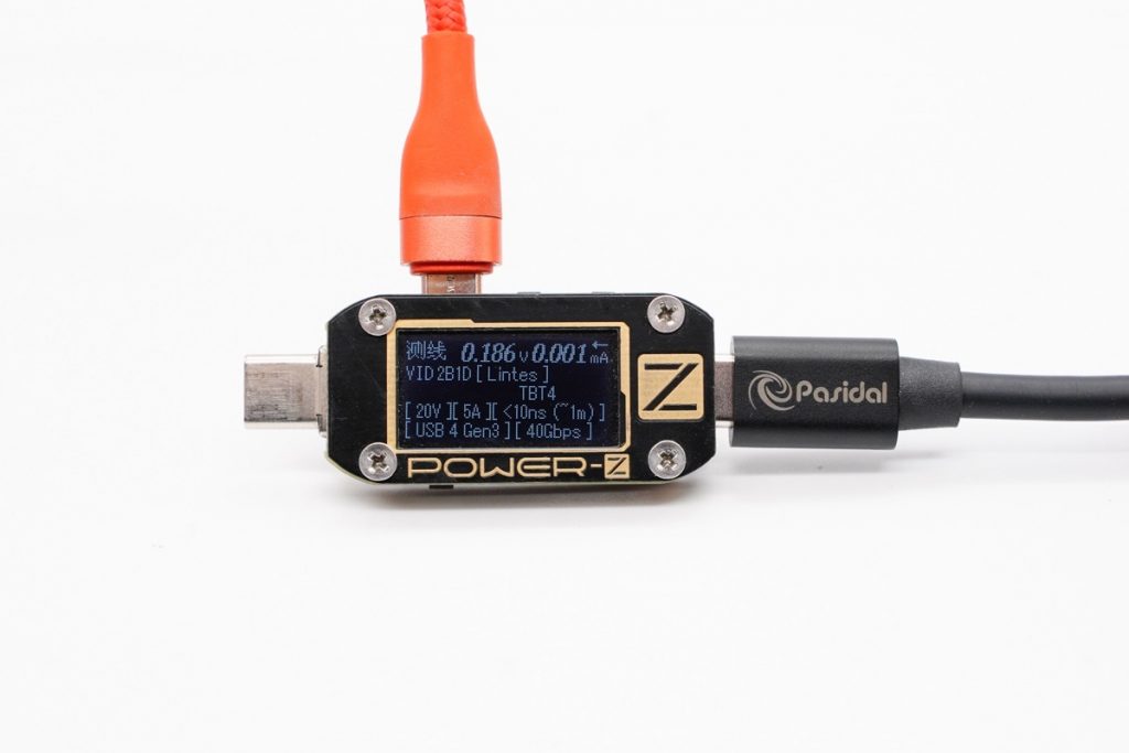

Use ChargerLAB POWER-Z KT002 to check the cable information. You can see that it supports up to 20V 5A 100W power, and the cable length is less than 1 m.

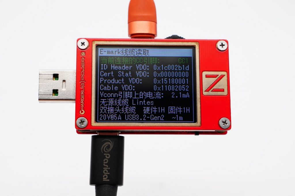

Use ChargerLAB POWER-Z KM001C to reread the cable information. You can see the same power information, while supporting up to 40 Gbps bandwidth. And there are 22 Gbps is used to transmit data, and 18 Gbps or above is used to transmit video.

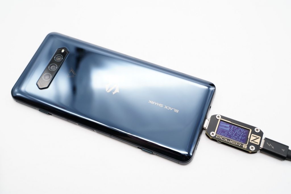

First of all, we found the Black Shark 4 Pro, which supports up to 120 W ultra-fast charging, which can basically test the power limit of the cable. The mobile phone comes with a 120W USB-A output port. However, it can also have good compatibility with third-party high-power chargers, so you can find a charger with a USB-C output port in the test. And we can see the power is 93.24 W.

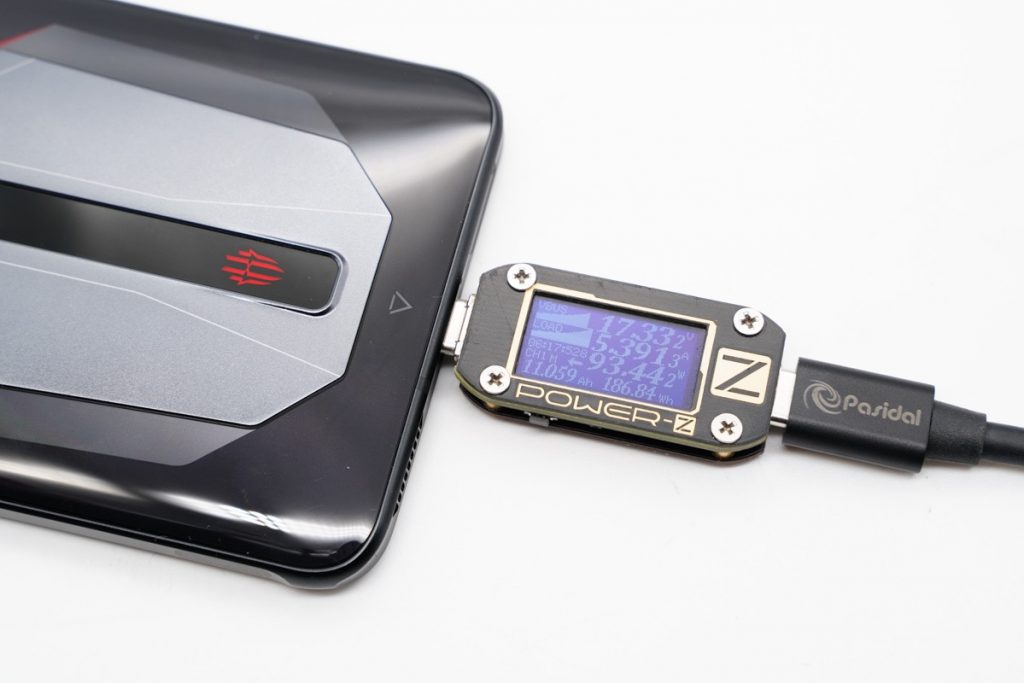

This is another gaming phone, the Red Magic 6 Pro. It also supports 120W ultra-fast charging, and the charging power we can see is 93.44W. Basically the same as the previous one.

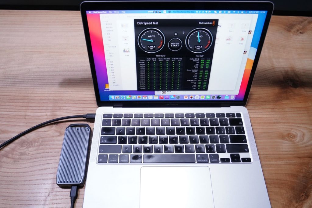

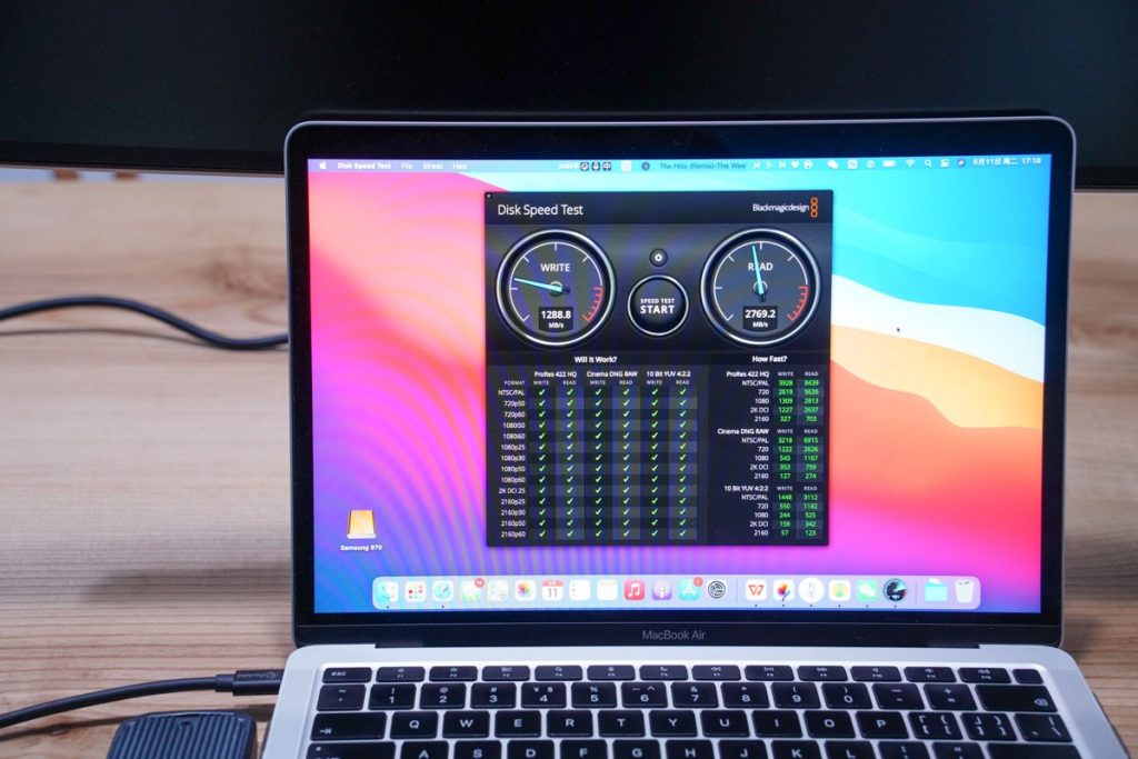

In the data transmission part, we found the latest Macbook Air equipped with the M1 chip, with Samsung 970EVO SSDand a hard drive enclosures that supports the USB 4 standard.
It can be seen that the transmission speed can reach to 1288.8m/s for writing and 2769.2m/s for reading, which meets the standard of Thunderbolt 4.

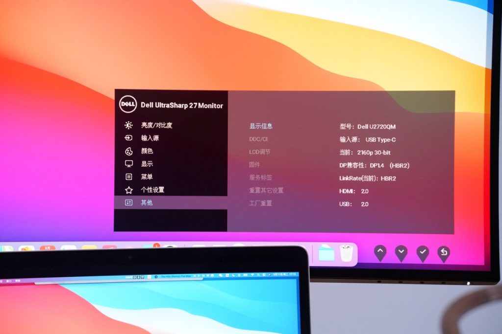

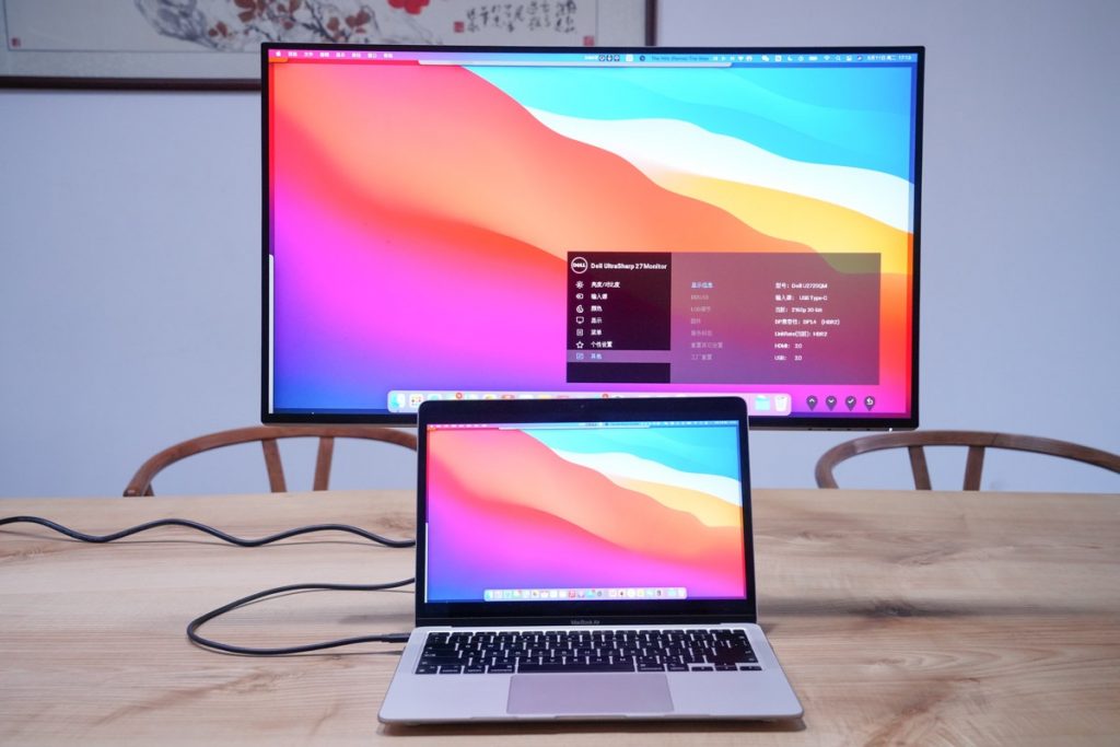

In addition to supporting charging and data transmission, the Pasidal Thunderbolt 4 data cable also supports video transmission. You can use the cable to connect the supported monitors and laptops with Thunderbolt ports directly.
As shown in the picture, the display’s resolution is 2160P, 60Hz, 30-bit, which means the Pasidal Thunderbolt 4 cable can support 4K 60Hz video transmission.
