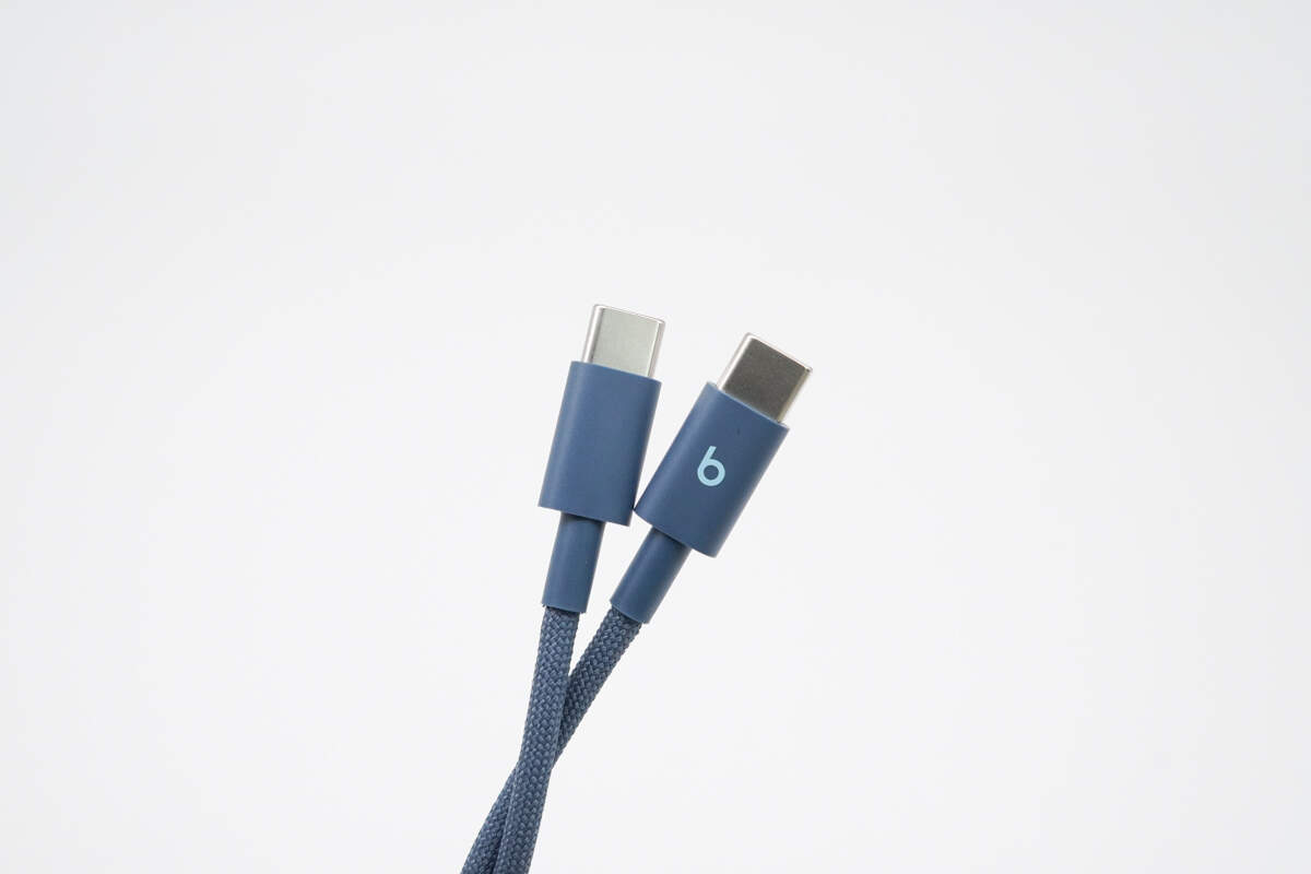

The connector is printed with the Beats logo. It is available in four colors: Bolt Black, Surge Stone, Nitro Navy, and Rapid Red.
Review of Beats USB-C to USB-C Woven Cable (1.5 m / 5 ft)-Chargerlab

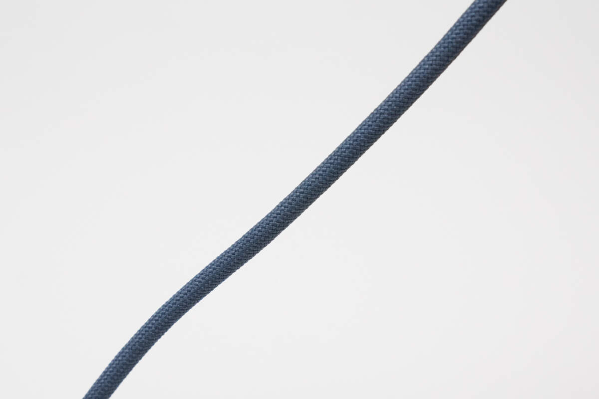

It features a tangle-resistant woven design and a reinforced core structure, significantly enhancing wear resistance through durability testing. Its lifespan far exceeds that of traditional cables, making it especially suitable for frequent plug-and-unplug use.

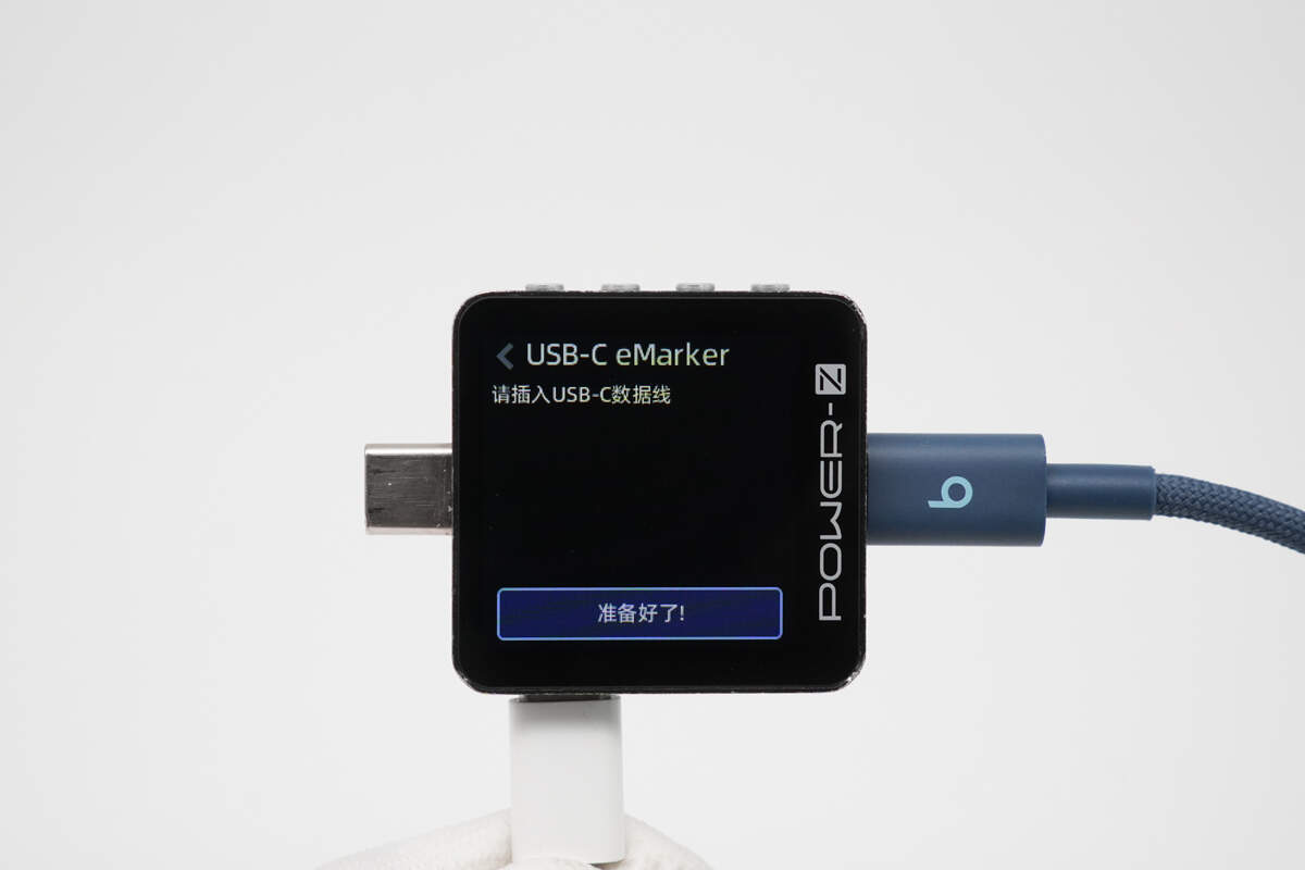

ChargerLAB POWER-Z KM003C shows that the cable doesn’t have an E-Marker chip, supports 60W charging power, and has a USB 2.0 data transfer rate.

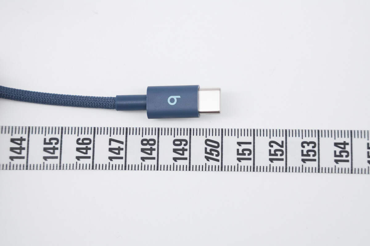

The length is about 1.5 m (5 ft).

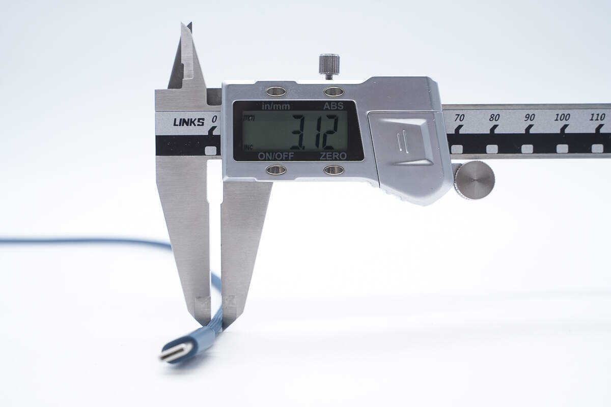

The diameter is about 3.12 mm (0.12 inches).

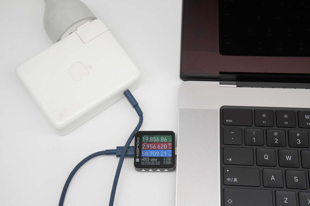

Using the Apple 140W charger paired with the Beats USB-C to USB-C Woven Cable to charge the MacBook Pro 16 M4 Pro, the power is about 19.86V 2.96A 58.71W.

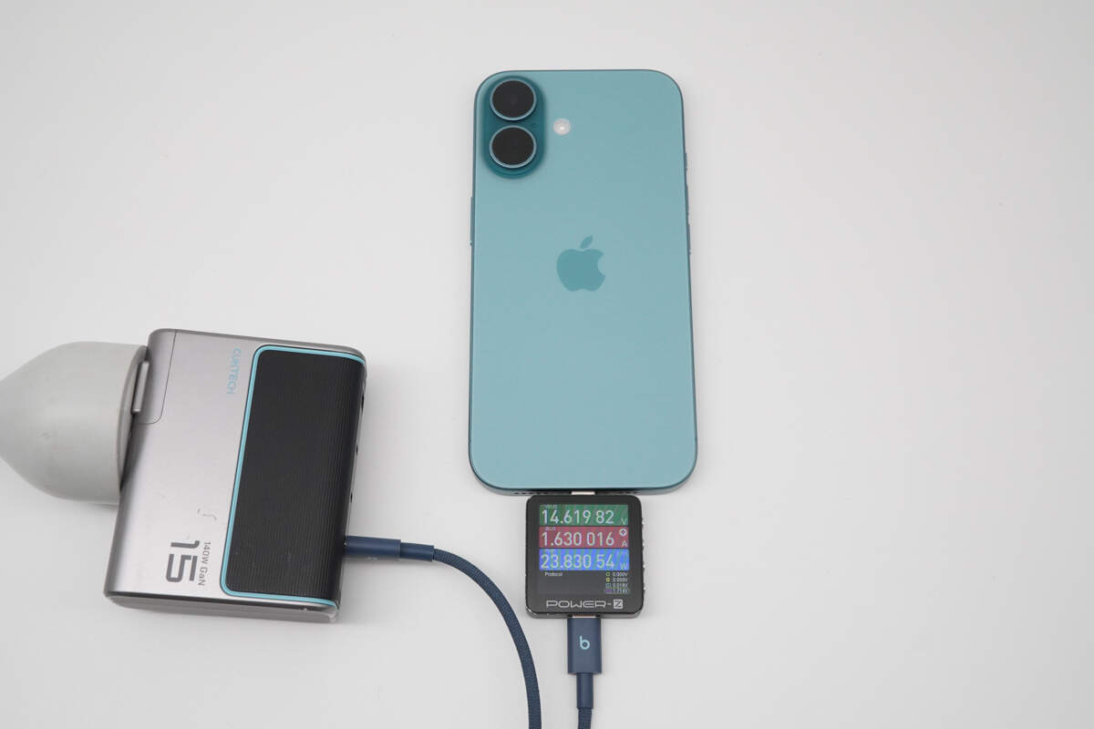

Using the CUKTECH 140W charger paired with the Beats USB-C to USB-C Woven Cable to charge the iPhone 16, the power is about 14.62V 1.63A 23.83W.

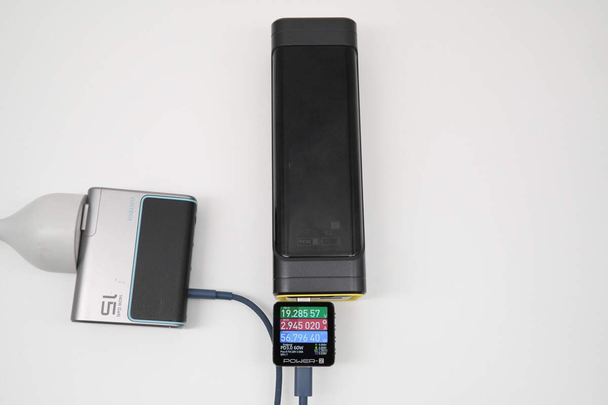

The charging power for the high-power power bank reaches 56.80W.

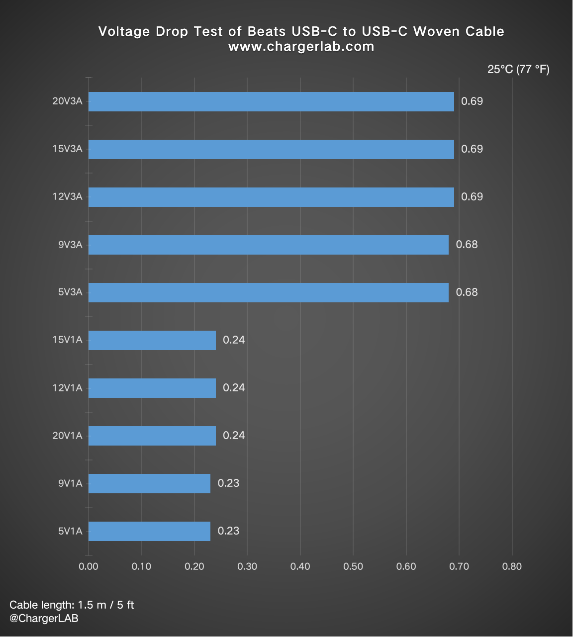

Voltage drop is an important factor in measuring the quality of the cable. During daily use, when the charger outputs the voltage and current to one end of the cable, it passes through the cable to the other end, which creates the voltage drop.
Connect the cable to the power supply and the electrical load, respectively. And we will test the voltage drop value under different voltages and currents. Here is the result.
From the bar chart, the voltage drop difference is largest at the 20V 3A, 15V 3A, and 12V 3A levels, measuring 0.69V. The smallest difference occurs at the 5V 1A and 9V 1A levels, at 0.23V. When testing voltage drop at a 3A current, the difference ranges from about 0.68V to 0.69V. At a 1A current, the voltage drop difference is around 0.23V to 0.24V.

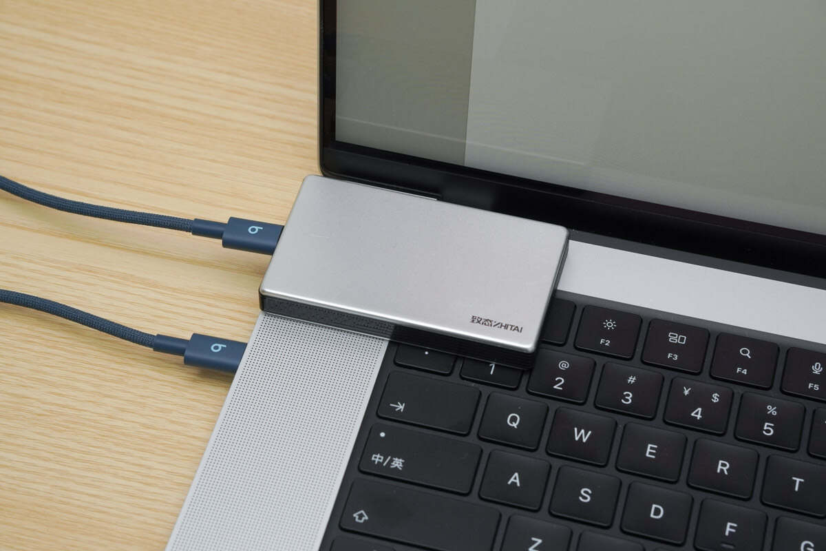

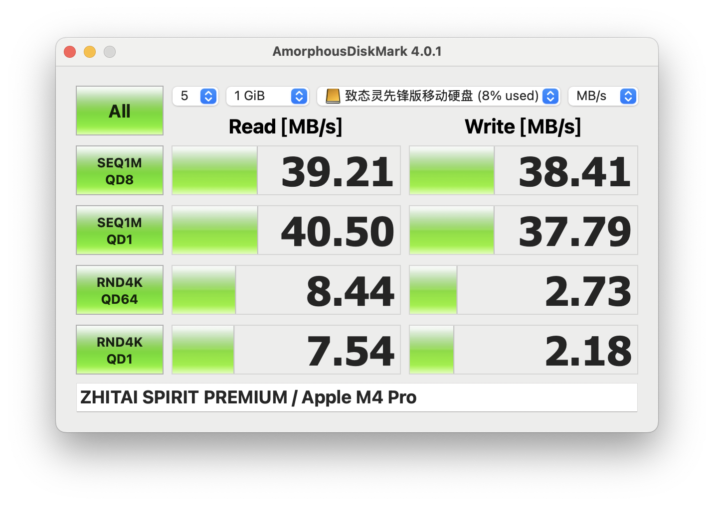

To test the transfer speed, this test used a MacBook Pro 16 M4 Pro paired with a ZhiTai hard drive, connected via the Beats USB-C to USB-C woven cable. Let’s see how it performs in the test.
Using AmorphousDiskMark 4.0.1 for read/write testing, the maximum read speed reached 39.21 MB/s, and the maximum write speed reached 38.41 MB/s.

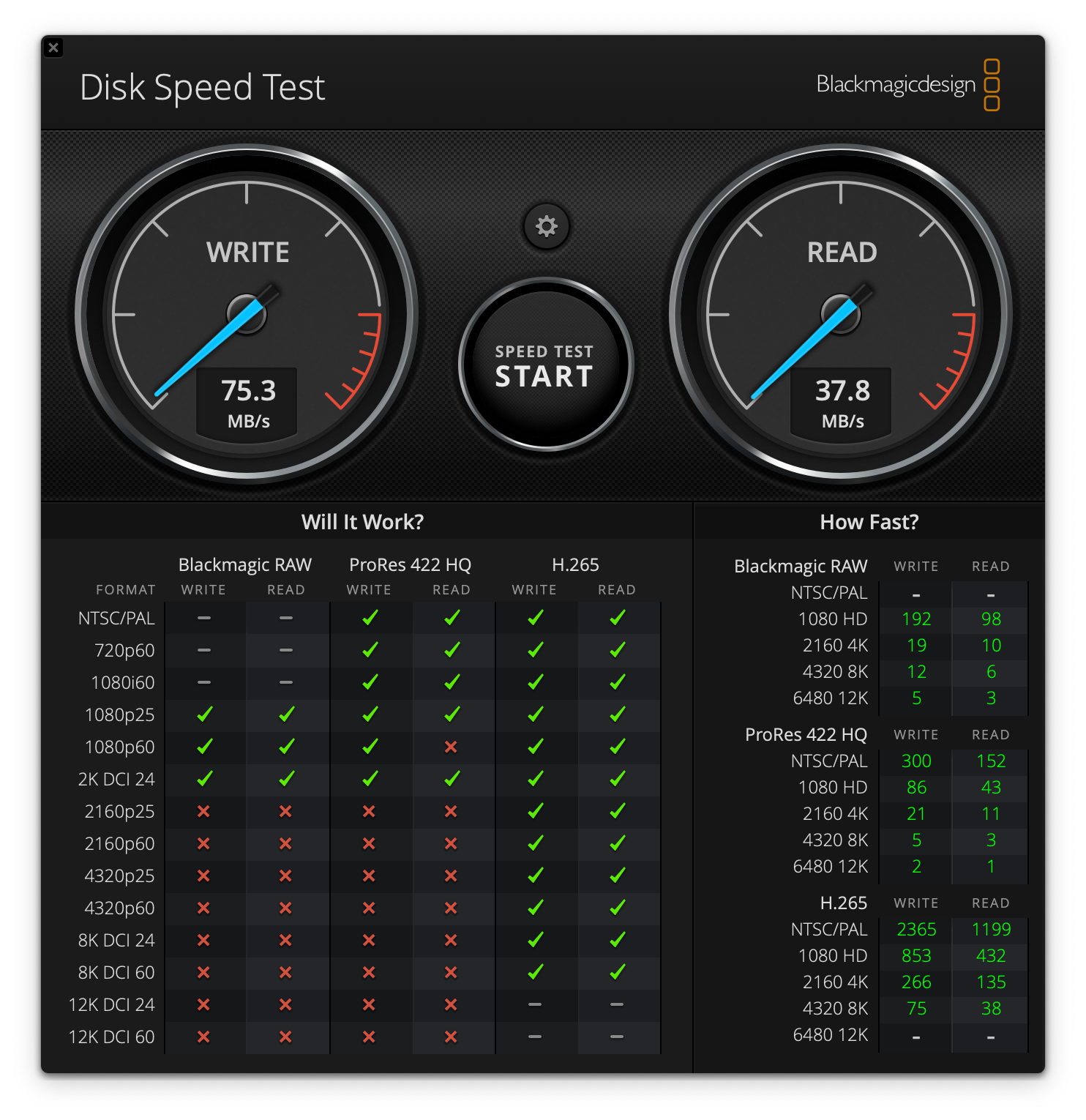

Using Disk Speed Test, the actual measured read speed was about 75.3 MB/s, and the write speed was around 37.8 MB/s. This performance currently cannot meet the demands of mainstream RAW format read/write for 2K, 4K, or 8K resolution files.

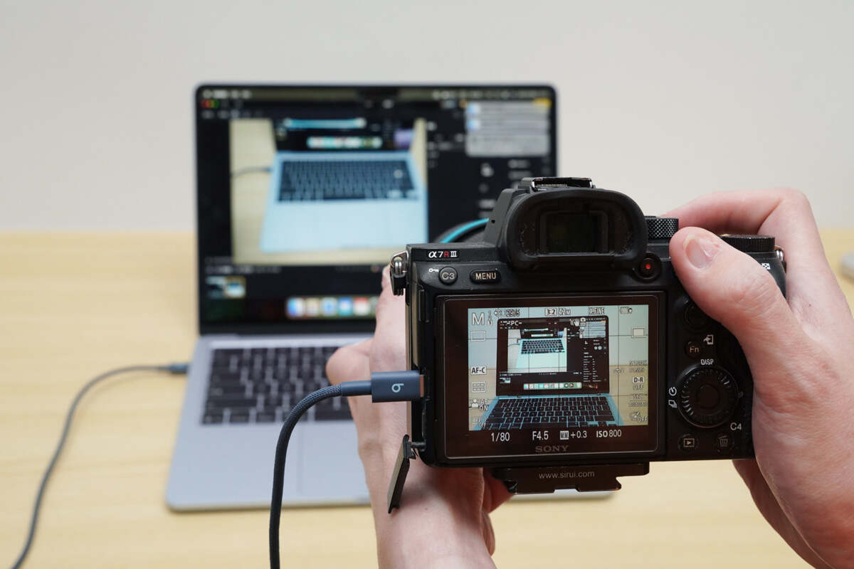

Using the Beats USB-C to USB-C woven cable to connect the laptop and camera enables real-time preview functionality.

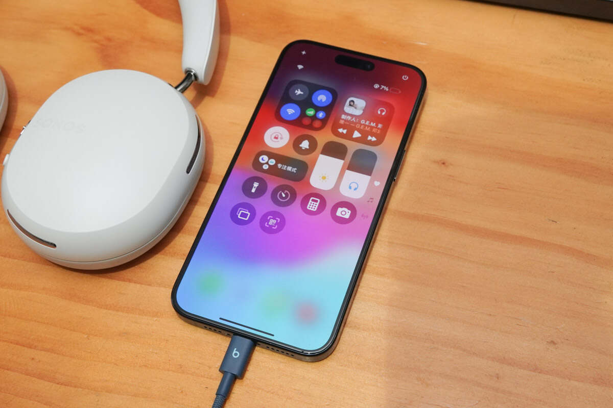

When using the cable to connect headphones and a phone, the phone successfully recognizes the headphone mode.
