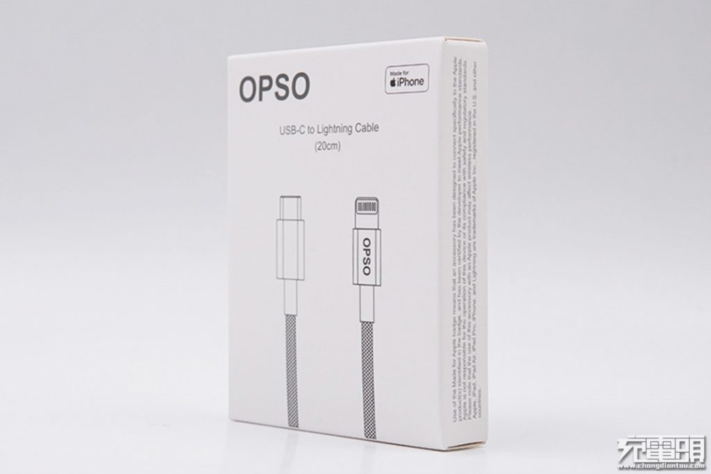

While OPSO shares high reputation as a MFi OEM/ODM manufacturer working for many famous brands, they also make products under their own brand. This OPSO USB-C to Lightning cable comes with a simple white box.

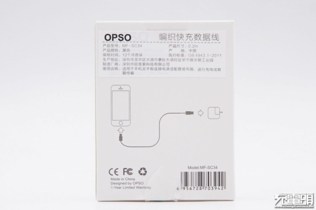

Manufacturer and certification info on the back. The model MF-SC34 can be found in Apple’s MFi website.

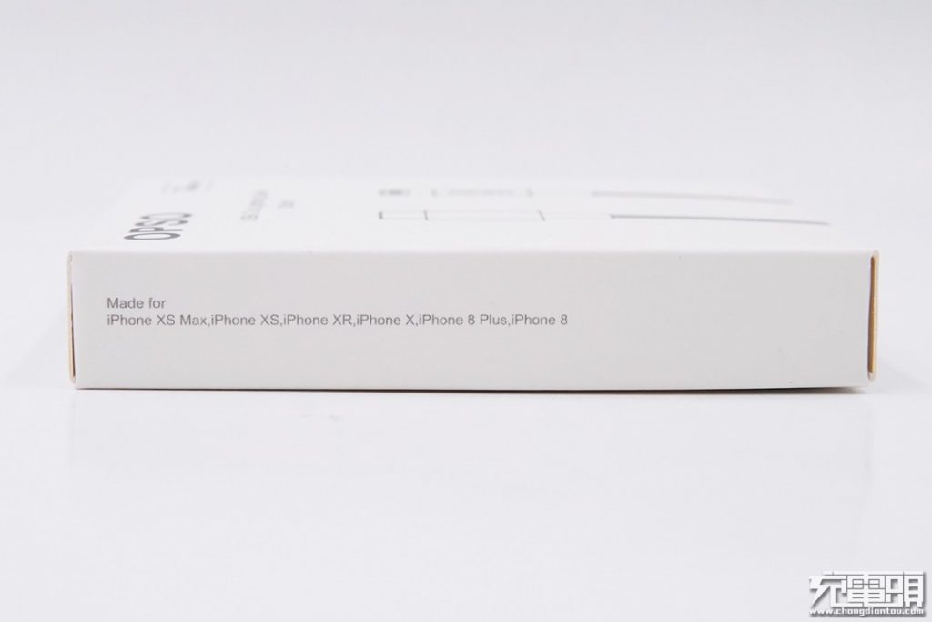

OPSO 20cm USB-C to Lightning Short Braided Cable Review: Perfect Companion for Power Banks-Chargerlab
Compatibility notes on the other side.

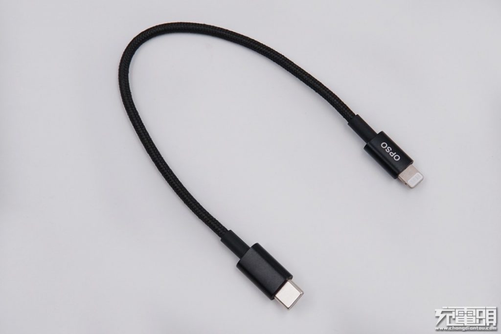

The cable’s workmanship is outstanding. It has a braided cord which is soft and flexible. The connectors are made using injection molding with Aluminum alloy shells, making it strong and robust.

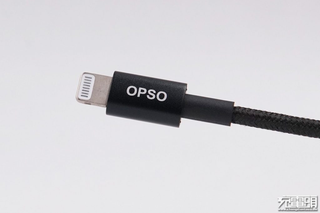

OPSO logo on the Lightning connector. The pins are silver instead of gold, since the C94 connector has upgraded its electroplating process from gilding to rhodium and ruthenium plating.

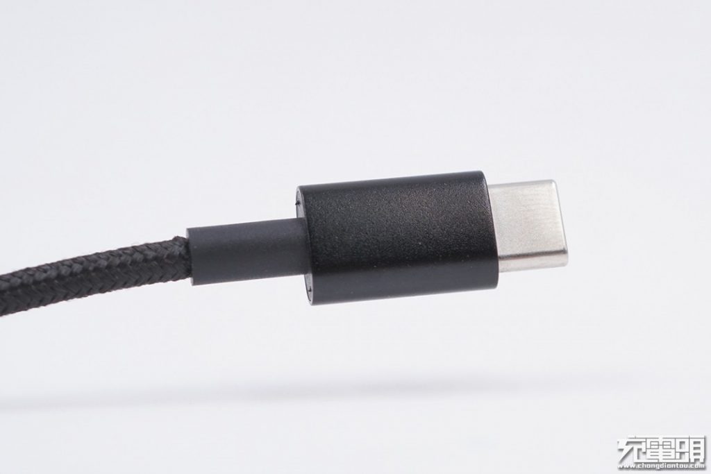

The USB-C connector is clean.

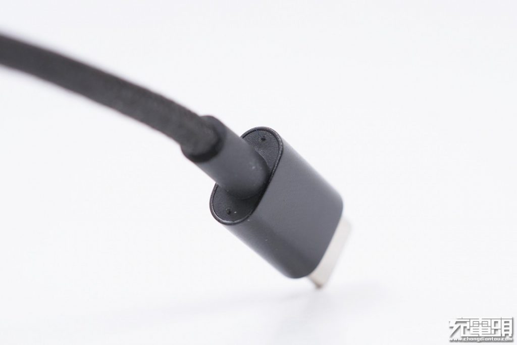

Extra thickness at the bottom of the connector makes it resistant to bending and cracking.

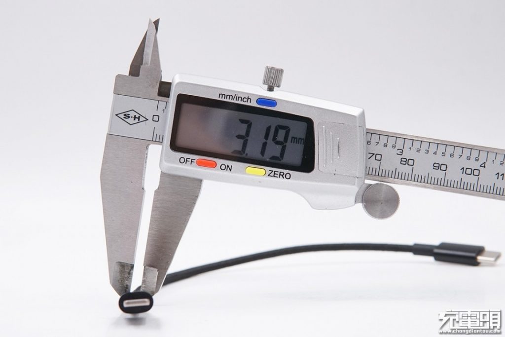

Cable diameter is 3.19mm.

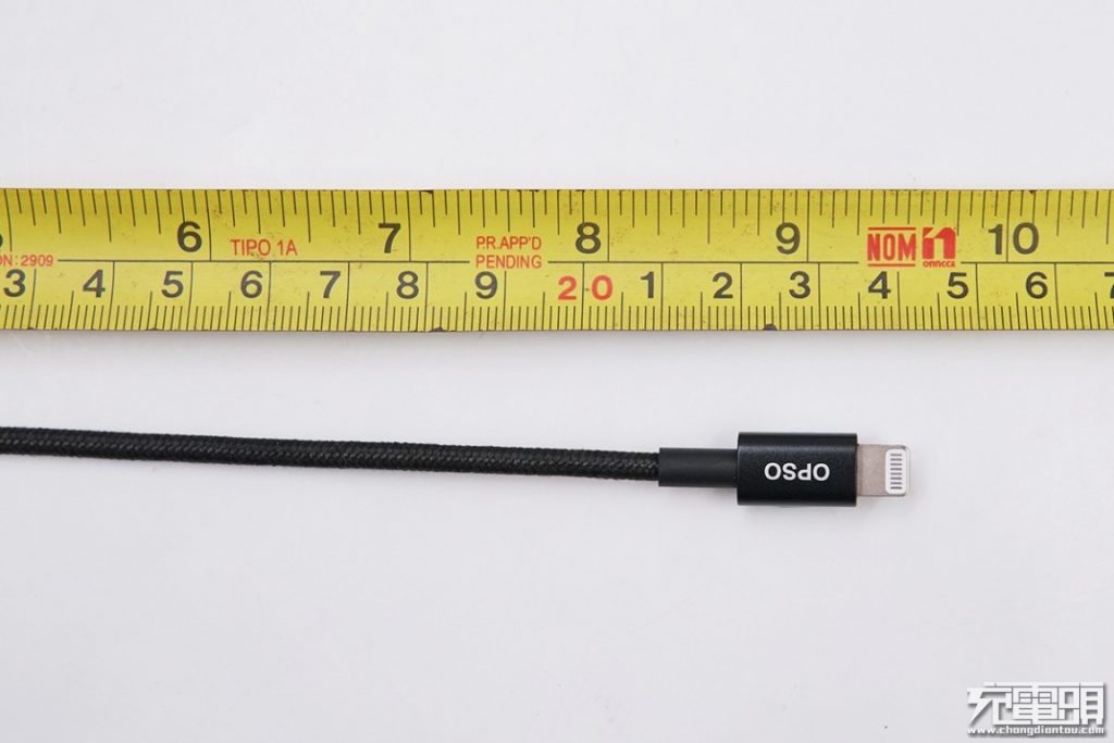

Cable length is 24cm.

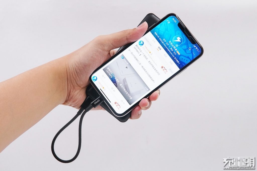

The 24cm length is perfect for power banks. No more entangled cables.

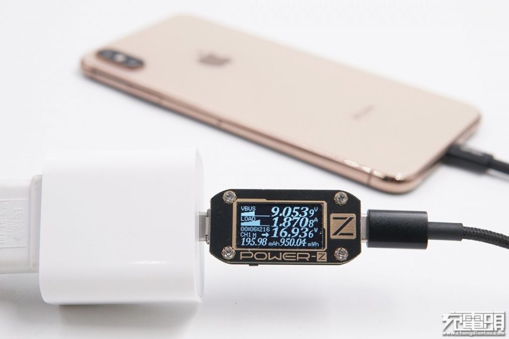

Use the Apple 18W PD charger and OPSO USB-C to Lightning cable to charge the iPhone XS Max, we are getting 9.05V 1.87A 16.93W, under PD protocol.

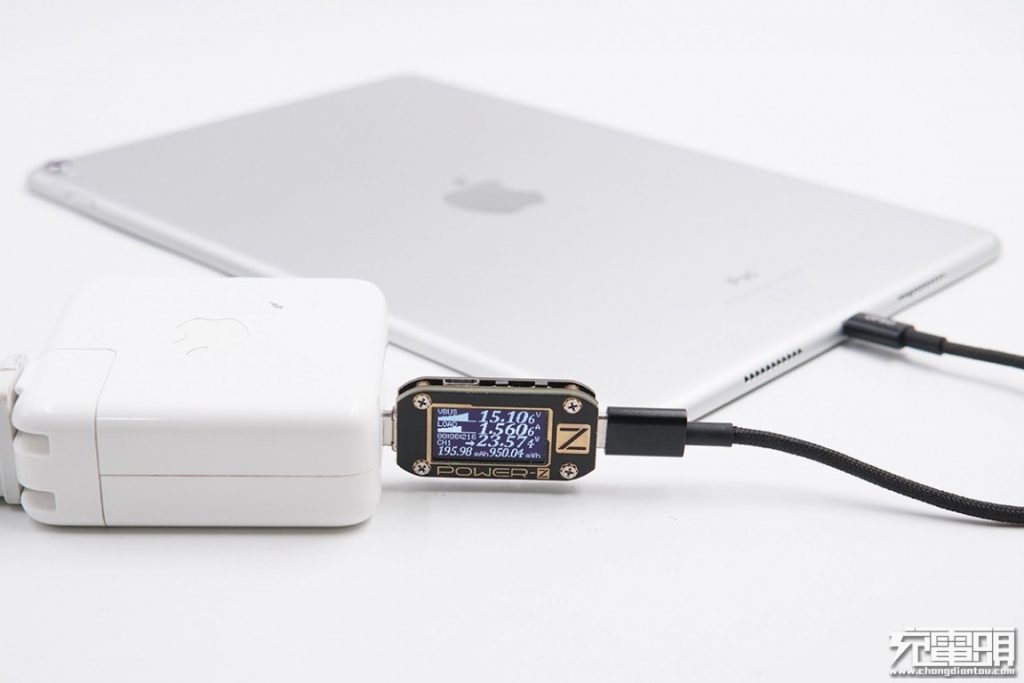

Use the Apple 61W PD charger and OPSO USB-C to Lightning cable to charge the iPhone Pro 10.5-inch, we are getting 15.1V 1.56A 23.57W, under PD protocol.

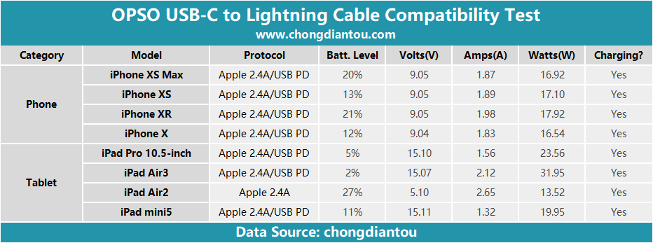

Summarized above.
