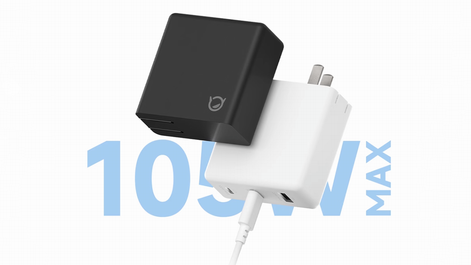

On July 22, 2023, Lenovo launched several new products, including laptops, tablets, and the Lenovo 105W GaN Charger, which supports 100W single-port high-power fast charging and simultaneous charging for three devices. Recently, it has been officially listed for pre-order.
Lenovo Launched 105W GaN Charger for Laptops-Chargerlab
The Lenovo 105W GaN Charger, model XX105G1, is a high-power multi-port charging solution meticulously engineered to cater specifically to laptops. It boasts extensive compatibility, supporting mainstream protocols like PD3.0 and PPS, while seamlessly accommodating QC3.0, SCP, FCP, AFC, and other widely used fast charging protocols. Distinguished by its sleek design, the charger's surface exudes elegance with a fine matte finish, further adorned with a cute logo, creating a decent visual effect. It is available in two color options: the classic chessboard black and the pristine chessboard white.
