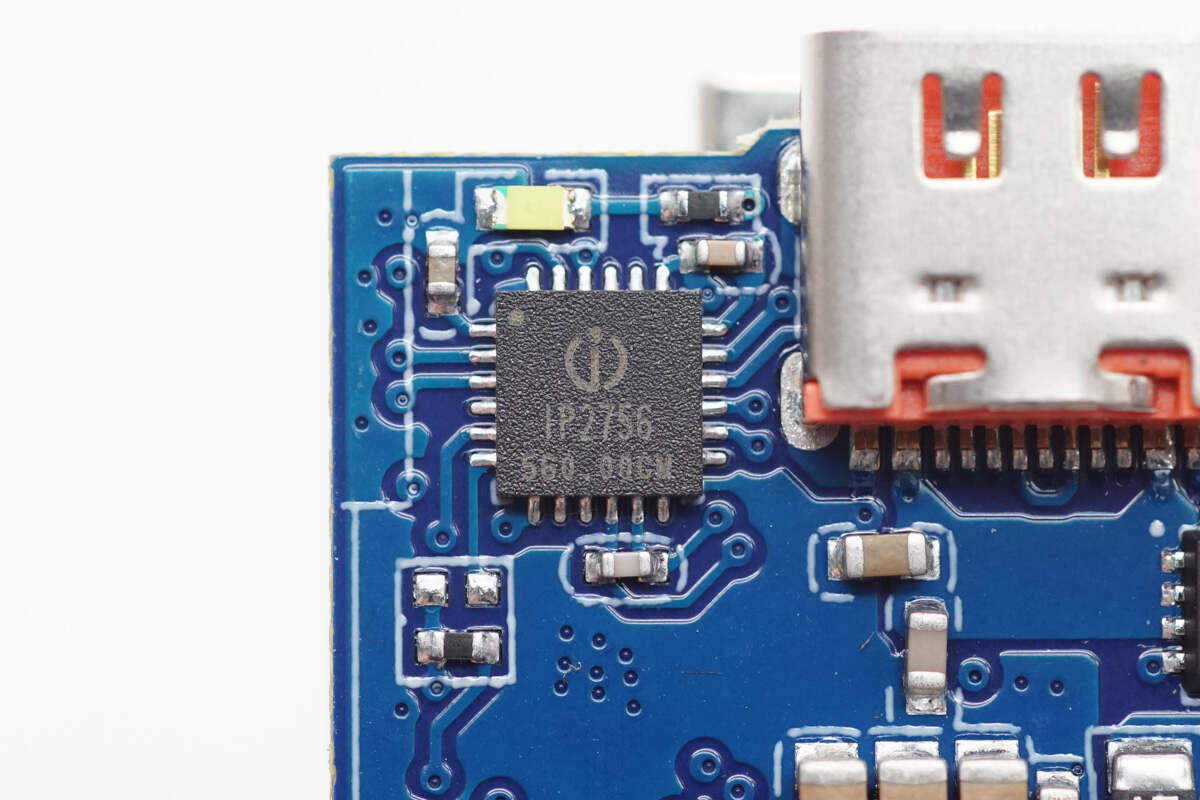

Injoinic IP2756
The Injoinic IP2756 is a fast-charging protocol controller IC designed for USB ports, integrating support for multiple charging protocols. It supports a wide range of fast-charging standards, including PD2.0/PD3.1 SPR & EPR up to 36V, HVDCP, QC5/4+/3+/3.0/2.0, FCP, SCP, AFC, UFCS, Apple 2.4A, BC1.2, and Samsung 2.0A. It provides a comprehensive solution for single-direction output applications such as adapters and car chargers.

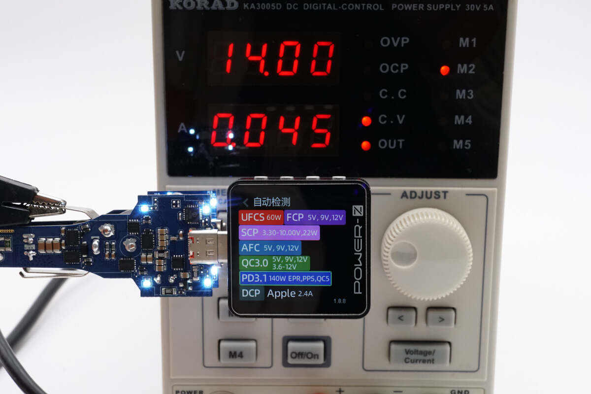

ChargerLAB POWER-Z KM003C shows it supports multiple fast charging protocols such as UFCS, FCP, PD3.1, and the maximum power can reach 140W.

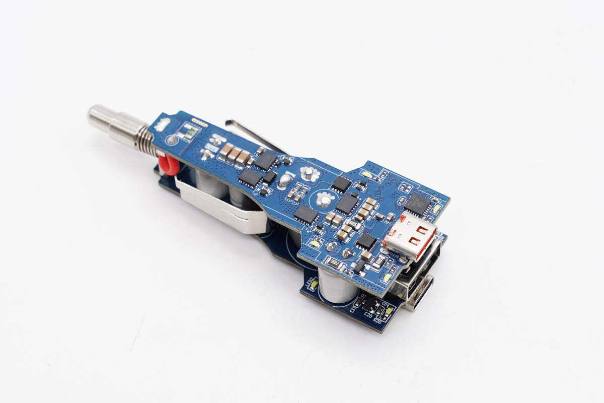

Injoinic IP2756 Solution
Injoinic IP2756: High-Performance 140W Fast-Charging Controller-Chargerlab
This solution supports PD3.1 140W and uses a combination of two USB-C and one USB-A interface. The indicator light at the interface lights up when powered on. The size is 83 x 27.27 x 20.33 mm.
2 USB-C 1 USB-A 140W Car Charger Solution
Interfaces: 2 USB-C + 1 USB-A
Maximum Power: 140W
Indicator Light: support
Size: 83 x 27.27 x 20.33 mm.
The Injoinic IP2756 supports mainstream fast-charging protocols such as PD3.1 EPR 36V, UFCS, and QC5, and delivers a maximum output power of up to 140W under PD3.1—making it a benchmark in fast-charging protocol controller performance. Whether in the adapter or in-vehicle charging scenarios, its high-voltage tolerance and robust protection design greatly enhance both product reliability and user experience.
This car charger demo, powered by the IP2756, achieves industry-leading levels in power delivery and compatibility, fully showcasing its advantages of high integration, high reliability, and high performance. It stands out as the ideal choice for premium fast-charging automotive solutions.
