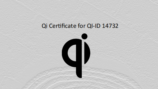

On November 17th, at the TTA IOP testing conference in Korea, the CVSMicro CV222 module successfully passed the final test, scoring excellently in compatibility testing, achieving a 100% pass rate for Qi2 certification. It became one of the first few products to pass this certification, and certificates were issued on December 7th with the number 14732.
