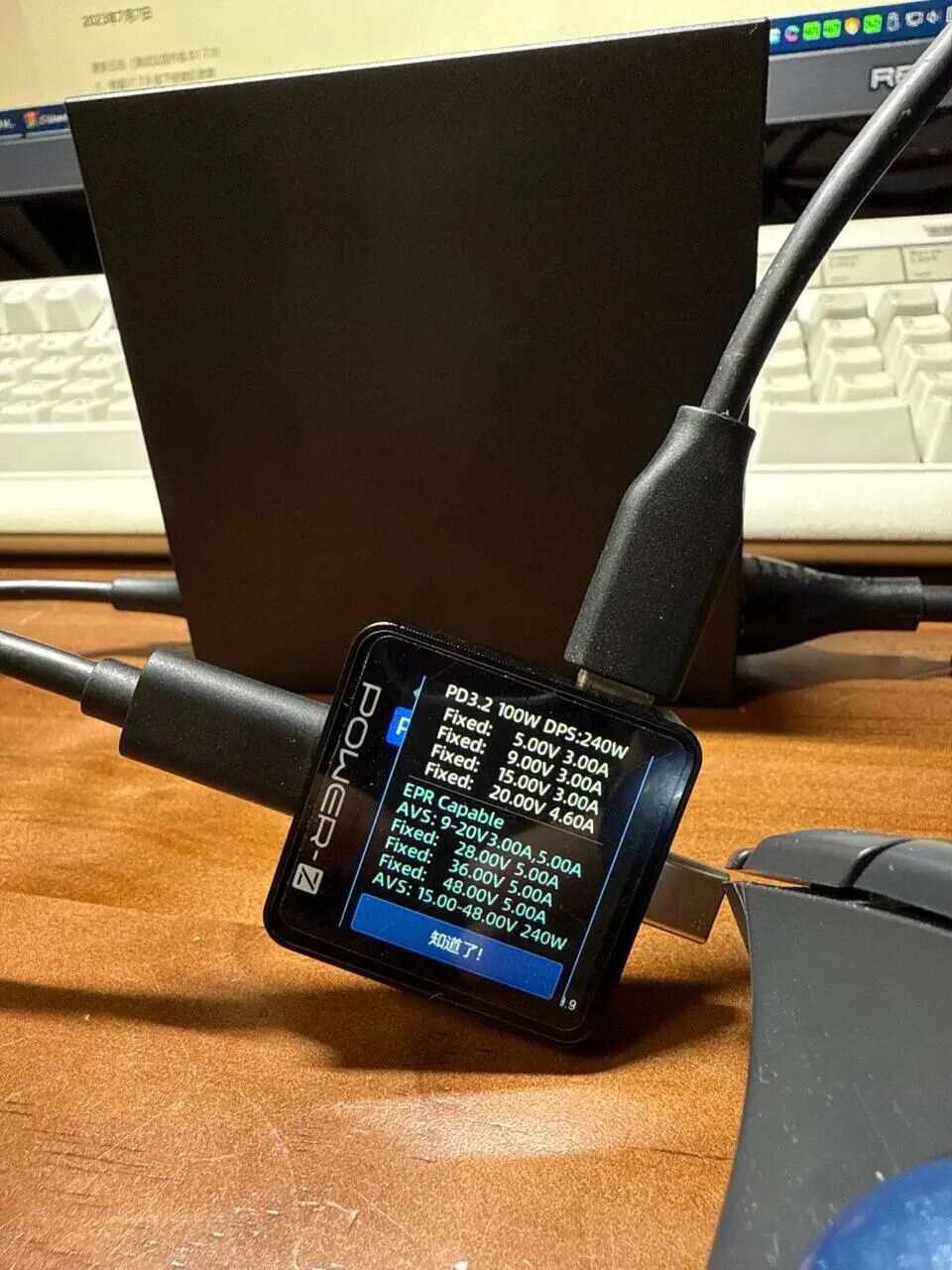

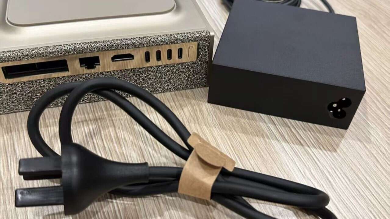

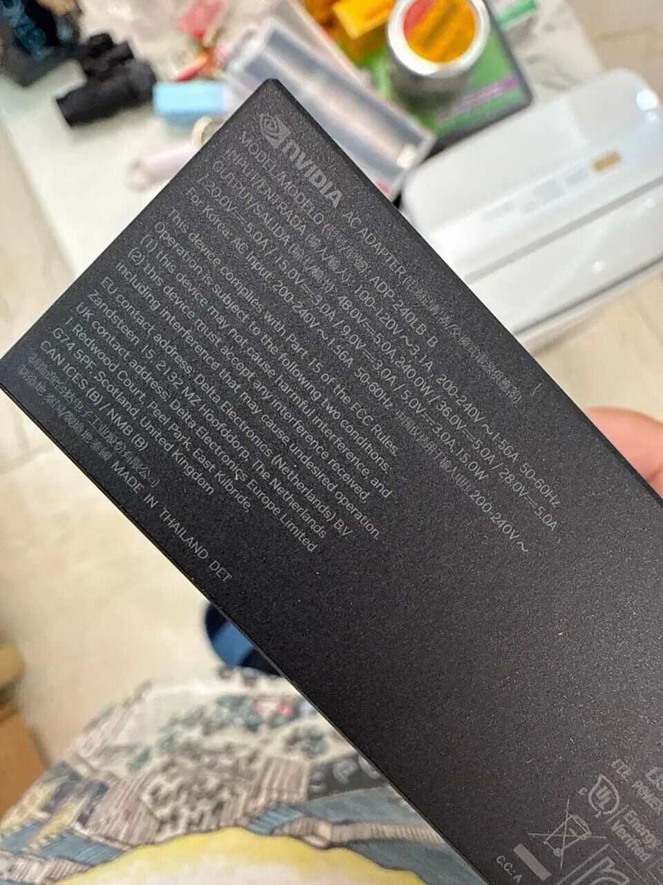

Recently, we received a submission from one of our fans, who discovered that the power adapter ADP-240LB, paired with NVIDIA’s portable computing server DGX, features an input range of 100–240V, supporting global mains voltages. The output reaches up to PD 3.1 240W, making it compatible worldwide.
ChargerLAB POWER-Z Fan Test: NVIDIA DGX Supports 240W PD 3.1 Power Delivery-Chargerlab
【ChargerLAB POWER-Z KM003C Test Results for ADP-240LB PDOs】
PD3.2 100W DPS: 240W
Fixed: 5.00V 3.00A
Fixed: 9.00V 3.00A
Fixed: 15.00V 3.00A
Fixed: 20.00V 4.60A
EPR Capable
AVS: 9-20V3.00A,5.00A
Fixed: 28.00V 5.00A
Fixed: 36.00V 5.00A
Fixed: 48.00V 5.00A
AVS: 15.00-48.00V 240W
According to the test results provided by the fan, the ADP-240LB supports up to PD 3.1 240W and PD 3.2 100W output power. With PD 3.1 EPR delivering up to 240W and AVS dynamic voltage adjustment from 9–20V and 15–48V, it not only ensures full performance for the DGX computing power output but also optimizes energy efficiency for NVIDIA’s portable DGX server. Its power delivery performance far exceeds conventional designs, pushing the power standard for portable AI devices to the maximum.
