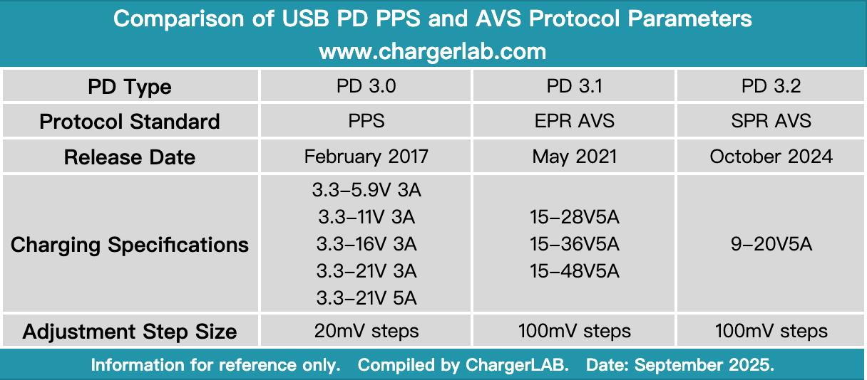

Differences Between PD 3.1 EPR AVS, PD 3.2 SPR AVS, and PD 3.0 PPS
The main differences between PD 3.0 PPS, PD 3.1 EPR AVS, and PD 3.2 SPR AVS lie in voltage range, adjustment precision, application scenarios, and power delivery modes.
AVS Protocol Explained: The Standard Making Fast Charging Faster and Safer-Chargerlab
During the PD 3.0 era, PPS (Programmable Power Supply) was designed as a dynamic output mechanism for mid- to low-power devices such as smartphones. It allows voltage adjustments within the 5-20V range in 20mV steps and current adjustments in 50mA steps, enabling chargers to finely tune output voltage in real time according to battery voltage, achieving efficient direct charging.
With the introduction of PD 3.1, the EPR (Extended Power Range) mode and AVS (Adjustable Voltage Supply) protocol were introduced, expanding output capabilities to 15-48V and up to 240W. EPR AVS supports voltage adjustments in 100mV increments and is primarily aimed at high-power devices like laptops, providing stable and efficient high-voltage output to reduce conversion losses.
In the latest PD 3.2 specification, AVS has been extended to the Standard Power Range (SPR), creating PD 3.2 SPR AVS, which is designed for devices under 100W, such as tablets and smartphones for fast charging. It retains AVS’s fine voltage adjustment capability but narrows the voltage range to 9-20V.
It is important to highlight that while PPS offers finer 20mV voltage steps and current adjustment on paper, this level of precision often proves unstable in real-world conditions. Factors such as cable loss, contact resistance, and voltage ripple typically exceed 20mV, rendering the theoretical advantages of PPS difficult to realize in practice.
More critically, PPS suffers from a "power cliff" phenomenon in its power delivery model: at lower voltages, current is limited, causing total output power to drop sharply and significantly reducing fast charging efficiency.
In contrast, AVS uses 100mV step increments, which are sufficient for matching battery voltage requirements while providing better resilience against real-world electrical noise. Its constant current output design also avoids the power drop issues seen with PPS, resulting in a more consistent and engineering-intuitive charging experience.

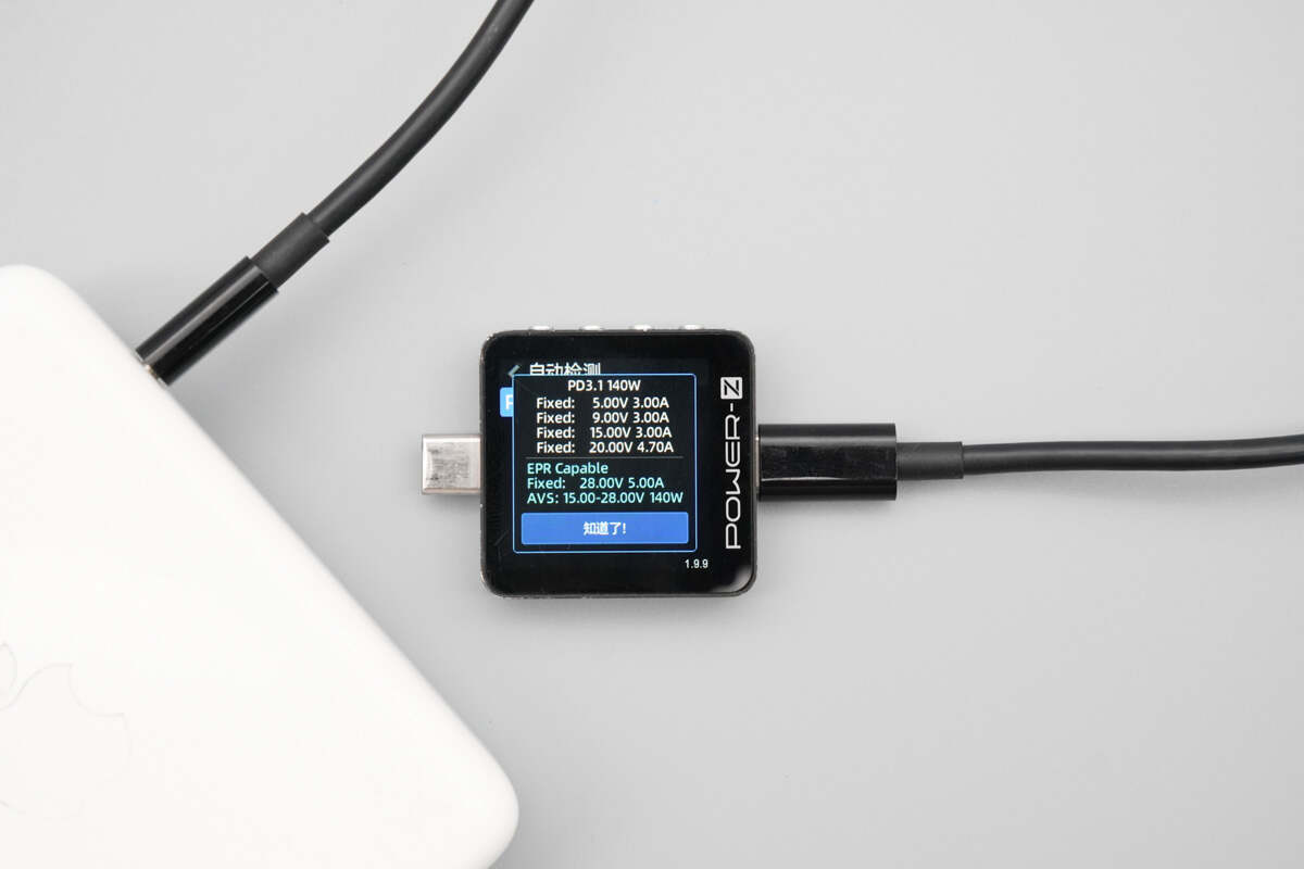

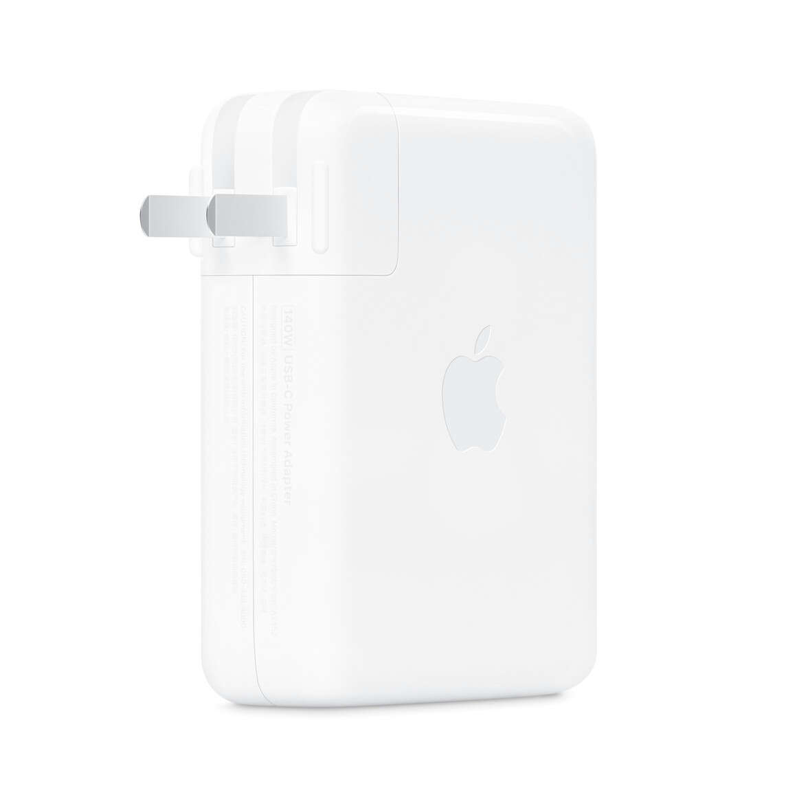

Apple's first 140W USB-C Power Adapter (model A2452) was released in 2021 alongside the 16-inch MacBook Pro. This adapter supports the USB PD 3.1 EPR specification and features an AVS adjustable voltage range of 15–28V, with a maximum output power of 140W.
This means that during charging, the adapter can dynamically adjust its output voltage up to 28V to meet the power demands of high-performance laptops. According to official information, this adapter can charge a MacBook Pro to approximately 50% battery capacity in about 30 minutes.

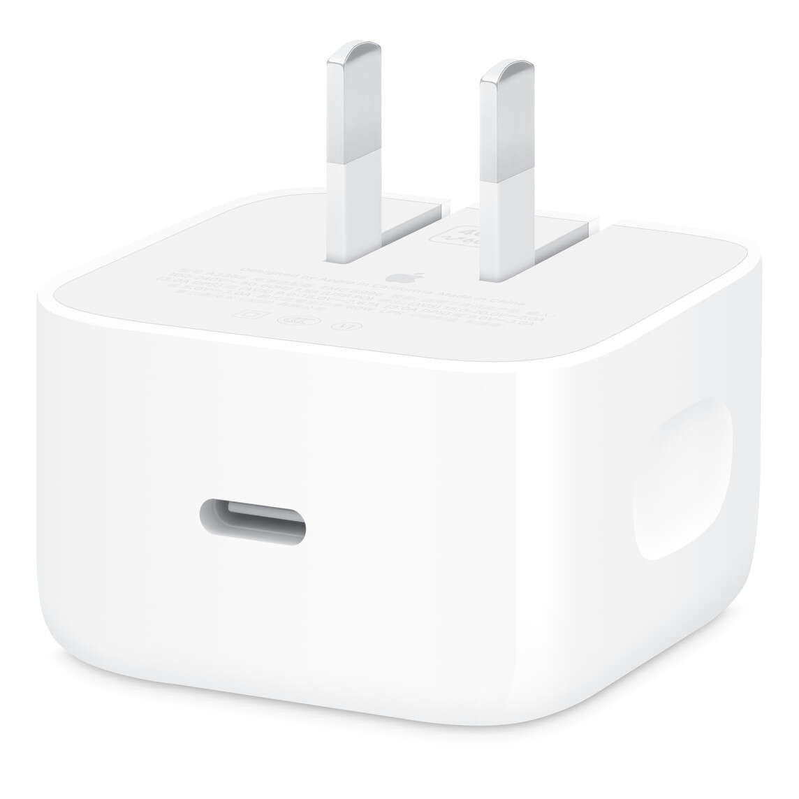

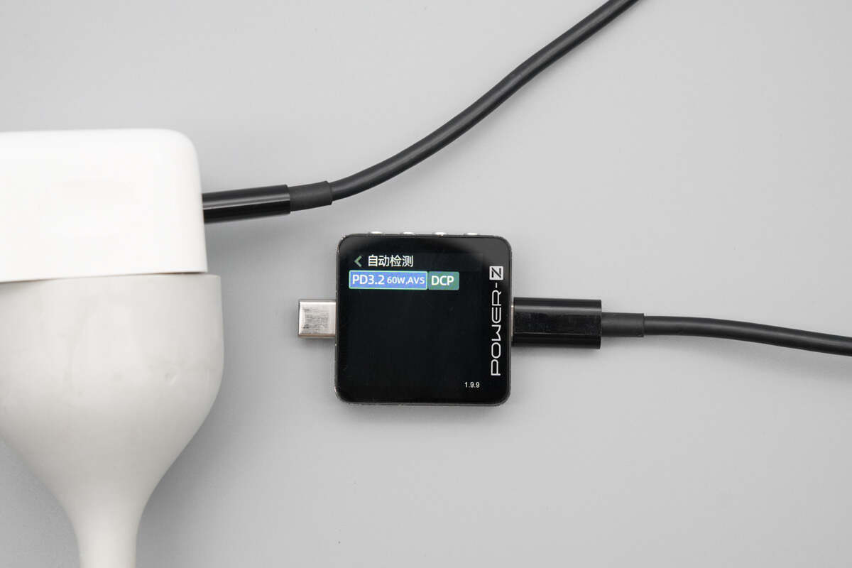

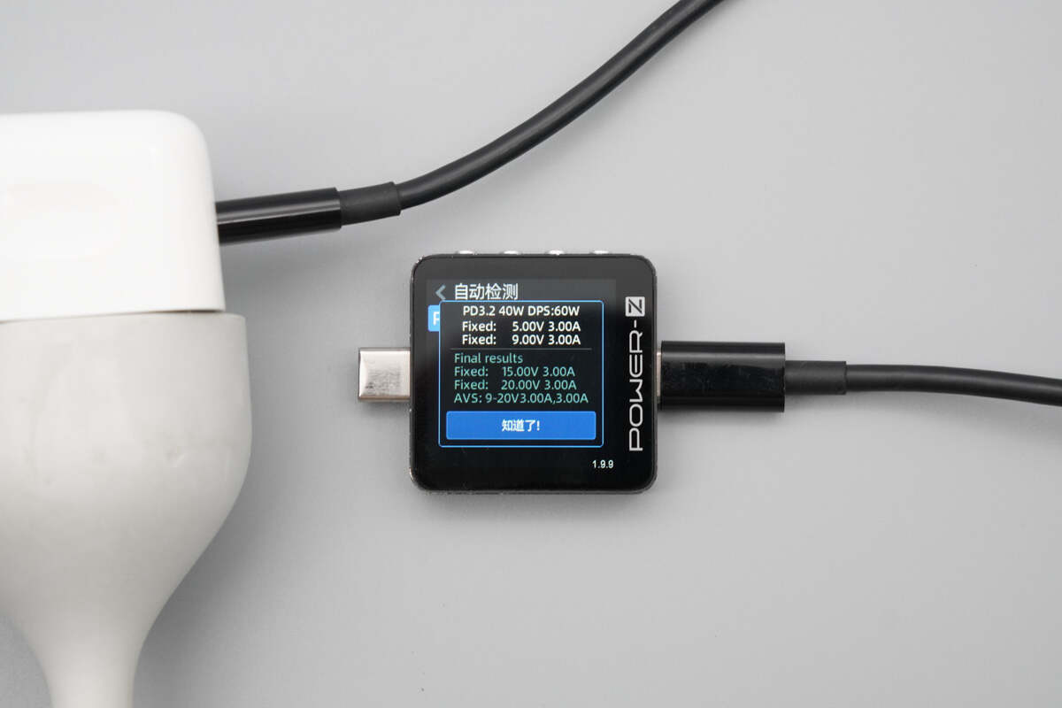

Apple's latest 40W Dynamic Power Adapter supports USB PD 3.2 SPR AVS technology. According to the specifications, this adapter delivers a nominal output of 40W, with a peak output of up to 60W. It can adjust the output voltage within the 9–20V range in 100mV increments, providing more precise and efficient charging.
Thanks to the AVS adjustable voltage mechanism, the charger can precisely control the output voltage to the ideal level based on the device's needs. This enhances power conversion efficiency and reduces heat generation, ensuring a more efficient and thermally optimized charging process.
