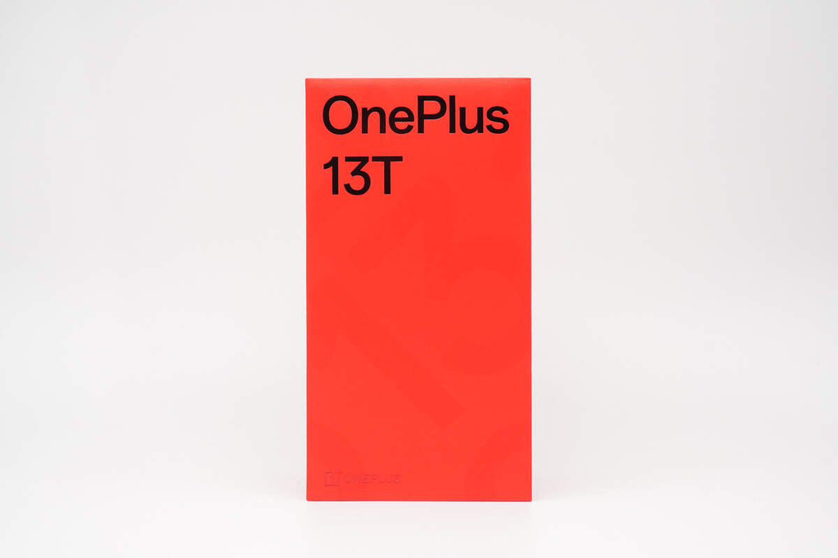

The box is red with OnePlus 13T printed on the front.

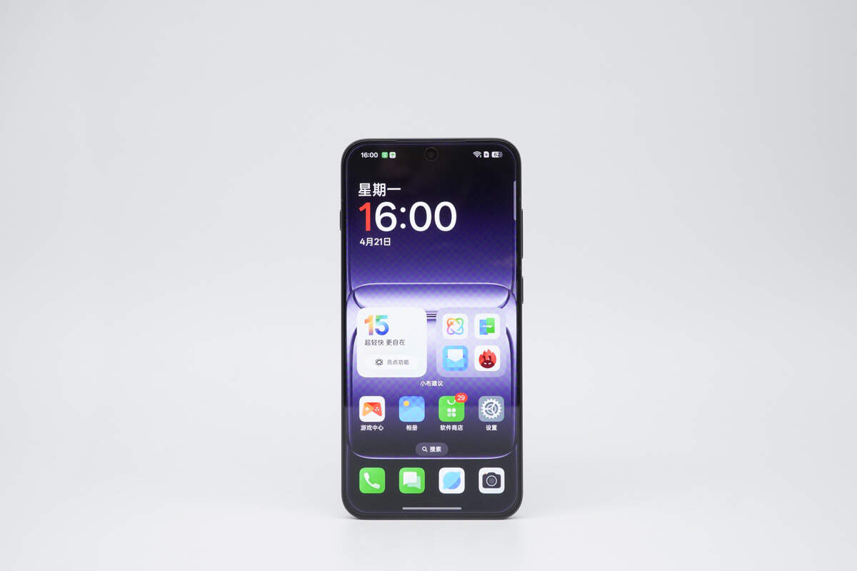

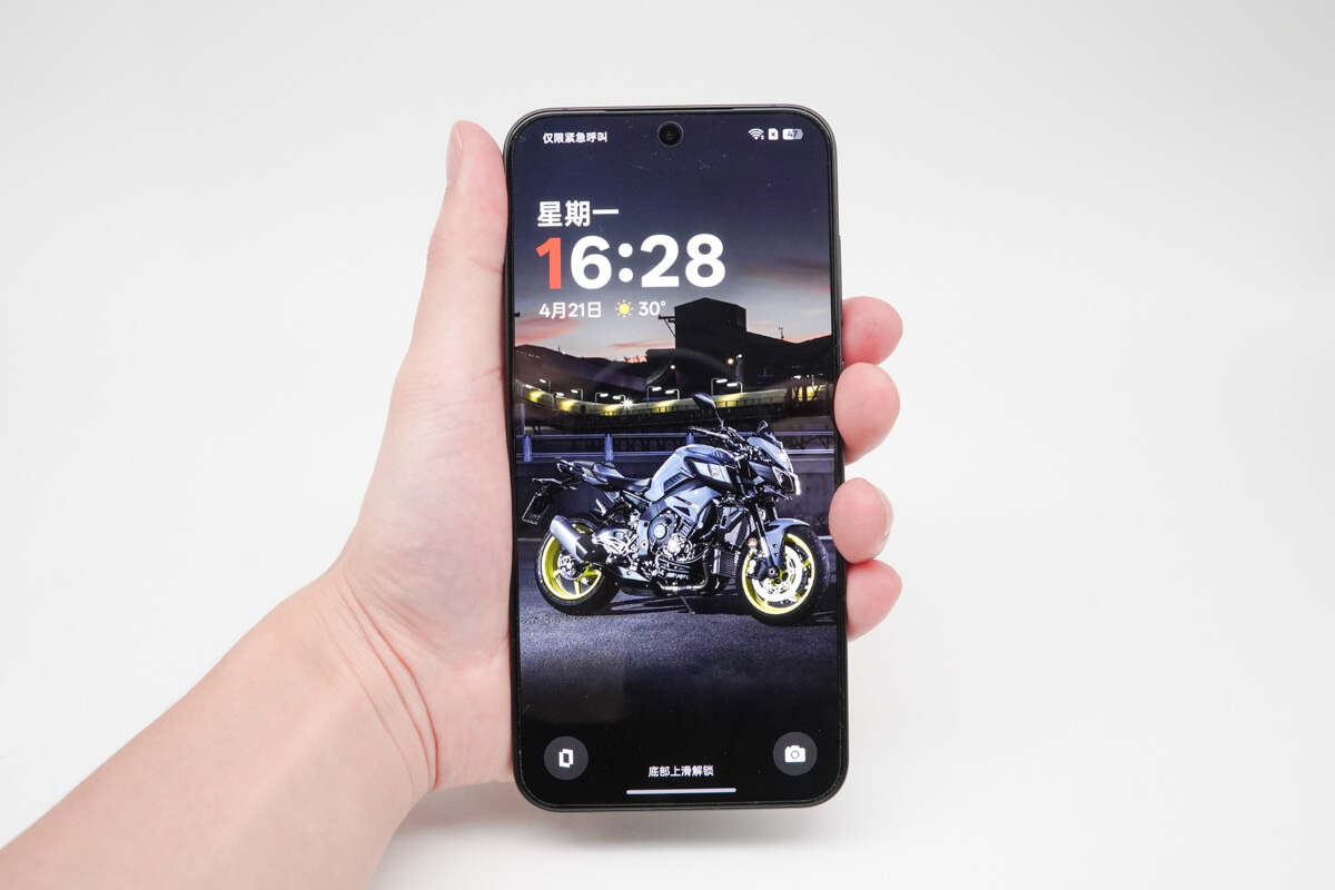

The OnePlus 13T introduces a 6.32-inch 1.5K full-screen display, with a resolution of 2640\*1216 and 460 PPI. The four edges are extremely narrow, offering an extraordinary visual effect, with a more immersive small-screen experience. The body width is only 71.7mm, adhering to the ergonomic "golden width," featuring a golden curvature R-angle and a 50:50 balanced weight distribution, making the device lightweight at just 185g.
Notably, the OnePlus 13T utilizes a new screen lighting material and an 8T LTPO circuit design. The screen is calibrated through the world’s second, and China’s only, self-developed display science production line, resulting in the purest, most transparent screen with vivid, lifelike display effects.

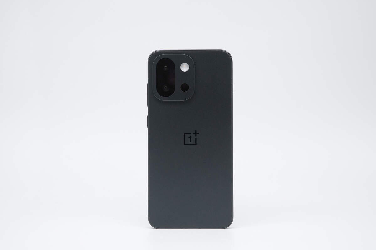

The OnePlus 13T is crafted from a single piece of aluminum alloy, integrating all components into a seamless, unibody design that exudes a premium feel. The Deco area occupies only 7.5% of the back, with a minimal protrusion of just 2.15mm, giving the entire back panel a clean and sleek look. The device is available in three color options: Black, Gray, and Pink.

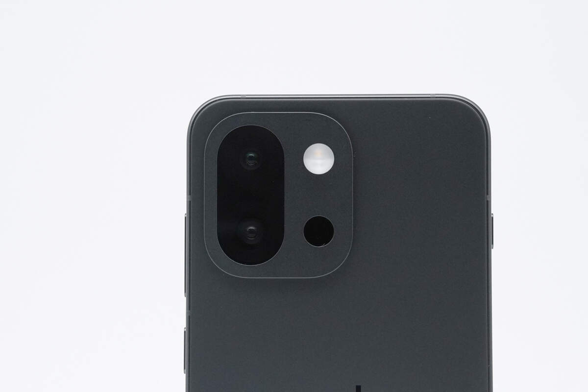

The OnePlus 13T is equipped with a brand-new 50MP large-sensor Sony IMX906 flagship main camera, supporting both OIS (Optical Image Stabilization) and EIS (Electronic Image Stabilization). It also features a 2x optical telephoto lens, which supports 4x lossless zoom, making it versatile for various shooting scenarios. Whether in backlit or low-light conditions, the camera ensures the capture of intricate and detailed photos.

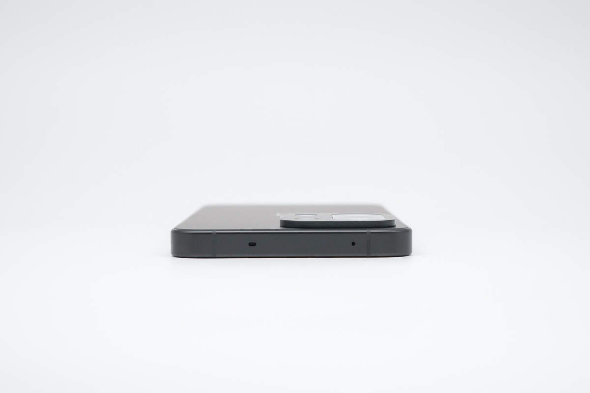

The top is equipped with openings for a microphone, speaker, and an infrared sensor.

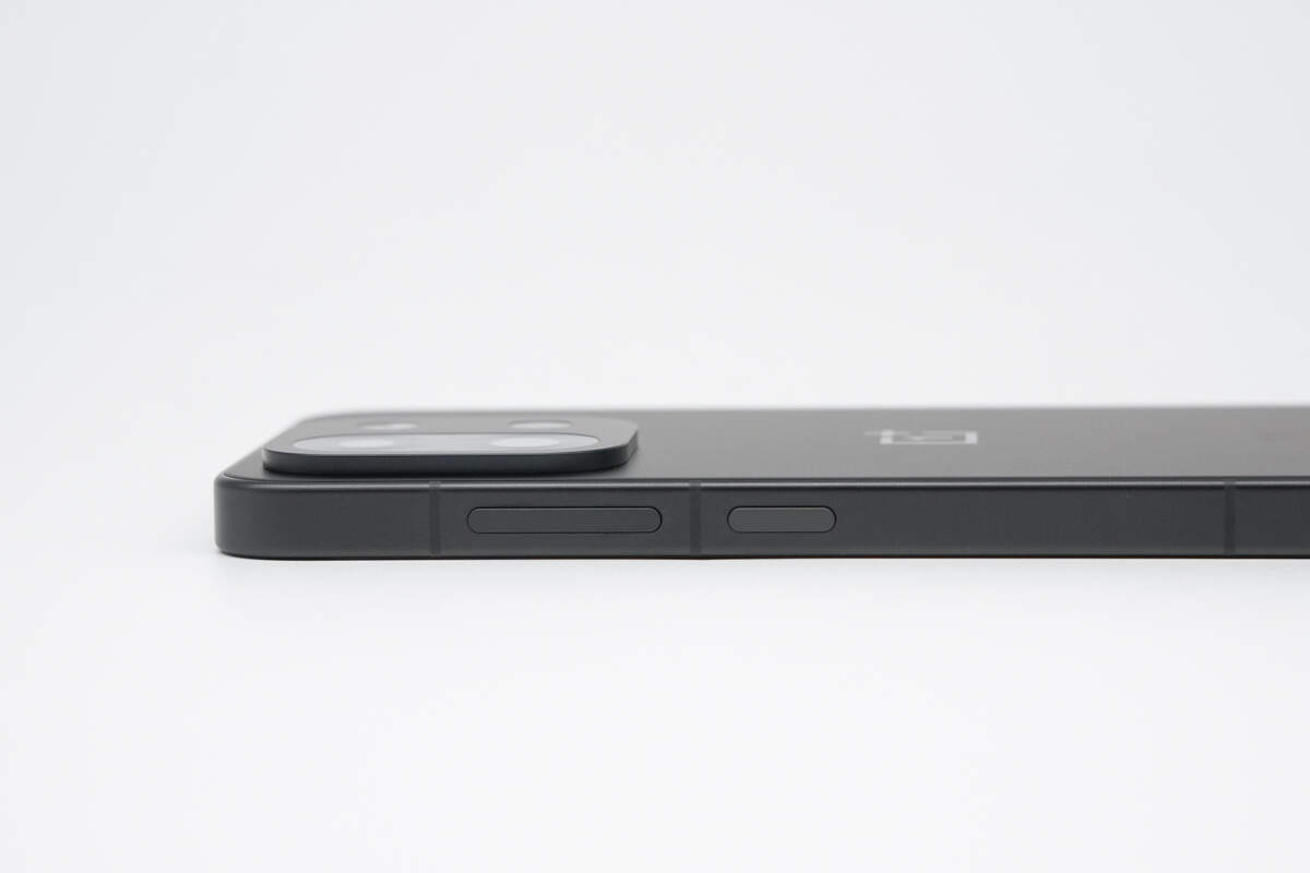

6260mAh+80W | Charging Review of OnePlus 13T-Chargerlab
The volume buttons and power button are on the right.

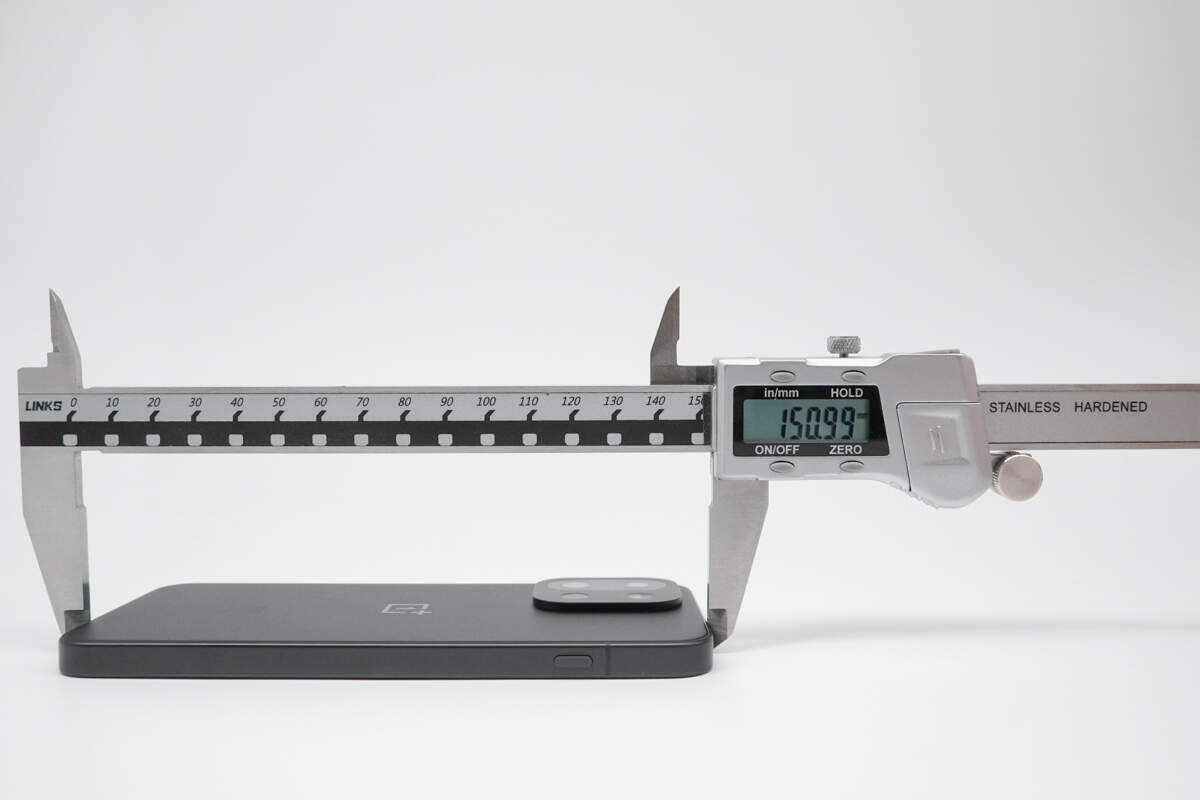

The length is about 150.99 mm (5.94 inches).

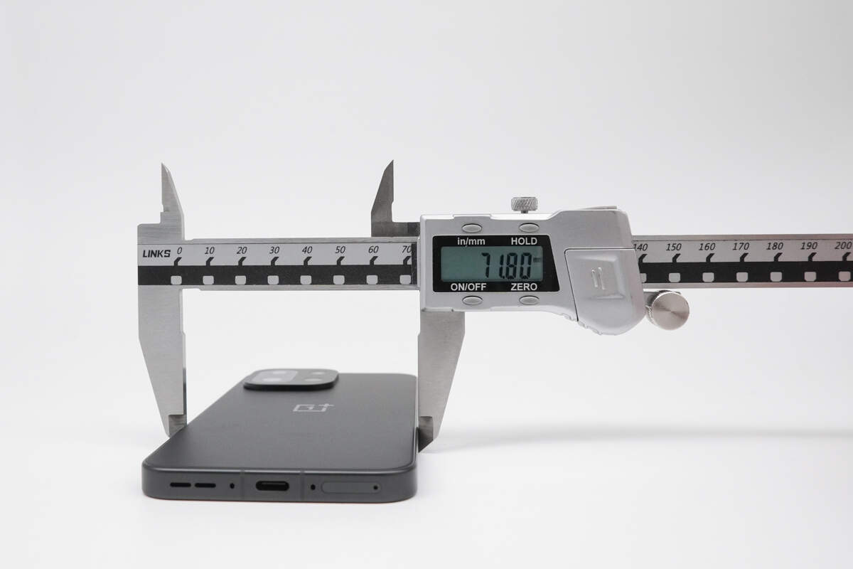

The width is about 71.80 mm (2.83 inches).

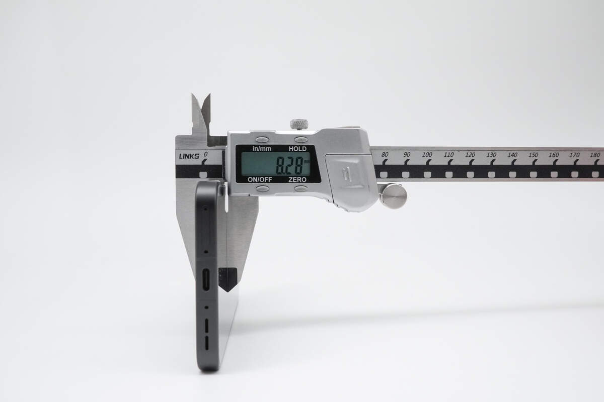

The thickness is about 8.28 mm (0.33 inches).

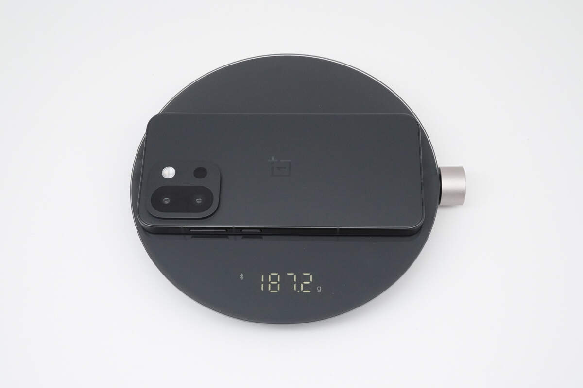

The weight is about 187.2 g (6.6 oz).

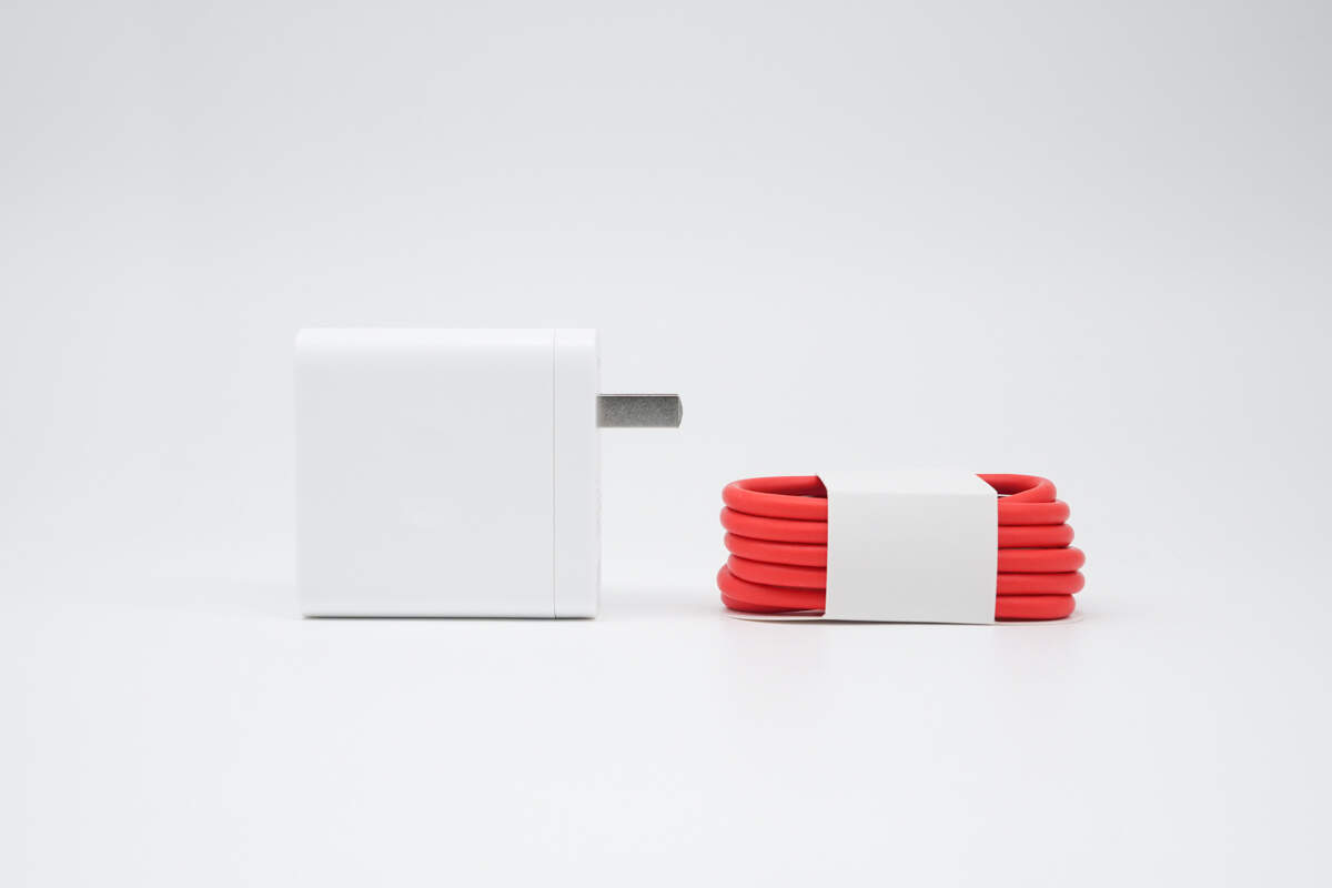

It comes with an 80W charging set.
The plastic sheet of the USB-A is white.

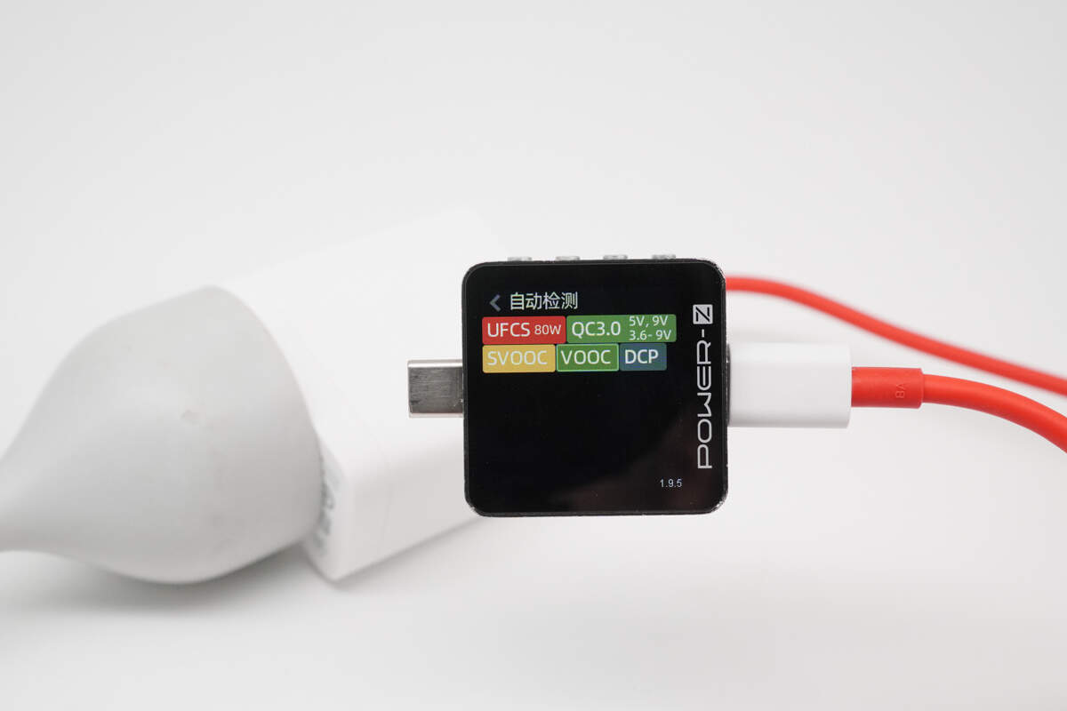

ChargerLAB POWER-Z KM003C shows it supports UFCS, QC3.0, SVOOC, VOOC, and DCP charging protocols.

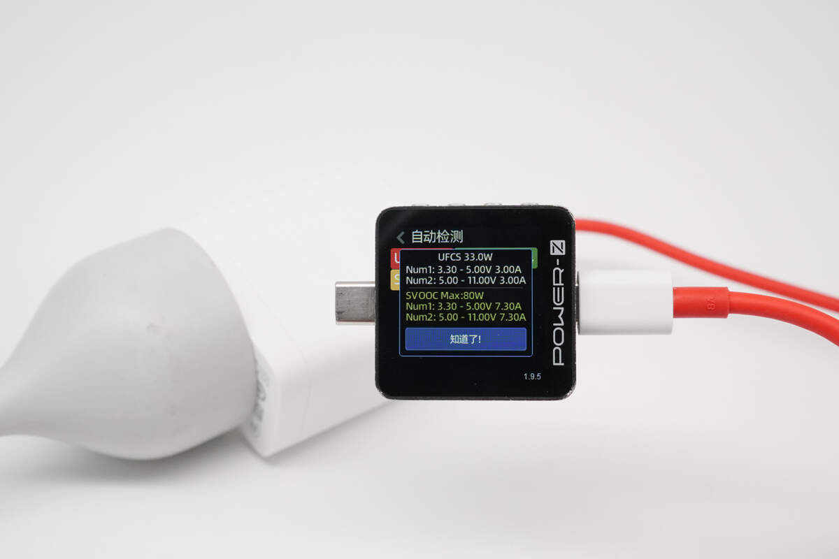

It supports a maximum UFCS output of 33W, has two PDOs of 3.3-5V3A and 5-11V3A. It has two sets of SVOOC, which are 3.6-5V7.3A and 5-11V7.3A.

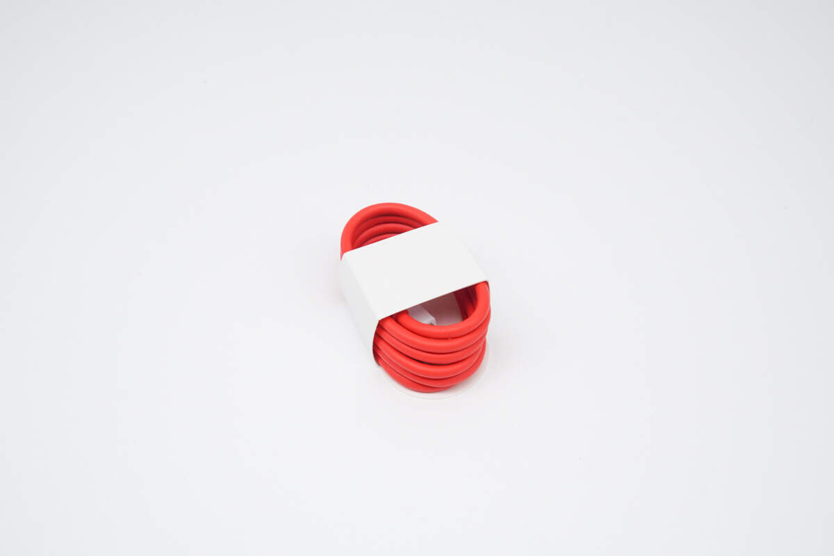

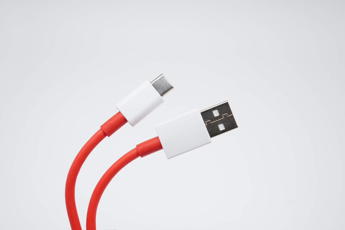

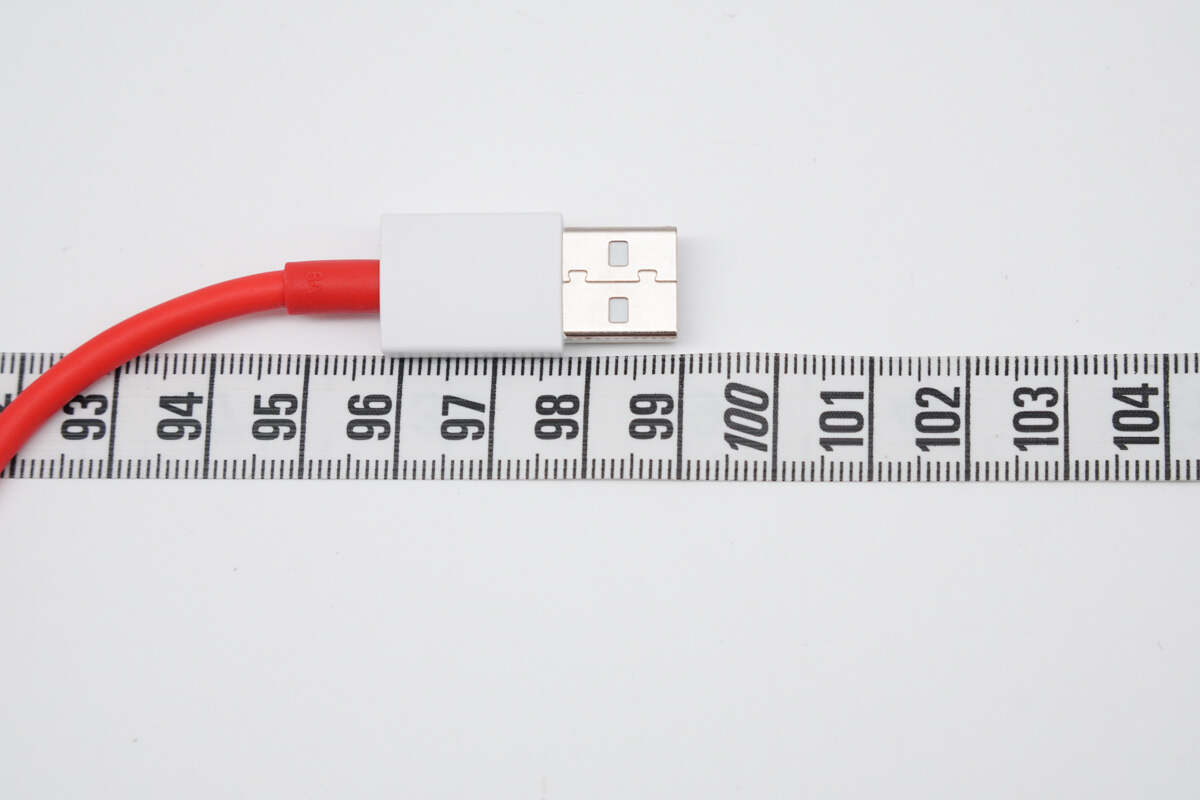

The USB-A to USB-C cable is secured with a paper strap for bundling.
8A is printed on the connector.
The length is about 1 meter.

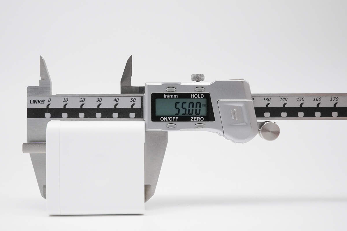

The length of the charger is about 55 mm (2.17 inches).

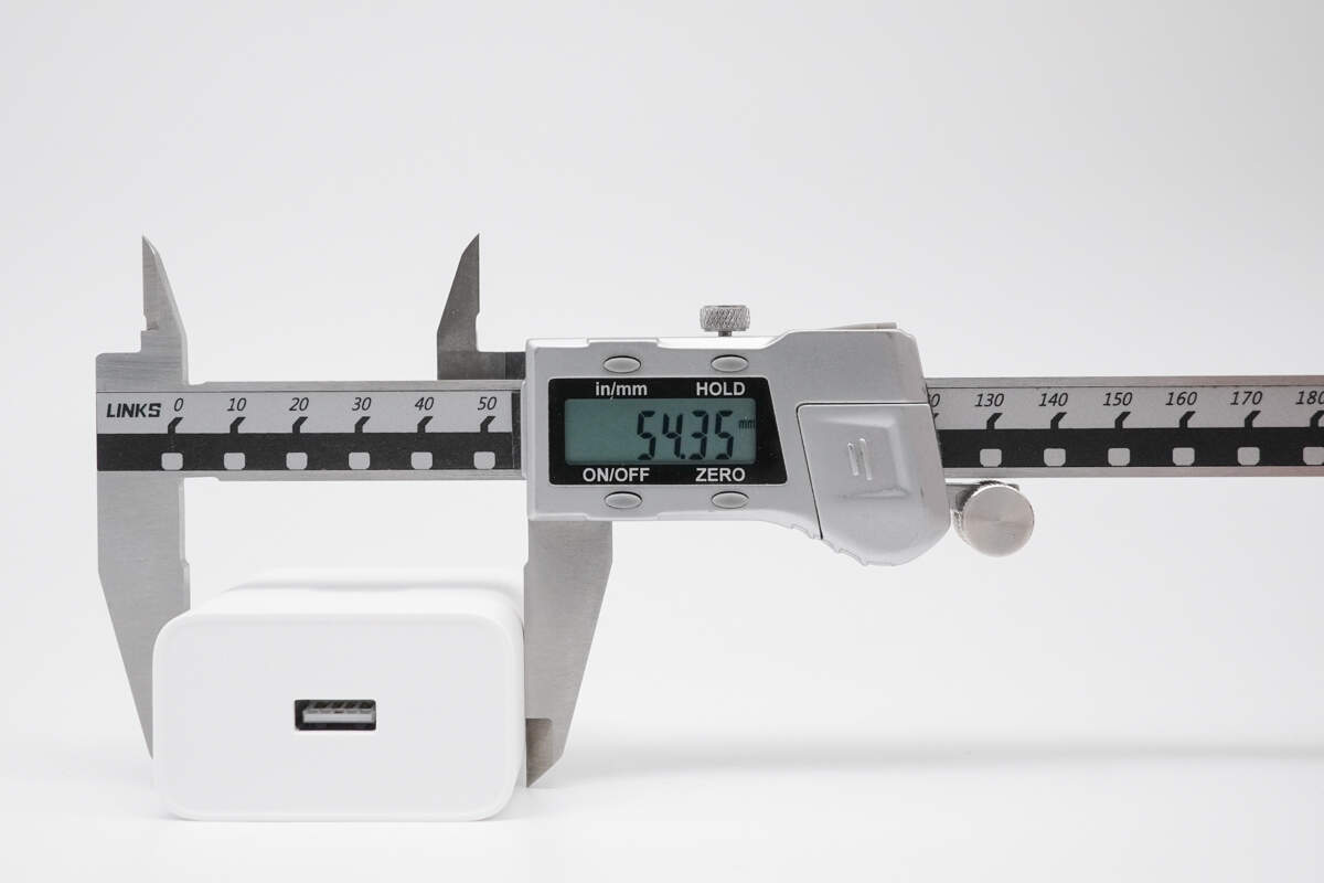

The width is about 54.35 mm (2.14 inches).

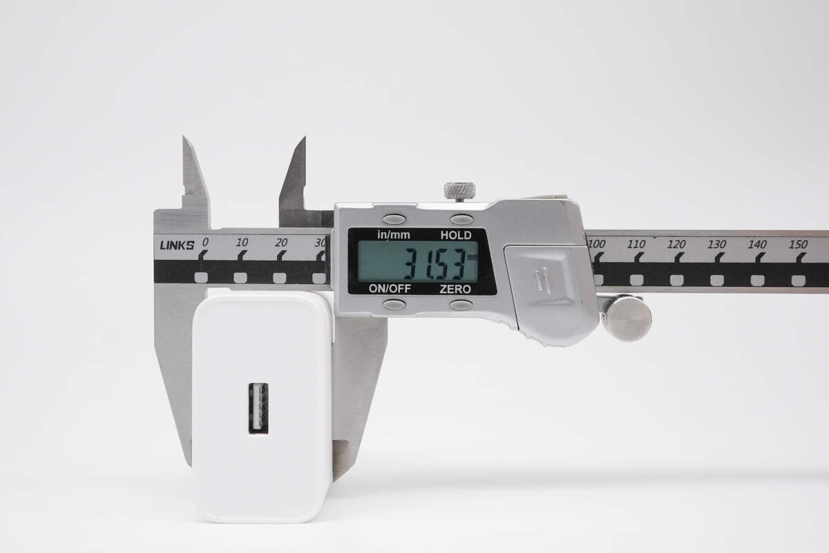

The thickness is about 31.53 mm (1.24 inches), the volume is about 94.25cm³, and based on the power of 80W, the power density is about 0.85W/cm³.

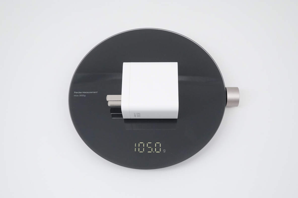

The weight is about 105 g (3.7 oz).

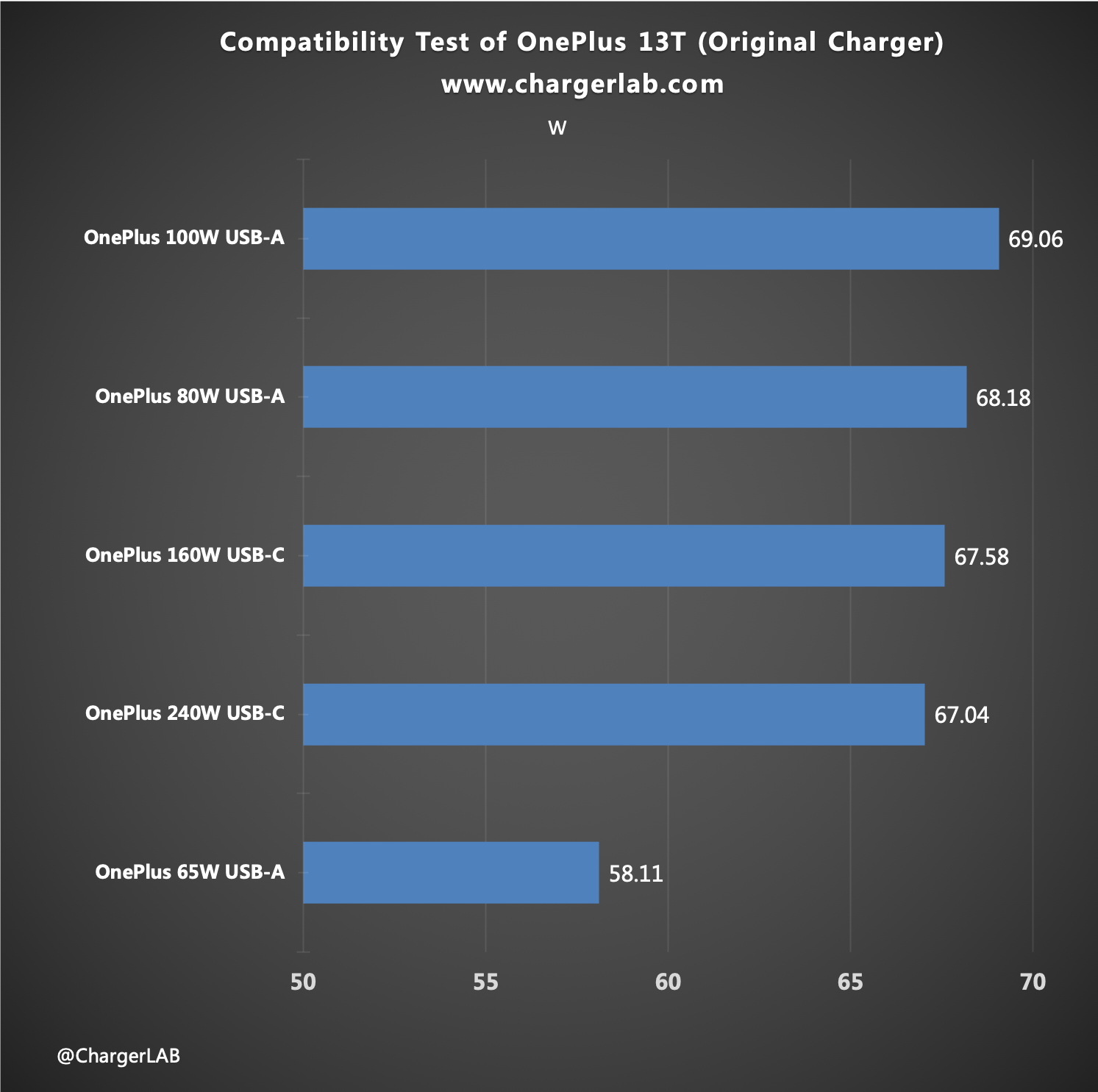

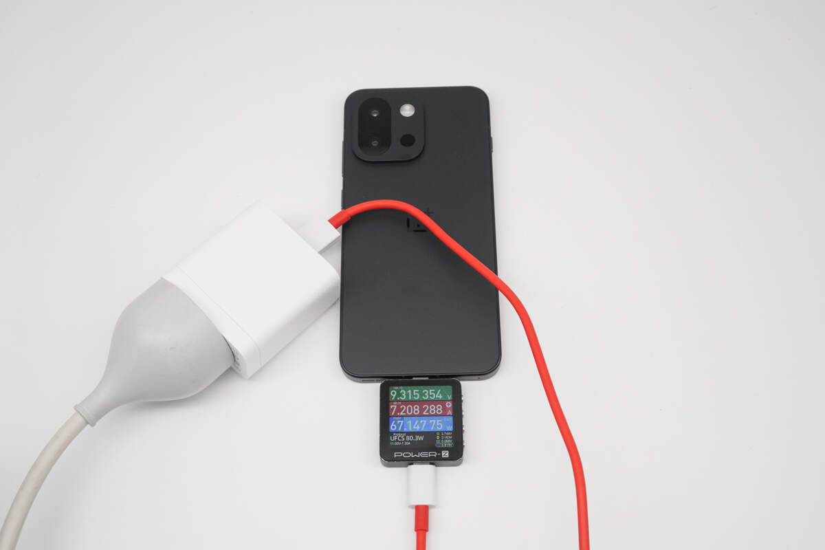

When using the original charger set to charge the OnePlus 13T, the power is about 9.32V 7.21A 67.15W.
The charging power can reach up to 69.06W.
We summarize the test results into a bar chart. Except for the OnePlus 65W charger, the rest can reach 7A current, and the power is above 67W.

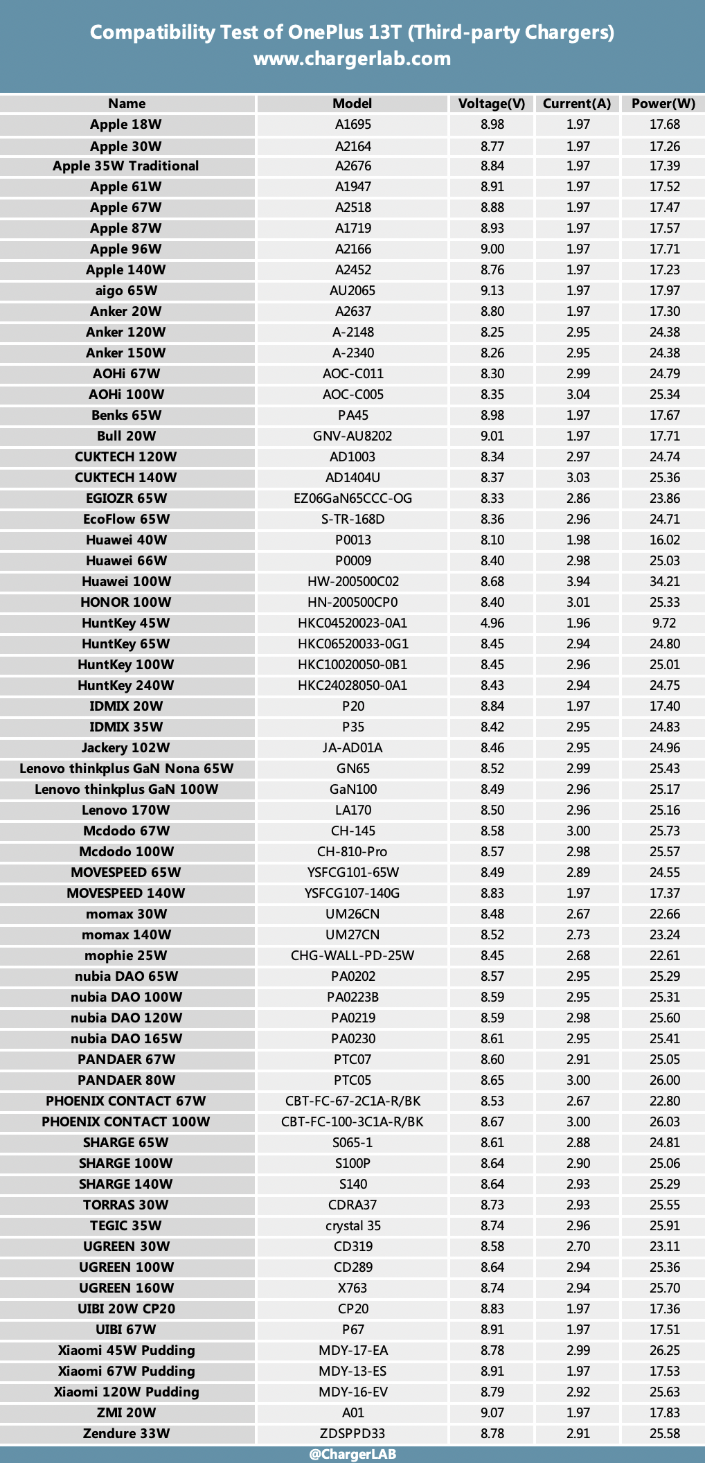

Third-party Chargers
We also used a variety of third-party chargers with the original cable during the test. Let’s take a look at the results.
There are no compatibility issues. Most third-party chargers can reach a voltage of around 9V.
We summarize the test results into a bar chart. The charging power is mainly concentrated in two gears: 17W and 25W. Huawei's 100W charger also supports the UFCS protocol, so it can reach a higher current and a charging power of 34.21W.

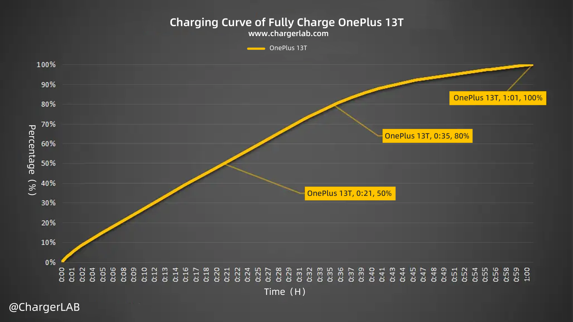

Full Charging Test
We use the original charger to fully charge the OnePlus 13T. And put them into a 25°C (77℉) thermotank throughout the test.
The voltage is around 9V at first. The charging curve can be divided into six parts. The peak power is around 67W for the first 38 seconds. Then, the power gradually drops to 53W, 35W, 33W, and 13W in turn. The final part begins at 46 minutes, and the power drops to 5V. It takes 1 hour and 1 minute to be fully charged.
We also turn it into another curve. It reaches 50% in 21 minutes. And it can reach 80% in 35 minutes, 100% in 1 hour and 1 minute.

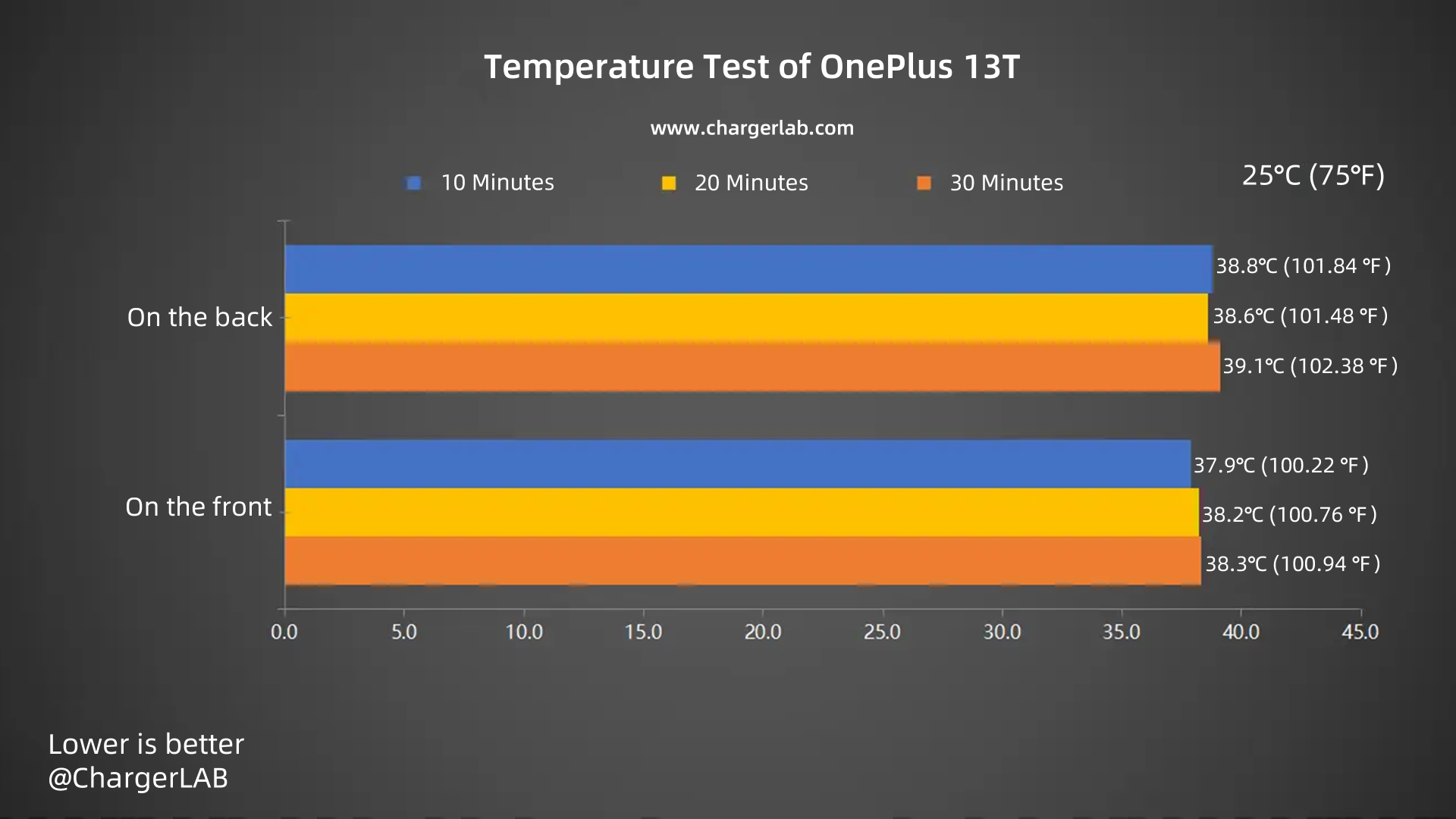

Temperature Test

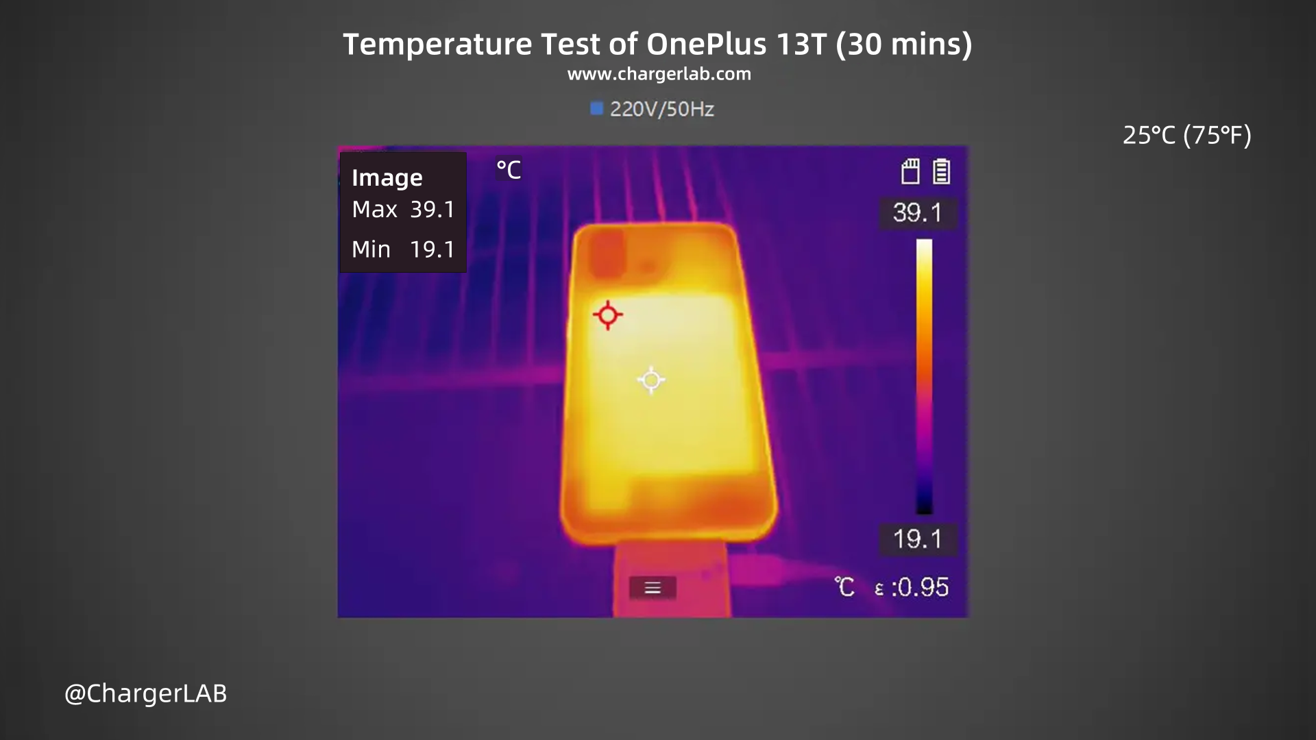

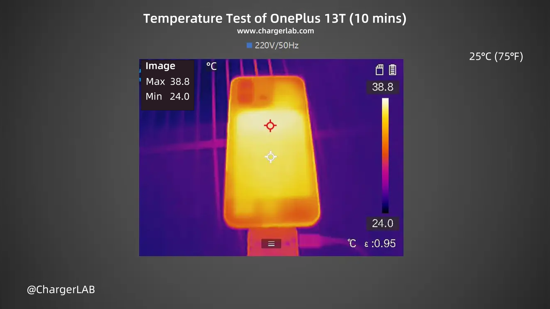

10 minutes Charging
After 10 minutes, the maximum temperature on the front is 37.9℃ (100.22 ℉).
The back is 38.8℃ (101.84 ℉).

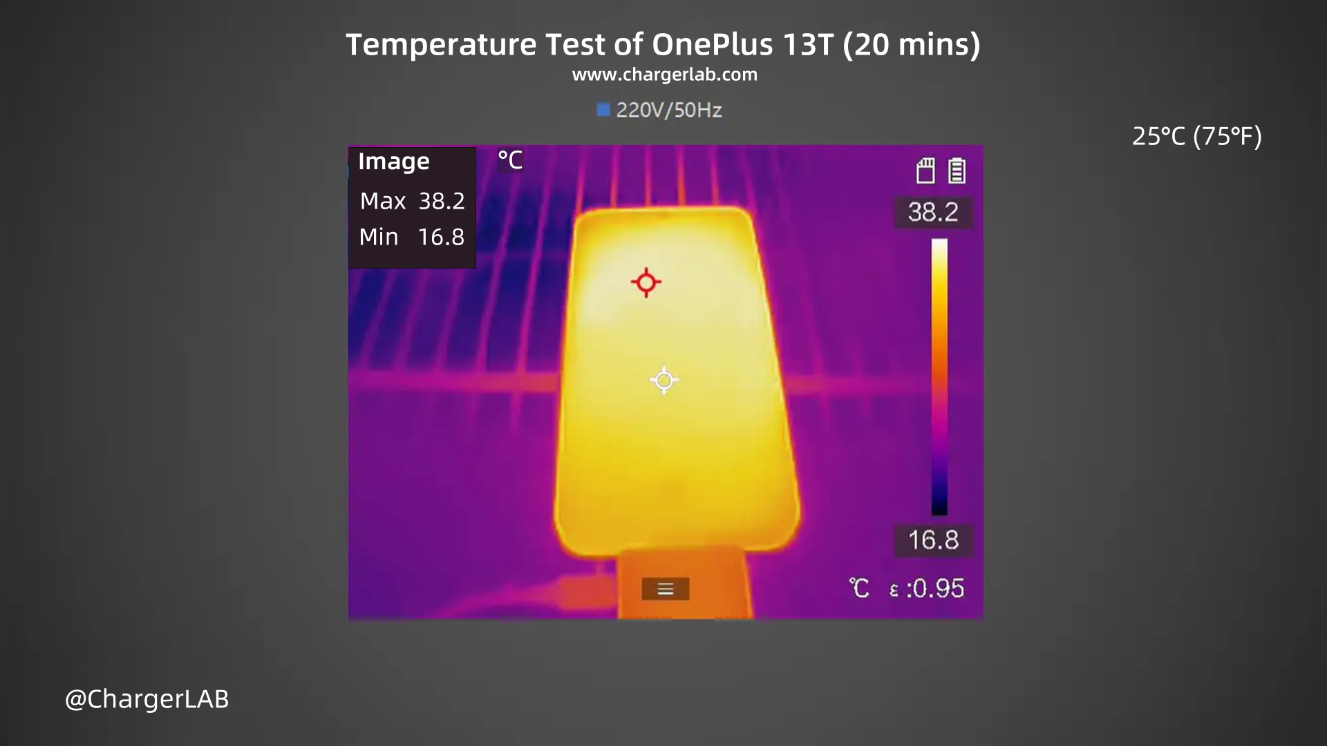

20 minutes Charging
After 20 minutes, the maximum temperature on the front is 38.2℃ (100.76 ℉).
The back is 38.6℃ (101.48 ℉).

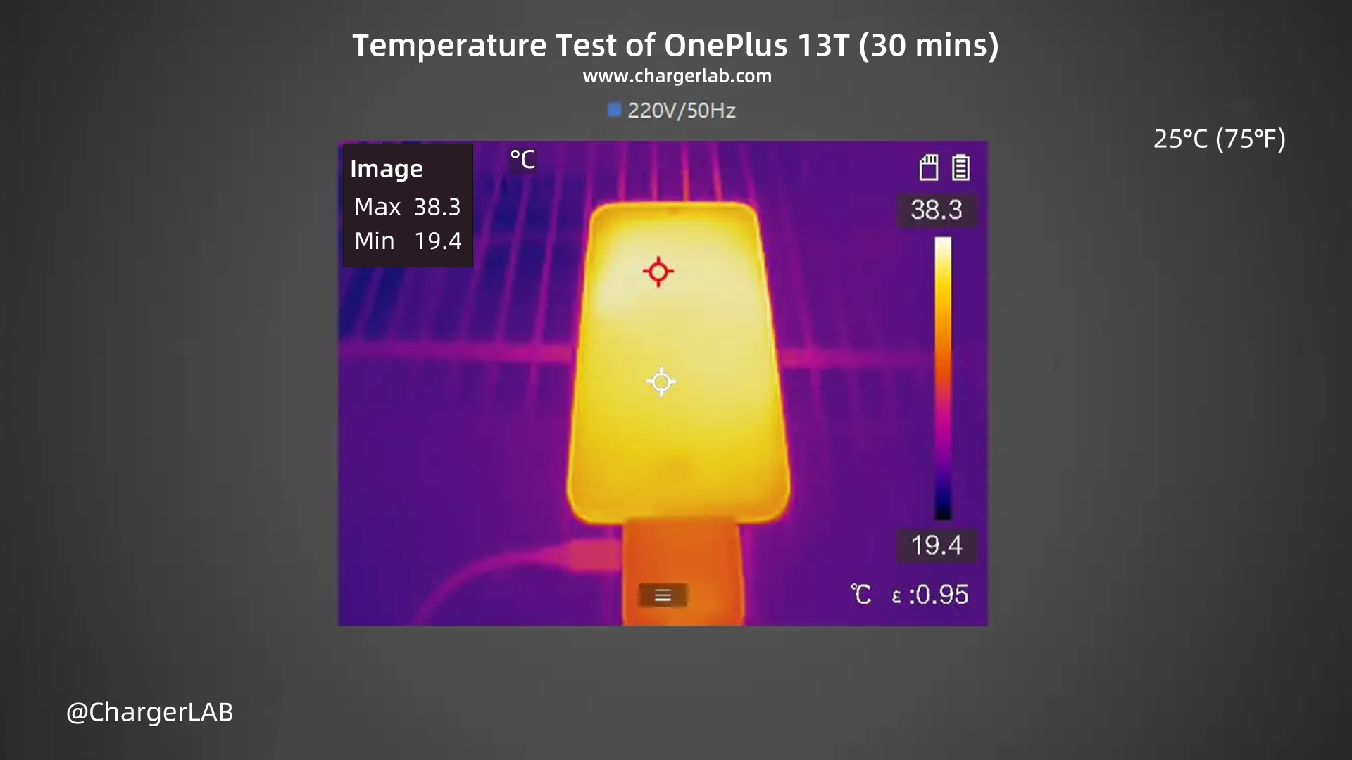

30 minutes Charging
After 30 minutes, the maximum temperature on the front is 38.3℃ (100.94 ℉).
The back is 39.1℃ (102.38 ℉).
We also turn it into a bar chart. During charging for 30 minutes, the temperature is between 37.9 and 39.1°C. Considering the charging power, the OnePlus 13T maintains a stable charging rate between 33W and 35W within the first 30 minutes, indicating effective thermal management and good temperature control during charging.
