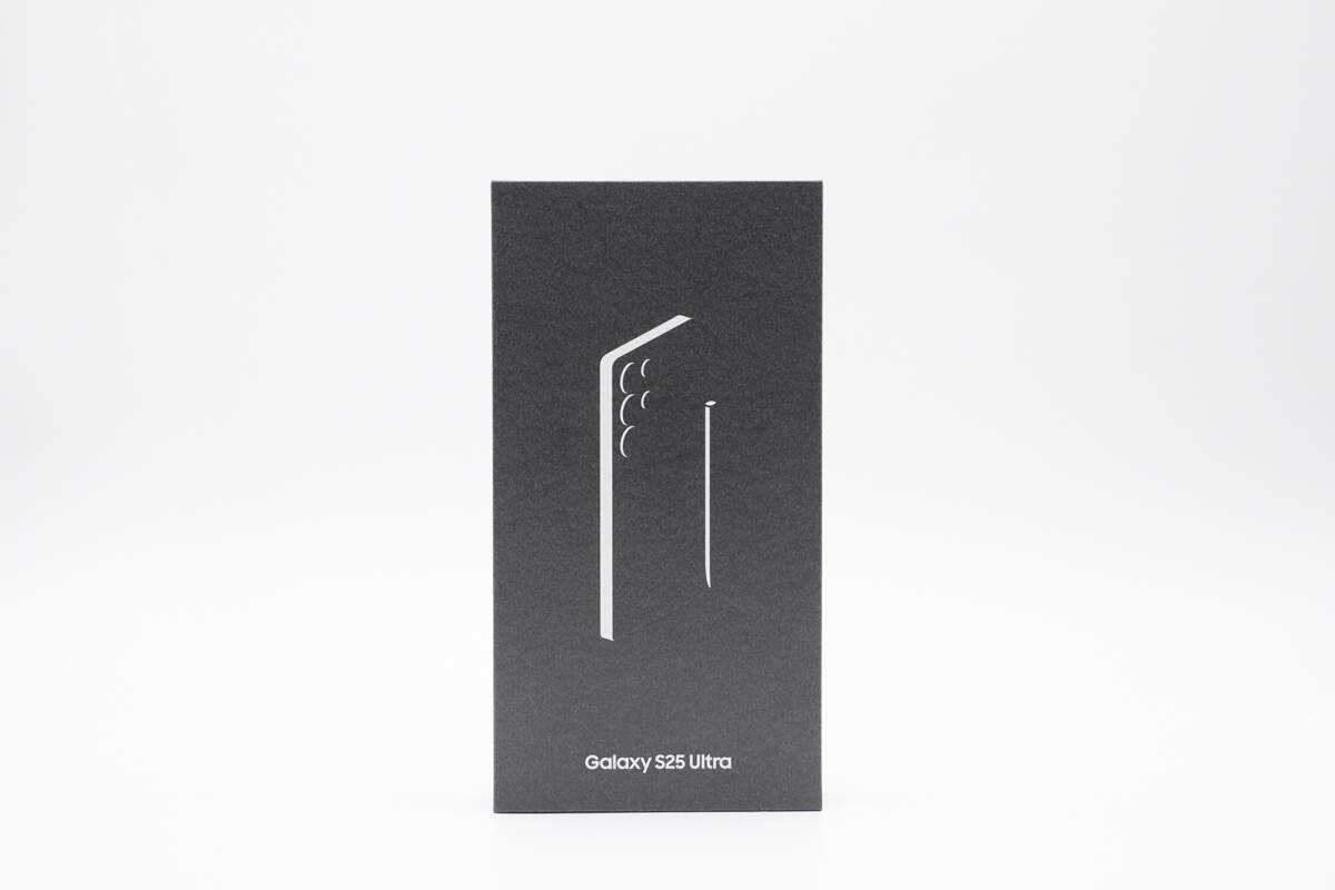

The front of the box has a black-and-white silhouette of the phone and S-Pen, and Galaxy S25 Ultra is printed on the bottom.

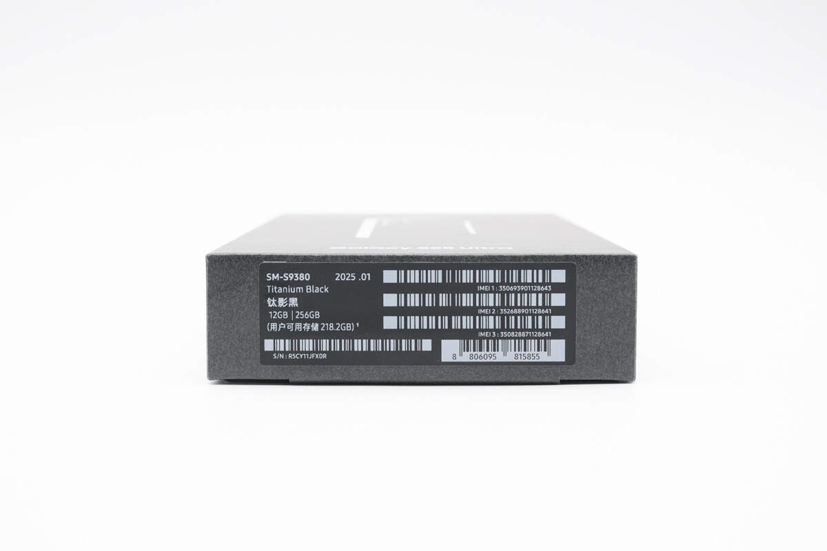

Specification information, S/N, IMEI numbers, etc. are posted at the bottom of the box.

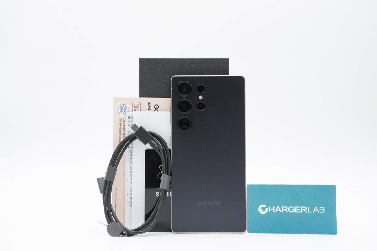

45W + 5000mAh | Charging Review of Samsung Galaxy S25 Ultra-Chargerlab
The box contains the Samsung Galaxy S25 Ultra, a dual USB-C cable, and some documents.

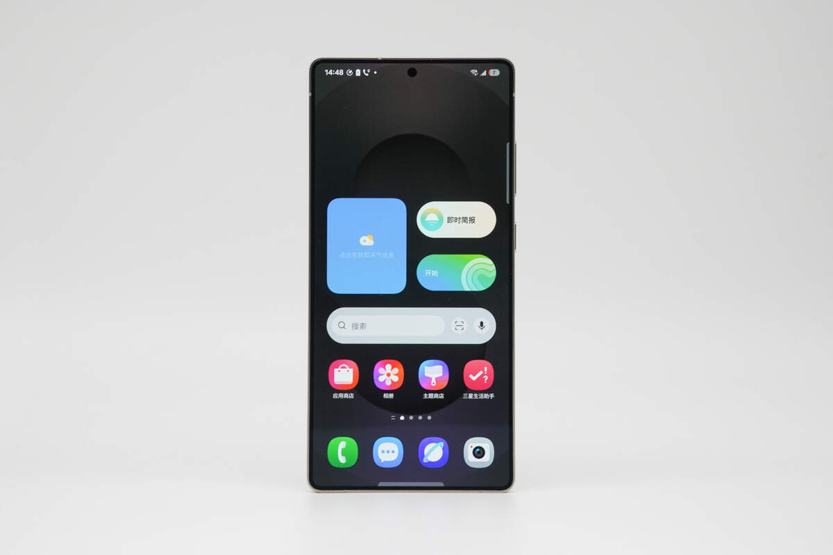

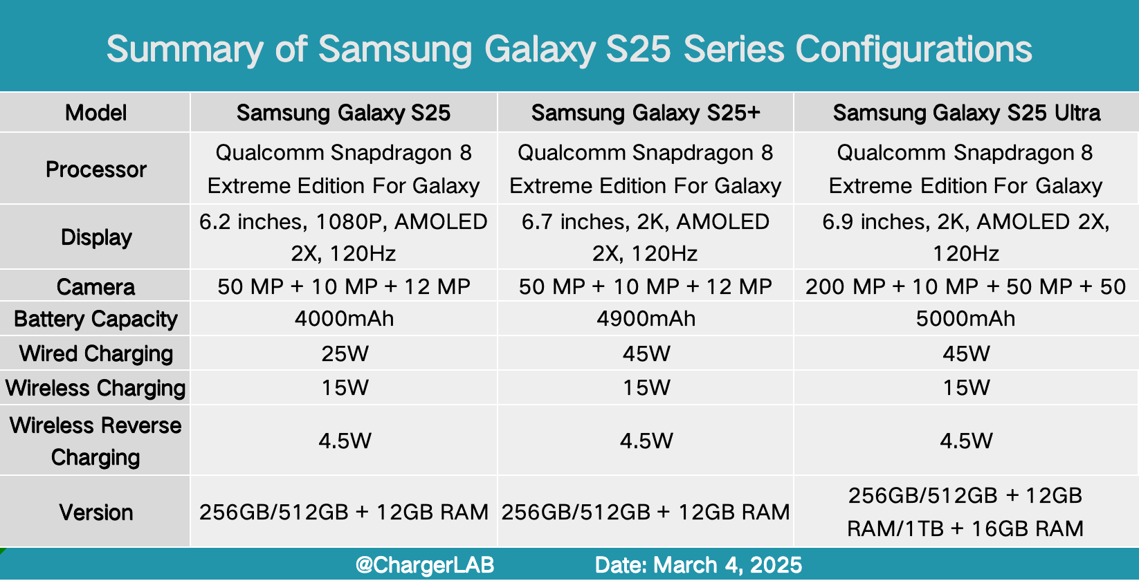

The Samsung Galaxy S25 Ultra features titanium frames and a 6.9-inch Dynamic LTPO AMOLED 2X display with a resolution of 1440 x 3120, a refresh rate of 120Hz, and Corning Gorilla Armor 2 glass. It is equipped with Qualcomm Snapdragon 8, up to 16GB RAM and 1TB storage.

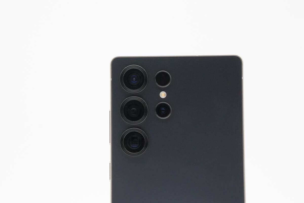

The camera module has four cameras, from top to bottom: 50-megapixel ultra-wide-angle, 200-megapixel wide-angle, 50-megapixel telephoto, and a 10-megapixel lens on the right.

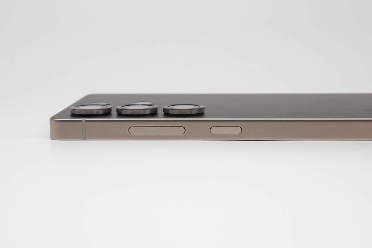

The power button and volume button are both on the right side.

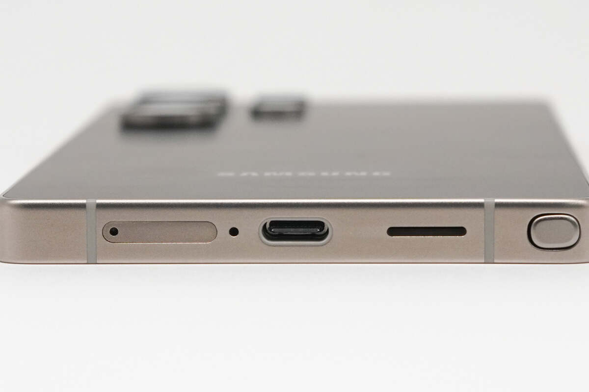

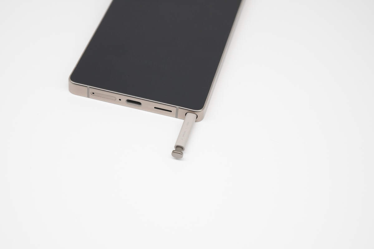

The bottom has a SIM card slot, USB-C port, microphone, speaker, and S-Pen. The USB-C port is USB 3.2 Gen 1.
The S-Pen adopts a push-to-pop design, regardless of the front or back.

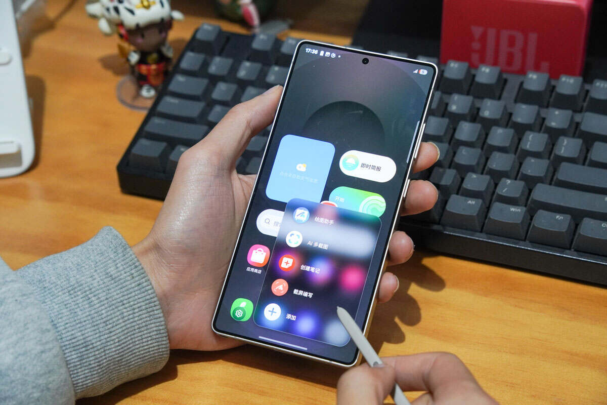

When the S-Pen is pulled out, you can call out related apps directly by setting the shortcut key on the side of the S-Pen. When the pen tip is 10mm away from the screen, you can see the cursor track of the pen tip on the screen, and the cursor disappears when it is away.

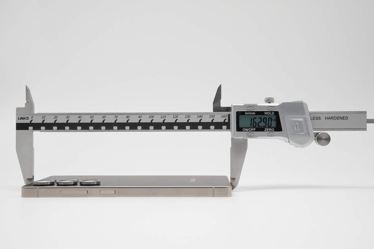

The length of the phone is about 162.9 mm (6.41 inches).

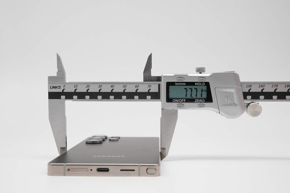

The width is about 77.71 mm (3.059 inches).

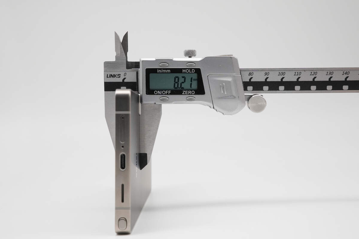

The thickness is about 8.21 mm (0.32 inches).

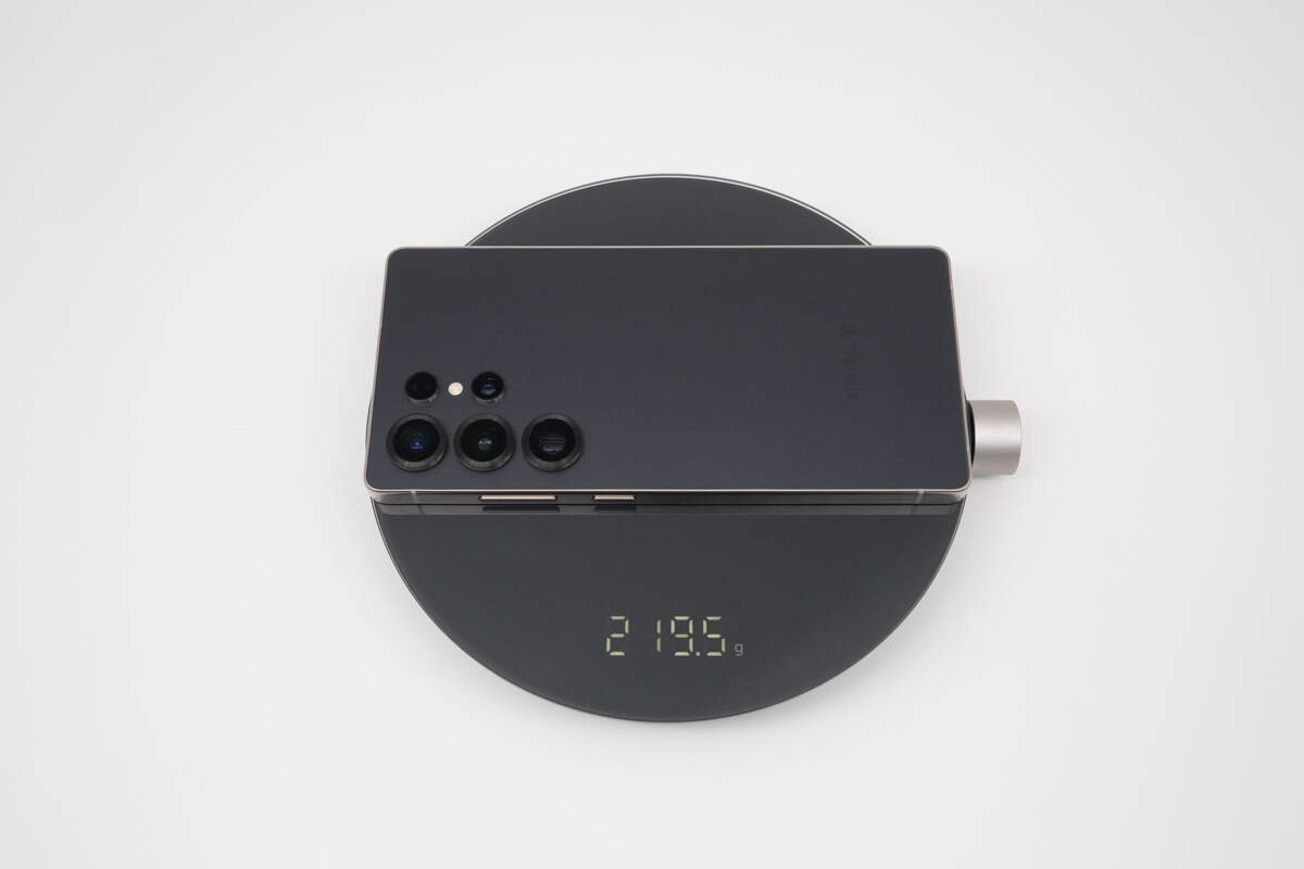

The weight is about 219.5 g (7.74 oz), which is about 14 g lighter than the S24 Ultra.

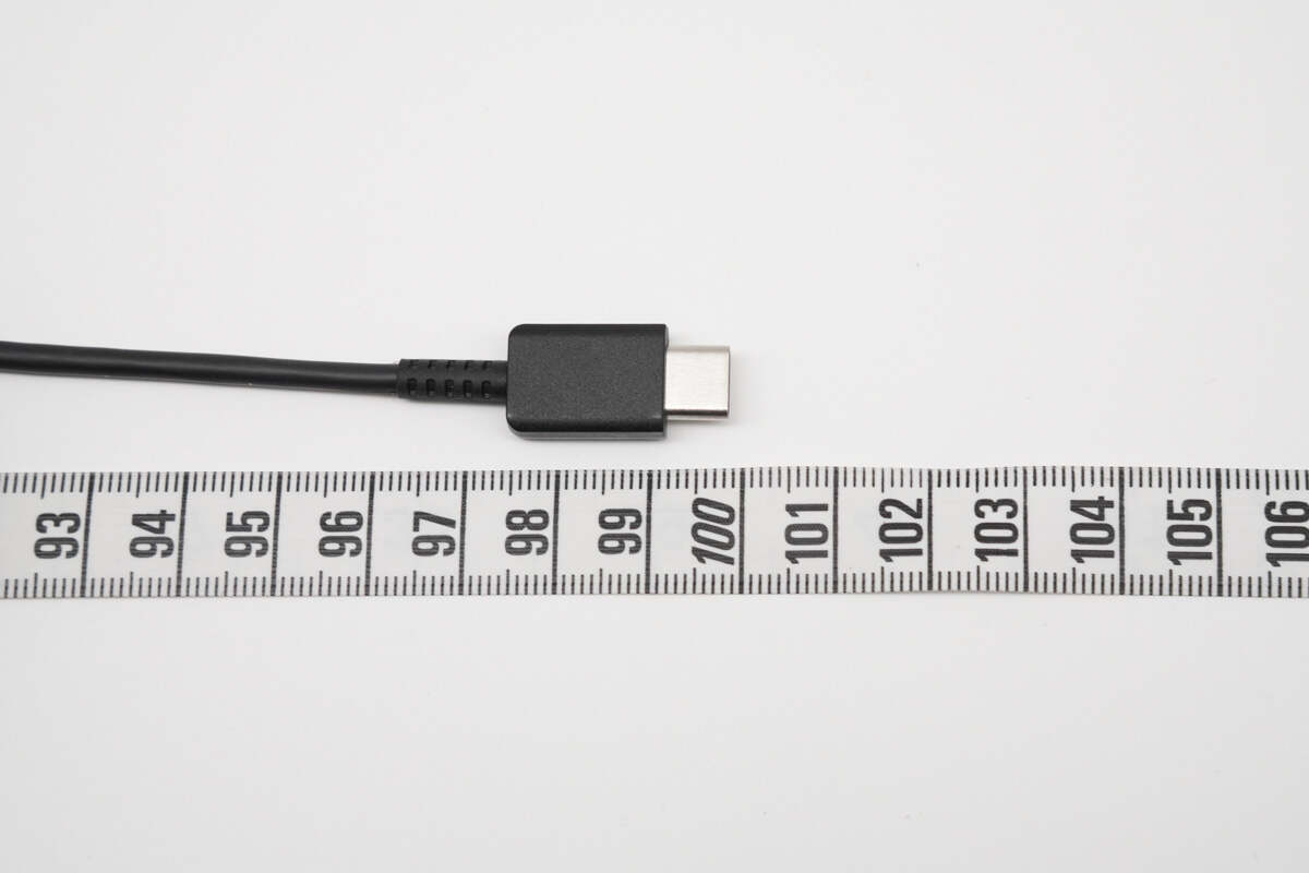

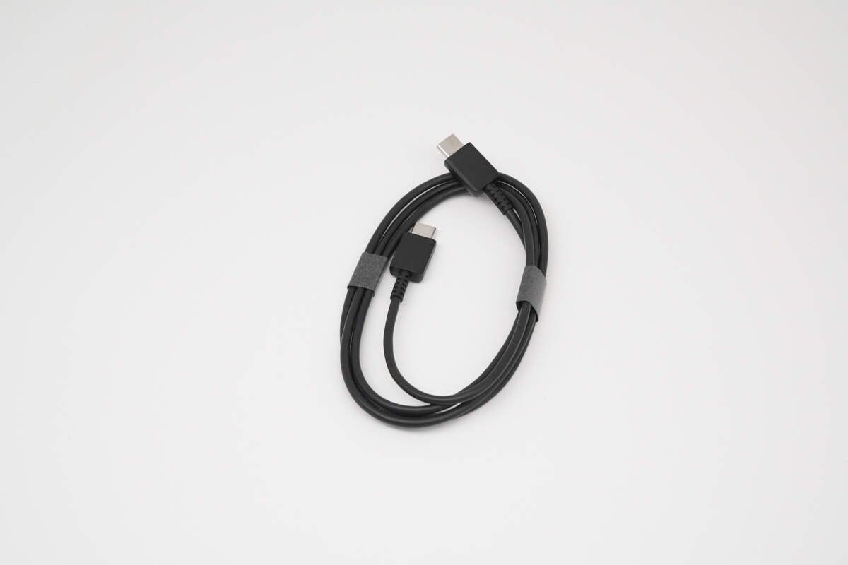

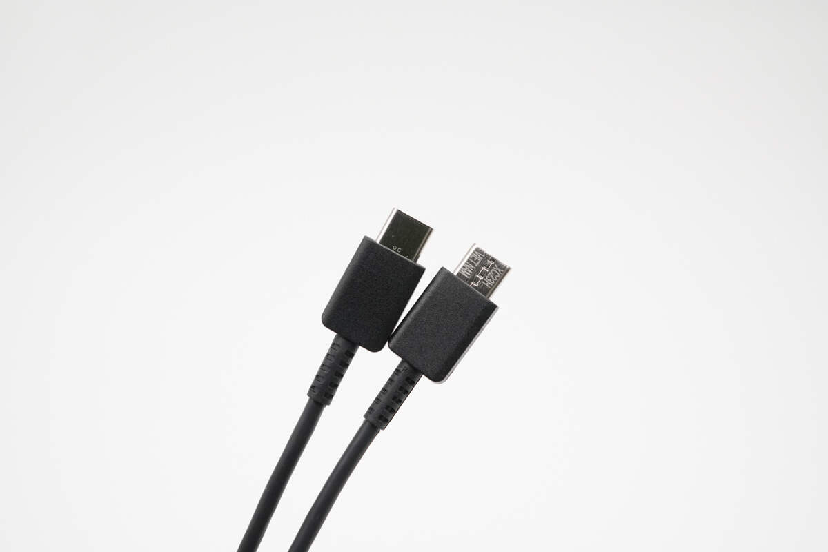

The dual USB-C cable is made of TPE and has a smooth surface. Secure with paper shells.
The connectors and the cable are thickened to be more resistant to bending.

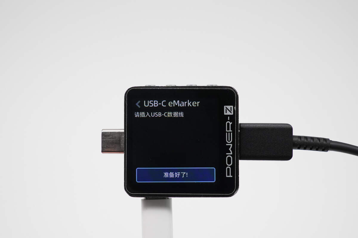

ChargerLAB POWER-Z KM003C shows it doesn't have an E-marker chip.

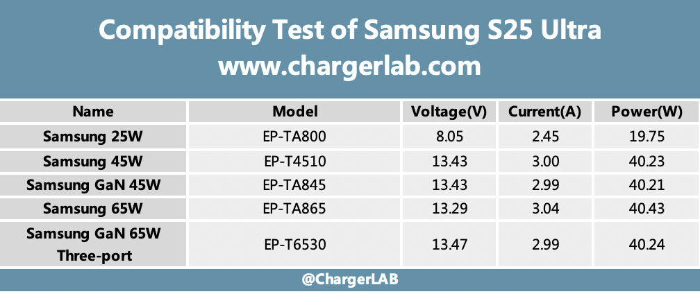

Original Charger

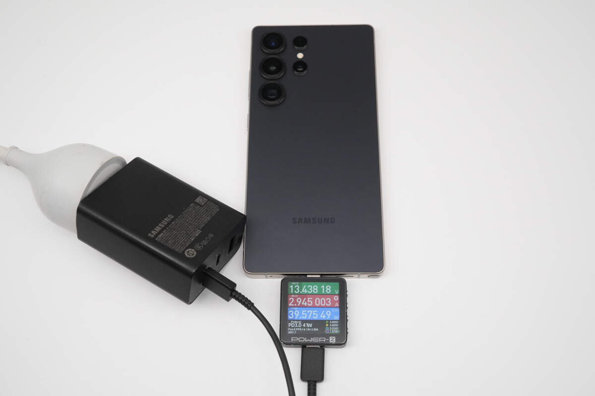

Charge with the Samsung 65W three-port charger with the original 3A cable, the power is about 13.44V 2.95A 39.58W.

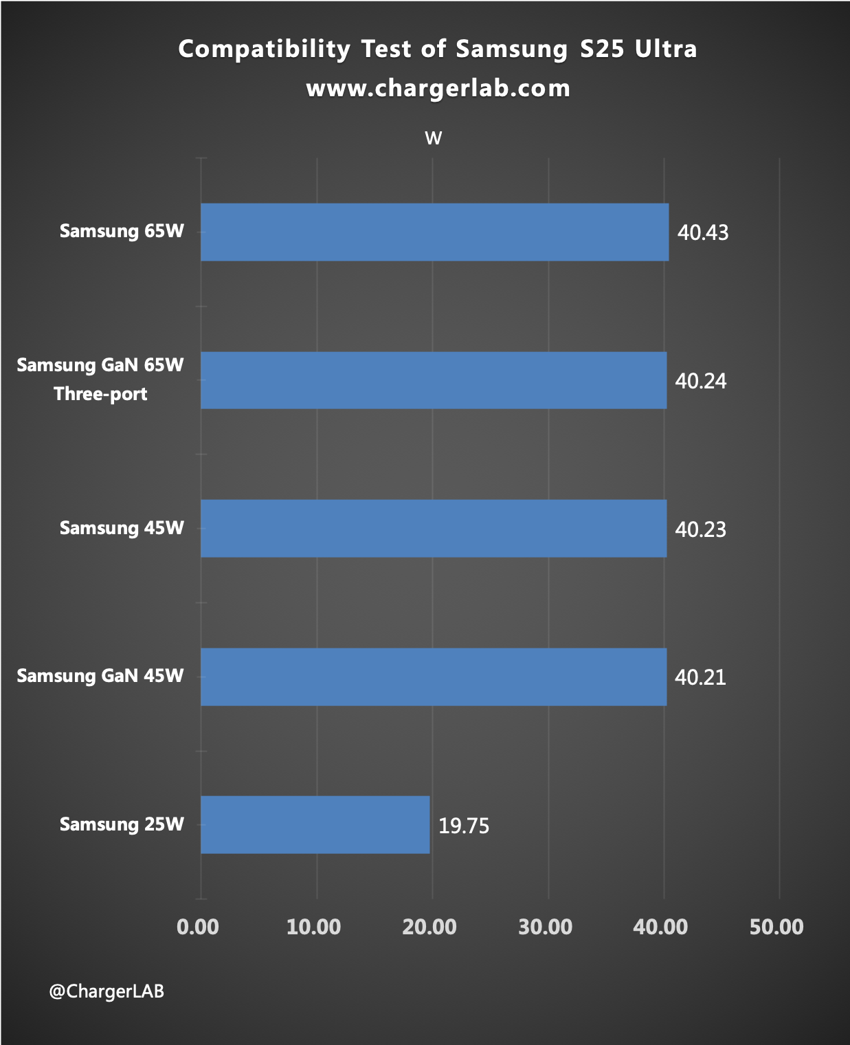

Samsung chargers were tested one by one, and all were paired with the original 3A dual USB-C cable. The maximum voltage can reach 13V. Except for the 25W charger power limit, the power of the rest of the Samsung chargers is above 40W.
The power of chargers above 45W can reach 40W, and the actual power of a 25W charger is close to 20W.

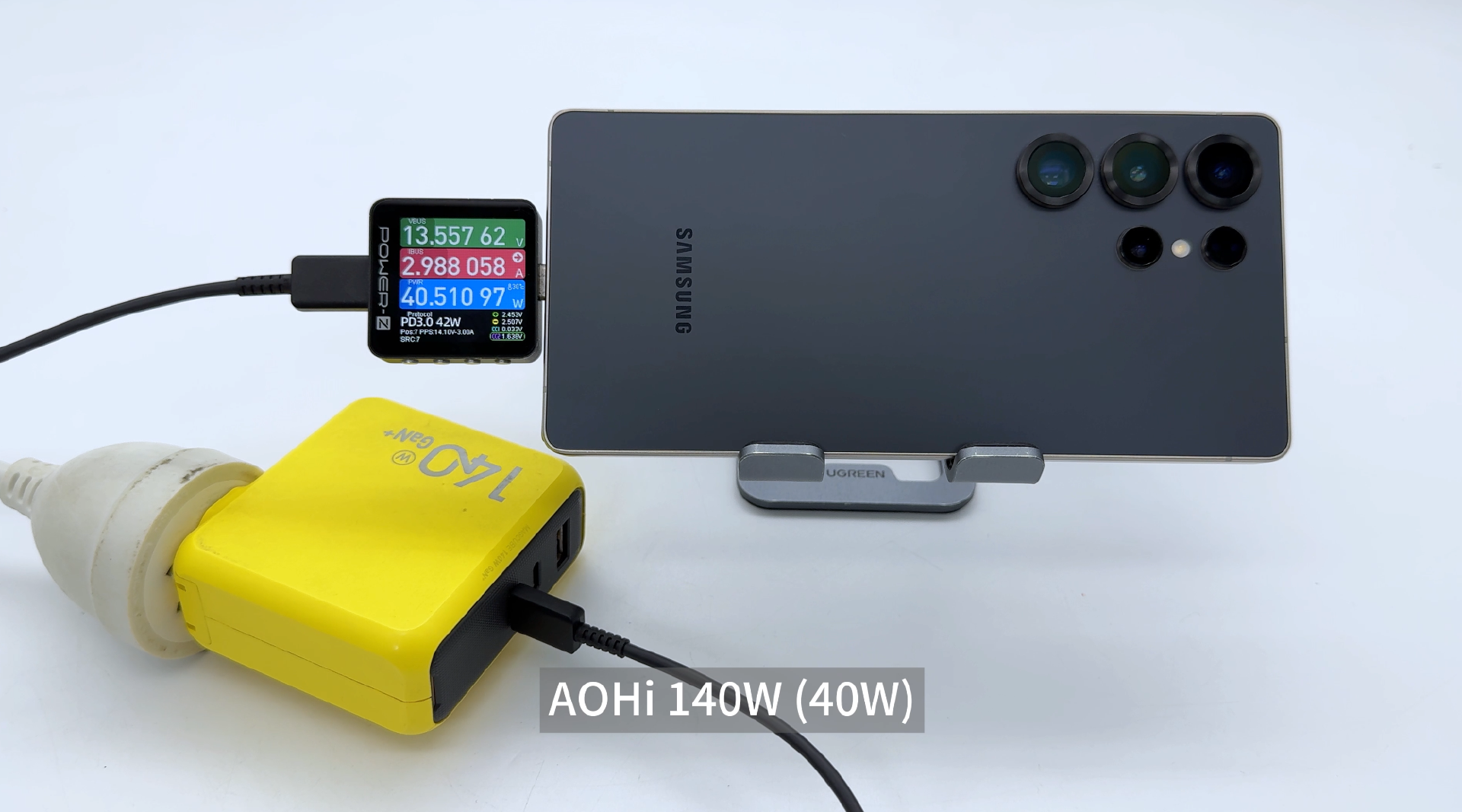

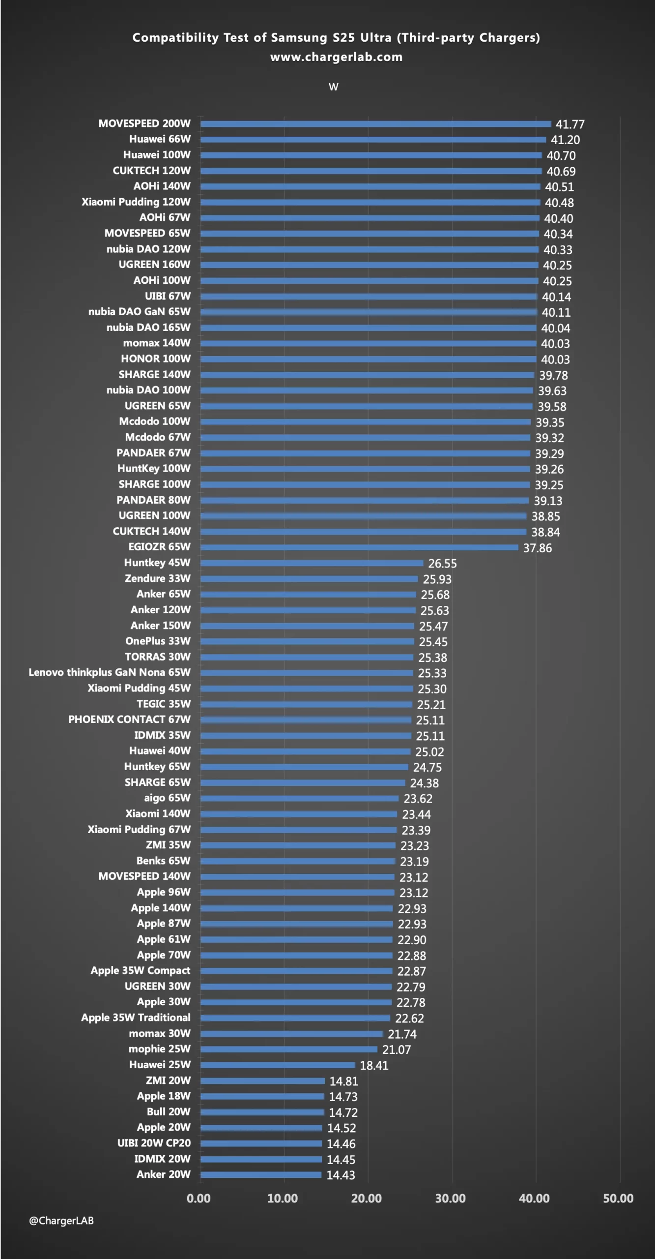

Third-party Chargers
Charge with the AOHi 140W charger with the original 3A cable, the power is about 13.56V 2.99A 40.51W.
The third-party chargers tested can generally reach a voltage of around 9V or 13V, and the power is between 14 and 41W.
We have compiled the test results into a bar chart. There are no compatibility issues. Most of the power is above 20W. For chargers that support the PD protocol, the power is generally around 23W, and chargers that support the PPS protocol have a higher power, between 25-41W, with a maximum of 41.77W, which has good compatibility.

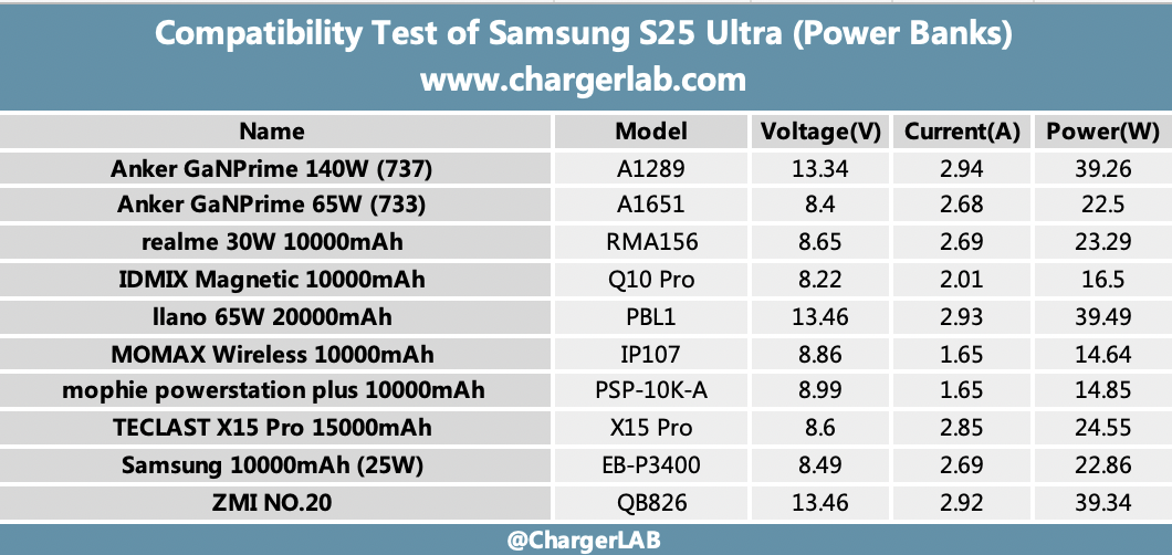

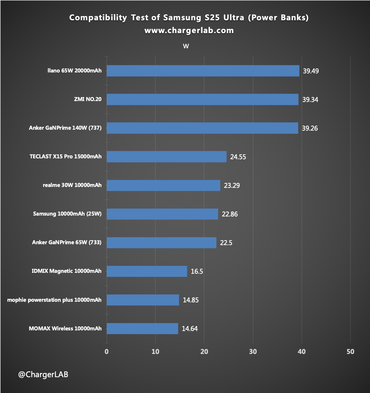

Power Banks
The voltage of most power banks can reach 9V, while those that support high-power PPS can reach 13V, with higher power.
Compiled the test results into a bar chart. There are no compatibility issues. There are three power banks that can reach a power of about 39W, and the power of the rest is about 23W or 15W.

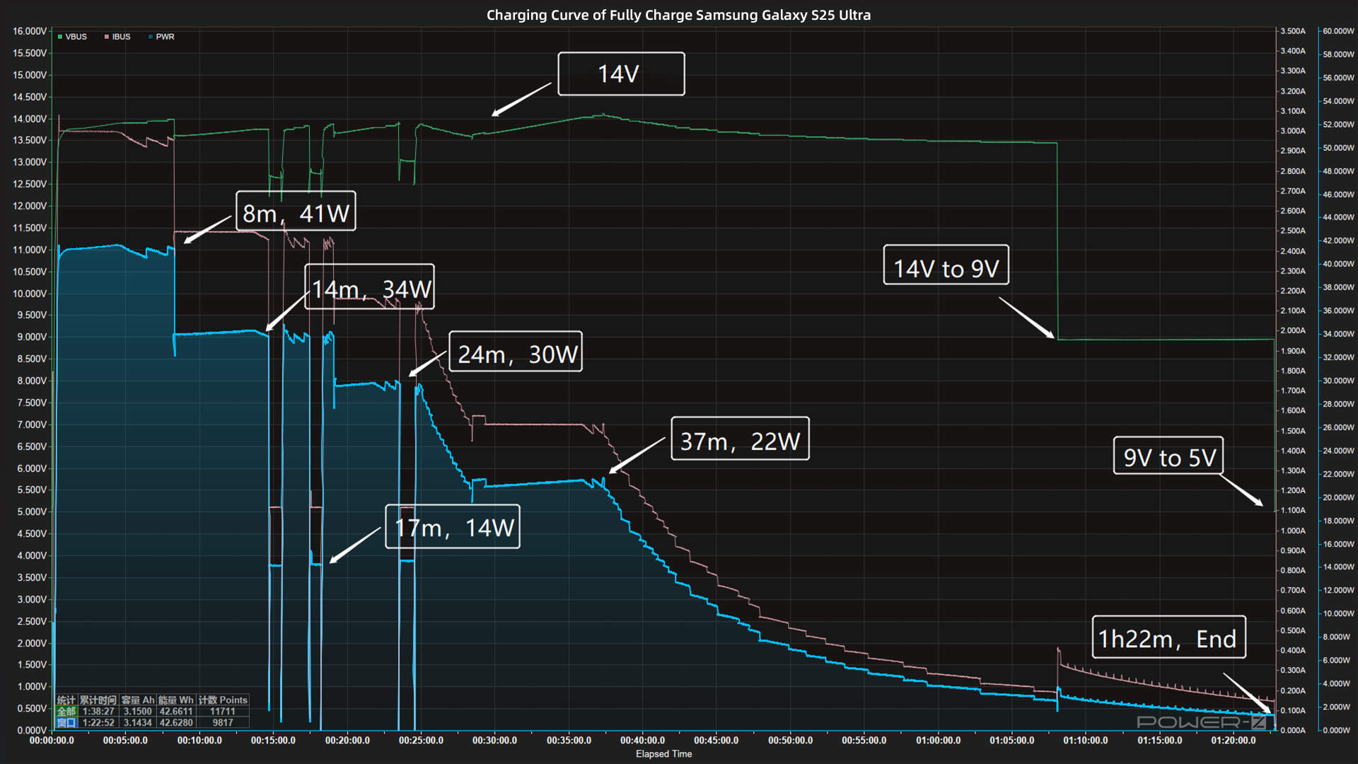

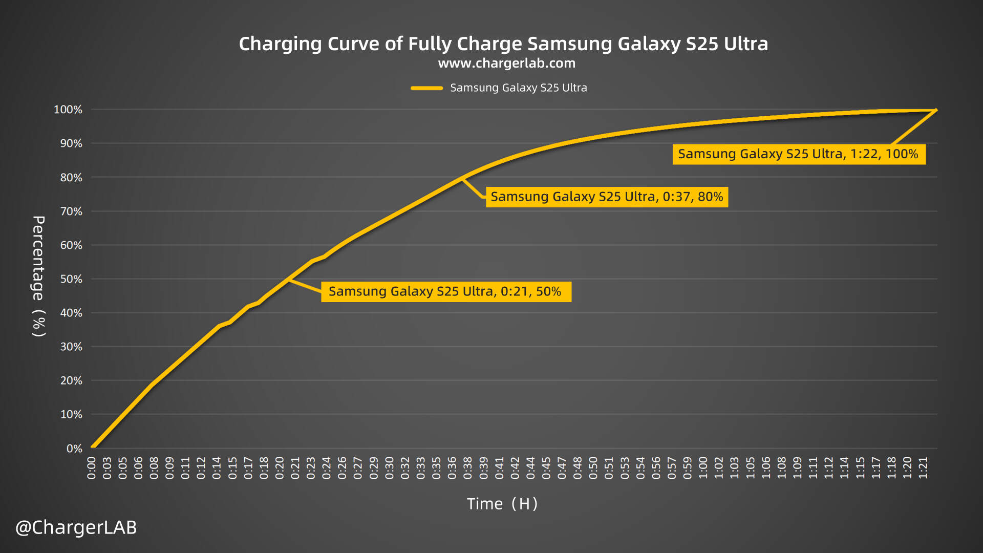

We use the Samsung 65W three-port charger with the original 3A cable to fully charge the Samsung Galaxy S25 Ultra. And put them into a 25°C (77℉) thermotank throughout the test.
At first, the voltage is around 14V. The charging curve can be divided into six parts. The power is around 41W for the first 8 minutes. Then, the power drops to 34W and 14W. Next the power rises to 30W and then drops to 22W. After that, the voltage drops from 14V to 9V. It takes 1 hour and 22 minutes to be fully charged and the voltage drops to 5V.
We also turn it into another curve. The Samsung 65W three-port charger can charge the Samsung Galaxy S25 Ultra to 50% in 21minutes. And it can reach 80% in 37 minutes and 100% in 1 hour and 22 minutes.

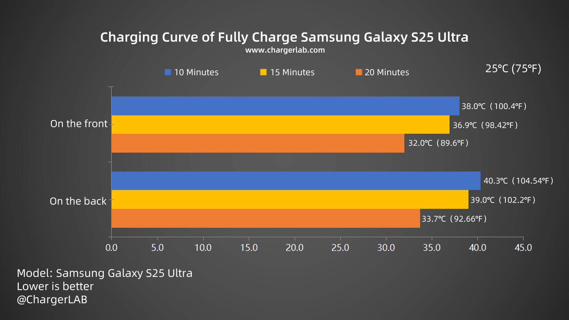

Temperature Test

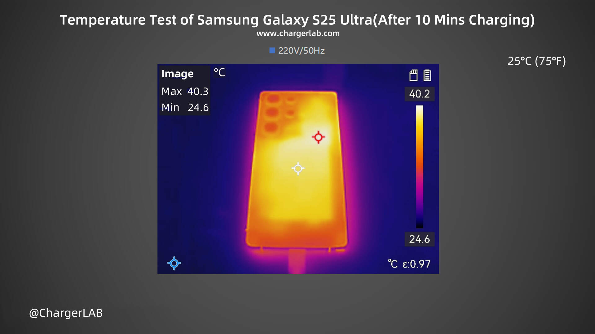

10 minutes Charging

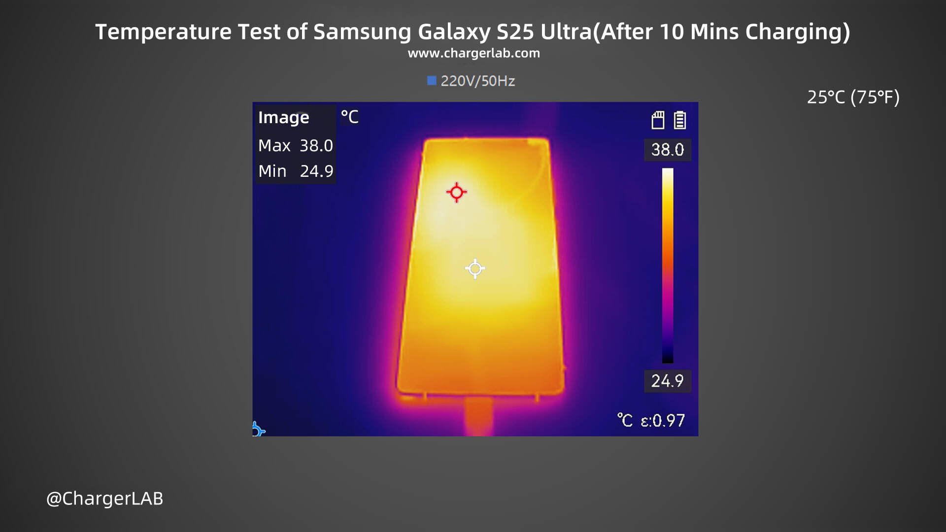

After 10 minutes, the maximum temperature on the front is 38℃ (100.4 ℉).
The back is 40.3℃ (104.54 ℉).

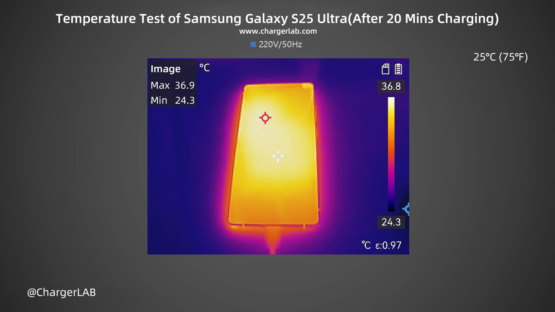

20 minutes Charging

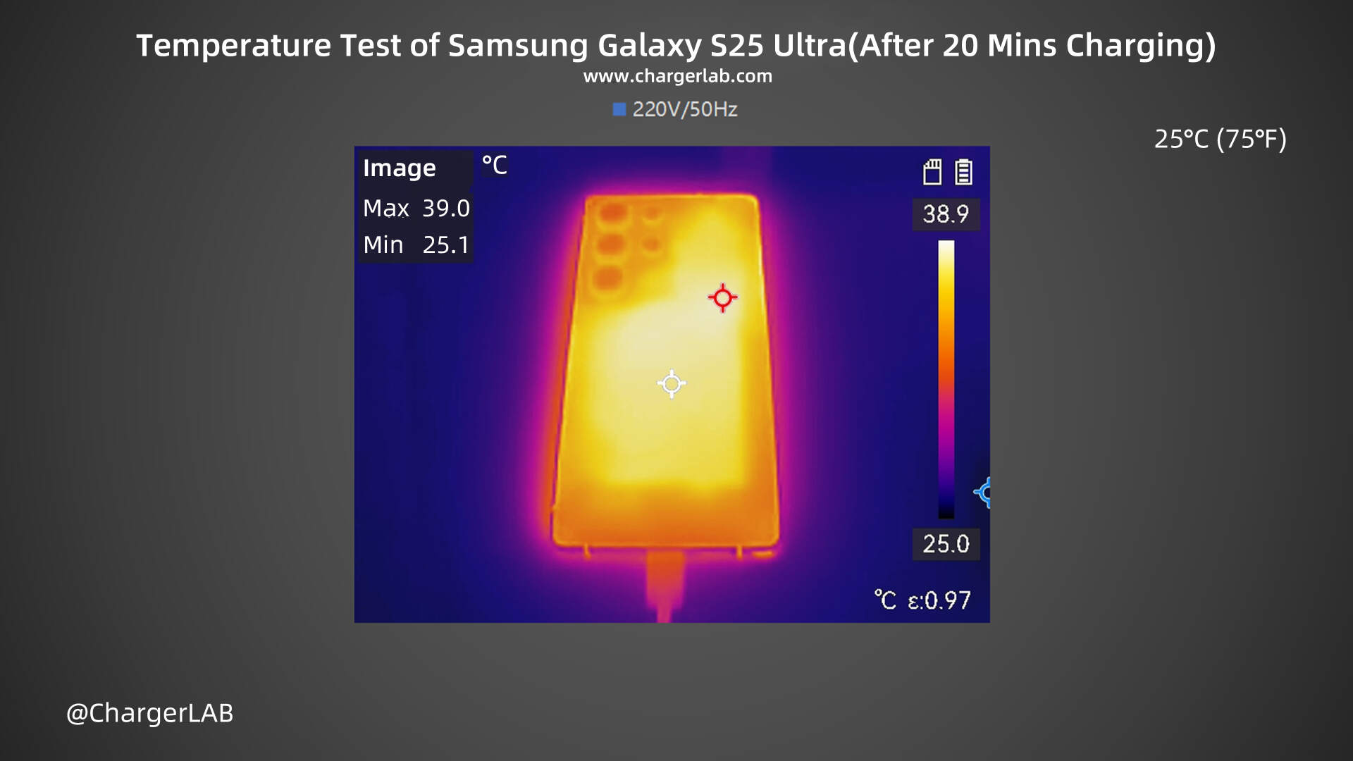

After 20 minutes, the maximum temperature on the front is 36.9℃ (98.42 ℉).
The back is 39℃ (102.2 ℉).

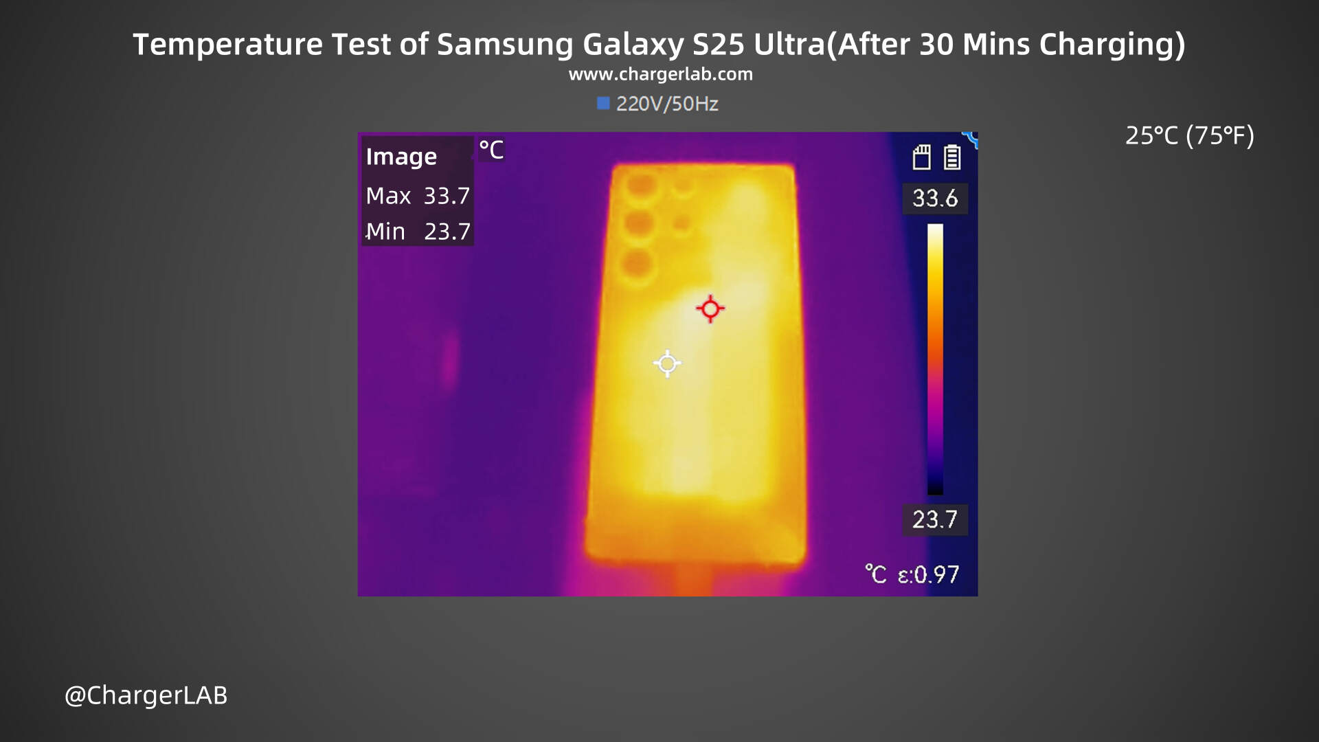

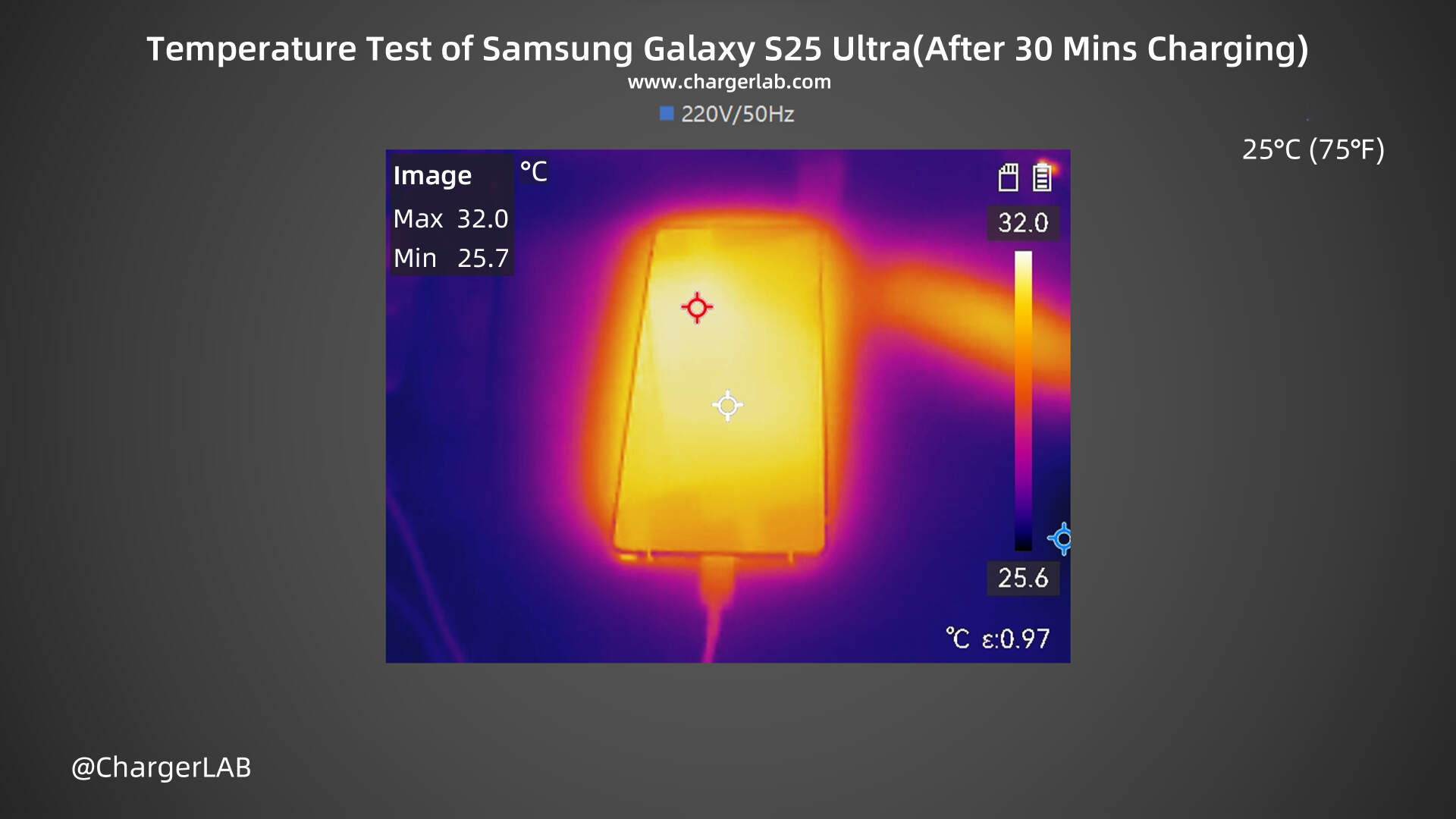

30 minutes Charging
After 30 minutes, the maximum temperature on the front is 32℃ (89.6 ℉).
The back is 33.7℃ (92.66 ℉).
We also turn it into a bar chart. During charging, the temperature on the back is slightly higher than that on the front. At the tenth minute, the temperature on the back was the highest, reaching 40.3℃ (104.54 ℉), and the power was about 34W. At the 30th minute, the temperature on the back was only 33.7℃ (92.66 ℉), and the power was about 22W, showing excellent temperature control.
