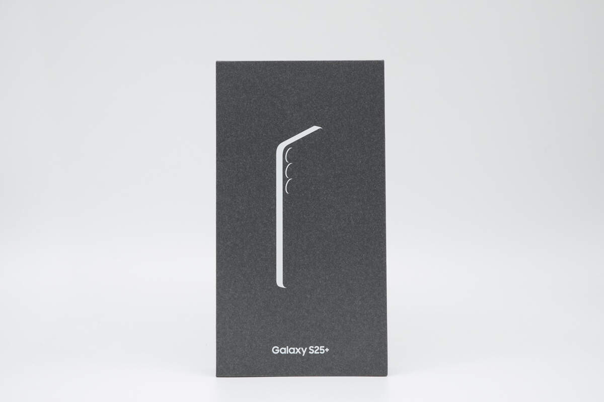

The front of the box has a black-and-white silhouette of the phone, and Galaxy S25+ is printed on the bottom.

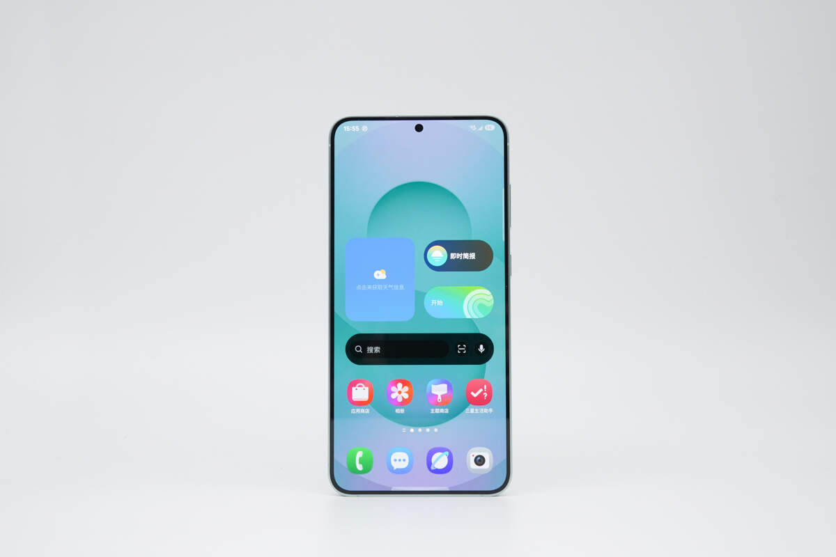

The Samsung Galaxy S25+ features a 6.7-inch AMOLED display with a resolution of 3120 x 1440, a refresh rate of 120Hz, and Corning Gorilla Armor 2 glass.

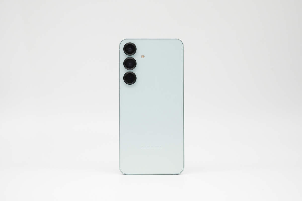

It is available in Icy Blue, Mint, Navy, Silver Shadow, Pink Gold, Coral Red, and Blue Black.
45W + 4900mAh | Charging Review of Samsung Galaxy S25+-Chargerlab

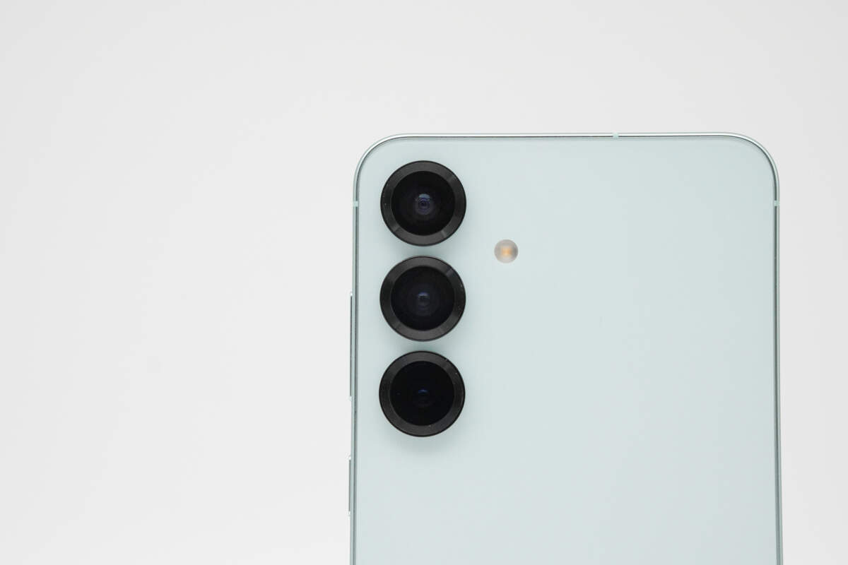

It features a triple rear camera setup, including a 50MP wide-angle lens, a 12MP ultra-wide-angle lens, and a 10MP telephoto lens. The advanced noise reduction algorithm enhances low-light photography for clearer night shots. Preloaded with the One UI 7 system, it offers smart and convenient AI-powered features such as multi-screenshot capture and instant circle-to-search functionality.
The camera is raised, so you need to pay more attention to it in daily use.

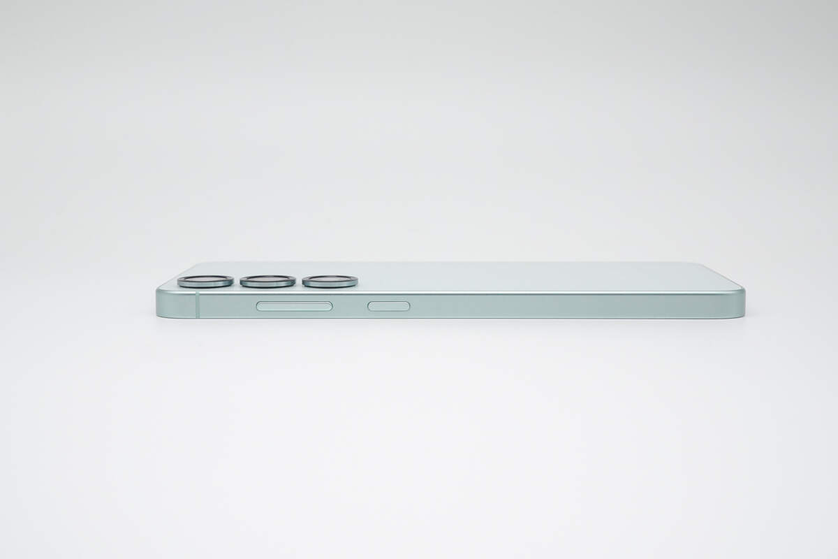

The power button and volume button are both on the right side.

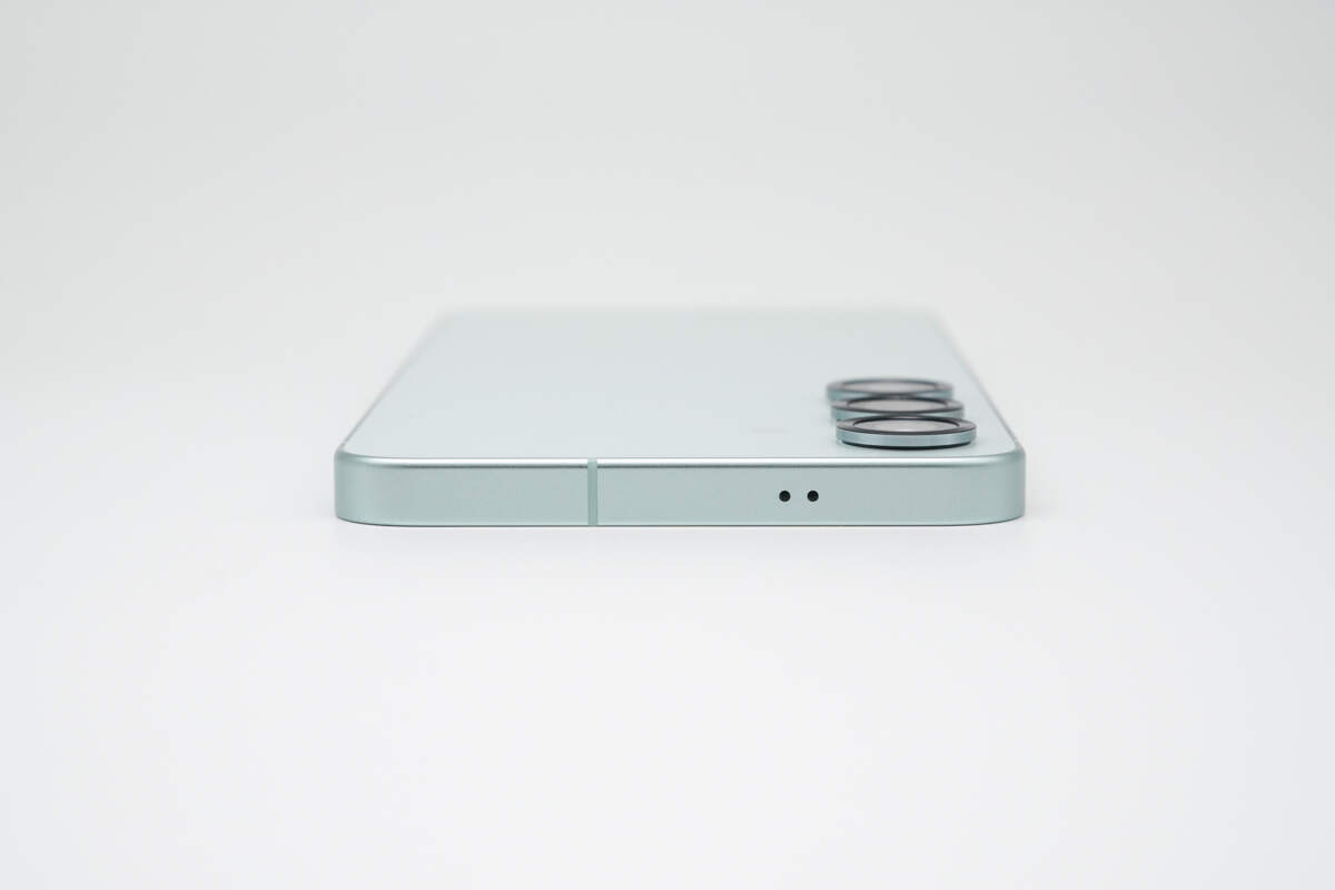

The bottom has a SIM card slot, USB-C port, microphone, and speaker.

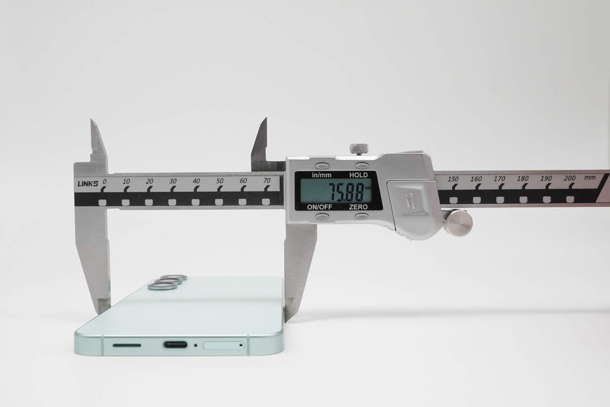

The width is about 75.88 mm (2.99 inches).

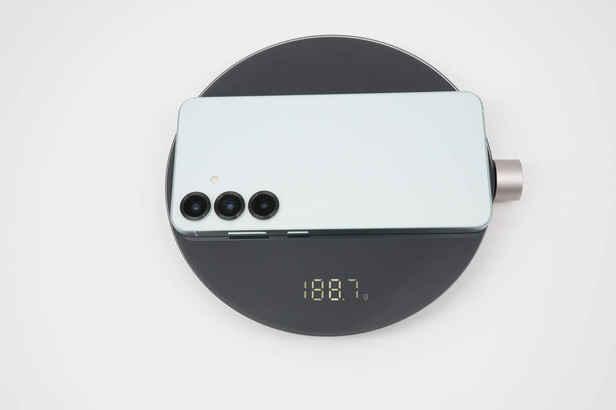

The weight is about 188.7 g (6.66 oz).

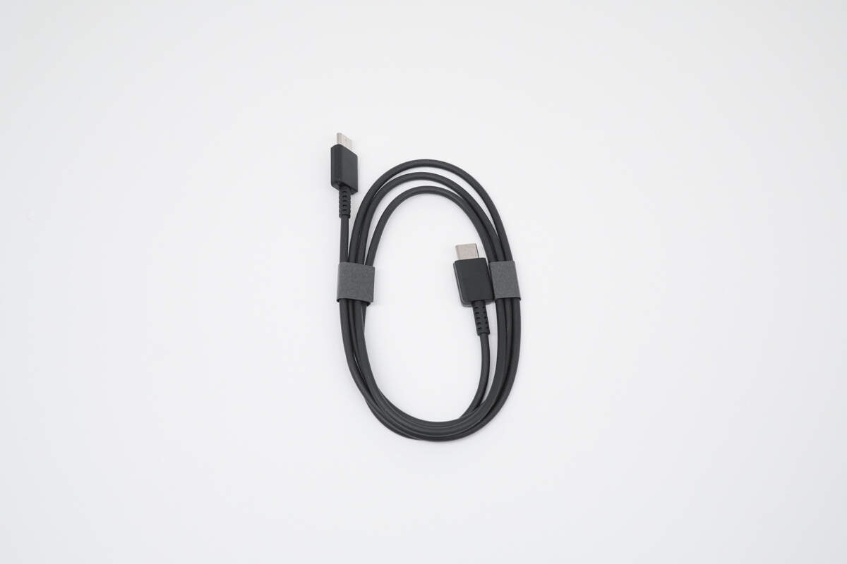

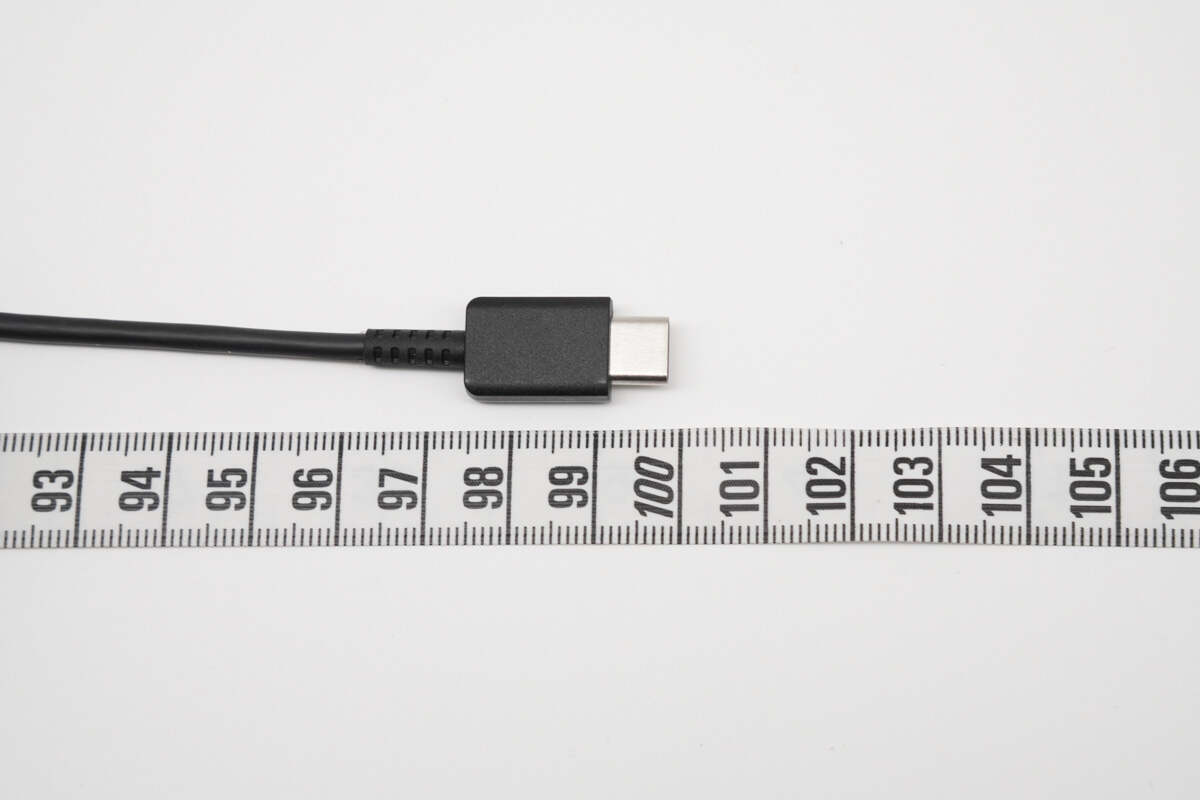

The dual USB-C cable is made of TPE and has a smooth surface. Secure with paper shells.
The connectors and the cable are thickened to be more resistant to bending.

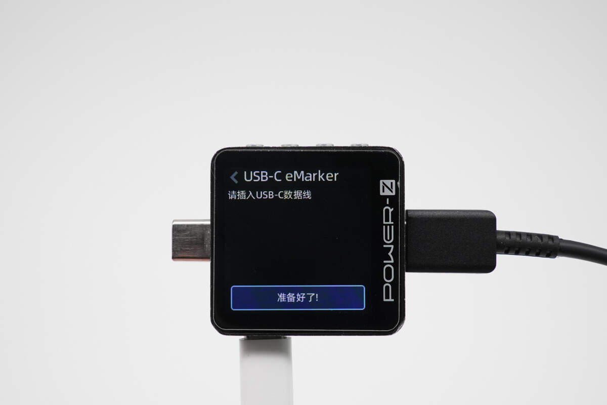

ChargerLAB POWER-Z KM003C shows it doesn't have an E-marker chip.

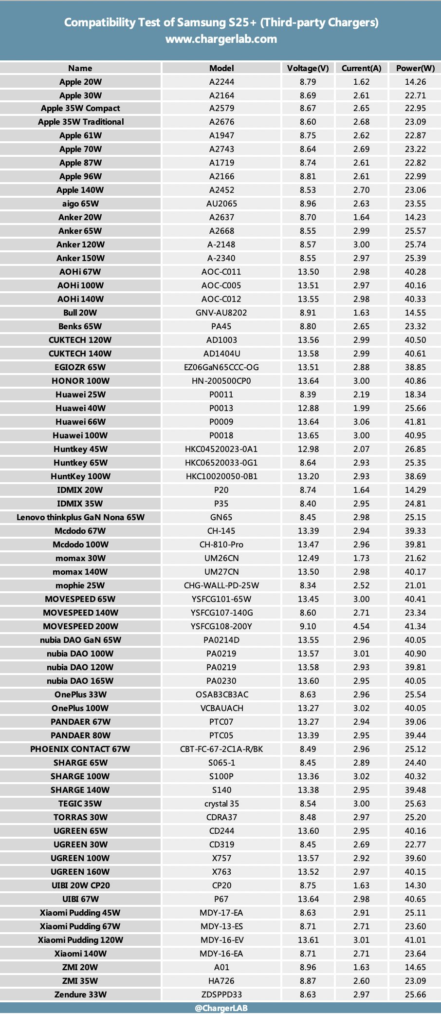

The third-party chargers tested can generally reach a voltage of around 9V or 13V, and the power is between 14 and 41W.
We have compiled the test results into a bar chart. There are no compatibility issues. Most of the power is above 20W. For chargers that support the PD protocol, the power is generally around 23W, and chargers that support the PPS protocol have a higher power, between 25-41W, with a maximum of 41.81W, which has good compatibility.

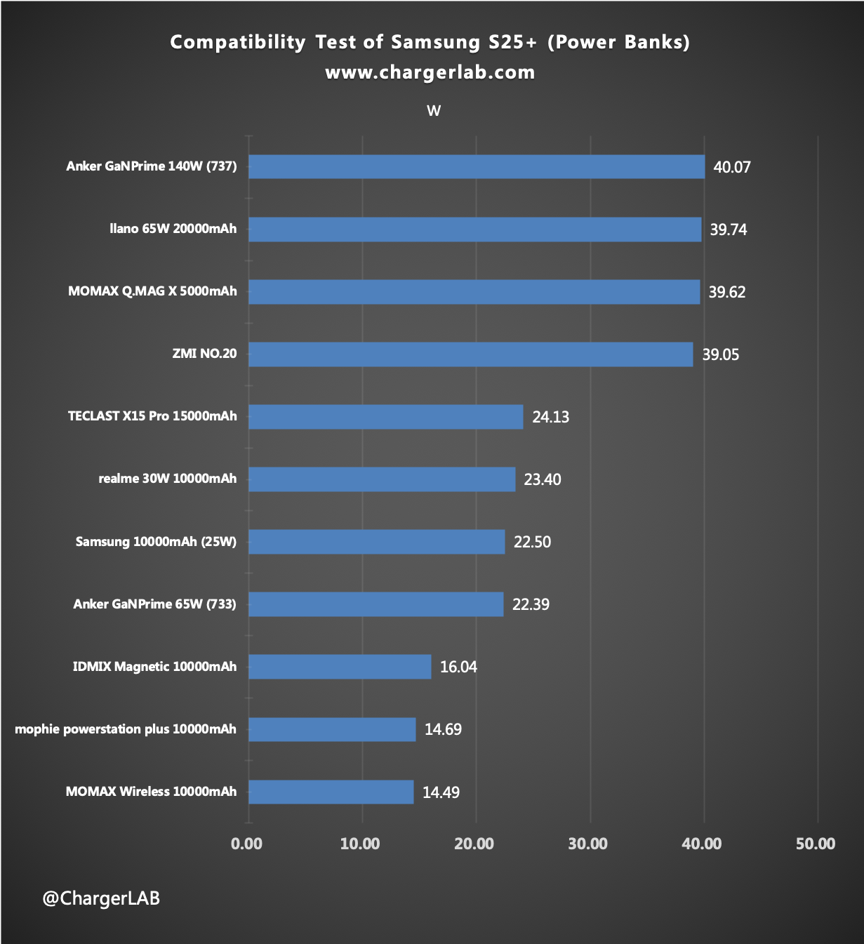

The voltage of most power banks can reach 9V, while those that support high-power PPS can reach 13V, with higher power.
Compiled the test results into a bar chart. There are no compatibility issues. For power banks that support the high-voltage PPS protocol, the power is generally higher, up to around 40W.

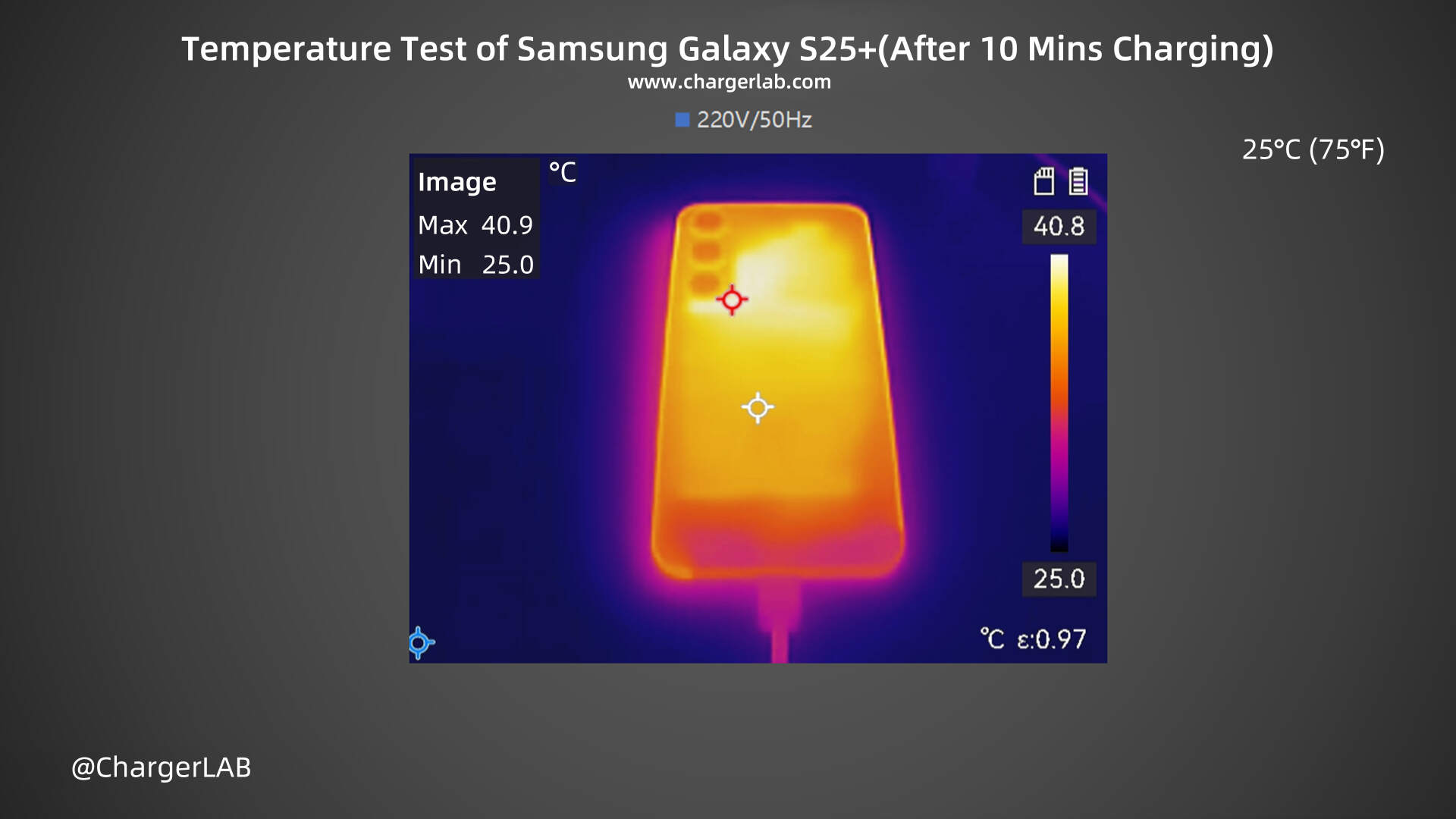

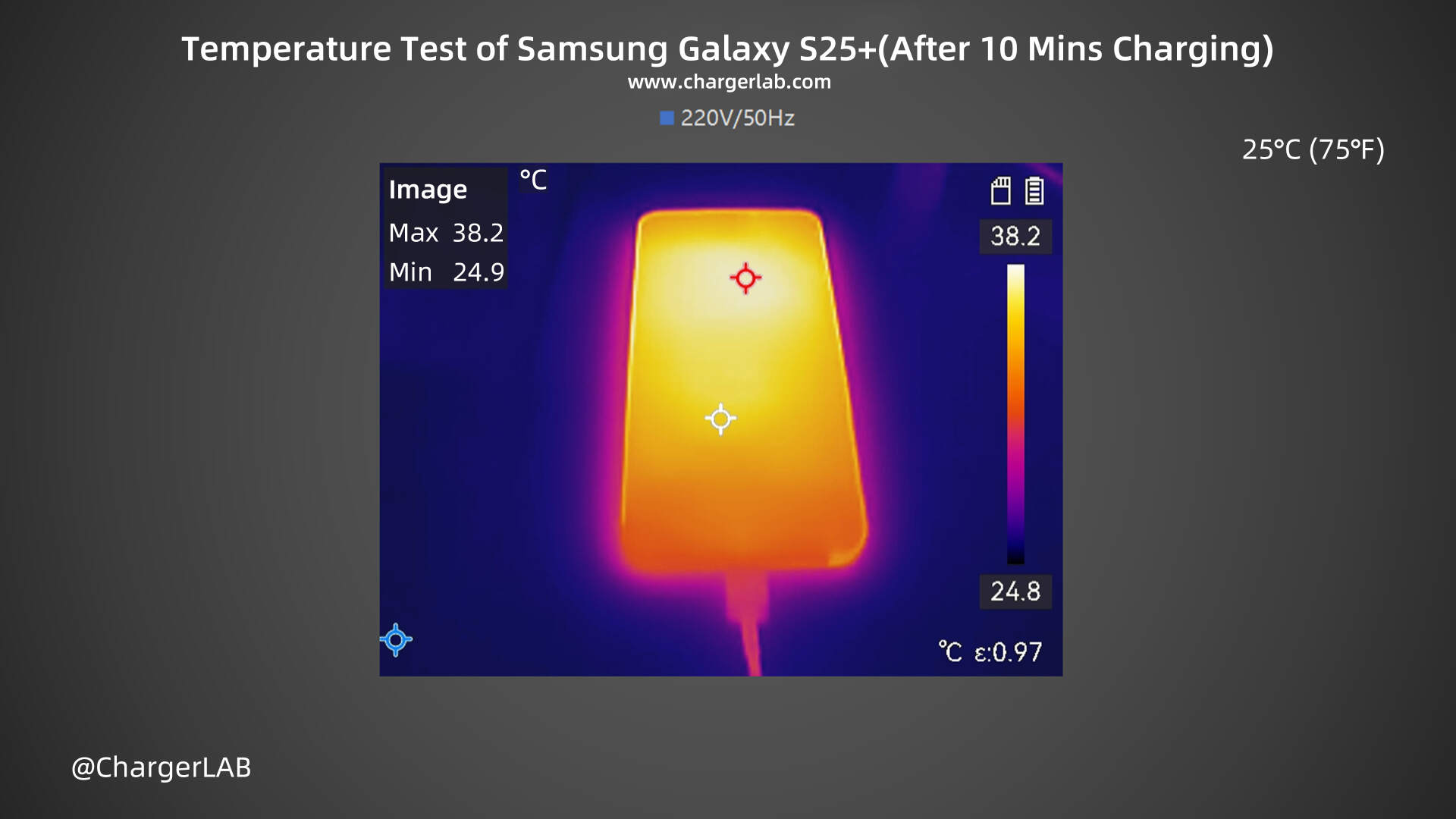

After 10 minutes, the maximum temperature on the front is 38.2℃ (100.76 ℉).
The back is 40.9℃ (105.62 ℉).

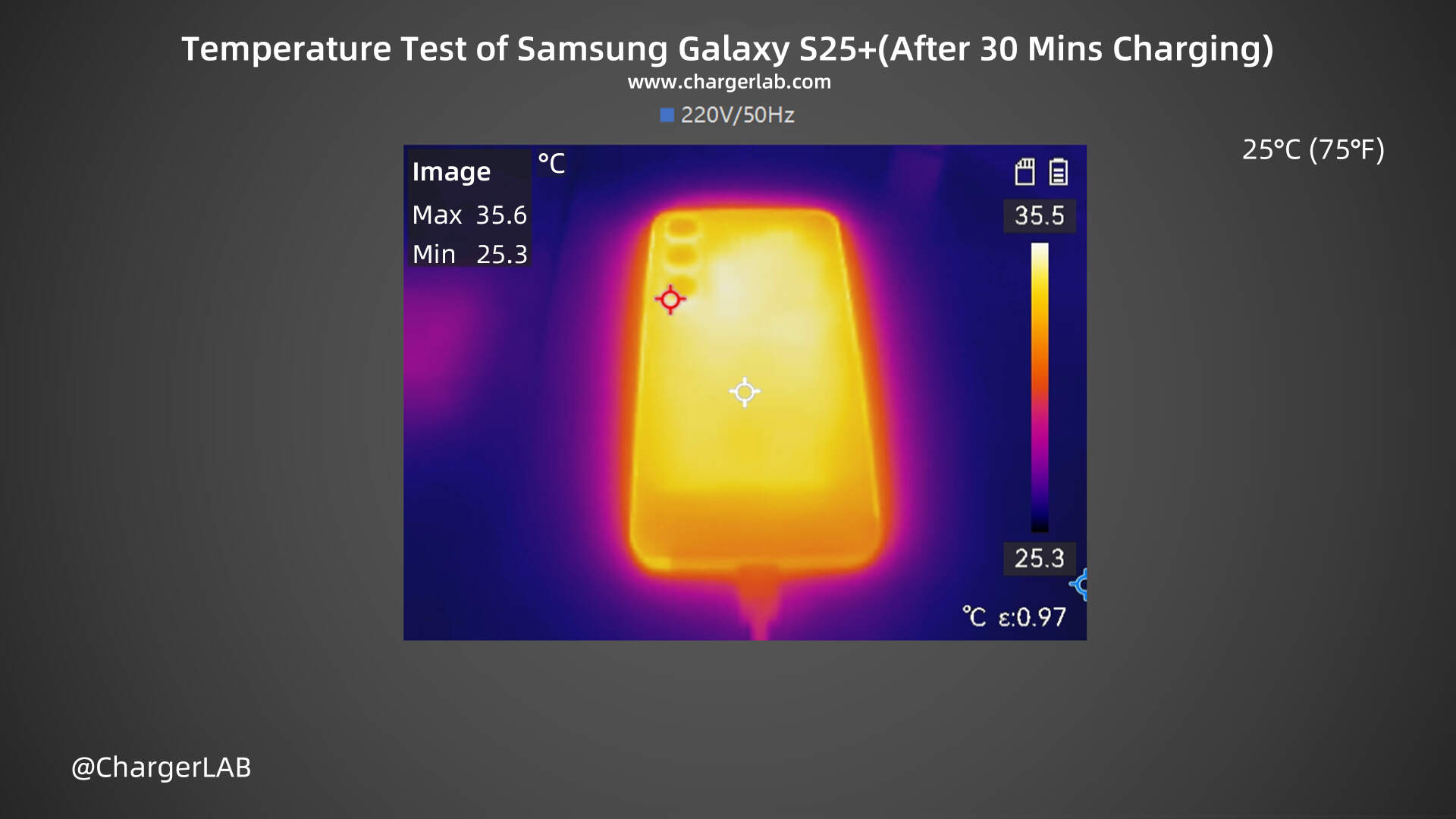

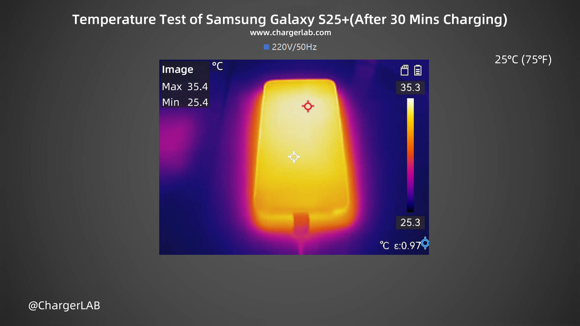

30 minutes Charging
After 30 minutes, the maximum temperature on the front is 35.4℃ (95.72 ℉).
The back is 35.6℃ (96.08 ℉).

We also turn it into a bar chart. During charging, the temperature on the back is slightly higher than that on the front. At the tenth minute, the temperature on the back was the highest, reaching 40.9℃ (105.62 ℉). At the 30th minute, the temperature on the front was only 35.4℃ (95.72 ℉), and the power was about 20W, showing excellent temperature control.
