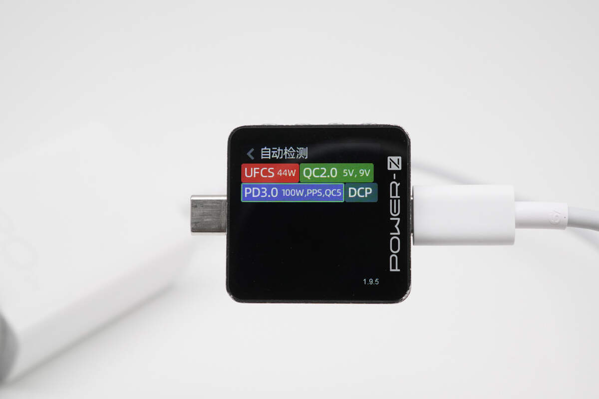

ChargerLAB POWER-Z KM003C shows it supports UFCS, QC2.0, PD3.0, QC5, DCP, and PPS charging protocols.

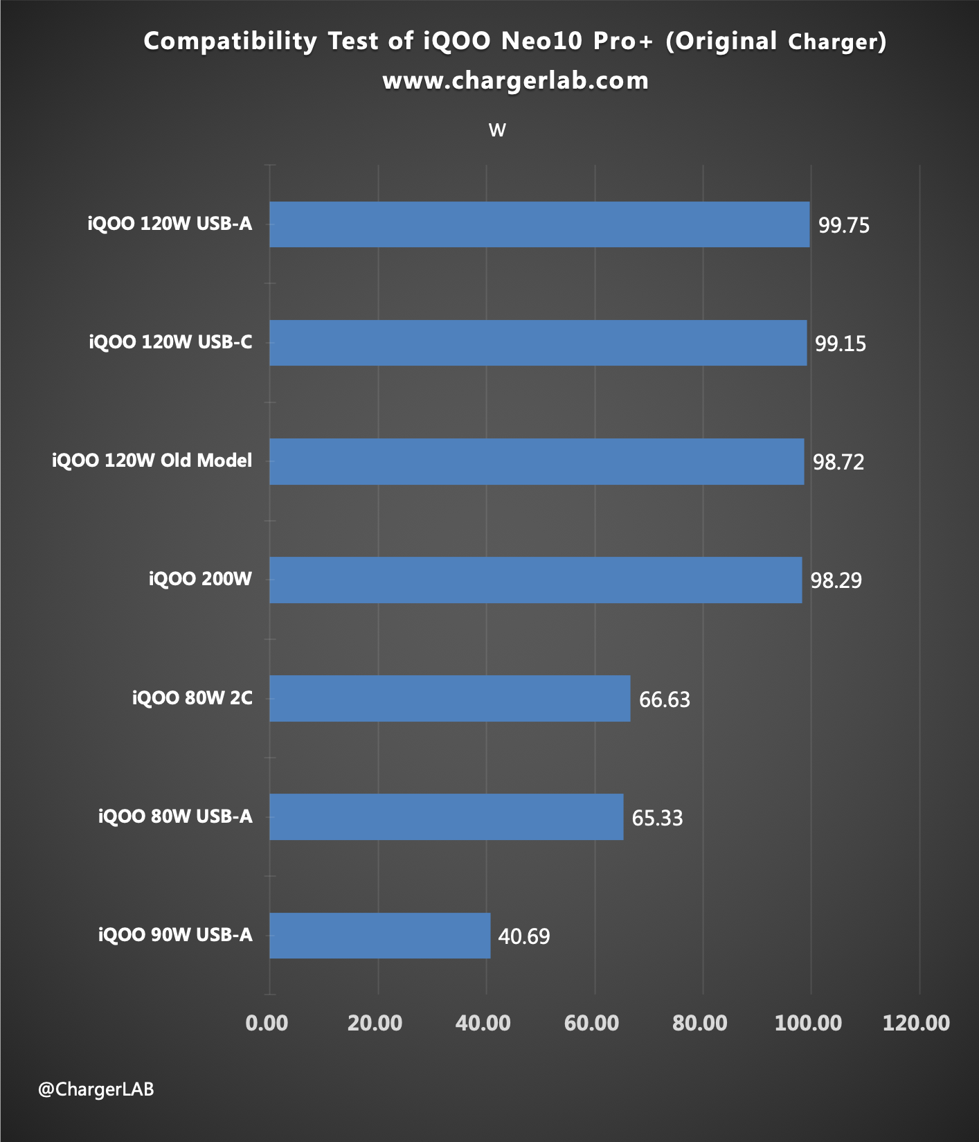

Compatibility Test
Original Chargers
120W + 6800mAh | Charging Review of iQOO Neo10 Pro+-Chargerlab
The voltage of all tested chargers except the 90W charger reaches 17 to 18V.
Summarize all test results into a bar graph. The lowest charging power is 40.69W, and the highest is 99.75W. The four chargers above 120W can reach a power of nearly 100W.

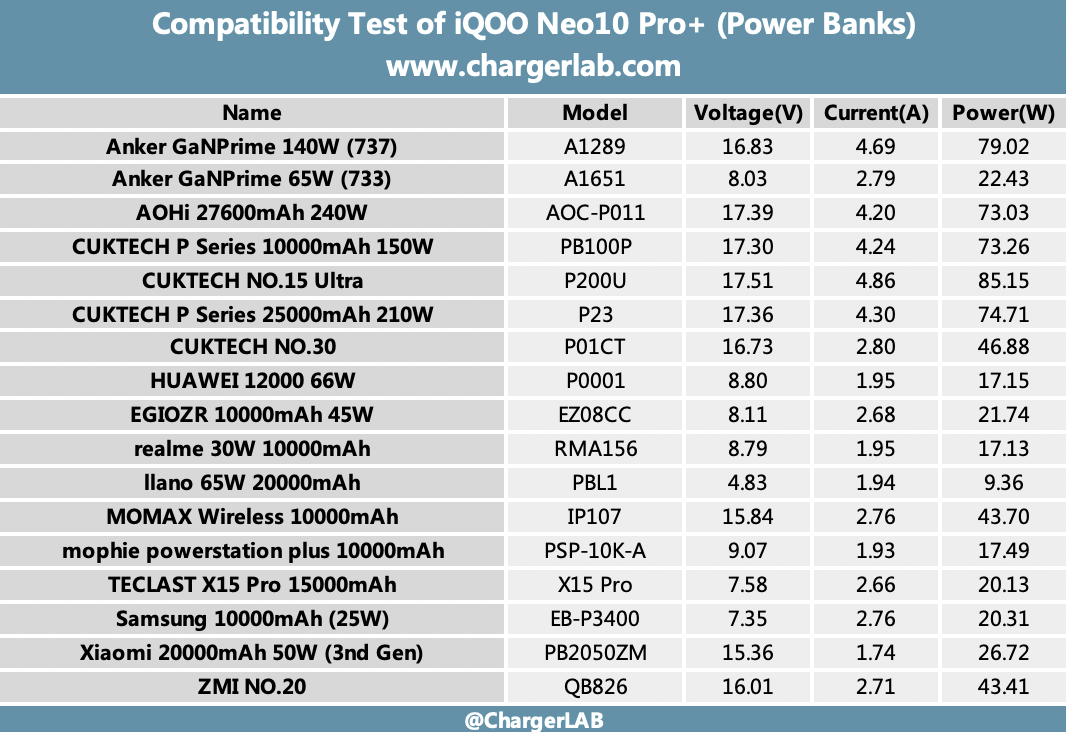

Power Banks
The tested power banks basically reached a voltage of around 9V or 17V, and a current of 1.74 to 4.86A.

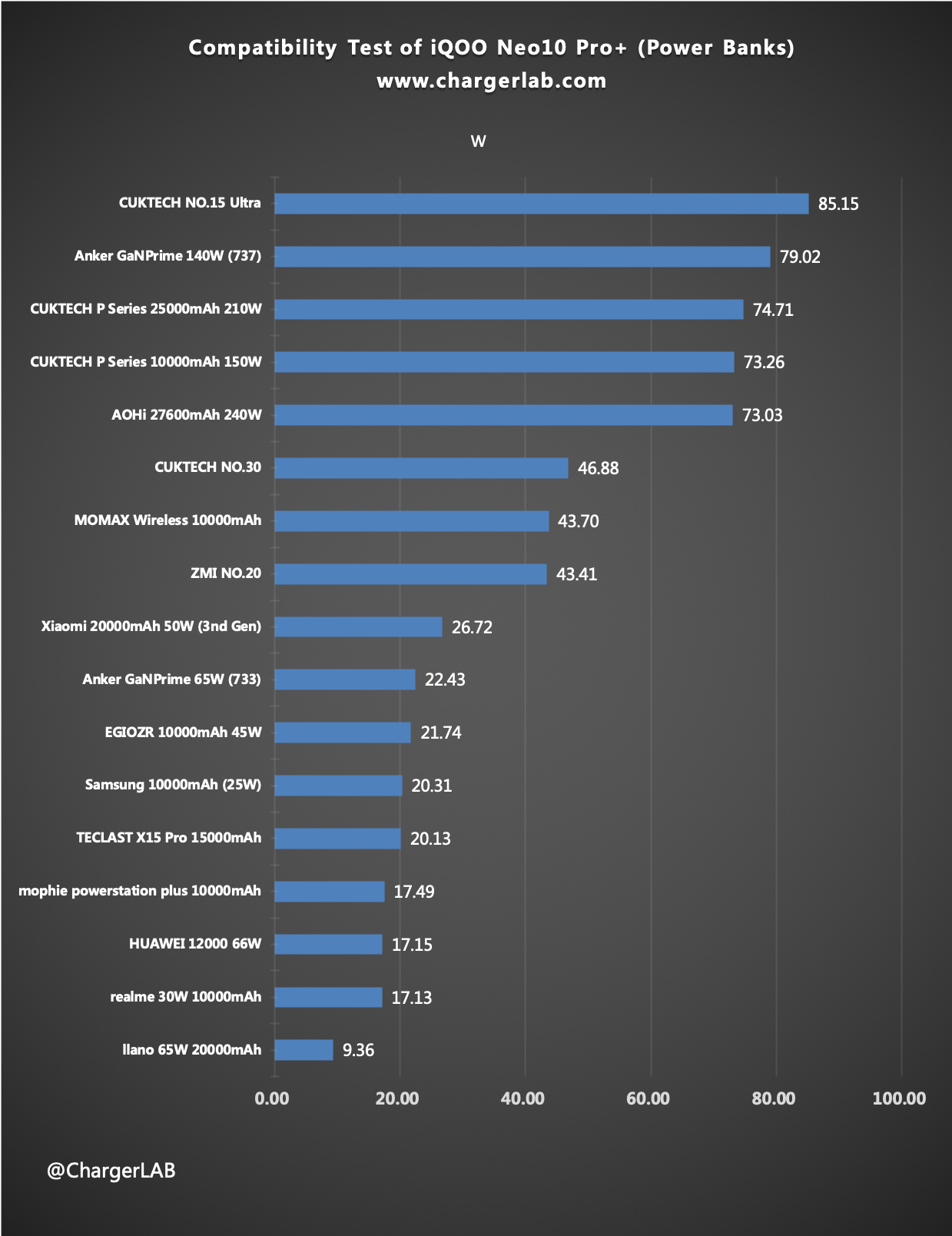

The data is summarized in a bar graph, and there is no compatibility issue. The charging power is mainly concentrated at several levels: 15 to 18W, 20 to 30W, 35 to 50W, and 70 to 85W. The highest charging power is 85.15W.

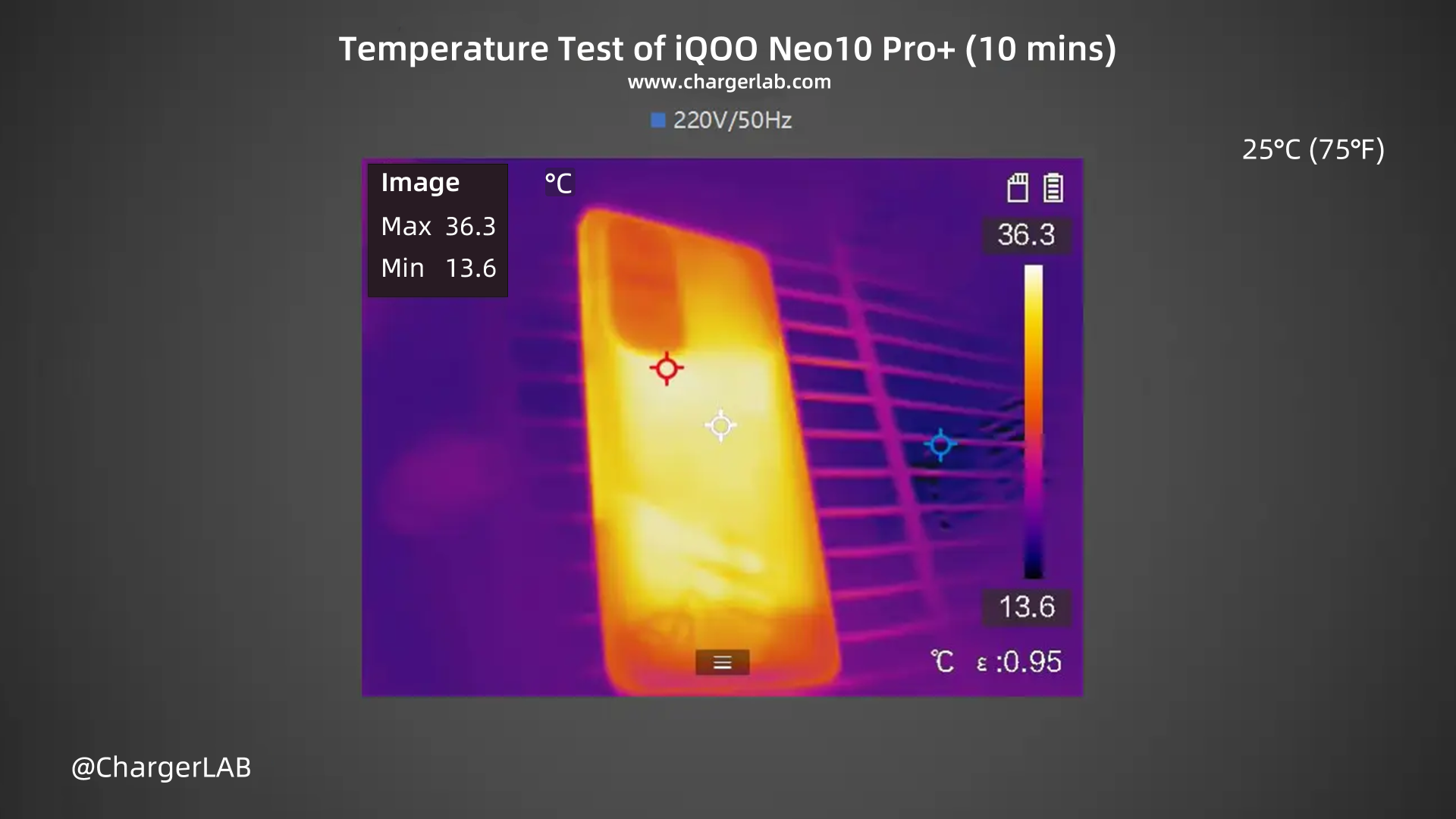

Temperature Test
10 minutes Charging
After 10 minutes, the maximum temperature on the front is 35.9℃ (96.62 ℉).

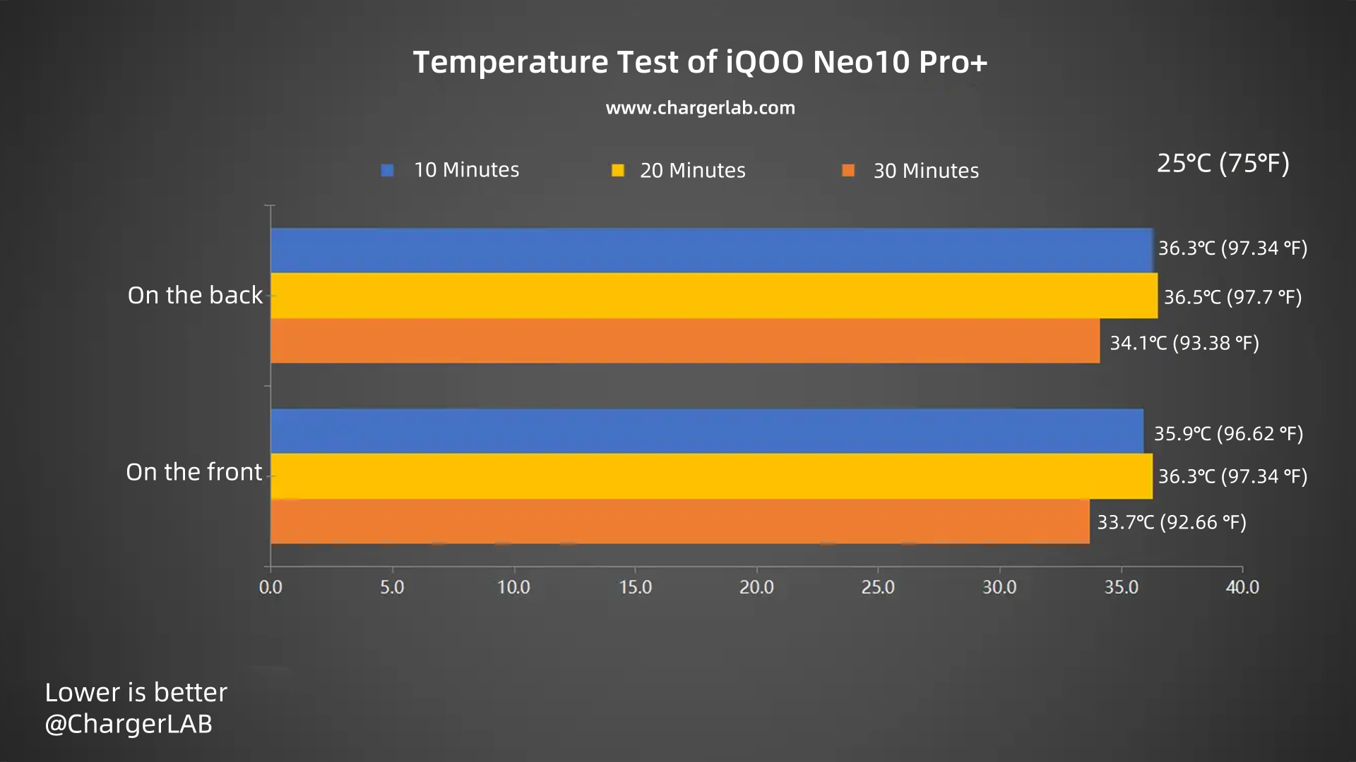

We also turn it into a bar chart. During charging for 30 minutes, the temperature is between 33.7 and 36.5°C. Combined with the power curve, it can be seen that the charging power remains consistently high throughout the process. Overall, the thermal management performs very well.
