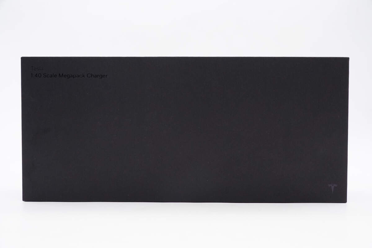

The packaging box is pure black, with the TESLA 1:40 Scale Megapack Charger printed in the upper left corner.
108W 21000mAh | Teardown of TESLA 1:40 Scale Megapack Charger (TSL03)-Chargerlab
The Tesla logo is printed in the lower right corner.

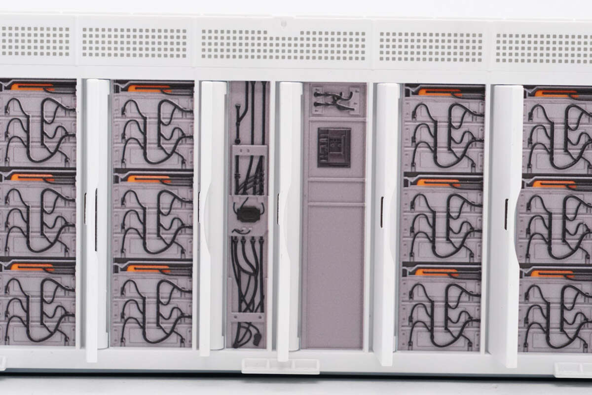

All service access panels are movable components, revealing intricately detailed replicas of internal battery packs and wiring once opened, showcasing impressive craftsmanship and attention to detail.
The interior details have also been reproduced.

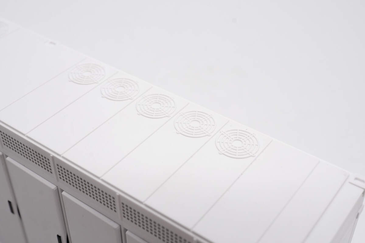

The multiple cooling fans on the top deeply restore the Megapack.

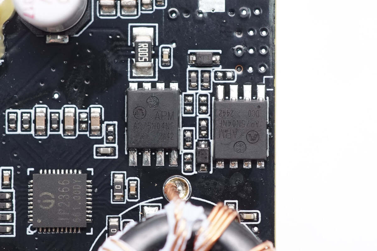

The four synchronous buck-boost MOSFETs are from APM. Model is AP75N04NF.
The other two synchronous buck-boost MOSFETs are of the same model.
