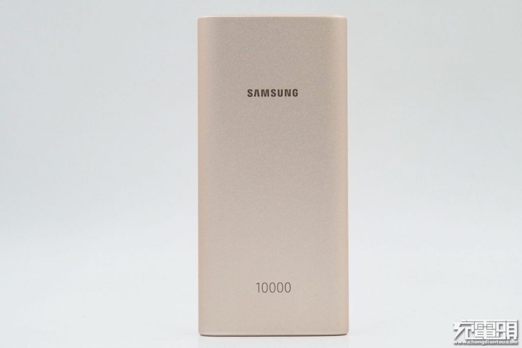

Our unit comes in pink, which actually has a champagne hue. It is made from an aluminum block with a matte finish which gives a premium hand-feel. Its wireless charging area is made from polycarbonate with a rubberized surface to avoid slipping. A circle in the center indicates the position of the wireless charging coils underneath.

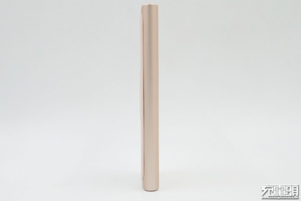

Curved sides offer great hand-feel.

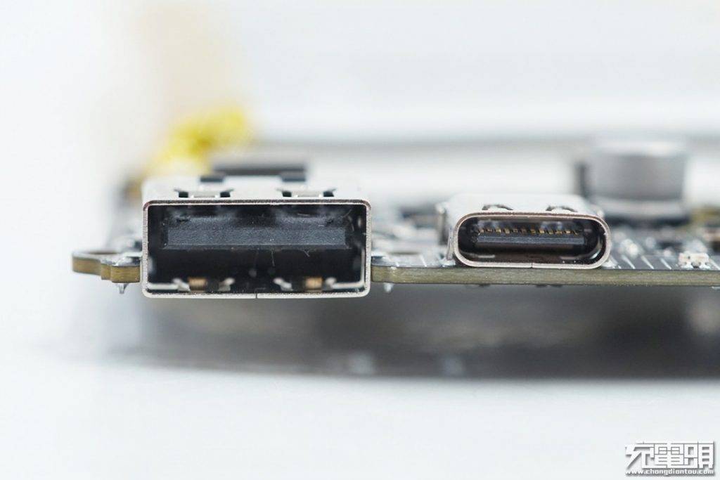

From left to right: USB-A output port, USB-C input port, status indicator, 4 battery level indicator LEDs, power button.When the power bank is turned on, the status indicator flashes once in the order of red, green, and yellow. When the wireless charging is turned on, the status indicator lights red.

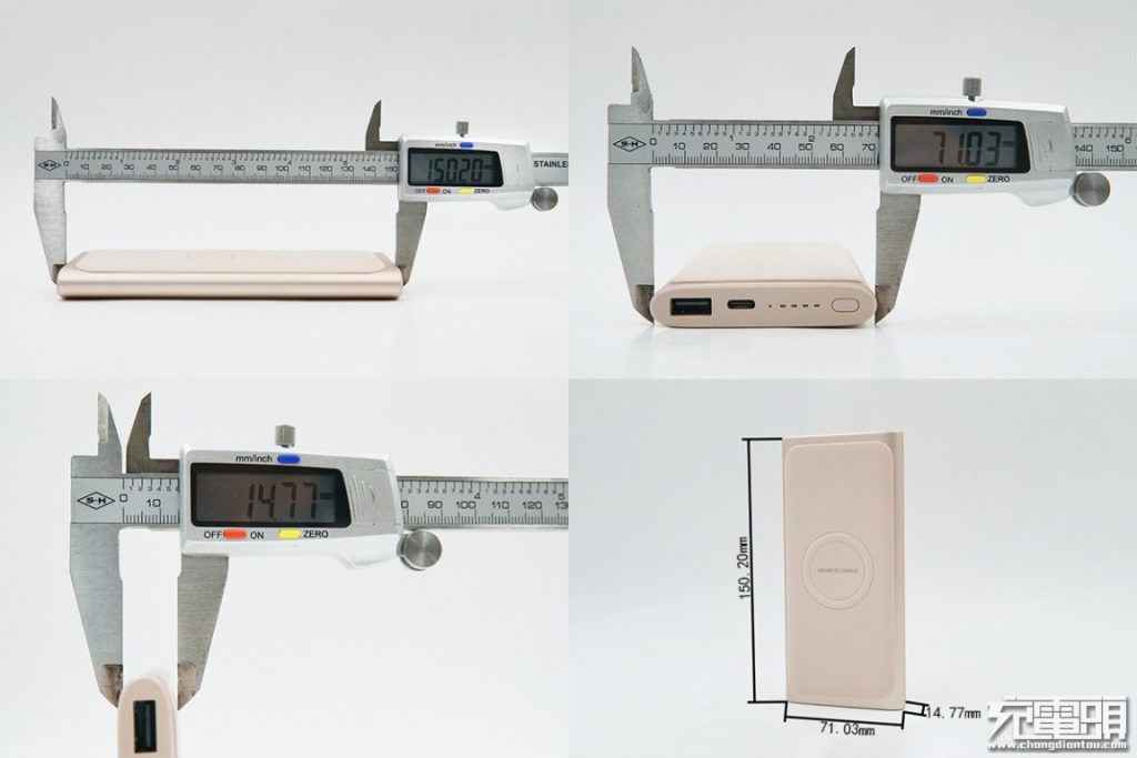

Dimensions: 150.20mm (5.91in)*71.03mm (2.80in)*14.77mm (0.58in).

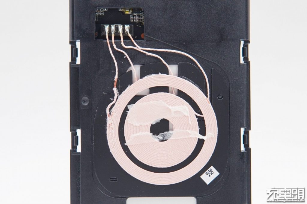

Remove the wireless panel, we can see two coils underneath.

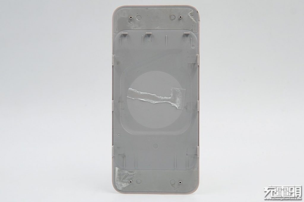

Samsung Wireless Charger Portable Battery (EB-U1200) Teardown Review-Chargerlab
The polycarbonate plate is glued to the metal body.

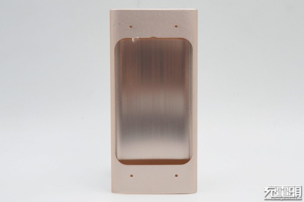

The aluminum unibody.
4 wires for 2 coils.

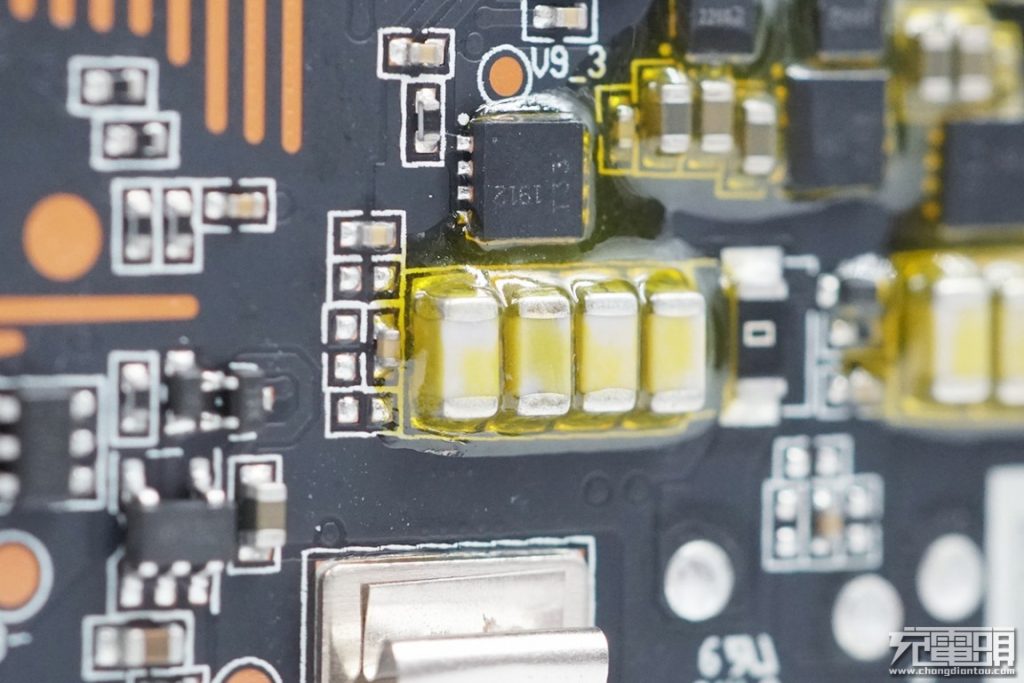

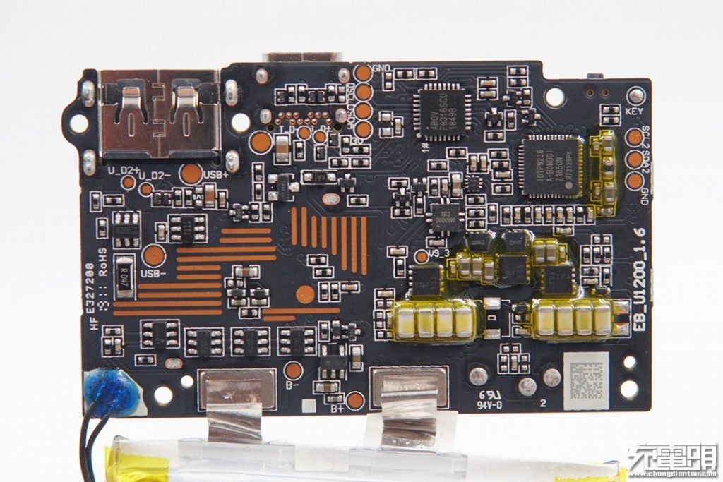

On the back of the board, there are exposed copper pins on the left side to assist heat dissipation, and capacitors and the driving components on the right side are glued.
There are a boost inductor and filter capacitor on the front, 4 battery level indicator LEDs and a wireless charging indicator, and a shield.

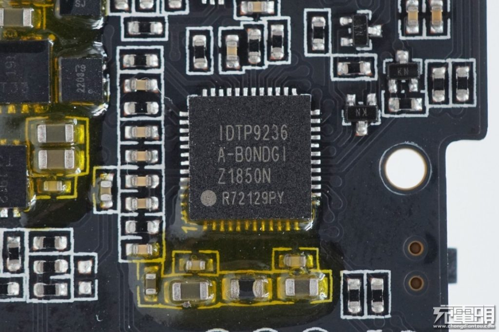

IDT IDTP9236 wireless charging controller, paired with external drive tube for wireless charging.

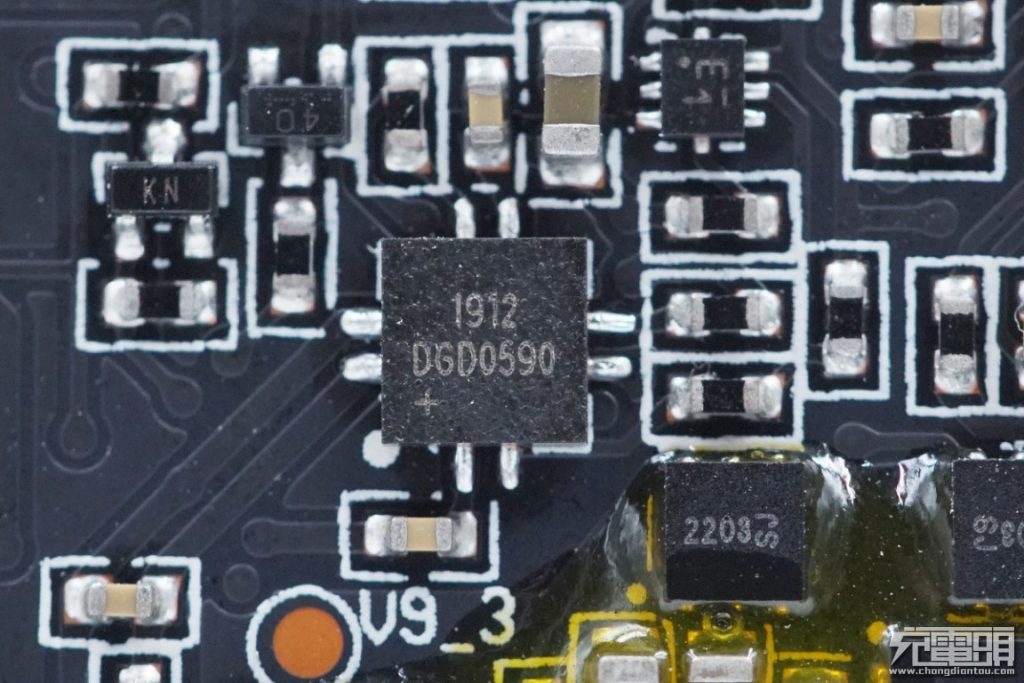

DIODES DGD0590 High-frequency high-low side gate half-bridge driver with minimal external components for wireless charger, motor drive, and logic level mos driver.
Detailed specification of the DIODES DGD0590.

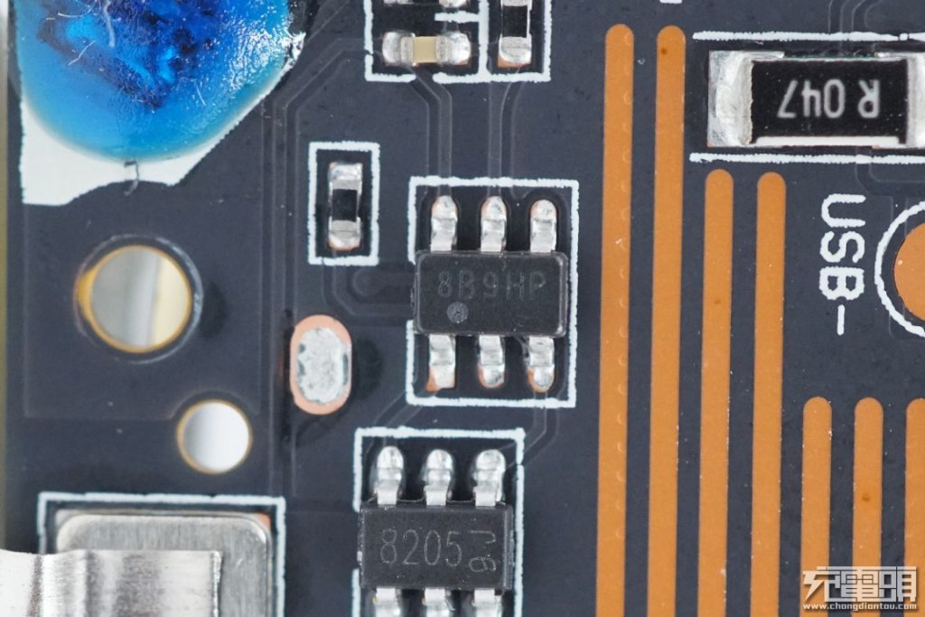

Lithium battery protection circuit with multiple 8205 in parallel.
Battery protection IC.

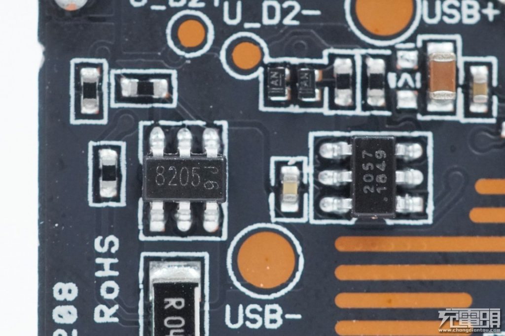

The 8205 and rs2057 switch responsible for turning off the output.

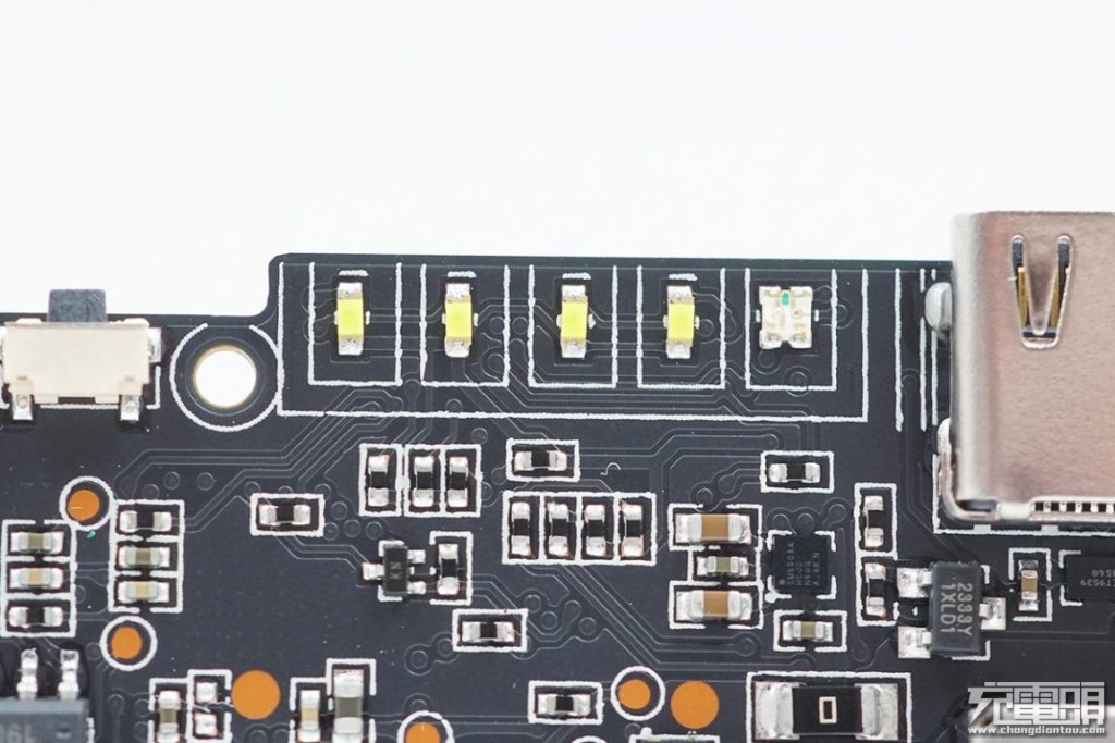

Battery indicator and tri-color LED wireless charging indicator.

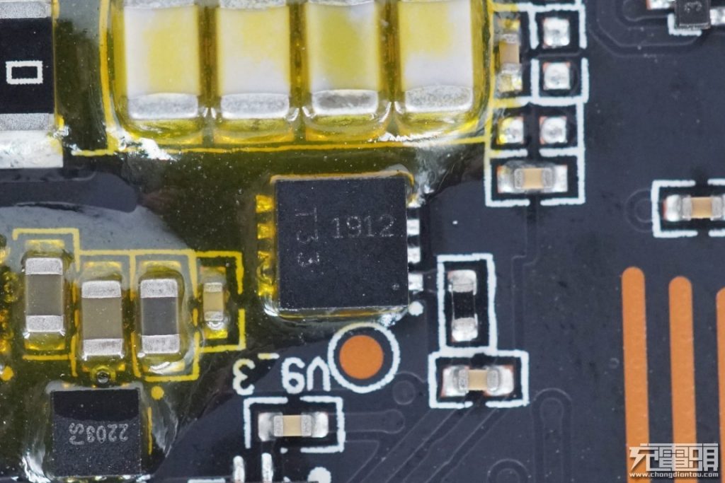

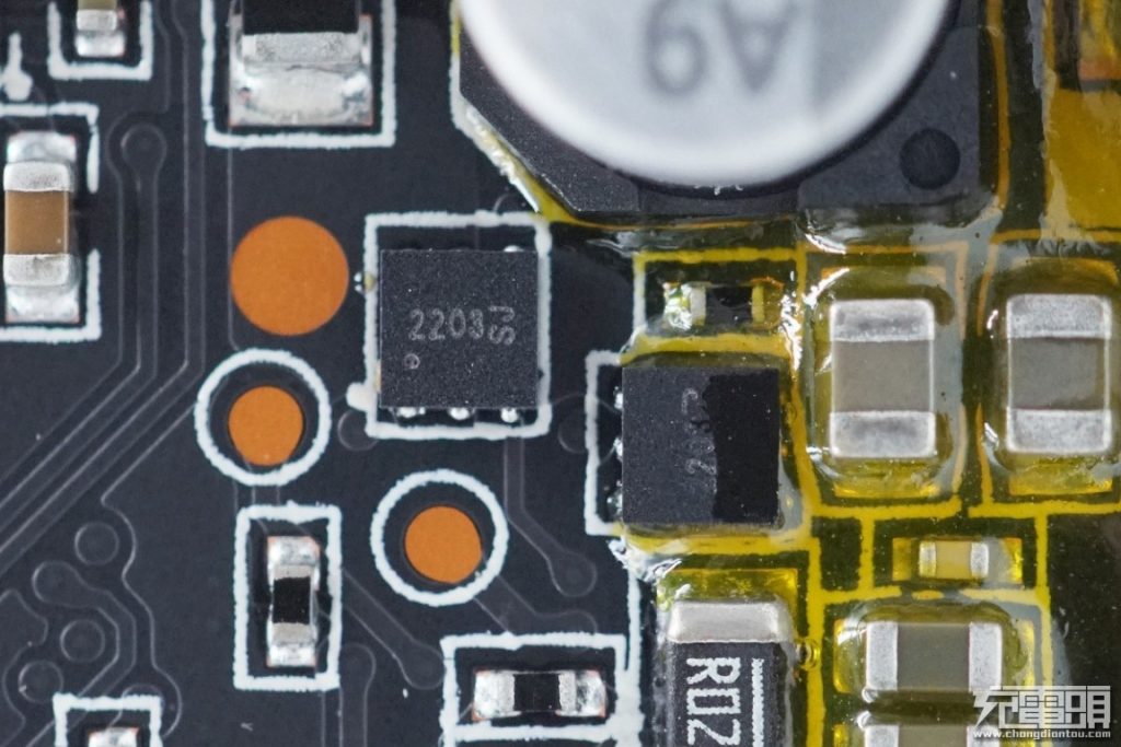

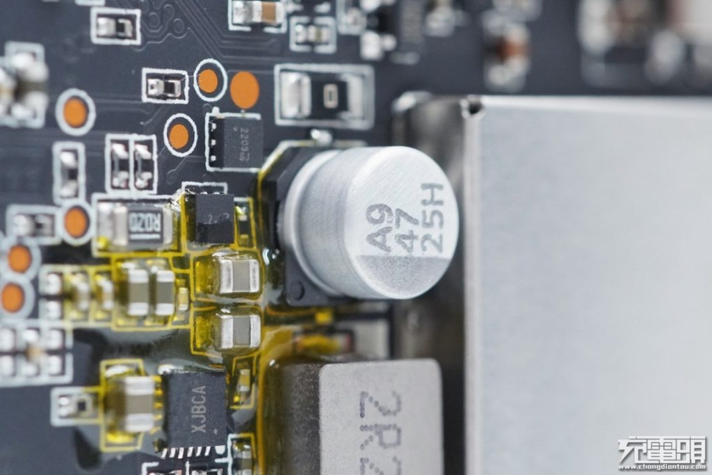

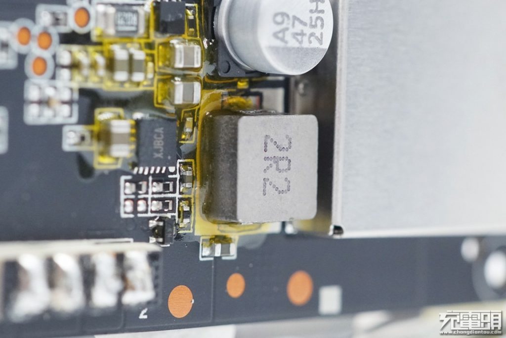

Boost IC from Silergy with XJBCA lettering.
Boost output filter capacitor, 47μF, 25V.
The 2R2 boost inductor boosts the battery voltage for wireless charging.

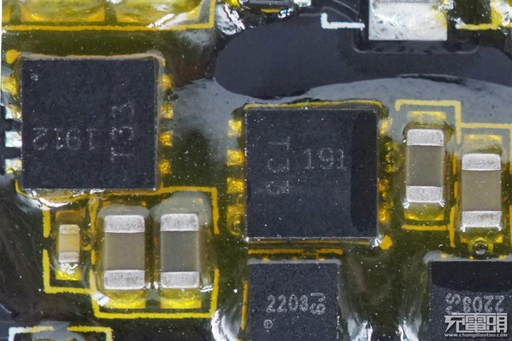

Inside the shield is a step-up and step-down circuit of the power bank, and on the left side of the shield is the boost circuit for wireless charging.
The Southchip SC8943 buck-boost IC is responsible for charging and discharging of the power bank.

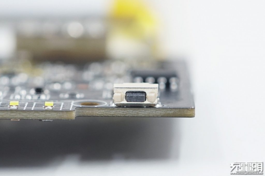

The power and battery activation button.

USB-A output port.
