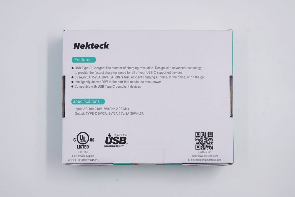

Specifications on the bottom.
Input: 100V-240V/AC, 50/60Hz
Output: Type-C PD 90W Max
USB-C PD Port :5V/3A,9V/3A,15V/3A,20V/4.5A
Dimensions: 3.34 x 3.34 x 1.18 inch
Cable Length: 6ft/2m

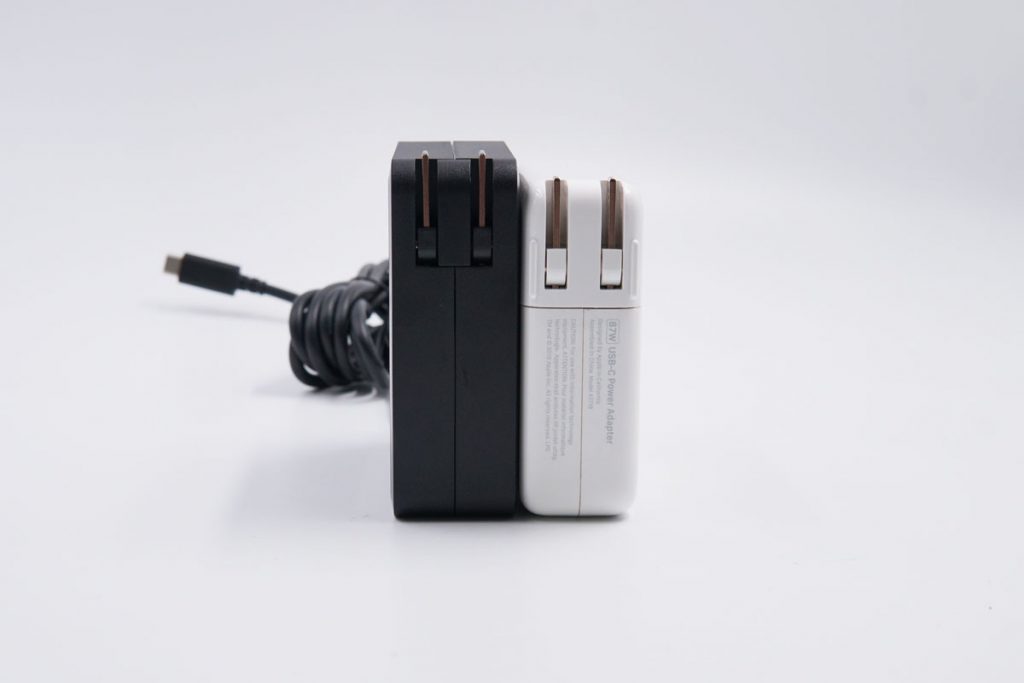

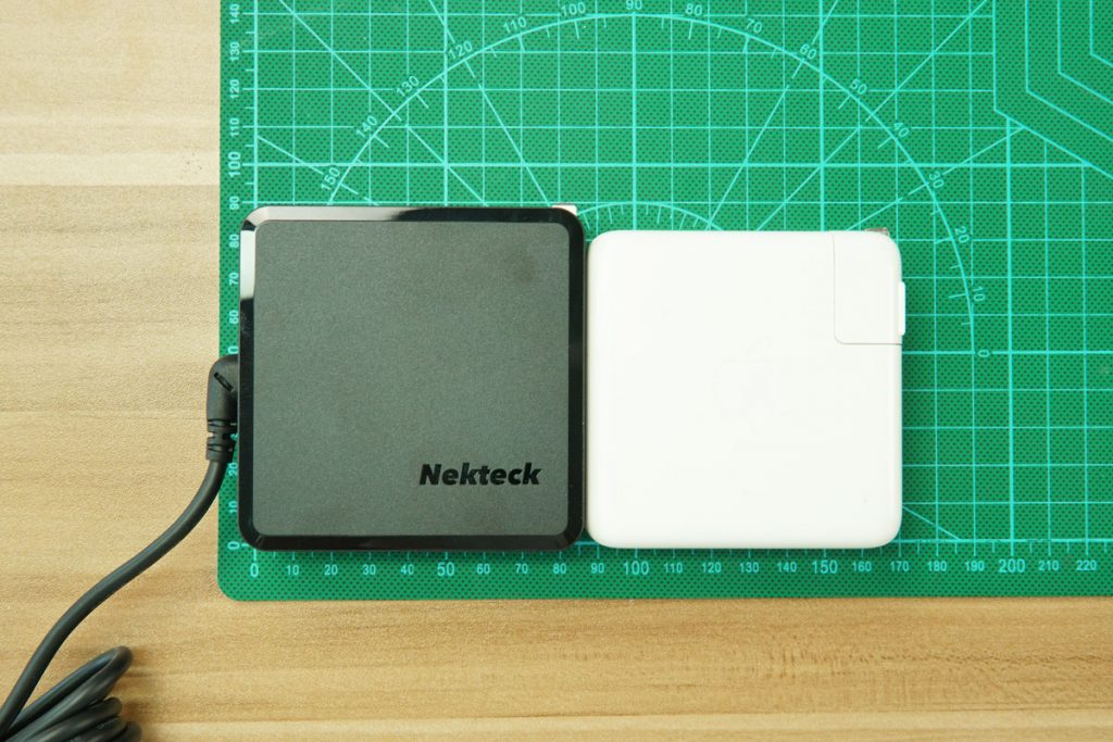

Size comparison with the Apple 87W PD charger.
Nekteck 90W PD Charger with Built-in Cable Quick Review-Chargerlab

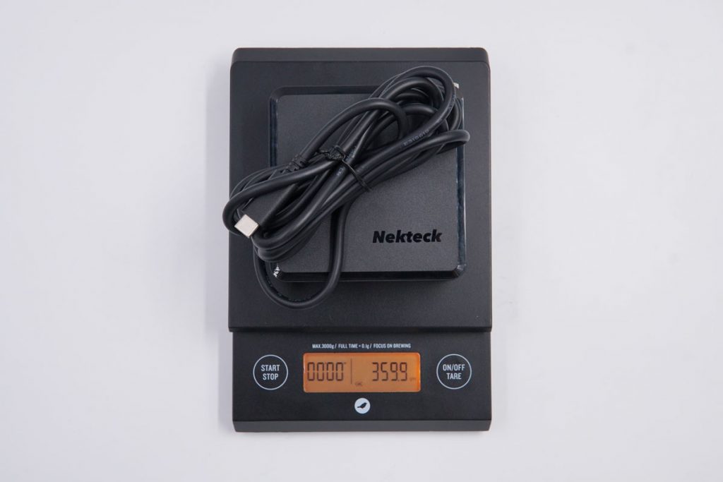

It weighs 359.9g. For comparison, the Apple 87W PD charger (US prongs) weighs 295.7g.

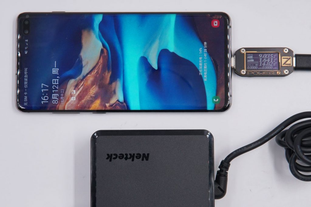

Charging the Samsung Galaxy S10+, we are getting 9.04V 1.64A 14.83W, under PD protocol.

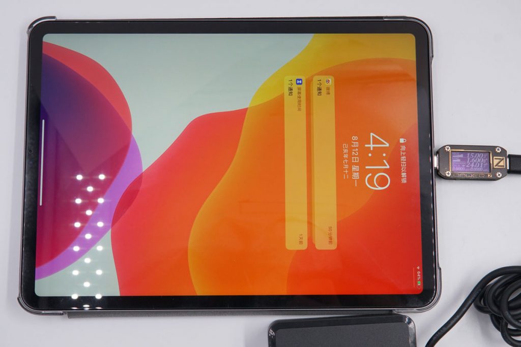

Charging the iPad Pro 11-inch, we are getting 15.0V 1.60A 24.02W, under PD protocol.

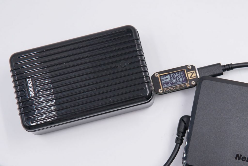

Charging the Zendure SuperTank 100W PD Power Bank which is capable of 100W input/output, we are getting 19.65V 4.53A 88.99W, under PD protocol.

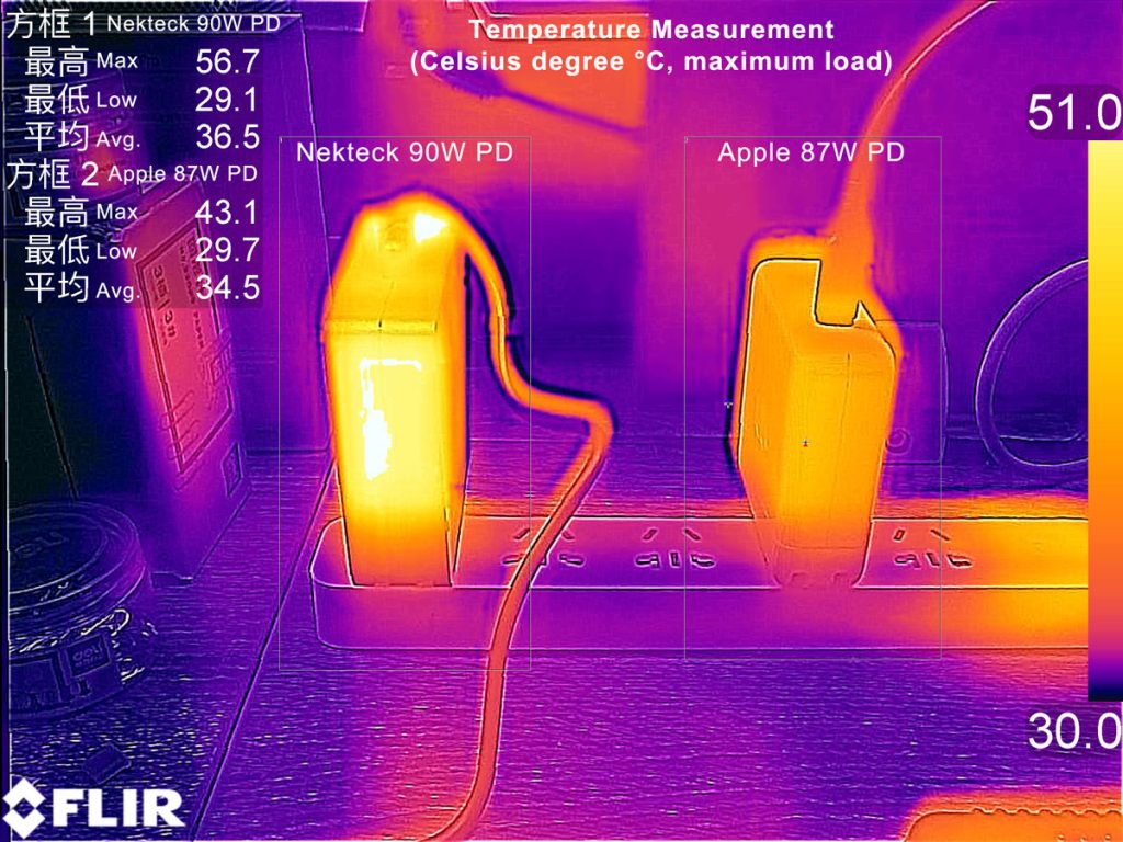

3. Heating Test
It gets hotter than the Apple 87W PD charger, but within an acceptable range.
