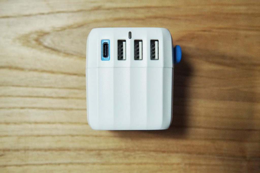

Our exclusive look at the upcoming Zendure Passport GO GaN (engineering sample). It features a USB-C PD (Power Delivery) port in addition to three USB-A ports. With an auto-resetting fuse and 30W USB PD fast charging powered by GaN technology, it is the most advanced global travel adapter. You can grab it now on Kickstarter for $39 (retail $59).
I Hands-on
Our exclusive hands-on video.
Zendure Passport GO GaN Hands-on Review: The Ultimate Global Travel Adapter-Chargerlab

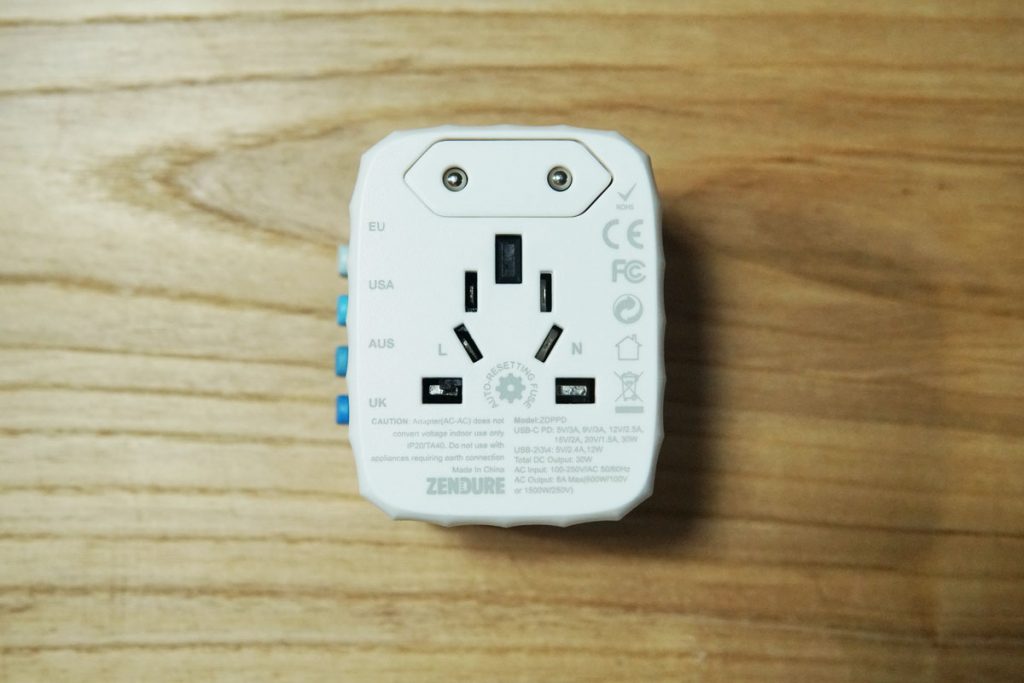

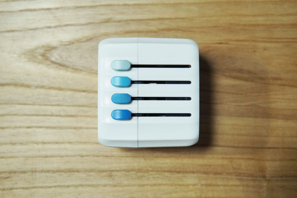

Simply push and slide the buttons.
One USB-C port which supports 20V 1.5A 30W max charging, and three USB-A ports that each support 5V 2.4A 12W max charging.

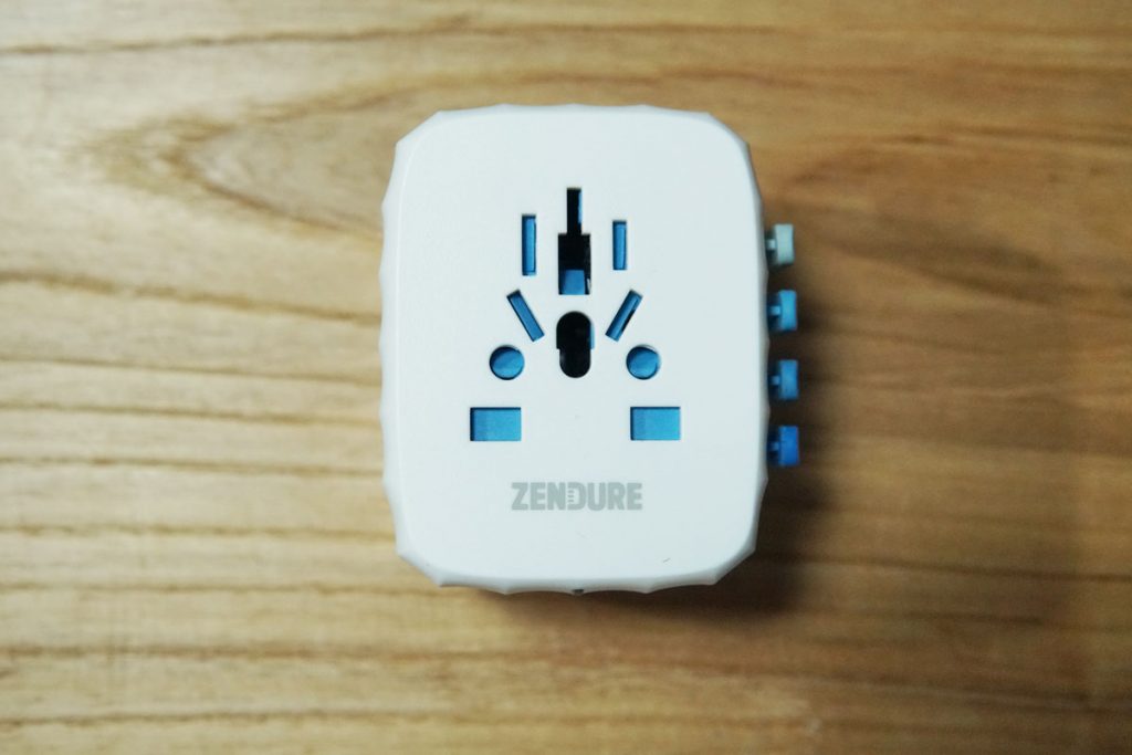

It has auto auto-resetting fuse built-in, and plugs work in more than 200 countries and regions.
The Passport GO GaN can accept type A, B, C, E, F, G, I, J, K, L and N plugs with its universal socket.

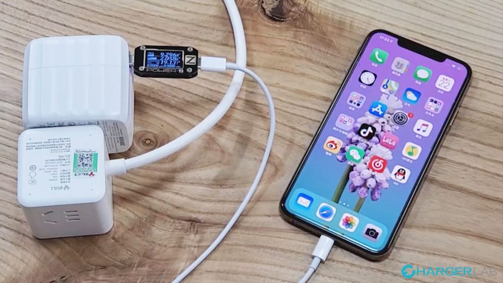

The USB-C port is charging the iPhone XS Max at 9.30V 2.06A 19.13W, under USB PD fast charging protocol.

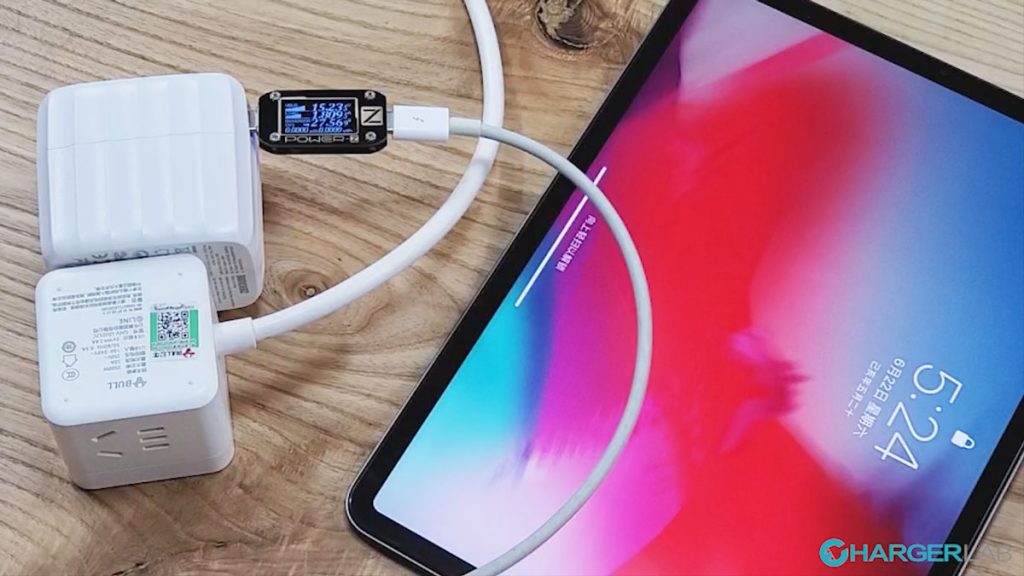

The USB-C port is charging the iPad Pro 2019 11-inch at 15.23V 1.81A 27.56W, under USB PD fast charging protocol.

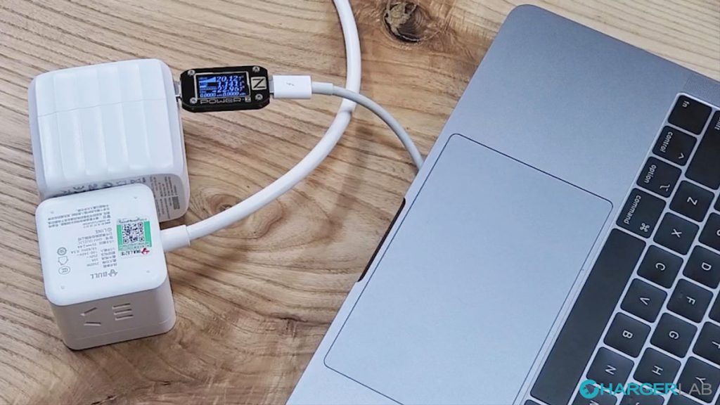

The USB-C port is charging the MacBook Pro 13.3-inch at 20.12V 1.14A 22.96W, under USB PD fast charging protocol.

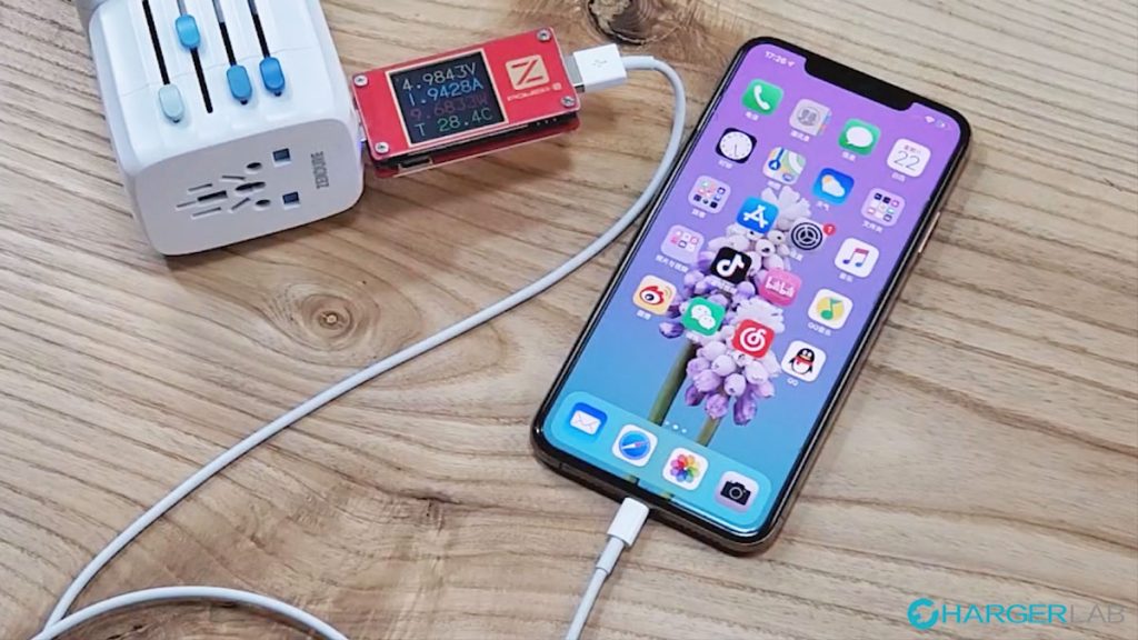

The USB-A port is charging the iPhone XS Max at 4.98V 1.94A 9.68W, under Apple 2.4A protocol.

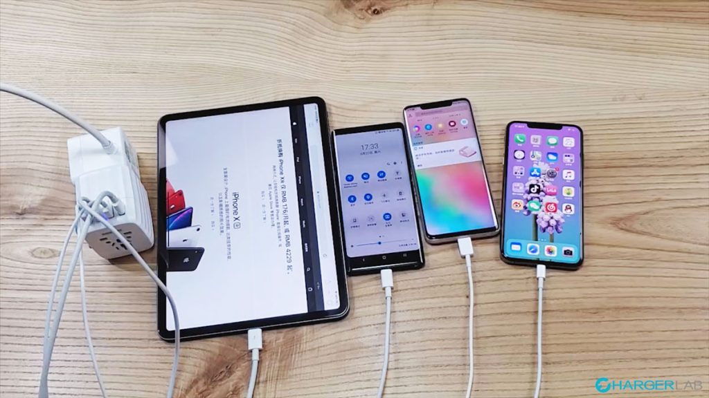

It can charge four devices at the same time.
