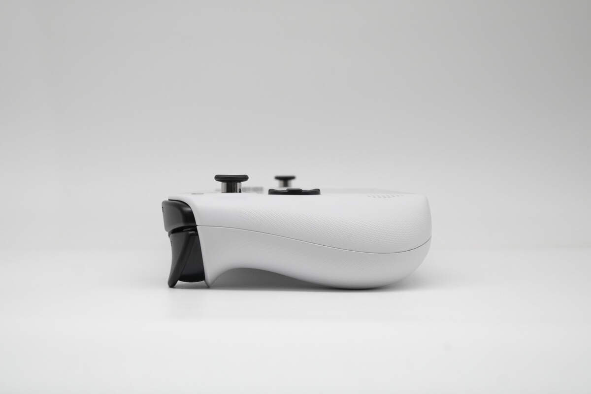

The Lenovo Legion Go S abandons the detachable controller design seen in the Legion Go, which is similar to the Switch, and instead adopts an integrated design. Its corners are rounded, and the overall lines are smooth, ensuring that extended use does not result in discomfort.
Teardown of Lenovo Legion Go S Gaming Console-Chargerlab

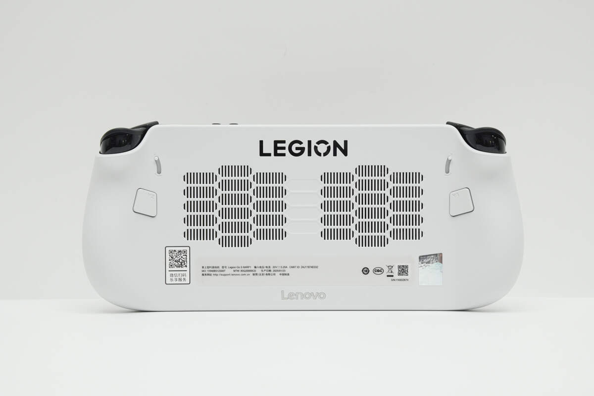

In Beast Mode, airflow is increased by 68%, effectively reducing the device’s temperature and ensuring stability during high-performance gaming. In Silent Mode, noise levels drop as low as 25dB(A), allowing for quiet gameplay even late at night without disturbing others.

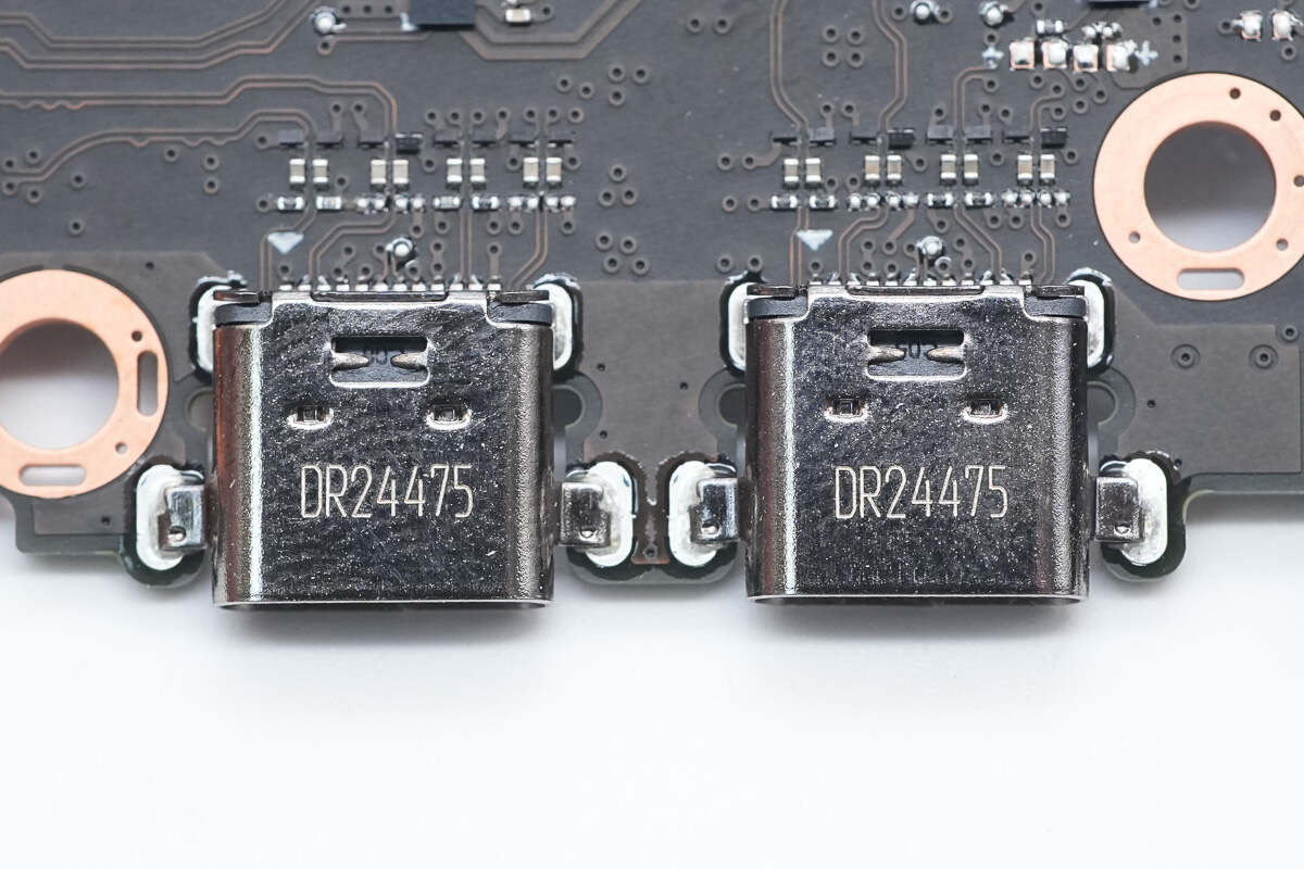

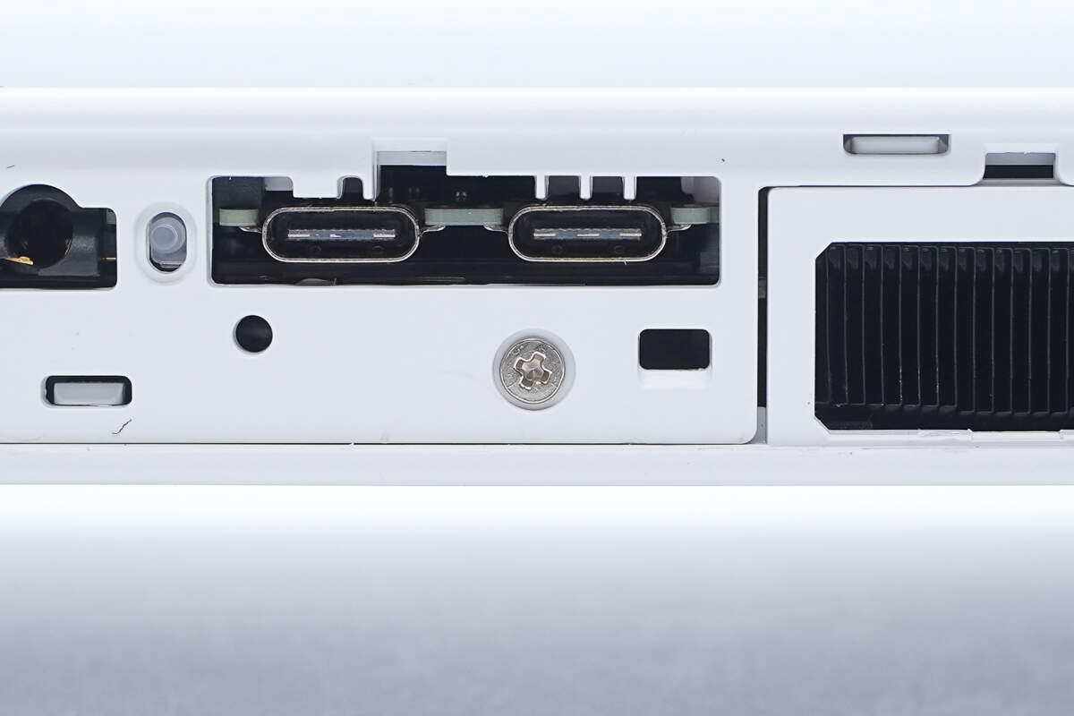

It is equipped with two USB-C ports on the top, both conforming to the USB4 standard. These ports support PD 100W charging, 4K 120Hz video output, and data transfer rates of up to 40 Gbps.

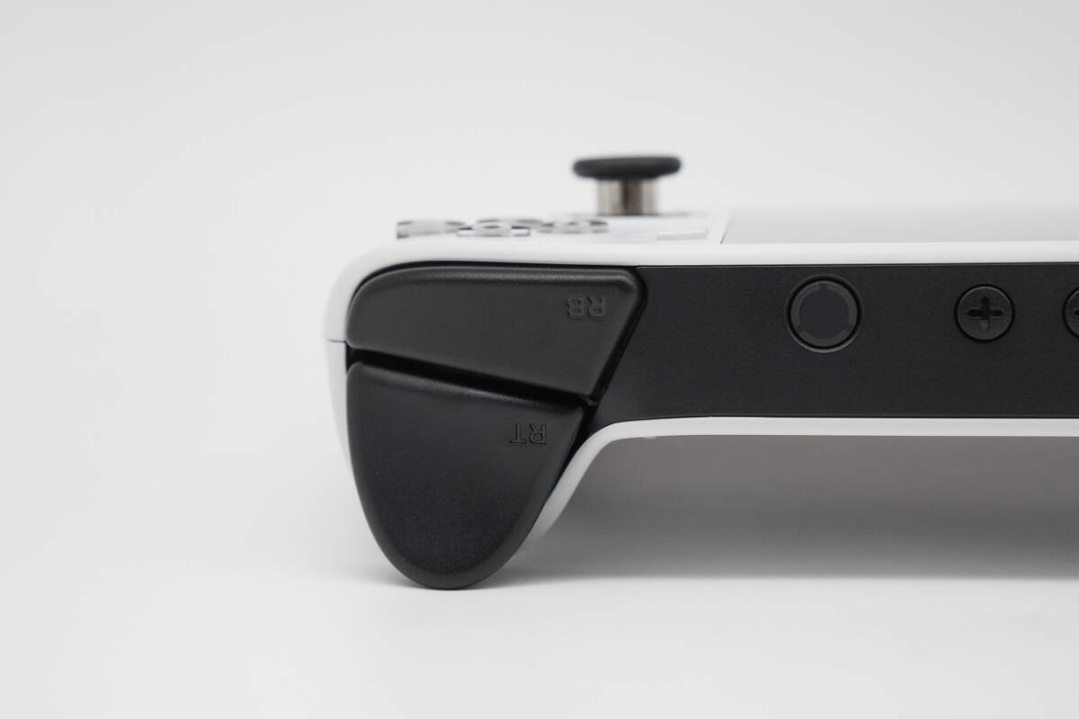

Both sides of the top feature adjustable two-stage Hall trigger designs. The pressure and damping feel are highly responsive, allowing for more precise control during gameplay.

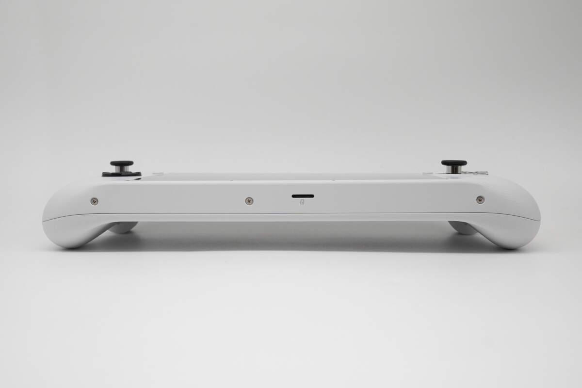

The bottom features an SD card slot with a maximum capacity of 2TB, and it also supports 2280 NVMe SSD expansion.
The overall design follows an ergonomic structure, with the thicker handles providing a fuller, more comfortable grip.

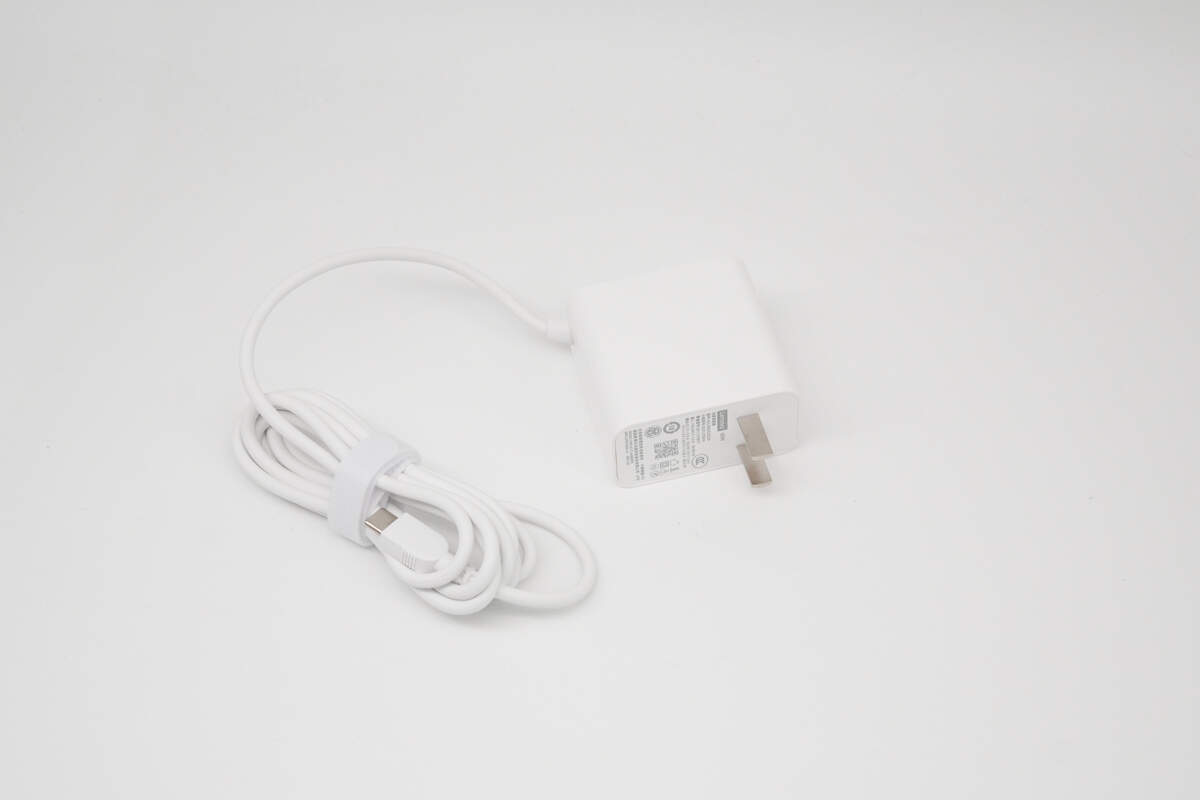

It comes with a 65W adapter with an integrated USB-C cable and a fine-grained frosted surface for a delicate touch.
The weight is about 175 g (6.17 oz)
Model: ADLX65UCGC2A
Input: 100-240V-1.8A 50-60 Hz
Output: 5.0V3.0A 15.0W / 9V3A / 15V3A / 20.0V3.25A 65.0W
It has passed CCC, VI-level energy efficiency, and other certifications.
The length of the cable is about 176 cm (69.29 inches).

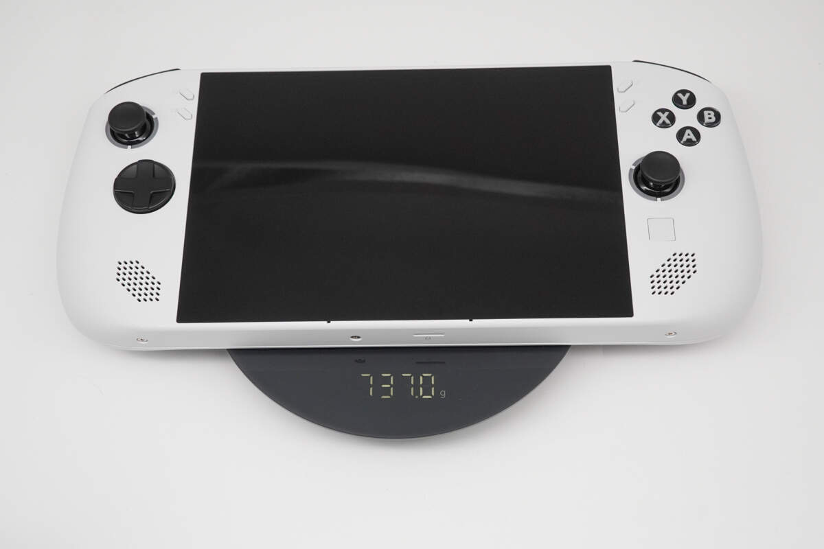

The weight of the gaming console is about 737 g (26 oz).

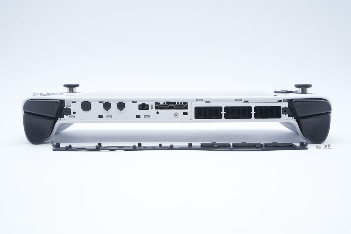

First, pry off the top cover.
This is the screw that holds the case in place.

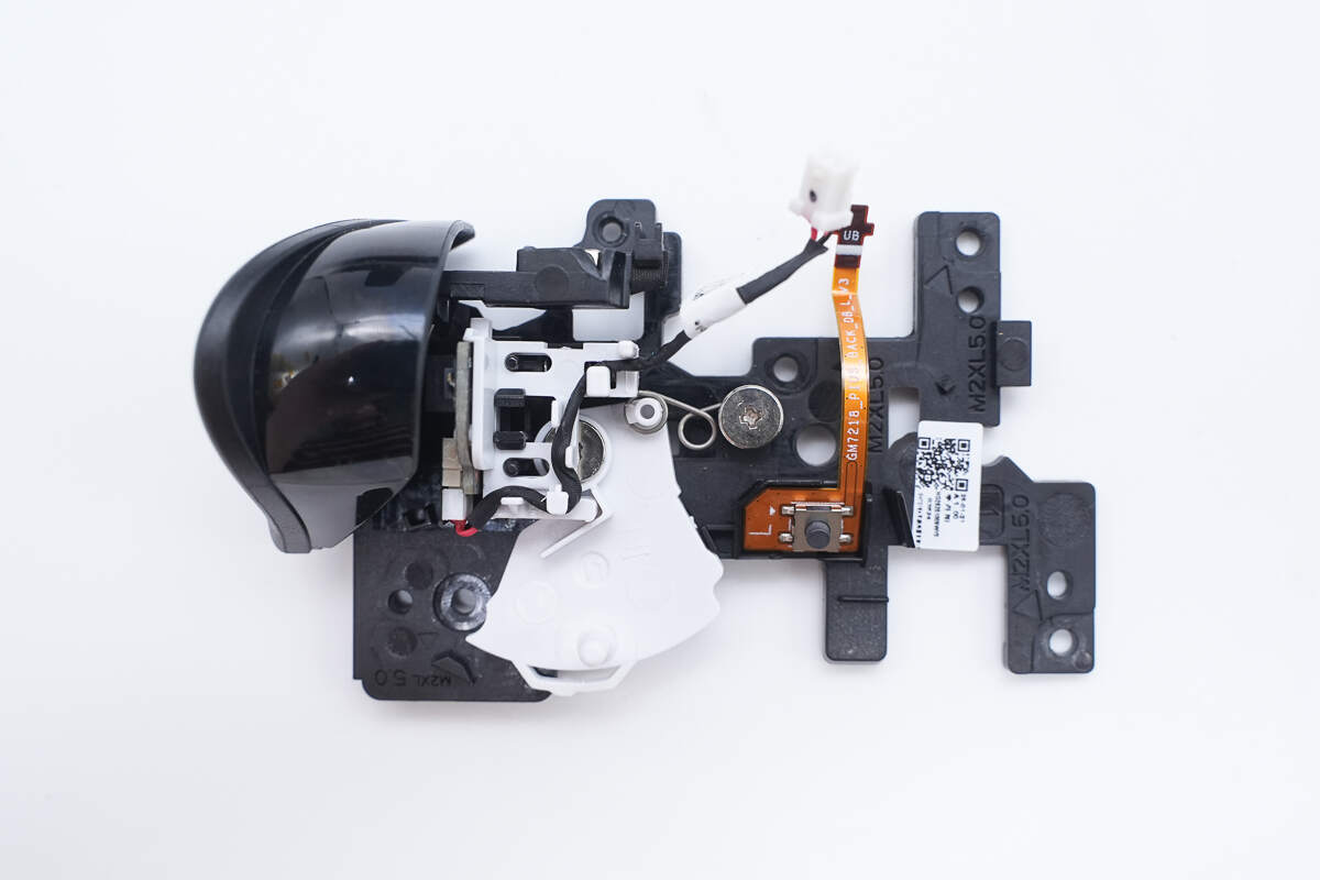

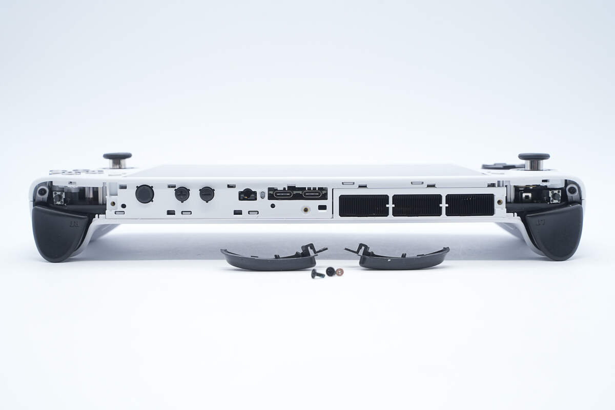

The shoulder buttons are also secured with screws.
Unscrew the screws and remove the shoulder buttons. There are also fixing screws inside.

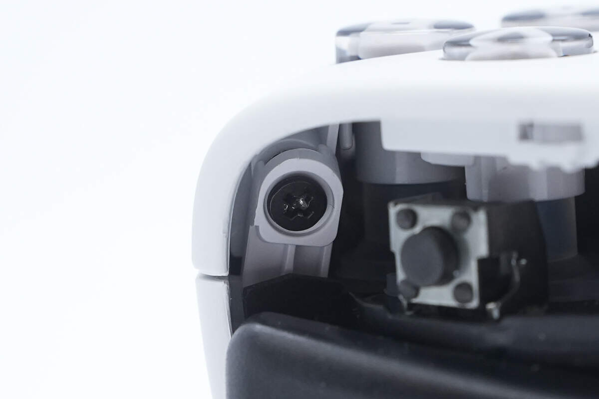

A close-up of the screws used to secure the case.

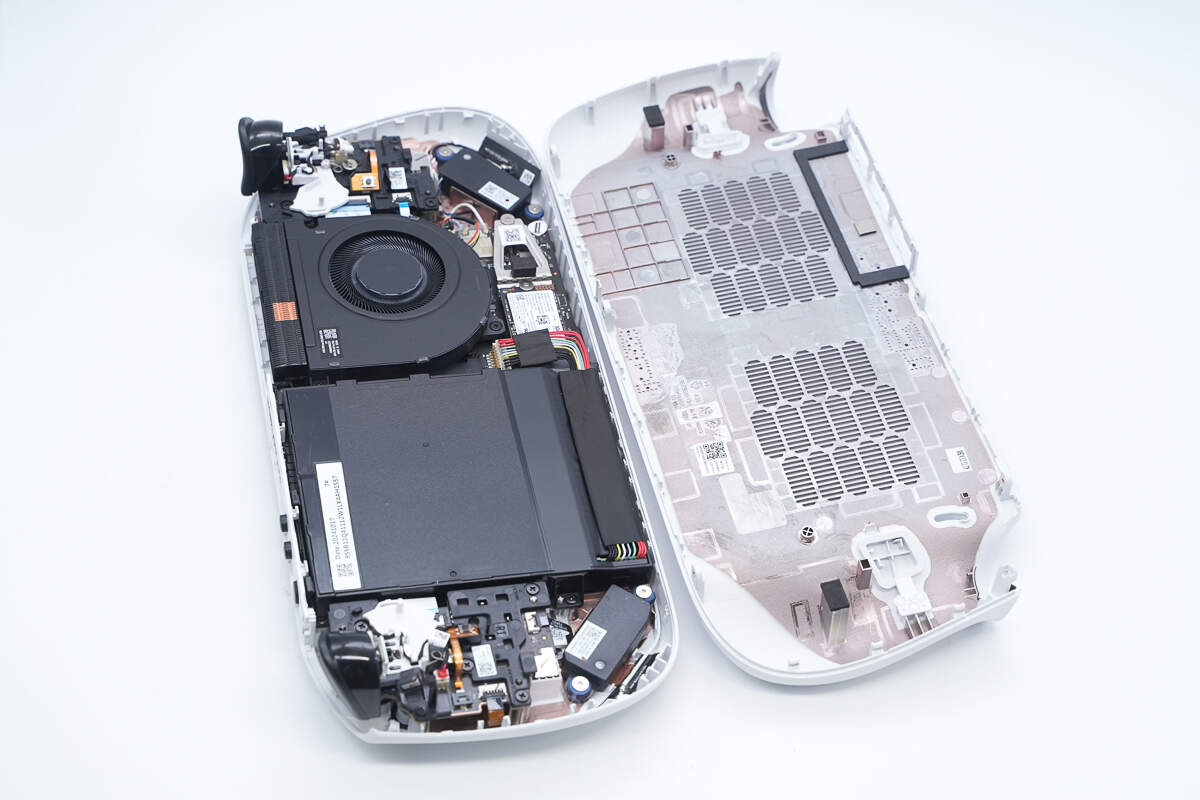

Remove the screws and open the outer case.

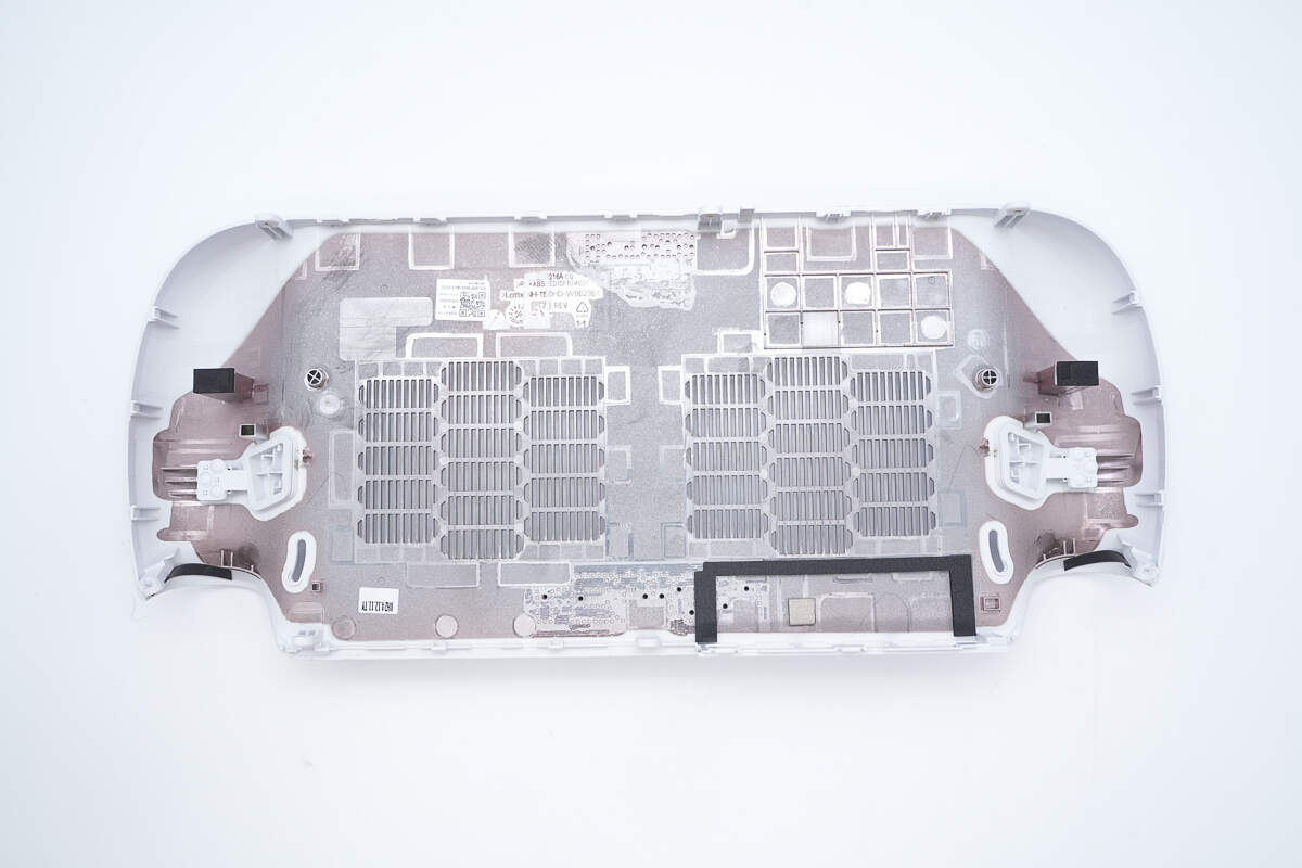

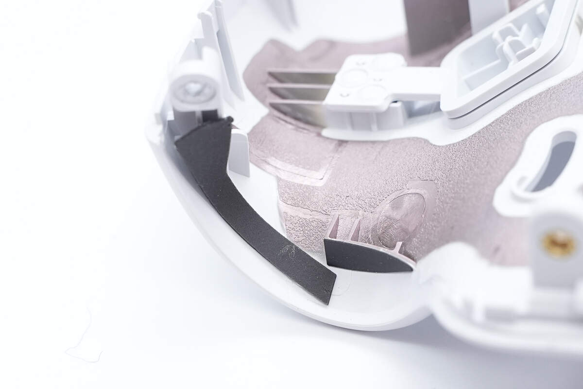

The inner side of the case has a shielding coating.

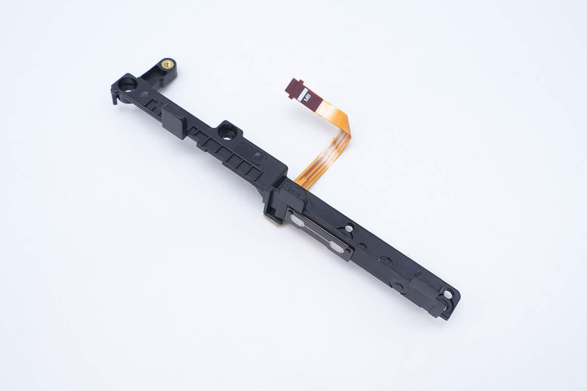

There is a button support structure inside.

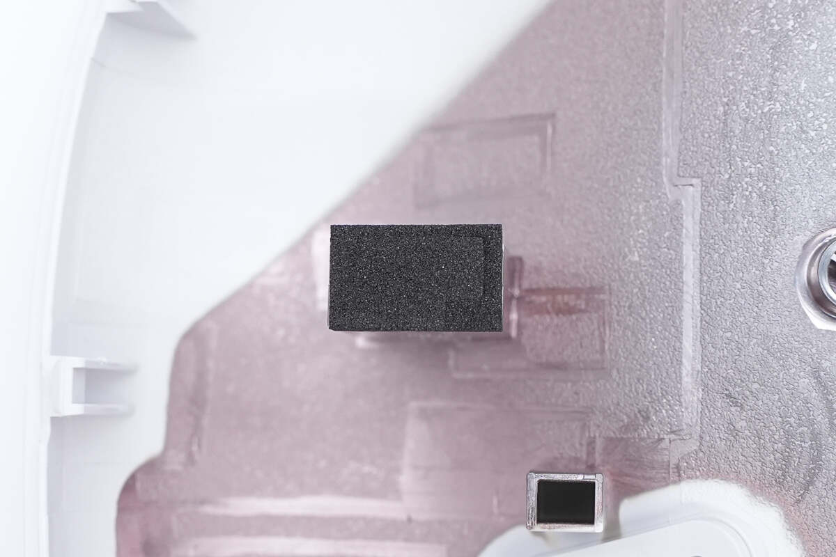

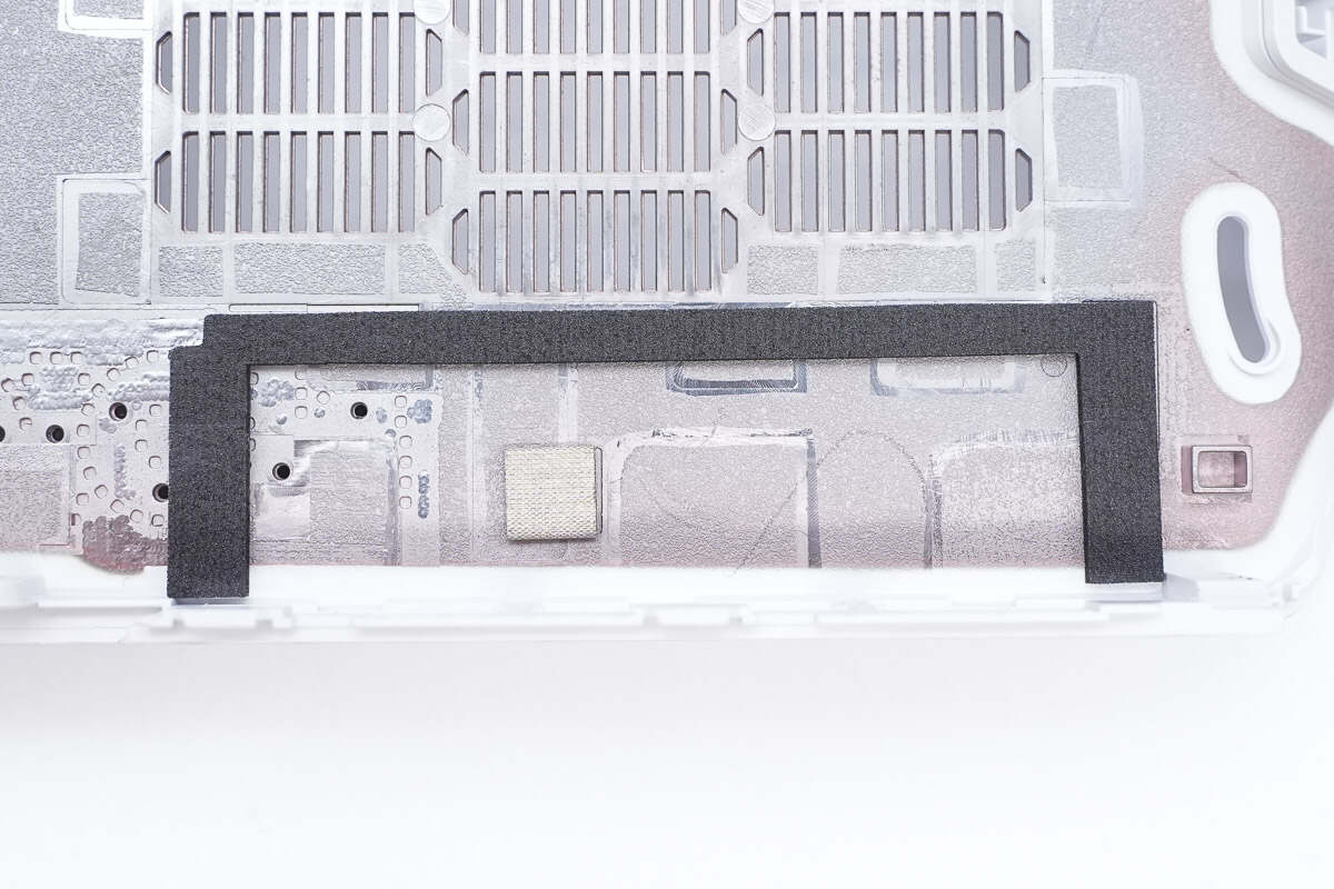

Cushioning foam is applied at the shoulder button area.
Foam sealing is applied around the heatsink area, along with conductive fabric for grounding purposes.

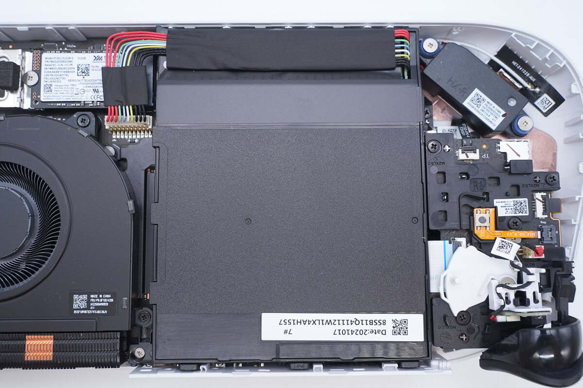

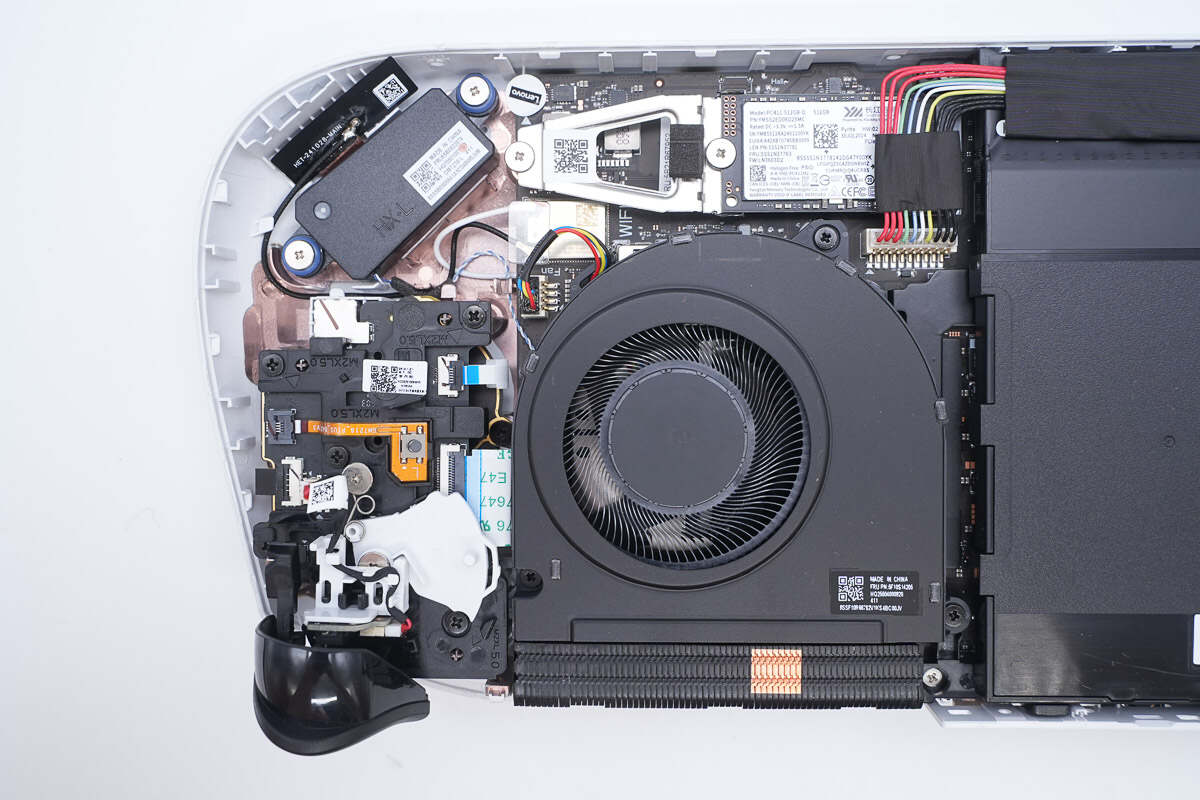

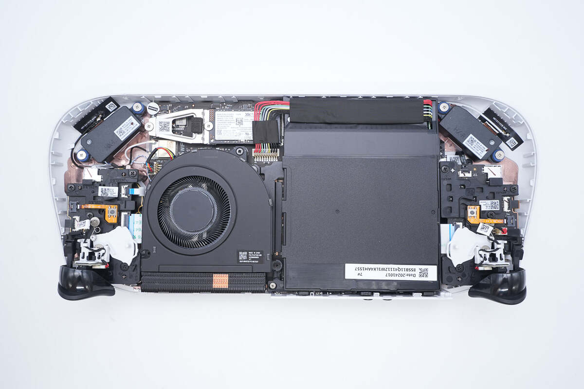

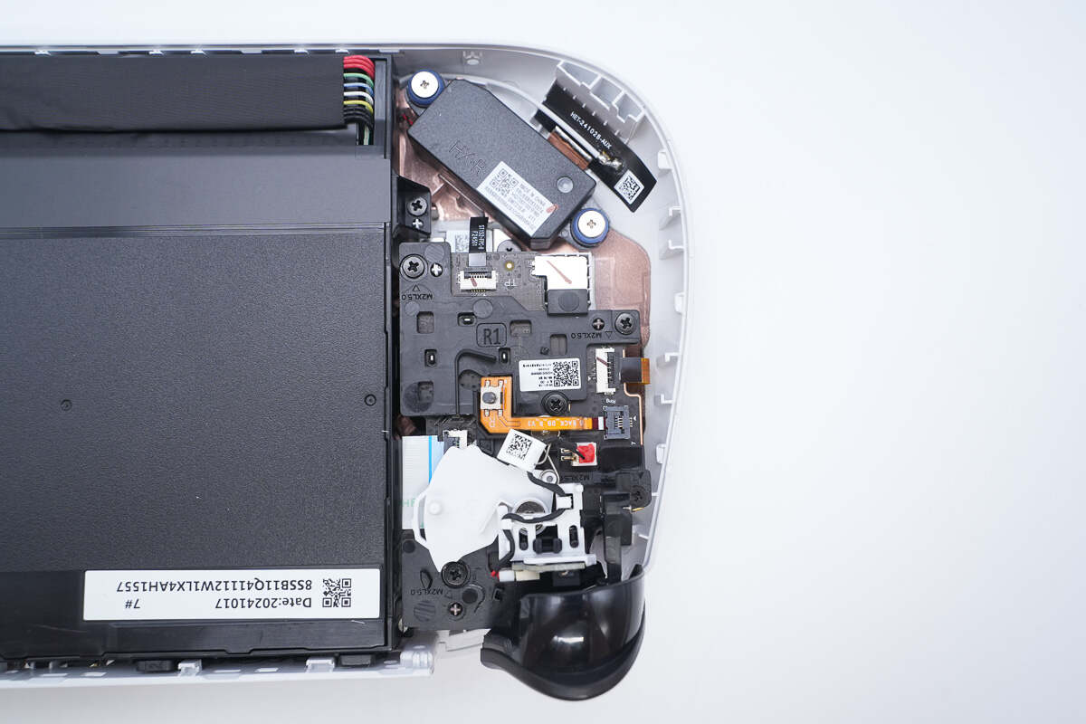

Inside, the cooling fan is positioned on the left side, with the SSD located above it. The battery pack is housed on the right side.
The cooling fan is connected via wires and secured in place with screws. The battery pack is also connected through wires.

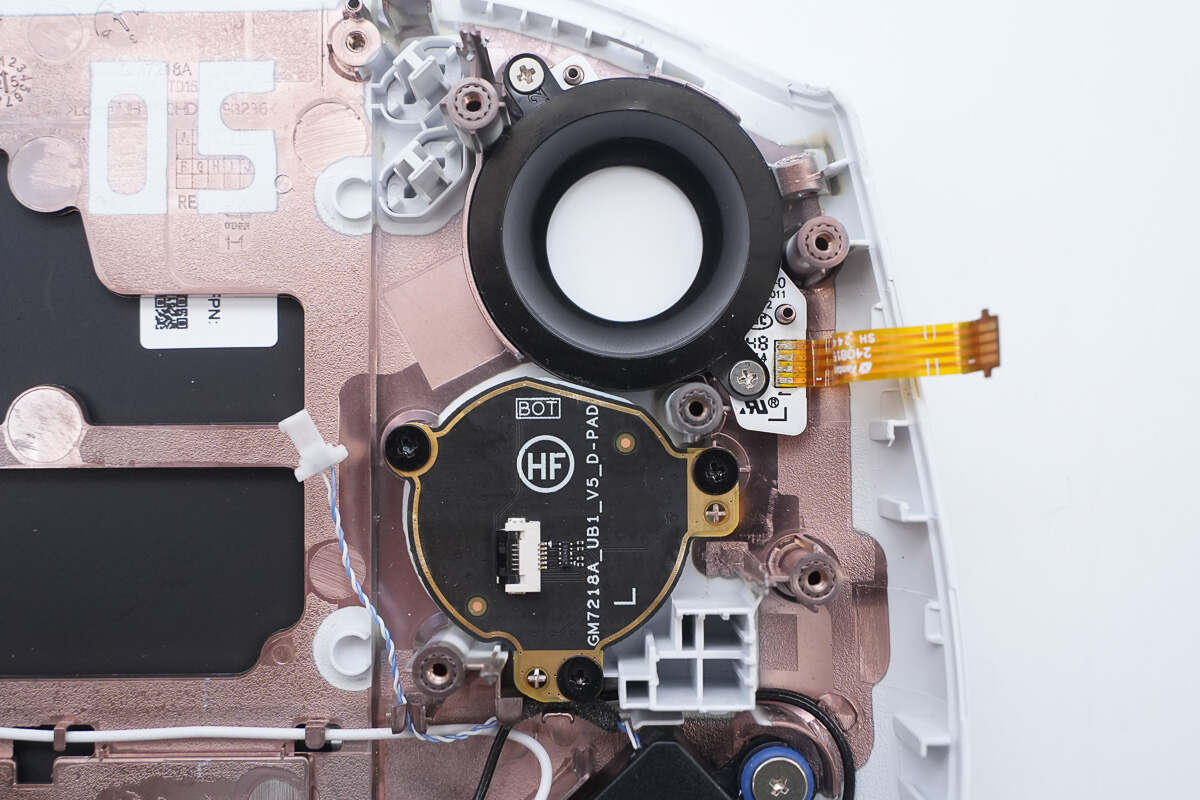

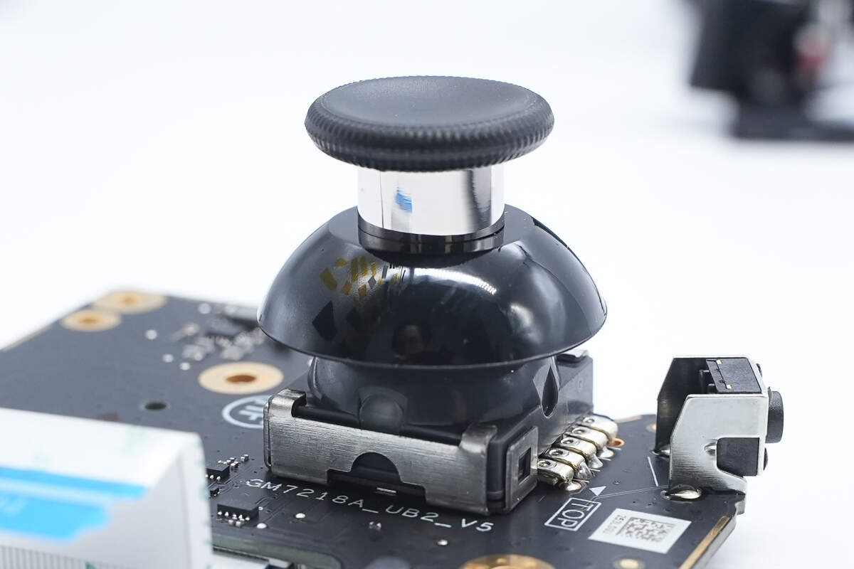

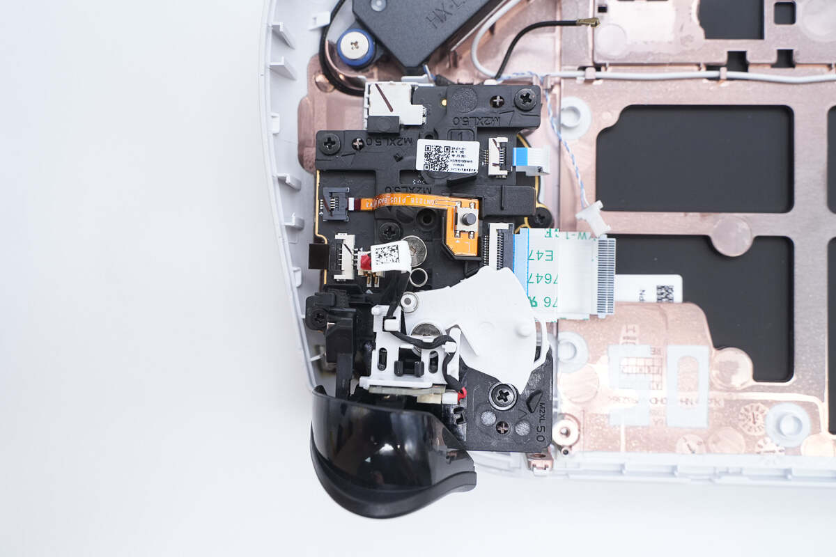

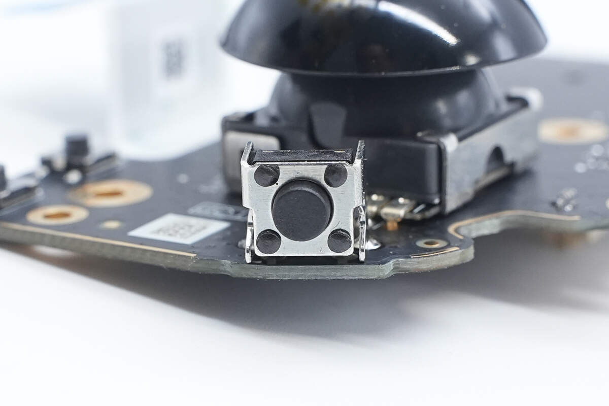

The buttons and joysticks are secured with screws.

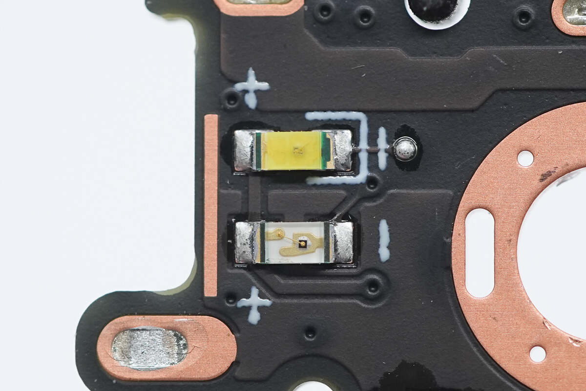

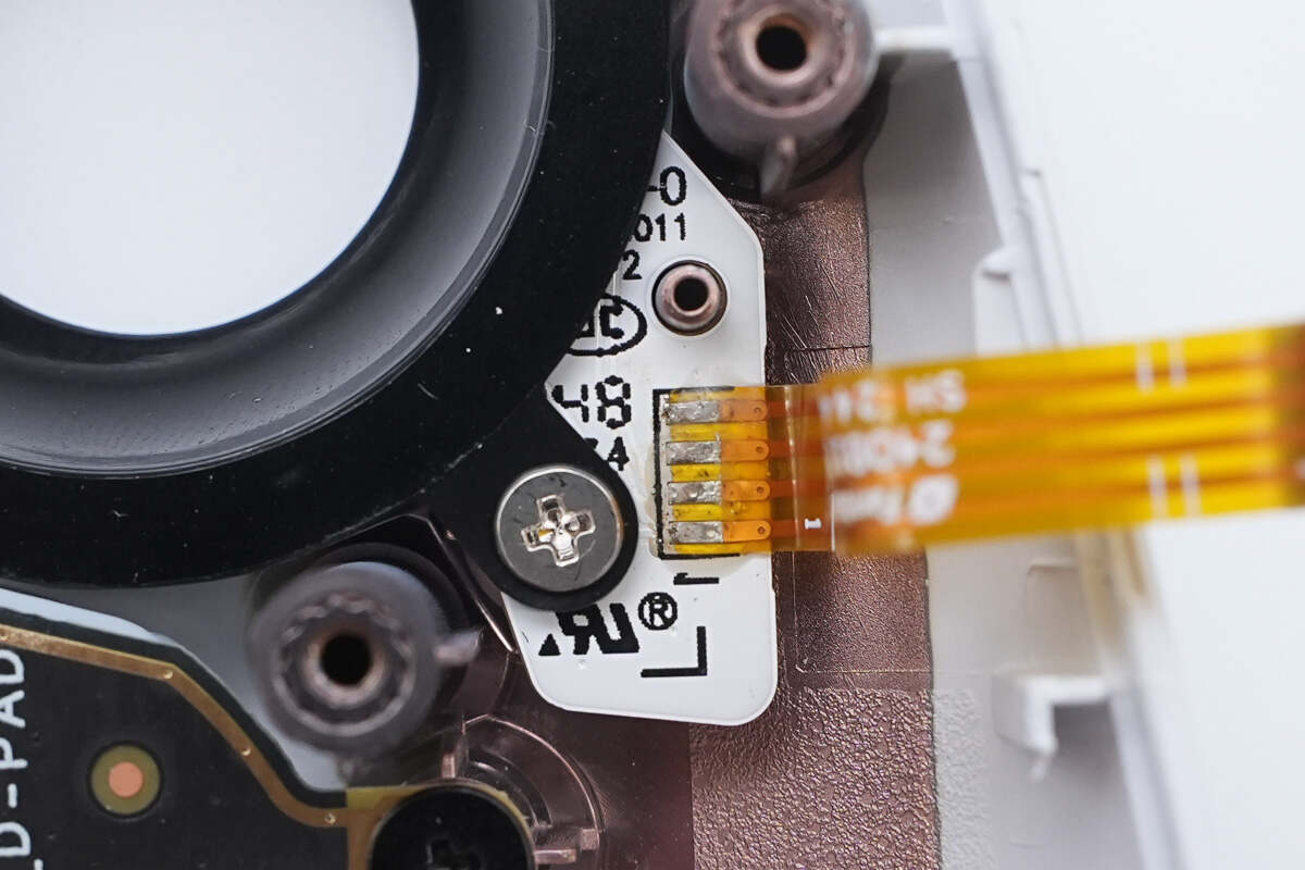

This connector links the ribbon cable responsible for powering the RGB LED lights.

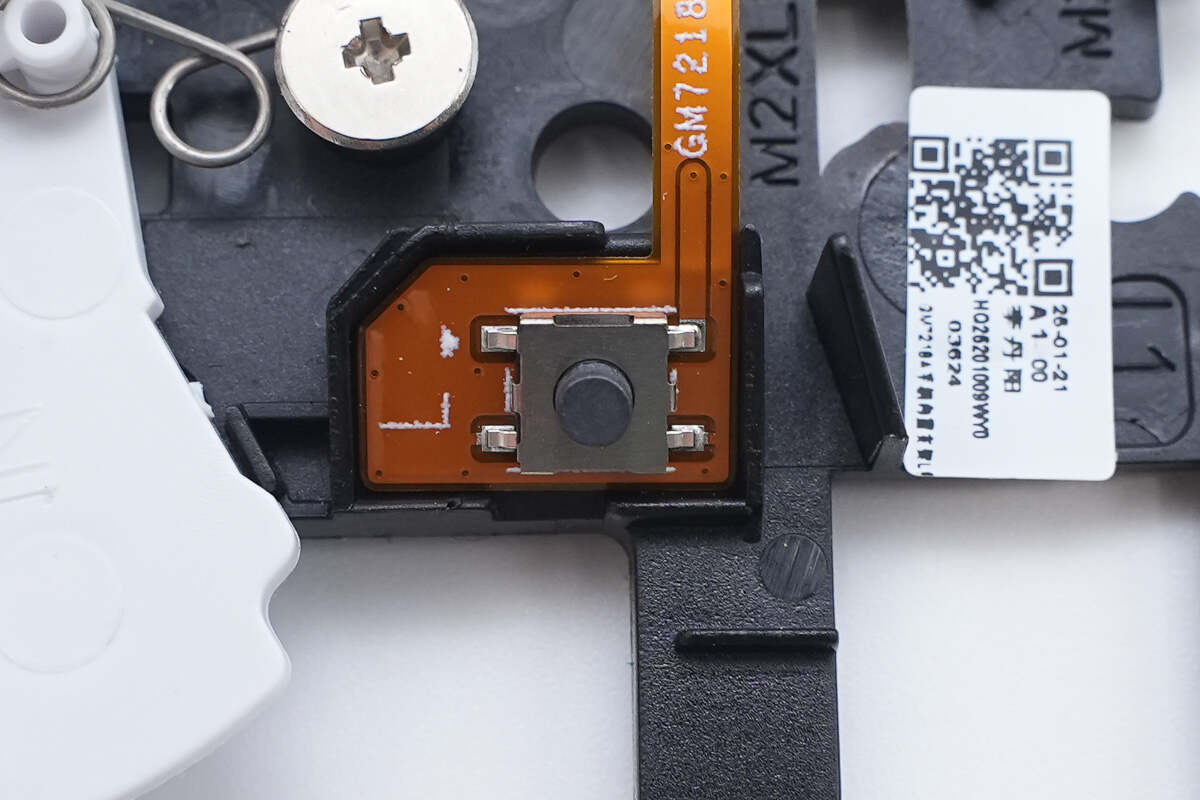

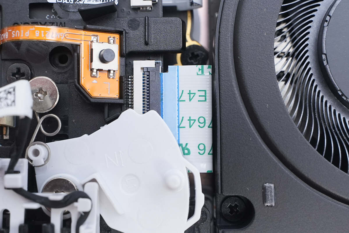

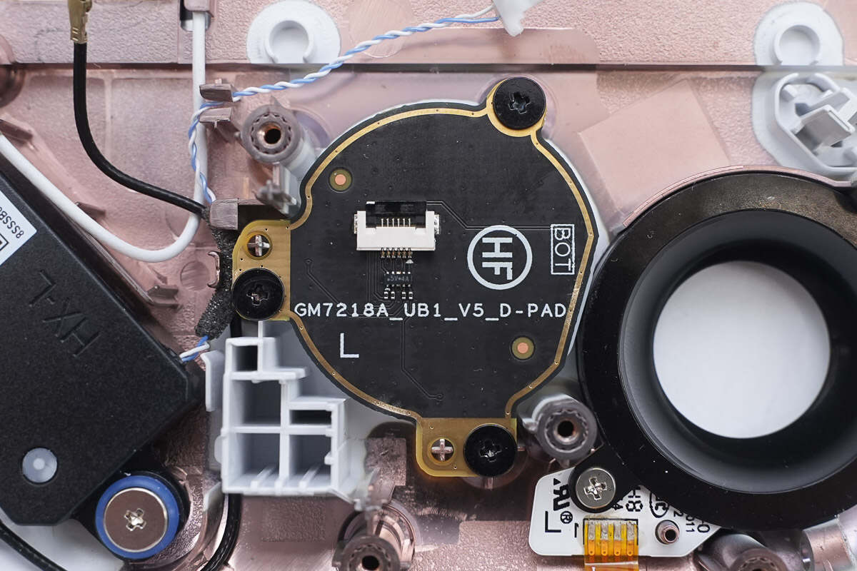

Close-up of the ribbon cable for the directional buttons.

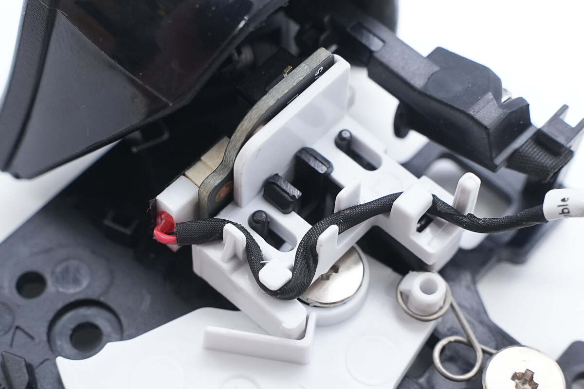

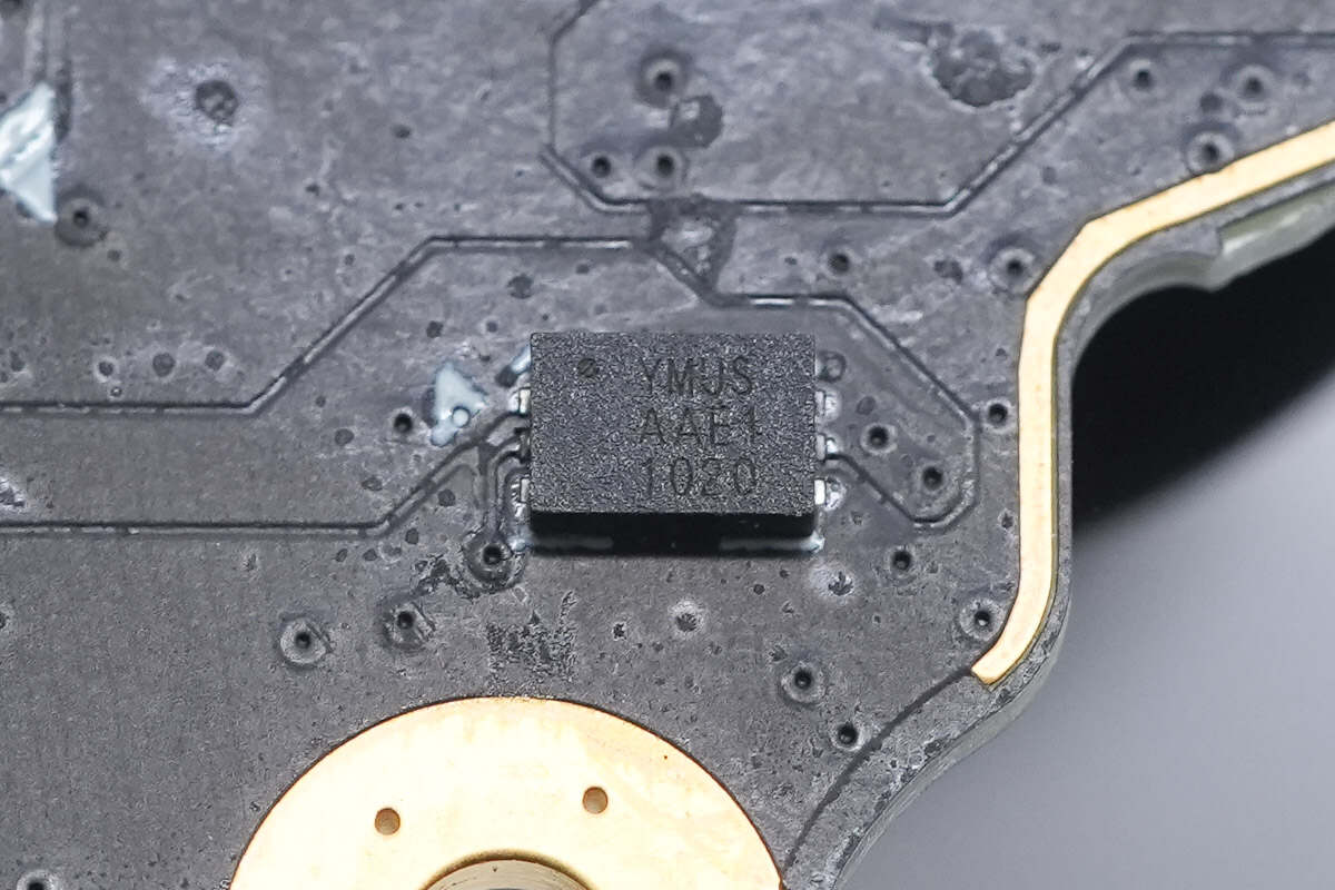

Close-up of the magnet for the Hall-effect trigger.

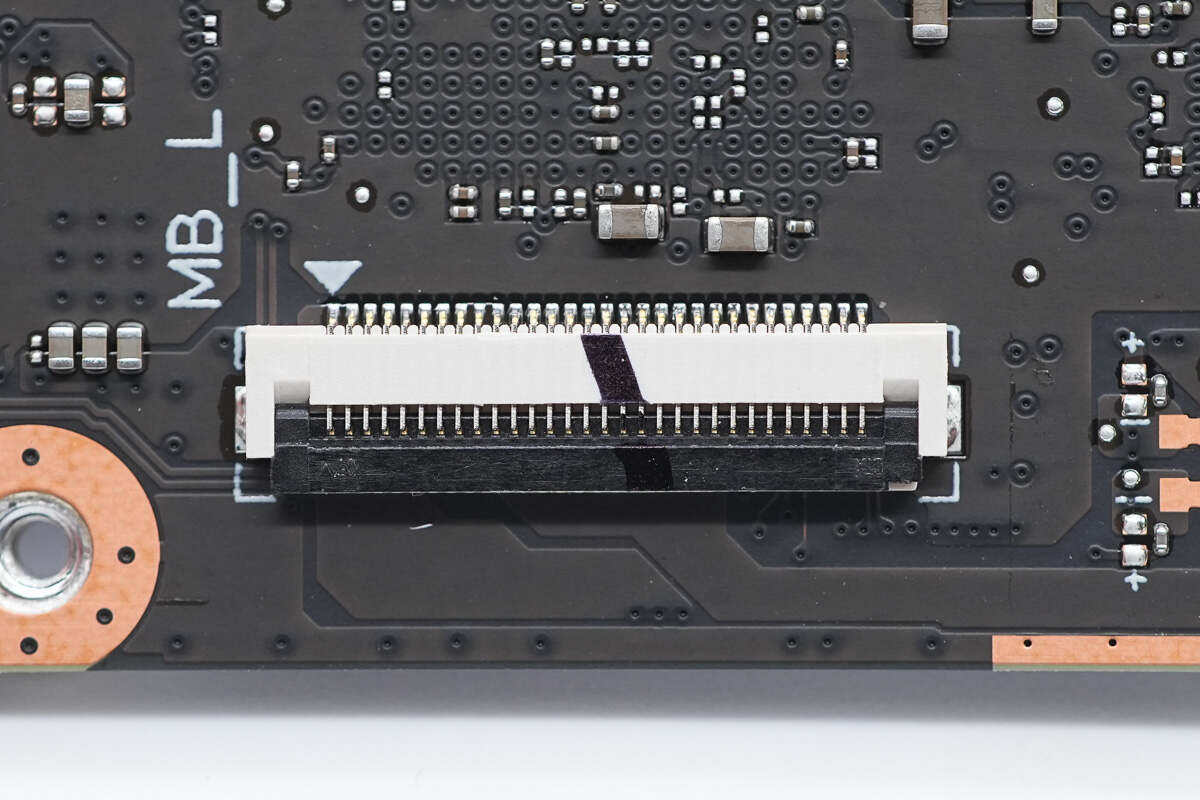

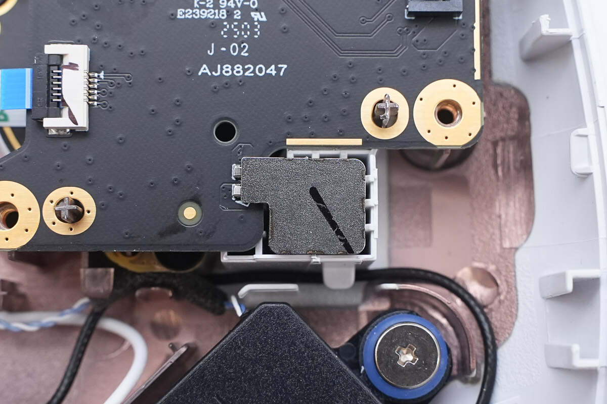

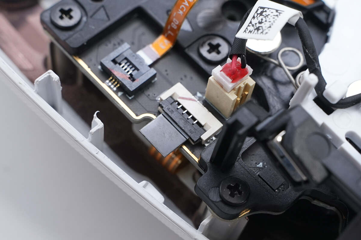

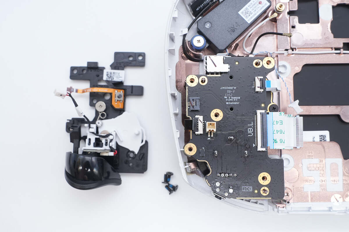

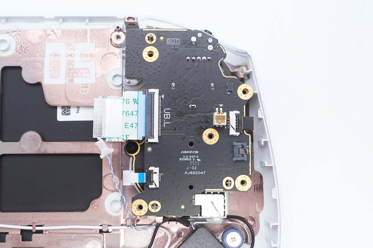

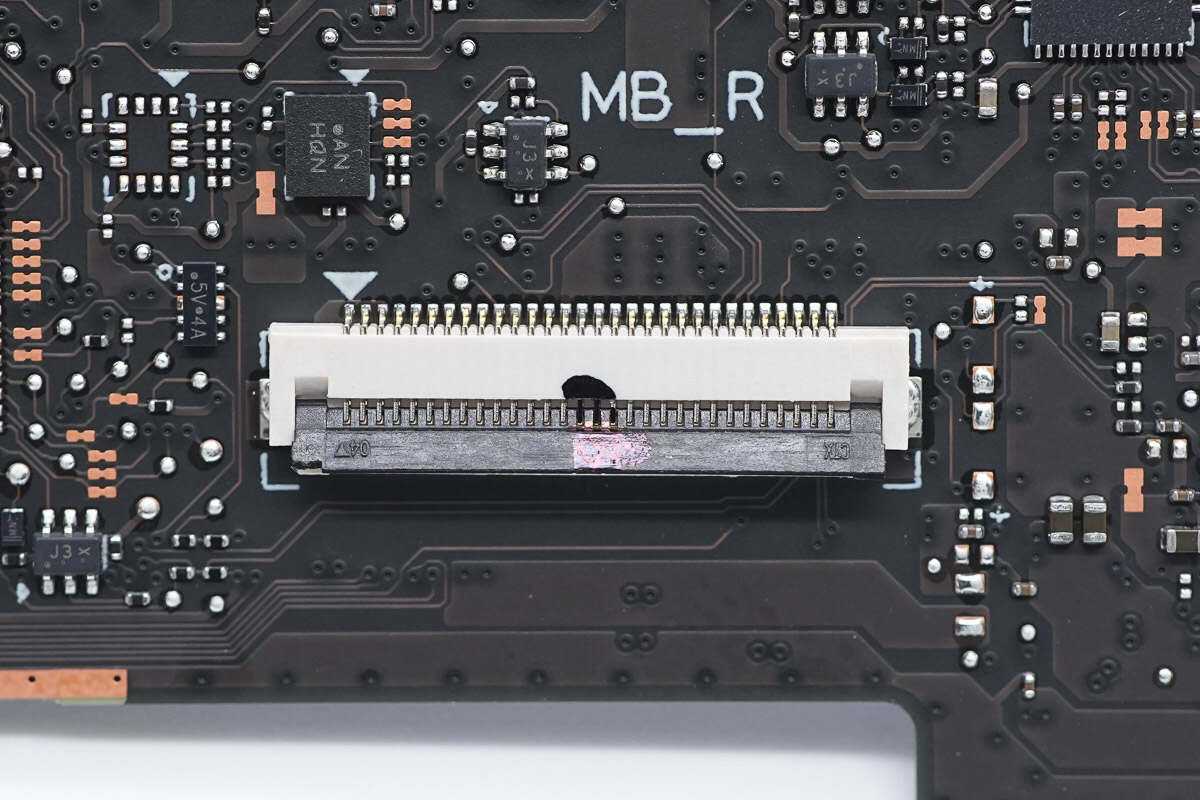

The secondary board is connected to the mainboard via a ribbon cable.

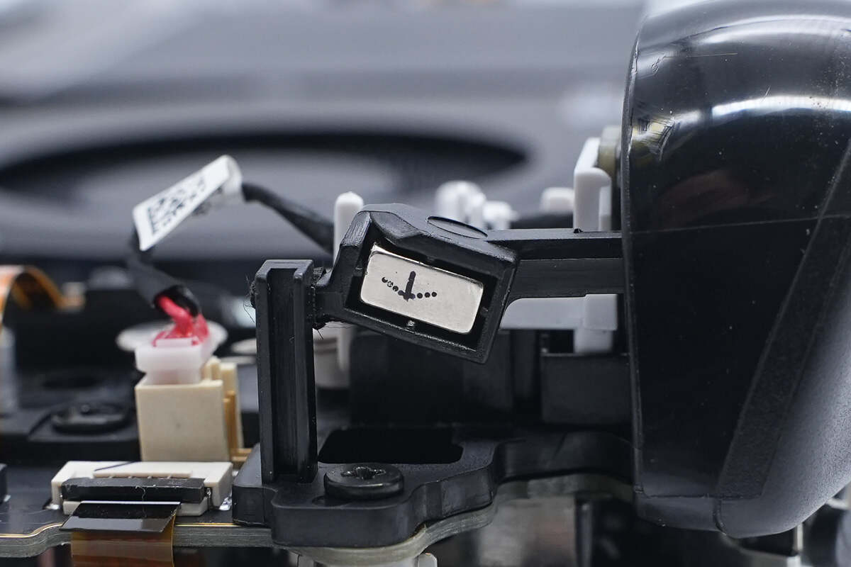

The speaker is secured with screws.

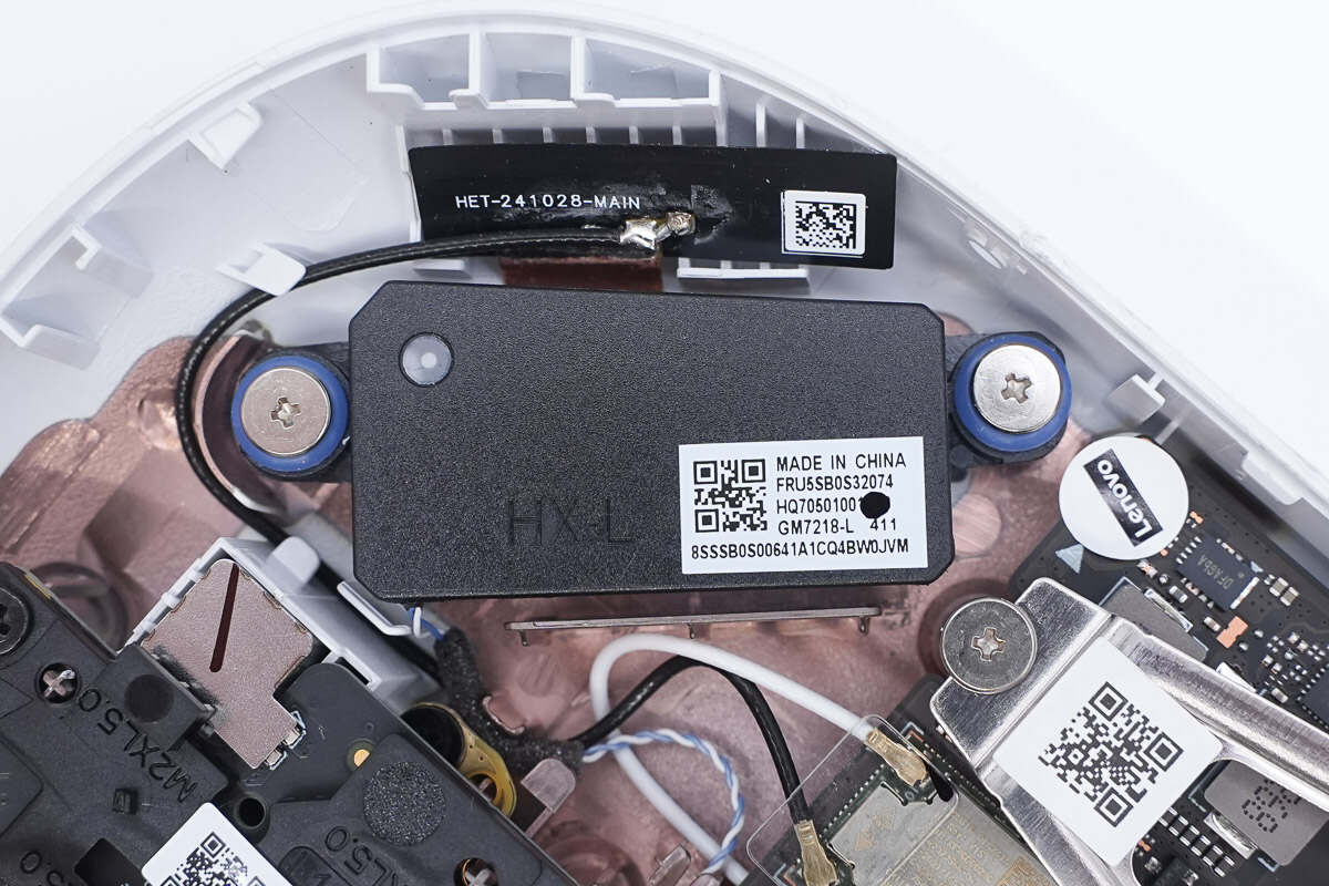

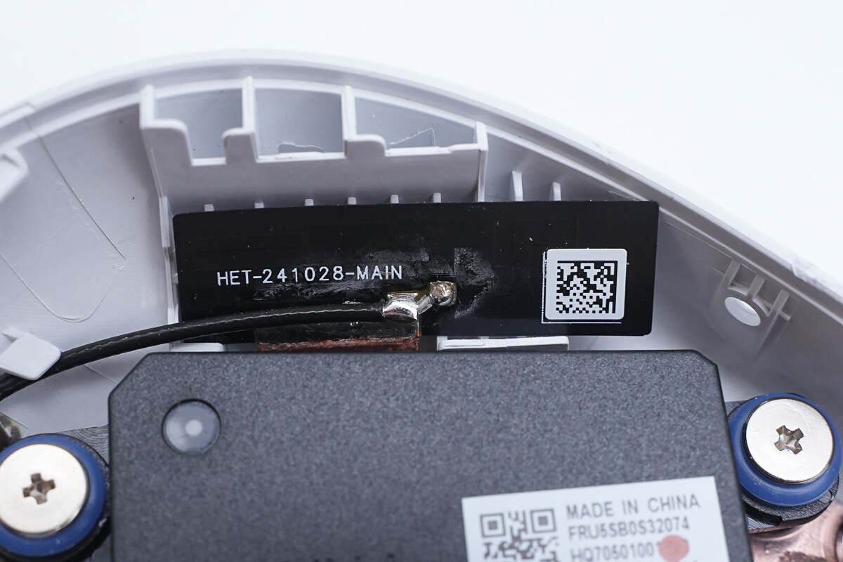

The WiFi antenna is secured inside the case.

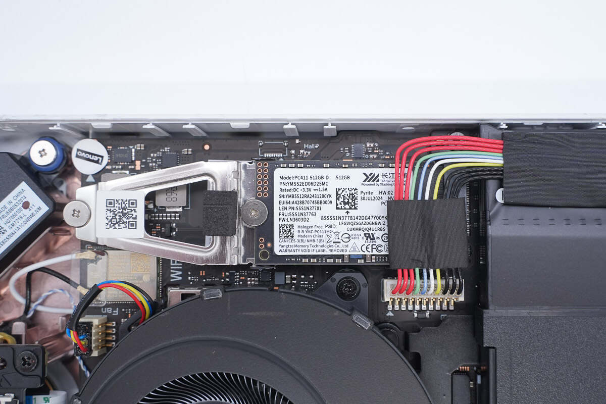

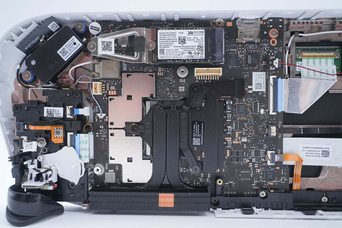

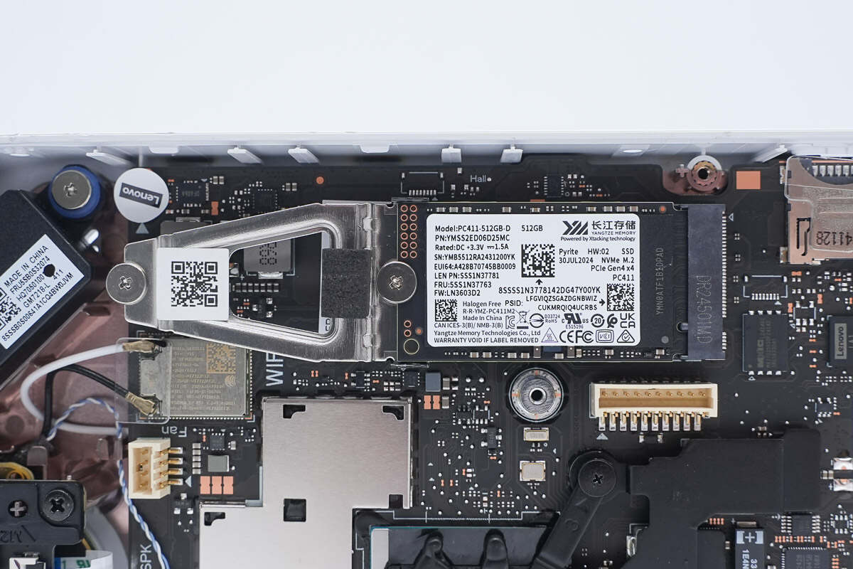

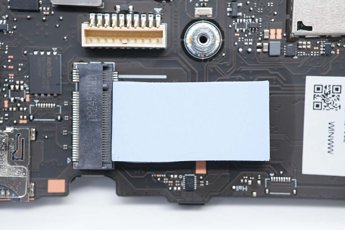

The SSD is a 2242 form factor and is secured using an extension board.
The battery pack is secured with screws.

On the other side, there is also a joystick mechanism, speaker, and a WiFi antenna.

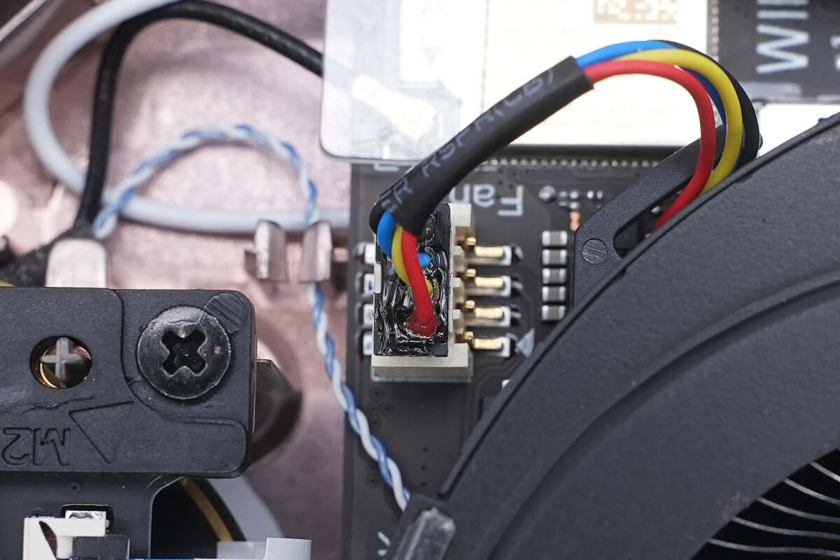

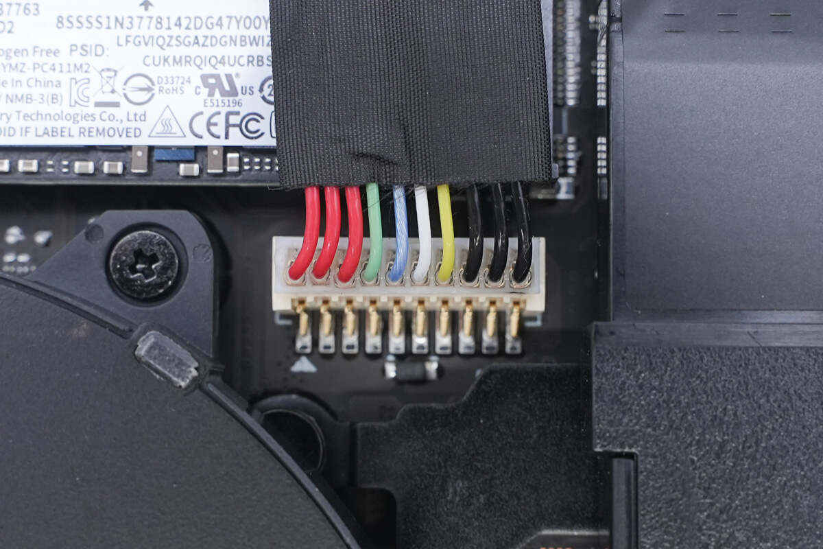

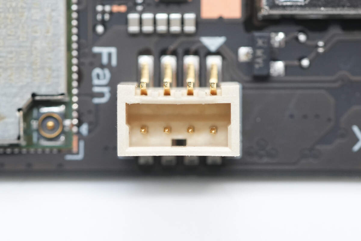

Close-up of the cooling fan connector.

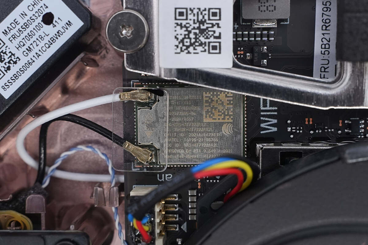

The WiFi antenna is connected via a connector.
Unscrew the screws to remove the battery pack and cooling fan.
The battery pack is enclosed in a plastic casing and secured with screws.

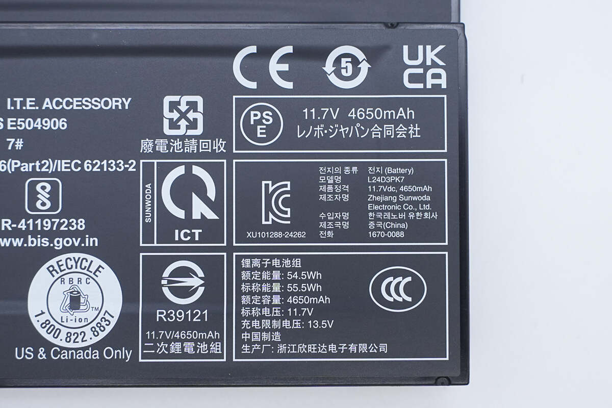

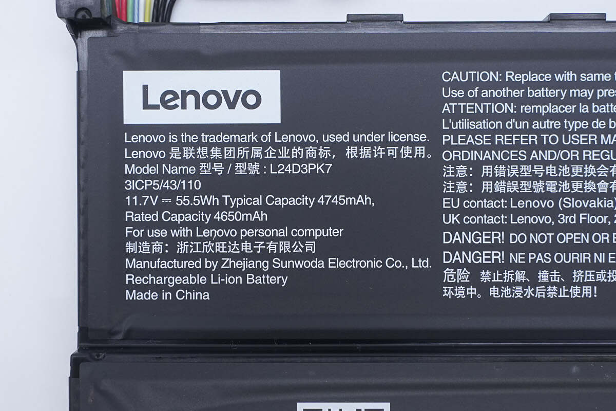

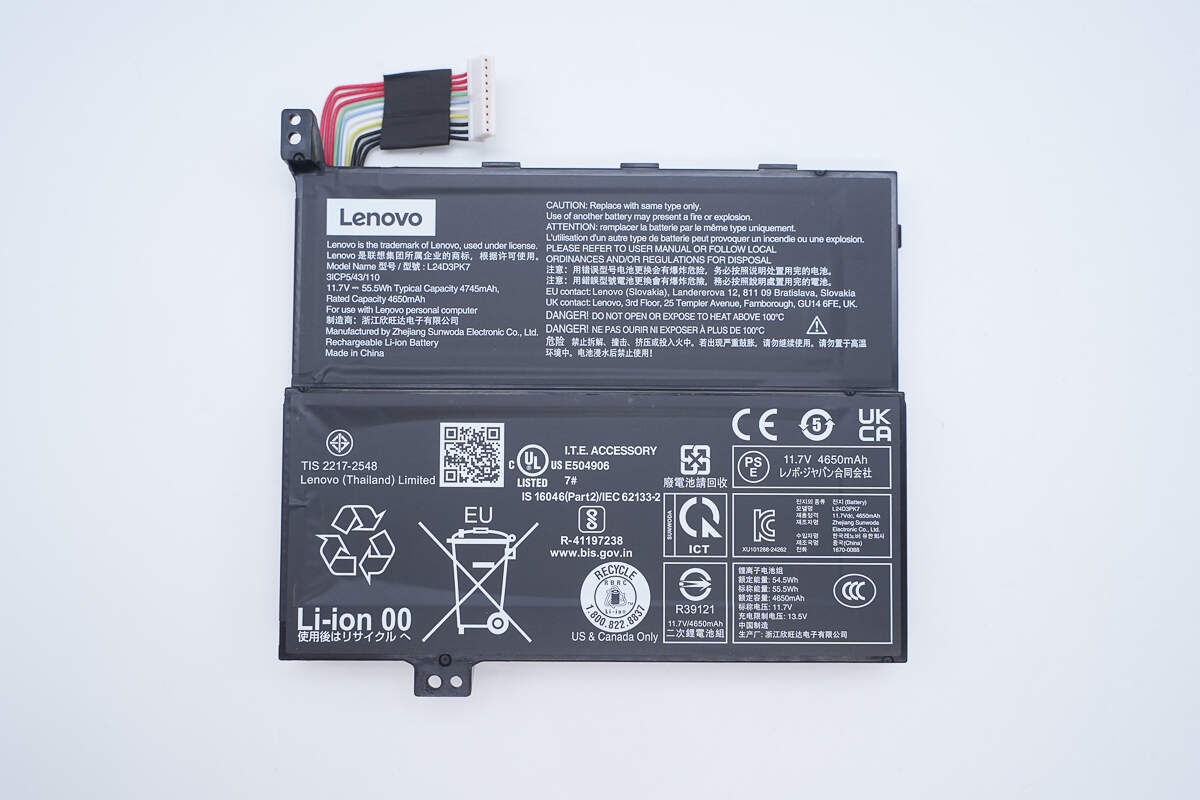

The battery pack model is L24D3PK7, with a nominal voltage of 11.7V and an energy capacity of 55.5Wh. It has a typical capacity of 4745mAh and a rated capacity of 4650mAh. The battery is manufactured by Zhejiang Sunwoda Electronics Co., Ltd.
Battery information is labeled on the bottom right corner.

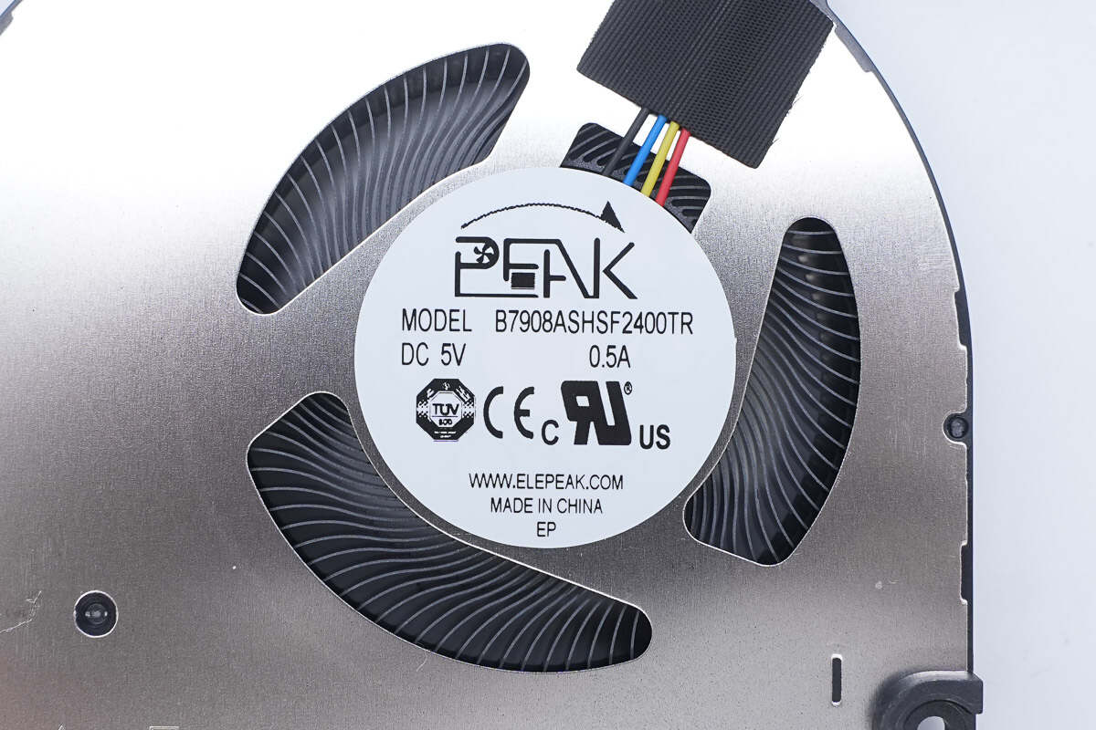

Close-up of the centrifugal cooling fan.
The cooling fan is manufactured by Kunshan Pindai Electrical Co., Ltd. It is a four-wire PWM fan, with a sticker indicating the clockwise rotation direction. 5V 0.5A. Model is B7908ASHSF2400TR.

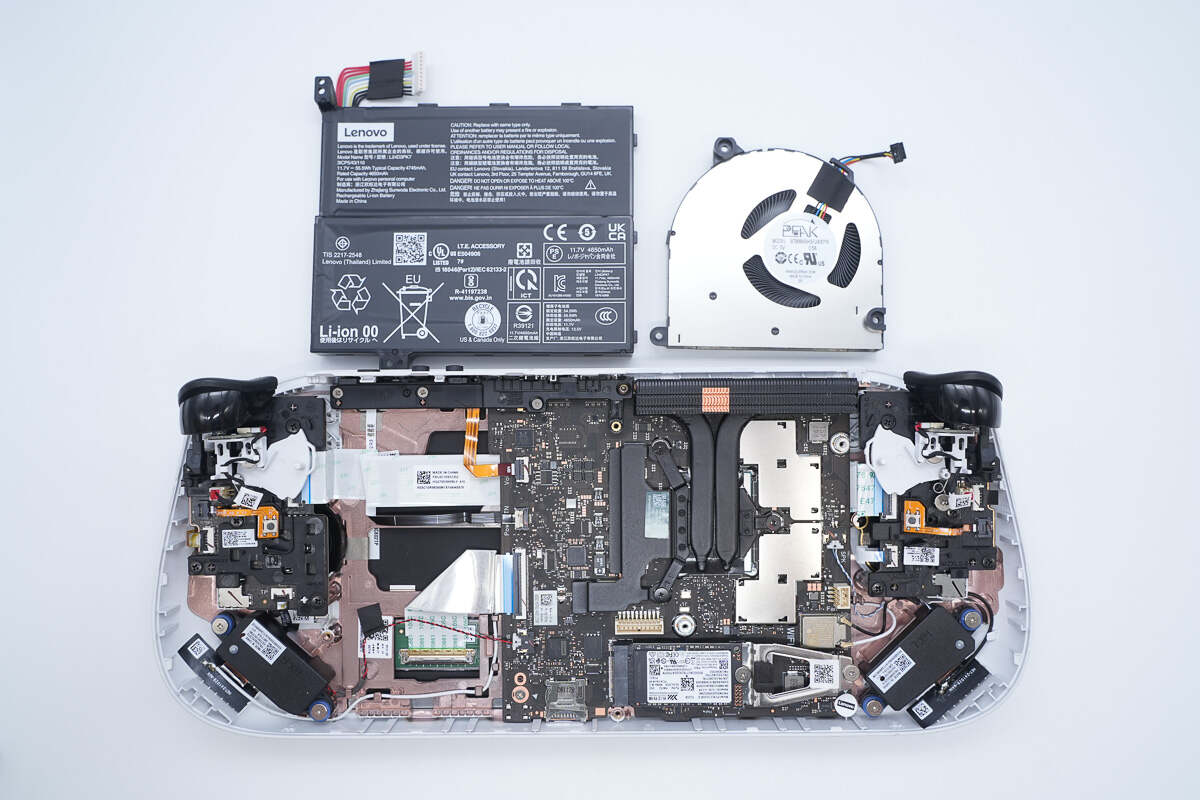

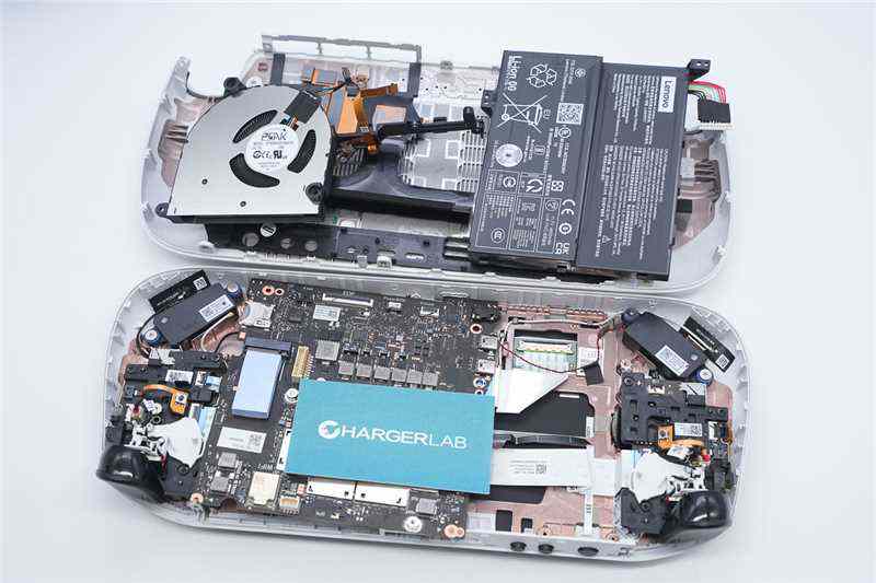

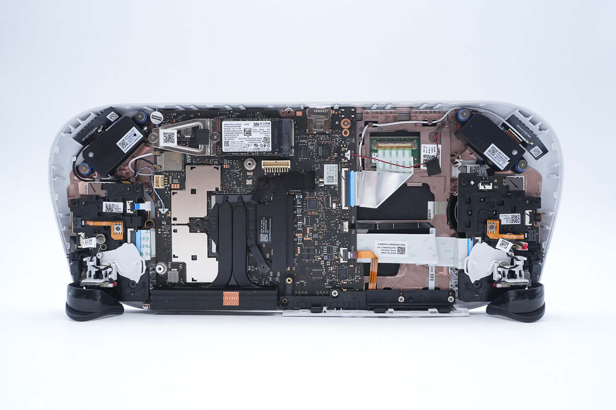

After removing the cooling fan and battery pack, the internal layout is fully exposed. The mainboard is connected to the display and the right-side daughterboard via ribbon cables.

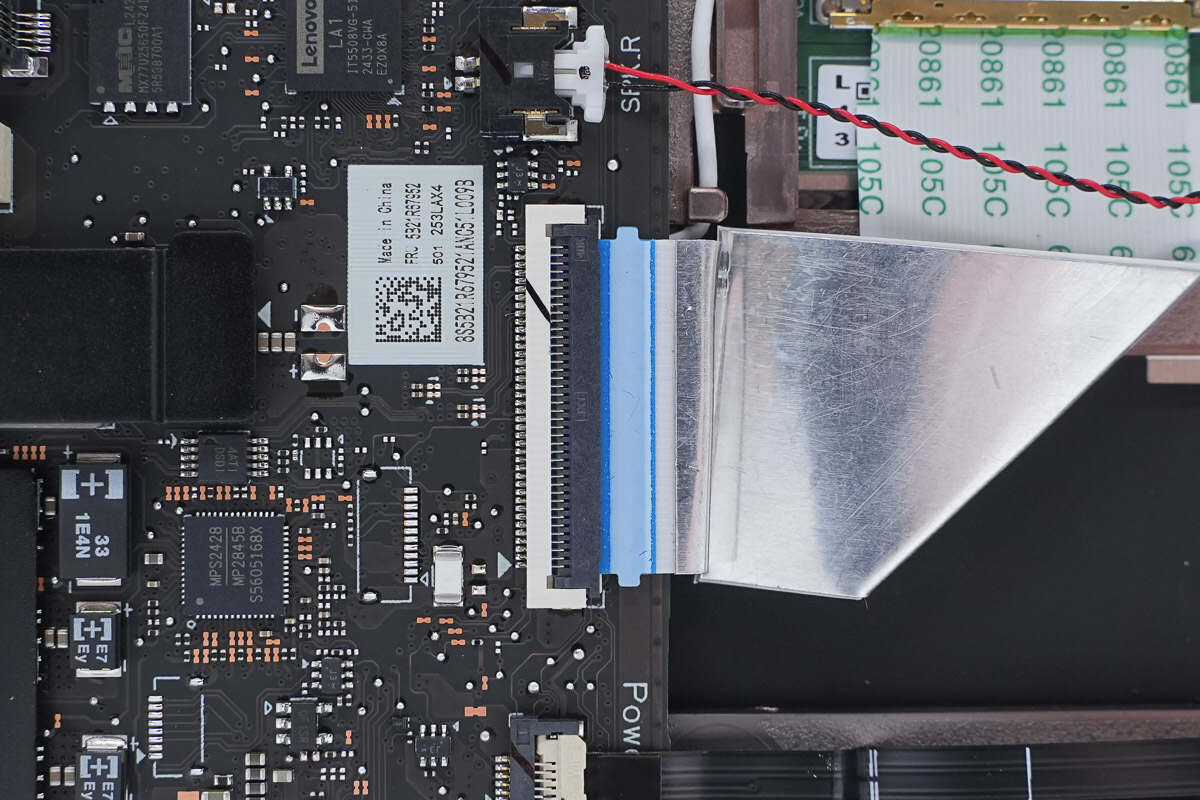

Aluminum foil is applied to the display ribbon cable for shielding.

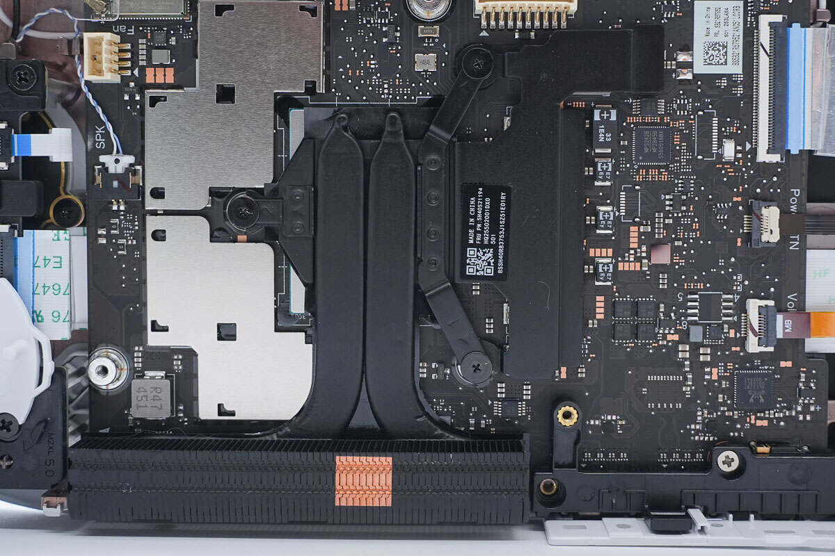

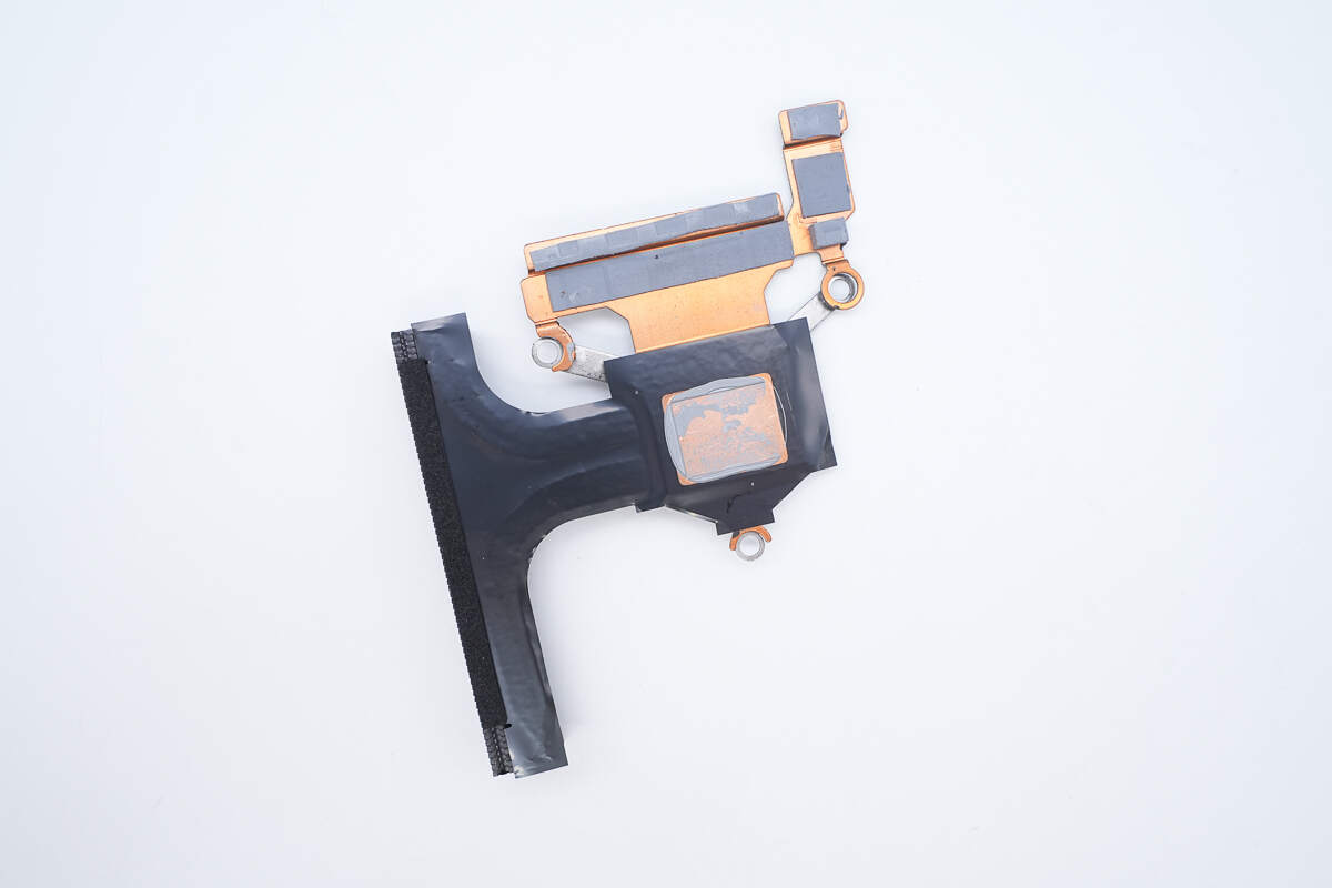

The mainboard is equipped with a shielding cover, and the heat pipe cooler is secured with screws.
The two heat pipe coolers are secured with three screws and also provides cooling for the power delivery circuitry.

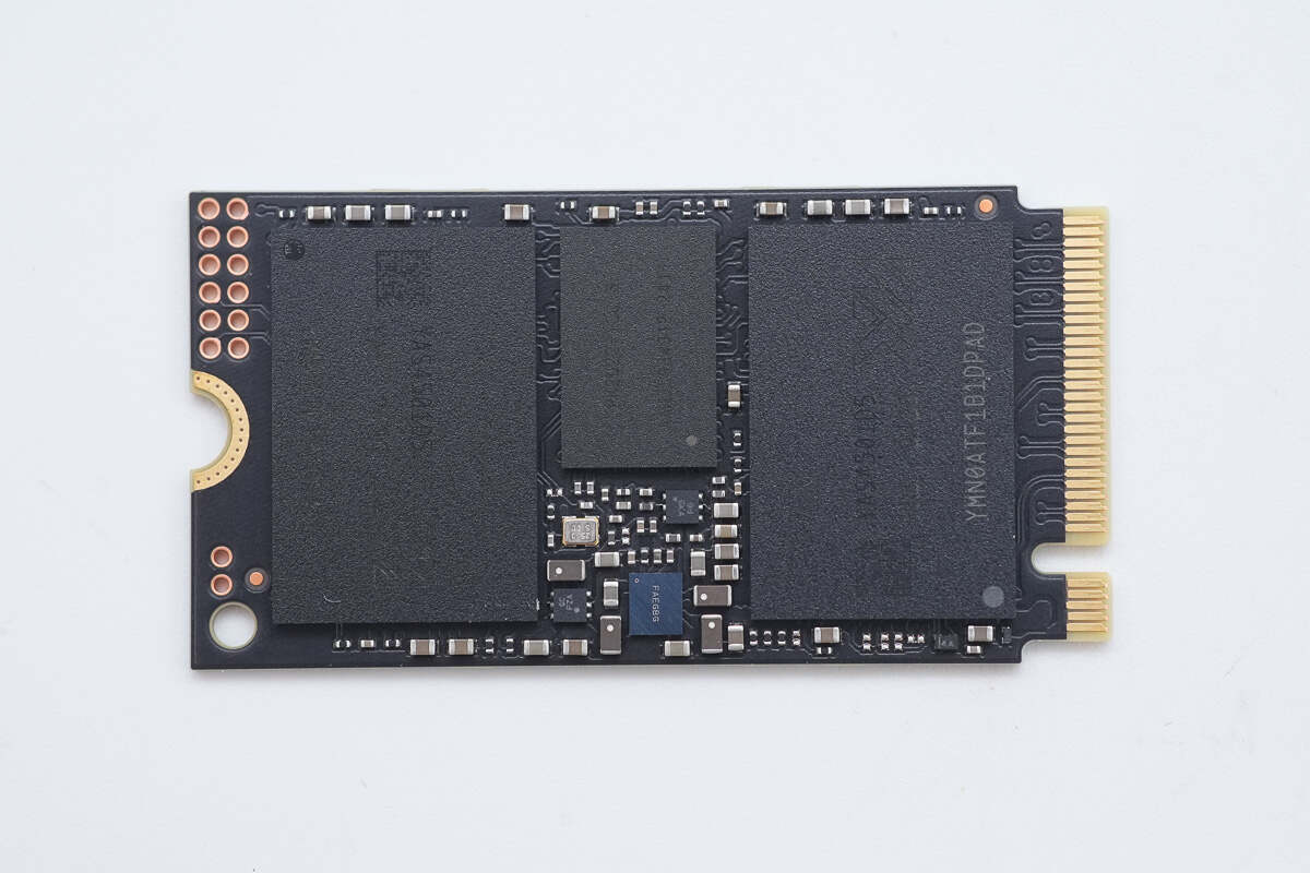

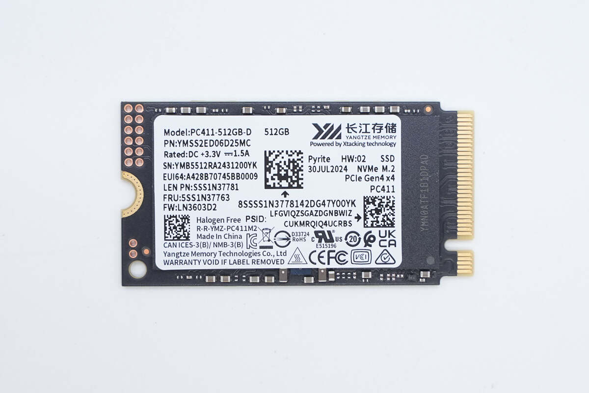

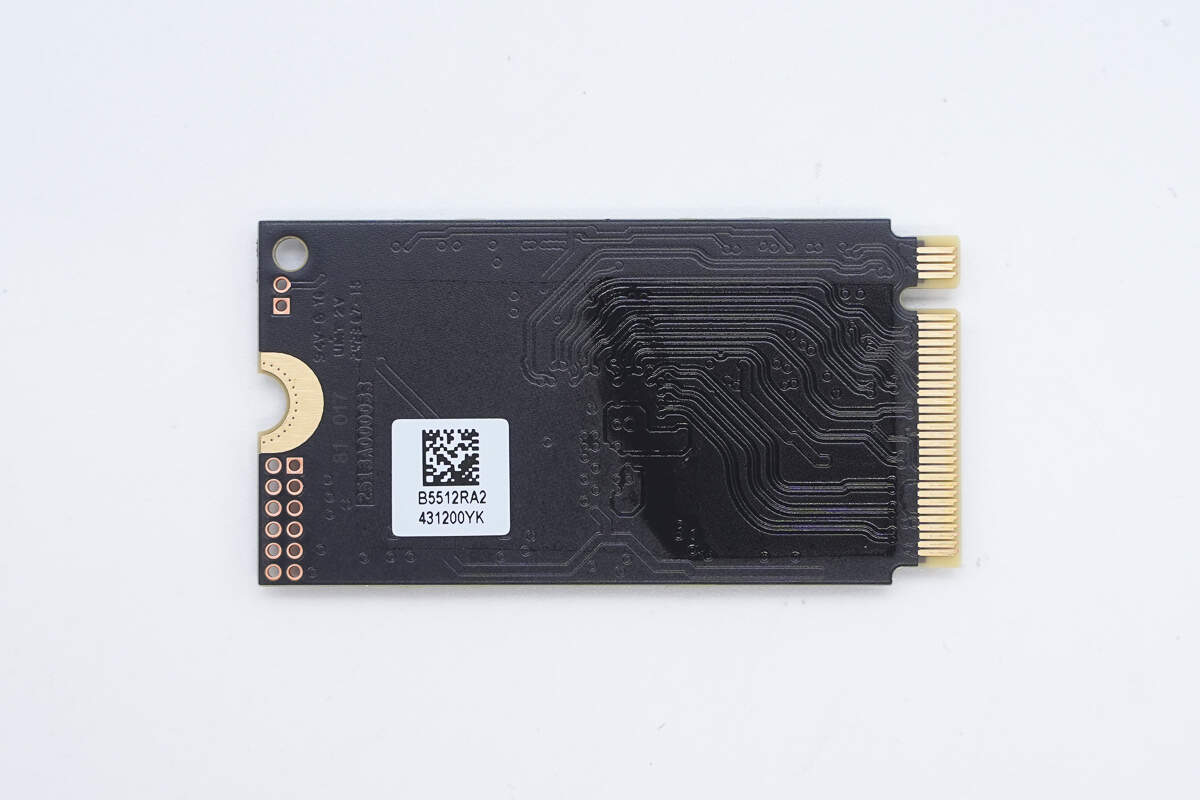

The SSD is from Yangtze Memory Technologies, with a capacity of 512 GB. It uses a PCIe Gen4 x4 interface and has a 2242 form factor. Model is PC411-512GB-D.

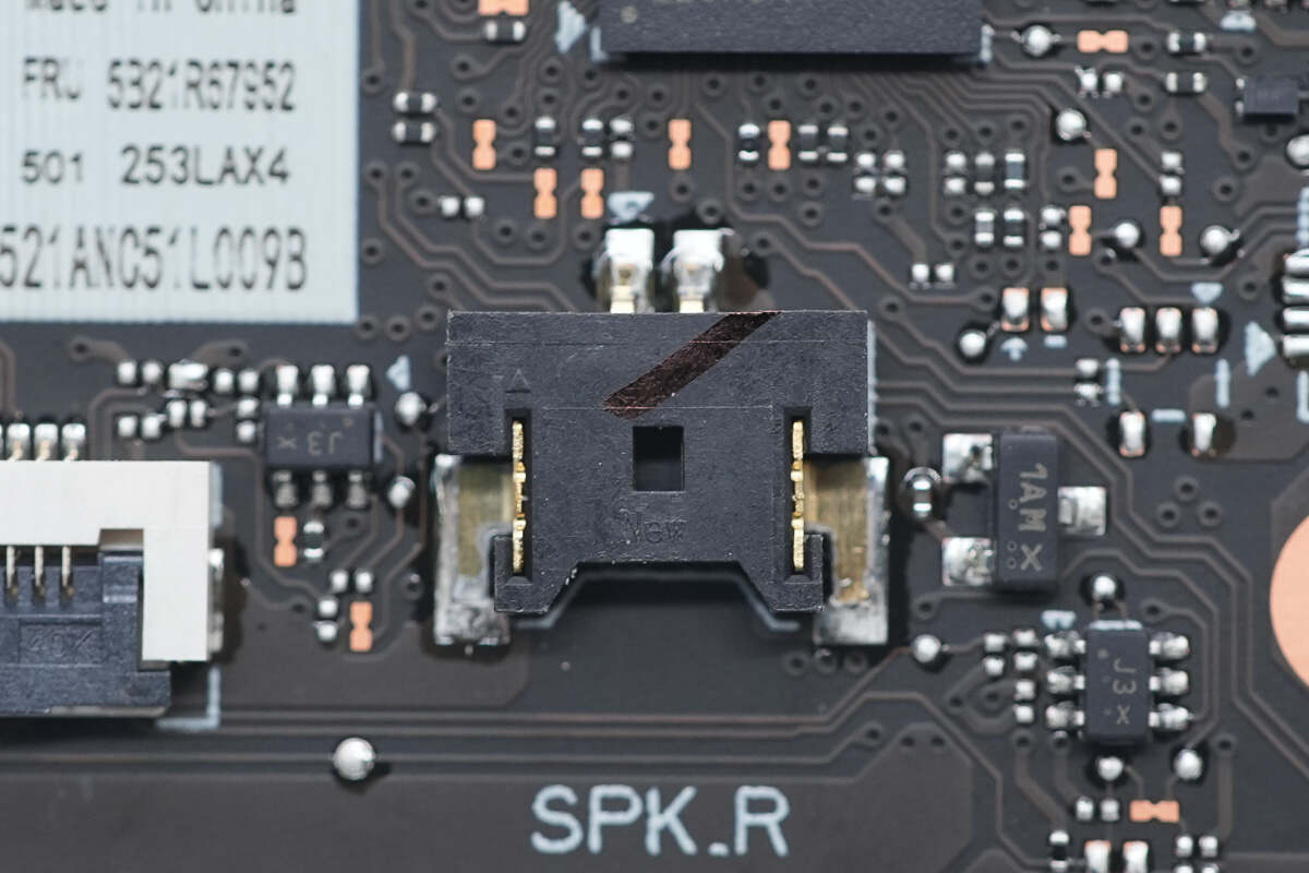

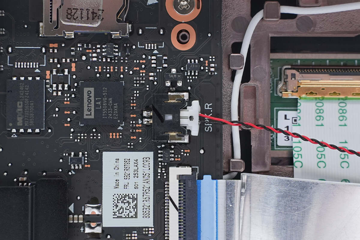

Close-up of the connector for the right-side speaker.

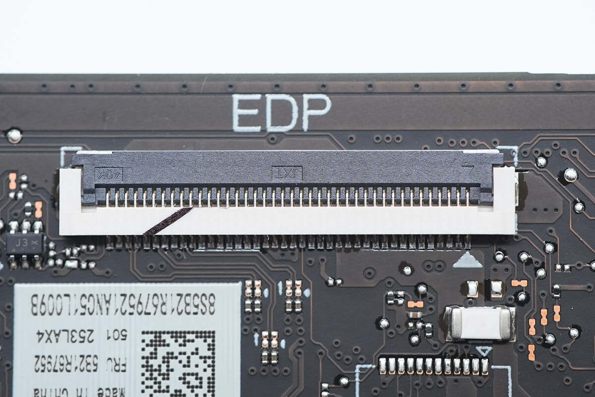

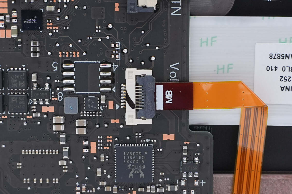

Close-up of the display ribbon cable.

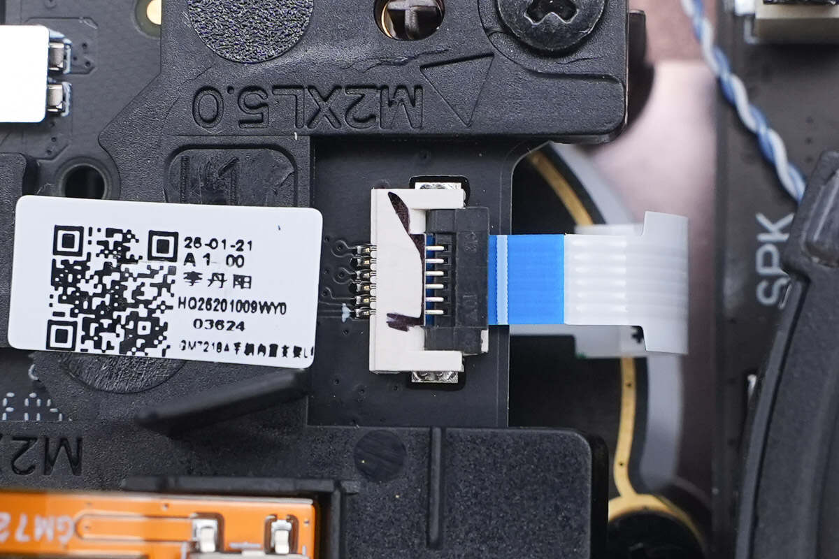

Close-up of the ribbon cable for the volume buttons.
The Yangtze Memory PC411 SSD features a PCIe Gen4 x4 interface and NVMe 1.4 protocol. It is compatible with mainstream computer motherboards and comes in a single-sided design supporting both 2242 and 2280 form factors. This enhanced physical compatibility makes it ideal for devices with limited space slots, such as laptops and PlayStation gaming consoles.
The SSD features a single-sided design.

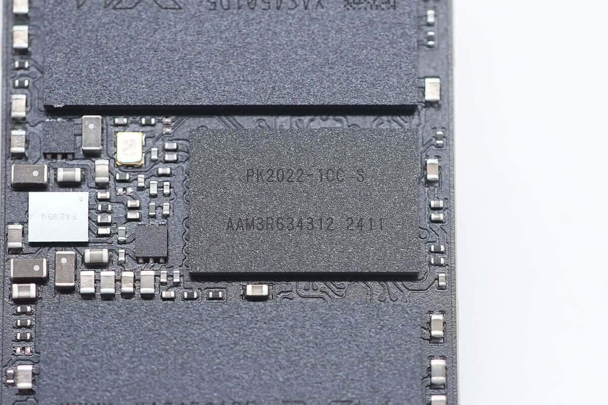

Peel off the label on the front of the SSD. The master controller chip is located in the center, flash memory chips are positioned on both sides, and the PMIC is situated at the bottom.
The master controller chip is marked with PK2022-10C S.
Close-up of the external clock chip for the main controller.
Flash memory chips, each with a capacity of 256 GB. Model is YMN0ATF1B1DPAD

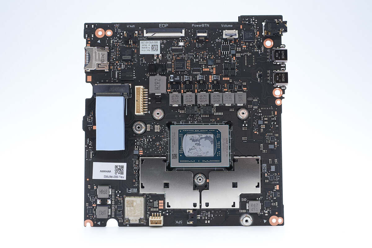

Disconnect the ribbon cables, remove the heatsink, and take out the motherboard from the case.
An insulating sheet is placed on the motherboard beneath the cooling assembly, with thermal pads applied over the power ICs and power inductors.

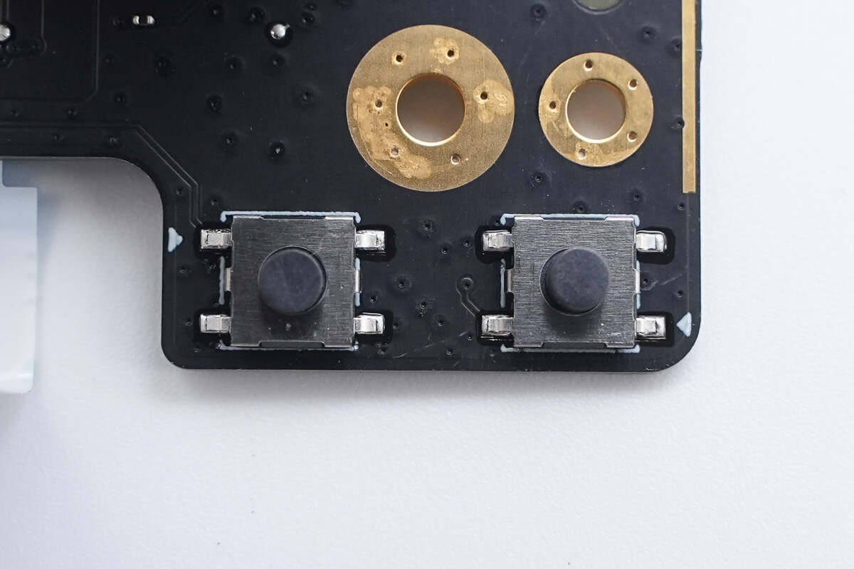

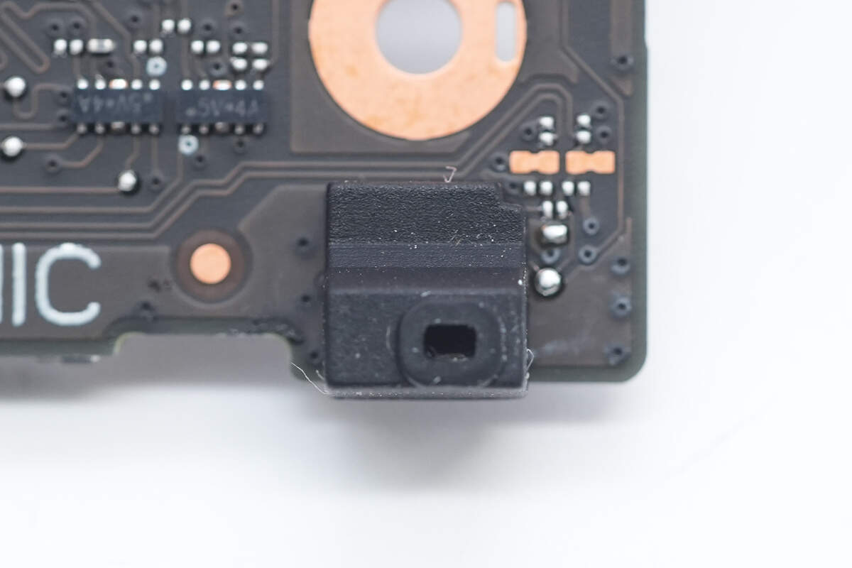

The pressure plate is equipped with volume buttons.
Close-up of the volume button dome switch.
The interior of the case features a hollowed-out design.

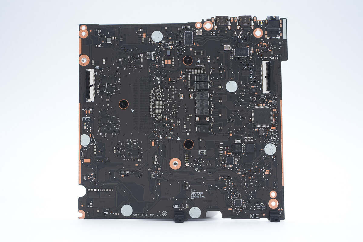

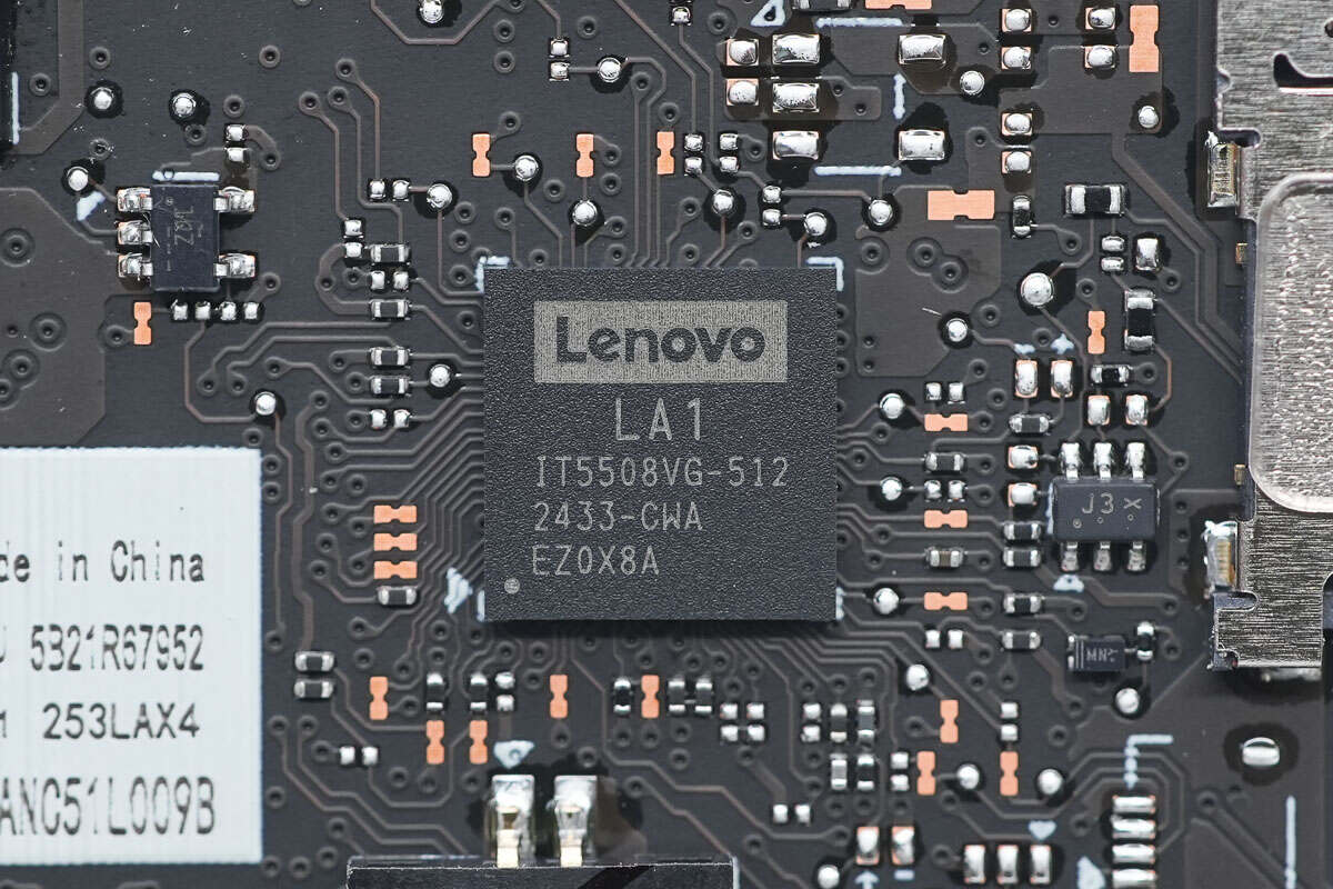

On the front side of the mainboard is the CPU. Below the CPU are two shielding covers housing the memory chips. Above the CPU are the power delivery components, including DrMOS, power inductors, and a power controller. In the upper-left corner are the embedded controller (EC) chip and its associated memory. Below these lies the SSD slot, and in the lower-left corner is the wireless network card. The upper-right corner houses the audio codec chip, the 3.5mm audio jack, and two USB-C ports.

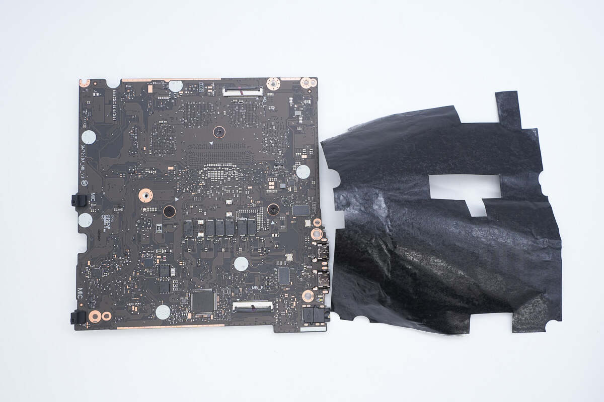

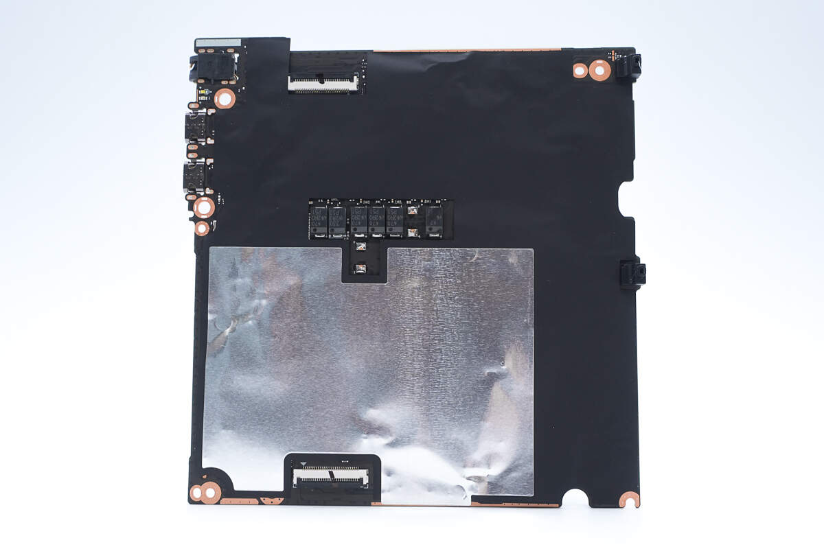

The back of the mainboard is covered with a black plastic insulating film, with aluminum foil shielding applied at the area corresponding to the back of the CPU.
Peel off the black plastic insulating film.

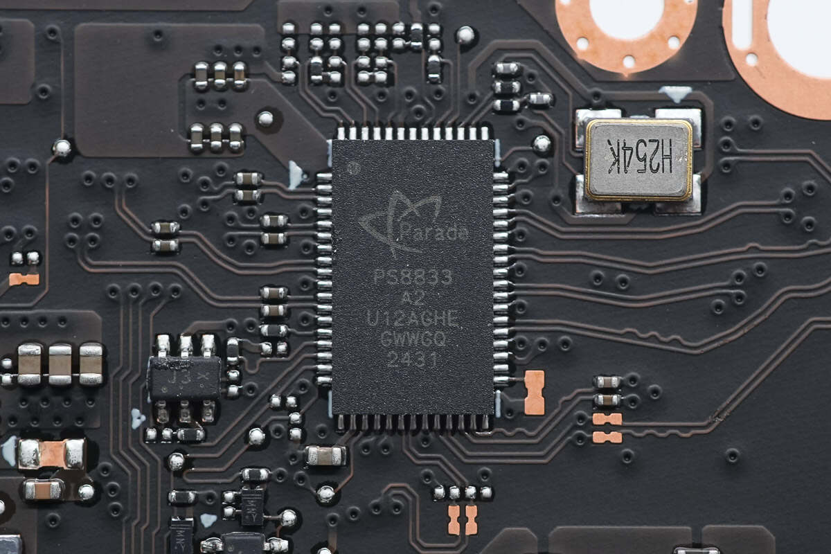

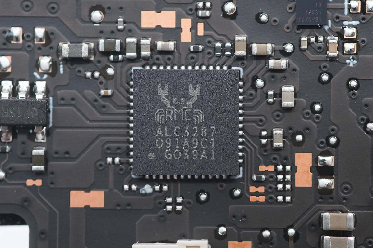

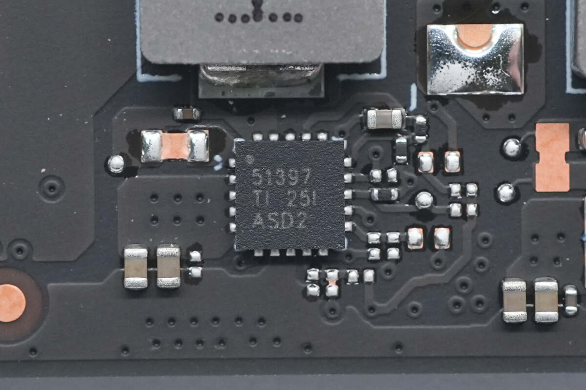

On the back of the mainboard are CPU power filtering capacitors, the retimer chip for the USB-C ports, the MCU, the battery charging chip, and the card reader chip.

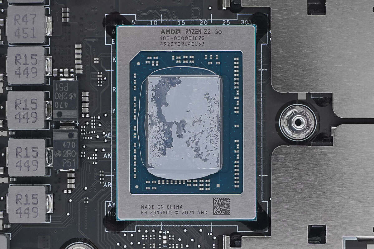

The AMD RYZEN Z2 Go processor is based on the Zen 3+ architecture, featuring 4 cores and 8 threads with a maximum boost clock of 4.3 GHz. It integrates 12 RDNA 2 GPU cores.

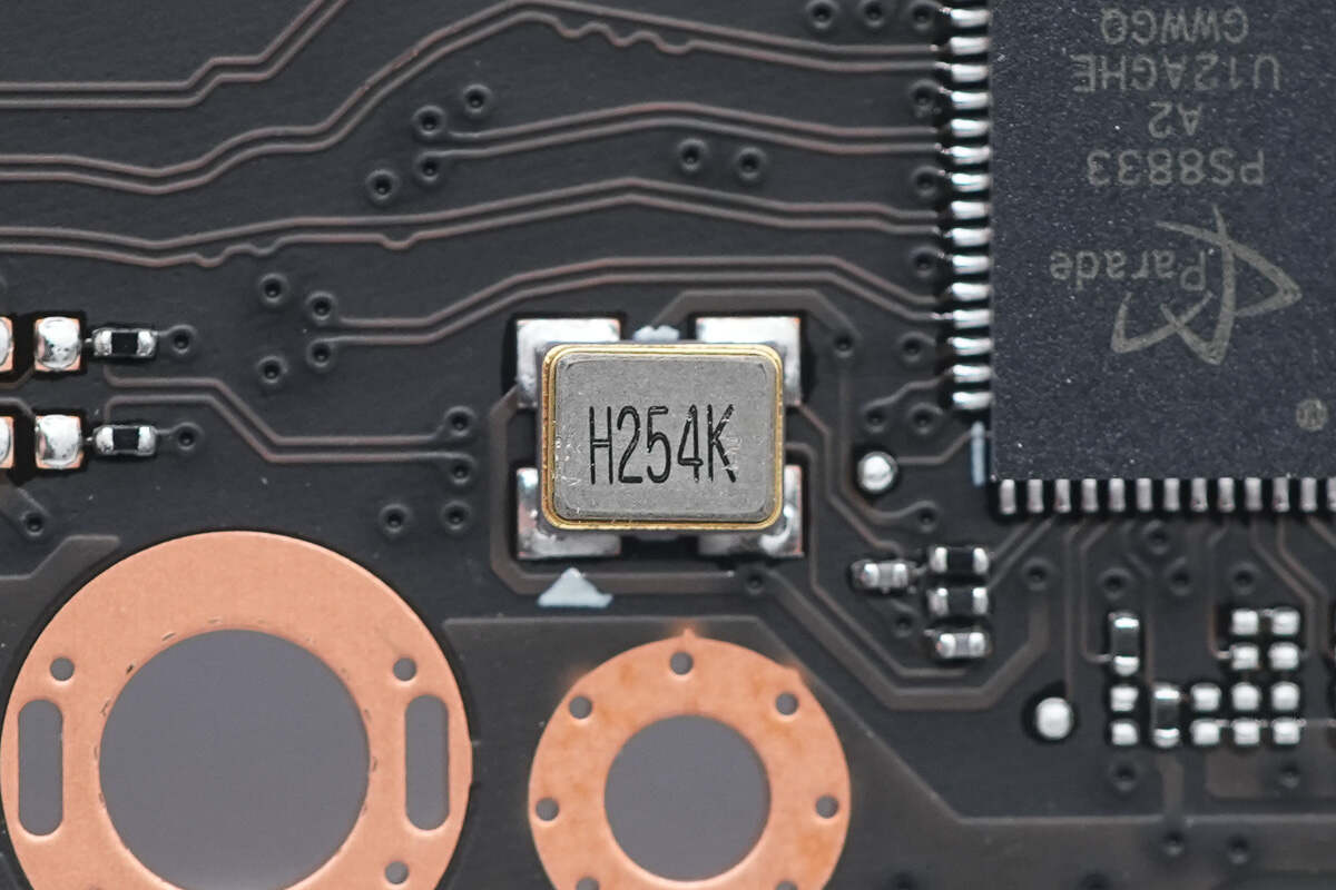

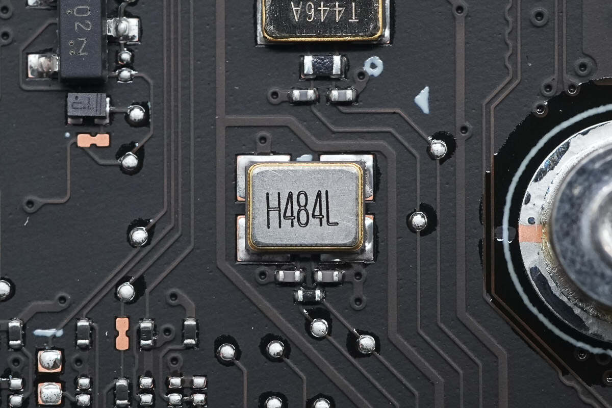

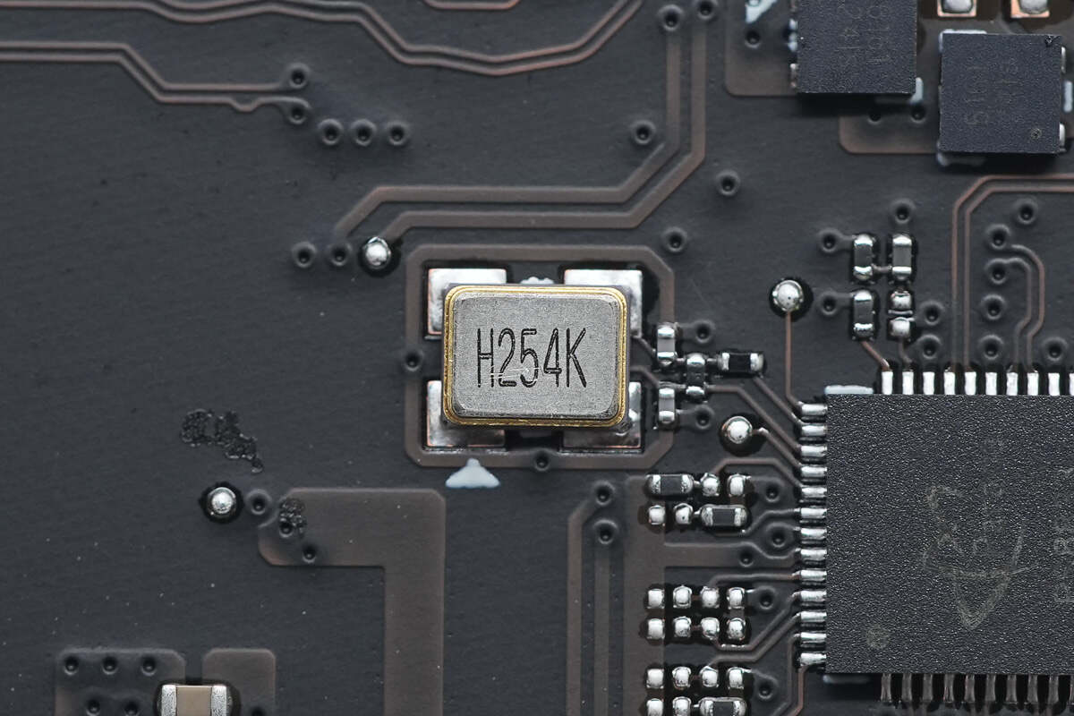

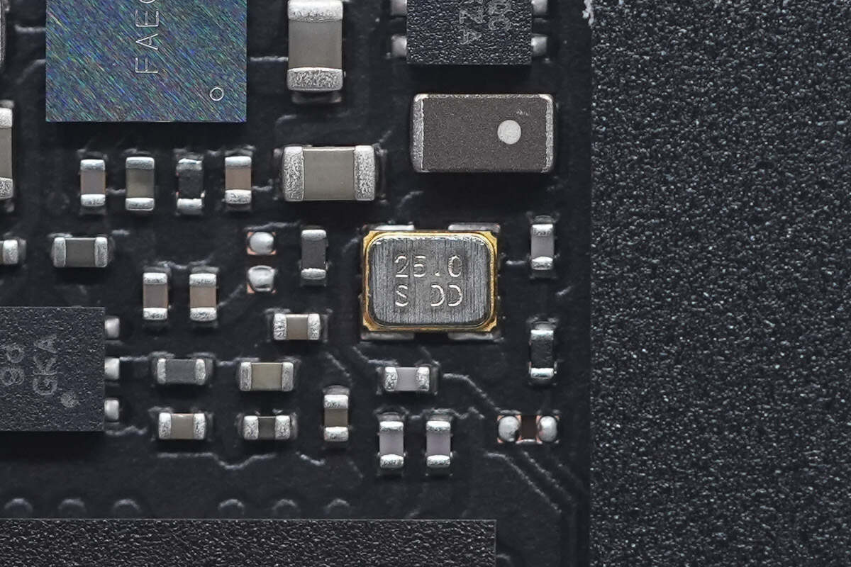

Close-up of the 48.000 MHz crystal oscillator.
Close-up of the 32.768 KHz crystal oscillator.

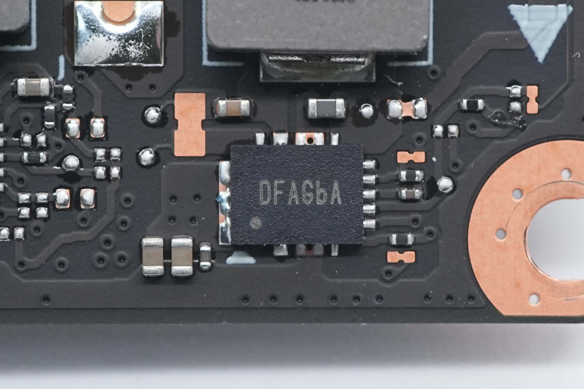

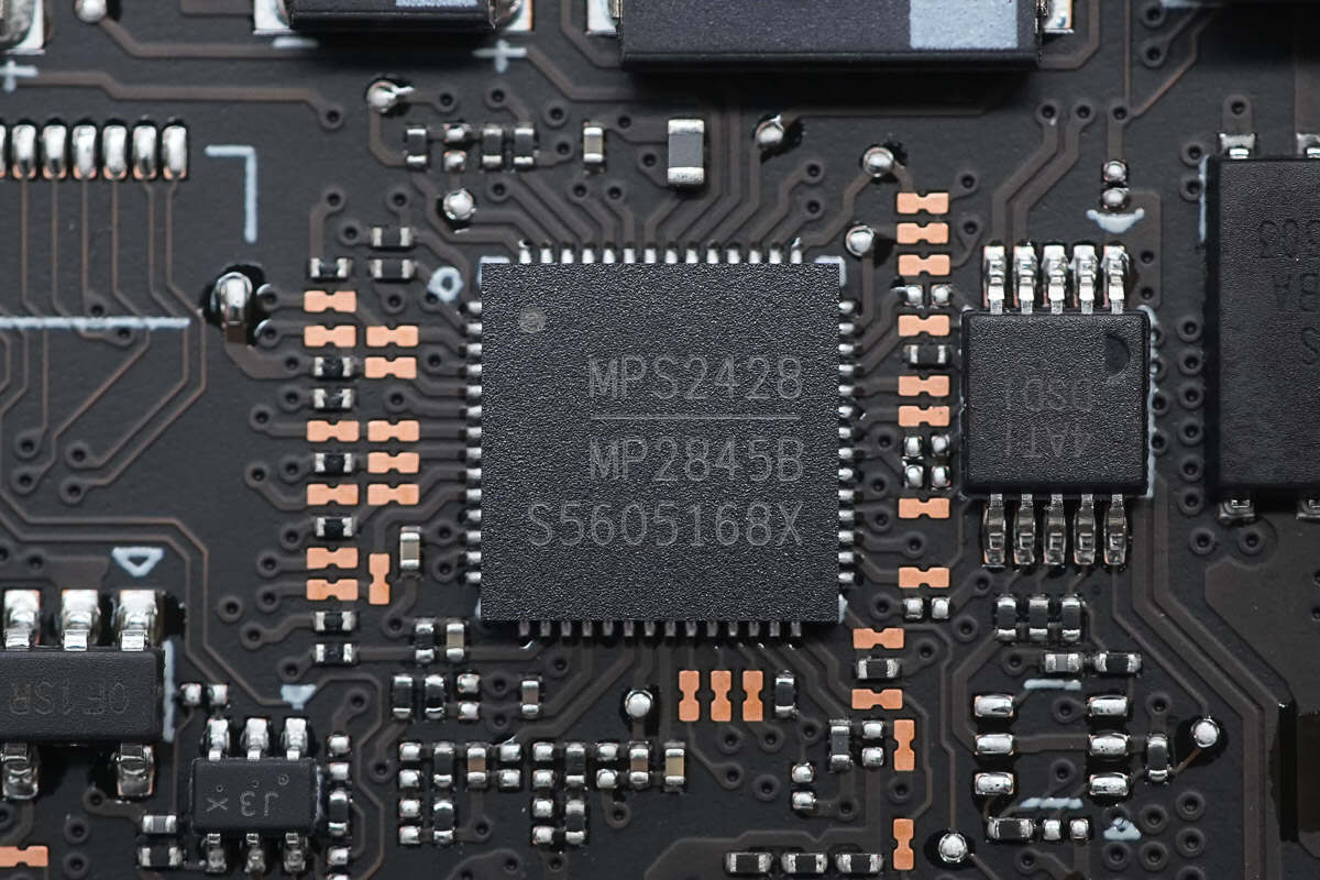

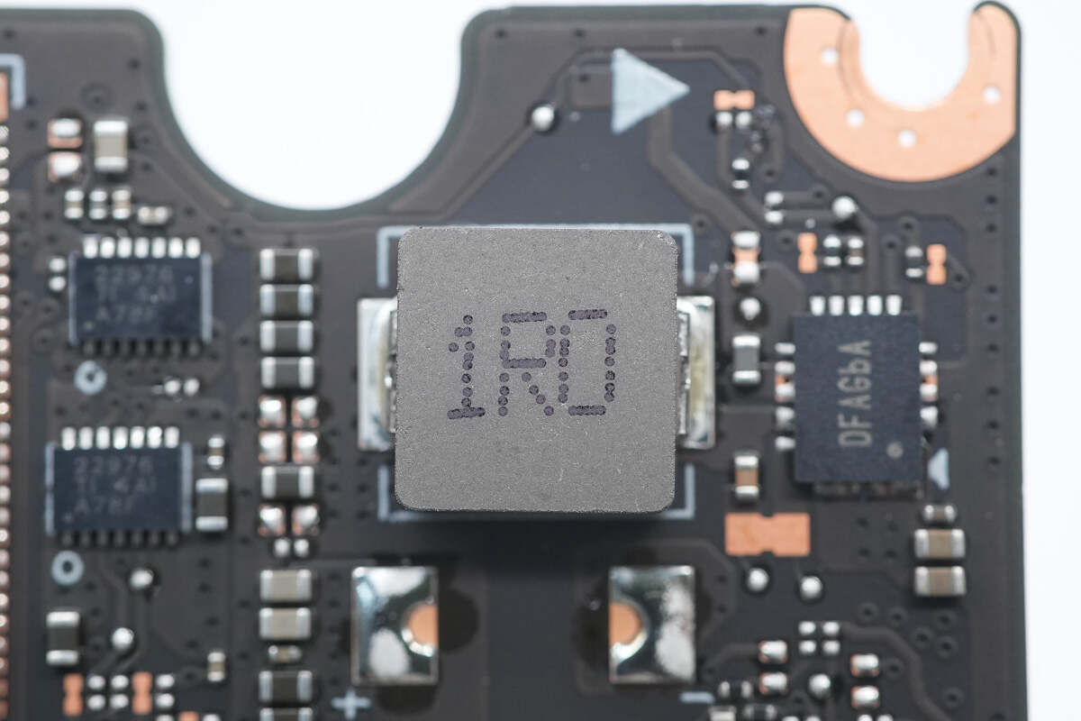

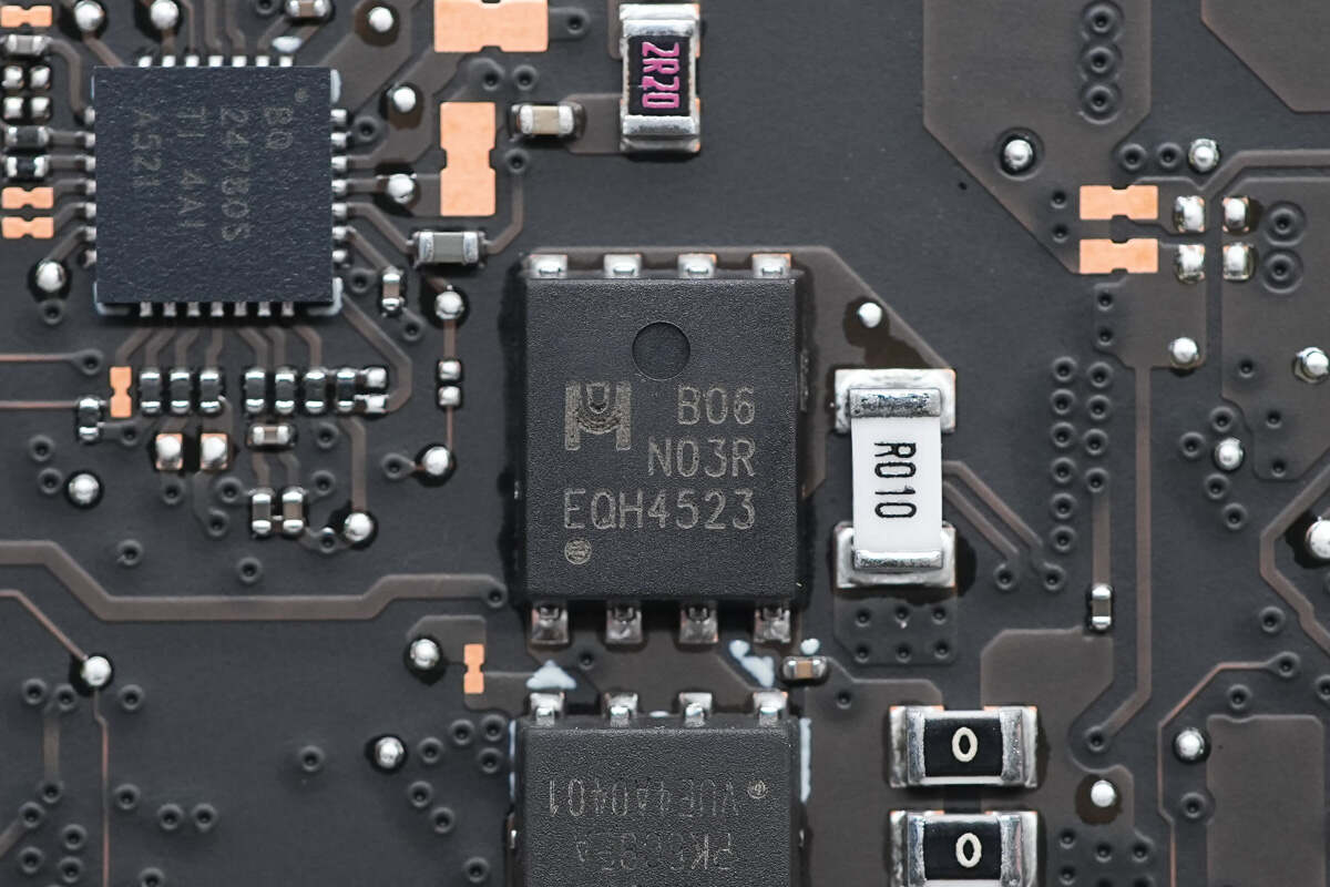

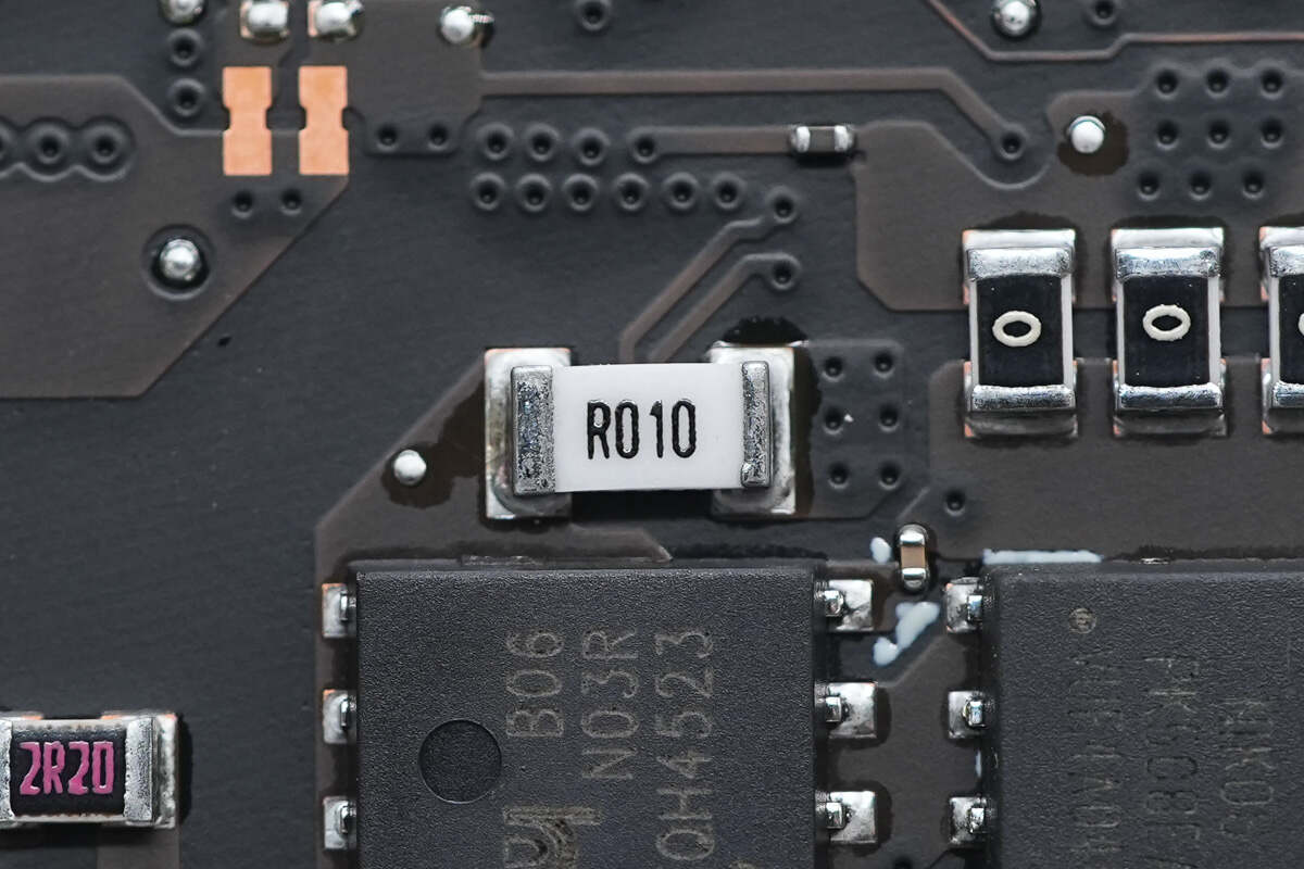

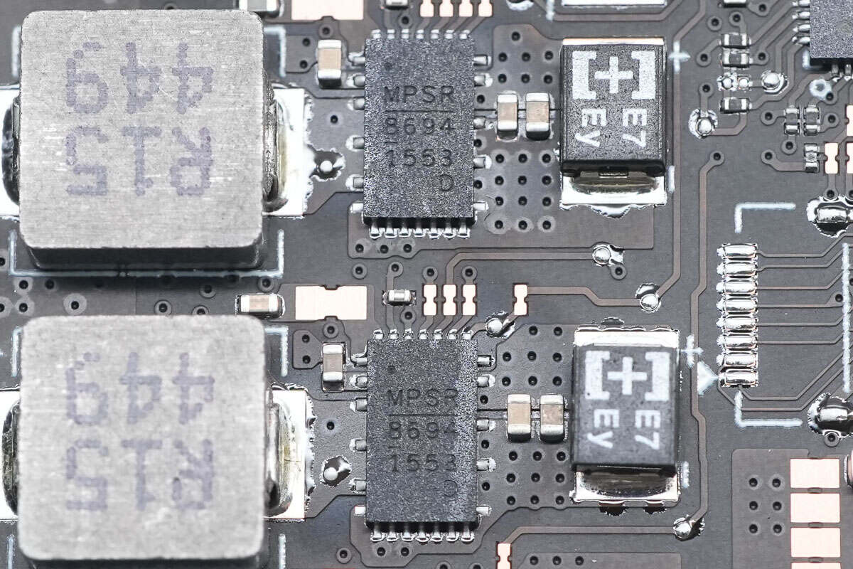

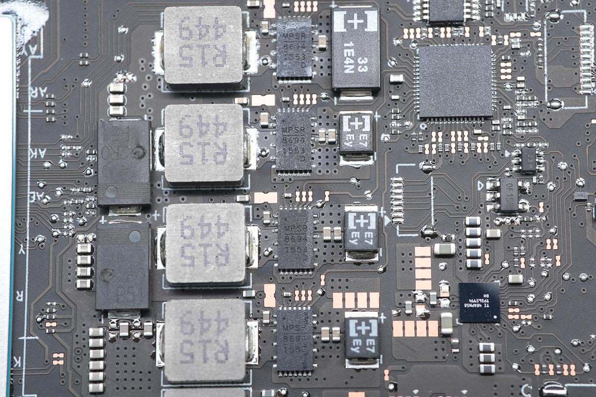

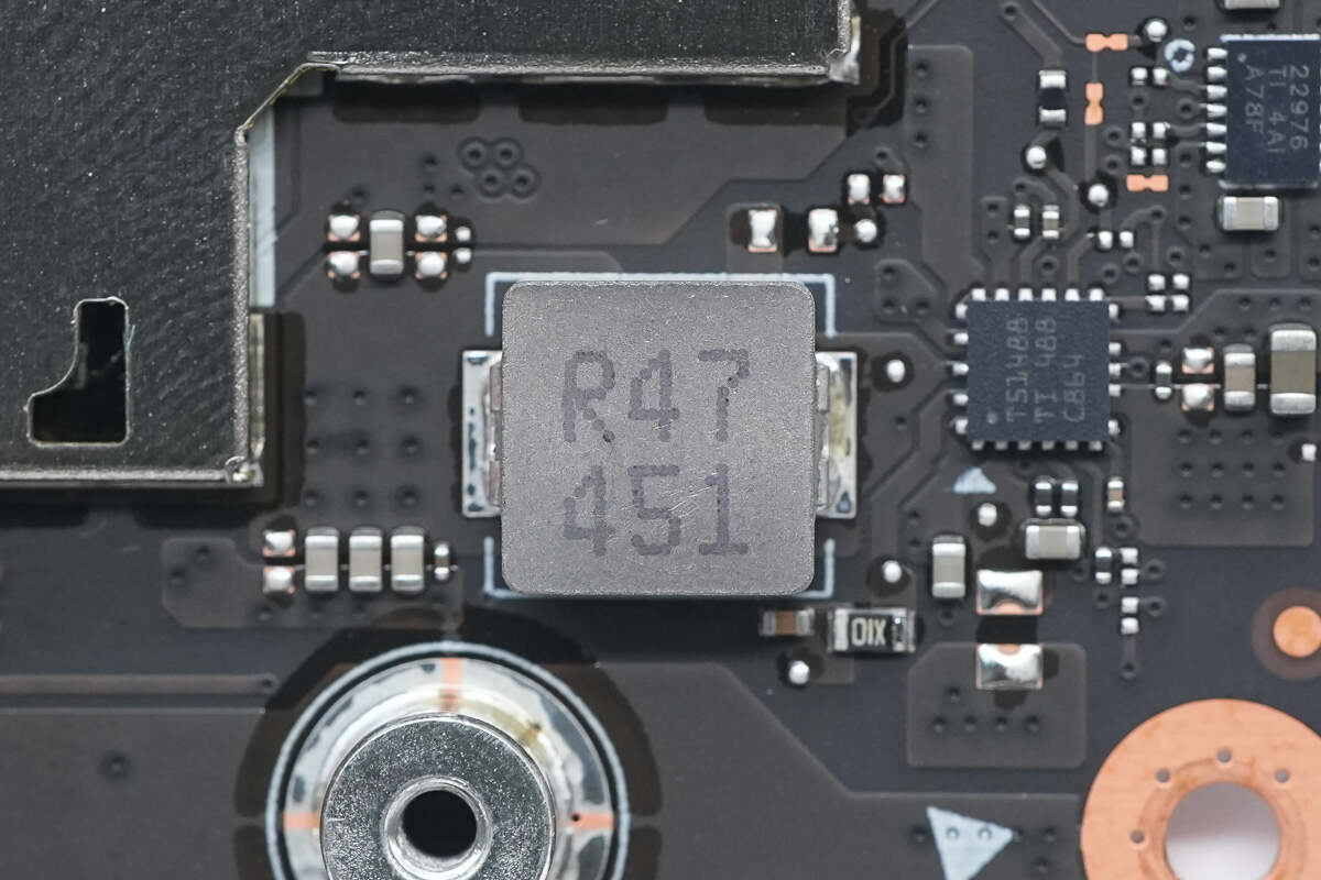

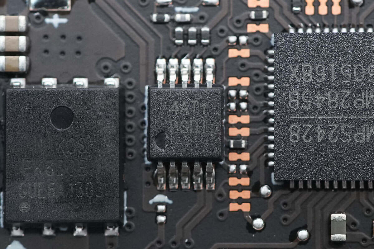

The power delivery controller is from MPS. Model is MP2845B。

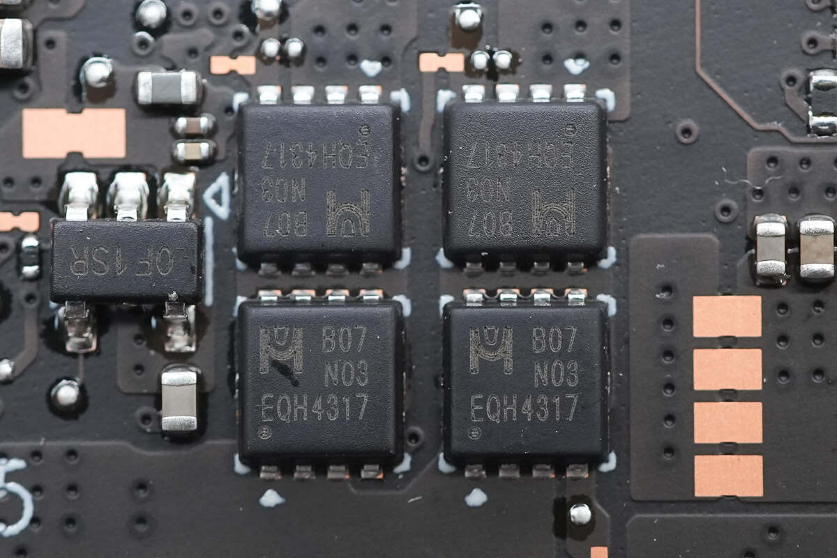

Close-up of the four-phase DrMOS used for CPU core power delivery.
The DrMOS is from MPS. Model is MP86941.

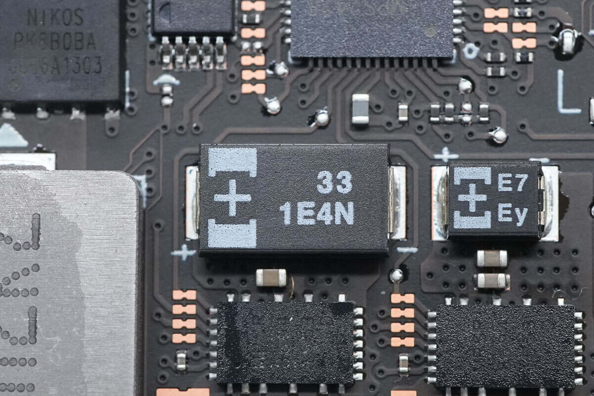

The power filtering capacitors are from Panasonic. 33μF 25V.
These power filtering capacitors are rated at 15μF and 25V.

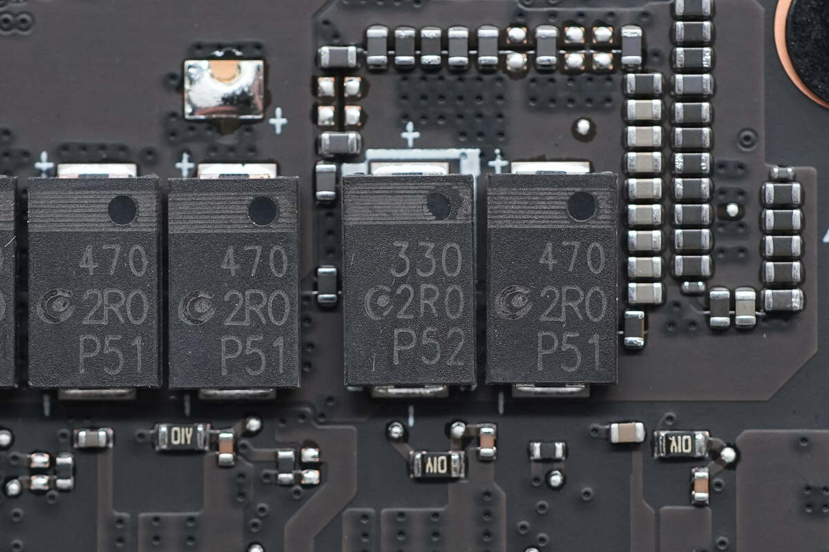

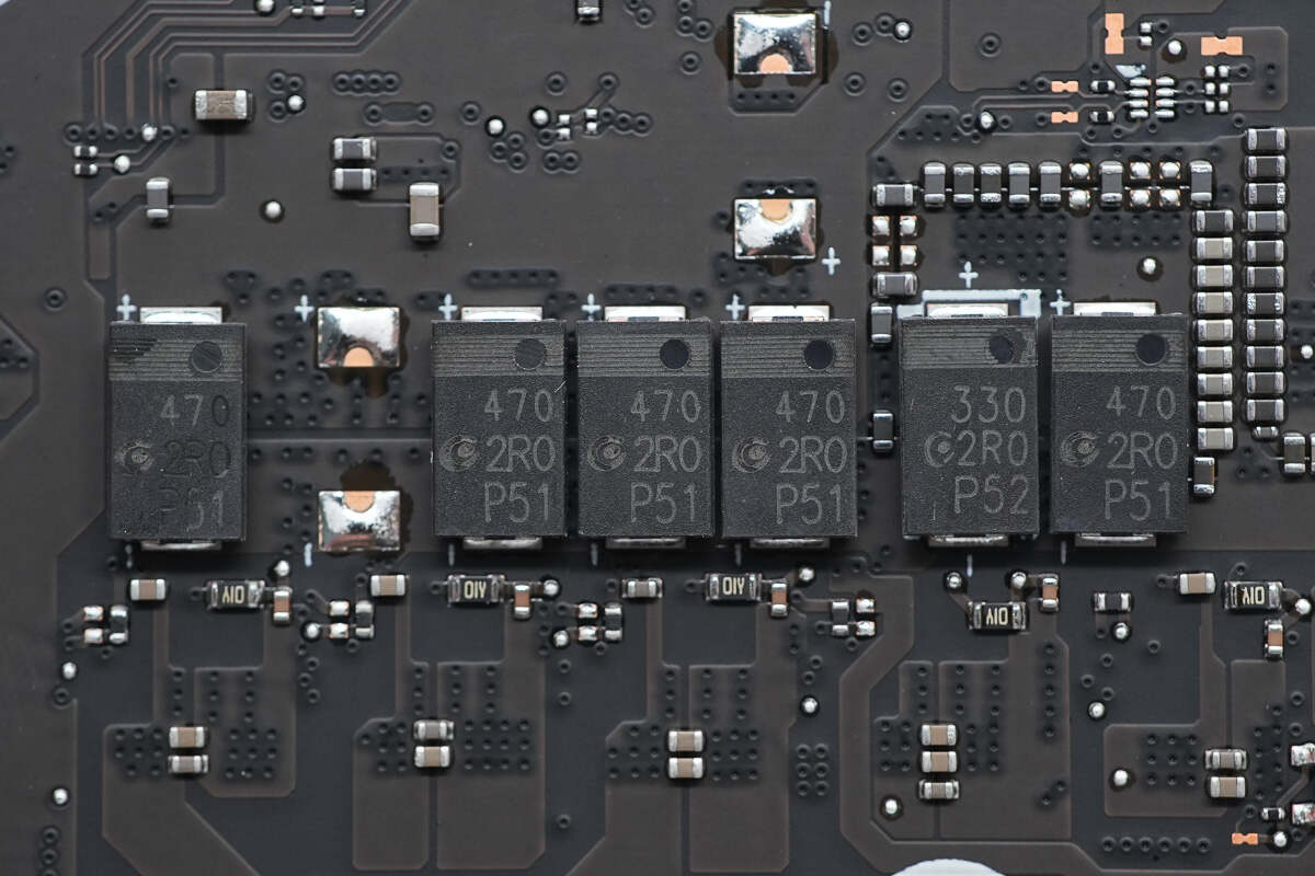

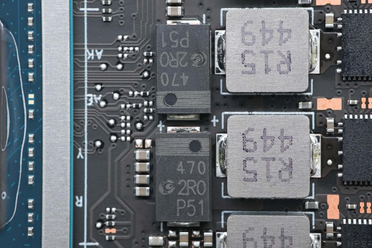

The capacitors for output filtering are from APAQ. 470μF 2V.
On the back, there are six filter capacitors, five of which are rated at 470μF and 2V.
The remaining one is rated at 330μF and 2V.

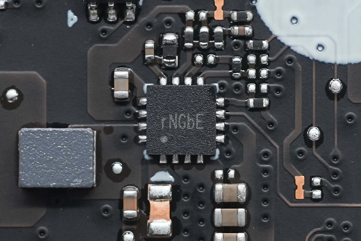

The back of the CPU features MLCC capacitors.

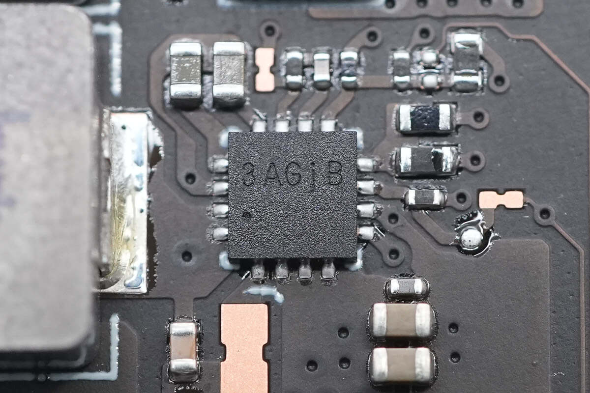

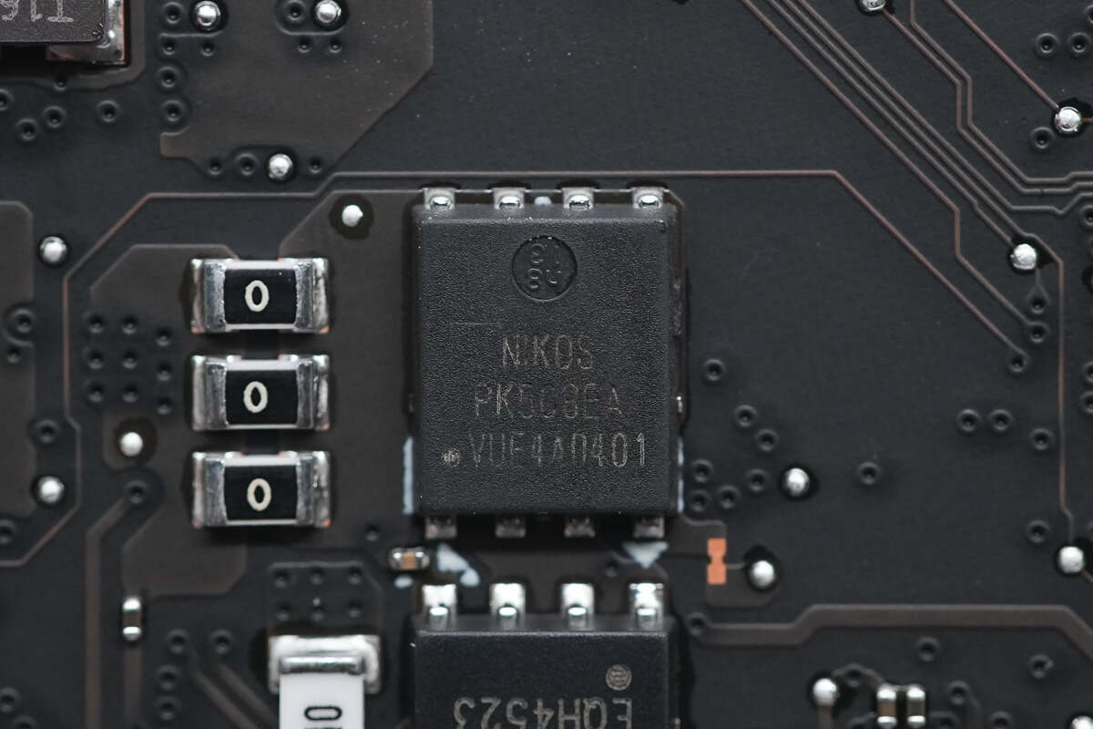

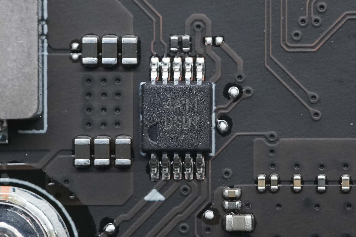

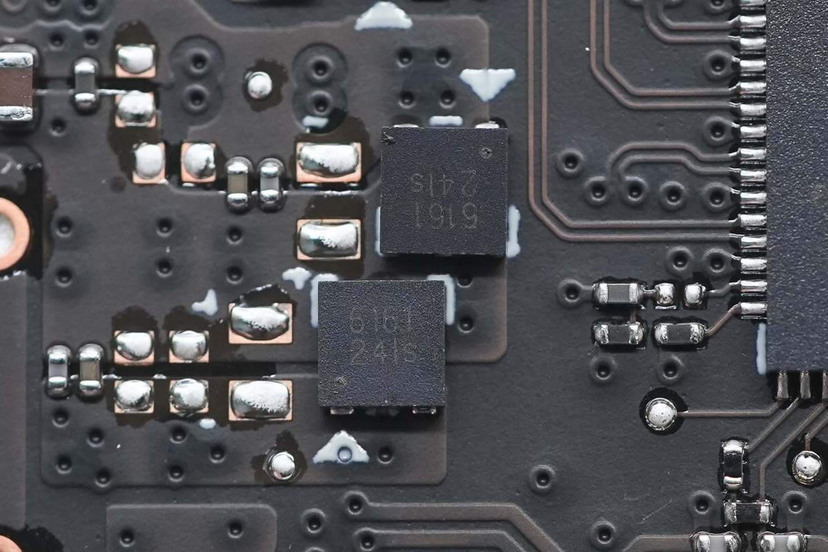

The DrMOS marked with AMV is from MPS and adopts a QFN-13 package. Model is MP86901-AGQT.
This chip is marked with 3AGjB.
The IO chip is marked with the Lenovo logo and LA1 IT5508VG-512.
The audio chip is from REALTEK and uses a QFN48 package. Model is ALC3287.

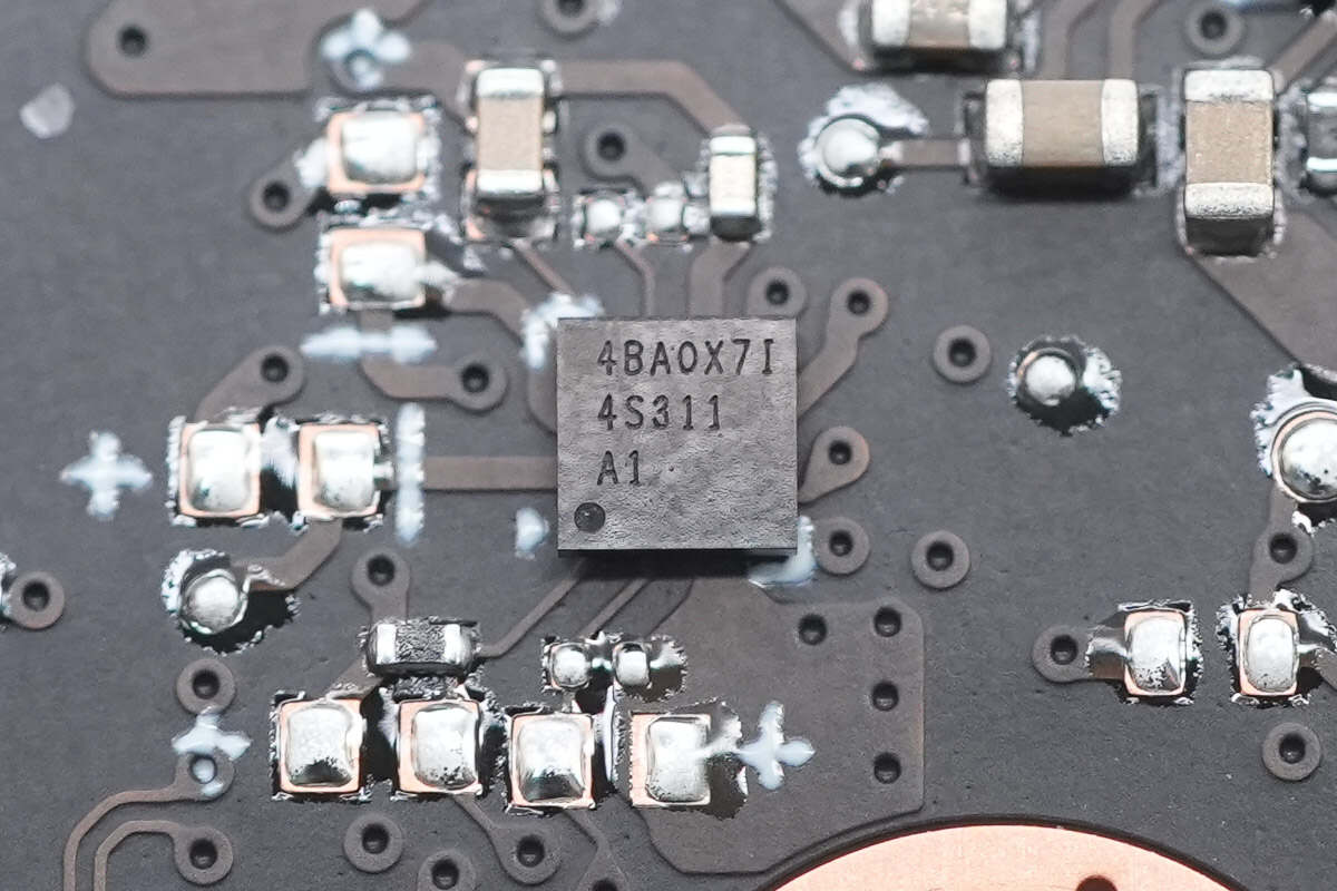

This chip is marked with 0F1SR.

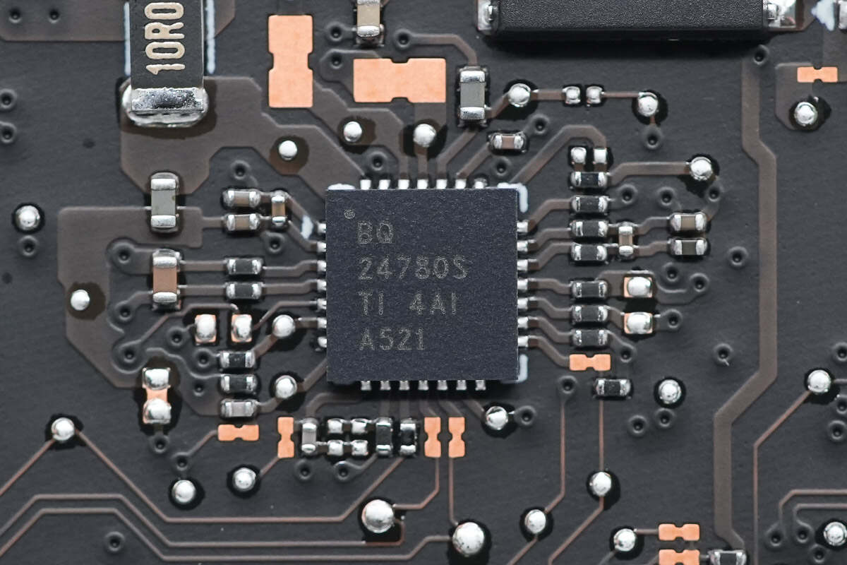

The battery charging chip is from TI. It is a charging controller supporting hybrid boost mode, compatible with input voltages from 4.5V to 24V, and designed for 1 to 4 cell battery applications. The chip features synchronous buck charging and supports hybrid boost mode. It comes in a WQFN28 package. Model is BQ24780S.
The VBUS MOSFET is from NIKO-SEM. It is an NMOS with a voltage rating of 30V and an on-resistance of 2.4mΩ, housed in a PDFN 5x6P package. Model is PK5C8EA.
The VBUS MOSFET is from Excelliance. It is an NMOS with a voltage rating of 30V and an on-resistance of 6mΩ, packaged in an EDFN 5x6 form factor. Model is EMB06N03HR.
The current sensing resistor is used for input current detection. 10mΩ.
The two MOSFETs used for charging are from NIKO-SEM. They are NMOS with a voltage rating of 30V and an on-resistance of 7.8mΩ, packaged in a PDFN 5x6P form factor. Model is PK8B0BA.

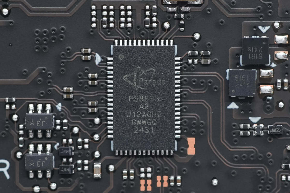

The retimer is from Parade. It supports USB4 at 40 Gbps and 20 Gbps, as well as DP and Thunderbolt Alt modes, and DP2.1 video output. It comes in a QFN62 package. Model is PS8833.
The chip is paired with an external 25.000 MHz SMD crystal oscillator.
A close-up of the other Parade PS8833 retimer, with two chips used to manage each of the two USB-C ports.
The temperature sensor, marked with DSDI, is from TI. It supports two external channels and local temperature detection, providing three channels of temperature monitoring with an accuracy of ±1°C. Communication is via the SMBus serial interface, and it comes in a VSSOP-10 package. Model is TMP432.

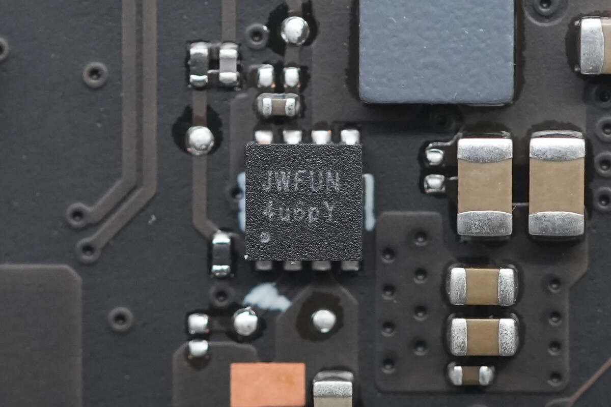

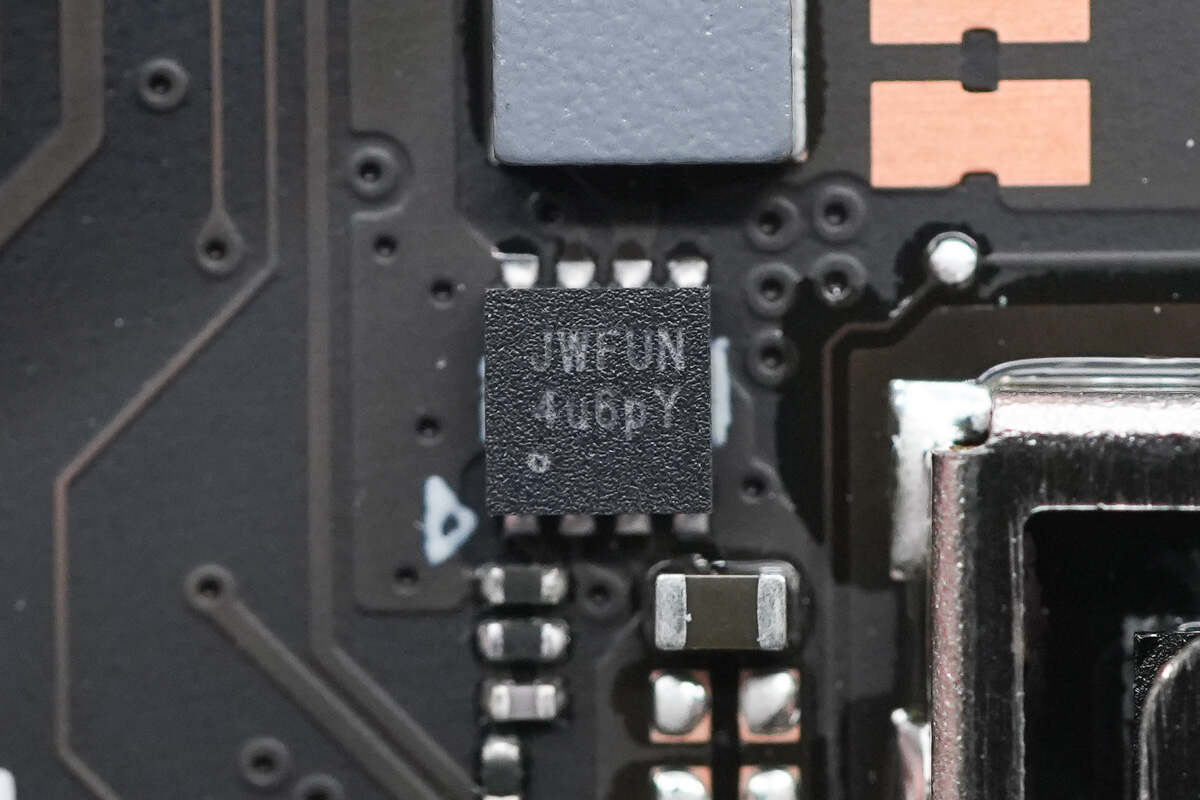

The synchronous buck chip, marked with JWFU, is from JOULWATT. It supports an input voltage range of 2.5-6V and provides a 3A output current. The chip integrates the switch MOSFET and operates at a switching frequency of 1 MHz. It features input undervoltage lockout, overcurrent protection, overvoltage protection, and overtemperature protection, and comes in a DFN 2x2 package. Model is JW5213L.

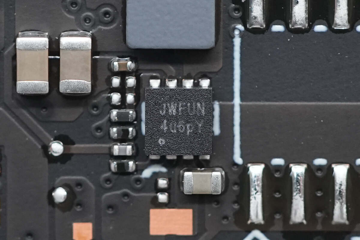

Close-up of the JOULWATT JW5213L synchronous buck chip.
A total of three JOULWATT JW5213 synchronous buck chips are used.

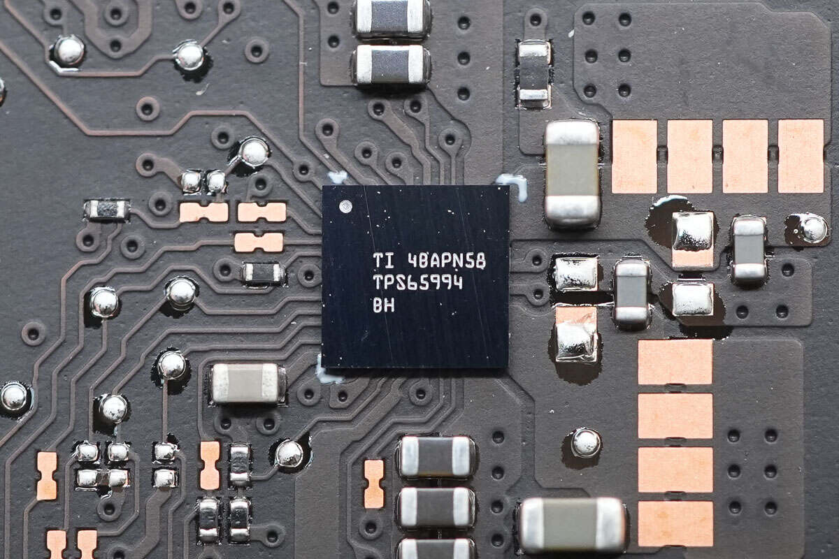

The LPDDR5 memory power supply chip is from TI and comes in a VQFN18 package. Model is TPS51488.

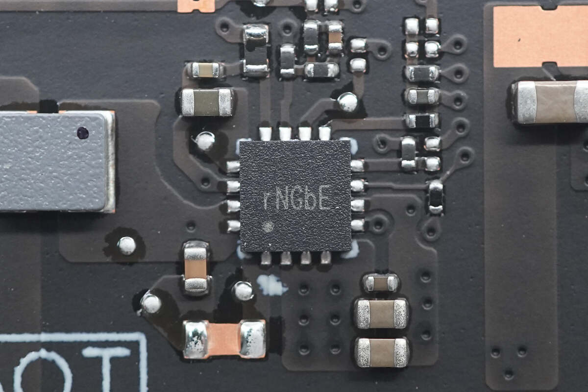

The synchronous buck chip is from Silergy. It is a high-efficiency synchronous buck converter that supports a 24V input voltage. The chip integrates 18/8mΩ MOSFETs and provides a fixed output voltage of 3.36V with a 10A output current capability. It comes in a QFN 3x4-13 package. Model is SY8371B.
Close-up of the 1μH buck inductor used in conjunction.

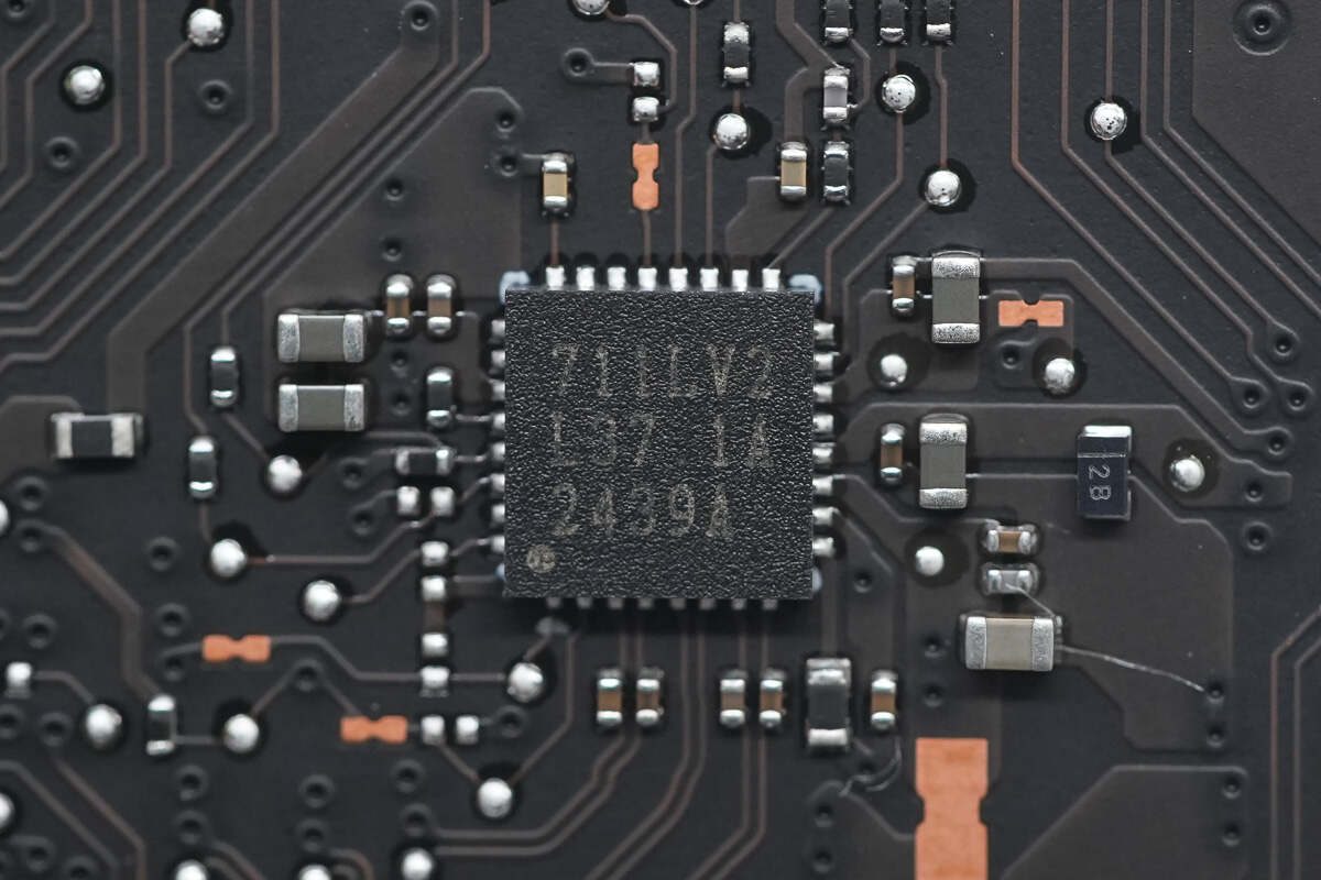

The synchronous buck chip is from TI and adopts the VQFN-20 package. Model is TPS51397.
Close-up of the 0.68μH buck inductor used in conjunction.

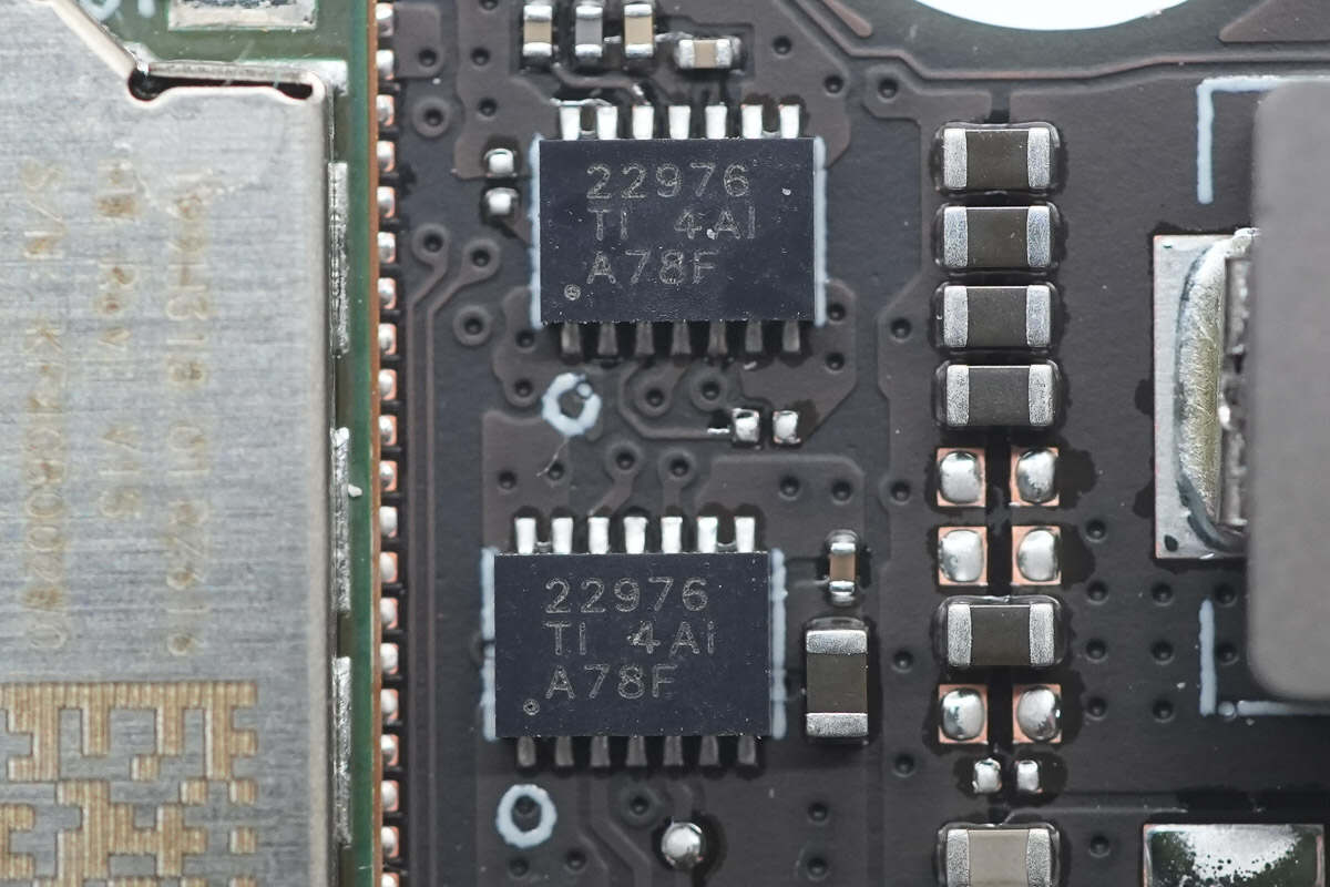

The load switch is from TI. The chip features two internal channels, supports 5V applications, and provides a maximum continuous current of 6A. It comes in a WSON14 package. Model is TPS22976.
A close-up of the other TPS22976 load switch.
A total of four TPS22976 load switches are used.
A thermal silicone pad is placed at the location corresponding to the SSD.

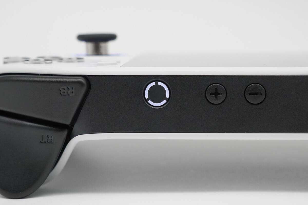

Close-up of the connector for the volume button flex cable.
Close-up of the power button flex cable socket.
Close-up of the connector for the power button flex cable.
Close-up of two USB-C ports, fixed with through-hole soldering.

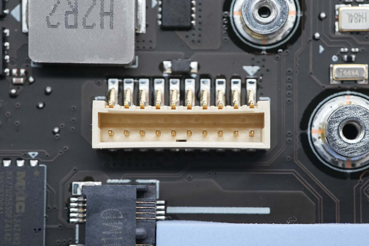

Close-up of the fan connector.
Close-up of the ribbon cable connector on the secondary board.
Close-up of the ribbon cable connector on the right-side secondary board.
The wireless network card features a built-in MediaTek MT7922 wireless chip. Model is RZ616.

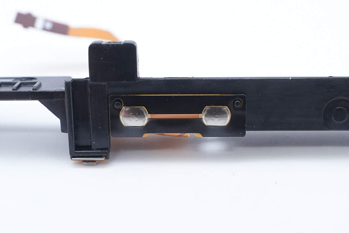

The shoulder button mechanism includes a range switch and a control button.
Close-up of the micro switch for the control button.

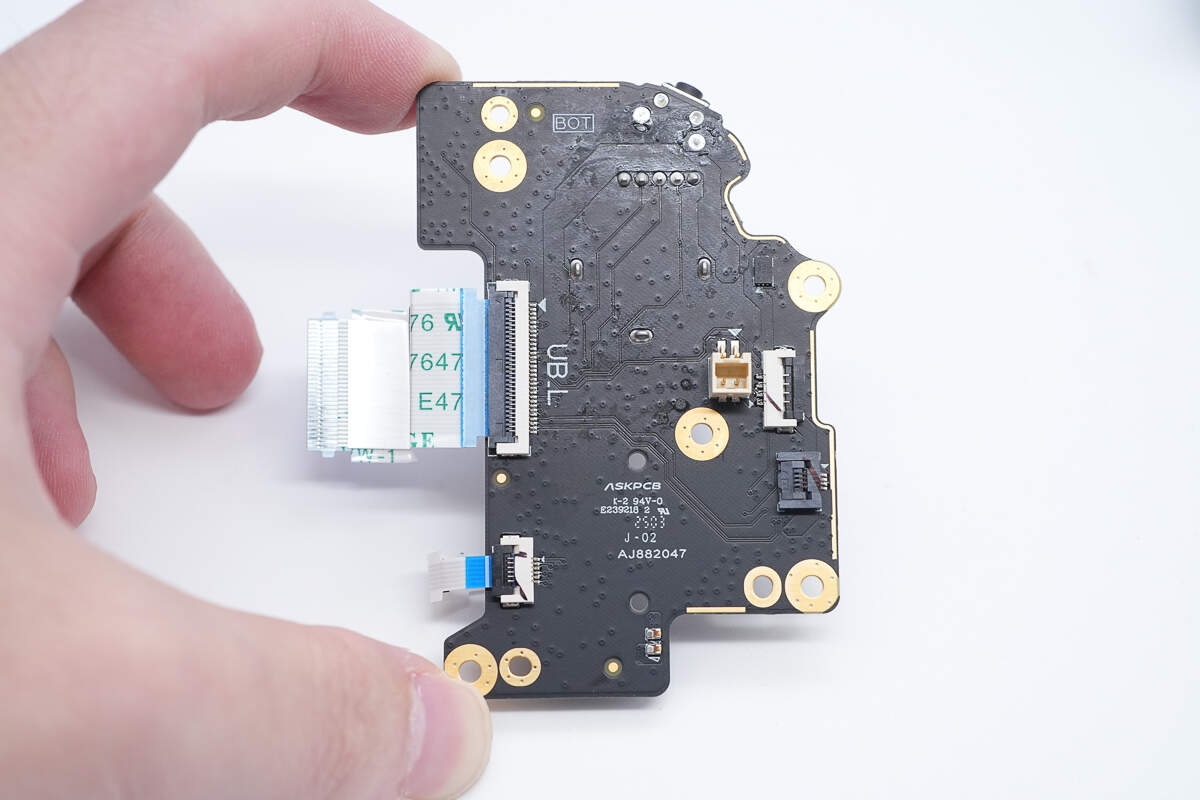

The secondary board features multiple ribbon cable connectors for connecting buttons and RGB LEDs.
In the upper left corner of the secondary board is a shoulder button, below it is the joystick, and function buttons are located on the right side.
The joystick is secured through through-hole soldering.
Well, those are all components of the Lenovo Legion Go S Gaming Console.
Here is the component list of the Lenovo Legion Go S Gaming Console for your convenience.
It features an 8-inch 120Hz high refresh rate display, with Hall-effect joysticks and Hall-effect shoulder buttons on both sides of the screen, along with a directional pad and function buttons for convenient gaming controls. It offers dual USB4 ports, supporting 100W charging and 4K 120Hz video output, making it easy to connect to external power sources, displays, and storage devices.
After taking it apart, we found that it is equipped with an AMD Ryzen Z2 Go processor and uses MPS power management chips along with DrMOS. The audio codec chip is from Realtek. The internal USB-C interface controller, port protection chip, and battery charging chip are all from TI.
The USB-C retimer is from Parade, and the synchronous buck converters are from JOULWATT and Silergy. For the CPU power supply, SMD capacitors from APAQ and Panasonic are used. There are secondary boards on both sides inside the device, connected to the mainboard via ribbon cables. Components such as the battery pack and cooling fan are also connected through plug-in connectors, which facilitate assembly and manufacturing.
