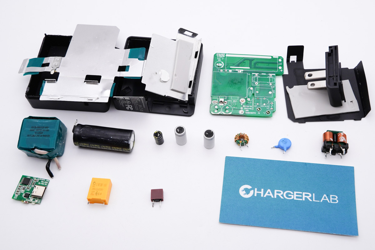

As always, use a spudger to pry along the gap. The PCBA module is covered with aluminum heat sinks.
Teardown of DeWalt 65W Charger of the Charging Kit (2AEK0655)-Chargerlab
The PCBA module is fixed with dark cyan tape.
The heat sink is secured with snaps.
The length of the PCBA module is approximately 58mm (2.28 inches).
The width is also about 58mm (2.28 inches).
And the thickness is about 24mm (0.94 inches).
The input wires are insulated with heat-shrinkable tubing.
The heat sink is soldered to the PCBA.
Remove them; you can see that there is a black Mylar sheet inside, which is connected to the PCBA module through a gray thermal pad.
The output USB-C socket is soldered to the vertical small PCB, and the transformer on the side is also insulated with dark cyan tape.
The fuse, common mode choke, safety X2 capacitor, and high-voltage capacitor are on the front of the PCBA module.
And the bridge rectifier, master control chip, synchronous rectifier controller and feedback optocoupler are on the back.
ChargerLAB found it adopts QR flyback topology, which can output a wide range of voltage. Next, let's examine the information of various components, starting from the input end.

Well, that would be all the components of this charger.
The DeWalt USB Charging Kit consists of a charger, cable, and charging module. It not only charges battery packs but also allows them to be used as power banks for charging mobile devices. Moreover, the 65W charger is powerful enough to meet the charging needs of most smartphones, tablets, and ultrabooks.
In terms of internal structure, its PCBA module covers a lot of aluminum heat sinks, supplemented by thermal pads to further enhance heat dissipation and reduce temperature rise during prolonged high-power output. This is crucial for devices that are likely to be used in harsh outdoor environments. So, if you already own DeWalt battery packs or power tools, this upgrade will certainly be worthwhile.
